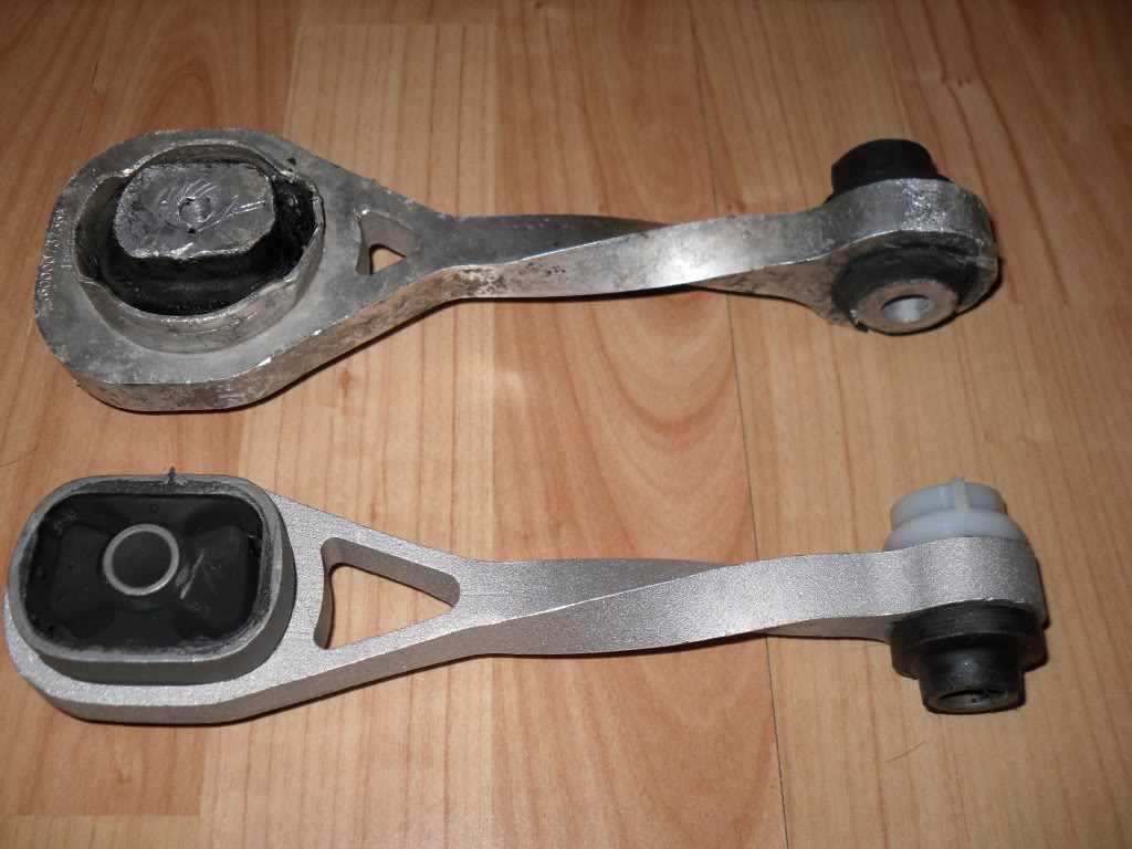

I bought some powerflex bushes for my dogbone mount and set about removing my old ones. Unfortunatley i didnt really have the correct tools to get the old ones out and kinda chipped/bent the metal of the old mount. I ordered another off ebay which stated was for a 182 and it arrived but it seems to be a different shape all together to my old one.
Higher one is off my 182 and the lower is the new one
My question is does anyone know what the lower one is off and does it fit the same as my old one does, not sure the bushes would fit as the metal is a completely different shape ??
If its for a different car/model will mine still be able to be refitted it does have slight dents into the metal but doesnt change the structural shape of the mount.
Thanks for your help
Jay.
  Clio 172mk2
the bottom one looks like a after market one , so not a renault part (unless they changed design later on)
shud still be able to use yer original one tbh, hammer n chisel to get the old rubbers out, or a press like garages use

Cheers Biojo,
Dont think the new powerflex bushes would fit in the new one as the powerflex bushes are round but the new mount is more square :( so looks like using the old mount would be the best way.
Just hope the few little dinks i put in it dont do it any harm, i tried using a hammer and burning them out but unfortunatley just messed it up. Will probs try taking it to a garage to get pressed out tomorrow then. Just hope they can still get them out as parts of the bushes are knackered now. :dapprove:
