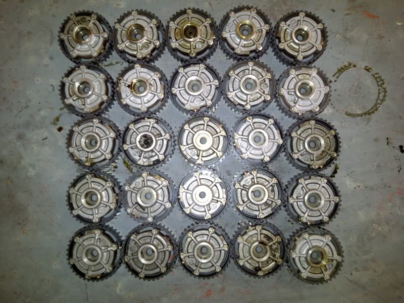

considering people say the dephasers never go wrong or whatever, there has been an awful lot that do this. mine was the same. and there are loads on here that have sorted the problem by changing the dephaser.

only uneducated fools think dephasers don't go wrong, its one of the most common failures i see

def dephaser, mine sounded the same, just had belts and dephaser done, now its purring as it should do and no longer sounds like a tank!!! Get it done its worth it in the end!
