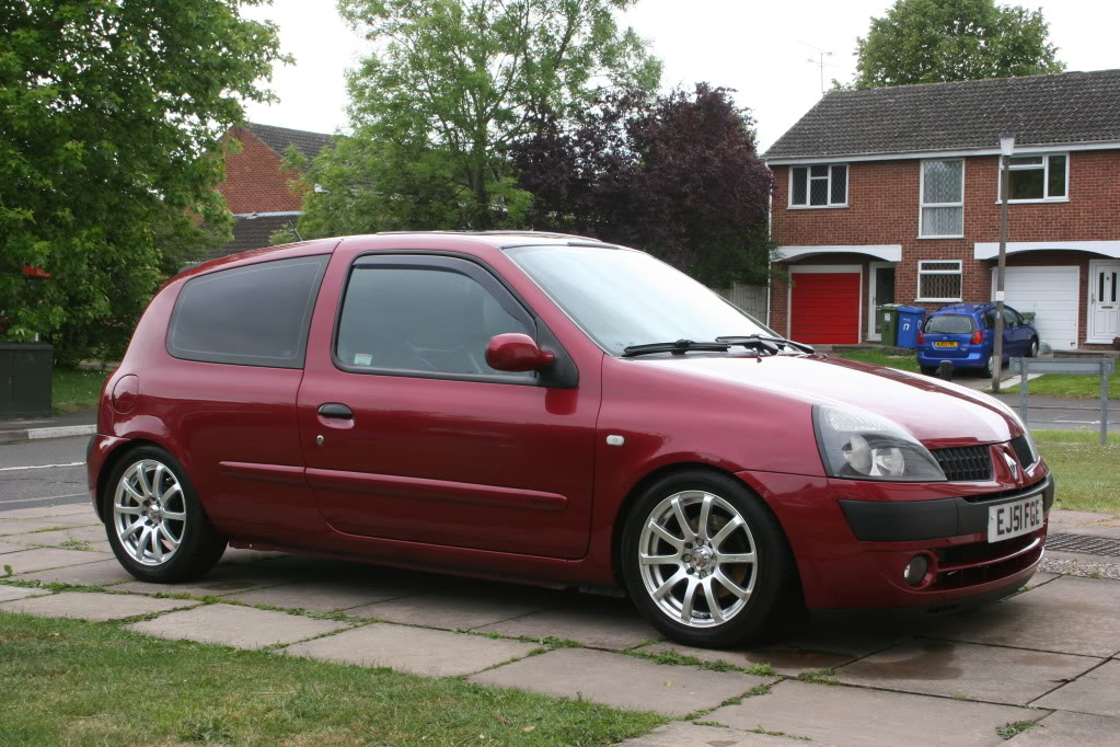

I'm basically looking into getting some coilovers for fast road use in the coming months but I'm quite undecided on what's best to go for as there are so many split reviews. I don't have really deep pockets (£450 max) and because I'm not planning on tracking my Clio I don't need anything to fancy. However, id like something that will be bearable for everyday driving. I'm lucky as the roads in my area are pretty decent. On my previous Clio (1.2 16v) I ran Raceland/Rokkor coilovers, I know some people slated them but for what I wanted they were fine. Id probably want something abit better. This is the kind of height I was driving at, so something similar would be ideal.
