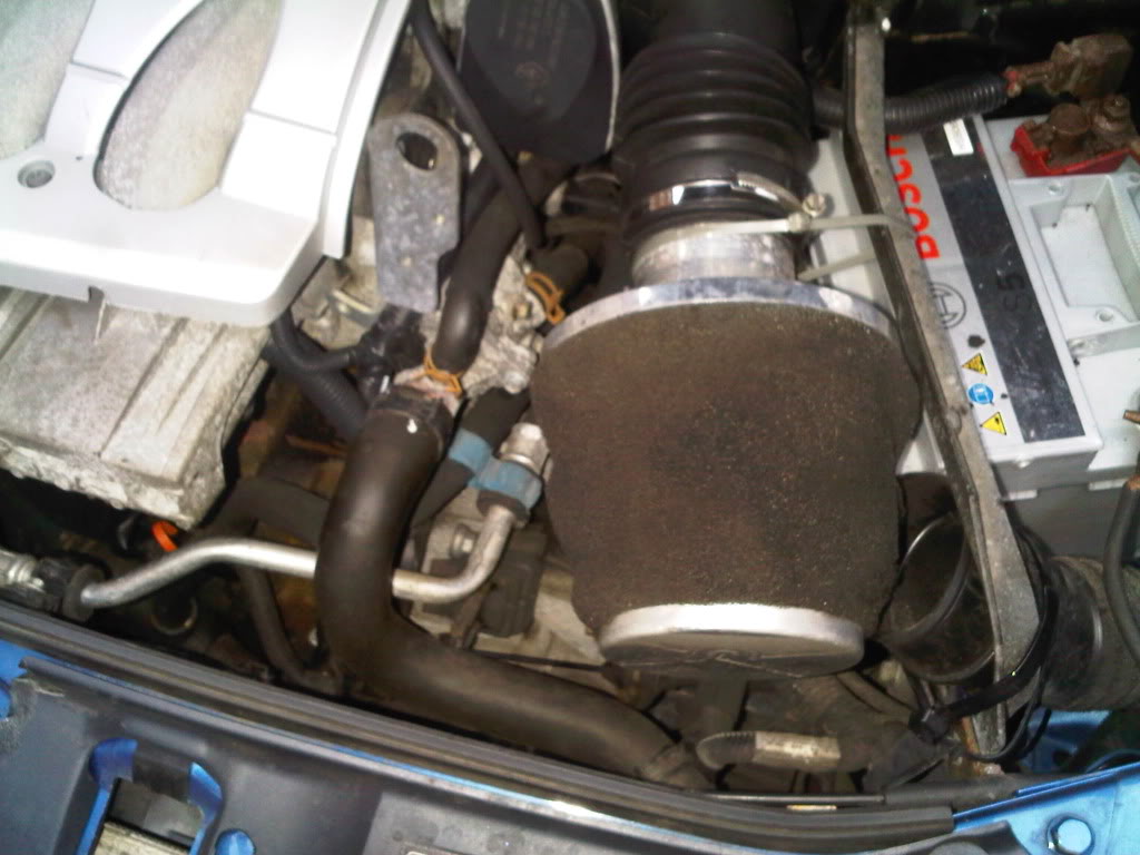

I did mention this to the guy at the garage that it could be something intake related but he wasn't sure, here's a picture of the induction kit that came on the car when I bought it. I've been thinking about switching it back to the standard set up but it hasn't caused a problem as of yet so haven't. I don't think that it is the induction kit though, the sound is loud and is not like the faint high pitched noise some kits produce, sounds like something else to me.

Ever heard of Heatsoak? Get a standard set up on there, you are probably down on power by the time the engine warms up.
Also, that CAF will do nothing whatsoever.
I reckon the noise will go once you have a standard set up on there. You should be able to source on for £50 max, and you can sell that on to someone else to make some of your money back.
EDIT: If you don't do that, at least clean that foam thing, it is filthy, looks like it has been on there at least one year.

Yeah lol i'm doing a motorsport engineering degree at uni so fully aware of the affect/cause of heat soak. This is how the induction kit came when i bought the car, I assure you it is not how I would set it up as I don't believe in induction kits and think there more noise than power. I'm looking to get it to running good before any mods so probably will switch back to a standard air box. When it was on the ramp today I also noticed that the exhaust mounts were ancient and the exhaust itself is very rusty. I'm going to purchase the militek (iirc) exhaust off the ktr website and fit it next week so i'll do the air box at the same time and hopefully the noise will go! Video of the noise to follow....

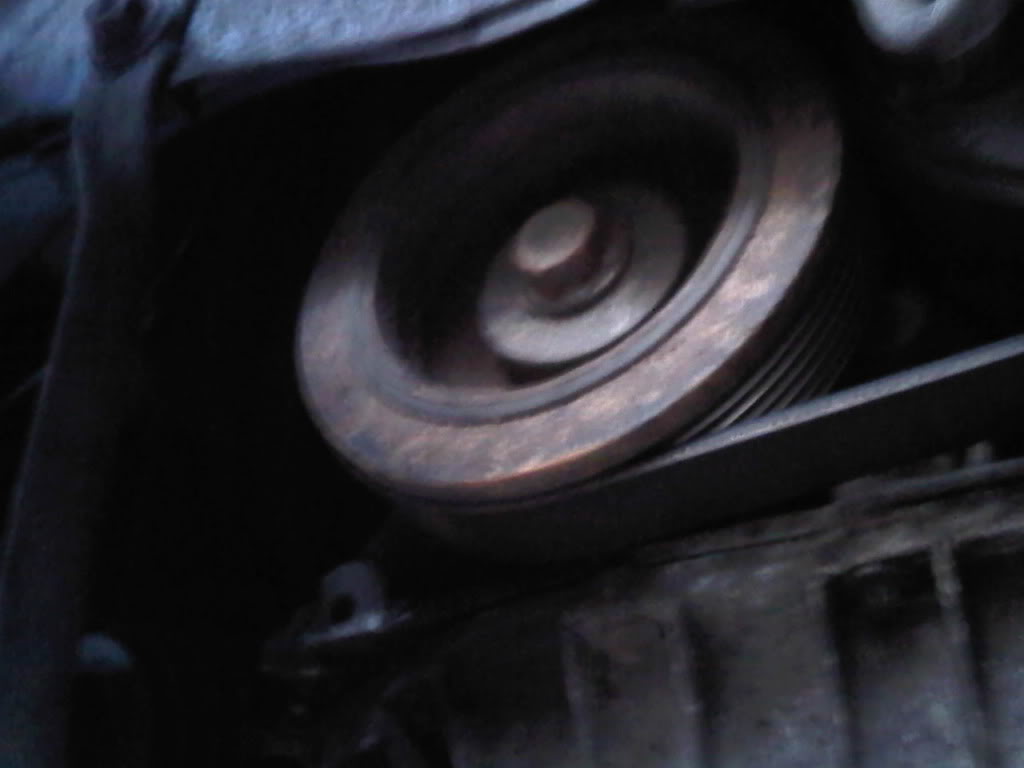

This sounds more on the money (literally) however I was hoping it wasnt this due to the cost of getting the work done :( If it is this then it could be the bearing on the idler perhaps? As previously said im studying motorsport engineering but am better with the design side rather than the mechanical so here is a picture below of the only pulley I could see when under the car, notice how it looks fucked perhaps due to the abscence of the inner wheel arch trim? I checked the belt for wear and looks good. Anyone know of a clio specialist I could go to for a more educated opinion in hertfordshire area or enfield?
That's totally normal, and that's the main crank pulley, the idler is the furthest foward on the aux setup at the bottom. I'd also be dubious that you can check the wear of the belt visually, or even while it is on the car at all!
As previously said im studying to be an engineer not a mechanic lol, I just gave it a visual check, compared to the cambelt on my gti lupo before it was done it looks mint. The lupo's cambelt had cracks in the material that suggested it was on the verge of snapping. I'm gonna get a new exhaust and get the standard air box coz there both gonna need doing so hopefully that will sort it. When you said the aux belt idler I assume you do mean the bearing within the pulley?
