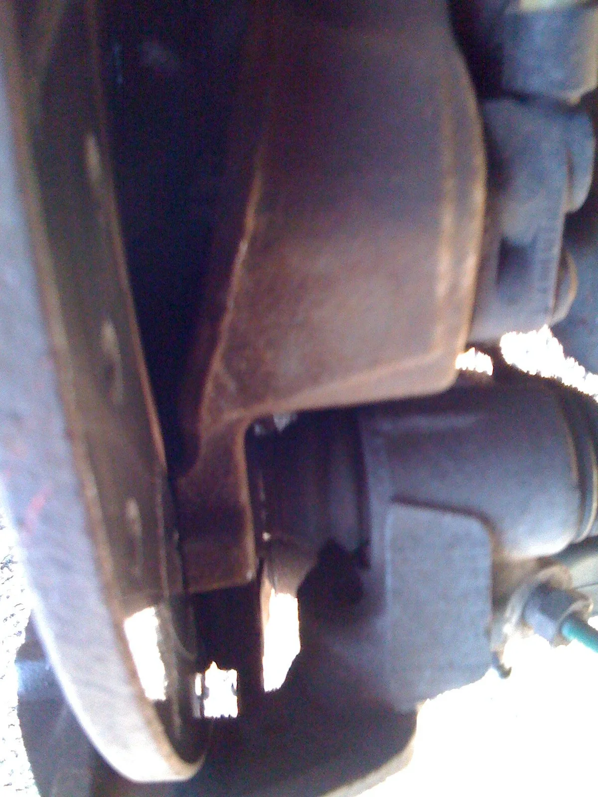

I heard a grinding noise coming from the rear passenger side brakes and i could feel a scraping throught the brake pedal so i took the wheel off to find that the actual hub was touching the disc and grinding on it!
I asked my mate whos a mechanic and he said hes never seen anything like it and wasnt sure how to fix it. Anyone had the same problem or any ideas of what to do? :S
There should be a washer plate between the back of the disc and the hub. Did someone forget to fit it?
I did change them myself but im sure i put everything back on that came off, its only started happening recently but i changed the discs a couple of months ago
Did the discs come with bearings?? If not where the new ones fully pressed into the back of the discs.
