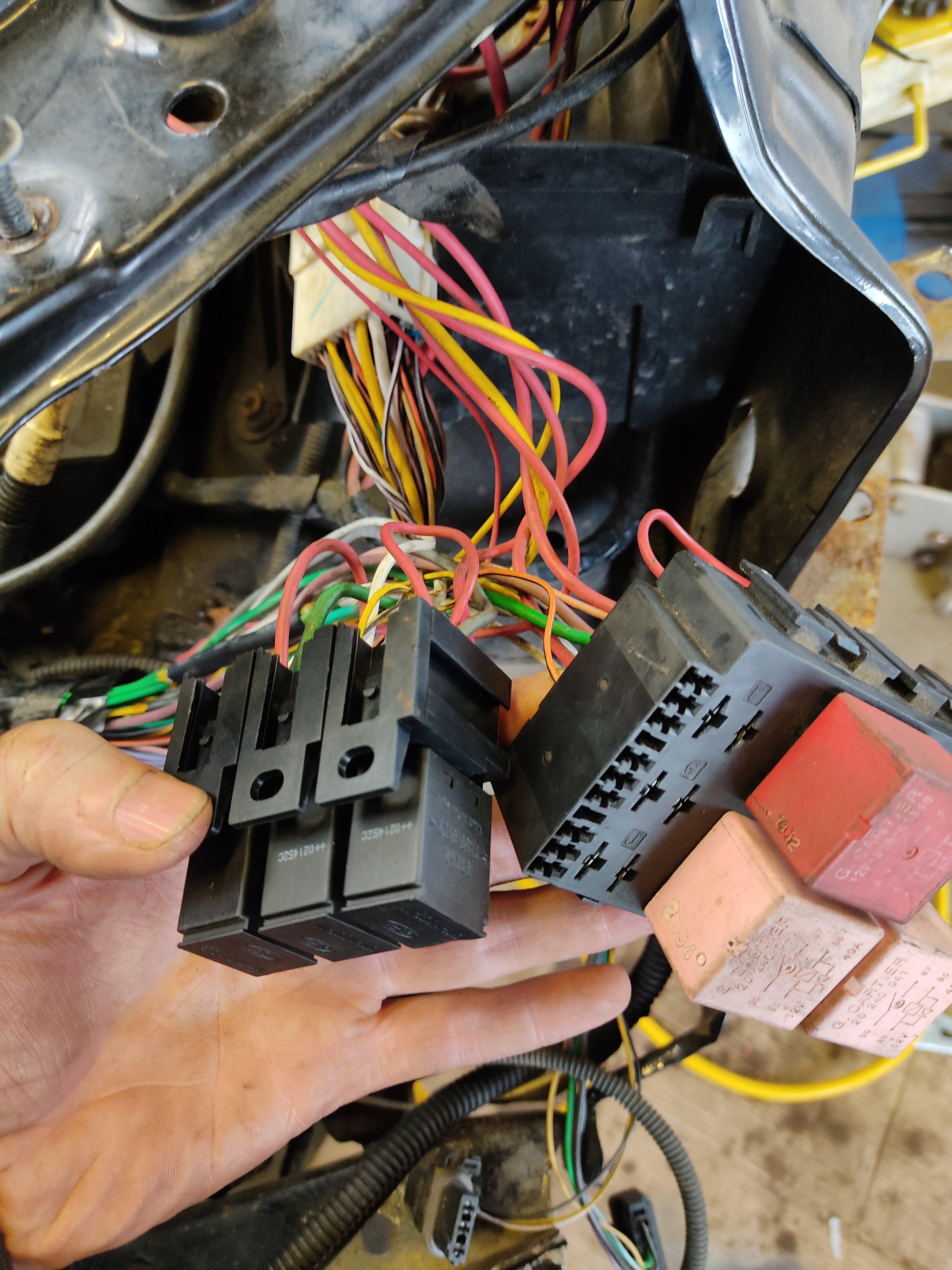

Car was running prior to the engine coming out. Put it back in and the immobiliser light staying on. Turns over for 3 seconds and stops.
1. Earths checked and replaced gearbox strap.
2. Small black engine bay relays and bases replaced.
3. Wires from ECU striped back and continuity tested.
4. Engine bay fuses all good with continuity across them.
5. Tried linking out the fuel pump and engine control relays.
6. SnapOn diagnostic won't connect to the engine control unit (Probably as ecu not powered up)?
Light still on! As it's a track car is the any way to bypass this by powering up or treating any specific ecu or UCH pins?
Cheers, Andy

Update on the immobiliser light staying on. Took the engine loom out of the car (quite easy!) And noticed that the earth to the rear of the gearbox was green. Cut and crimp a new terminal on and the light now goes out.
One earth that I obviously didn't check when in the car d🙈.
