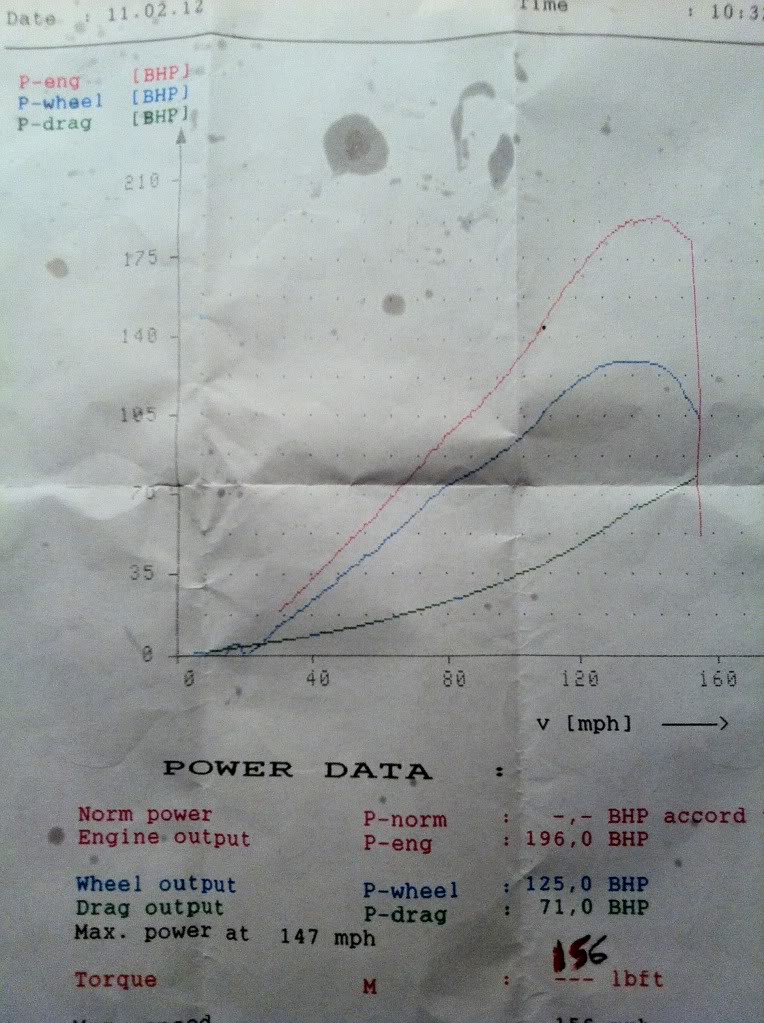

right, i have found the power curve and it is uploading now. I have contacted the previous owner who has said he had it chipped but hasnt as yet said any more than that. Picture to follow
have just been told it was chipped (which i am assuming is just another work for remap) by engine dynamics. anybody heard of them?
here the graph with all the figures.......
Considering clios lose about 17% through the transmission, if your ATW figure is correct, that would indicate a very unhealthy engine - pulling only 150bhp or so ATF!!!!!
Which is awful, suggesting the timing is out? Not sure if u mentioned whether thats been done.
Iirc Engine Dynamics are what used to be BB Performance Tuning. They fell over previously so draw your own conclusions ...
