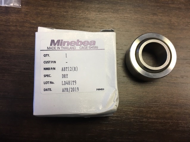

I agree with the above to a certain degree, I've fitted several motorsport shifters to previous cars and while none have vibrated quite as much as the PMS. They have all had their own resonance so I also call the #becauseracecar a little flaky.
You can try several things to quieten the PMS down with the lead shot and heavy grease in the boots etc.. but you still seem to get some noise on overrun.
I'm currently awaiting a teflon lined spherical bearing to see if i can dial it out totally.
Having spoken with Nick @ PMS Motorsport they have tried various things to silence the shifter with different bearings and even a plastic bearing however their feeling is that the current setup is the best all round and that the PTFE lined bearings made it stiff.
Personally i would rather have the action of the shifter slightly stiffer than it is, so I'm going to experiment with that option and see how it goes.
I'll report back any findings when I've tested it on the car.
frayz
I had the PTFE bearing in and it did indeed make it almost silent in every gear except 4th.
However it was so stiff that it did not inspire confidence across the gate. It would be possible when pressing on to go from say 3rd, miss 4th and actually get 2nd instead. These parts are made for driving when we are pressing on/track etc. So if they dont inspire confidence, whats the point?
I have since swapped to the updated non PTFE bearing of which allows the lever to self centre and follow the H pattern easier.
However it buzzes, rattle and generally makes the action feel cheap & nasty.
As said before, im no stranger to modified cars, performance parts with increased NVH, but this is different. I could forgive it if it were "that" much better than everything else.
But so far, it isn't.
Interesting..
Was the preloading removed from the PTFE bearing you used ? and did you try the non-branded bearing or was it the NMB PTFE bearing ?
frayz
Interesting..
Whatever PMS used in there originally. It was incredibly stiff, didn't self centre and wasn't very nice to use. Hardly any rattle at all both up and down gears, but was borderline uncomfortable to use it was so stiff.
frayz
Simple solution to the pms rattle...change the laws of physics!!!!
Agree to some extent, but it would be nice to find out exactly which part is rattling. Perhap swaping out the bearings for some Delrin if that would provide enough damping? I don't know without looking.
Well they do have both non-branded and NMB bearings so i guess it could have been either.
I'm hoping it was an early non branded one where he preloading hadn't been removed.
I'm going to try an NMB and release the preloading first to free up the movement a little.
Hopefully it makes an improvement as i agree the non-lined one is loose at best which certainly causes mine to vibrate.
frayz
How are you going to release the pre loading on the NMB item?
  dan's cast offs.
It's basically a solid connection to the gearbox so it will vibrate. Any slop in the box will make it worse.
  406 V6, Race Buggy
I would suggest switching to a split outer-race bearing to make sure you have very low preload, fill that with a silicone damping grease, and fit a grub screw to the housing so you can just nip it up enough to remove any play that might contribute to the rattling without getting the shift too tight for the centring springs.
I don't think it'll cure it all after seeing how their designed - personally last time I looked at them I think there's probably a resonance issue in the lower bearing pack too going from the descriptions of where it occurs RPM-wise - but it might cure some of the lower frequency cabin noise.
frayz
According to PMS,
"Press the ball while holding the bearing on the outer race to just release the preload "
I've taken the PTFE lined original bearing and put it under the hydraulic press to take some of the preload out. I couldn't move it at all by hand previously and now i can force it around by hand. I'm hoping that's enough to keep the race tight but still allow the shifter the self centre in the gate.

NMB/Minebea bearing just arrived @frayz

@frayz
NMB Bearing is in and to say I'm over the moon would be a total understatement.
Nick @Pms has said there is a possibility the PTFE lined bearing may stiffen over time, but it only took 40 mins to swap so if i have to buy another in a years time so be it.
To have the shifter totally silent is a game changer..! and when i say SILENT.. I cant get any noise at any revs or on over run at all.
It's maybe 5% stiffer side to side, but still self centres .
I did put the ball under the hydraulic press to remove some preload, but i couldn't notice any real difference as it was quite free anyway.
Vids Below:
First: Original non-lined steel ball
Second: NMB PTFE
Third: Self centering

That looks like a game changer for a lot of people with the rattle ;)
Fair play to you.
