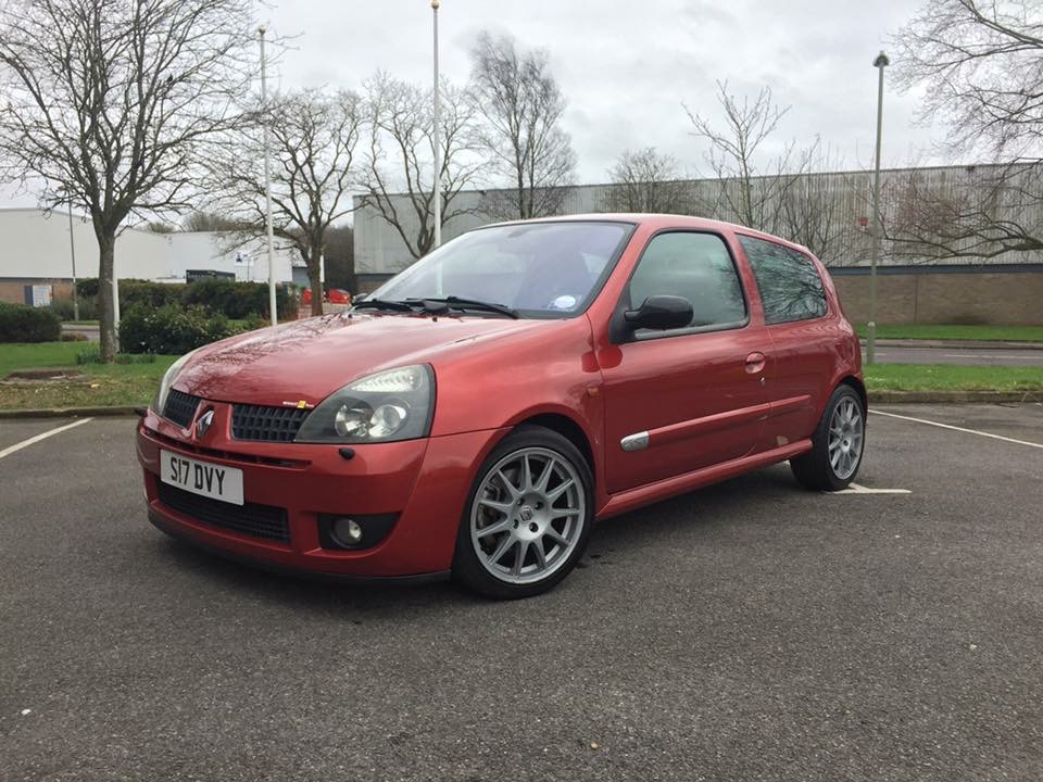

  Clio 172

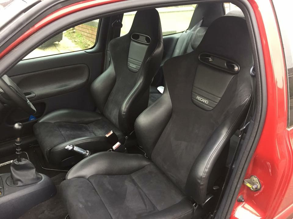

I wish I didn’t sell my clio, was perfect mix or fun and comfort.
Recaro’s, snappy wheel, eibach springs, Yanoo’d scenic shifter, solid mounts. I’d buy it back tomorrow.

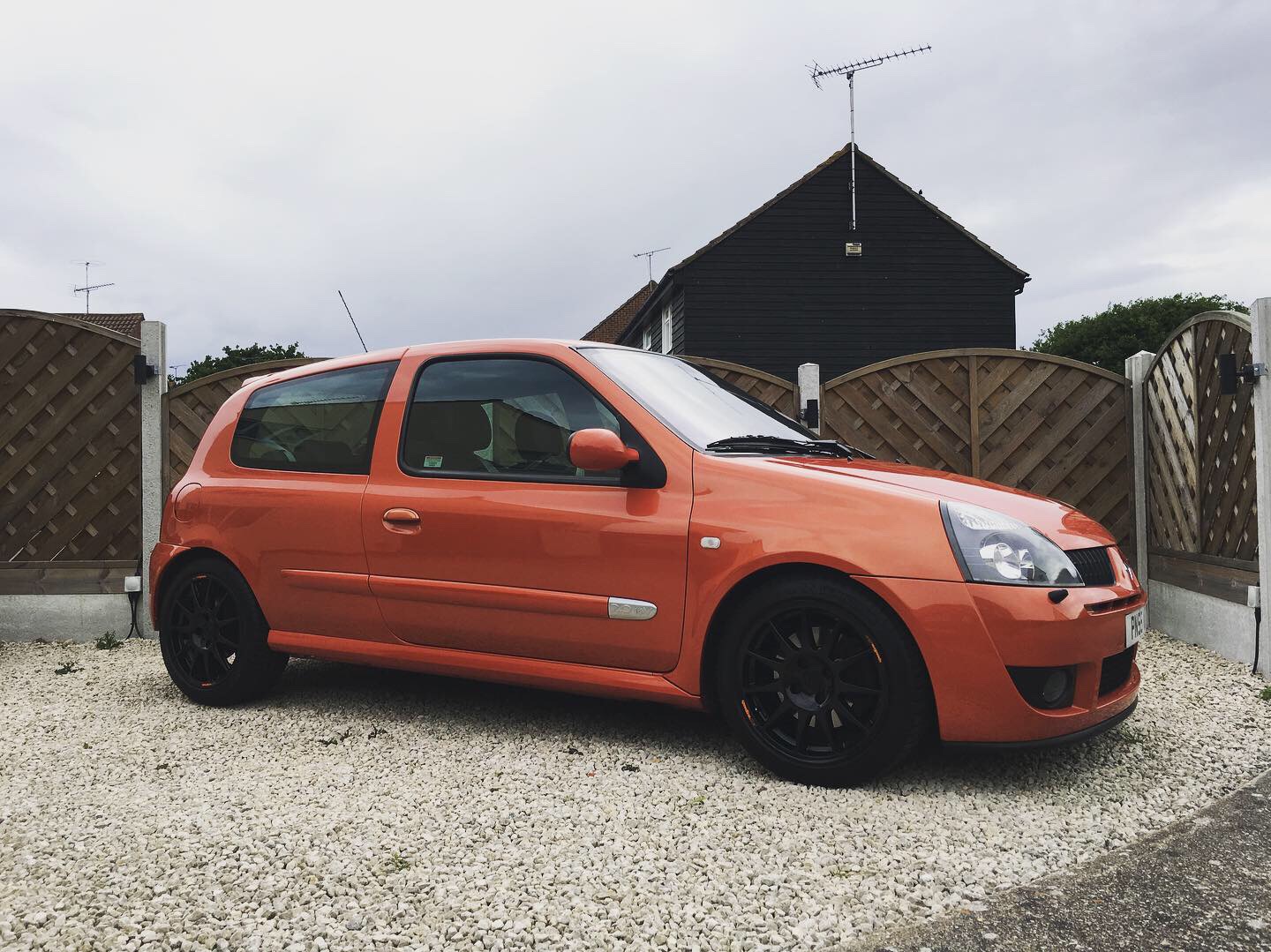

All good feedback,
So the inspiration to this thread is that I've recently bought back my old 182 that I owned from almost new (8k miles).
Keen to make the car as focused and enjoyable as possible without ruining it. Its my daily drive, and I do 50 miles a day in it across b roads and country lanes.
Current changes are few:
Full BTM/Yozzasport exhaust
Eibach Sportlines
Braided hoses
16" Turinis
Snappy steering wheel
Alpine headunit
Since buying the car back I've bought the following new genuine Renault parts:
New Cup dampers
New topmounts
New lower arms
New inner & outer track rod ends
Full ARB bush kit
New dogbone mount
Tempted by Vibratechnics and a PMS shifter... but not sure yet.
