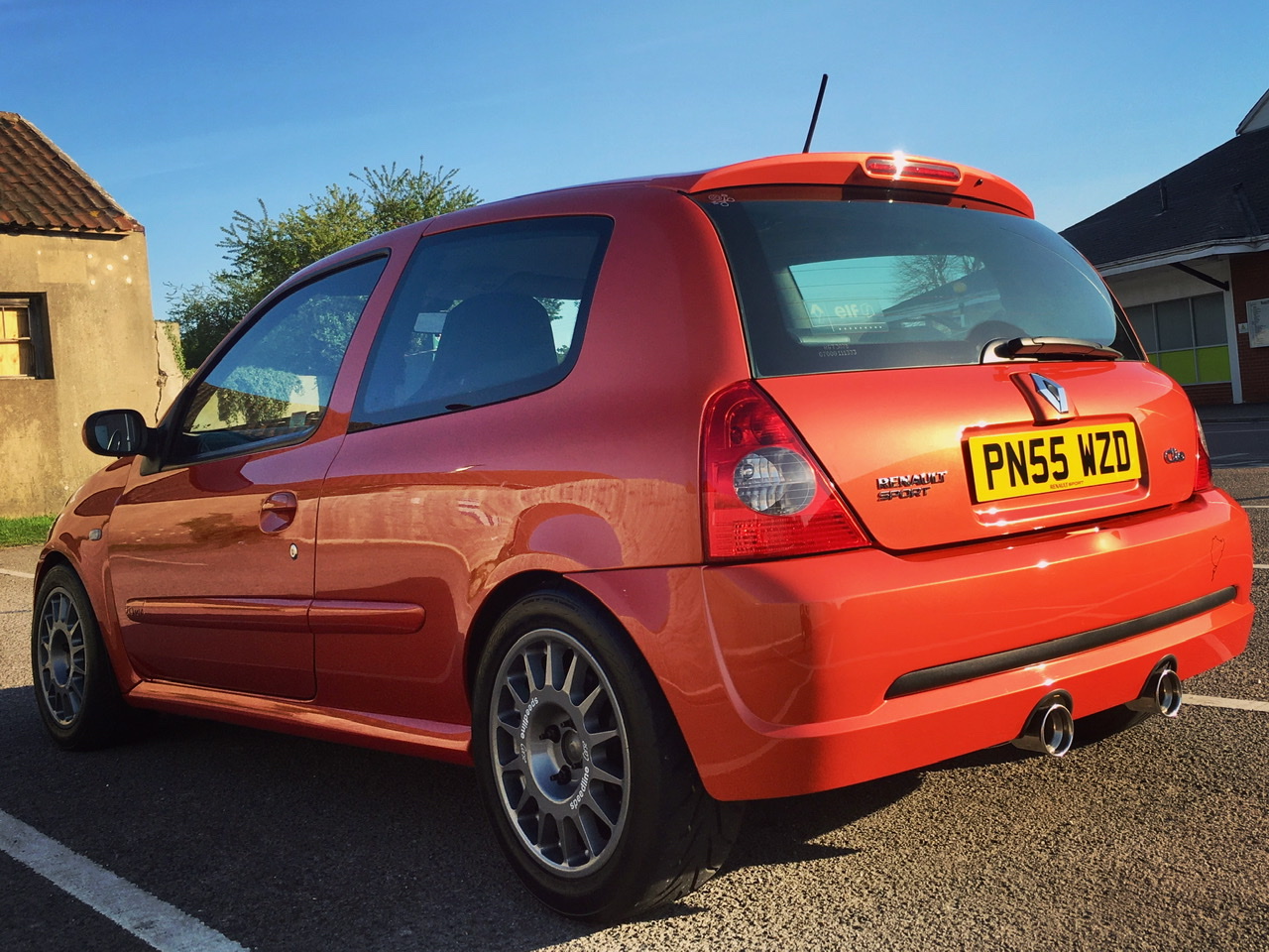

Okay so keeping this thread up to date, my “road car” now has the following parts.
Inferno Clio 182 FF & Cup Packs
Engine:
ITG Maxogen air intake
BTM/Yozzasport cat back exhaust
PMS cat derestriction
PhilM exhaust mounts /stainless mount bracket holders.
Transmission:
Quaife ATB diff
PMS motorsport shifter
Suspension:
AST5100 coilovers - specifically valved & sprung for road
PMS topmounts & brace
PhilM dogbone bushes
PMS 19mm Rear ARB
Whiteline rear beam bushes
PFlex Black steering rack bushes
PFlex Black front wishbone bushes
NorthloopCup Roll Centre / bump steer correction hubs.
Braking:
Hel Performance stainless brake hoses
Motul RBF 600
Brembo HC discs
PFC 097 pads
Wheels/tyres:
16” Speedline Turini - Gloss black
Michelin Pilot Sport 3
15” Speedline 2118 - Anthracite
Toyo R888
PMS Spacers +16mm front / +10mm rear
Stud/nut kit
Exterior:
2019 Fiesta stubby aerial.
Genuine Cup washer blanks
Phillips Xtreme Gen2 lighting
197 RS boot emblem
Fabia front splitter
Interior:
Momo Prototipo Classic Steering Wheel
Works Bell rapfix 2
Volantech cruise button panel
Recaro Pole Position ABE seats /JonFoz XL bases
Steering column dropped 8mm.
Alpine 178BT headunit.
Without doubt the most impressive changes have been the dampers, diff, RC hubs and tyres.
Bushes are nice changes that make incremental improvements, but the aforementioned items alone make such dramatic changes to the little Clios capability. None of them have any detrimental trade off either. None of them have increased NVH or have shown any ill side effects. In fact, none of the spherical bearings or bushes have increased NVH either which is a usual side effect. Perhaps the lack of adverse vibrations is because I’m using new OEM engine/gearbox mounts and these obviously transfer no noise to the cabin. Only the dogbone is uprated with the PhilM item and that also transfers no extra NVH.
The hubs require regular and careful maintenance, however that’s a trade off I can live with for the improvement in steering response and stability. The seats have made a huge improvement in driver position and feeling like you’re sat in the car rather than on it. Easily the most usable fixed back bucket seat out there, but they are more work to get in and out than the OEM seats.
So far my “worst/most detrimental” change has been the PMS shifter. Yes the feel and height are a huge improvement, but it’s taken a great number of hours and messing about in order to keep vibrations to a livable level. The BMS/Scenic shifter I found doesn’t have the correct control weight and feels too light. But obviously offers no increase in NVH inside the car.
Perhaps this is an item I maybe wouldn’t buy again and instead buy a brand new OEM item and swap out the lower bushes to brass items.
Tyres are also pretty noisy for road use but I’m no stranger to this and will suffer the increase in tyre noise for the offset in performance.
I absolutely adore this as my idea of an ultimate “road” Clio and will continue to update this and be 100% transparent with my experience. 🙂

I should also add that the addition of the Recaros means the rear seats are just for decoration now as you cannot get anyone In there now.
Nobody else ever rides in my car so this isn’t an issue for me. But there aren’t any tilting seats i like anyway.

Probably not by a great deal if at all. However it’s my interpretation of what I want from a road going focused road car.
See the mods on the car as I’m sure you can see are all changes that can be enjoyed at all speeds. They’re all designed enhance everything we already love about the Clio. Handling, feedback, response, feel and all out driving enjoyment.
I’ve had a 600bhp road car, and I didn’t enjoy it anymore than I do this. So take from that what you will. 😅

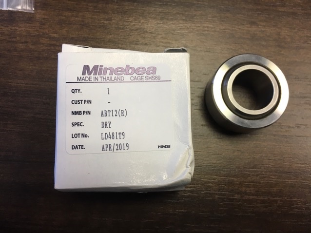

NMB/Minebea bearing just arrived @frayz
Interestingly you mentioned your PTFE bearing couldn't hardly be moved by hand however this one is relatively easy/smooth to move the ball around.
I think i will still try to remove the preload with a press anyway as i don't really want to be faffing with stripping the shifter too many times to play with the bearing.
Should be fitting tomorrow so i'll keep my fingers crossed and report back how it goes.
Im waiting on a second hand PMS shifter coming and as its going into a road car I had been looking into replacing the bearing with one of these.
As ive not yet stripped the one I have my question is, when I strip the old shifter down to replace the bearing it looks like the PMS bearing that is for sale on their website is retained by a circlip that goes into a grove in the bearing. would this be correct?
If I was to install this bearing you have would it still be held in with the circlip?

Yep, circlip out, bearing out and new one in followed by the circlip. It’s literally like for like. 👍🏼

Thank you very much appreciated, is there anything else that is recommended to do the shifter to be a little more road friendly or is it just a case of faffing about with adjusting it.

There’s numerous threads about it but basically it’s s**t in a road car that you want to be anywhere near being nice to be in.
Add a preloaded NMB bearing, fill the shifter tube with lead shot, fill the linkage/gearbox boot with the heaviest grease you can find and buy some earplugs. 😅

Haha fair enough, I say road car and use the term loosely :ROFLMAO: its road legal fair weather car.
