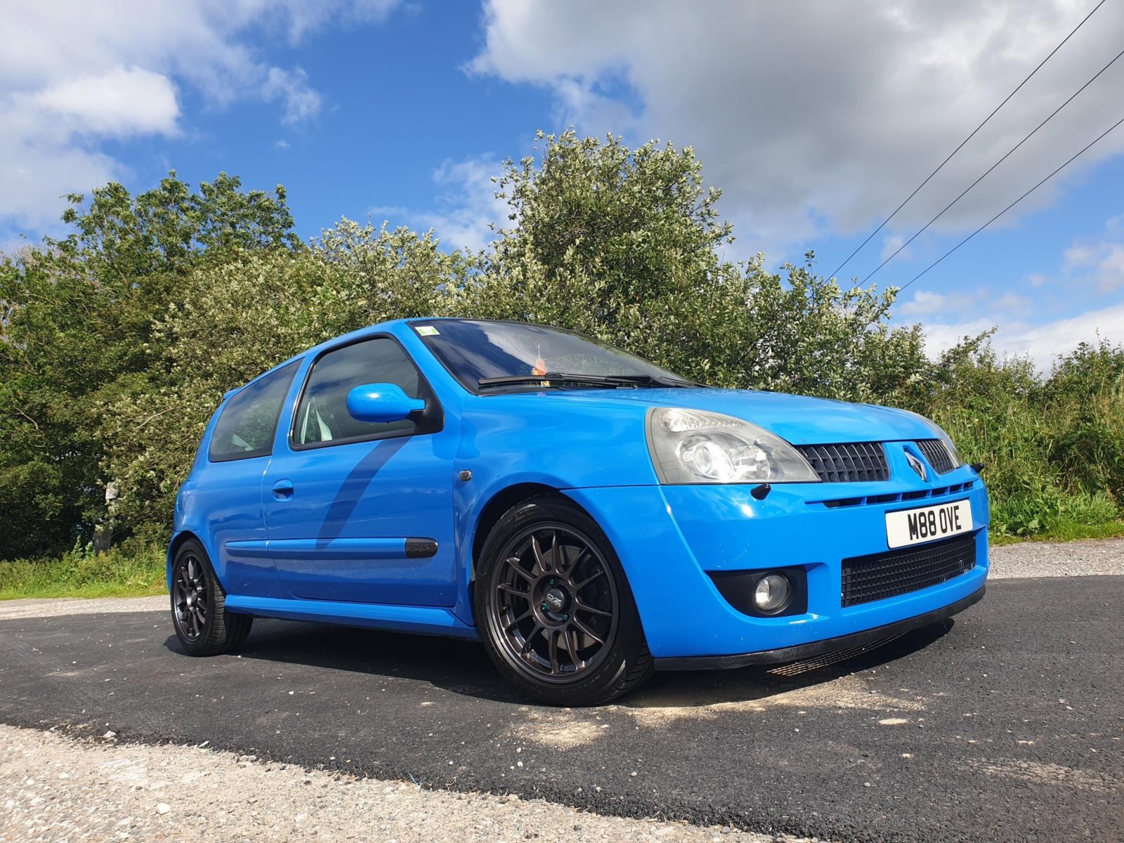

So the inspiration to this thread is that I've recently bought back my old 182 that I owned from almost new (8k miles).
Keen to make the car as focused and enjoyable as possible without ruining it. Its my daily drive, and I do 50 miles a day in it across b roads and country lanes.
Current changes are few:
Full BTM/Yozzasport exhaust
Eibach Sportlines
Braided hoses
16" Turinis
Snappy steering wheel
Alpine headunit
Since buying the car back I've bought the following new genuine Renault parts:
New Cup dampers
New topmounts
New lower arms
New inner & outer track rod ends
Full ARB bush kit
New dogbone mount
Tempted by Vibratechnics and a PMS shifter... but not sure yet.

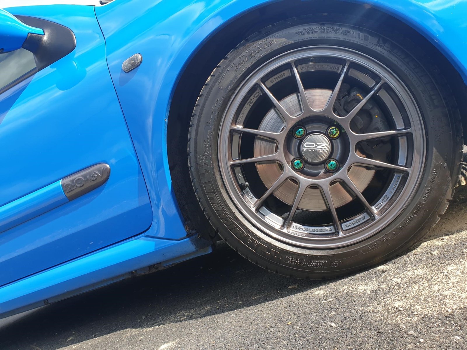

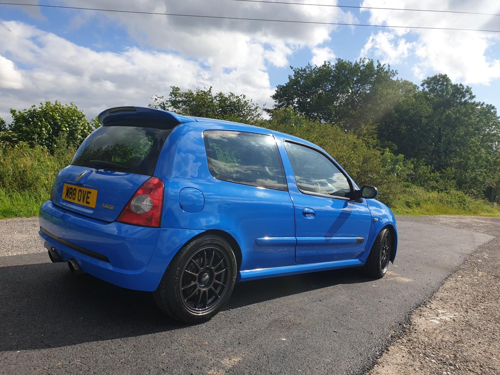

It's a long list !
Engine
- 172 Engine
- RS2 Inlet
- 197 Injectors
- Forge Motorsport hose kit
- Magnecor Leads
- Ktec Solid Engine Mounts
- KTR Ultra Performance exhaust
- Mocal Oil Catch Tank
- PMS Breather Plate
- Fully custom build brackets with heat shielding
- Oddessy 25 battery
- New Coolant and Power Steering fluid bottles
- Zinc plated bolts
- Mapped by EFI Parts. 200.6bhp/150.2lbft
Transmission
- Rebuilt Gearbox
- Quaife Differential
- PH1 gear shifter
Handling
- Standard shocks
- Grams Racing springs front and rear
- 172 Cup Wishbones
- PowerFlex Black series Wishbone Bushes
- PowerFlex Inner + Outer ARB Bushes
- PMS Top Mounts and Strut Brace
- Whiteline ARB
- 2x Set Turinis. Bridgstone Potenza/Federal RSR-RS
- 5mm spacer (front)
Braking
- Brembo 4 pots, Un-painted
- Custom HEL braided lines
- PMS 300mm conversion Brackets
- Brembo Pads/Feroodo DS11.1
- 300mm Brembo HCs (Front)
- Renault OEM Discs (Rear)
- ATE Super Blue Racing brake fluid
Interior
- Recaro Sportster seats
- Custom JonFoz frames
- Connects 2 3.5mm jack install
Exterior
- Skoda Splitter
- 197 Renault Sport badge
- 3/4 Plate

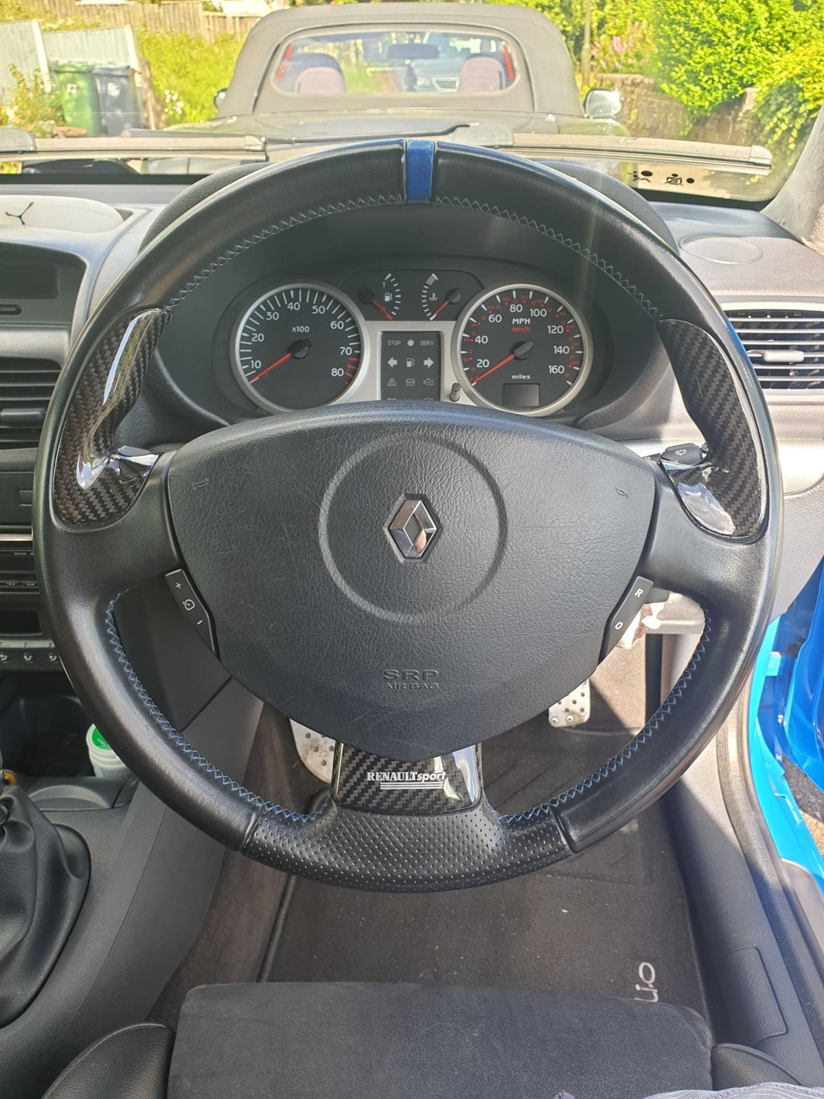

- Smaller wheel but that annoyed me when maneuvering at sainsbury's - back to snappy refurbished original wheel

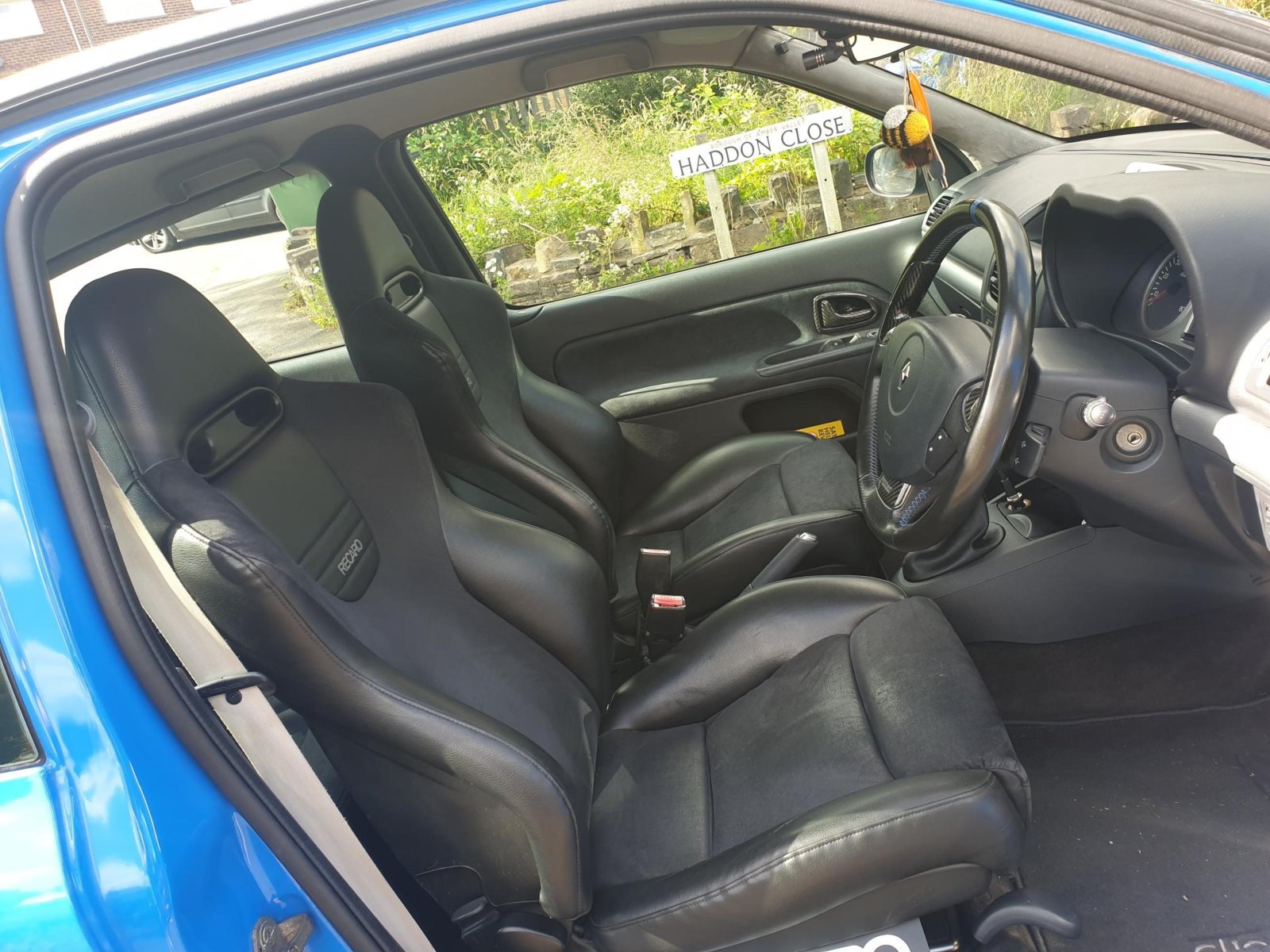

In my mind I fancy a proper drivers seat, a PMS shifter and Vibratechnic mounts. Just to get the feel and control of the car as it is now. As to be honets, as it is, its pretty sweet in terms of ride/handling. Some reduced body roll would be nice, but not sure I can achieve that without going to coilovers. Does anyone do a set of uprated front/rear matched ARBs?
I’ve literally been contemplating going back to stock passenger seat and then a bucket seat for the drivers side and selling my trendlines this afternoon lol. Just think it would add further to the car but then again mines now a daily. I’m also scared of marking the trendlines. Lol.
