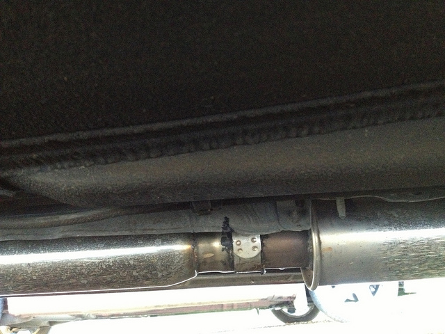

Ye I'm sure Fred charged about 60-70 quid for mine. We was at his unit till about 10pm though. Made a good chop on the cat pipe, I would take a picture but cars having a holiday at Fred's for 4 weeks.

I'd like to see a pic of one sleeved too. I've had various clamps/paste/silicon on my decat pipe and still blows.
  ph1 172
http://
Untitled by Rhys Beal, on Flickr
Excuse the rtv silicone.

Depends what exhaust. If its a Yozza yes as they come with a flange type fit as standard.
Some aftermarket exhausts have a sleeve type fitment on the centre section as standard.
