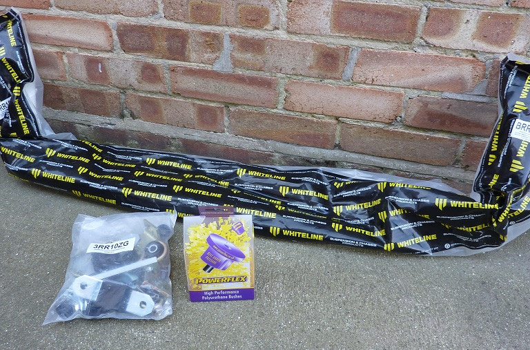

I've been getting together a very small collection of parts recently to go on the car asap and fingers crossed these will be fitted tomorrow, gone for the Whiteline ARB (simply as the PMS one looked a bit hardcore for what I want it for) and the usual Powerflex (yellow) engine mount insert....... says he who was quite firm in that the car didn't need anything else!!!

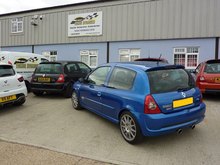

Today was the day for the car to go to Engine Dynamics and i'm very pleased to report, my revving/running issue is SORTED! :smiley:

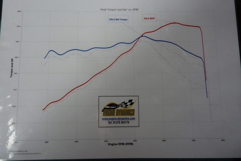

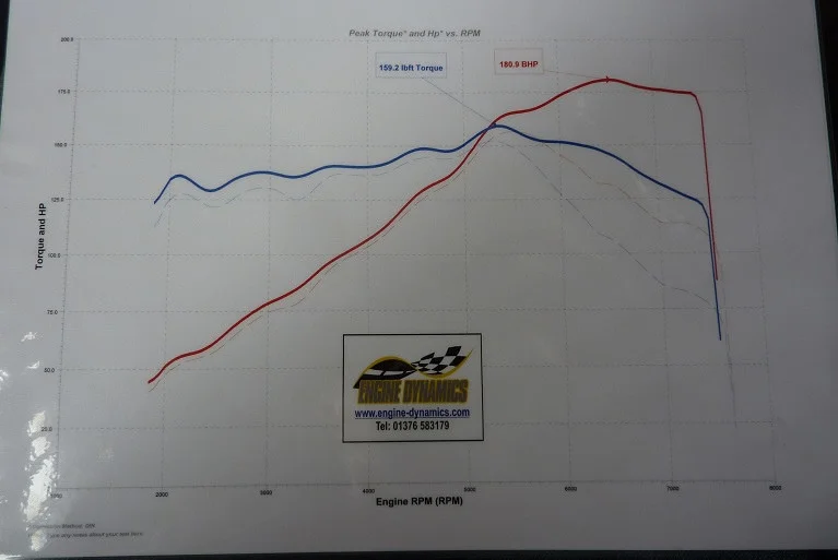

It turned out to be the fuel pump! When the car was first run on the dyno, in it's usual style it was totally fine below 5,000 revs, but as soon as the car went past this and tried to go further with the foot down, the fuel would completely drop off!! Due to this, on the initial power runs it was making 153bhp (and even worse, 114bhp at 7500rpm!!). Luckily Andy had a replacement uprated fuel pump on the shelf, got it fitted and all was fine. The car was then mapped and in short, I now have a strong 180.9bhp. As you can imagine, the car is now totally transformed and I'm really pleased it's all ok.
You can see on my power graph before and after how the car was behaving, the dotted lines show how it was falling off at higher revs!

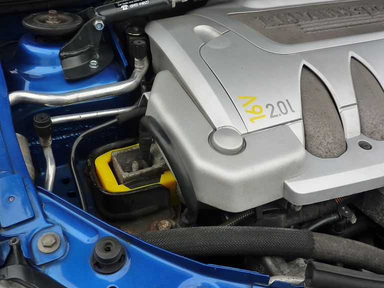

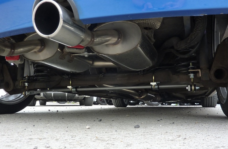

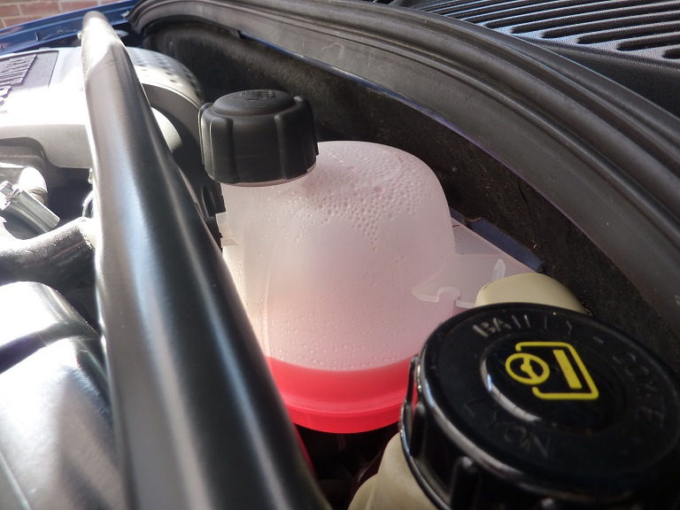

Also while there, the Whiteline ARB has been fitted along with the Powerflex upper engine mount insert I supplied but I also asked if they had a Powerflex dogbone insert as well. Which they did, so that was done as well! I had also requested a new genuine coolant bottle to be supplied and fitted with a fresh coolant change and this was done as well so it's looking fresh and running sooo much better, all stamped in the book too for the coolant change.

In regards to the drive, it is VERY responsive now and pulls hard after 5k. With the ARB as well, just feels nice and planted. Thing is though, I notice big changes due to how it was running before which I was getting used to so you may not see so much difference on yours if that makes sense? So worth doing though!
Sounds great, glad they were able to sort out the issue quickly and you could get all the other bit's done as well. You must be really happy with 180.9 I know I would be :smile: how does the arb feel? I know you haven't had a lot of time with it yet :up:

Cheers bud yes i'm very pleased with that power figure, afterall, it still has a CAT and only a cat-back exhaust and K-Tec induction kit......... feels very planted as said above when going round roundabouts but was a pretty gentle drive home, mainly single carriageway when nearer to home soil

Mine decatted and unsilenced centre made 183/163. Large dip in torque when the decat was fitted prior to mapping.
