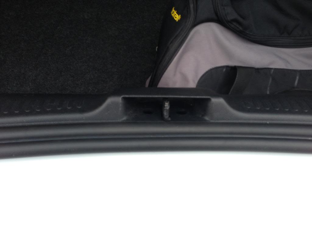

have you got a picture of the bit you taped up I have an annoying rattle at the rear :(
At work ATM mate but I'll take a quick one for you tonight and post it - it's basically just the metal loop that the boot lid locks down onto. Right infront of you when you open the boot - can't miss it
Very common fault on all mk3's. another way of fixing it is to put a bit of grease on the moving parts on the locking mechanism.
