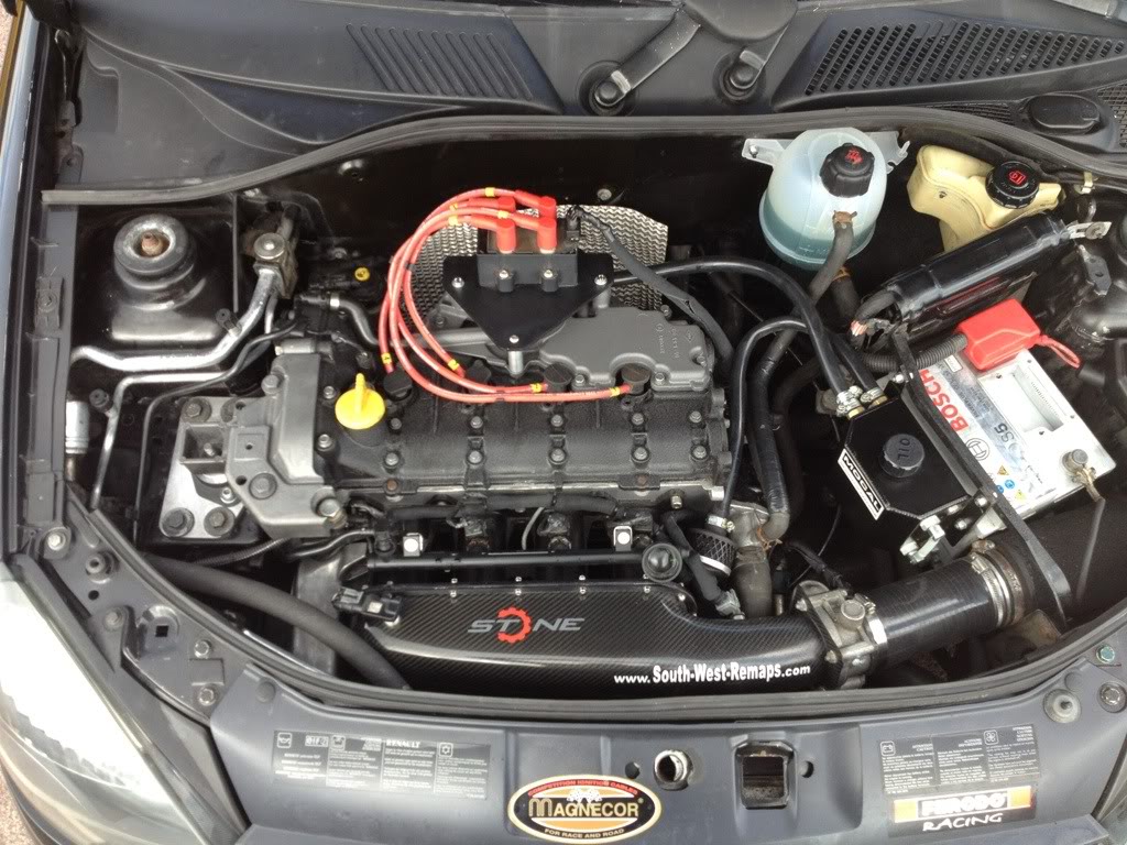

  182/RS2/ Turbo/Mk1
Here is my car on cams and rs2, seems to work pretty well to me!
If I pick up a guitar, it doesnt work, the sounds that come out are terrible, and I would instantly proclaim it faulty, because I cant play the guitar, if Mike from MWM picked one up, he would make the same diagnosis, that the guitar simply doesnt work to make decent music.
I guess its the same with the cams and the RS2, give them to a few people who dont know what they are doing, and they'll all say they dont work, give them to someone who does though, and they work fine.
  172 Ph1
