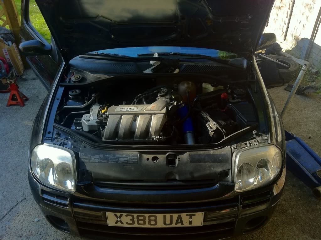

Hi every 1, was just having sum thoughts on fitting the a 197 plenum 2 my cup! does any1 know if its worth doing and how hard is it it to fit on the 172? if it fits atall that is :S
It does fit with a bit of modifying,drilling and cutting.
It works ok at the moment but is not finished, we still haven't sorted the map out 100% so i cant give you exact figures.
Once we get the time to finish it we will upload some exact figures :)
Can be made to fit, waste of time though with no real gains for the effort.
That depends really. Bolting the manifold on isn't going to see you 210BHP. But i wouldn't say there was no real gains.
We payed £120 for the inlet and fitted it on. Sadly we didn't get a before dynograph but with some very rough (and still not correct) AFR set ups the car now pulls 174BHP
As we all know these cars dont make anywhere near 172BHP form the factory so there is defantly a gain there.
Once the fueling has been sorted correctly (as it is still a way off, proving the better air flow) And the timing has been sorted, I would exspect to see a couple of BHP more.
Thanks loads 4 the pic and info,helps me a bit more. i think it somthing i could do,i work in an engineering company,so got no worries about the drilling and cutting bussiness. looks real good under the hood 2,brings it up 2 date a bit. just looking for a few mods b4 i eventually get it mapped. :)
I'd imagine for the time, money, effort you'd be better off having your inlets matched.
It will fit and it looks super cool IMO,all depends on how much time money and effort you have to spare.
Iirc there is an RS in France running one of the 197 inlets with some good gains, as to what his other mods are I can't recall.
I think this manifold will start to work well when used with other mods.
We are going to be turboing this car soon, so it will be intresting to see how things work then.
Looks really nice that, does bring it upto date. What figures are you looking at to get it to fit etc?
