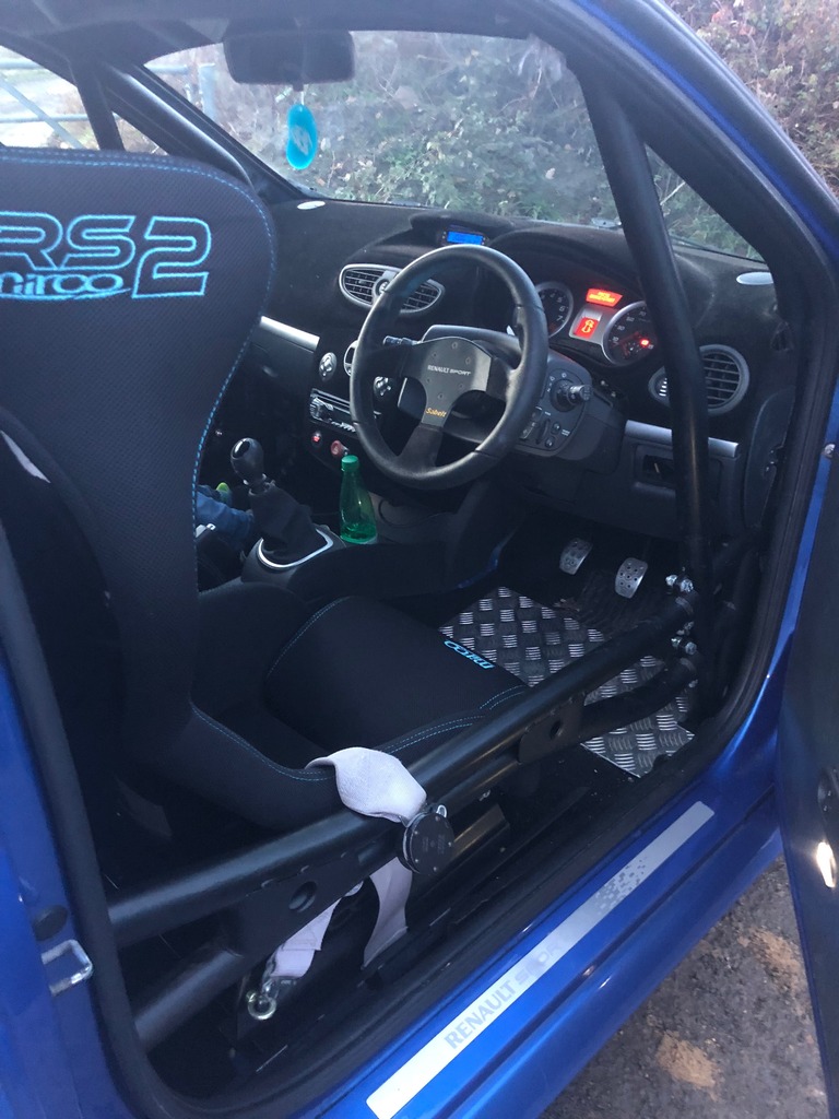

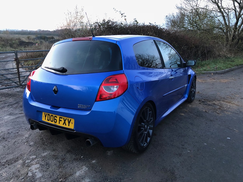

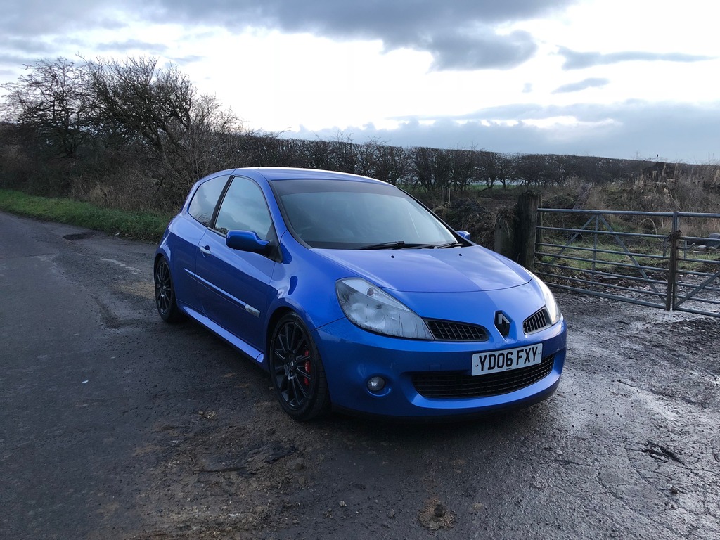

After 7 years away from Clio's I bought this 197 Turbo a week ago.
It needs a few bits sorting.
-Remap and 630 injectors.
-Brake pads, braided lines and maybe a refurb of the calipers.
-Interior tidying up.
-Track wheels/tyres.
-Suspension.
Spec.
-Low mileage megane 225 engine/gearbox.
-250 Turbo.
-Mark Fish cage.
-Buckets with Sabelt harnesses and Sabelt wheel.
-"Big" intercooler and hard pipe kit.
-Miltek exhaust and decat.
It was converted by a specialist.

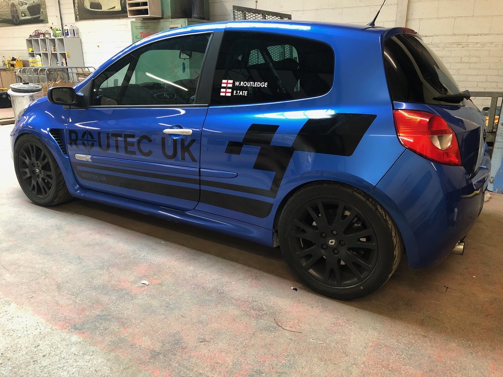

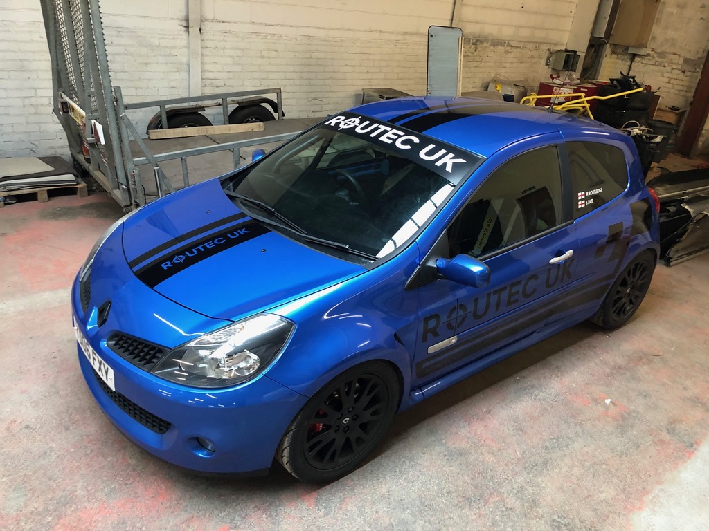

A couple of photos of the Laguna wheels and the vinyl that I have had applied.
One for you George....

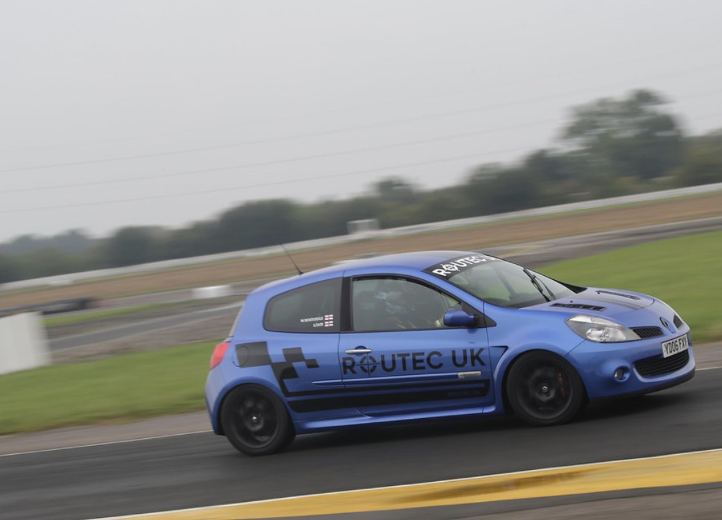

I did Blyton Park on Sunday, it was my first track day and I thoroughly enjoyed it.

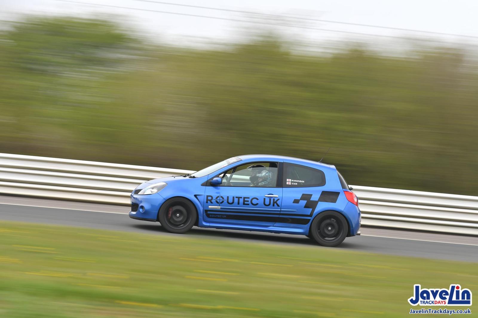

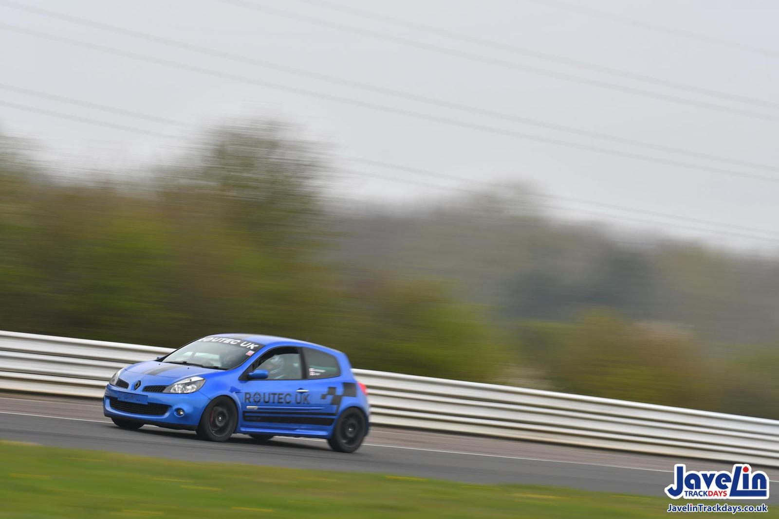

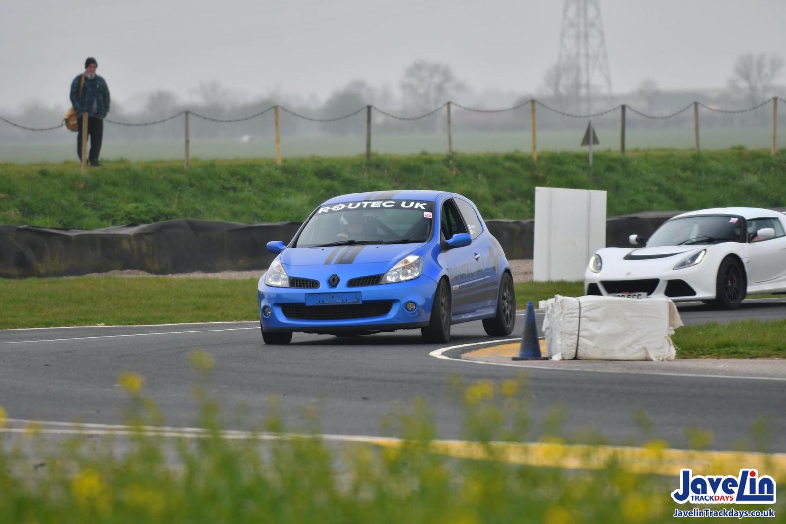

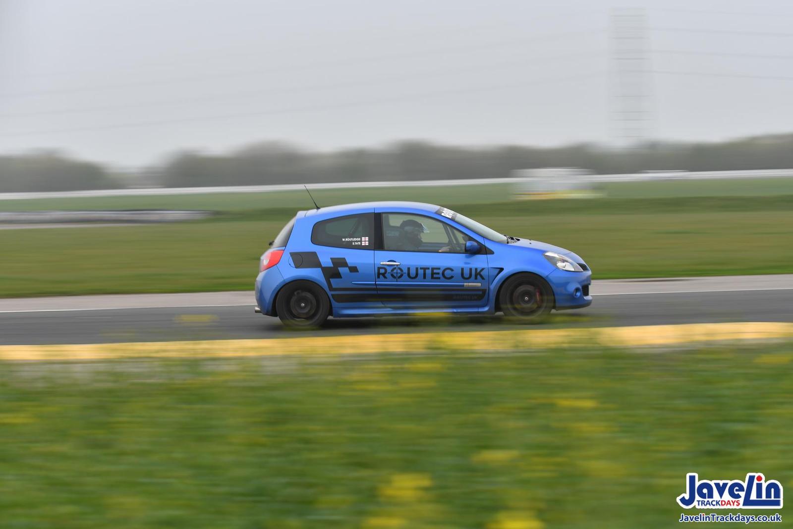

I had this out at a charity track day at Blyton on Wednesday of this week, it was my first track day of the year.
It developed a misfire last week that was sorted with new sparks and coils.
It was a wet morning and the Clio was useless on the NS-2R's. I certainly need to look at some different tyre options if its going to rain....
The front wiper motor linkage failed so we had to go down to one wiper.
I still need to look at an uprated radiator/fan set up.
  Clio 197,with megan'
With respect, before you go any further, are you running the Clio Rad, if so, go to the 225 Rad, as its a little larger, and with the 250 engine in mine, I do not suffer any overheating, even on track.I would strongly recommend to check the fan is blowing the right way, mine was sucking air FROM the engine compartment, through rad,INSTEAD of sucking it from outside through the rad, and its not the first time this has happened to people. Keep us posted.
Edd
  Ghibli/Boxster/197T
It is still the Clio radiator and fan set up, so it does need to be upgraded to the 225. I have got all of the bits.....
Left to its own devices the fan won't kick in until 103C. It has got a switch so I generally keep the fan on when it's over 90C on track.
