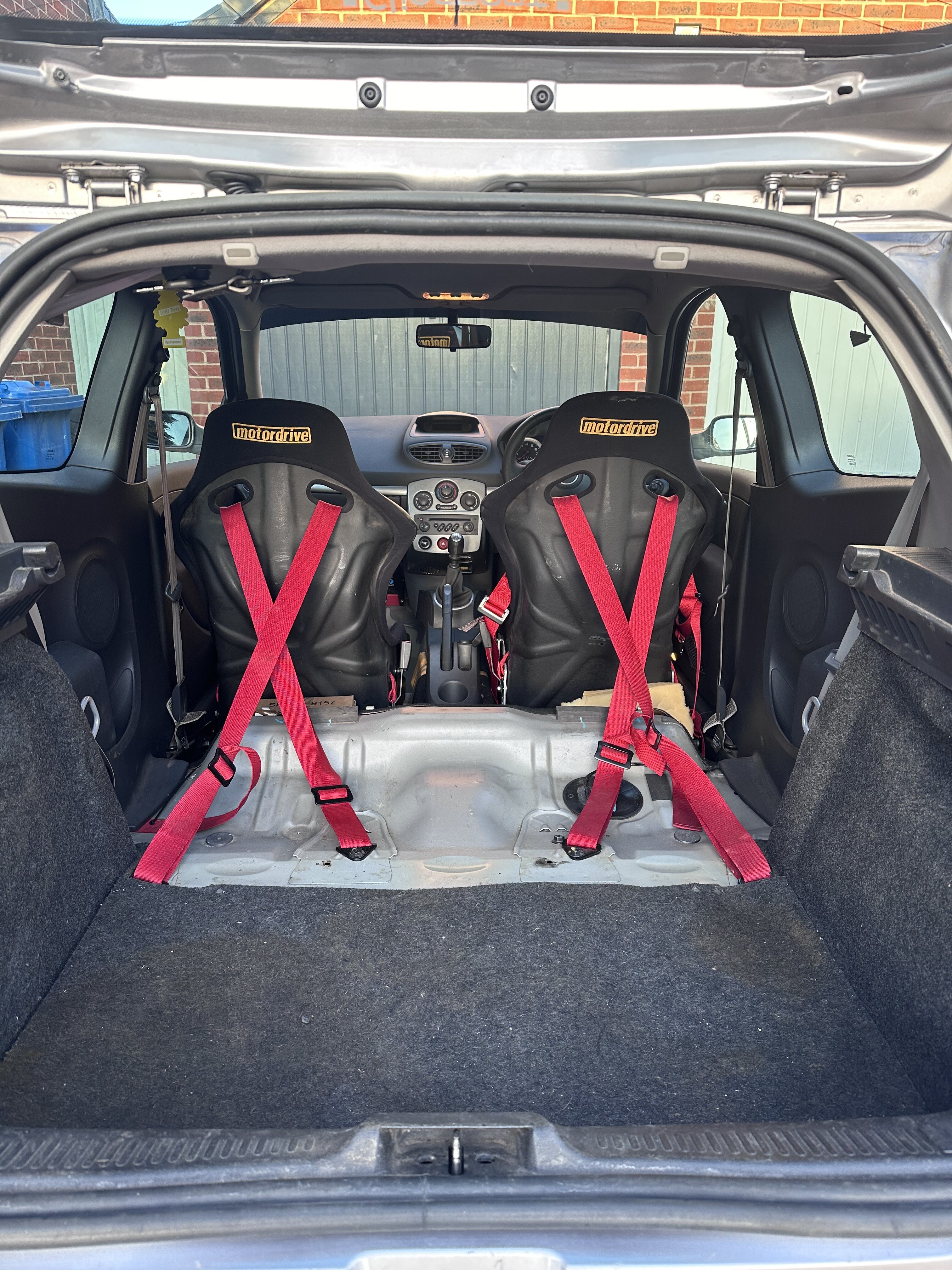

Cage £450
Wheels £450
Seats, harnesses and brackets £800
