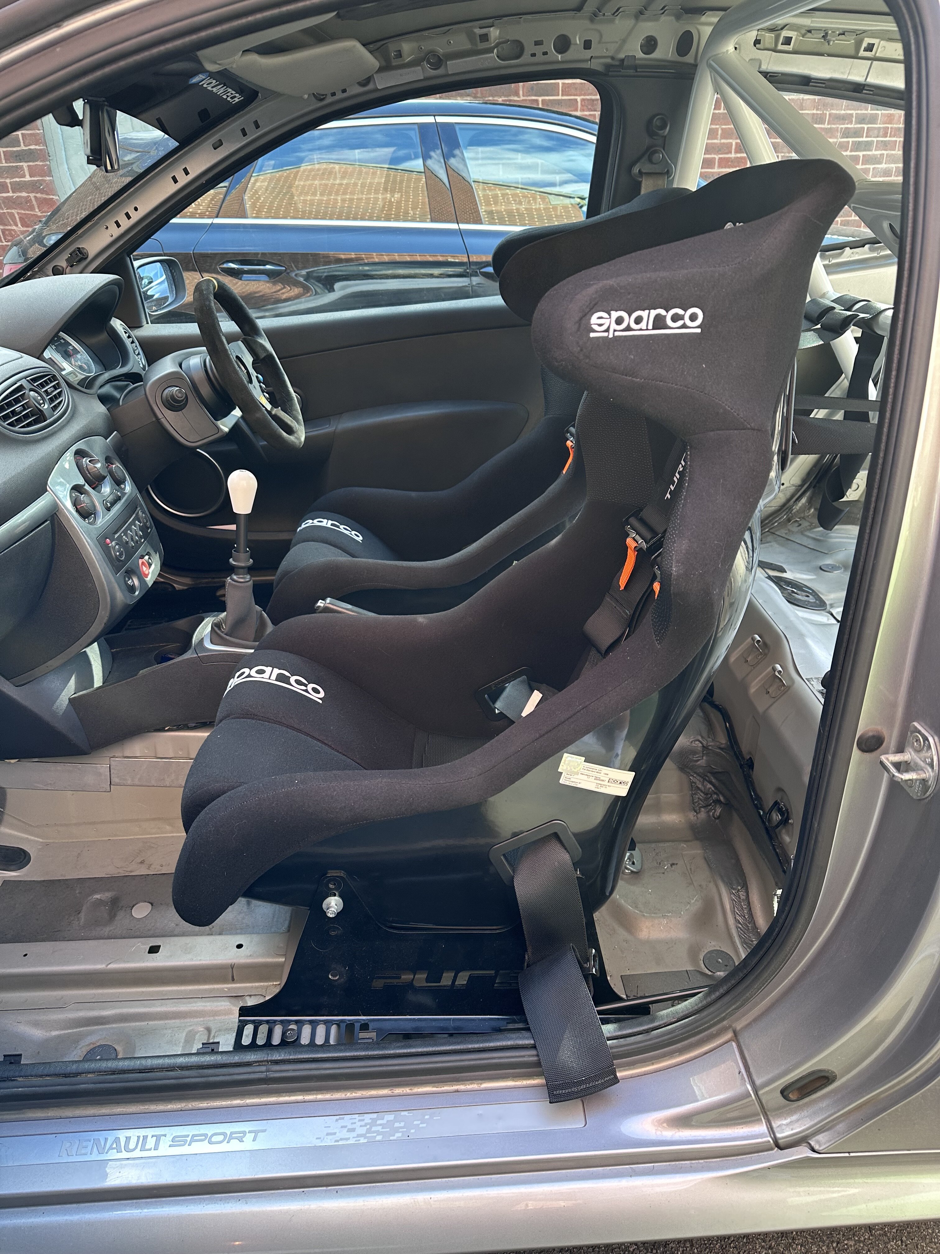

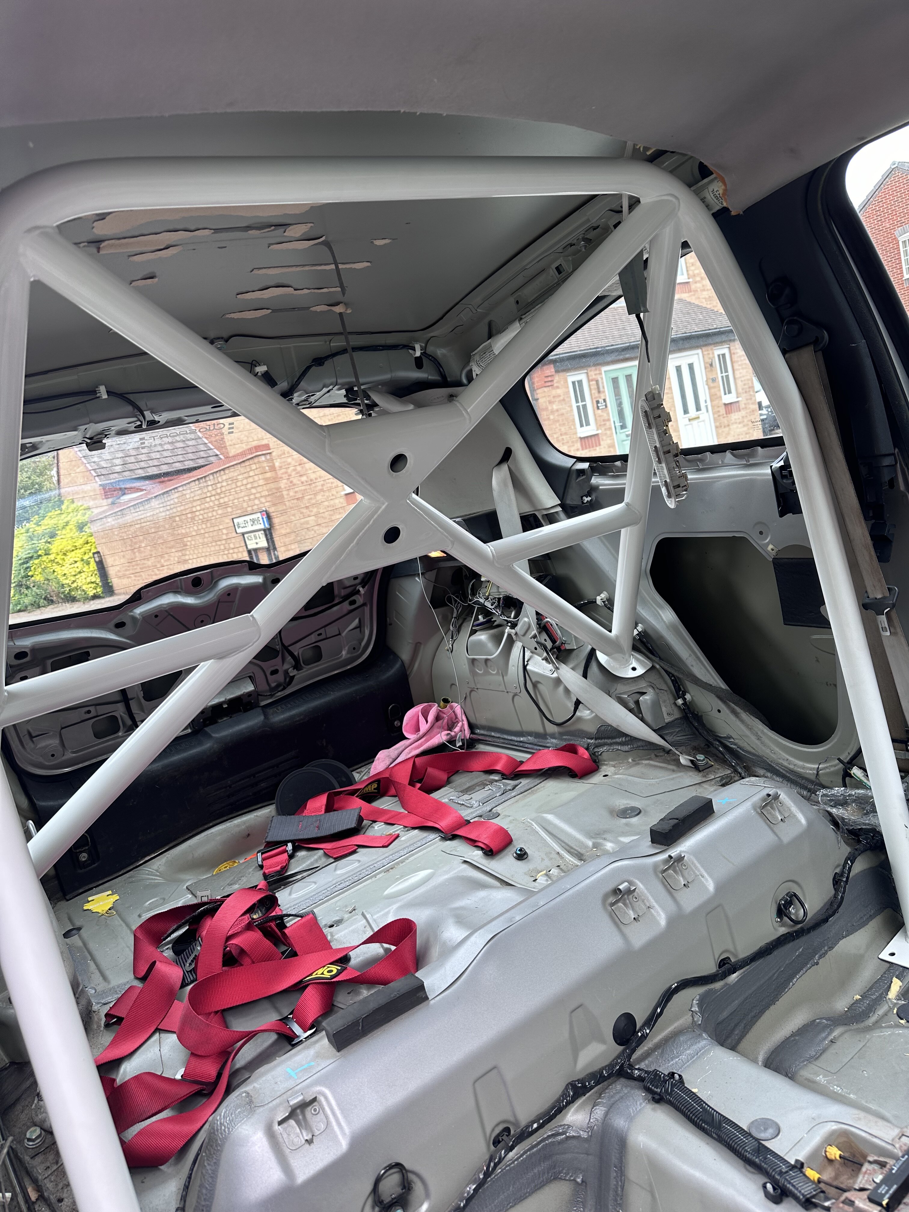

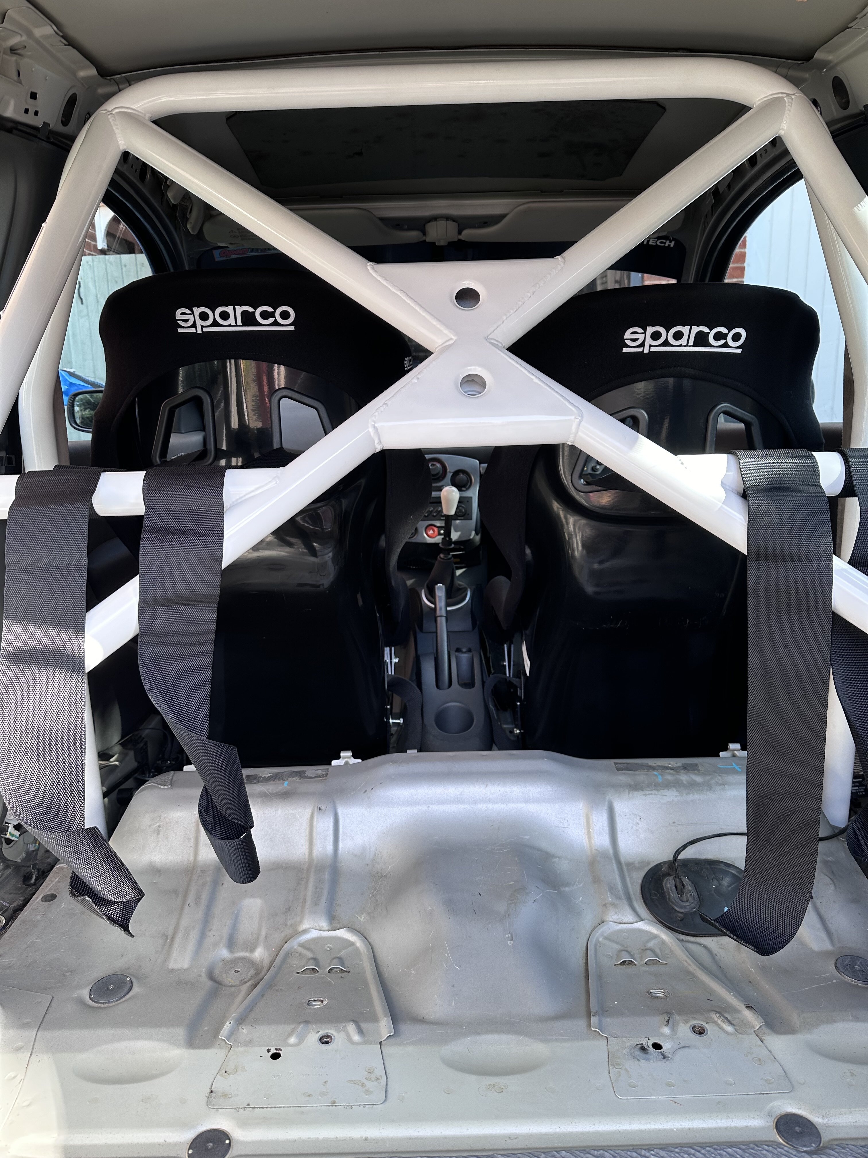

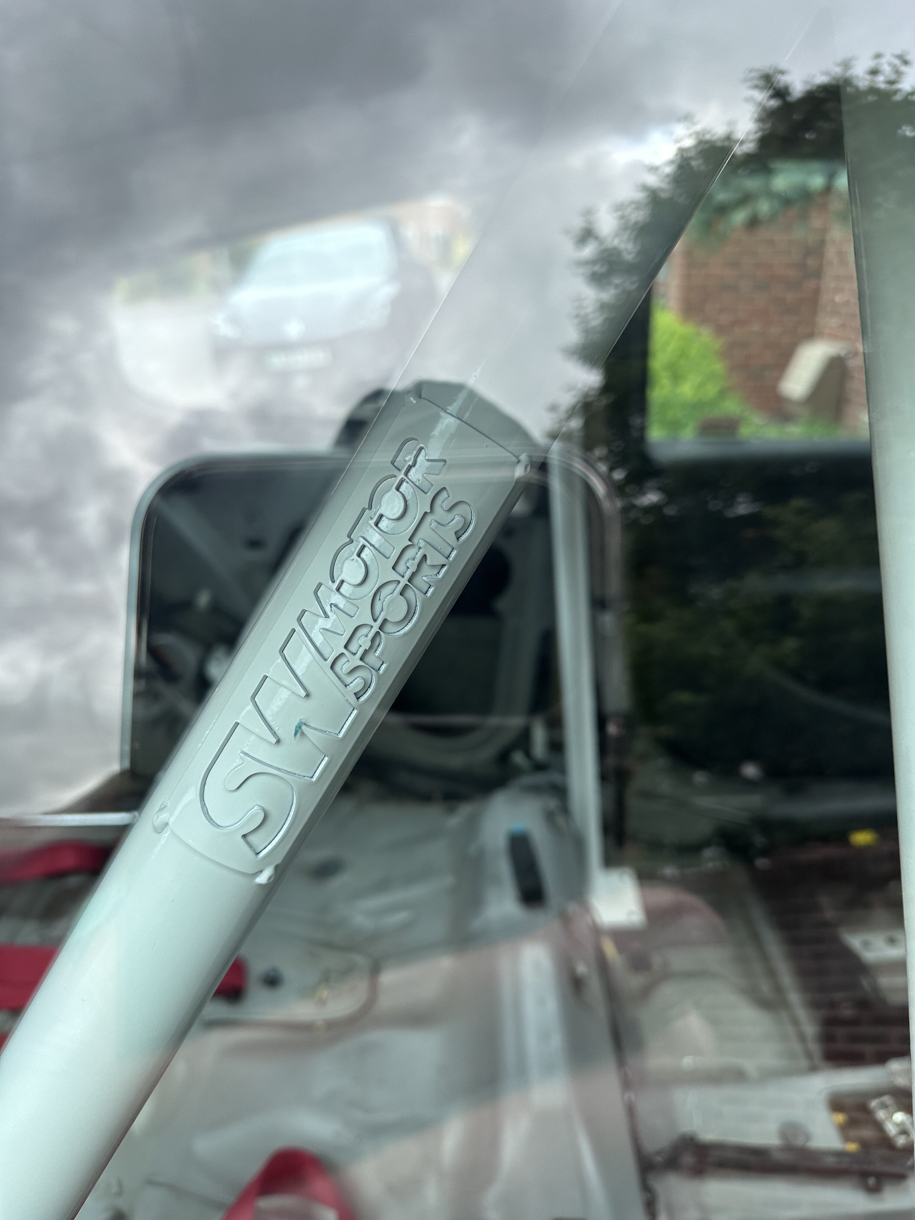

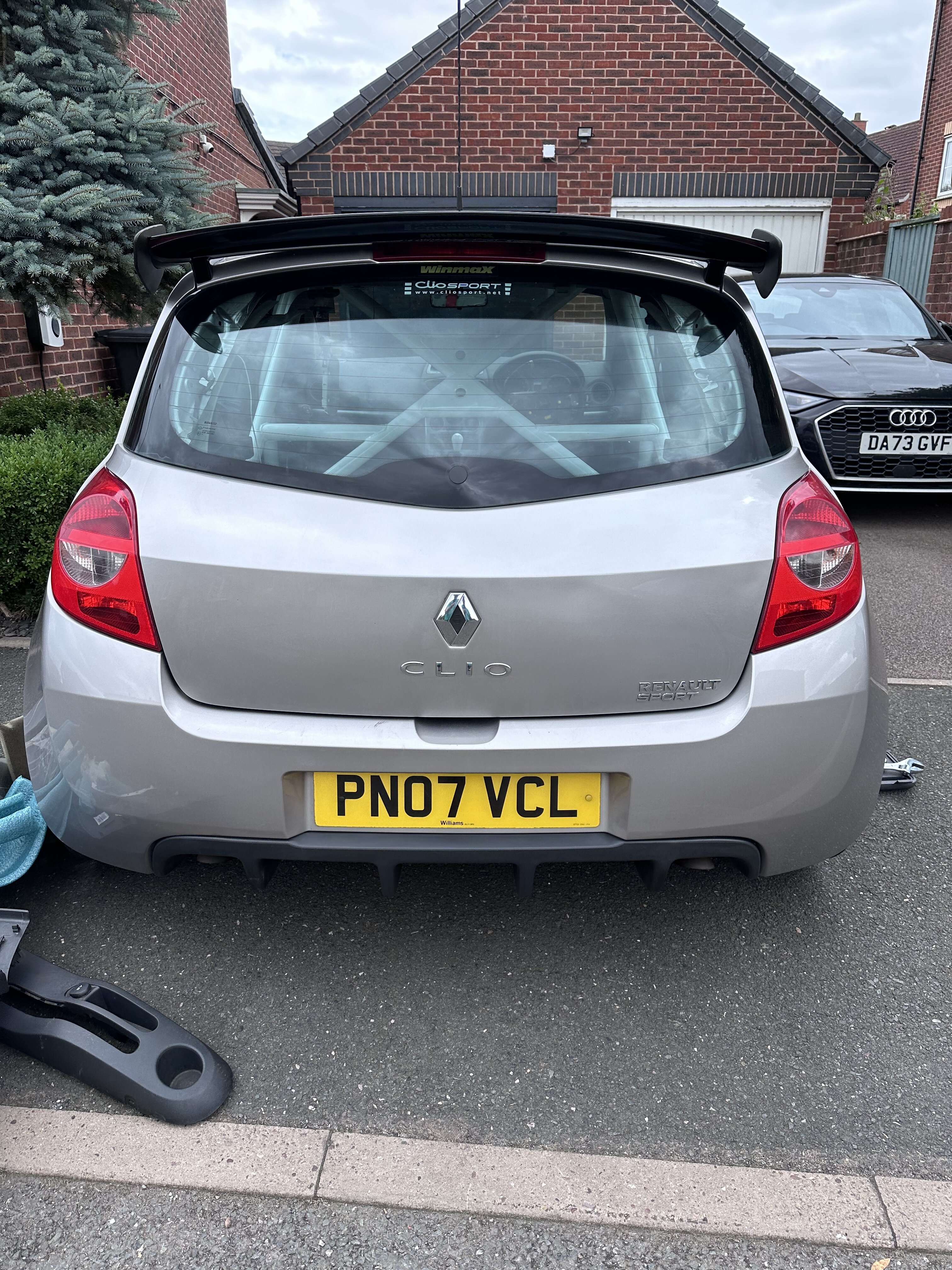

cage should be arriving today - i definitely need some new drill bits to fit it. Previously use cobalt with decent results but they don't seem to last long at all.
any recommendations?
Speedo Gonzales
Just don't buy Milwaukee ones
I've snapped about 4 of my f*****s. Maybe it's just me though because they go through metal like it's butter🤣

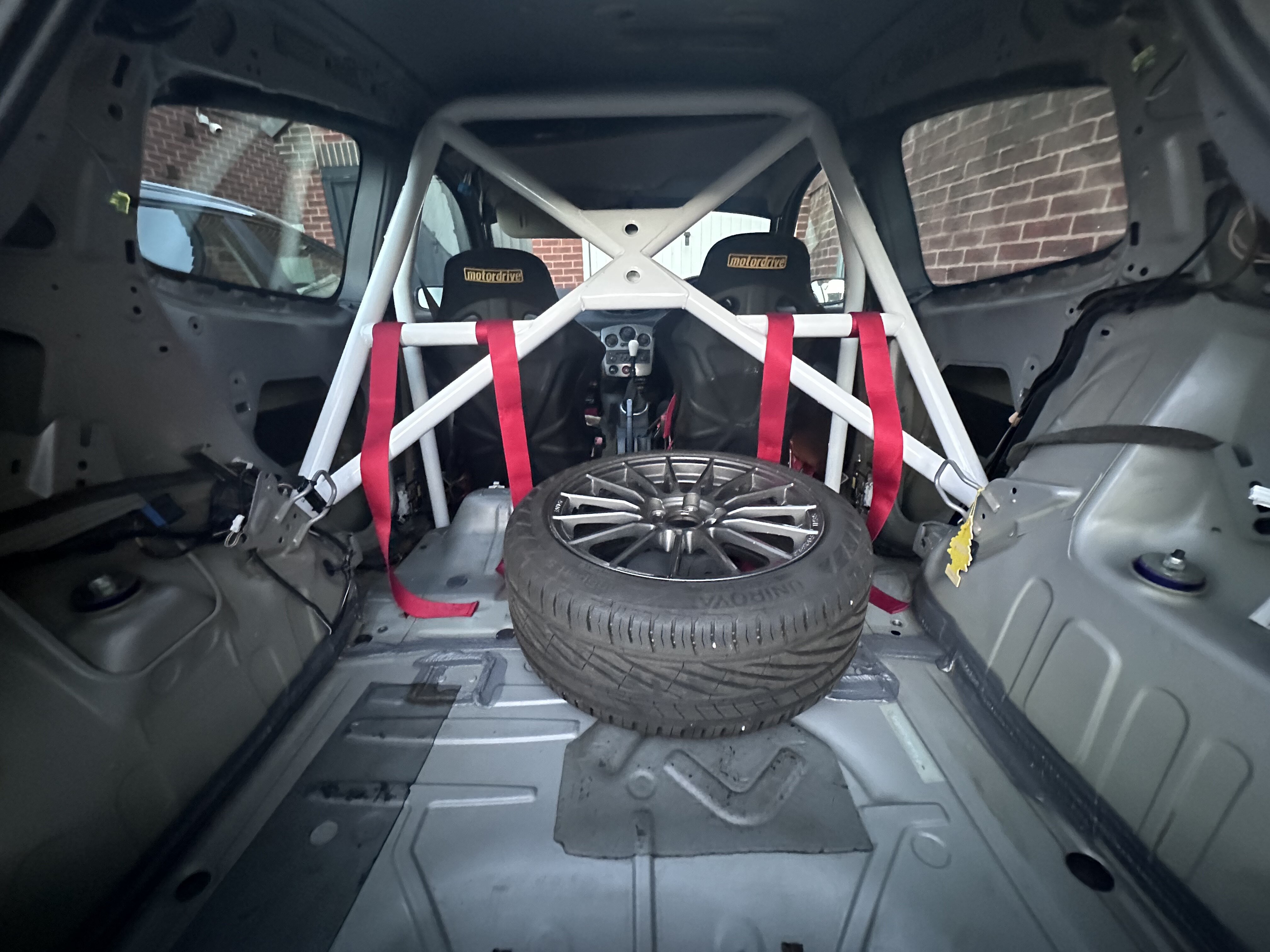

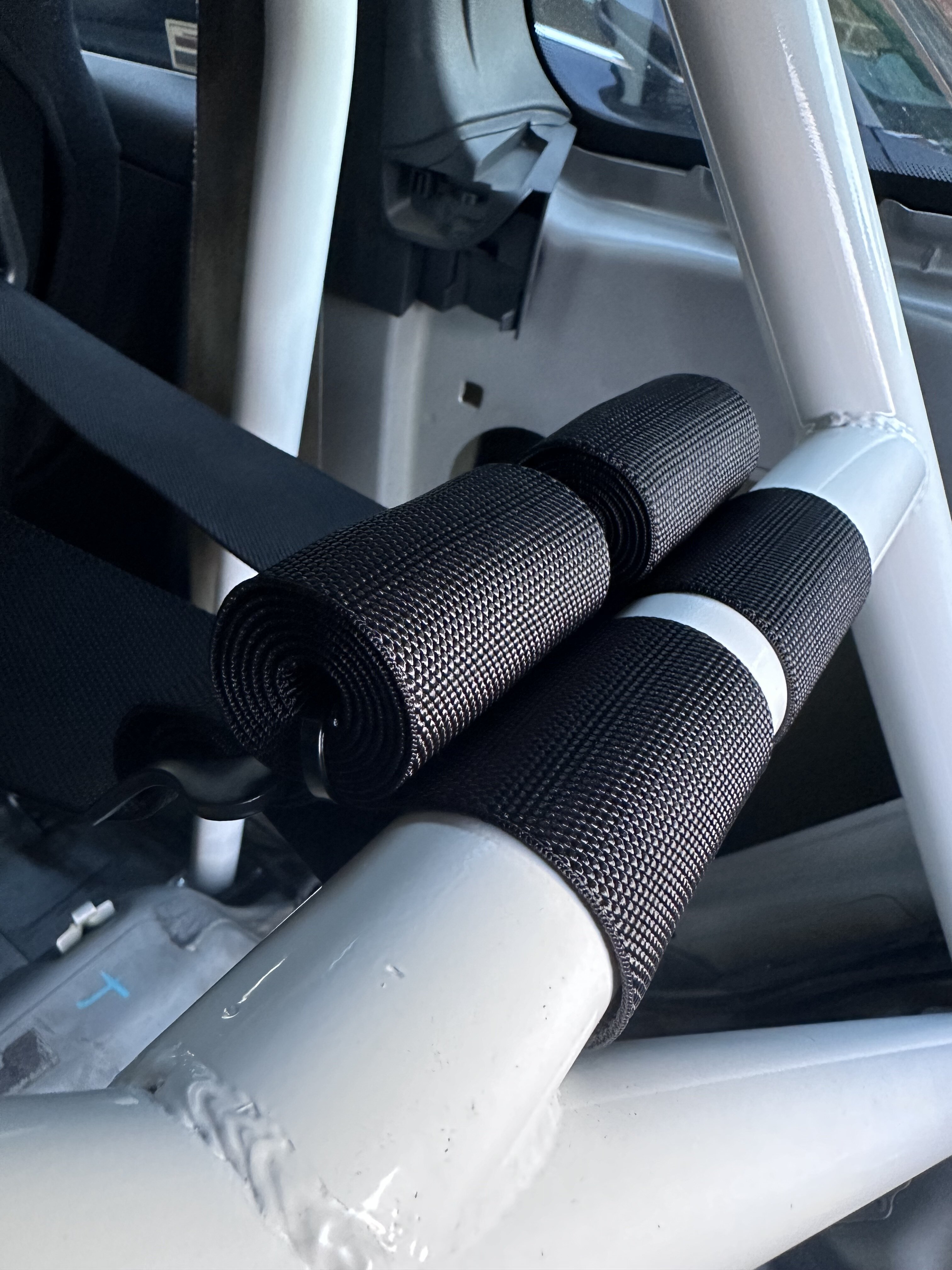

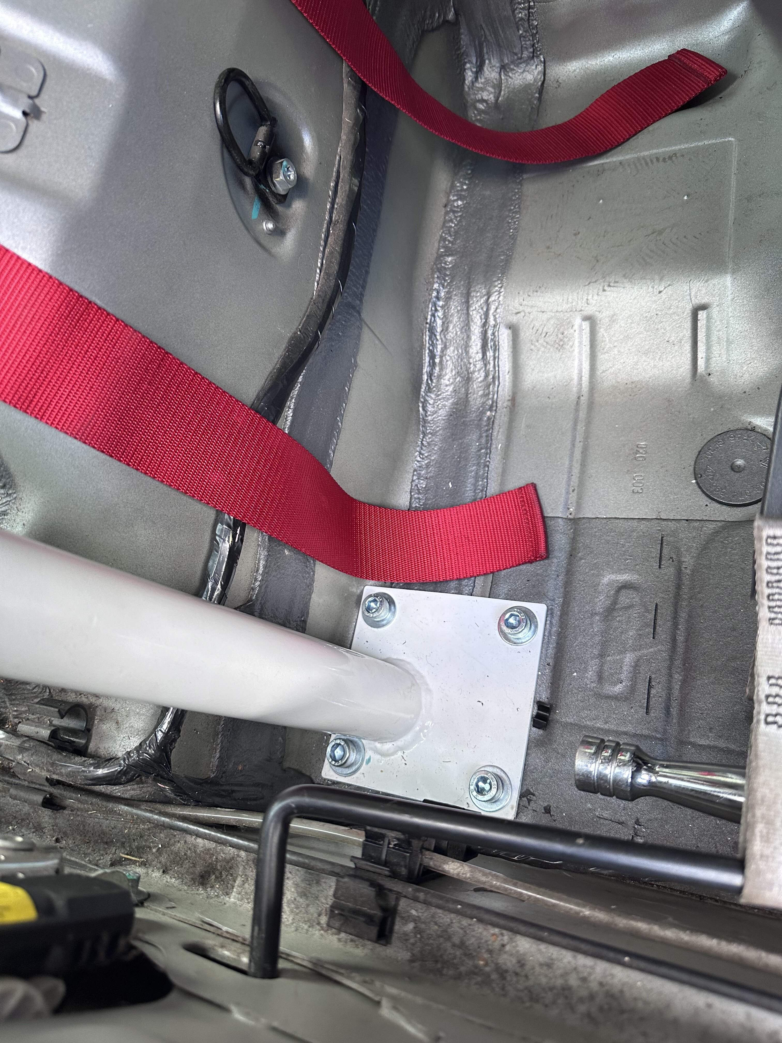

Did you have boxes welded in with captive nuts to attach the cage to the car?
Matt Cup
  Leon Cupra, 172 Cup
Fair enough. I just remember my bros Cup having a Satefy Devices dash dodge cage put in and having to get a specialist to fit it with those weld in boxes for quite a large sum.
massiveCoRbyn
  Several
Depends on the design of the cage. The SD cage for the 197/200 has weld-in feet. They are better in reality, as it strengthens the mounting points, but the body could still split around the welds in theory. It also allows the cage to be mounted more effectively (such as to the sill as well as the floor), rather than having to sit on a relatively flat surface. Motorsport UK/FIA cages well tend to have welded in feet, but half cages like this won't, presumably so people can install them at home.

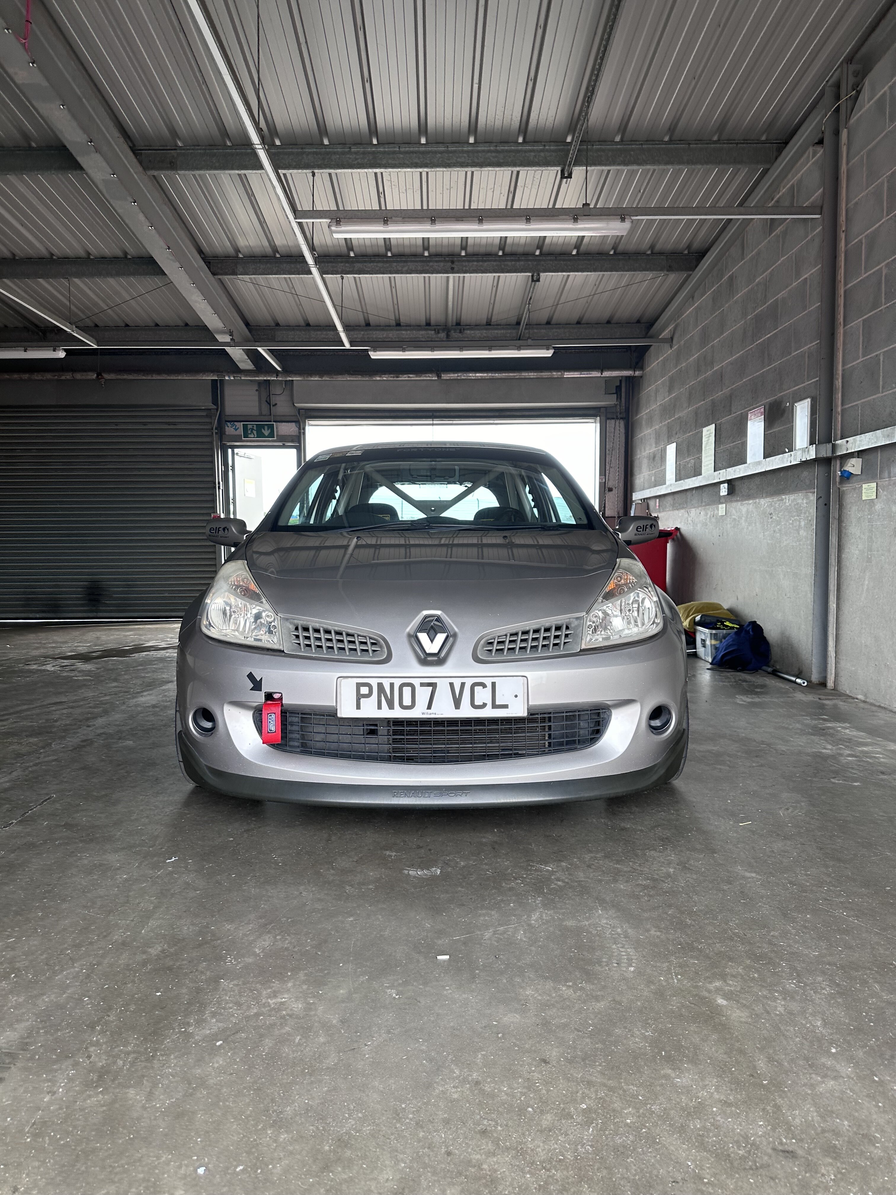

Good evening at donnington once I got the f**king thing going again. Did 10 laps and came in for a cool down. Then wouldn’t start, not turning over and saying steering not locked. My man @RSRowe coming through with the goods and the guys from open track giving me a bump start did the trick. Guess it’s the starter that’s fucked. Anyway had some great laps at the end with a trophy, 200 and mk4 which made up for the hour I lost. When you’re on it with other cars of the same pace lapping and overtaking it’s a feeling that can’t be beaten ❤️

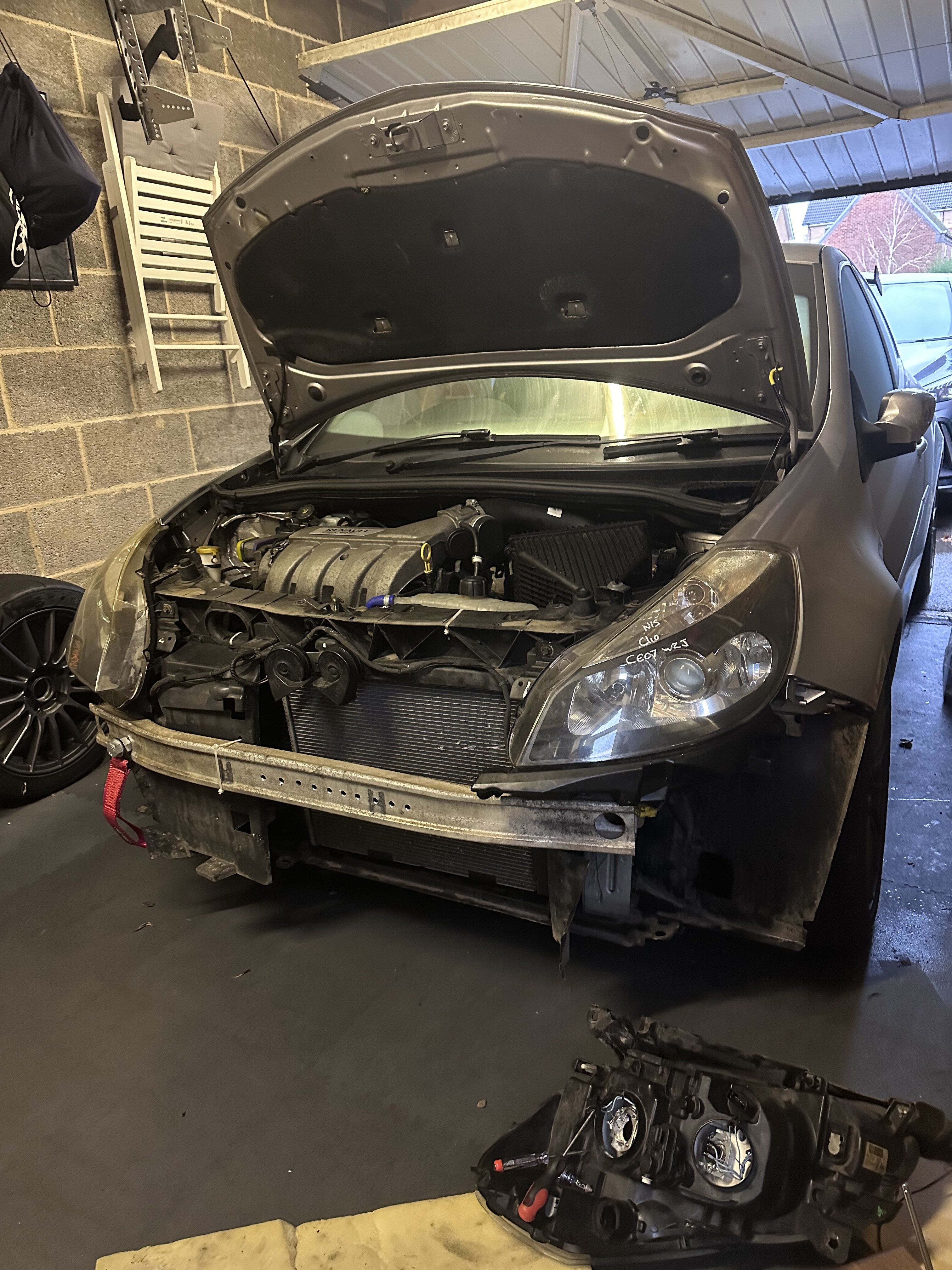

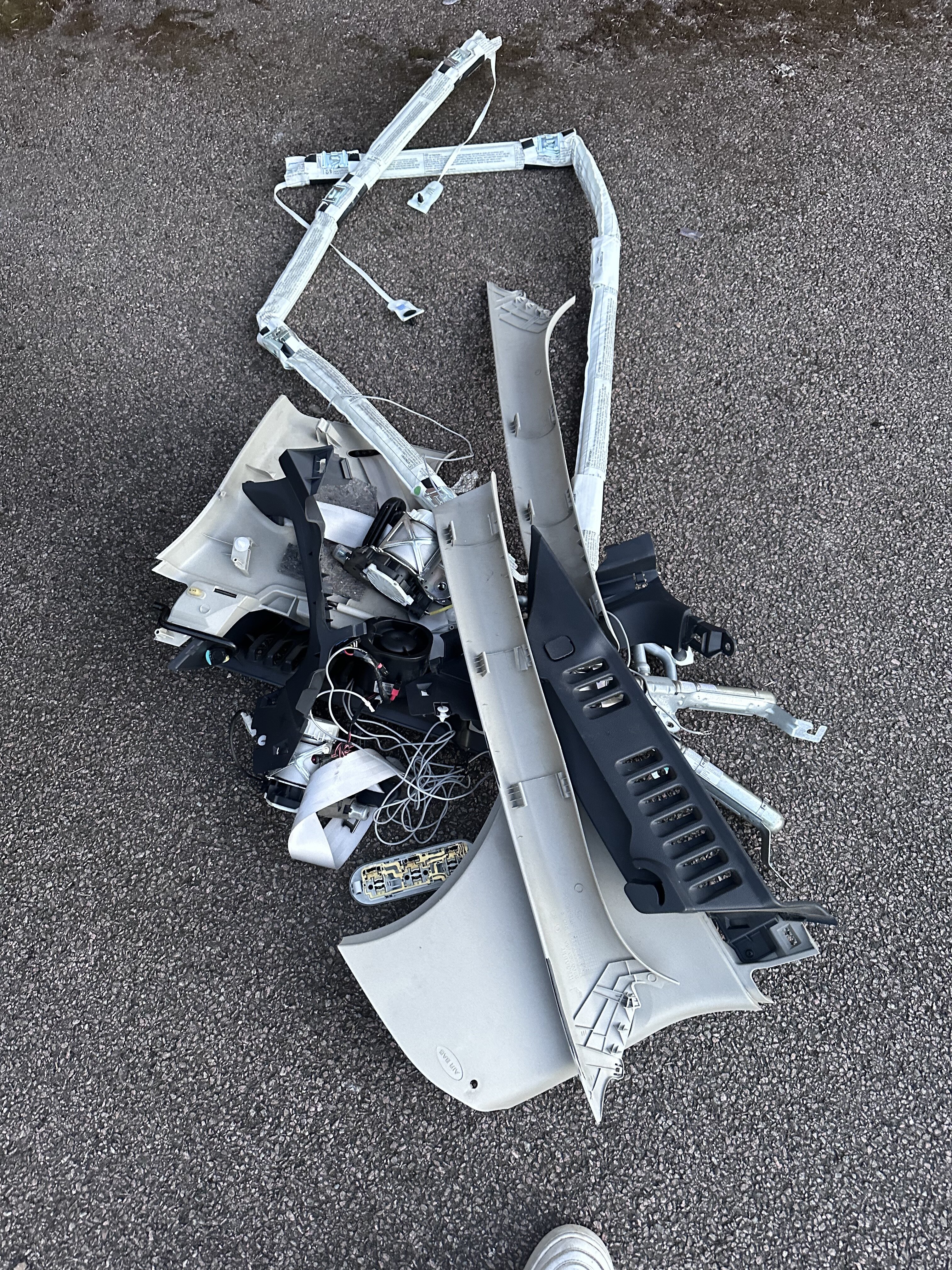

Stripped a bit more out tonight - rear airbags, seatbelts etc Surprising how much trim and plastics there is everywhere

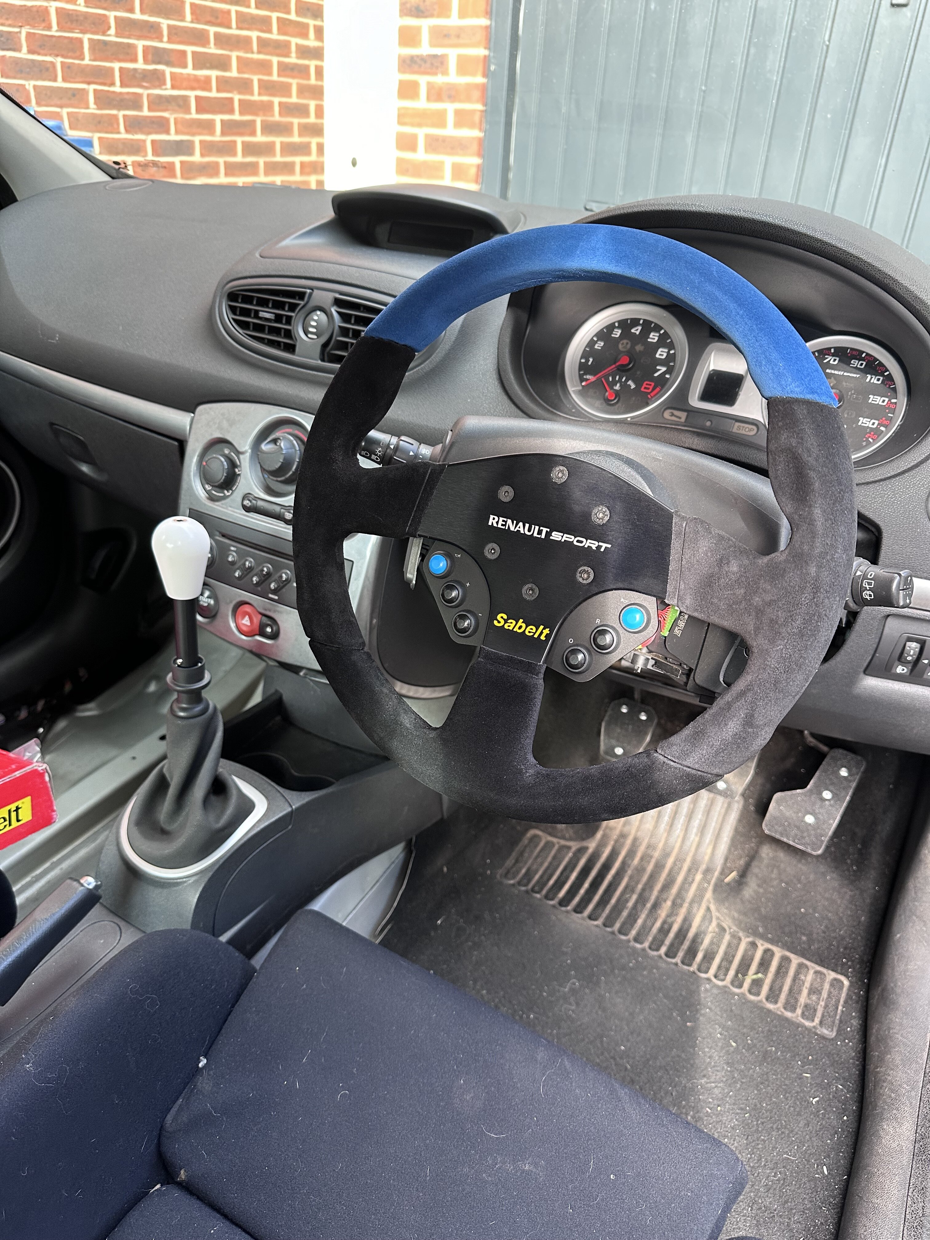

I did get a check injection fault whilst driving yesterday , went into limp mode. Sounds like it could be throttle body?
Clart

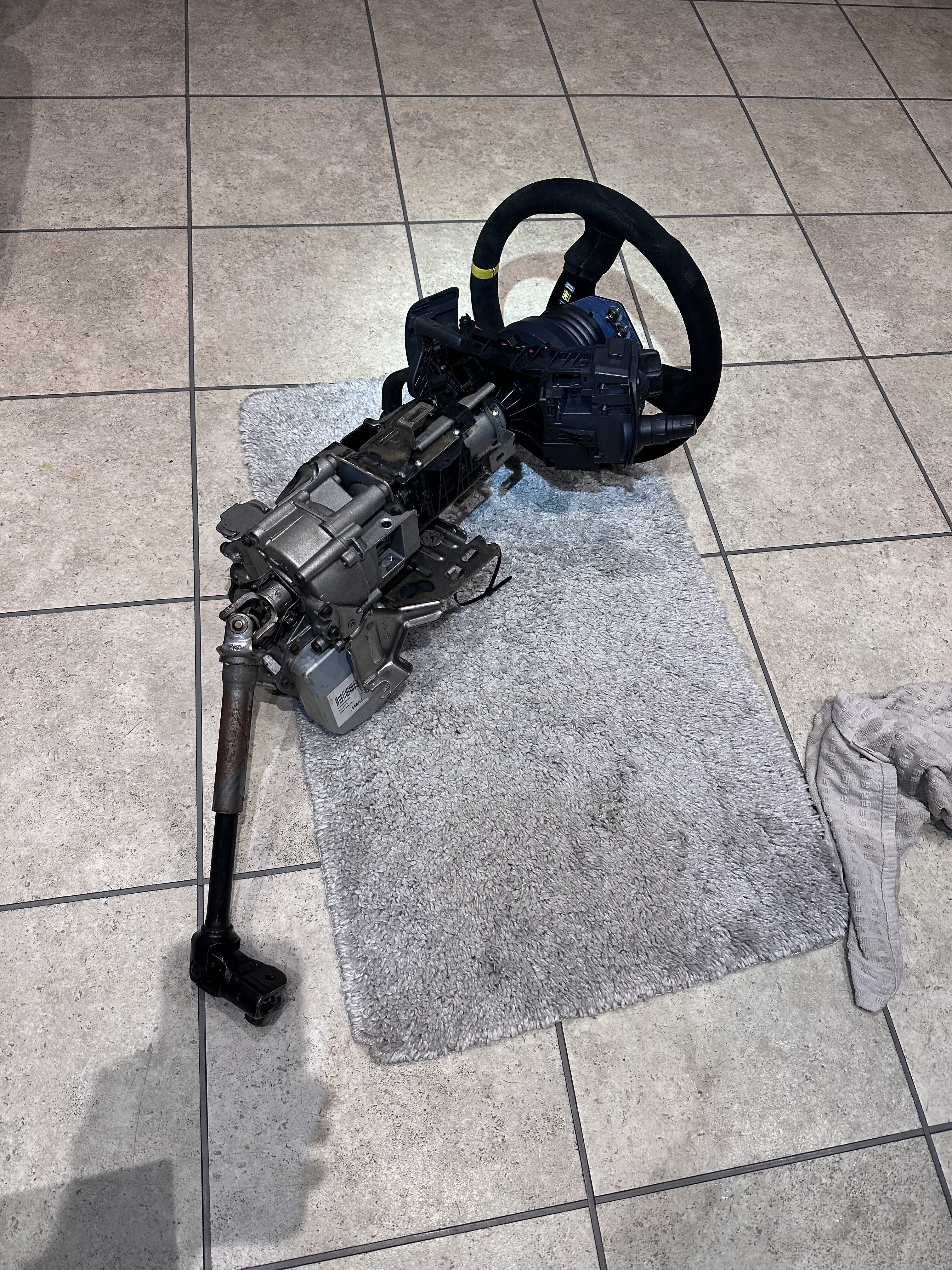

I’ve got the steering fault permanently now. It’s reading a few codes but nothing that looks related , maybe brake pedal switch fault?
Battery looks ok with 13.6v
Clart

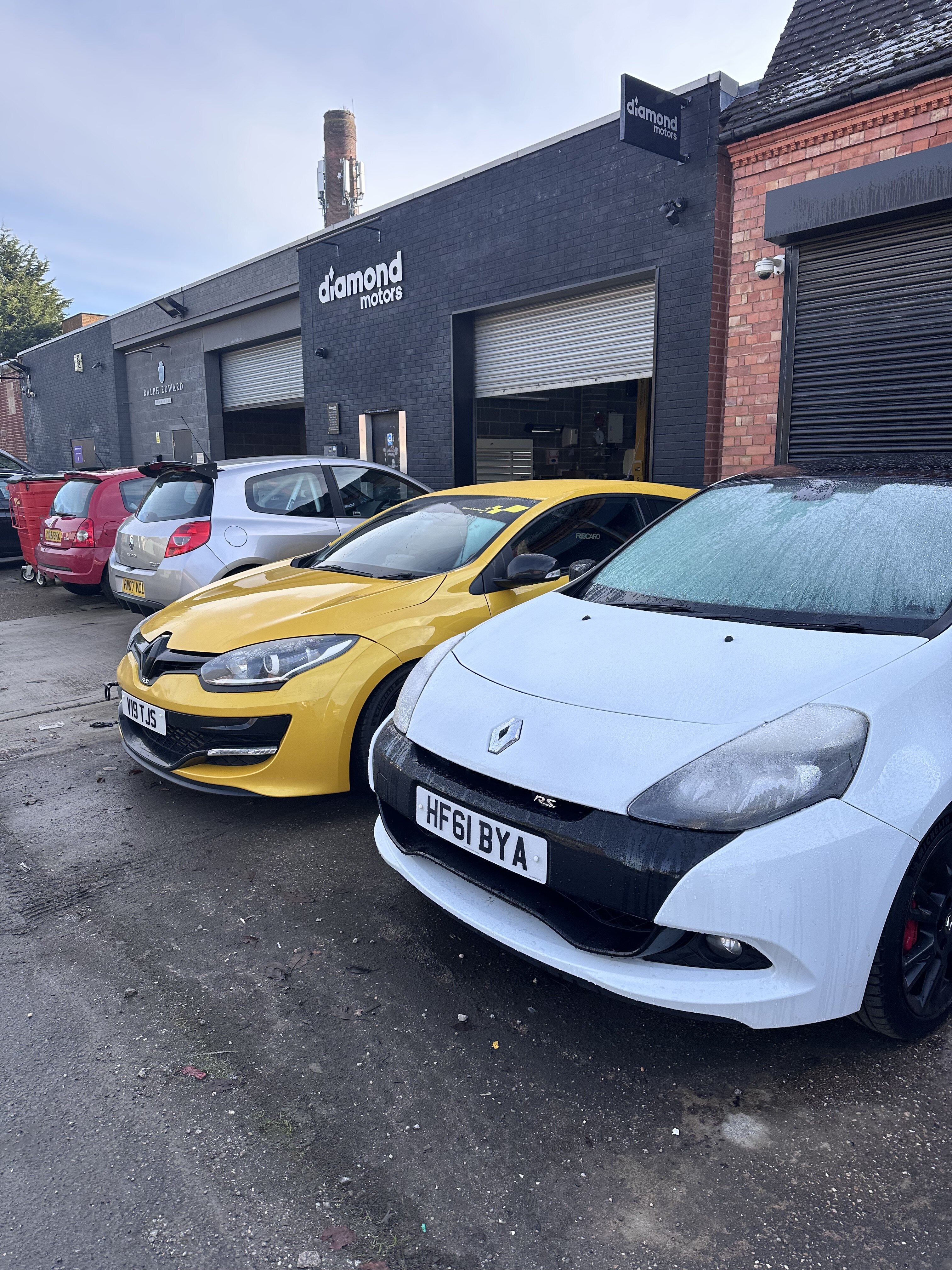

Got the car booked in with diamond motors next week. Hopefully he can get it fixed before my trackday on 8th :eek:
Clart
I’ve sourced a cheap steering column for £60 but it could also be the ecu that’s dead. There’s a company that wipes the ecu so you can just plug in and it recodes itself - just needs to be the same part number. So I need to get the part number from my ecu, of course it’s right under the clocks and you need to completely drop the column which is a pita as it’s an awkward fucker.
Anyway hopefully 🤞one of these 2 should fix it.
