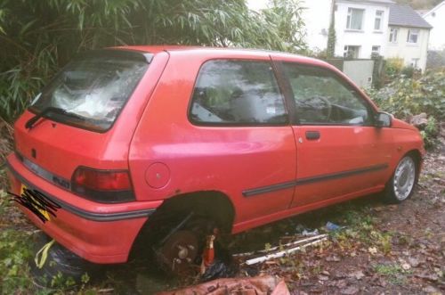

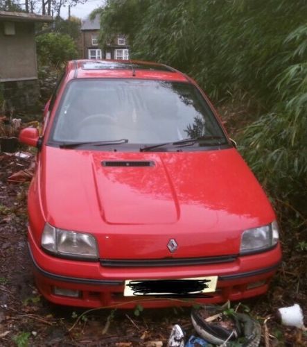

The one evening did a fresh search on Ebay and found a phase 1 car newly listed about 12 miles from home!

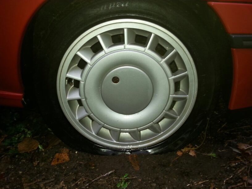

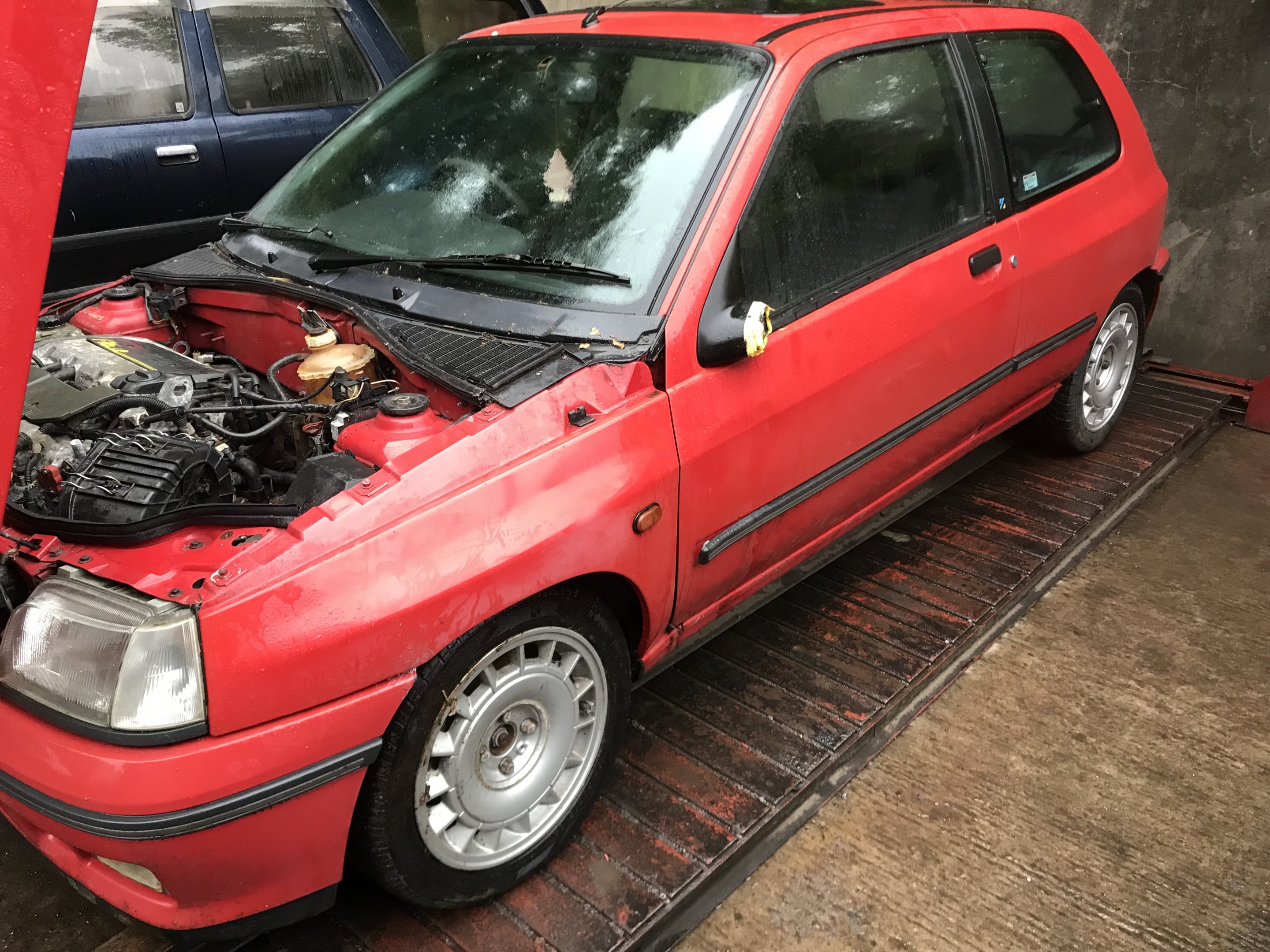

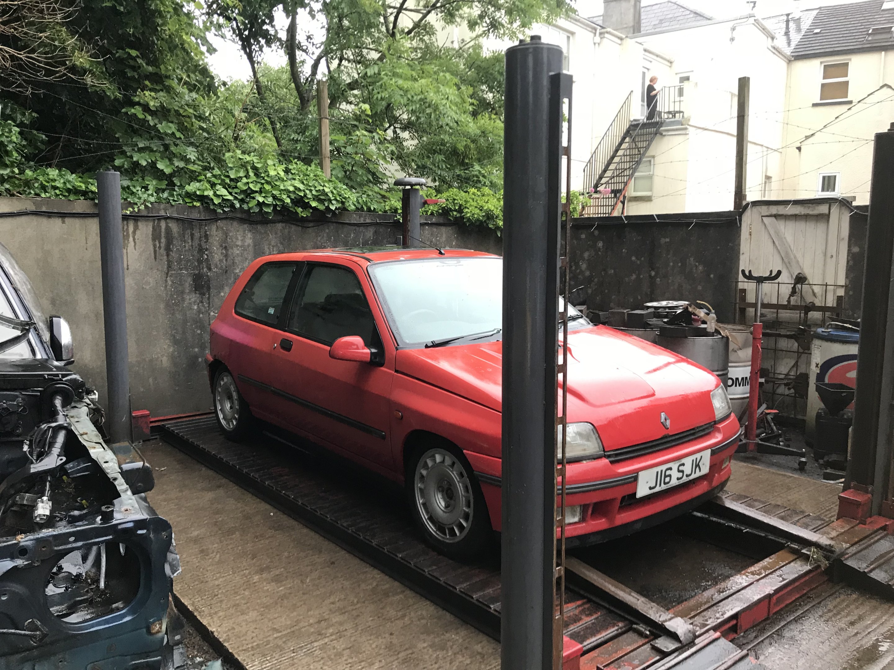

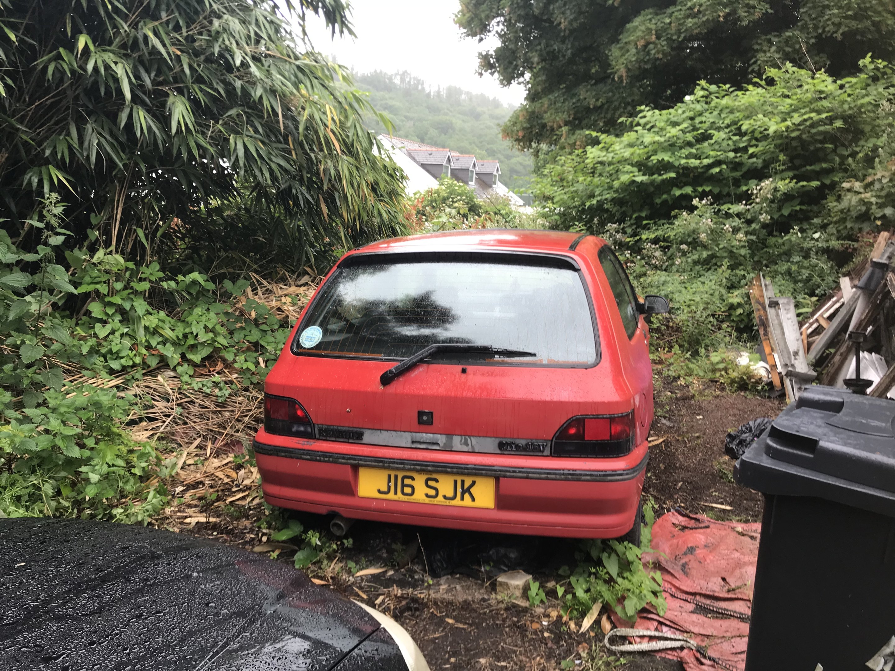

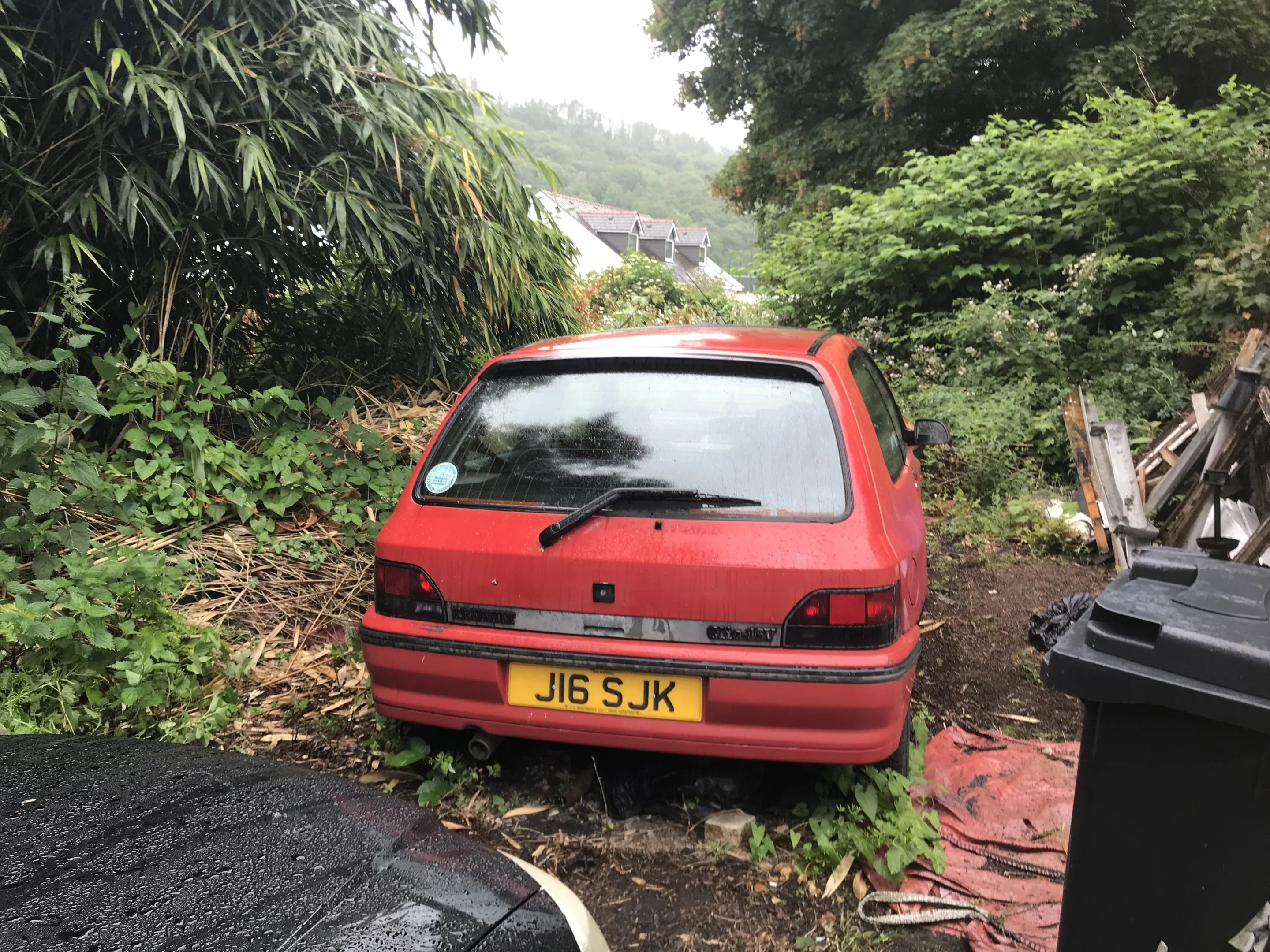

Car has been sat in the same spot for 10 years plus! and looking a bit sorry for itself, had a quick look around, did a deal, pulled off the wheels, freed up the brakes and dragged it onto the trailer

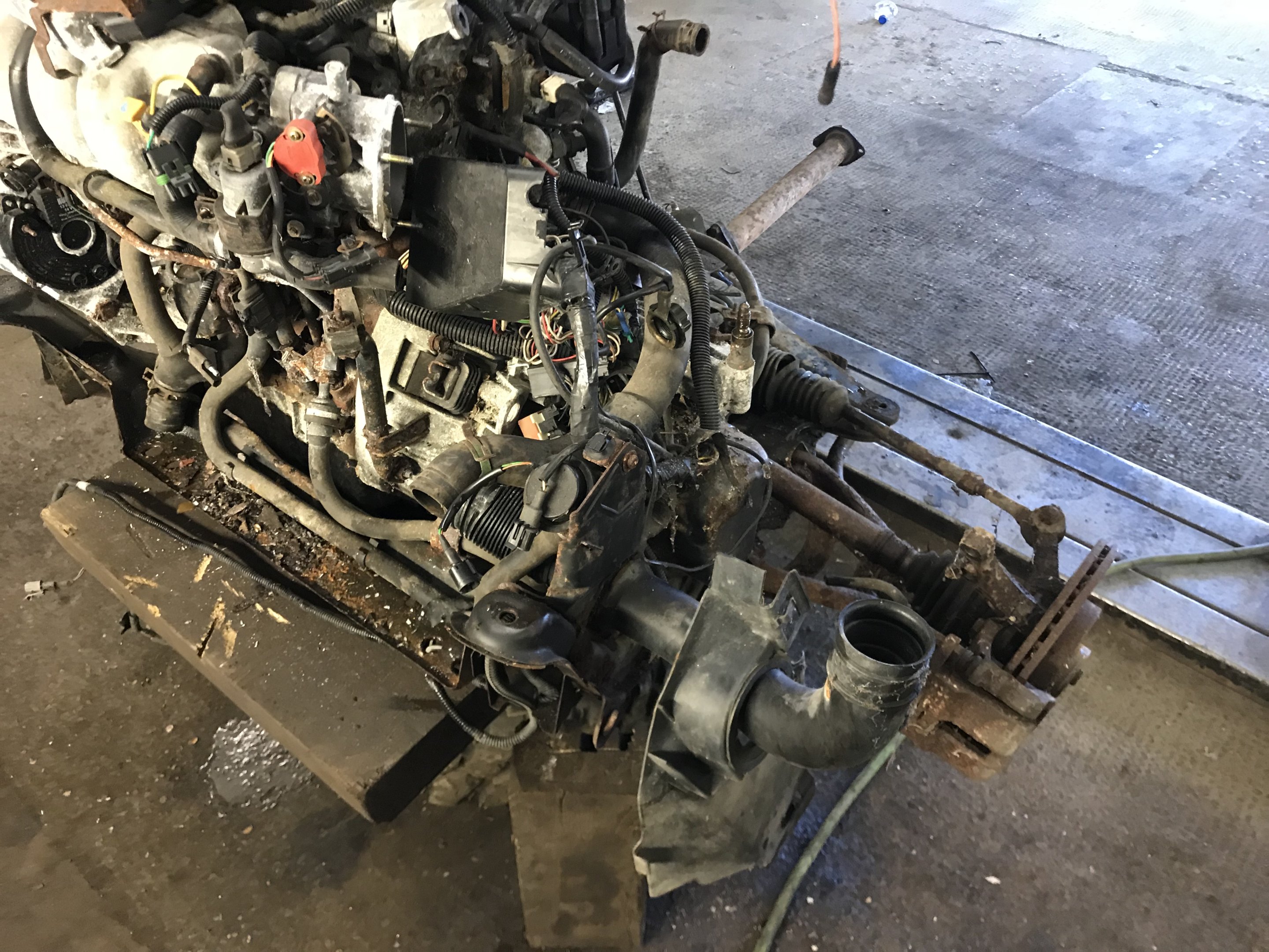

First job was to have a good look around and see if it was a viable project? Steam cleaned it top and bottom

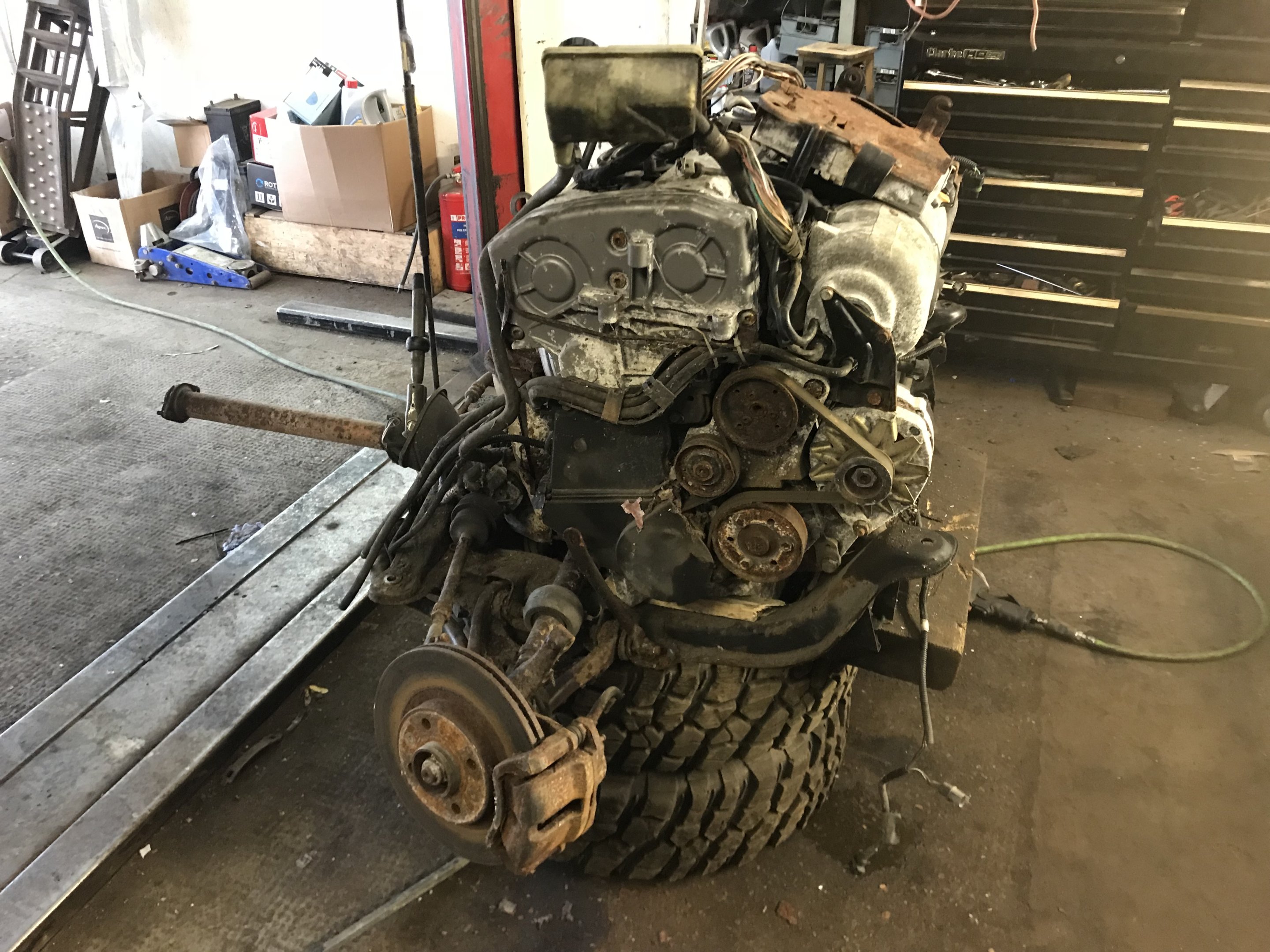

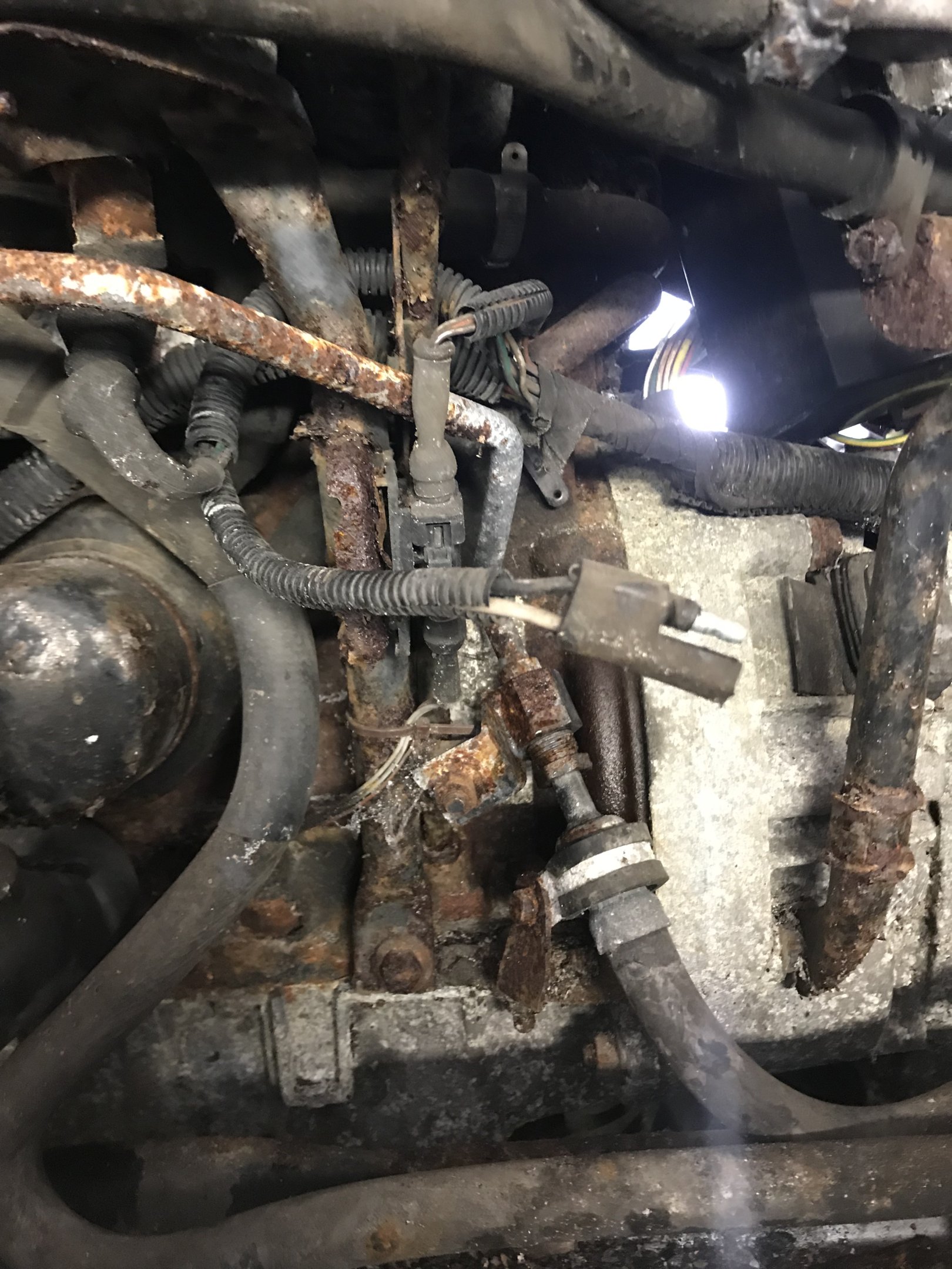

Had a good poke around, , front subframe rotten, front bottom arms so rusted that they are about to snap, exhaust etchas a good covering of surface rust, engine turns over. doesnt start and looks like its been used as a boat anchor! But Unbelievably the body shell is pretty good, rust on rear arches and rear of outer sills other than that looks really clean just some seriously faded paint!
Best bit is i dont think it has ever been modified, and is fairly complete, even has original radio and handbook

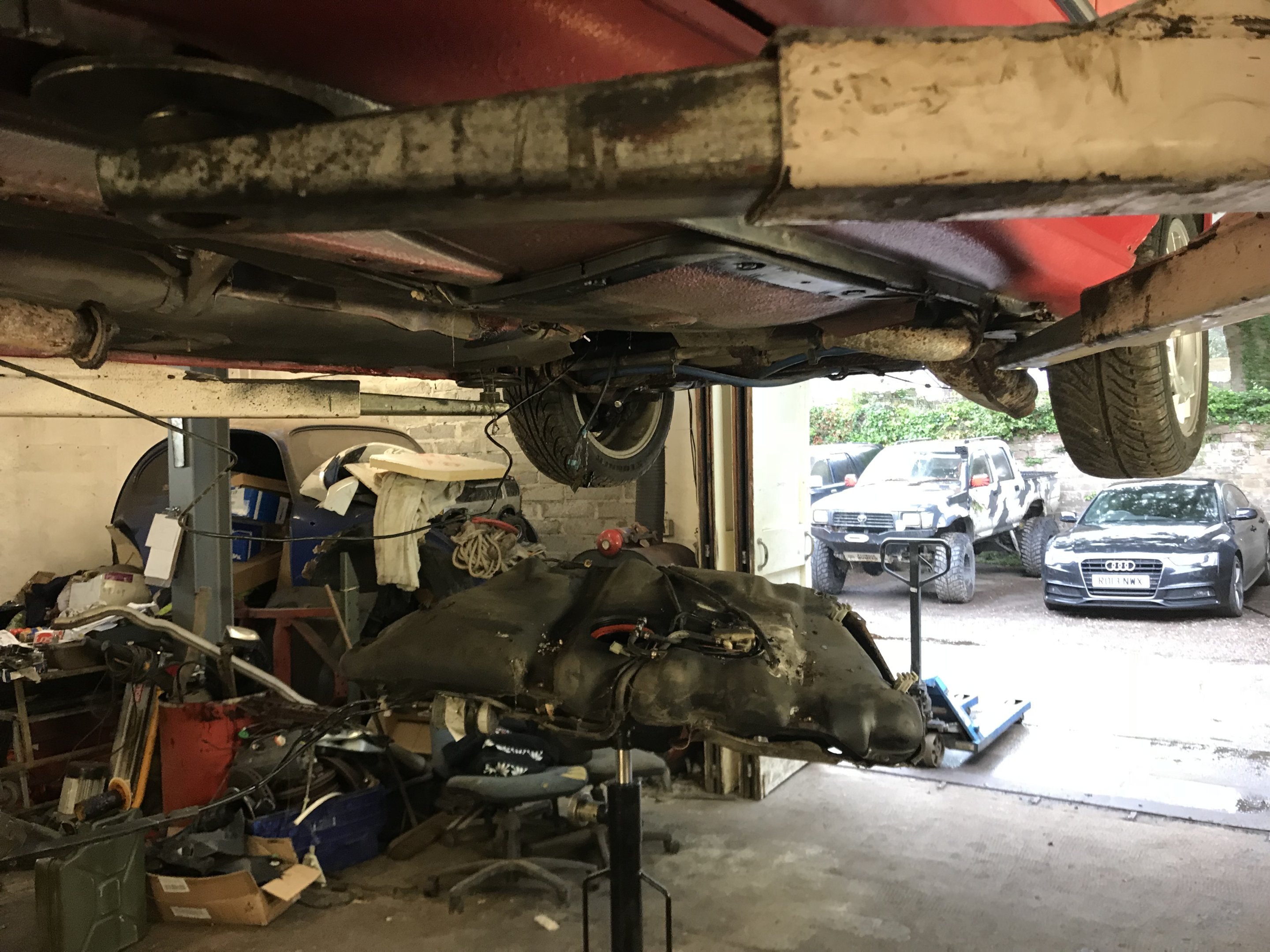

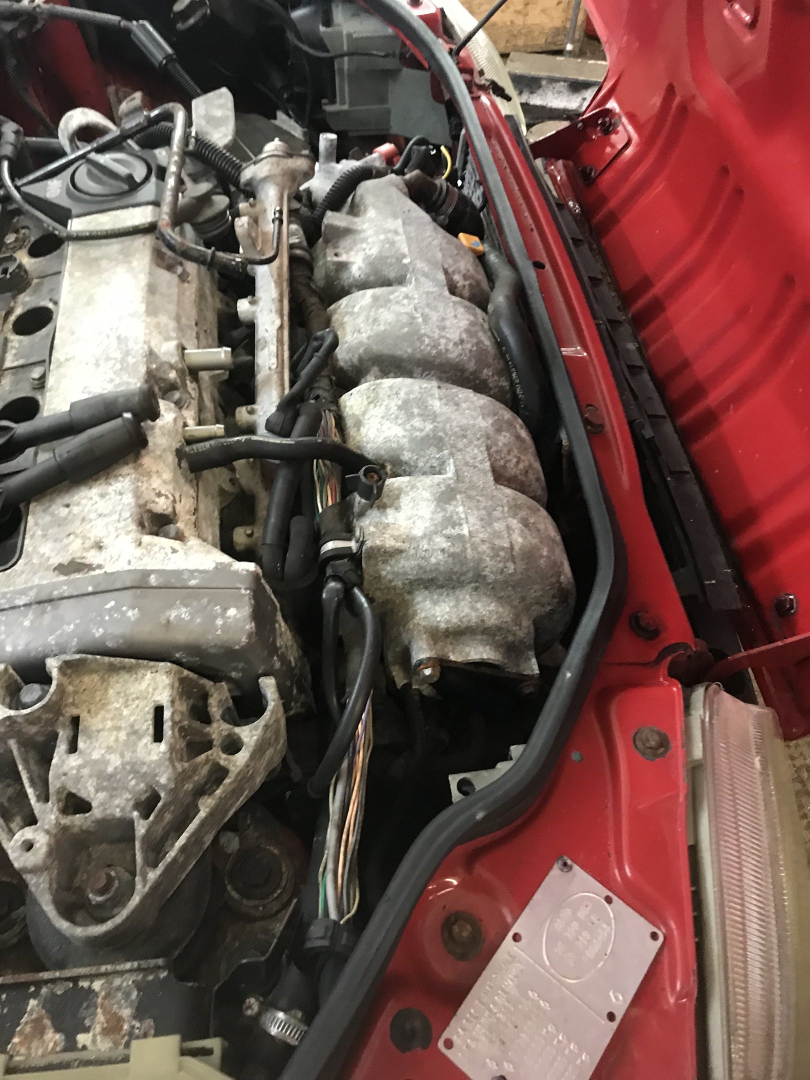

Thought it was worth trying to get it running before i tore it apart, checked the oil, nice and clean, chucked a battery on, lights and starter! but no fuel pump, Popped open the fuel filler and had a sniff, some seriously old petrol fumes.

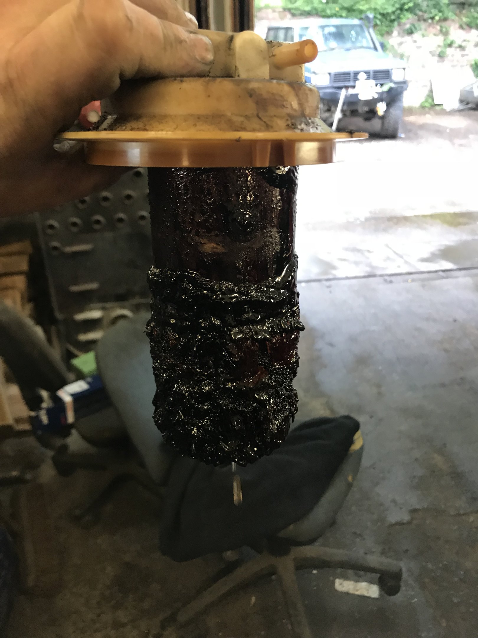

Dropped the fuel tank for a good flush
Hmmmmm lovely an impressive amount of shite in the tank!
new pump ordered and both tanks flushed and cleaned

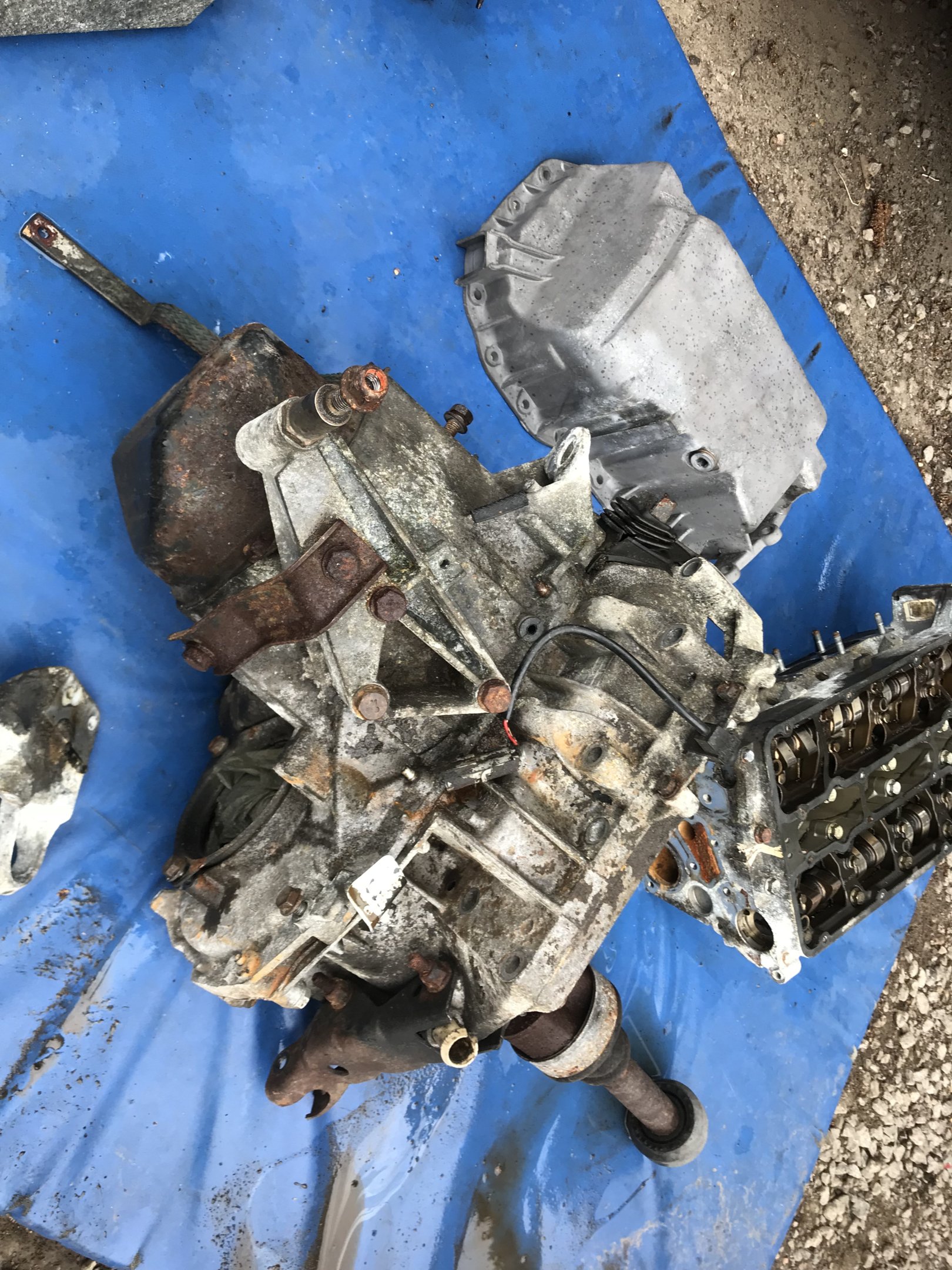

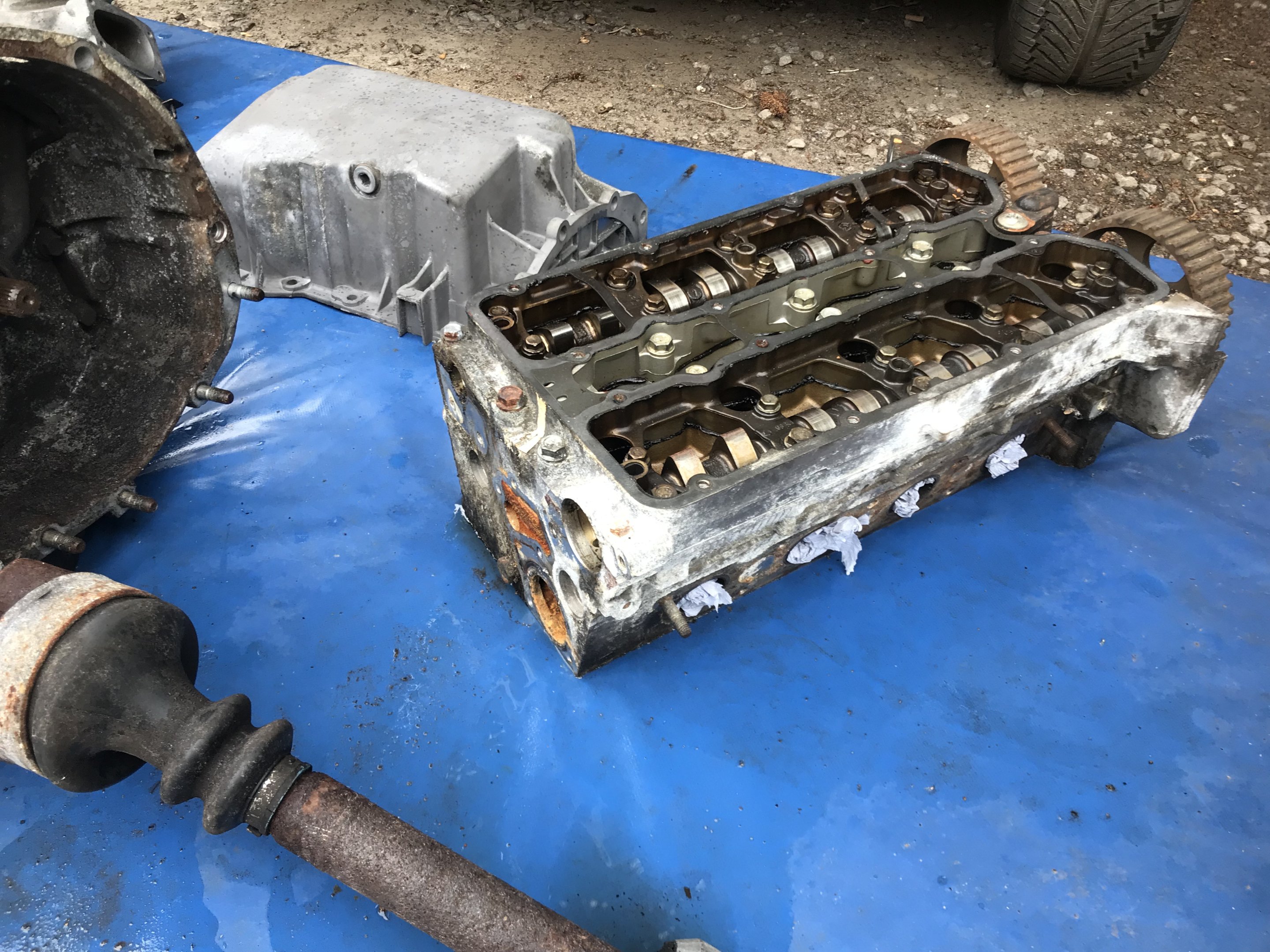

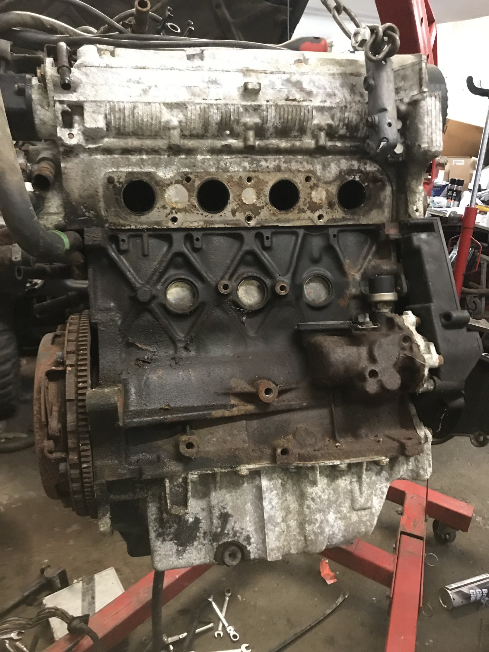

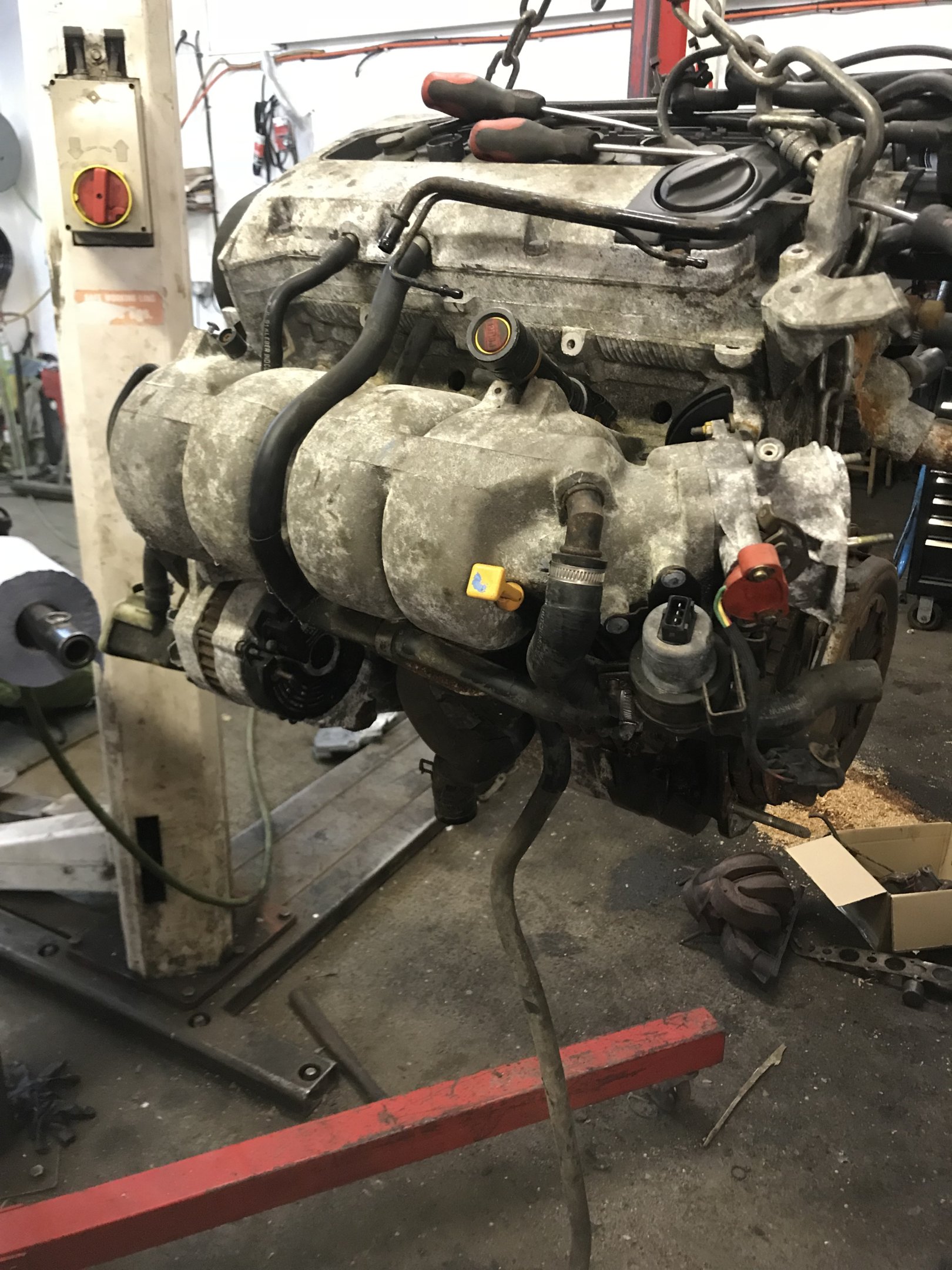

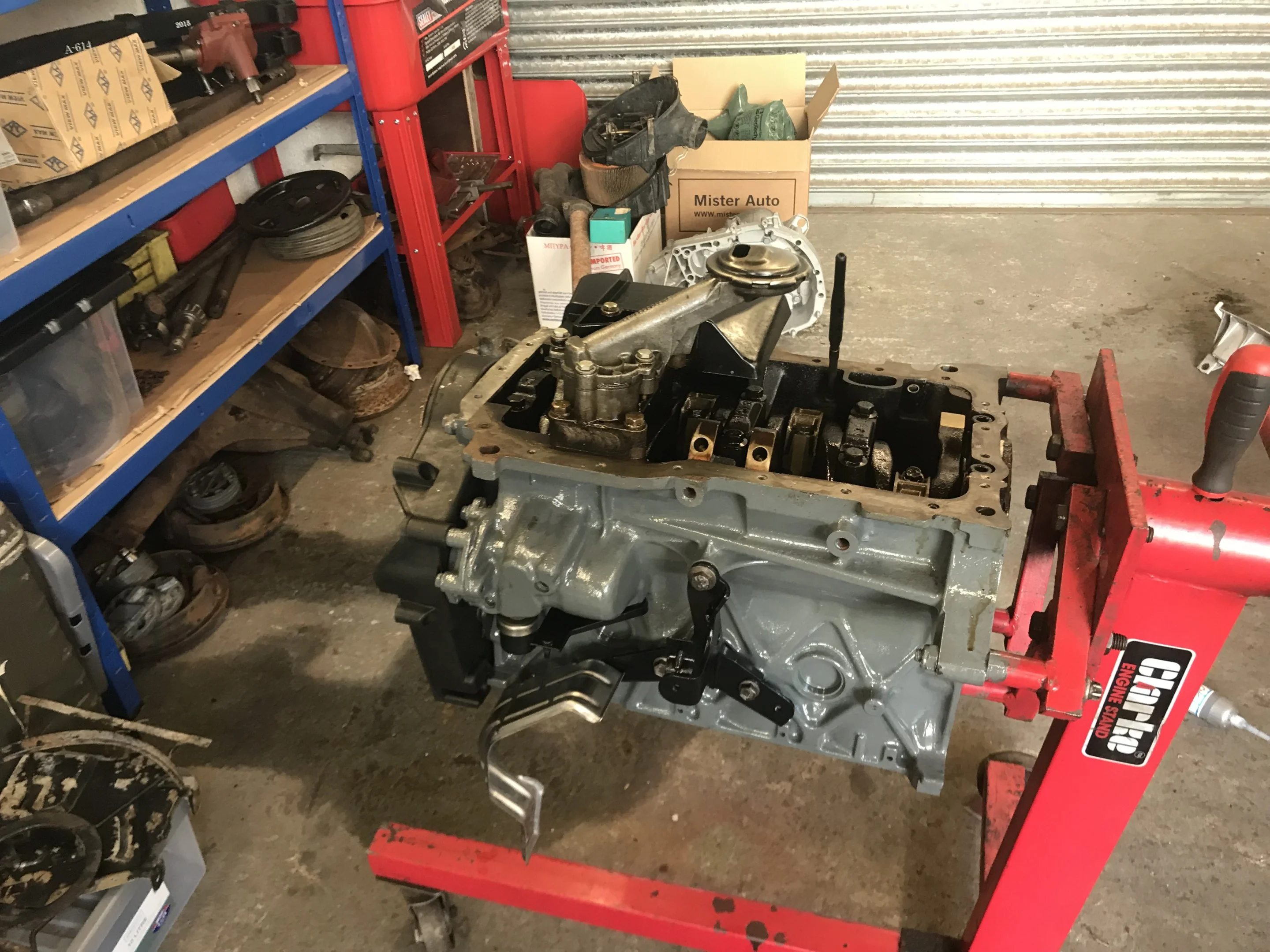

Stripped the engine down only done 90 odd thousand miles, mechanically looked really good, oil was crystal clear,

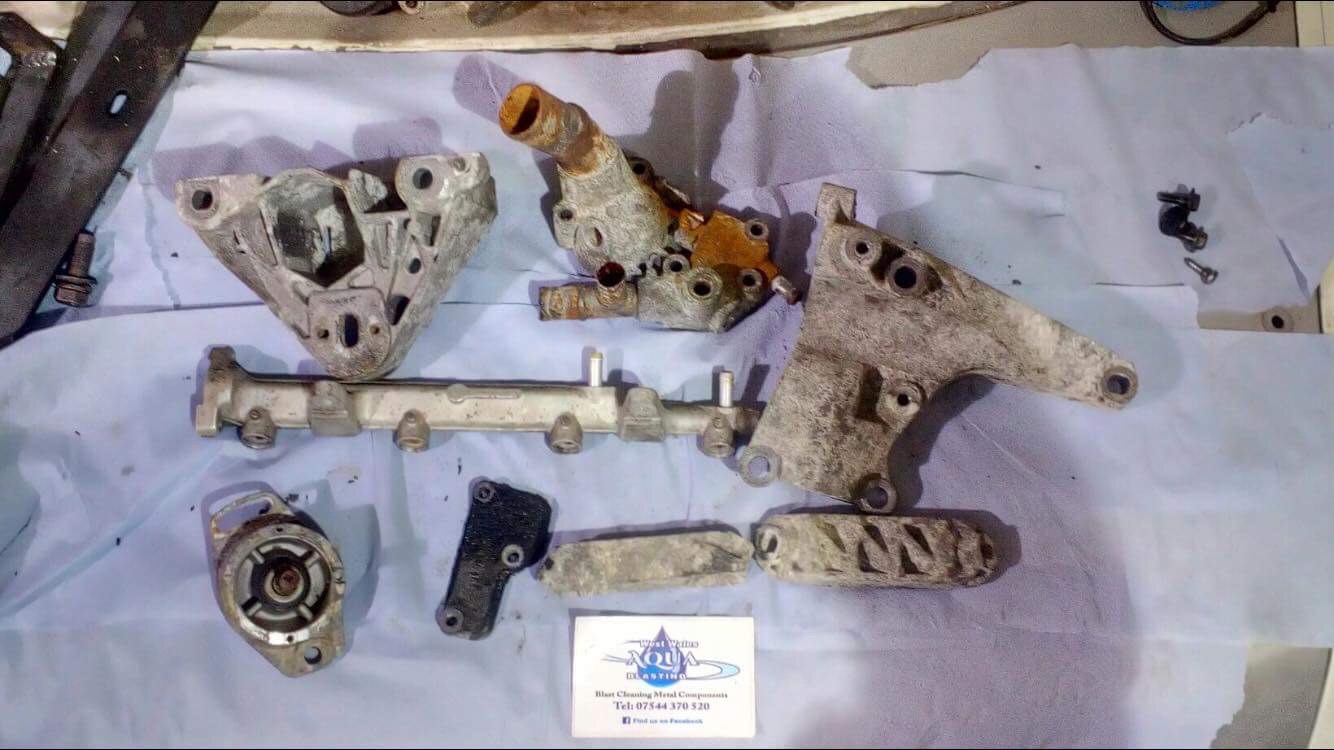

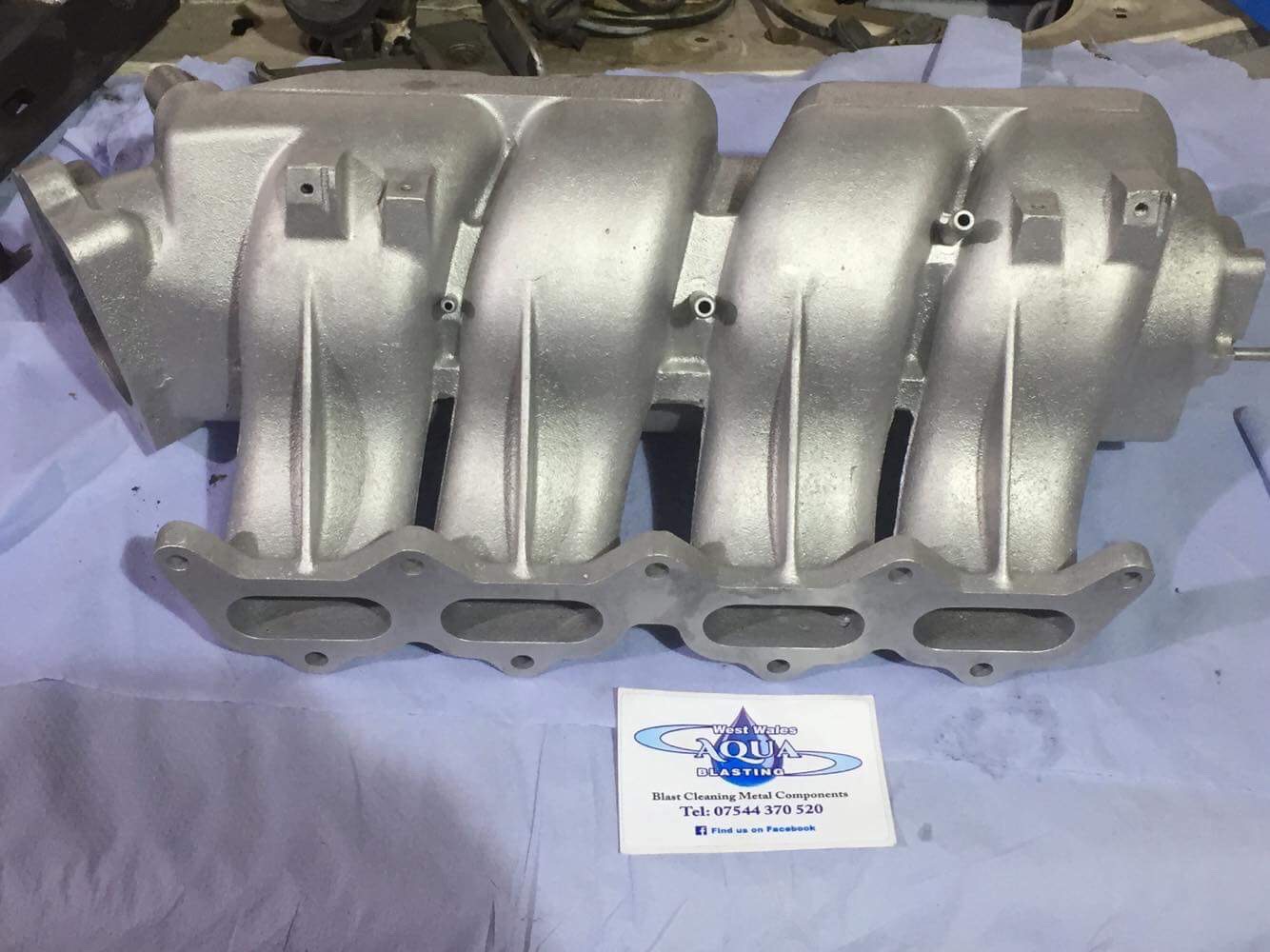

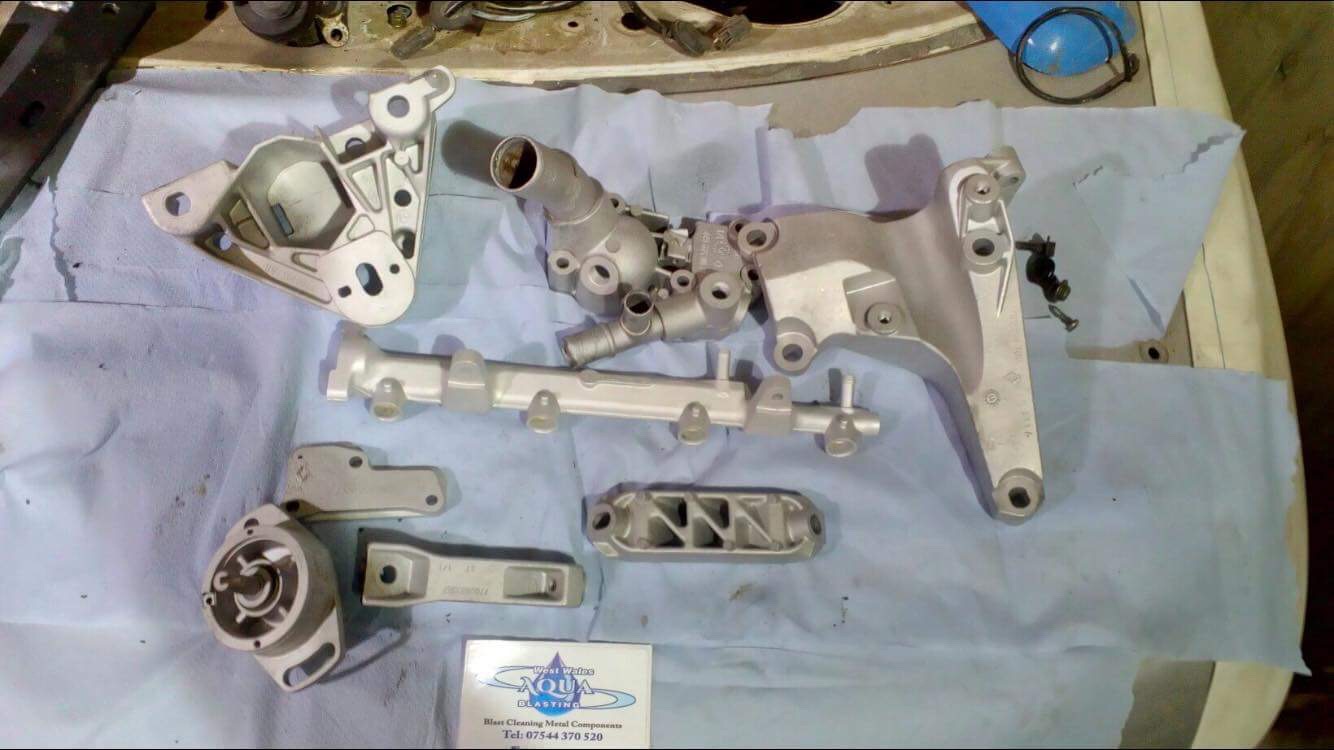

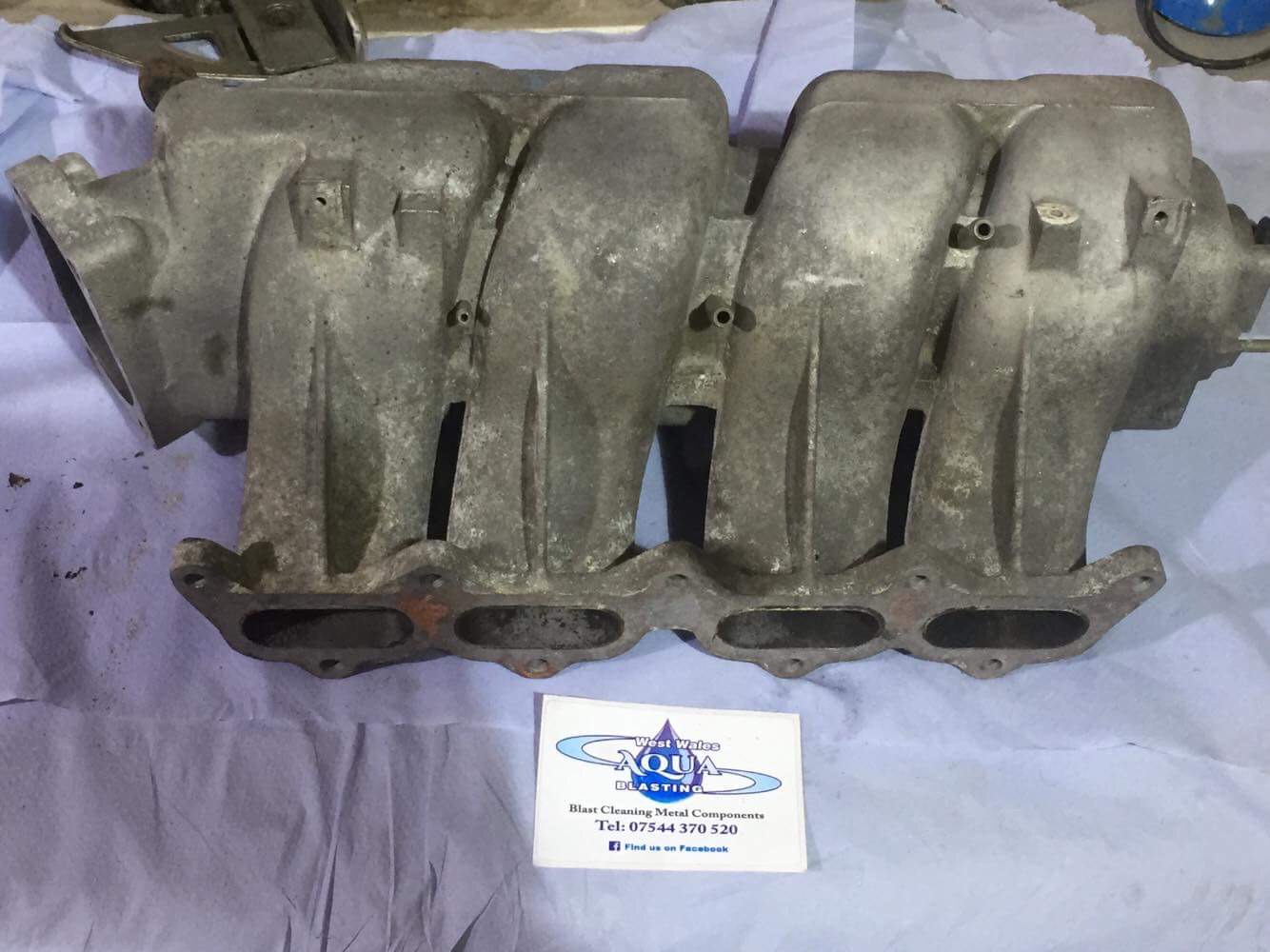

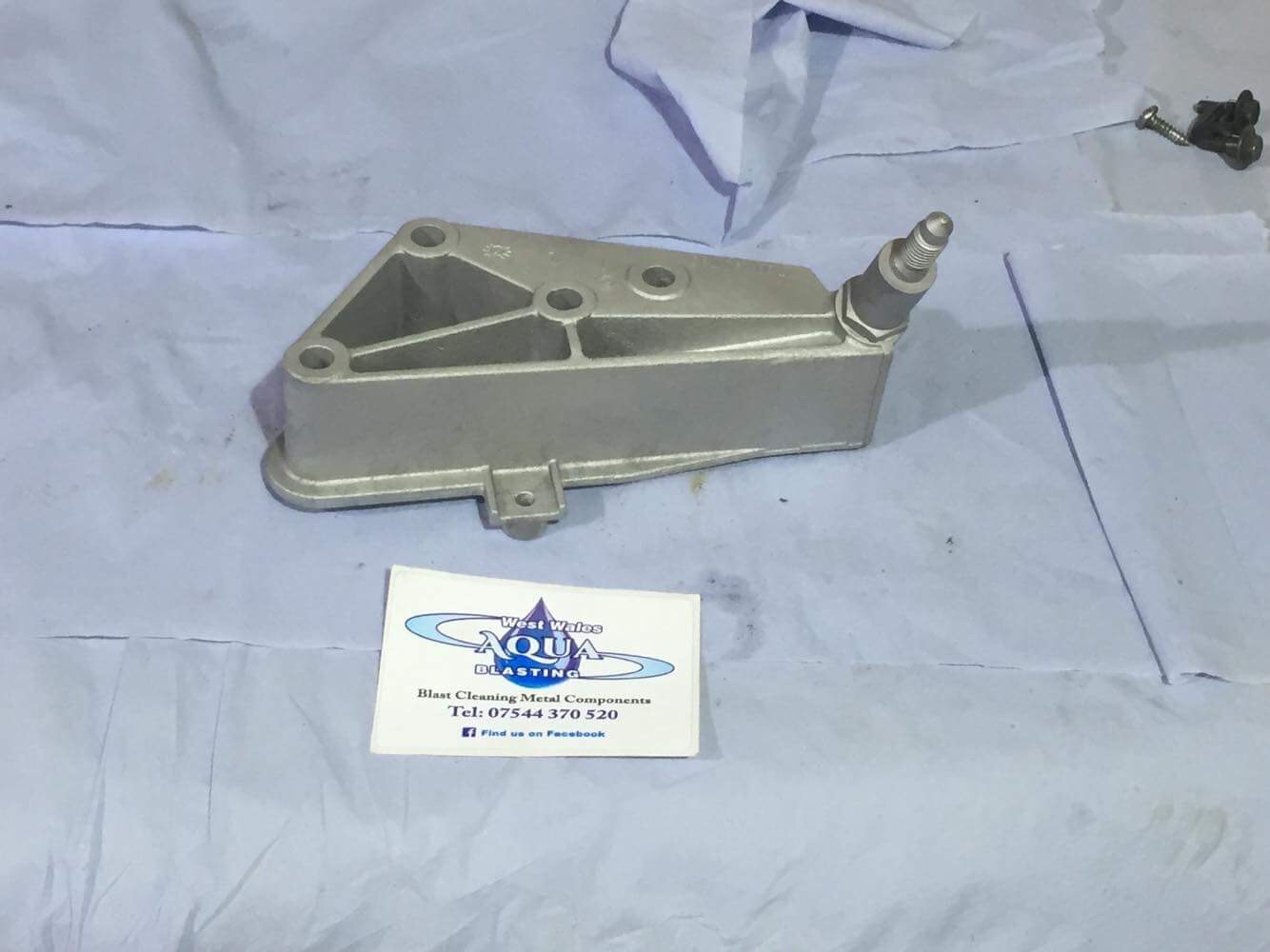

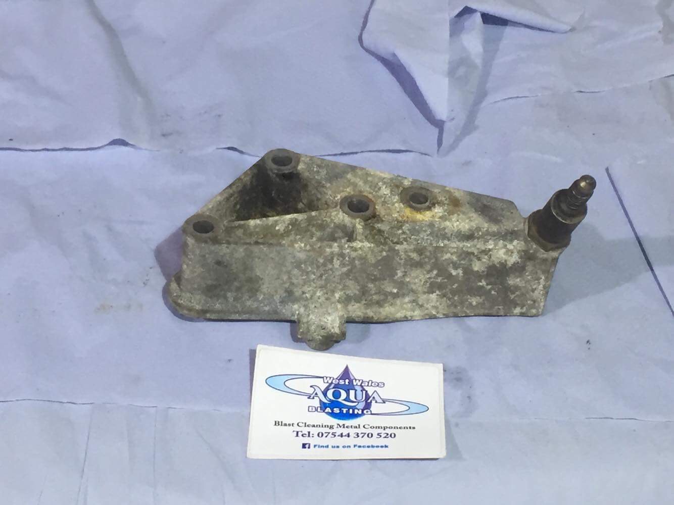

Alli bits all looking very crusty!

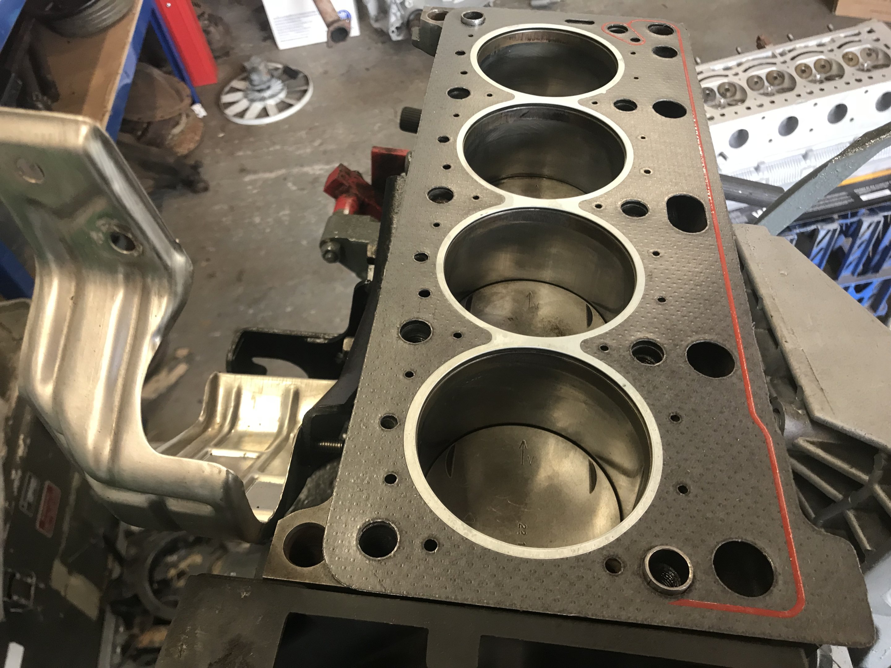

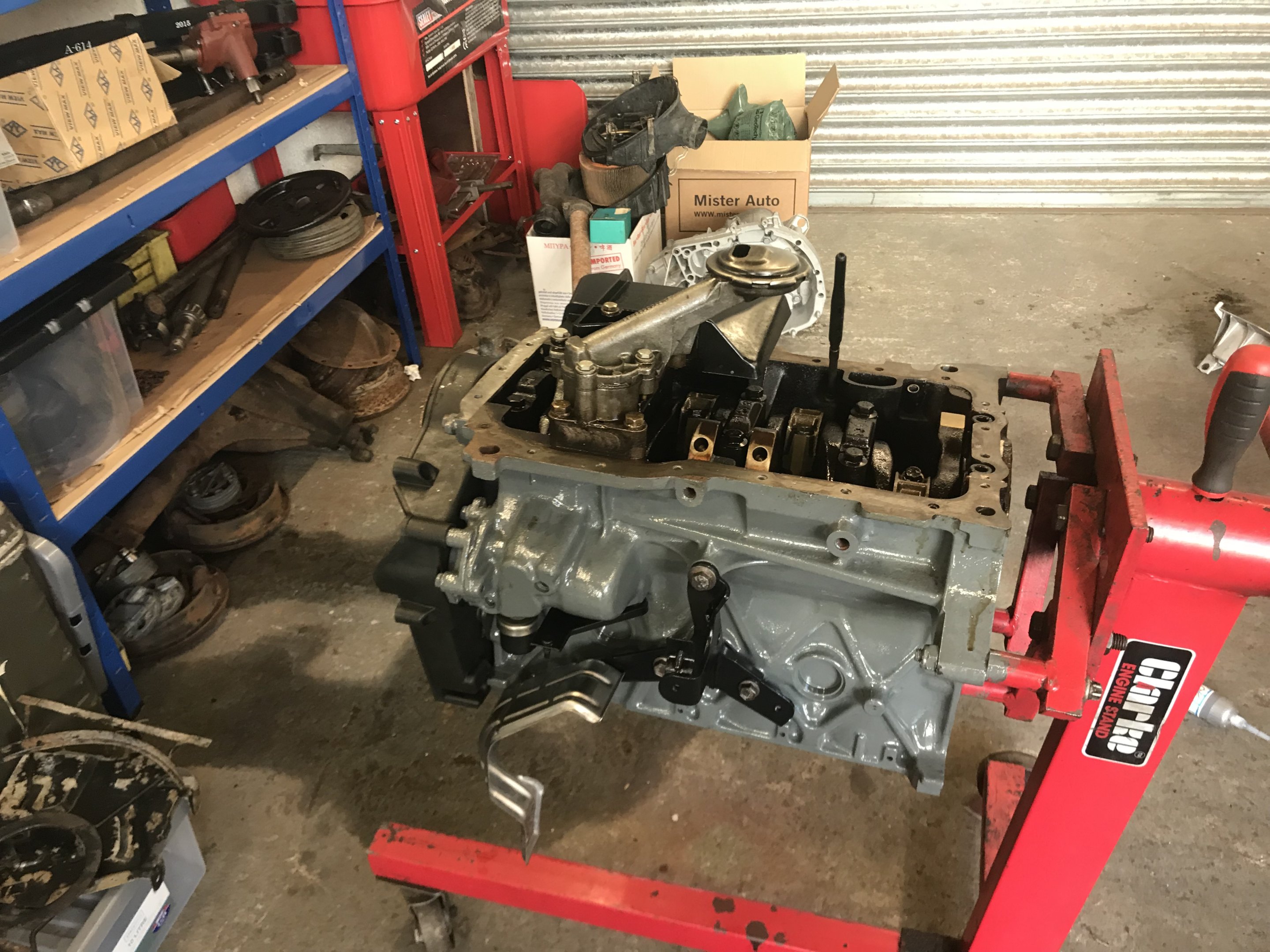

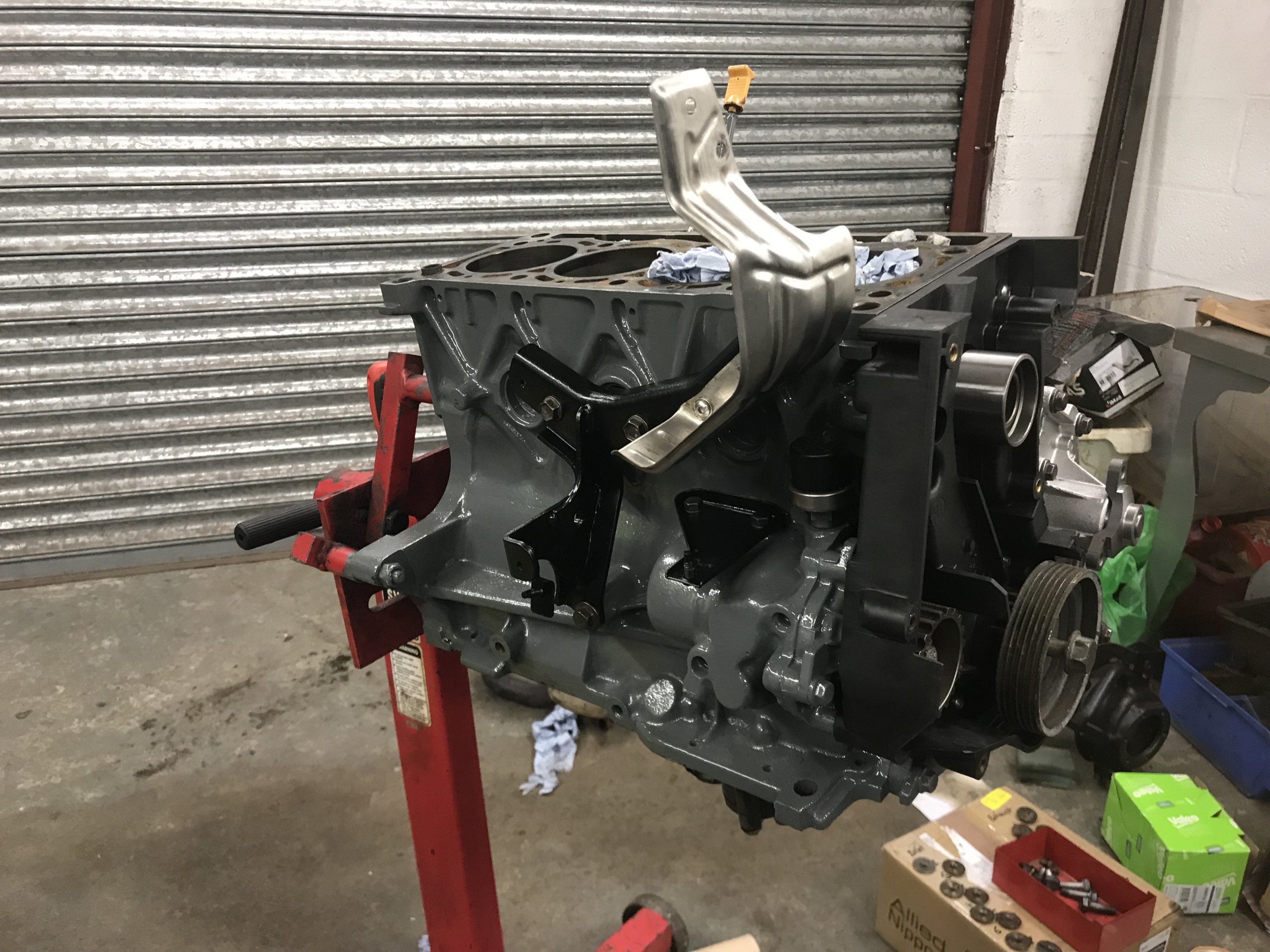

Whilst the bits were being blasted got to work on the bottom end, checked all bearings, clearances etc and all looking spot on, gave the block a coat of my favourite grey paint.

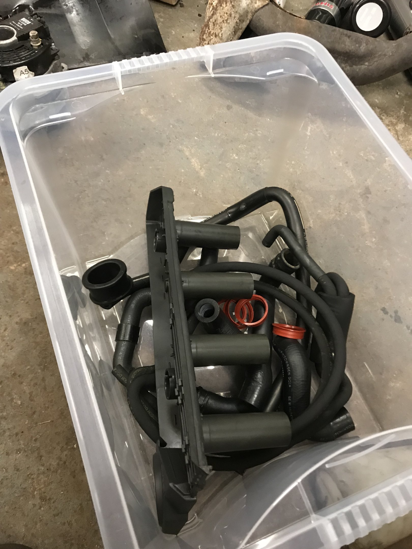

cleaned up all the hoses etc

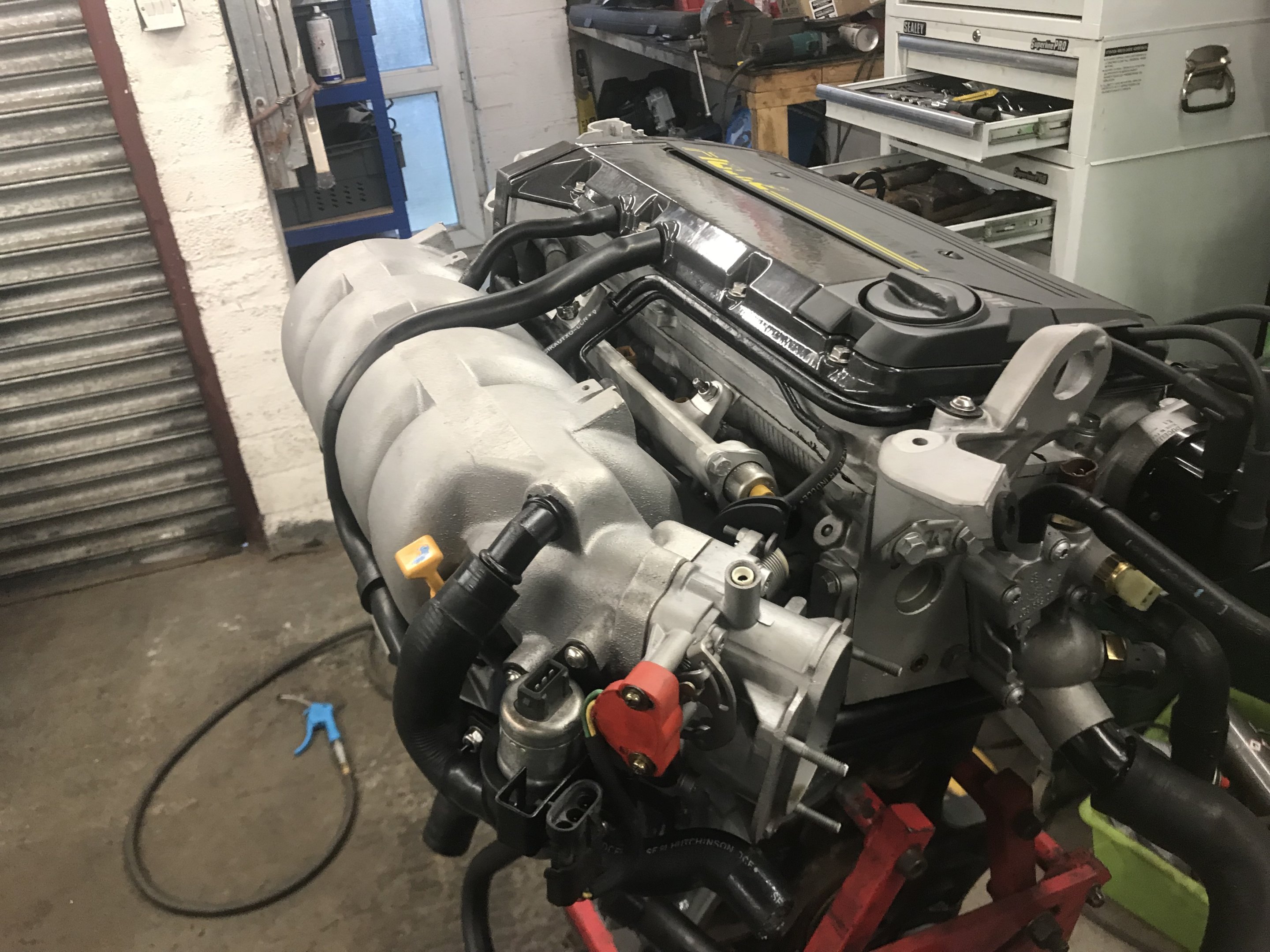

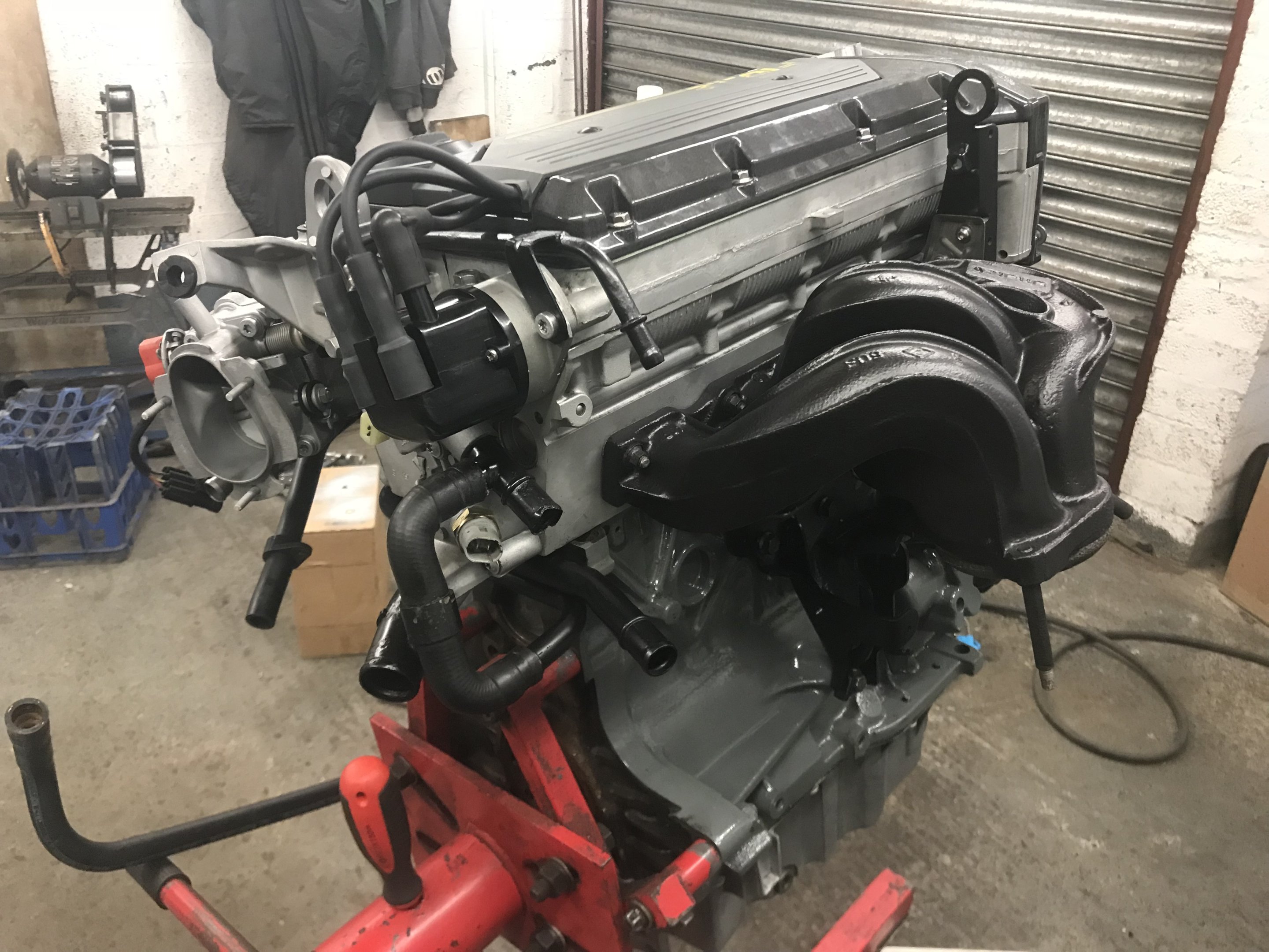

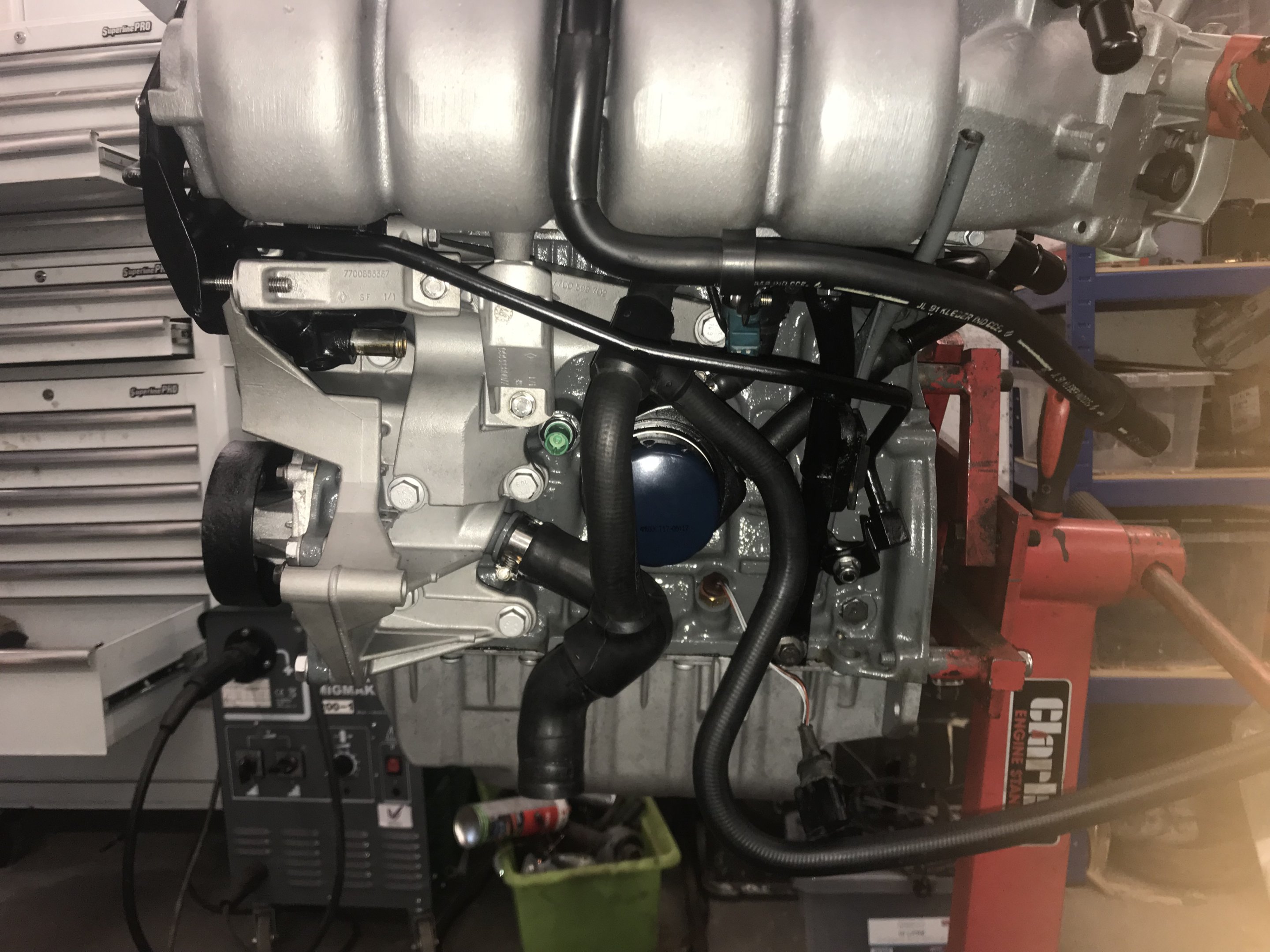

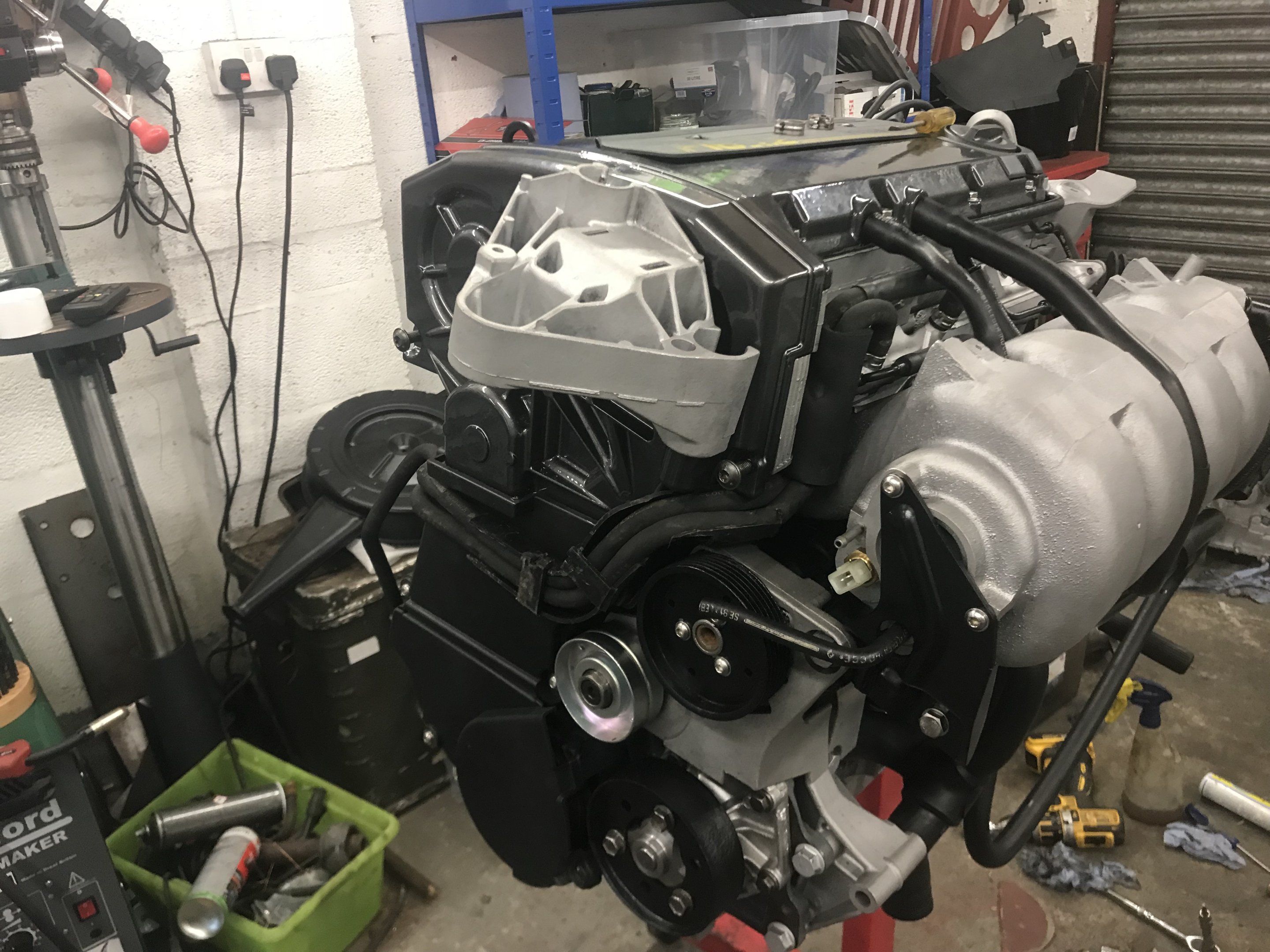

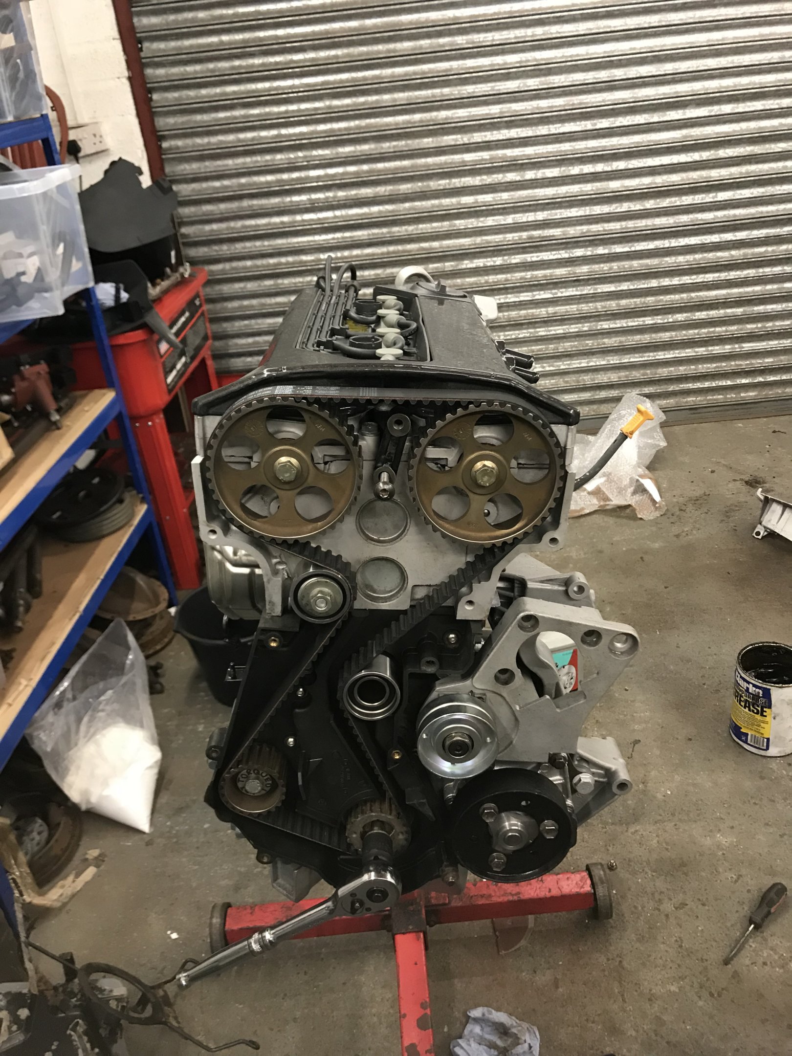

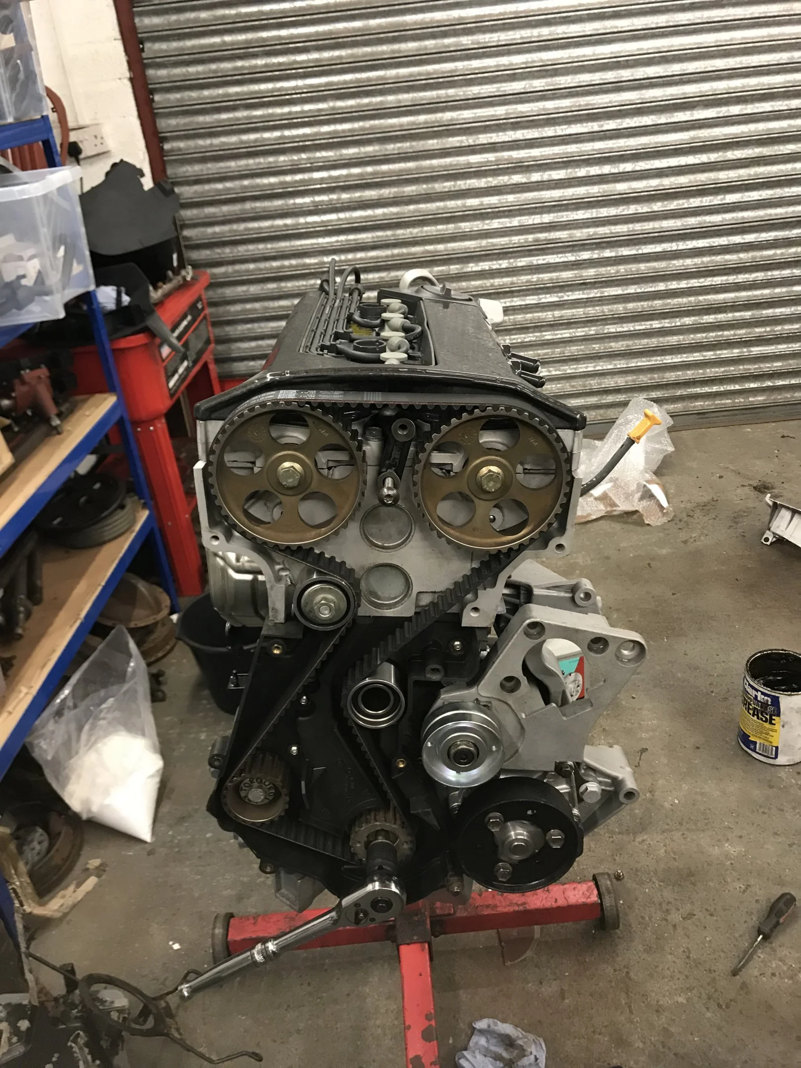

And finally to get the thread up to date have spent th last week getting the engine back together

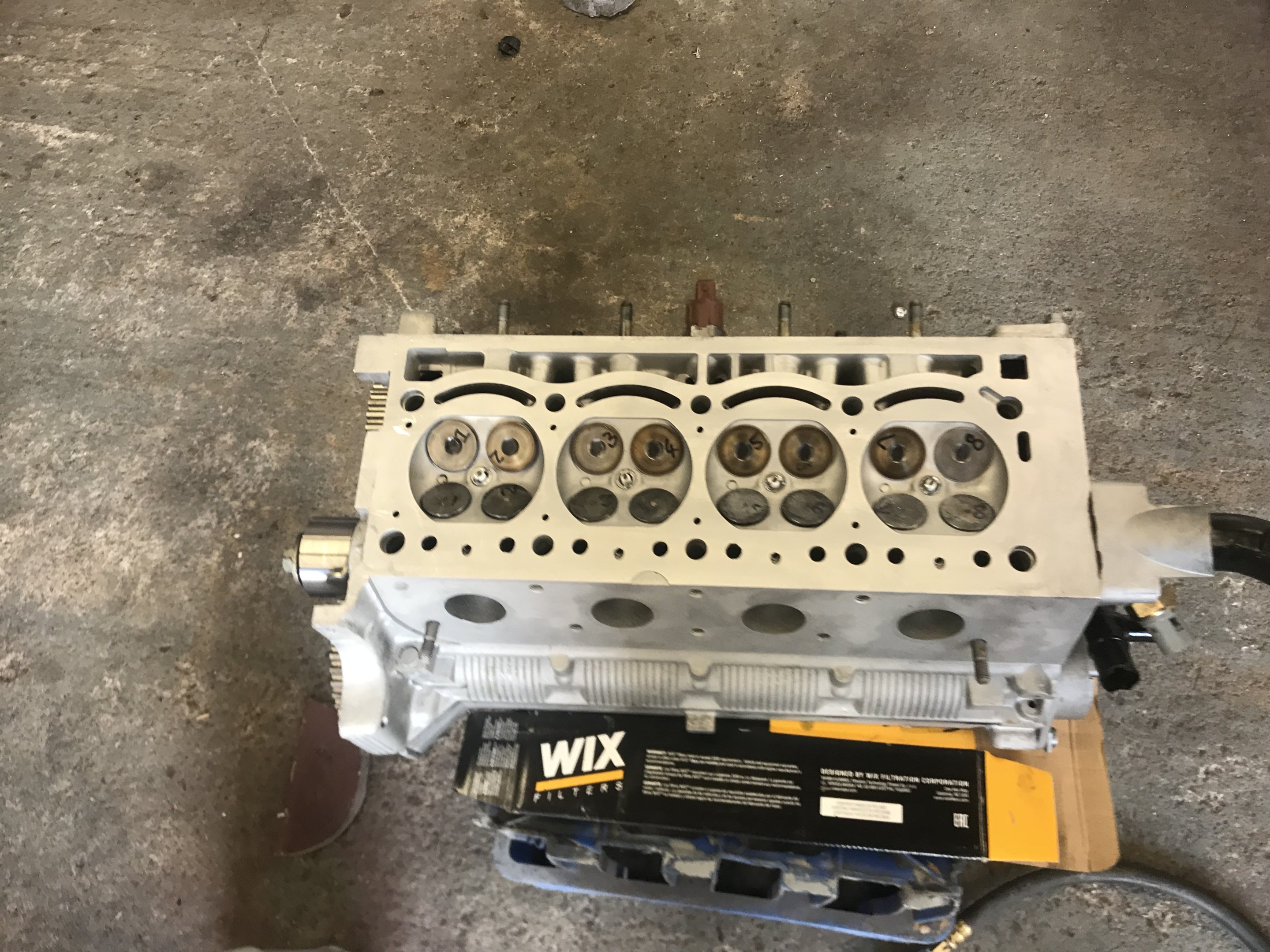

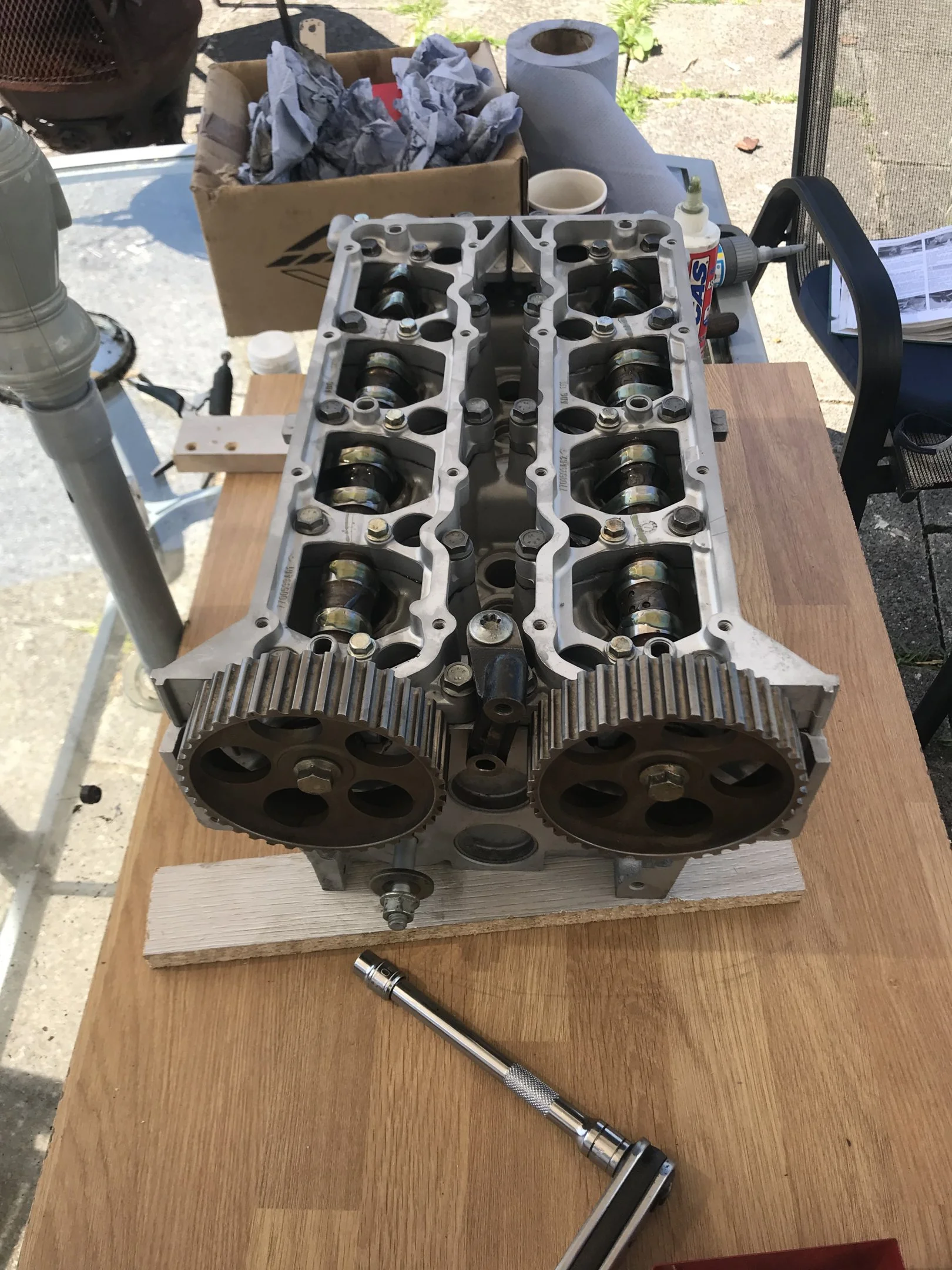

vlaves lapped in and head rebuilt
new gaskets. seals etc
