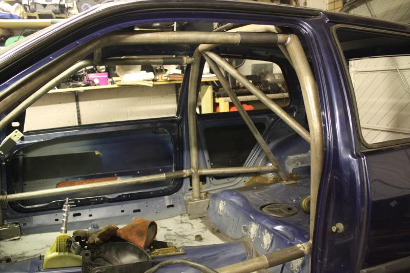

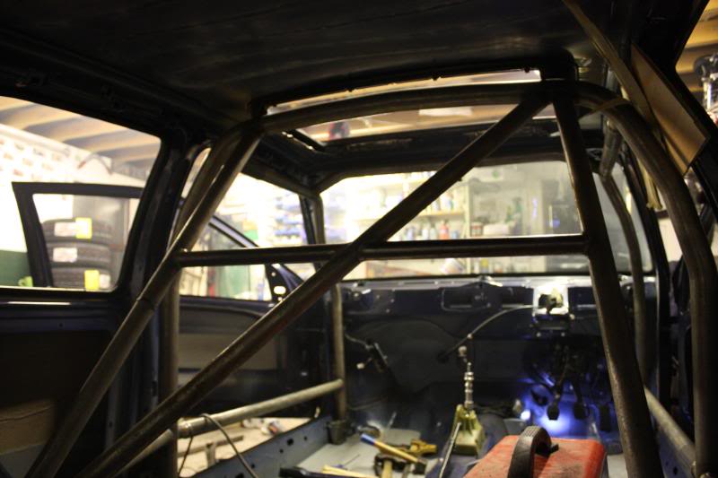

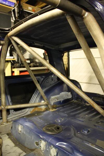

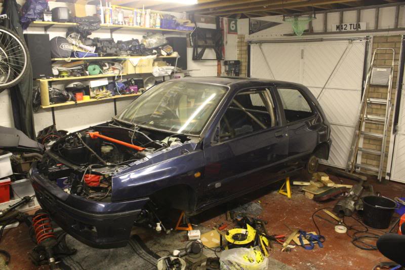

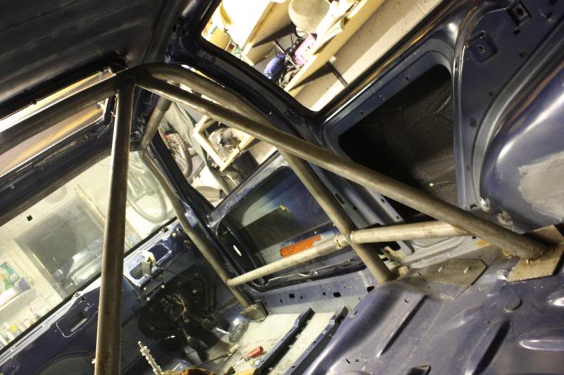

Bit of an update. Cage arrived earlier this week having taken SEVEN weeks to come from OMP through YB Racing. I'd avoid YB for anyone looking at cages, spend a little more and by from somewhere that has a phone number, comms were CRAP.

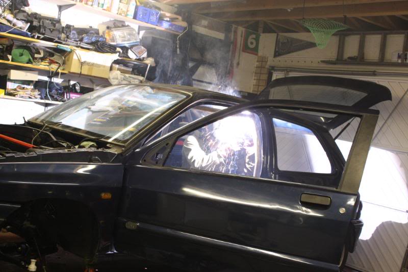

Anyway, plan was to get it welded in tonight, hasn't happened in full. We've got part way there but have come across a fair few problems over the evening. Quality of the cage is very average and I'm pretty disappointed for £400 tbh. I'll not go into fine details but here are a few pics of the nights progress.
OMP's finest: :rolleyes:

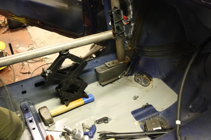

A use for a renault jack? Yep, footplates didnt fit without mass butchering.

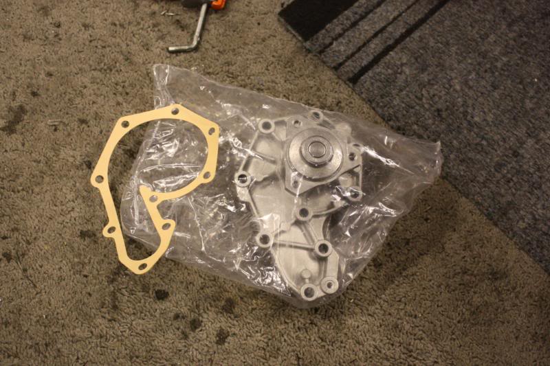

Picked up a new waterpump too
On the plus side though, it looks feckin cool and will no doubt do a good job should I feel the need to roll it.
Thanks again Daz for skills and patience.
(A slightly disheartened) Chris :(

Cage looks seriously cool dude :D
I agree :cool:

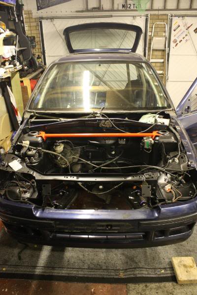

Nice update....thats quite a way out up front :(
Yep, not very good considering what it costs. Will get there though.

Quite a way out, is a nice way of putting it! :banghead:

Love the cage! looks lethal, hope you get it fitted alright
  E92 M3 Monte Carlo
Re: Valver Track Car Project Thread
i've got the same cage mate and i know there not brilliant but the likes of safety devices are £1200 so 3 times the price

Tell me your not bolting the cage in? I don't get the point of that. Weld the fcuker down and be done with it.
Cage itself looks alreet mate, just the box mounts are a bit :S
  BMW M5 & E36
There are holes and captive nuts in the cage and footplates, so I may aswell add them and weld it aswell rather than leave a load of open holes.

Seems alot of cage for the money tbh.
You'd only get a show cage in a 1*2 for that. Look's impressive though :)

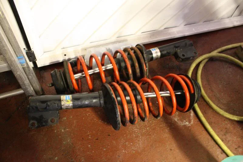

Had a fair few more parts delivered to work in the past week, they love me.
Bilstein front dampers and lower springs, Williams fitment.

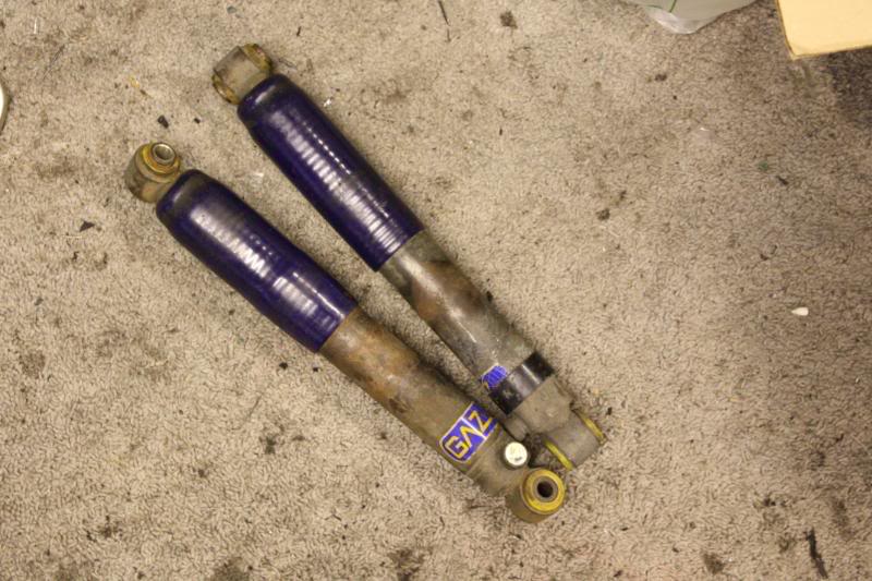

GAZ adjustable rear dampers

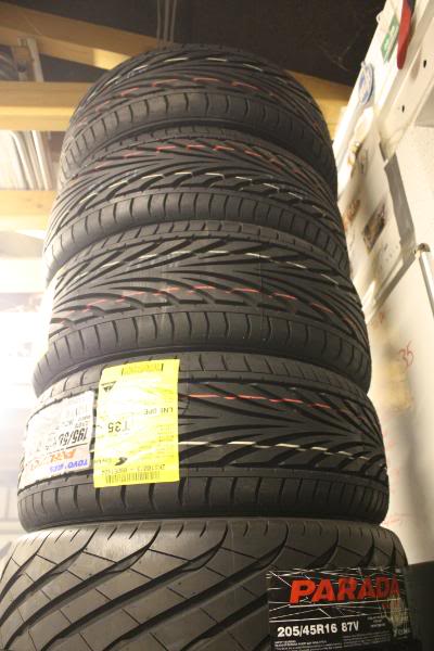

4 Toyo T1r's to go on the Williams wheels when I finish refurbing them

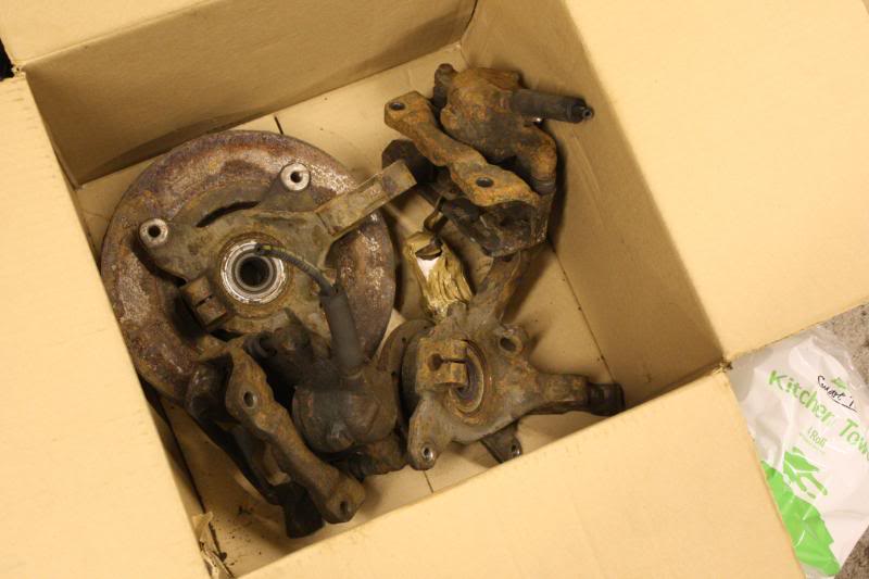

A pair of 172 front hubs and calipers. I need to get the hubs modified to accept Williams shocks before they can go on the car, and clean it all up too

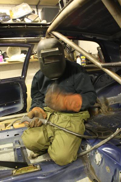

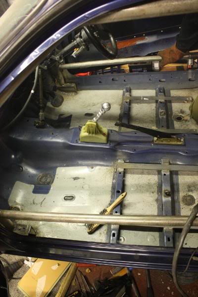

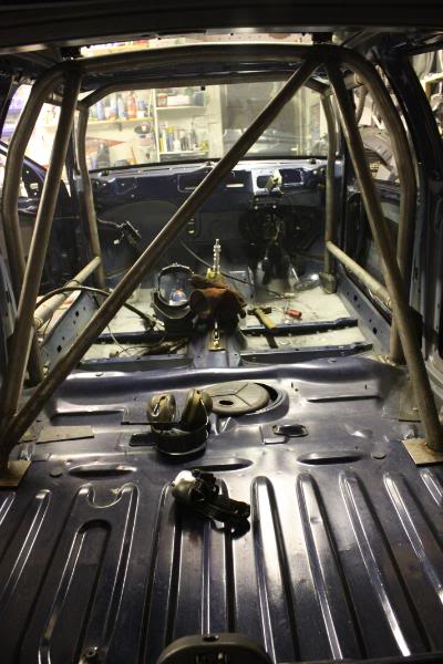

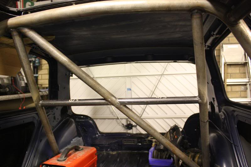

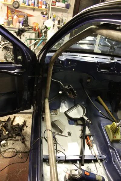

Anyway, we carried on with the cage for a 2nd night and things went alot better. I'd made up a harness bar to sit in the rear section of the cage so that was welded in
The rest of the cage was then welded with minimal fuss, bar the underseal setting alight at any opportunity. Bit of a pain but can be re-sealed easily. Welds need a little fettling to look prettier but it's all in and bloody solid.

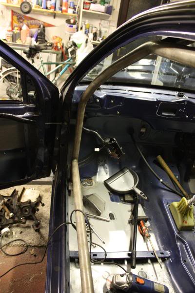

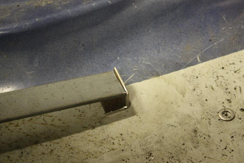

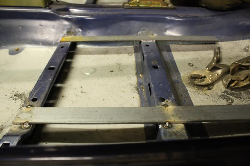

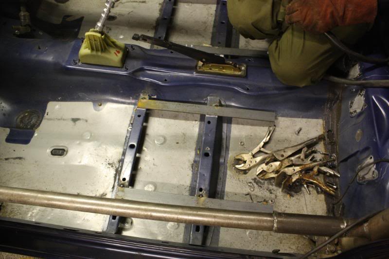

Started on the seat mounts next. I'd decided how I was going to do this a long while back but wanted to leave it until the cage was in to make sure nothing interfered. Got some 40x4mm steel off a fabby mate of mine which he cut to length. Marked everything up, checked straightness, double checked, and tacked in.
Welder man

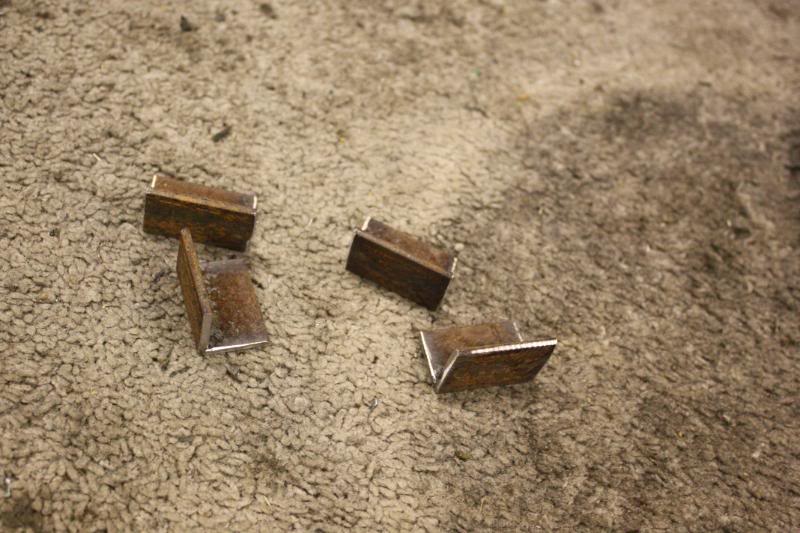

Cut some angle to size which were to be welded to the floor to brace the rear overhanging part of the seat rails. Absolutely solid with these in.

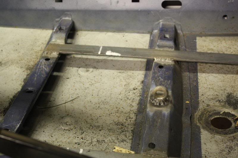

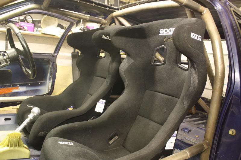

Welded the seats fully and also the centre crutch strap eye bolt. I was going to have 2 eye bolts with them being 6 point harnesses, but there was an ideal looking hole already there in the original seat mounts so we used that instead, perfectly in the middle.

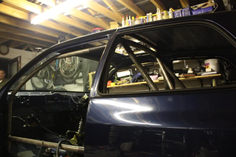

And finally the usual 'current status' shot.

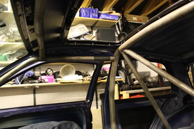

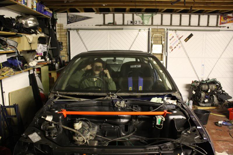

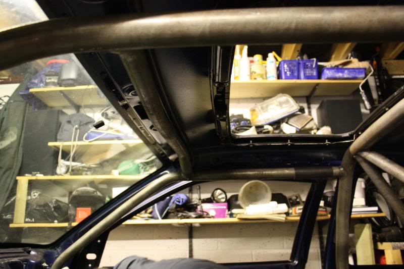

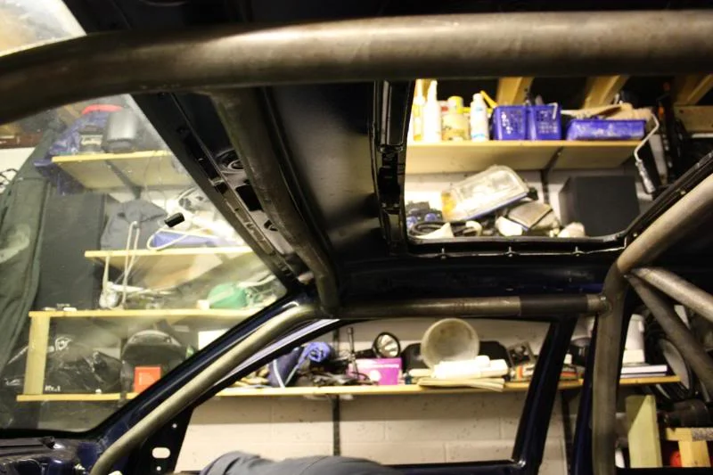

looks cool, but don't know if its just me, but the cage looks low at the front and over the head?
  BMW M5 & E36
Looking good mate, good to meet you at the RR day too.
Chris.
Cheers bud, you too.
It's sat right up against the shell at the front of the roof so its about as high as it can go. It'd be nice if it hugged the A-pillars and roof a little better but I think it's pretty well in as it is :)

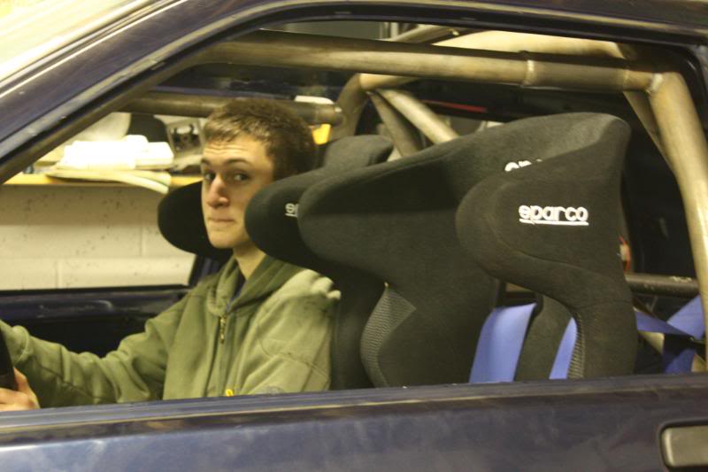

just double check (bit late now) the cage in pinky was high up and i still smacked my head off it all the time (with helmet on)
  BMW M5 & E36

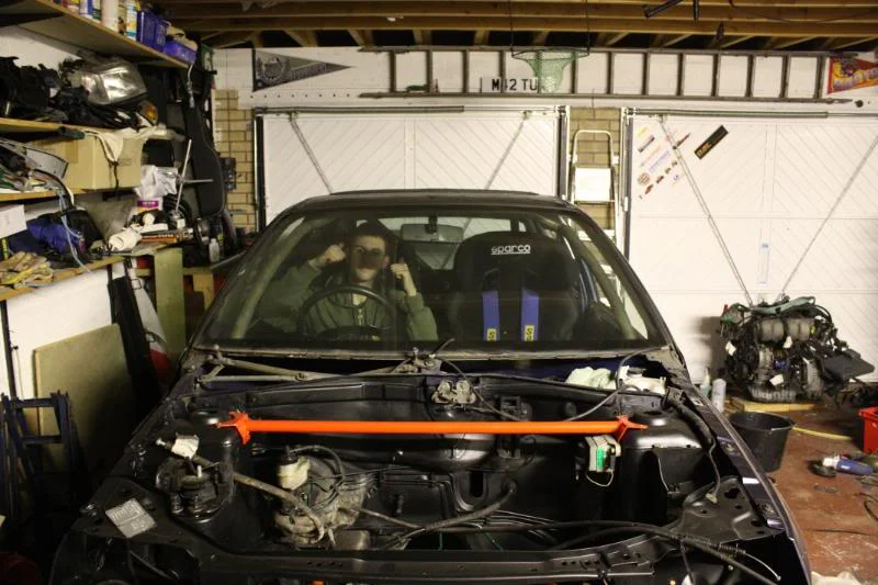

Yeah I've had the seats all mounted and sat in and it is a bit tight. Seats can go down and inwards slightly if needs be too. Cage padding sorted as well.
