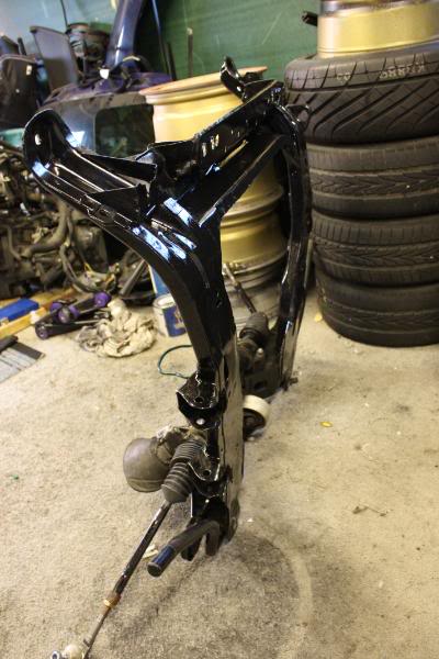

I haven't got time to scrawl through mate, have you refurbed your subframe?
  BMW M5 & E36
Re: Valver Track Car Project Thread
Refurbed.... brushed on hammerite smooth! Much better than before though. P10 mate
Bluebeard
  Whichever has fuel
You're a legend mate.
Did you just use that Muc-off stuff? I've been using the strongest degreaser I can get my hands on and its rubbish. Spent about 2 hours on it today and it still looks shite!
  BMW M5 & E36
Mainly that pink muck off stuff yep, as it was all I had at the time. That got the majority of it off, pressure washer finished the job. Left to dry, Hammerite 'Kurust' on the rusty bits, left to work, paint.

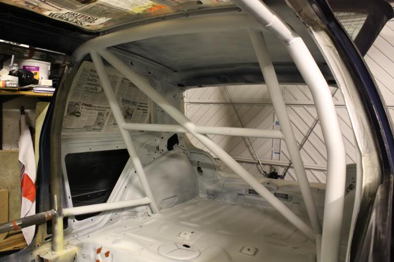

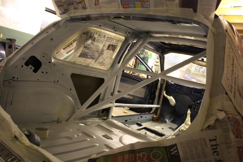

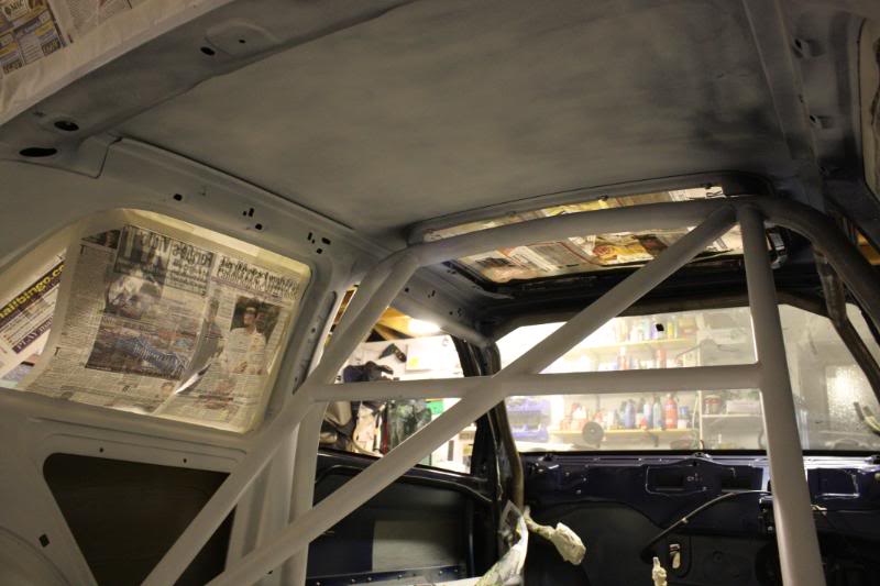

Long overdue update time. Not as detailed as some have been but it's better than nothing.

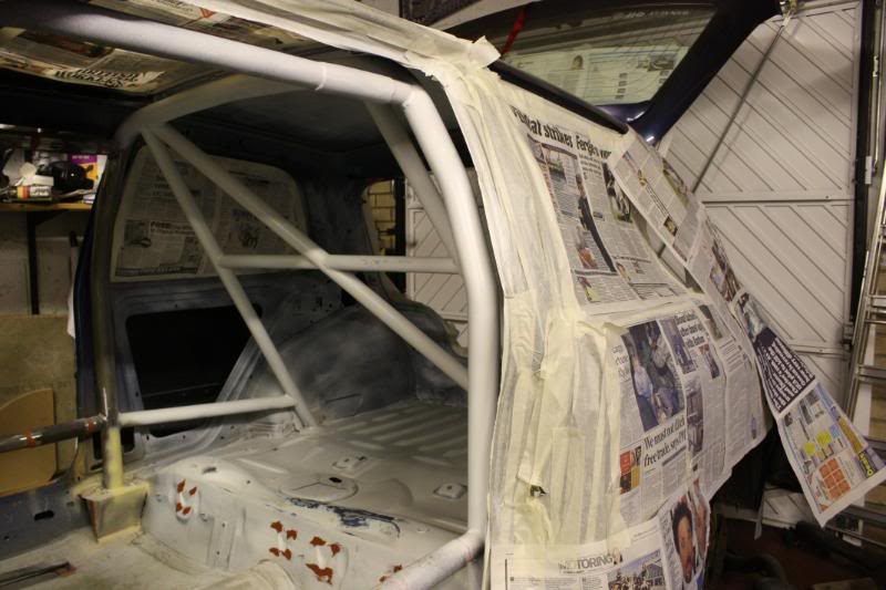

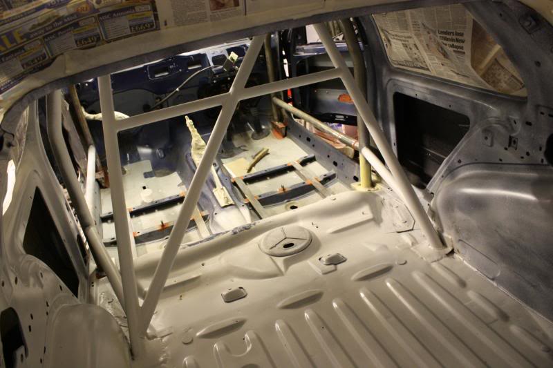

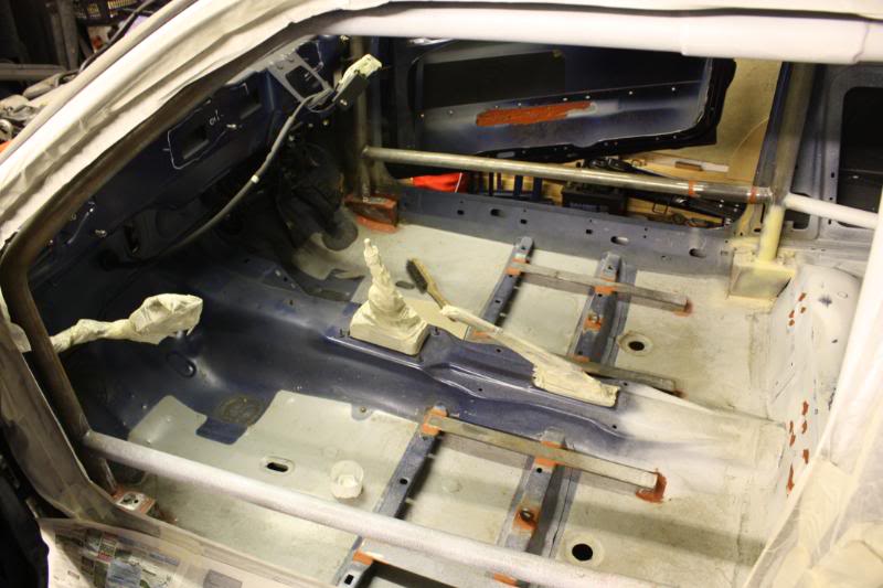

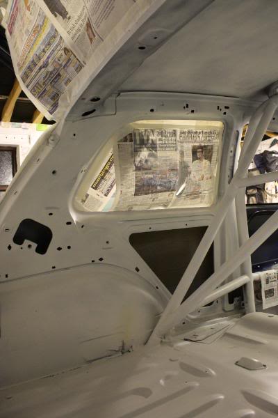

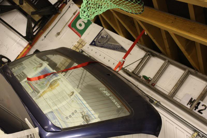

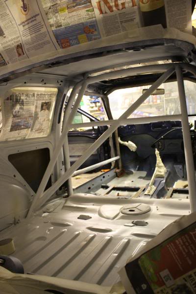

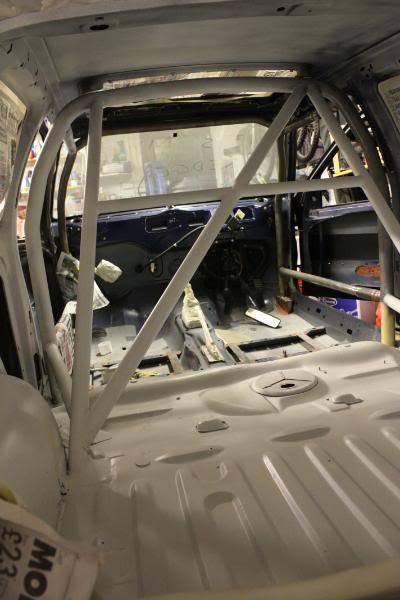

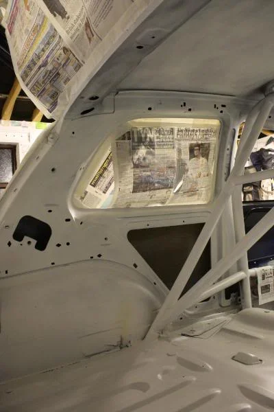

As you now know, the cage is fully welded in and ive had the seats mounted. This means that I can about finish the interior off. Having removed various bits of sound deadening it left the interior a bit multi coloured so I decided I wanted to paint the inside. I was torn between black and white for a short while, both satin. I decided on the white as it'll brighten things up abit. Might turn out to be a pain keeping clean but we'll see!
Masked some of the car off and gave the rear half a few quick coats. I'm only using normal satin white rattle cans here, so it's taking a good few coats to hide the dark blue underneath.

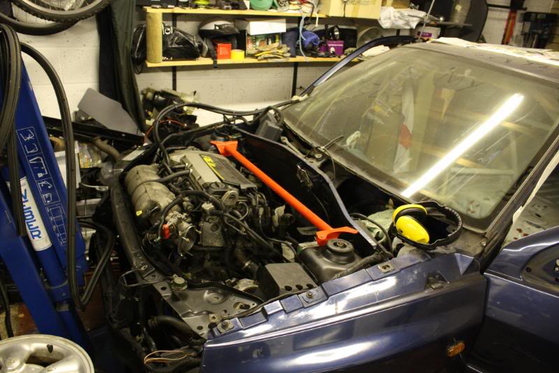

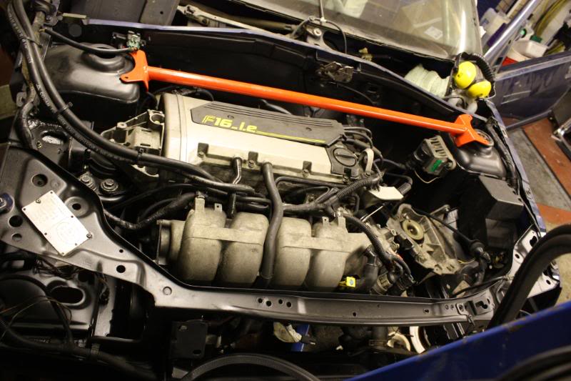

Last friday I dropped the engine back in after work. Before it went in I changed the waterpump, fitted a replacement cambelt cover which I managed to source, torqued the bottom crank pulley back up and fitted the alternator belt. No action shots of anything, just it sat back in.
It went back in nice and easily. Nothing is plumbed back up as yet.

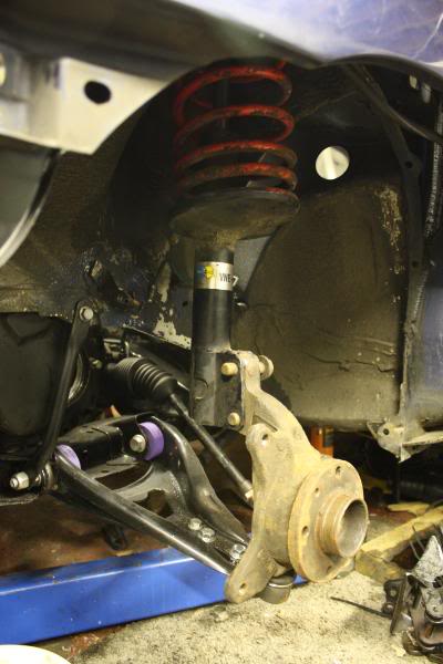

Ive modified my 172 front hubs to suit the Williams fitment Bilstein dampers, so test fitted that on one side.

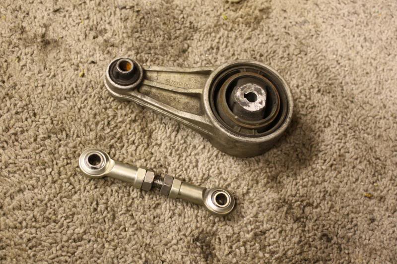

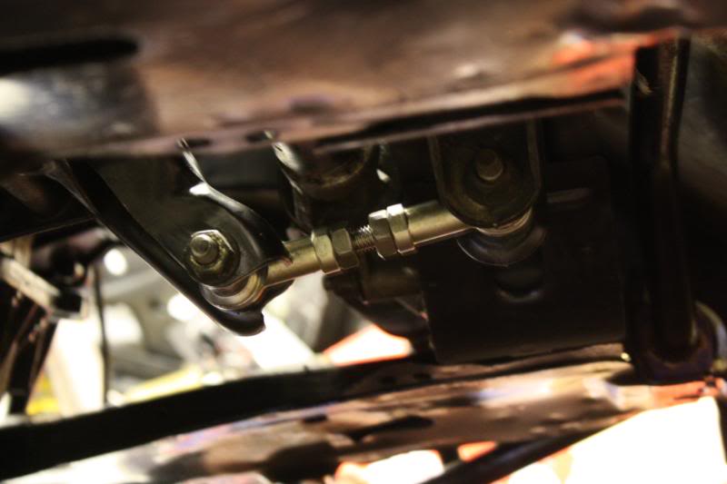

Next I removed the standard rear dogbone/gearbox mount and made my solid mount upto the same length
And fitted that with relevant nuts to space it to a similar position to the standard item

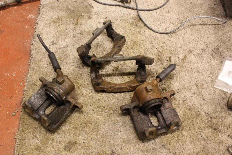

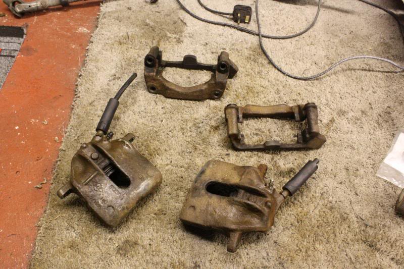

Made a start on cleaning up my 172 front brake calipers. Wire brush treatment then a clean off with degreaser

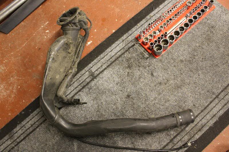

1.2 fuel filler pipe courtesy of Foxy. This does away with the small aux fuel tank and now fills directly into the main tank. Help with weight balance a bit and eliminate any low fuel issues.
Masked a bit more of the car up
And gave the rear another few light-ish coats
Getting there :)

Should be fairly. I've used satin white though so it's not going to be shiny and reflect.

coming on good mate. How come you're only spraying the rear for the moment? Try vinegar on the calipers if you want to clean any more crap off them ;)

where did you get the solid dog mount from fella? :)
It's known as a 'Coops' solid dogbone. There is a guy called 'Coops' on all 3 clio forums (CS, williamsclio, clio16valver) iirc who will supply you one
I'll be spraying all of it, just easier to concrentrate on one part at a time than spreading out across the car and preventing me doing other bits. I need to drill the seat rails for sidemounts yet, and attach 4 more harness eye bolts before the front will get painted.
