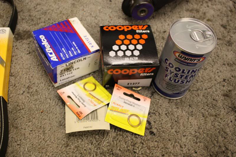

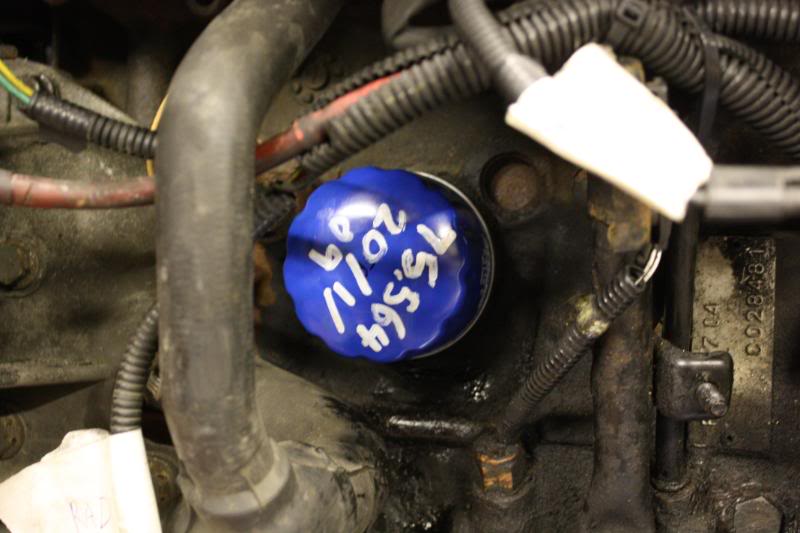

Picked a few bits up on the way back from work today. 2 oil filters and sump plug washers, one for the Valver and one for my 182 which is due a change shortly too. We roughly measured the length of the alternator belt I needed on Saturday so I got one as close to that as possible, turns out it was too long though so I'll try and swap for the next size down tomorrow. Also got a can of cooling system flush for when its up and running, here's hoping!

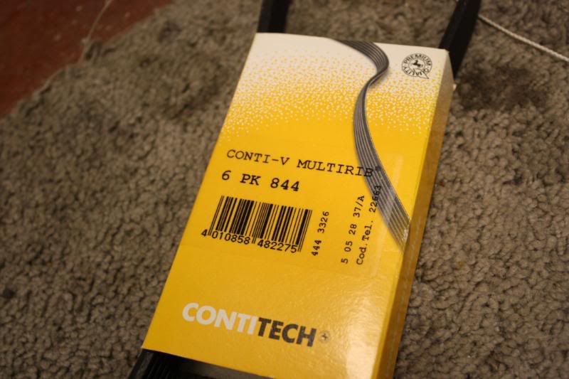

844 belt too long
Filter on, yes I know I got the date wrong!

whats wrong with water for flushing the coolant system! you posh b*****d!
  ValverInBits
Re: Valver Track Car Project Thread
When I had the thermostat housing off it was horrid, and I have a nice new clear header tank to go on so I want it clean lol.

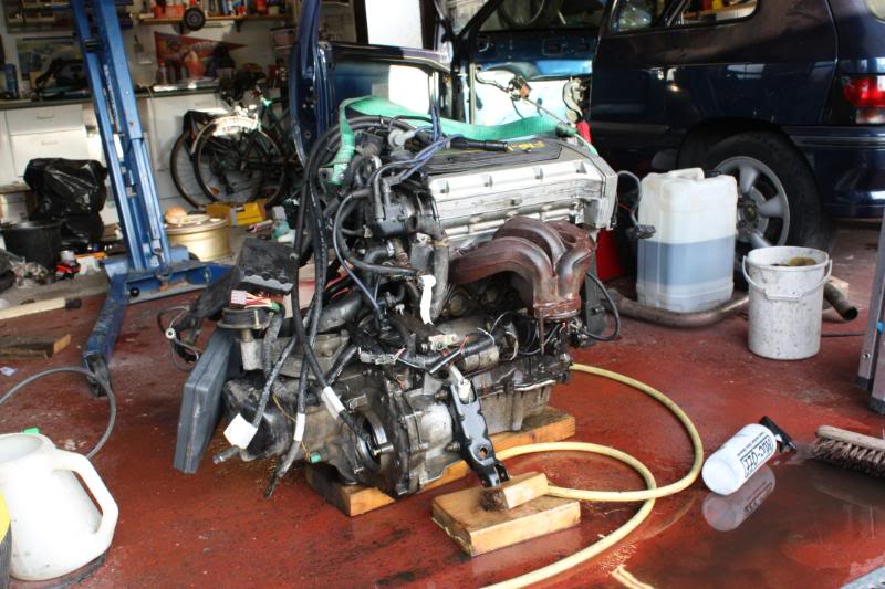

Wasn't sure if that valver engine has ever had antifreeze in it, there's a lot of brown sludge in that head!

836mm Alternator belt is PERFECT! Big enough to be able to get it on but small enough to get it tight with the limited amount of adjustment I have on the alternator mount. Thats one small step closer to the engine being back in and running!

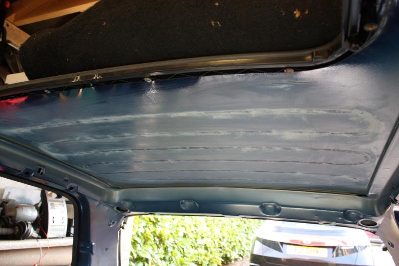

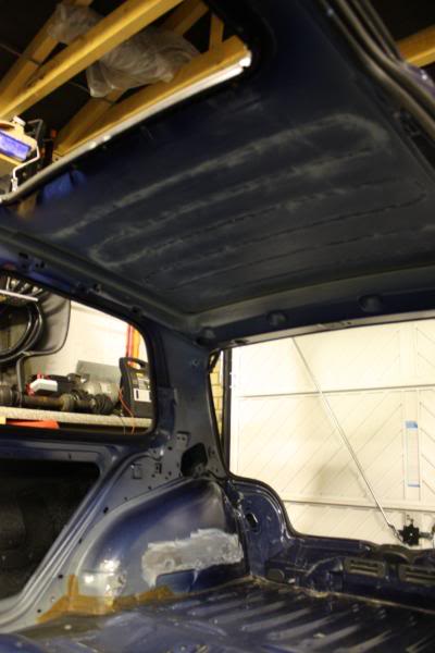

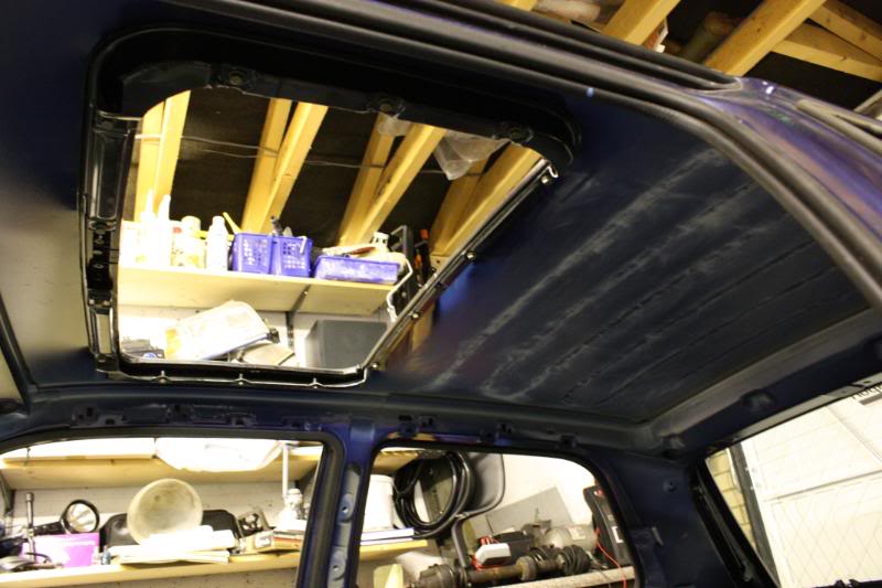

Anyway, got a little bit done elsewhere. Anyone that's had the misfortune of having to remove Mk1 headlining adhesive will understand what a pain this stuff is. For the rest of you, it's a royal pain the arse! Took much longer than it looks as though it should have.

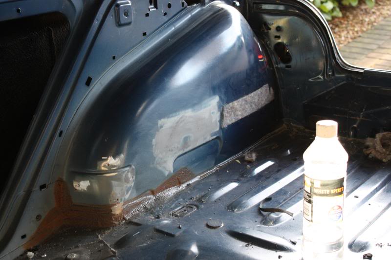

Fluff on the inner arches, a pain again. I may have used the grinder a little bit :eek:

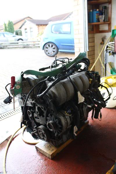

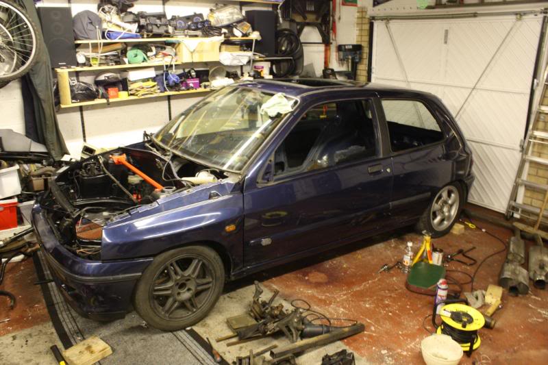

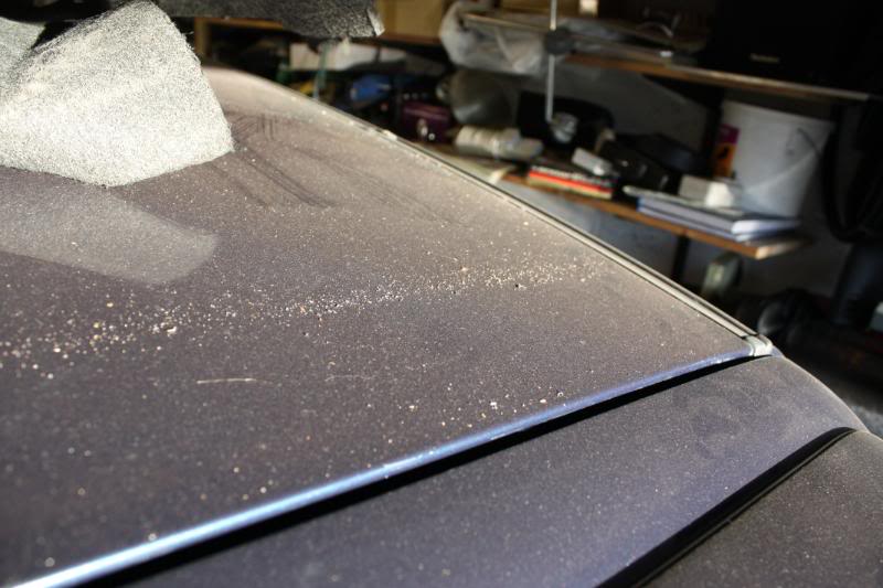

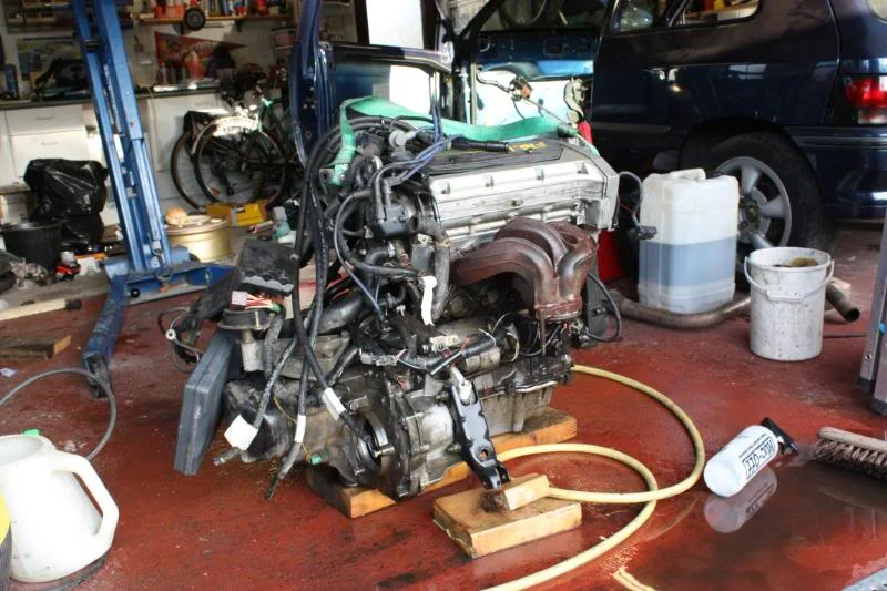

Made an attempt at degreasing the engine. 1 750ml bottle later and it doesnt look a great deal better, really is caked on.
Gathered a bit of dust over the weeks. It got the dustpan and brush treatment after this pic

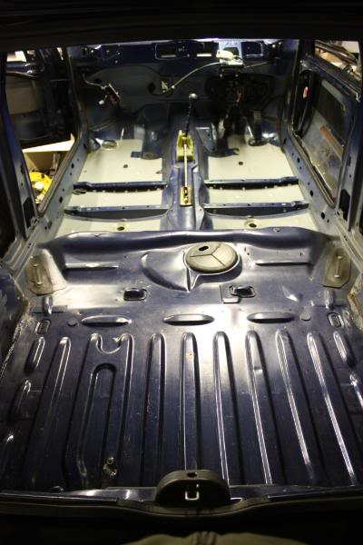

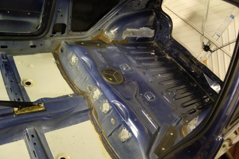

Finally got round to removing the tar and sticky from the drivers side floor, looks much better and closer to being ready to accepting the cage, if it ever comes. Cleared all the rest of the junk out and removed any remaining clips and bits
Also removed the spare wheel cage which Ive been meaning to do for a while.

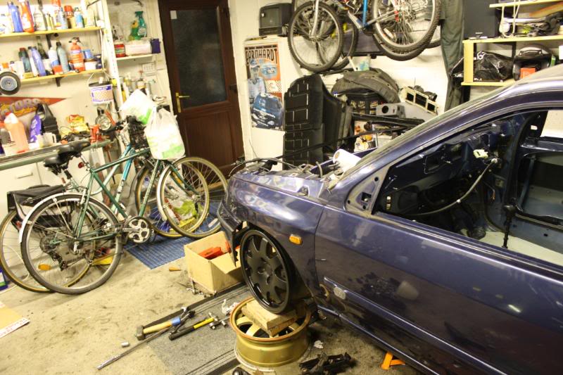

Made a bit more progress last night, coming along well now.
Random picture confirming black Willy wheels and 449 work, IMO of course.

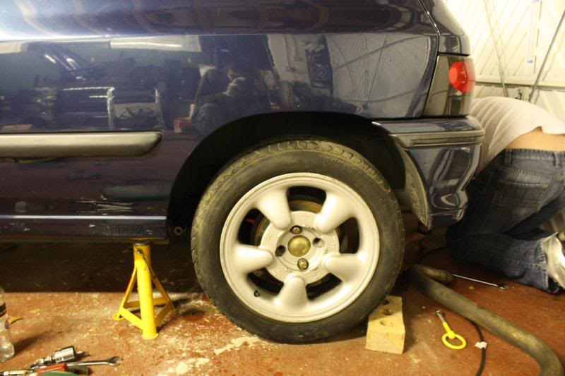

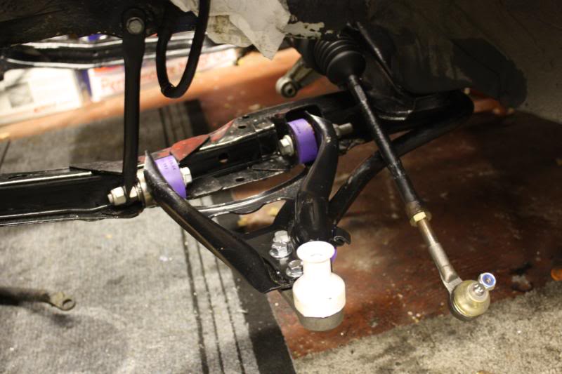

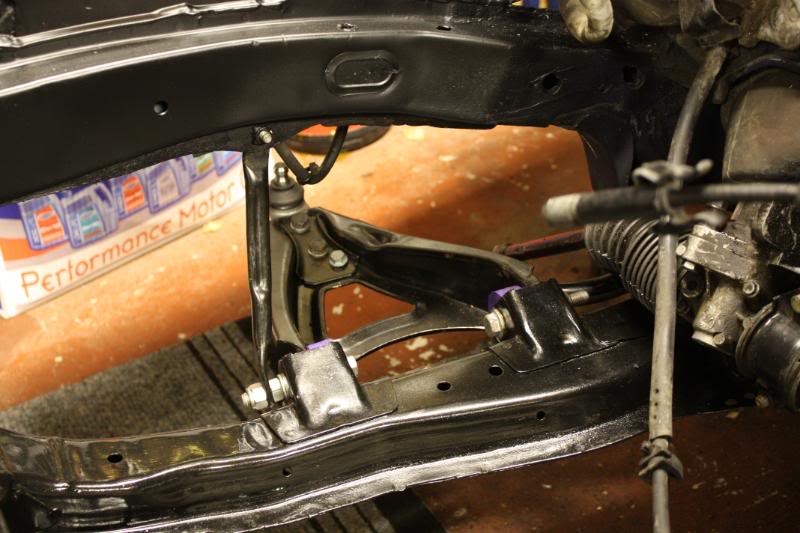

Got some new Wishbone bolts from Renault and new nuts from work and got those bolted on. Cleaned up the support arm thing (proper name is?) to match my clean subframe too. Also got ARB mounted with Powerflex poly bushes and new clips/bolts/nuts all round again.

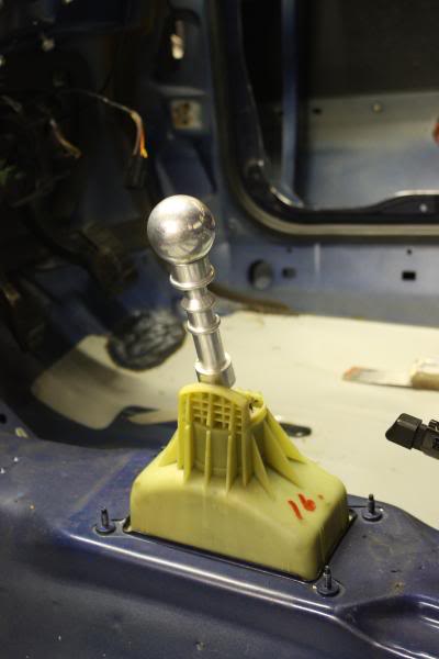

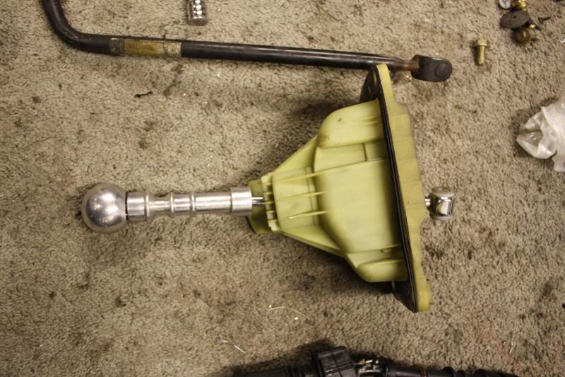

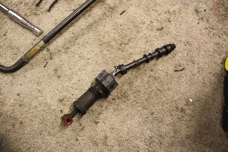

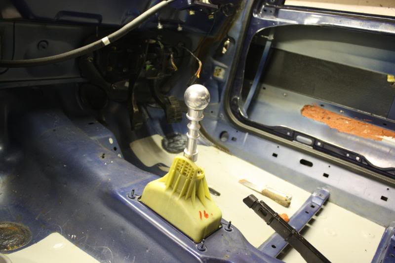

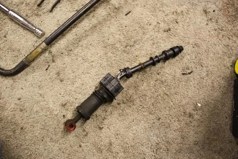

Set about fitting my shortshifter, so gear selector rod off and old gearstick out of the surround first of all.
New stick fitted into the surround. I'm not using the shorter gearbox linkage at the moment, so I'll be running at the sort of in-between stage of the short shift.
And fitted

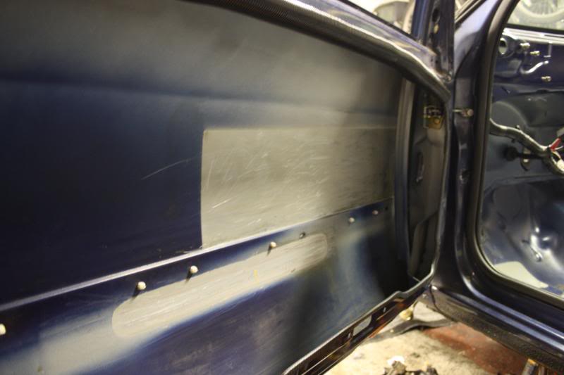

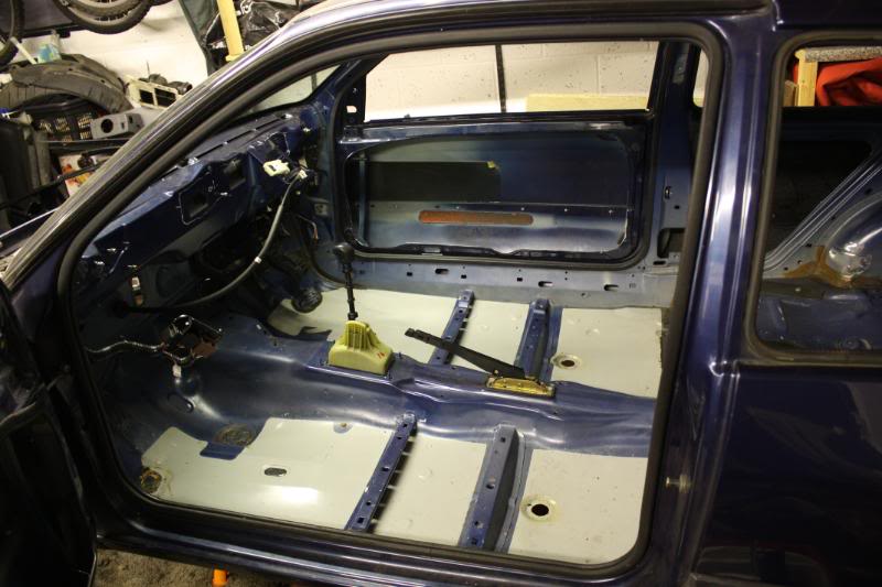

Door cleaned out of sticky/tar glue

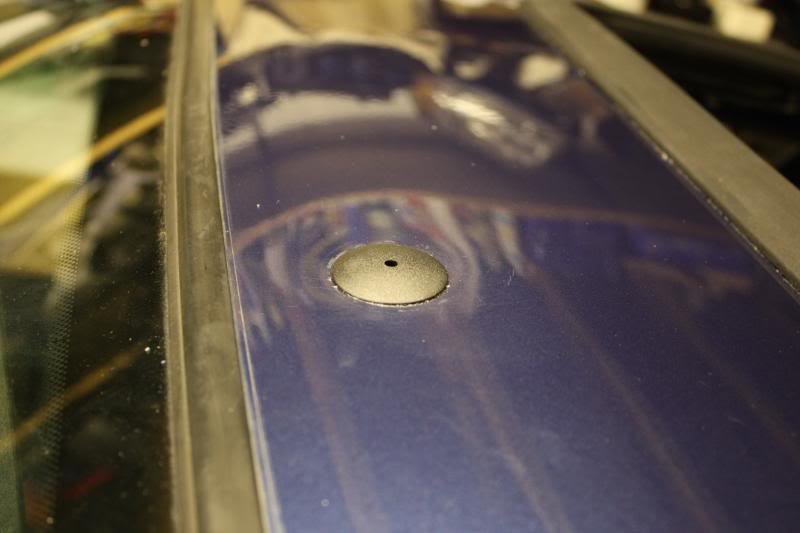

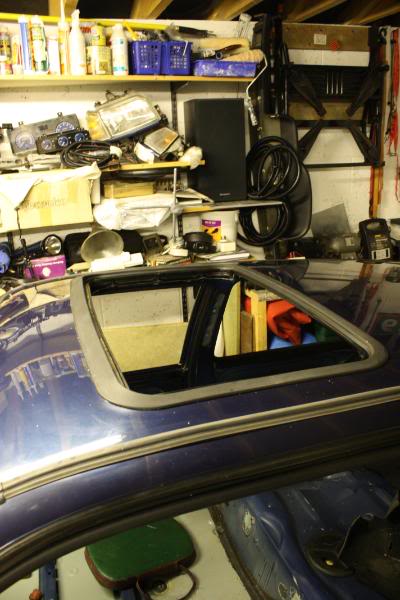

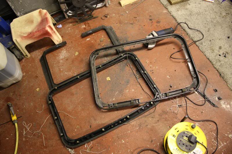

Sunroof surround modified/lightened a bit, from 4kg down to just over 2 (standard with glass and electric mech is 10kg). I'm now going to be running this altered surround with a sheet of polycarbonate in place of the glass rather than the original plating idea. It looks neater for starters, and the sunroof frame keeps a lot of strength in the roof so it'll hopefully stop it flapping in the wind so much.

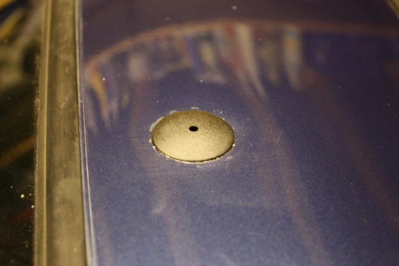

Bunged the aerial hole with a new arch liner clip

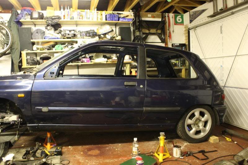

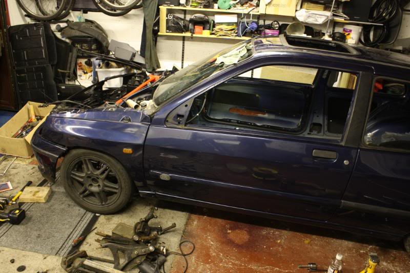

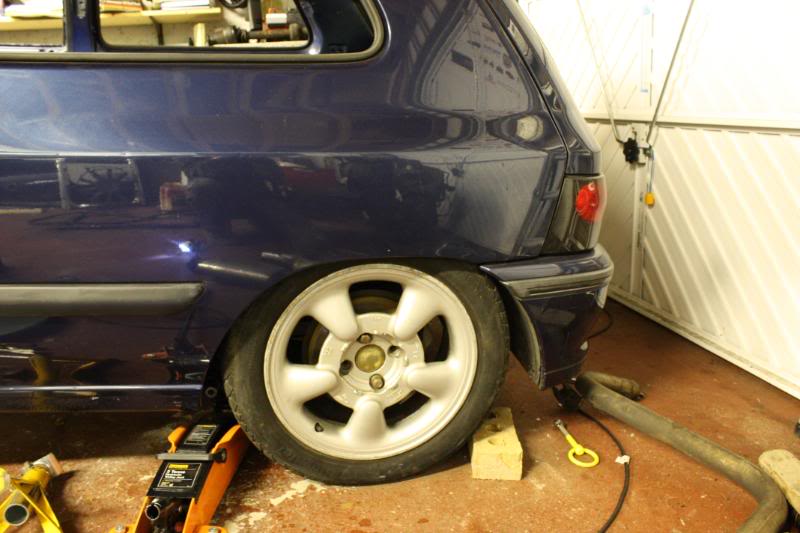

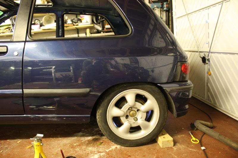

Having taken all the weight out of the car now, it was sitting incredibly high so we lowered the torsion bar on the back next. How it was before!
Bars out and guessing at the height, perhaps a bit too low?!
Decided on this, nice compromise
Which made the front end point right up
Front end lowered on the jack and a wheel placed roughly in place, looking better!

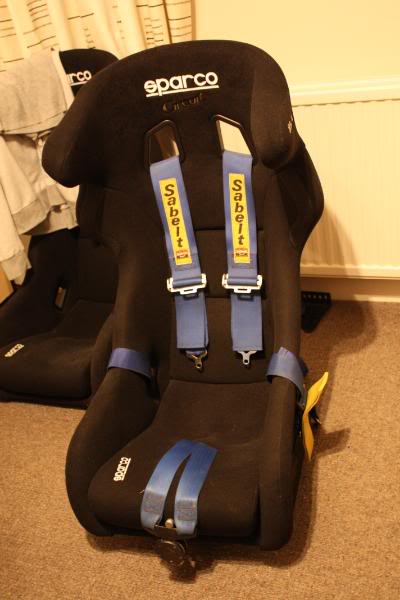

Harnesses arrived today too, 6 point Sabelt's:

nice, liking the rig up to see how the wheels look, and the archliner grommet, lol

Realy liking the height at the back now
