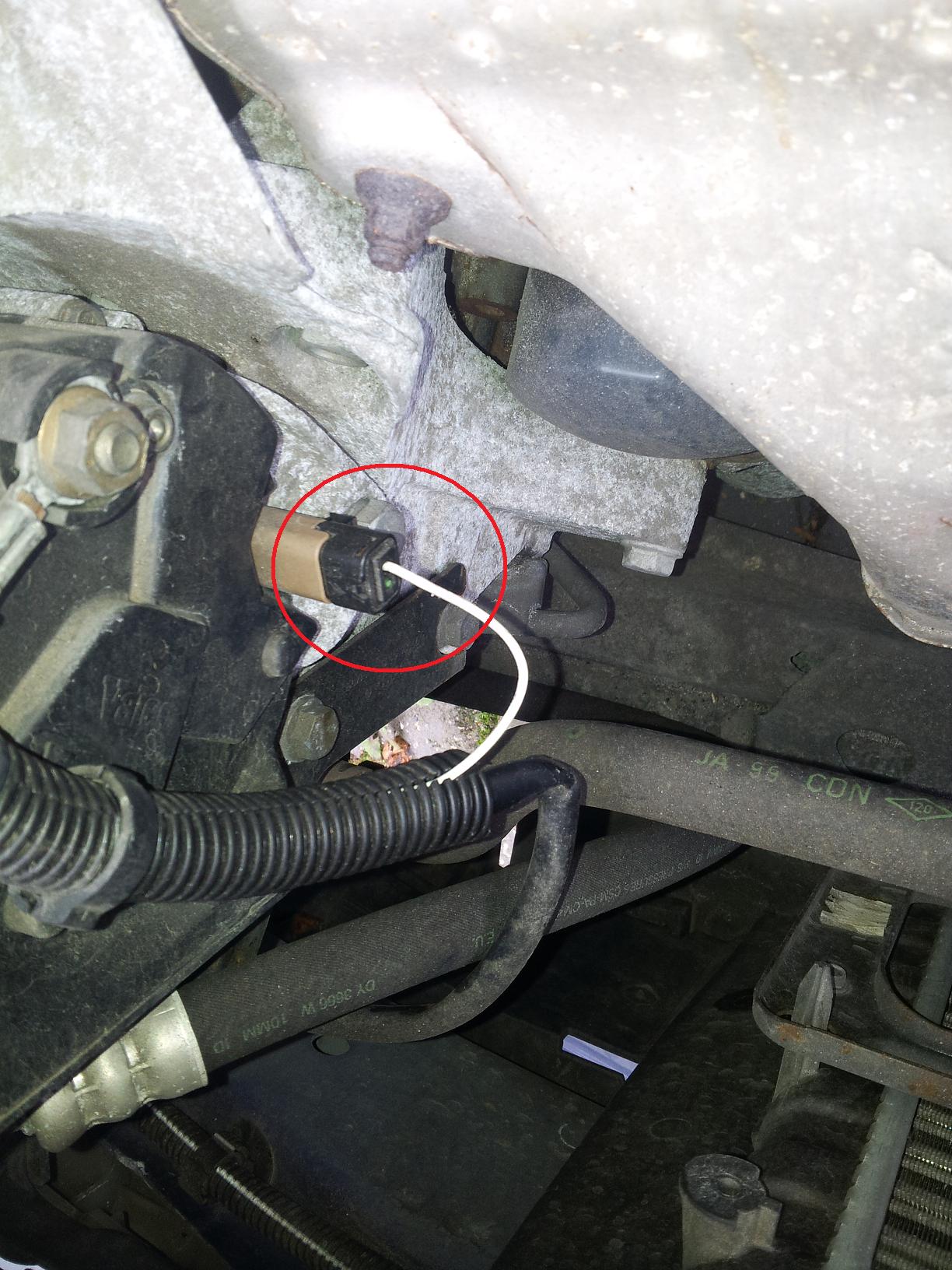

The connection to the alternator
There is only one cable going into it, a white one but if you look at the connection on the alternator it looks like there was a green cable connected to it as well but no longer there.
This cable is completely loose and is not connected to anything, I've had a look everywhere and cannot figure out for my life where it connects to. The wire is covered with black cover but the colours are black and pink and it comes out of the engine fuse box.

also the wire thats showing white with the green missing is the crank senser,it's a wonder it's running at all.take the black shruod apart,and you will find the other end of the green wire,bridge it to the plug and you should be off again.good luck.
  1999 Clio RT 1.6
hi bud,the wire with the plug is for a spotlight.
sorry, i know as ive just done the wifes on her 1.2 clio.hope this helps.
Mate you're an absolute LEGEND!!
I'm going to definitely take a look at the wires, I thought it would be for something else instead of the spot light as the cables coming out engine fuse box, but that would make perfect sense as the cable is not really long and doesn't reach anywhere really
I knew there was something wrong with the alternator/crank sensor and the fact there was only one cable connected and the green one was gone completely
So Graham opened up the bonnet today, and then I thought to myself.. wait a second, it isn't the crank sensor, the crank sensor however might need cleaning up but I cannot find it's location to save my life lol, The white wire is connected to the alternator not the cranksensor

Hi, the one white wire plug to the alternator is fine.
Cheers karol, I'm glad that's out of the way

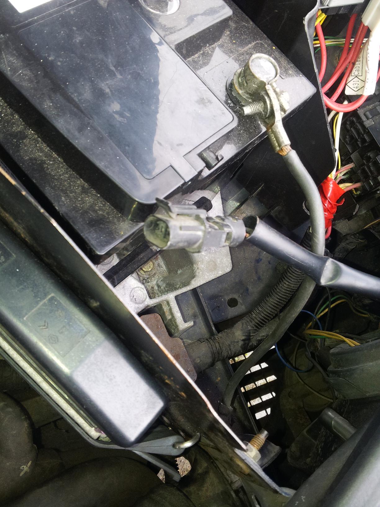

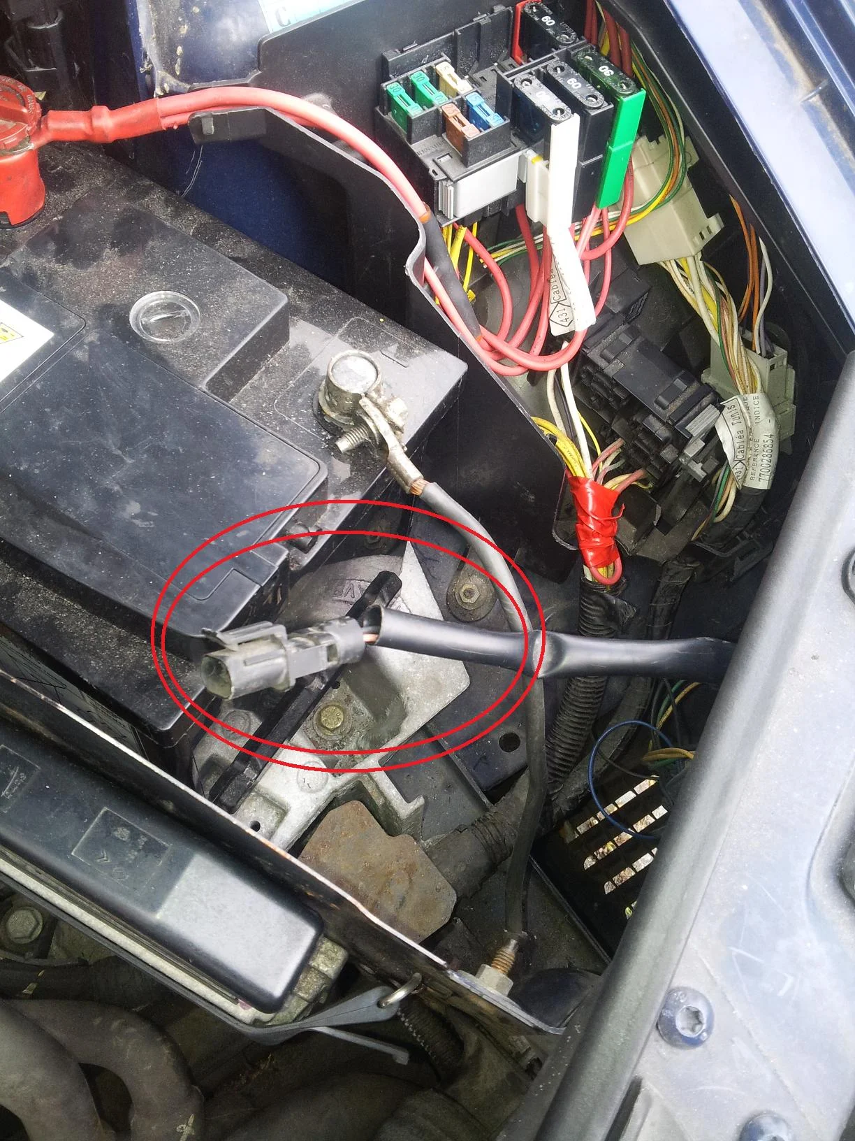

I tried to find a place on the spot light where to stick that cable, however it seems like they are all working fine and headlights and all are connected and correct, so don't have a clue what the cable is doing there or where it's supposed to connect to

the second connection by the battery is nothing to worry about, will be for equipment that's not fitted.
as karol has stated, the 1 wire to the alternator is just the exciter, so perfectly normal.
