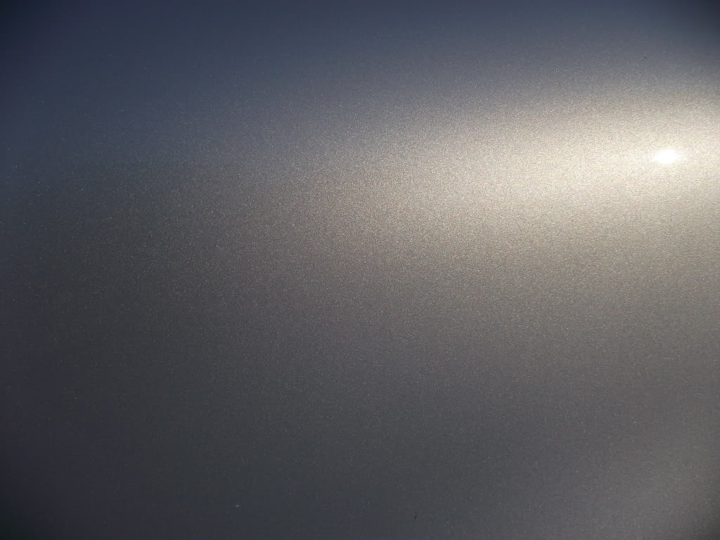

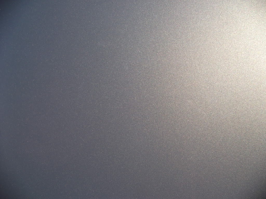

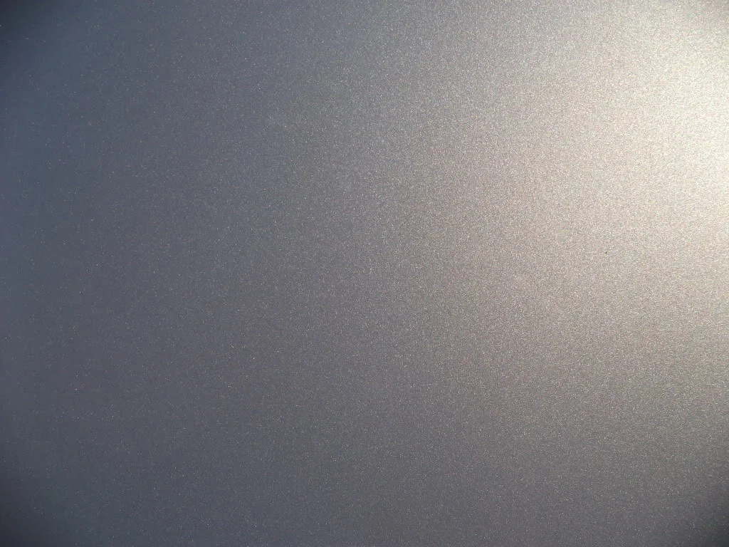

A few little pics.
My favourite of the Tardis on action. was so good thought my clay wasn't any good as there wasn't anything left to pick up
Unfortunately the swirls seem to have been hidden by poor photography
