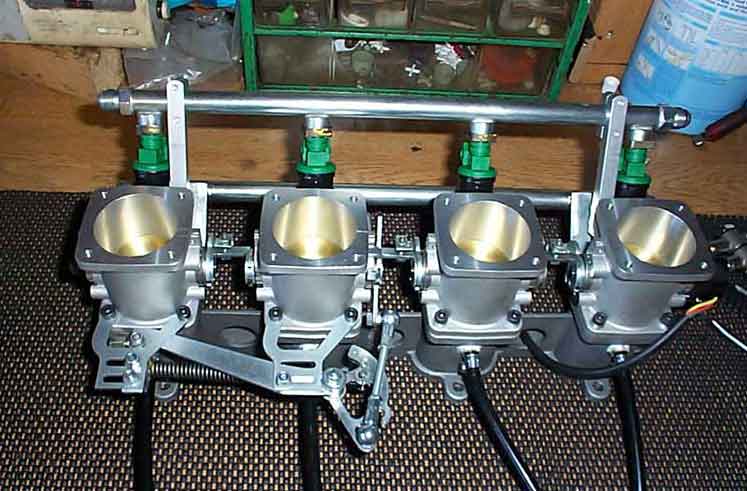

these are SF's
and these are DCOE
these are SF's
and these are DCOE
Hmm, ok then. Hopefullly I will be able to fit the pump with all I got now. And I also hope that I will get some recent result with Jenvey manifold and Jenvey air hornes etc....
