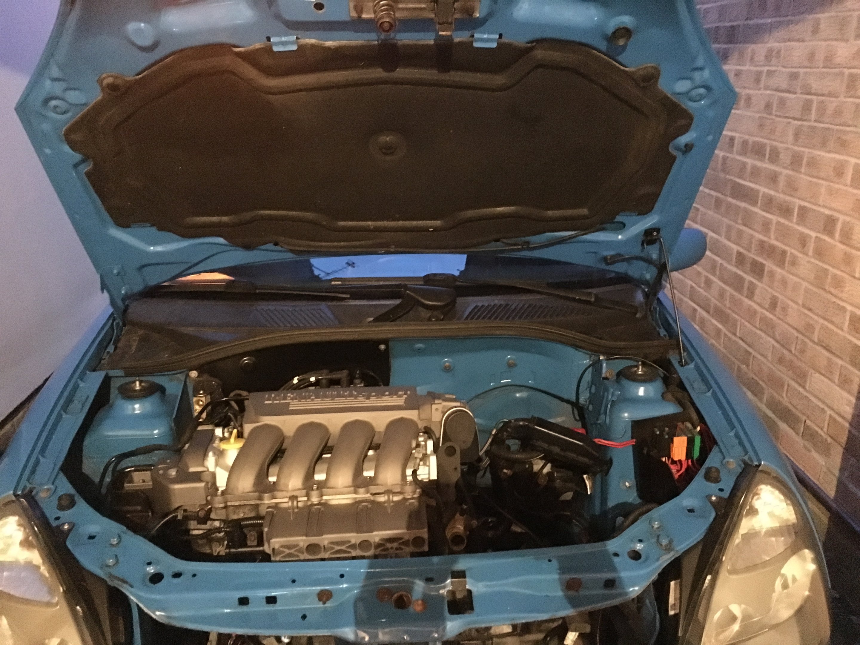

Oh I forgot to post the official pics:

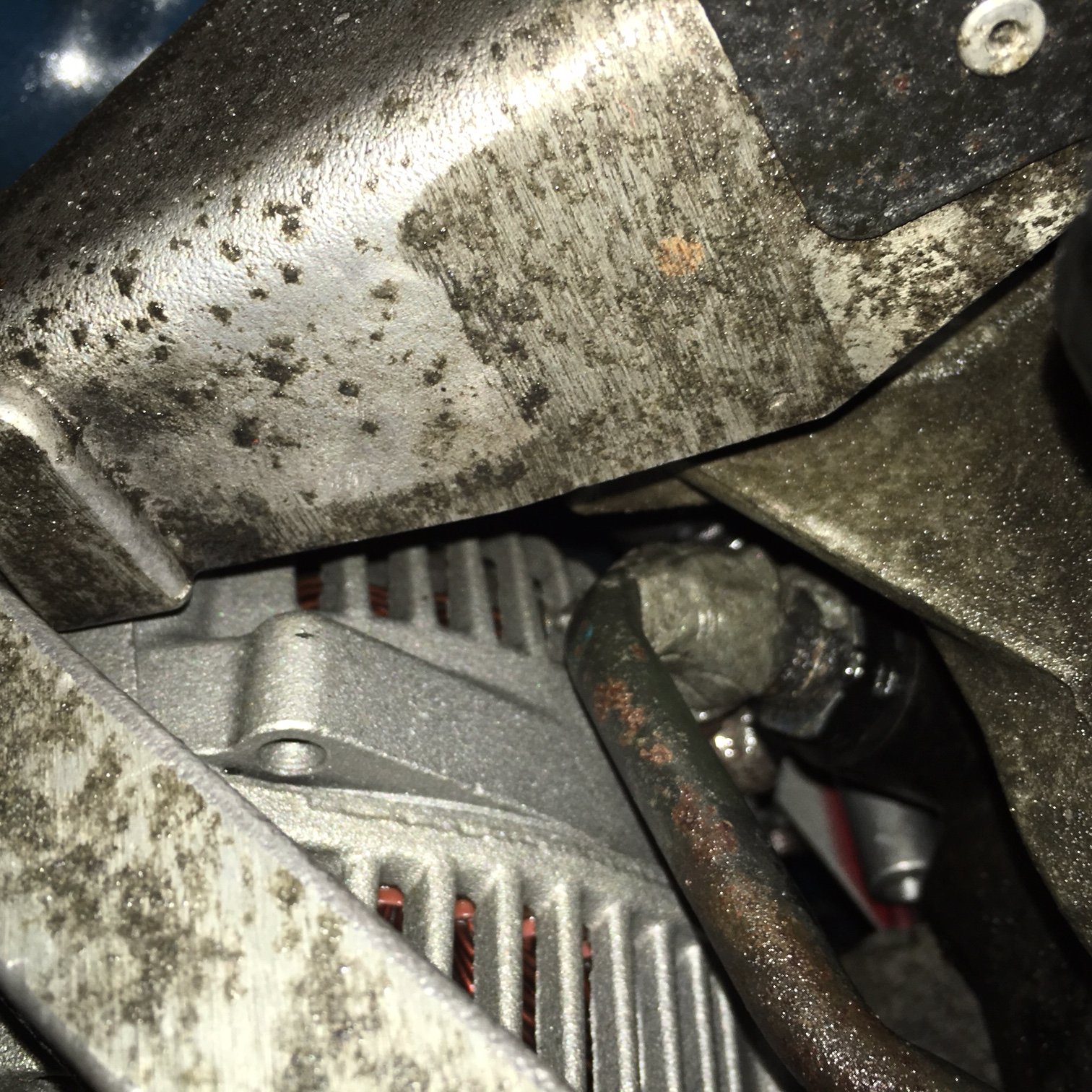

Time to get it working again...
Since Cadwell Park the car has just sat in the garage looking sorry for its self.

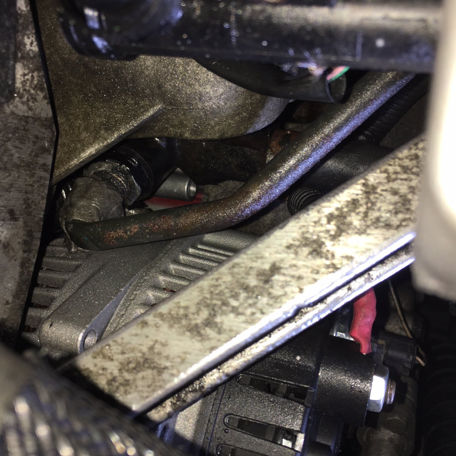

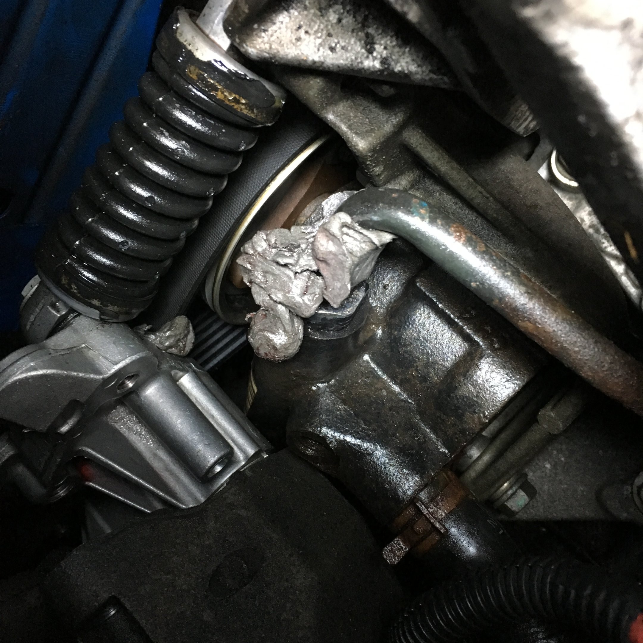

The power steering system has a link by the alternator, its leaking from the pipe it self as I hope the following pics will highlight:
We put a load of liquid metal around the pipe to allow me to get home so at some point I need to take it all part, but I'm stuck in two minds as to weather to go down the EPAS route or fix the standard system. If I go EPAS I may as well remove the AC also. If I went this route I think I would like to go 172 Cup set up which would also involve buying a new alternator and from my prices cost me around £450.00 to replace the hydraulic system and fix EPAS & a new 172 Cup set up.
Or do I just fix the current issue (cost should be around £50) for a pipe to be made up and enjoy the car?
Any views would be great.

You don't necessarily need to go straight to the Cup setup. The cheapest route would be to buy the delete kits from Pure Motorsport and then either buy the HPAS rack blanking kit from either PM or Proline. Then the only other outlay is for the EPAS steering column and controller.
The Cup bracketry and alternator could easily be changed over later. The PM Power steering delete kit will stransfer to that and then just sell on the aircon delete kit.
Oh and you'll need to change the aux belt too.
Just my opinion of course!

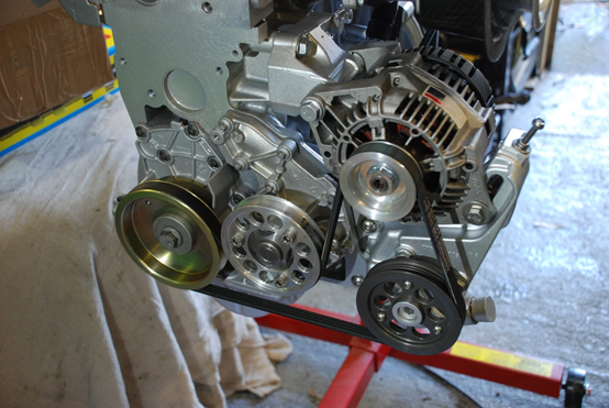

Sounds like a plan! I've used a 4pk1110 belt, but I'm using the lightweight pulleys (4pk) as apposed to the 6pk standard. Length should be very similar though. In this photo the power steering pump is still installed but I've since swapped this for the PM power steering delete kit which retains an idler pulley in the same position so belt remains the same.

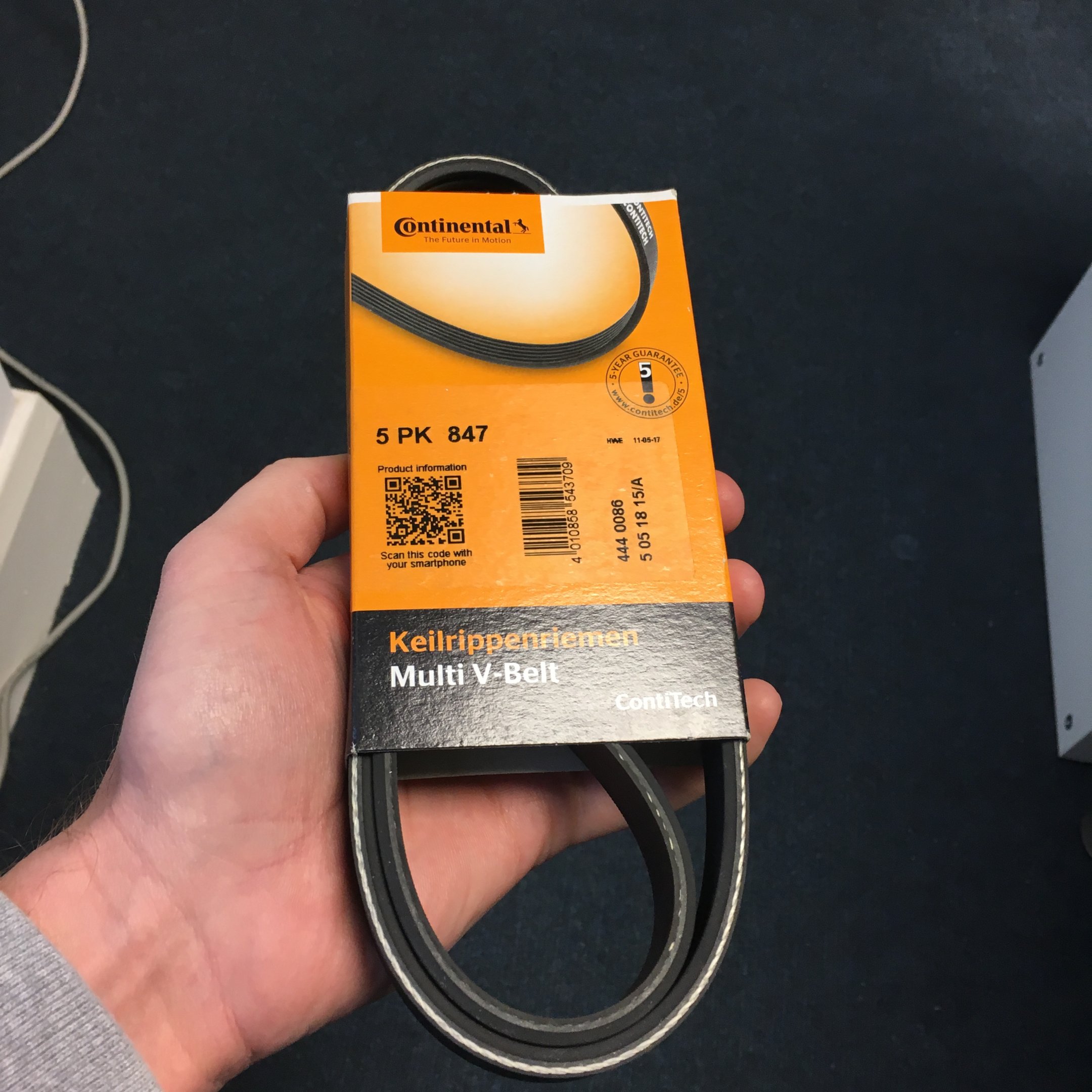

I'll be removing the pump etc so the belt will only be running via 3 pulleys.
The belt I'll be running will be the 5pk847, this is one rid smaller than standard so it doesn't catch on the cambelt cover. Thanks to @GrahamS for his help on this.
I'd be interested to see how you configure it for only 3 pulleys. As far as I can see, without a jockey wheel to replace the pump the water pump will be running backwards with the cup setup. Perhaps I'm missing something though!

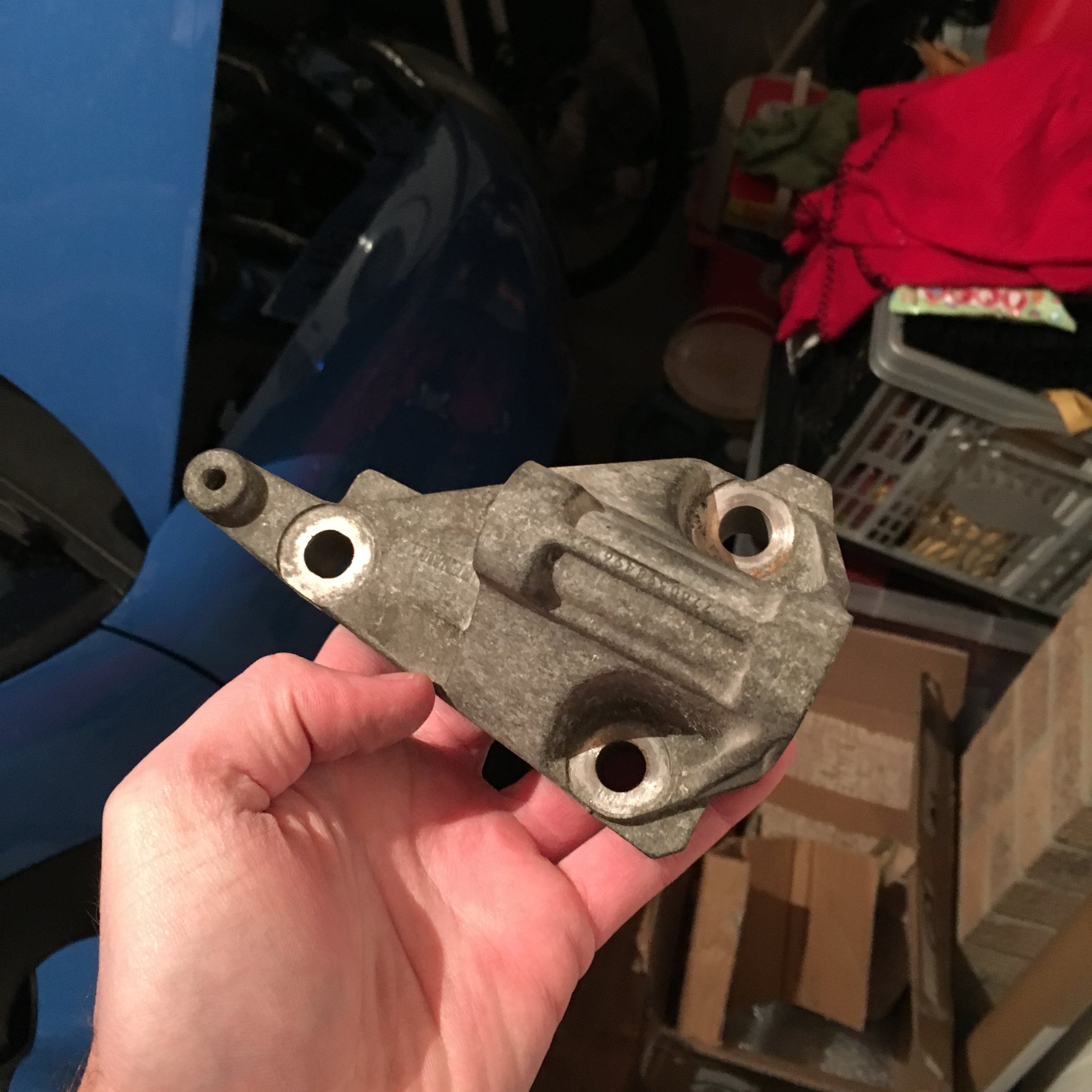

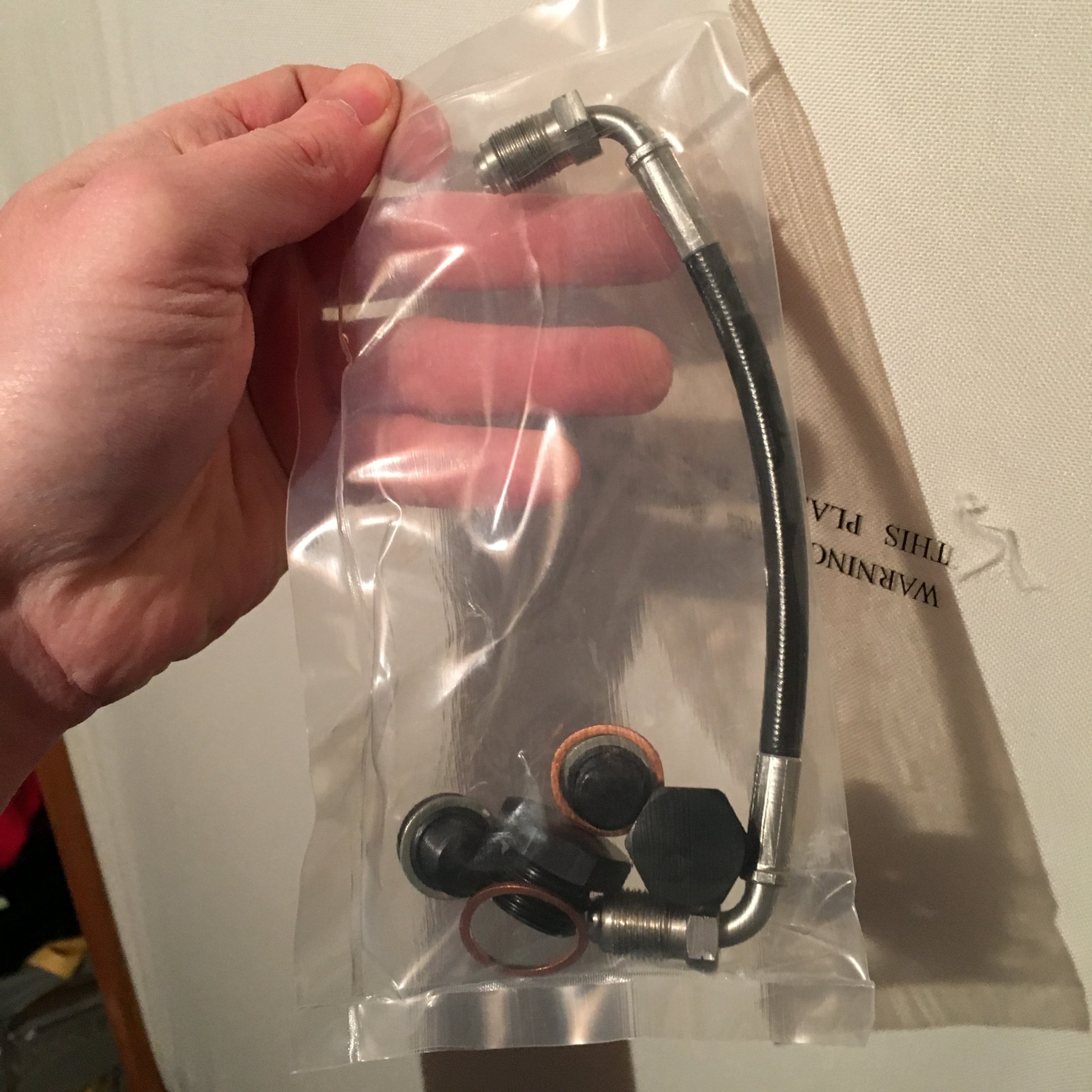

December 2017 - Update
As mentioned previously I’ve gone and made a start collection parts to convert over to EPAS. I’ve either ordered or have the following:
Brand New Clio 172 Cup Alternator
Clio 172 Cup Alternator brackets
Proline loop kit
DCI steering column (I promise its in there)
Belt
I've also ordered an eBay EPAS controller unit.
As previously mentioned I’m also going to remove the AC while doing all this as I've not used it once in my year of ownership so no benefit to keep IMO.

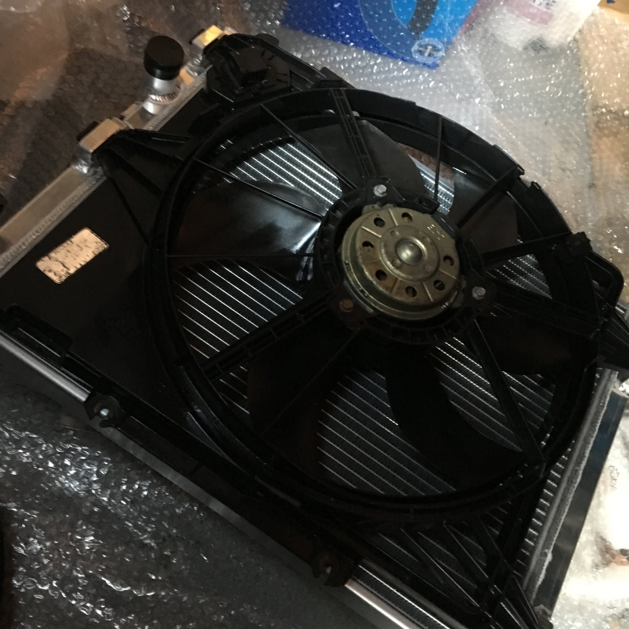

I then got a bit carried away and then ordered an Alloy radiator, genuine Renault header thank & a set of forge hoses currently awaiting on the first two to arrive from KAM Racing.
So I just need to get it all working again! Time is my main restriction at present, all going well I’ll carry out some a little progress this weekend. However there is currently no rush to get it working however I would like it all back together and running before 2018! Otherwise I can see spring arriving and this still sitting in the garage.

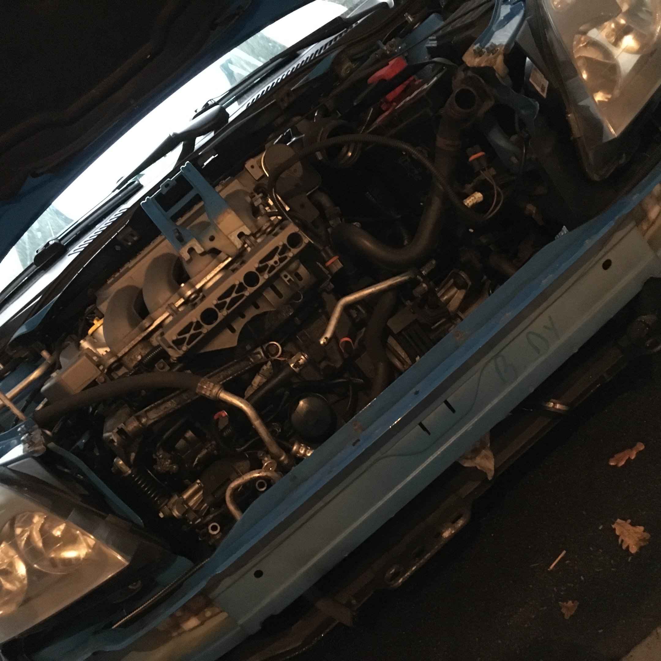

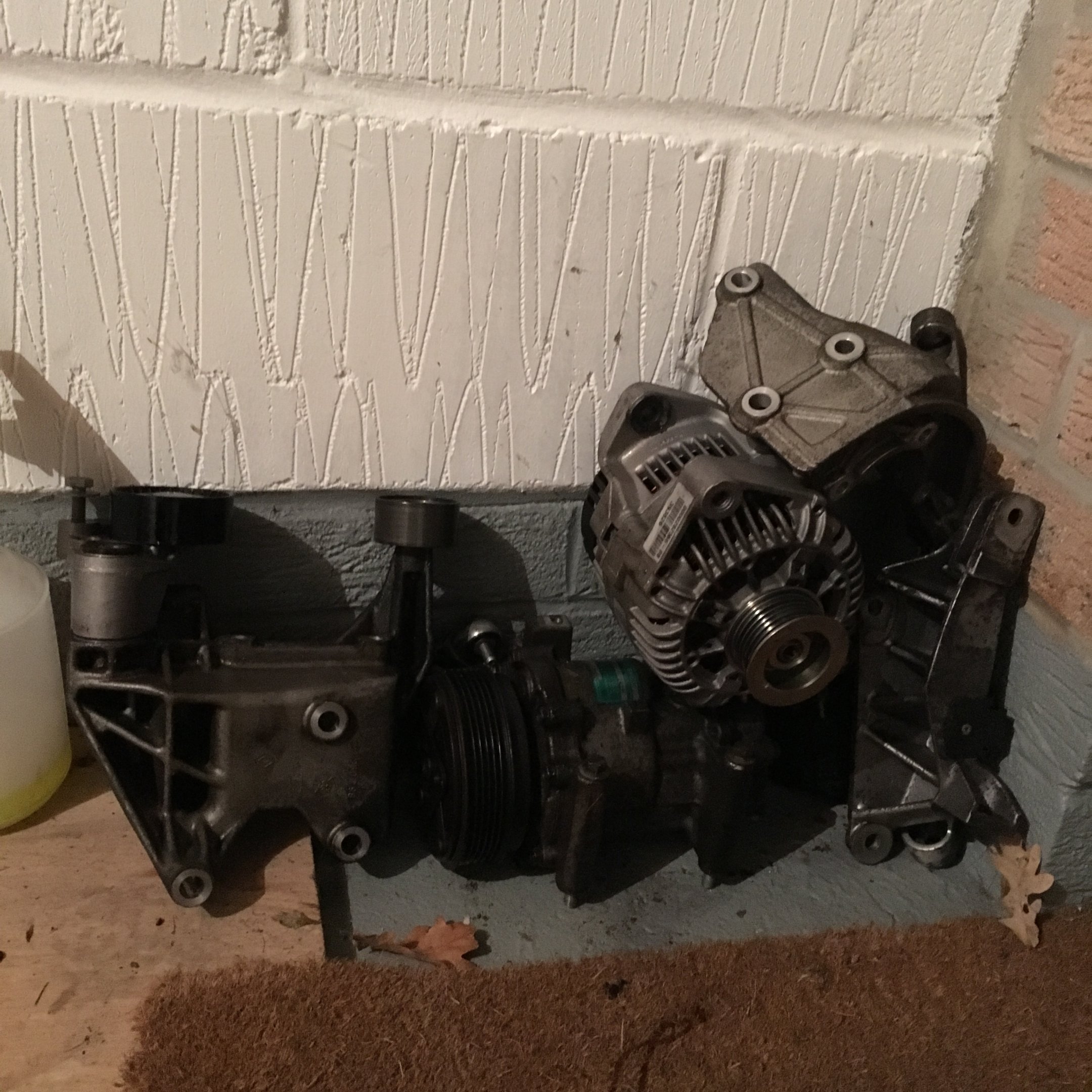

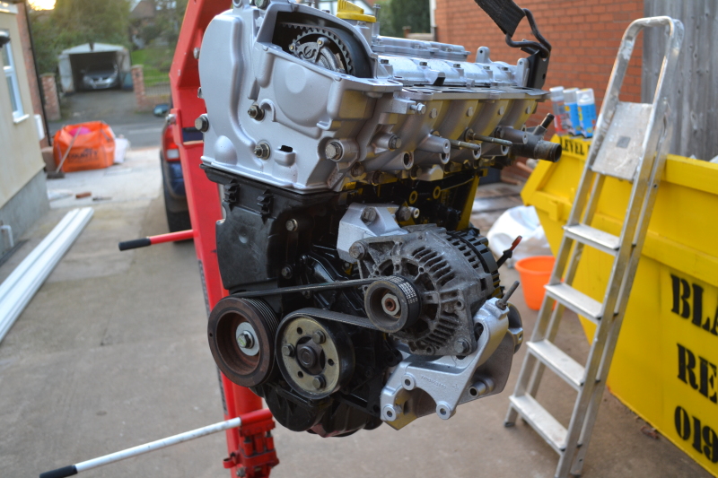

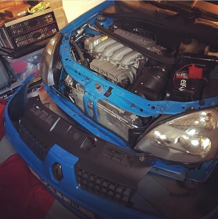

Over the Christmas break I did manage to make a start on removing the AC and HPAS:
Surprisingly quick to remove most of the front end!
This is where the original leak was coming from (the temporary fix didn't' work too well):

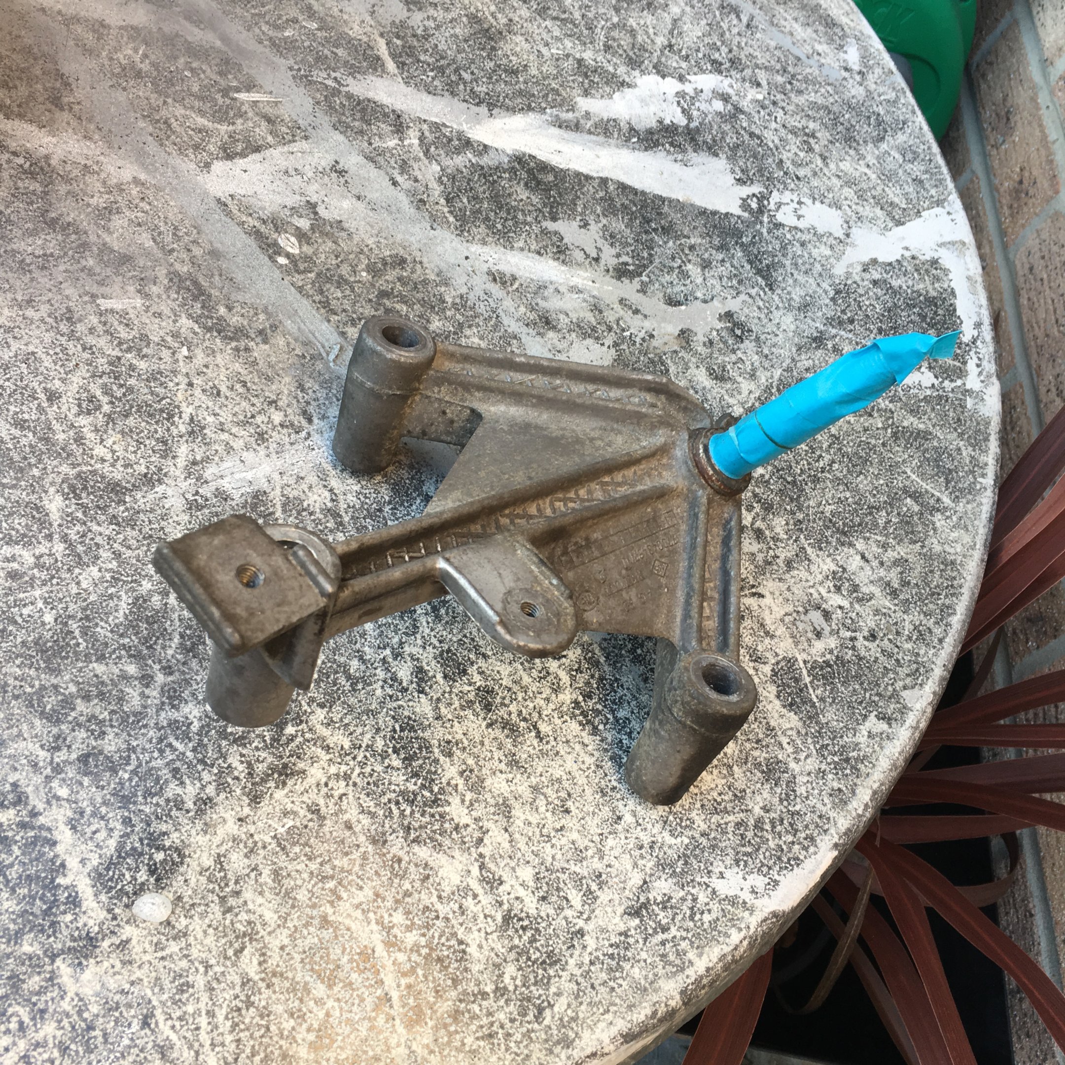

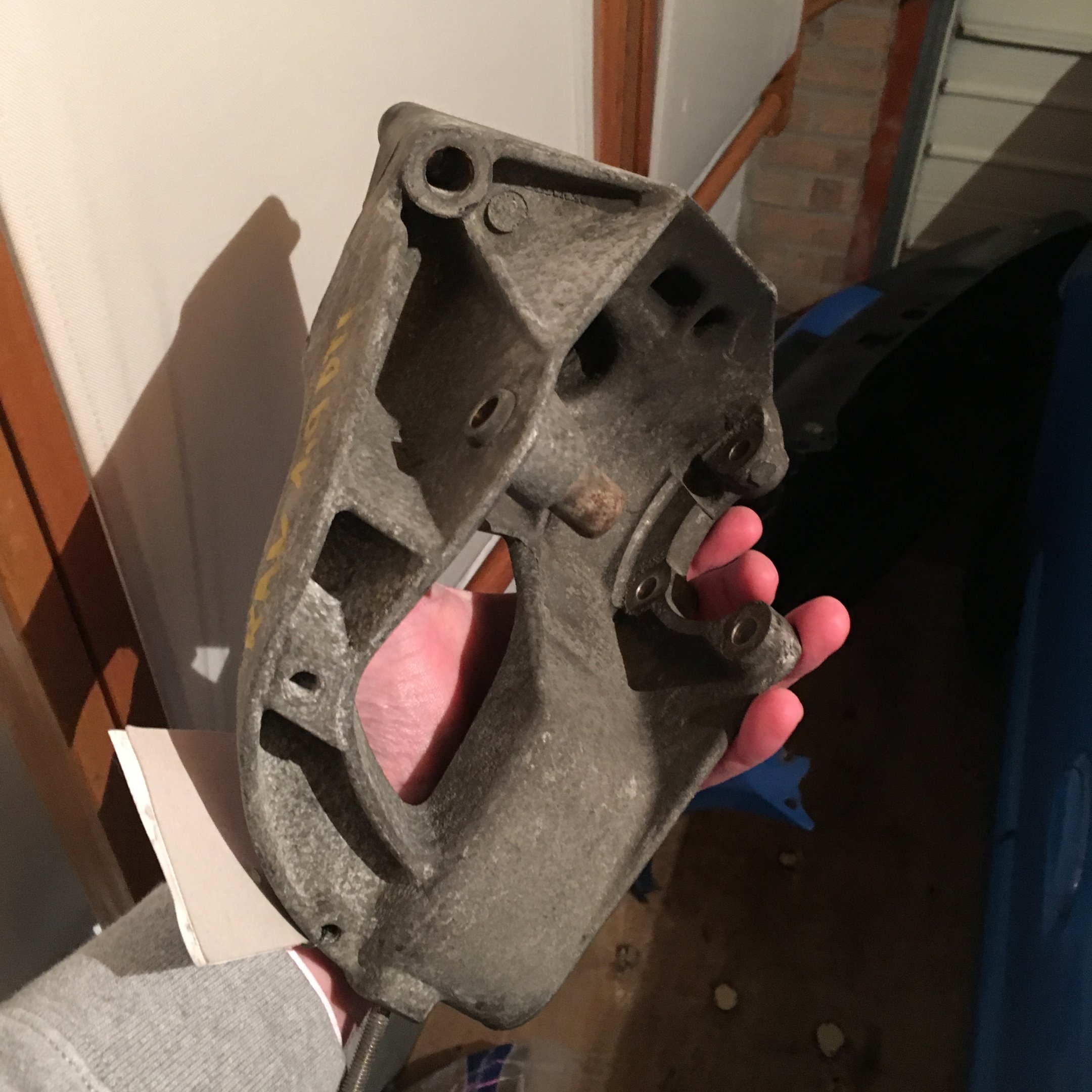

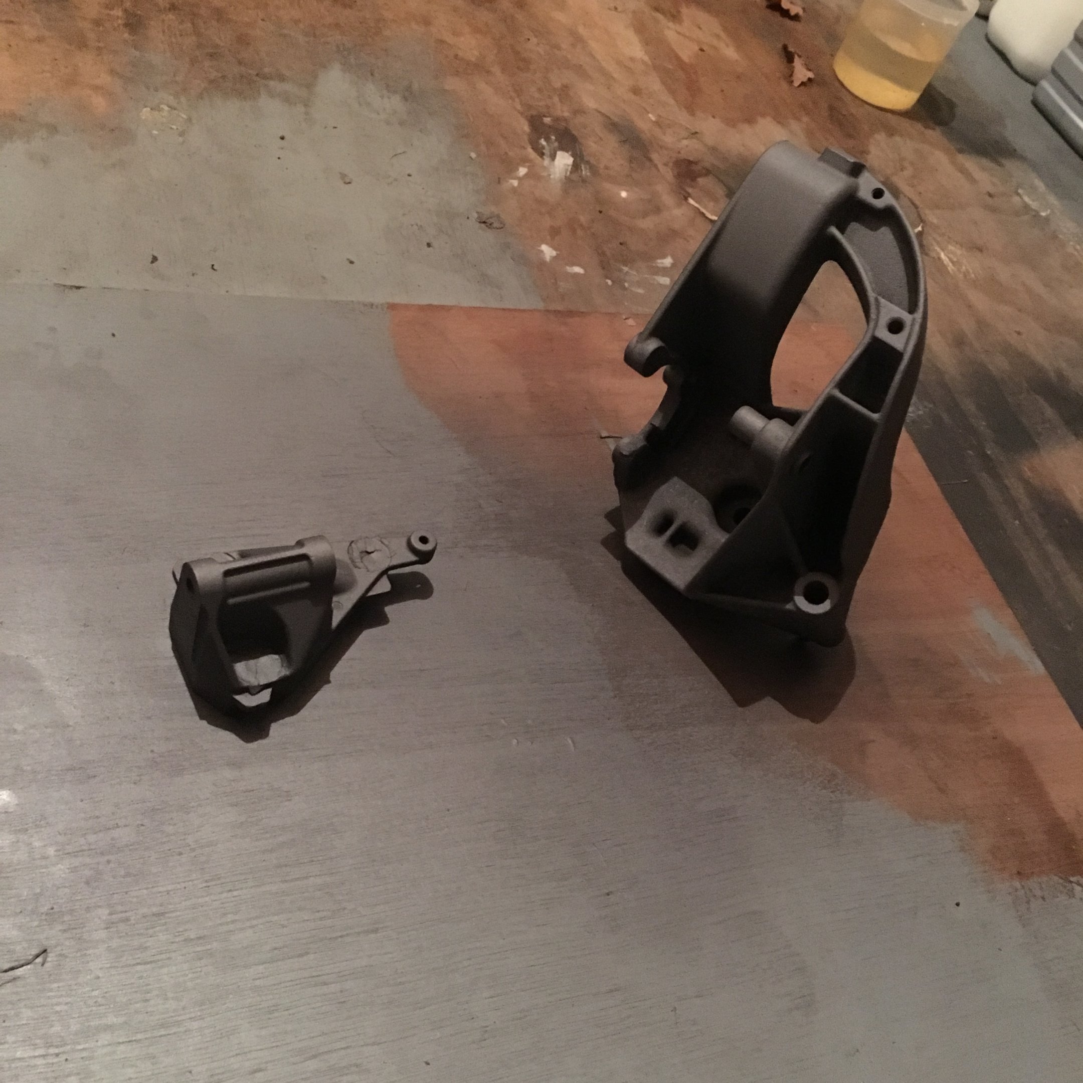

I cleaned up and painted the Cup alternator set up:
Some of what was removed:

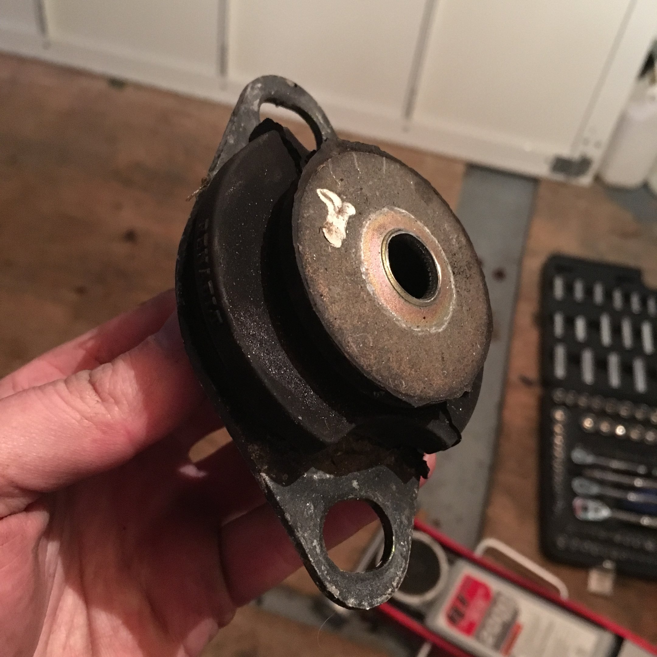

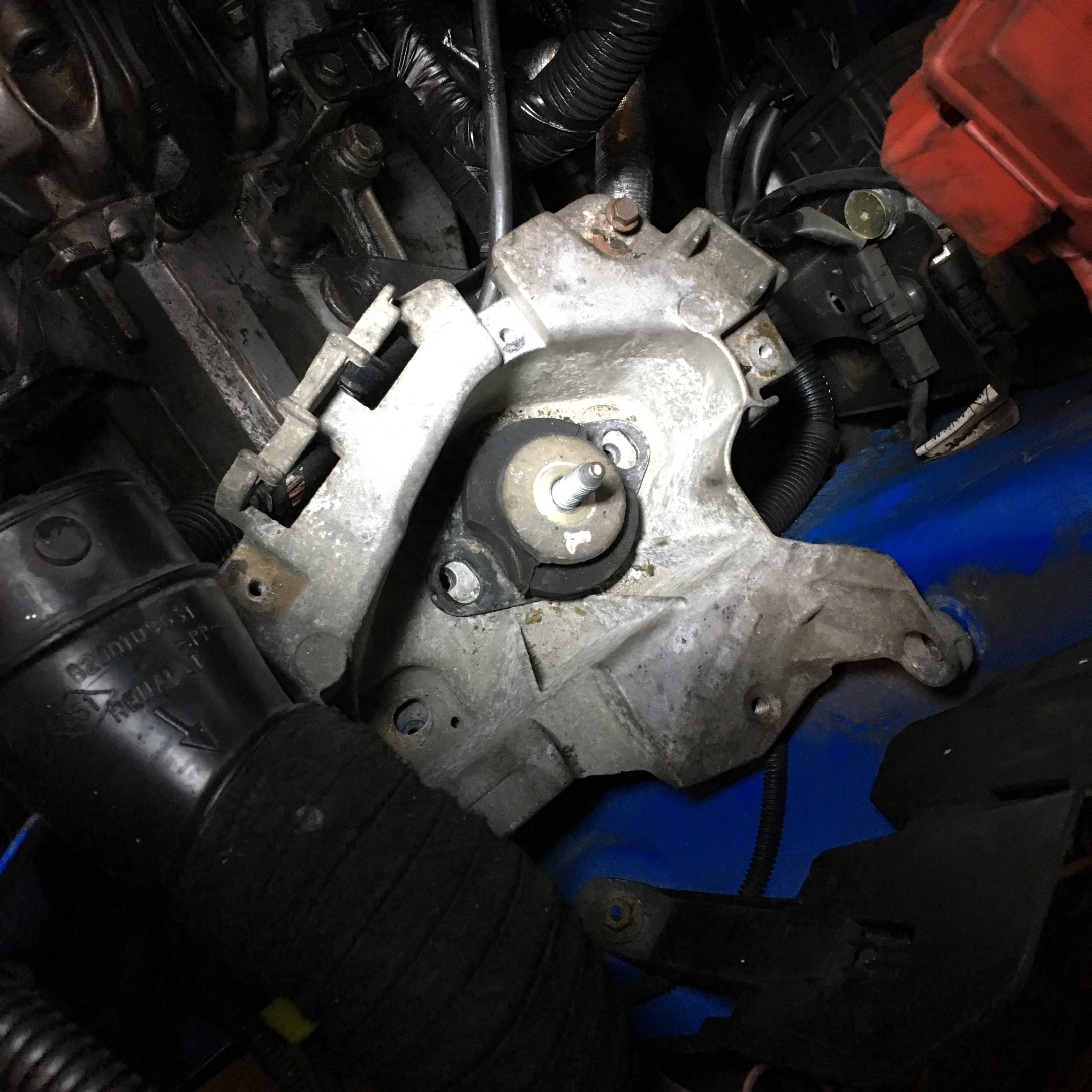

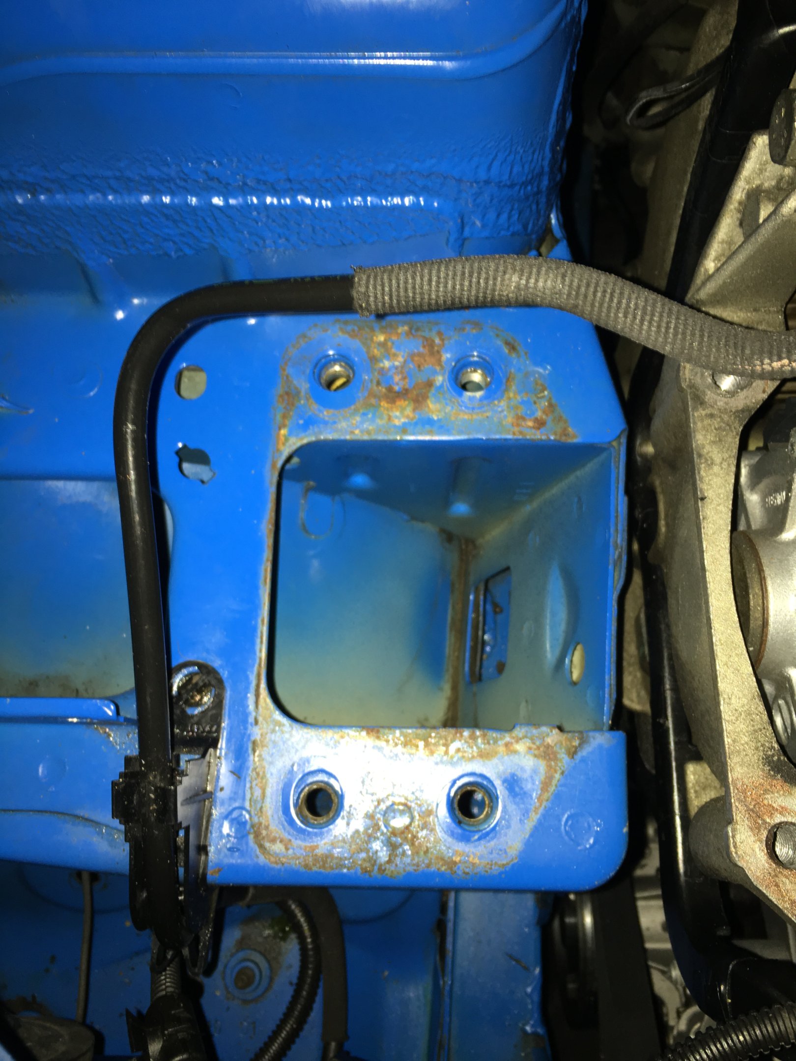

While in the process of removing the HPAS pipe work I notice the gear box engine mount had seen better days:
I've got a snapped bolt on my battery tray which I'll try and sort before I put it all back together.
I then removed the sound deadening connected to the bulk head assuming I would replace the heat shield section with one off a 1.2 Clio however finding a 1.2 manifold heat shield has turned into a nightmare, worse case I'll go to a scrappy, however the engine looks so much better without it all.
It'll especially look better as I have a new header tank and obviously I wont be running a Power steering fluid bottle so should look really neat once all complete.
I've also made a start on cleaning up the battery tray and gearbox bracket:

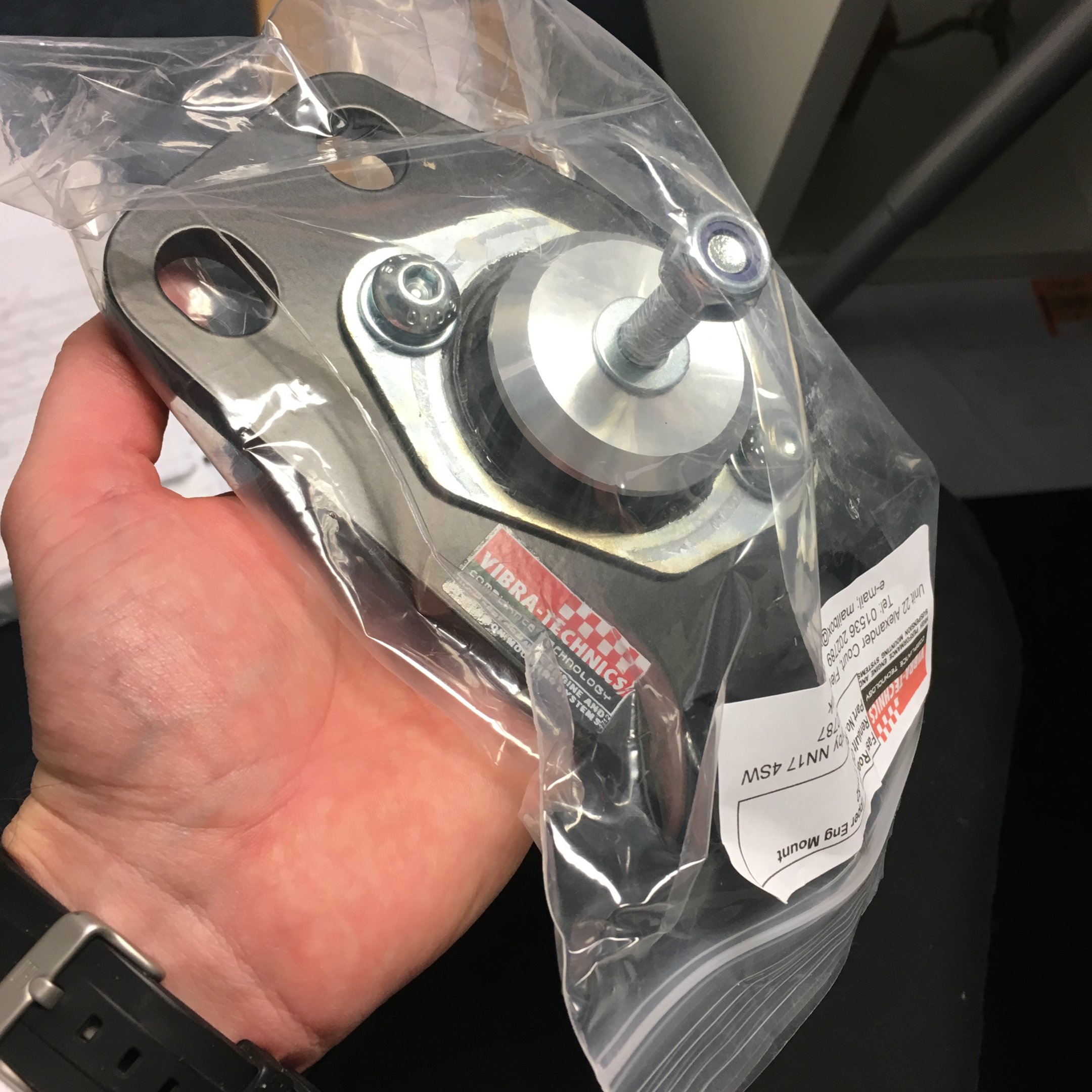

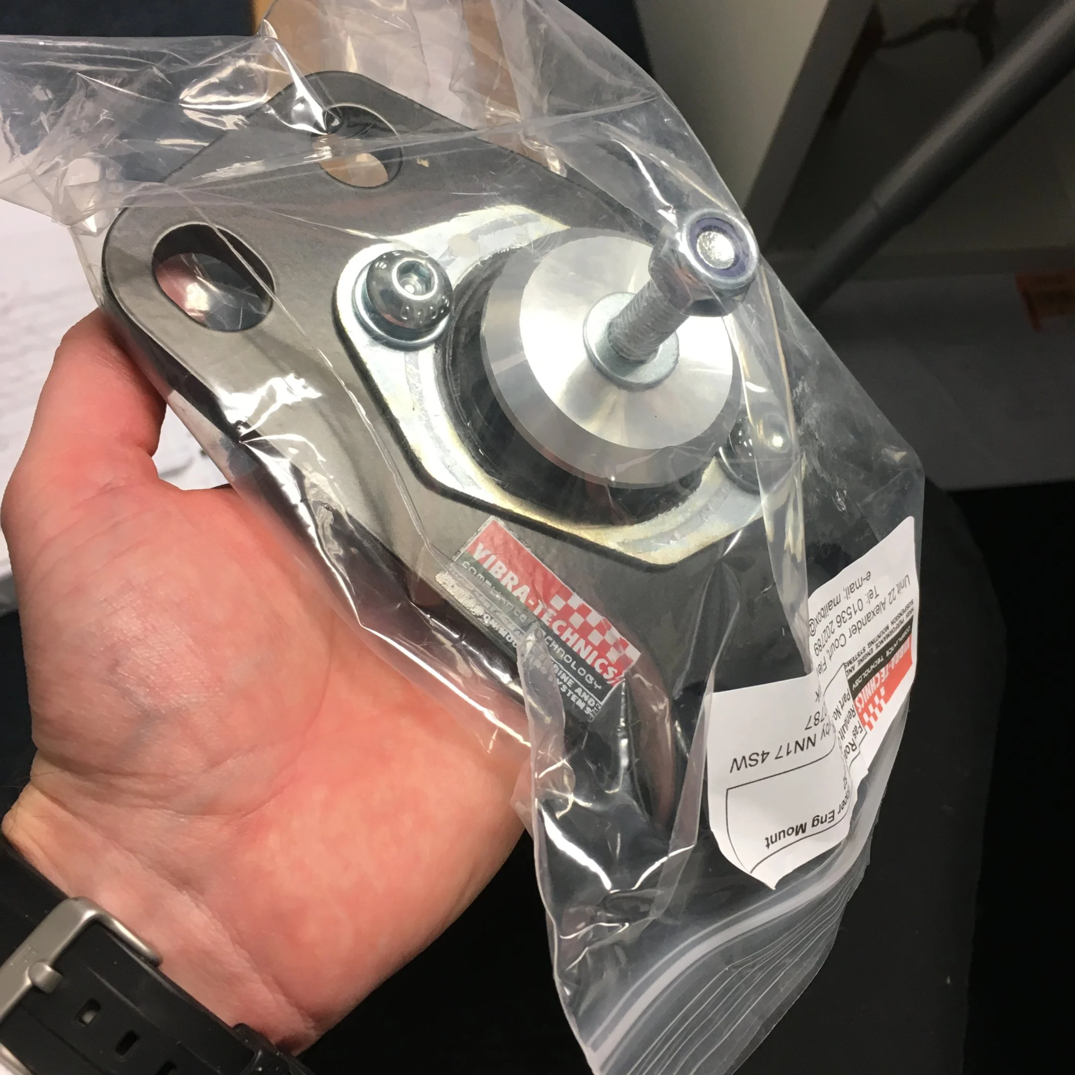

Finally pic of the new engine mounts:

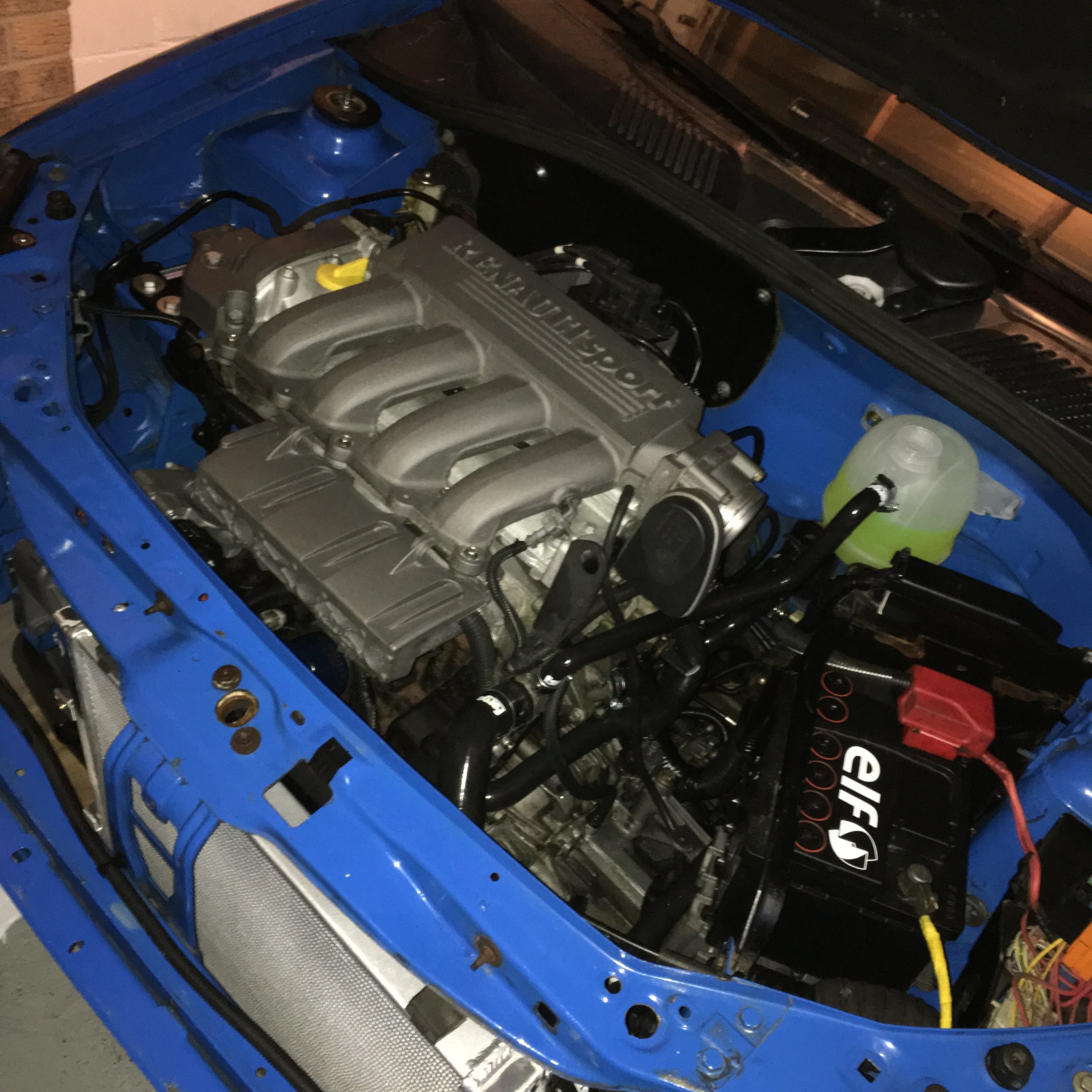

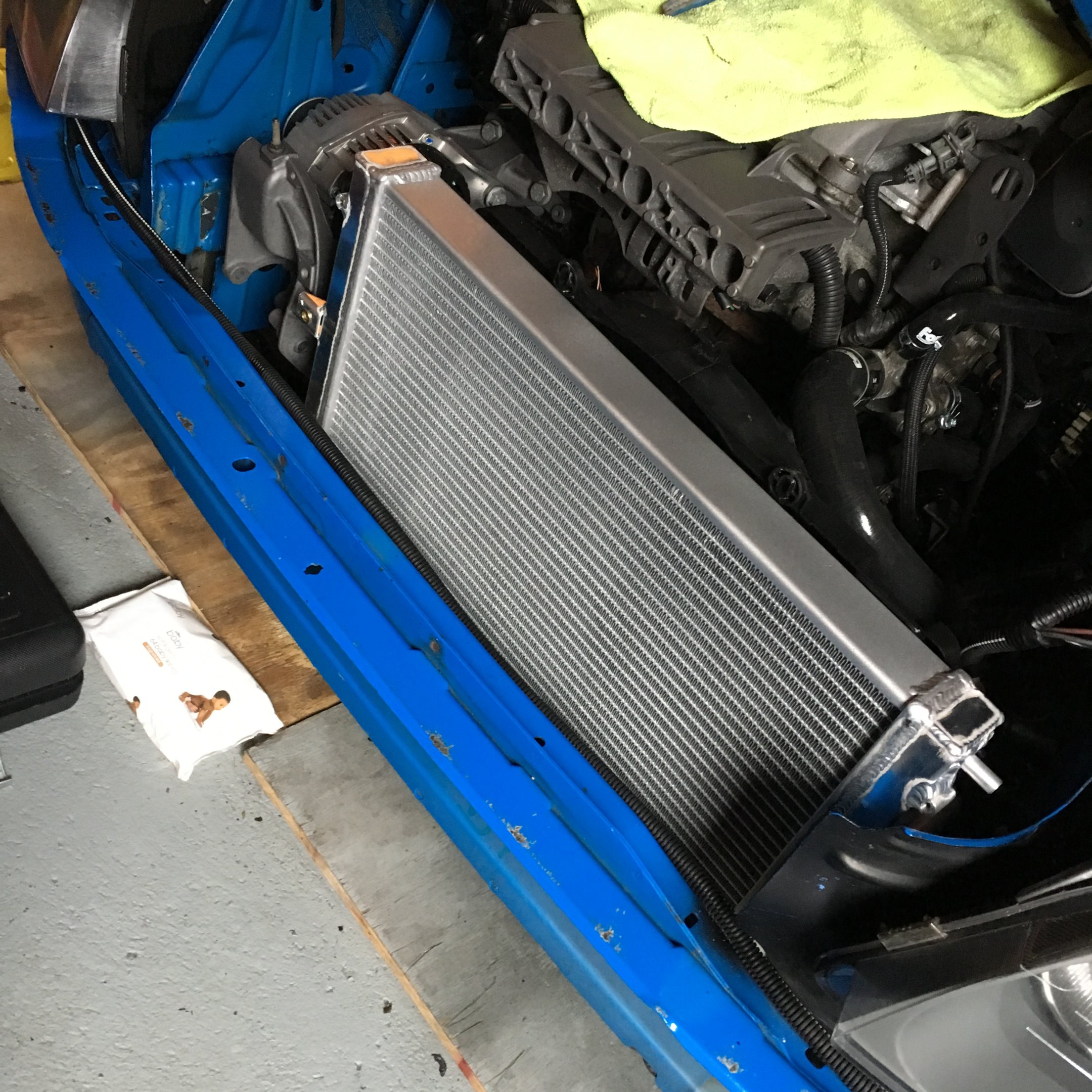

February 2018 - Working Again!
The car has been off the road since 15th October 2017 and I'm please to announce that its up and running again!
A brief summary of items completed since the above date:
  1. Removed HPAS and removed with loop kit. Not currently running any PAS.
  2. Removed AC (although still need to remove the items in the scuttle).
  3. Fitted Forge coolant hoses.

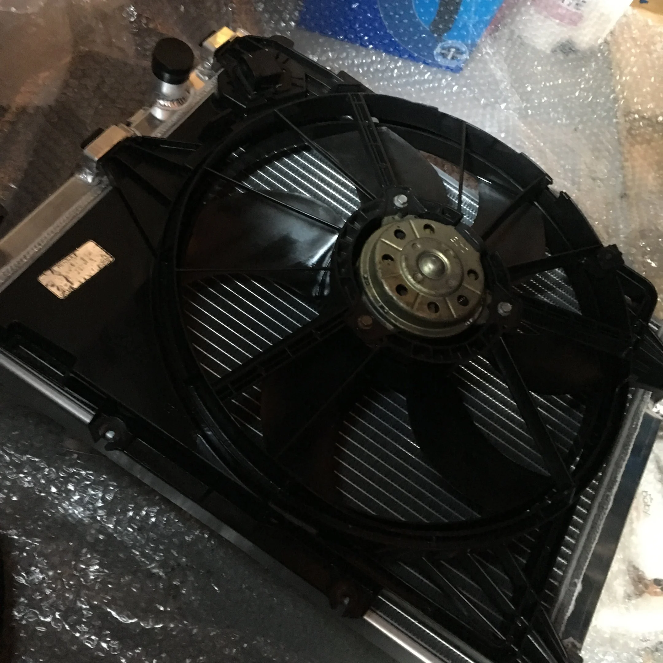

  4. Fitted Direnza alloy radiator.
  5. New Renault Type D coolant
  6. Fitted Clio Cup alternator set up.
  7. Fitted Vibra-Technics engine mounts.
Time was always my biggest constrain the jobs didn't actually take that long but the fact that I gave every area a clean it took longer than most. I still want to get the EPAS fitted which I'll make a start on tonight weather permitting but I'm really pleased with how its all gone excluding a few points below.
I'll let the pics do the talking:

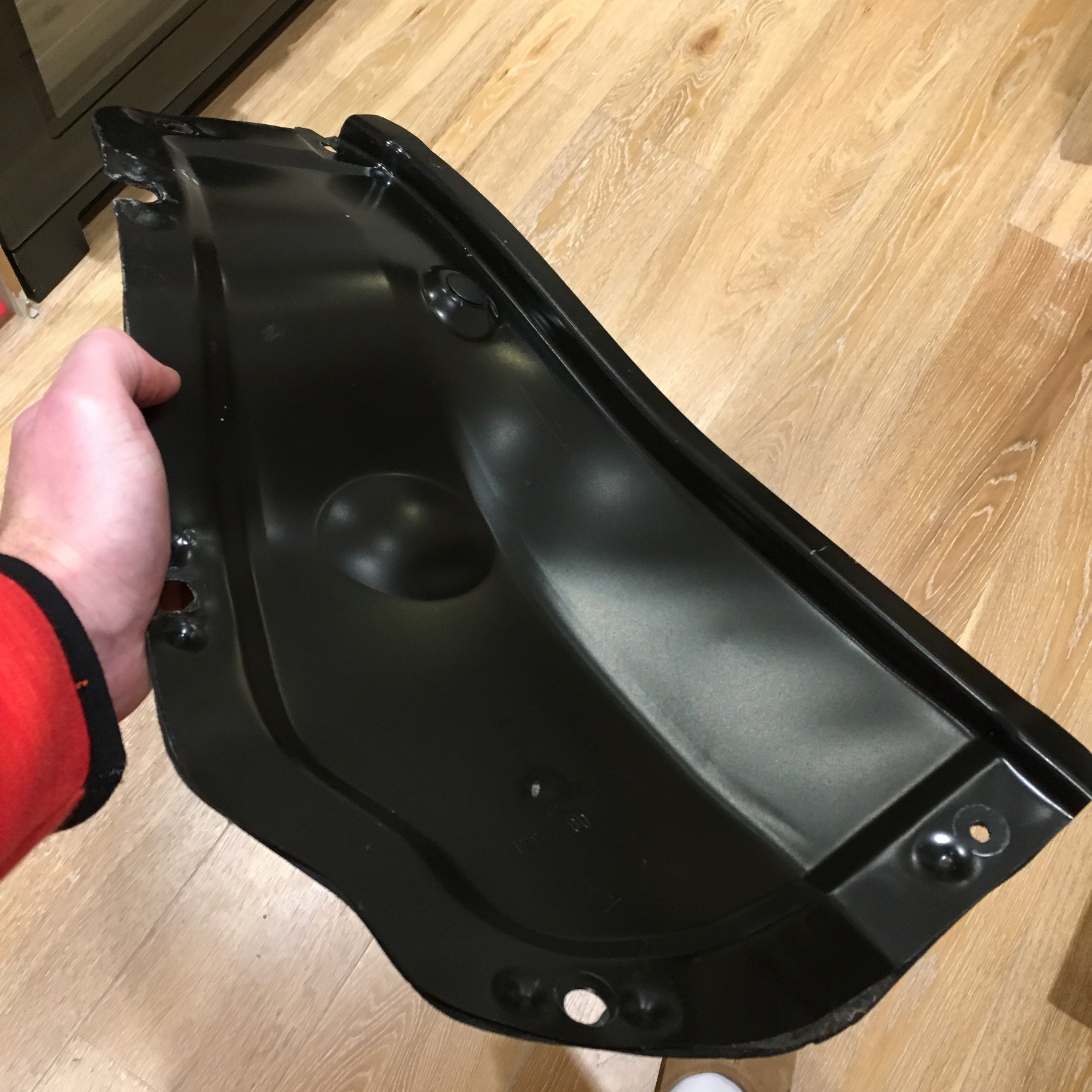

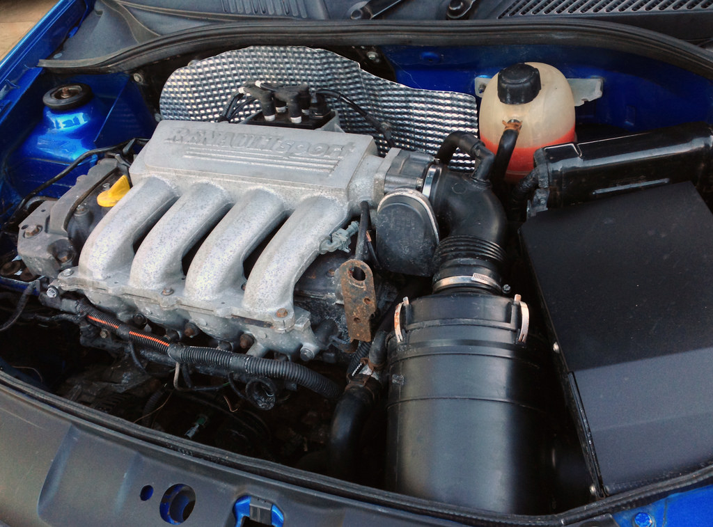

My new poverty spec bulkhead panel, which I'm yet to fit, although may re-paint either Black, Racing Blue or the same colour as the inlet:

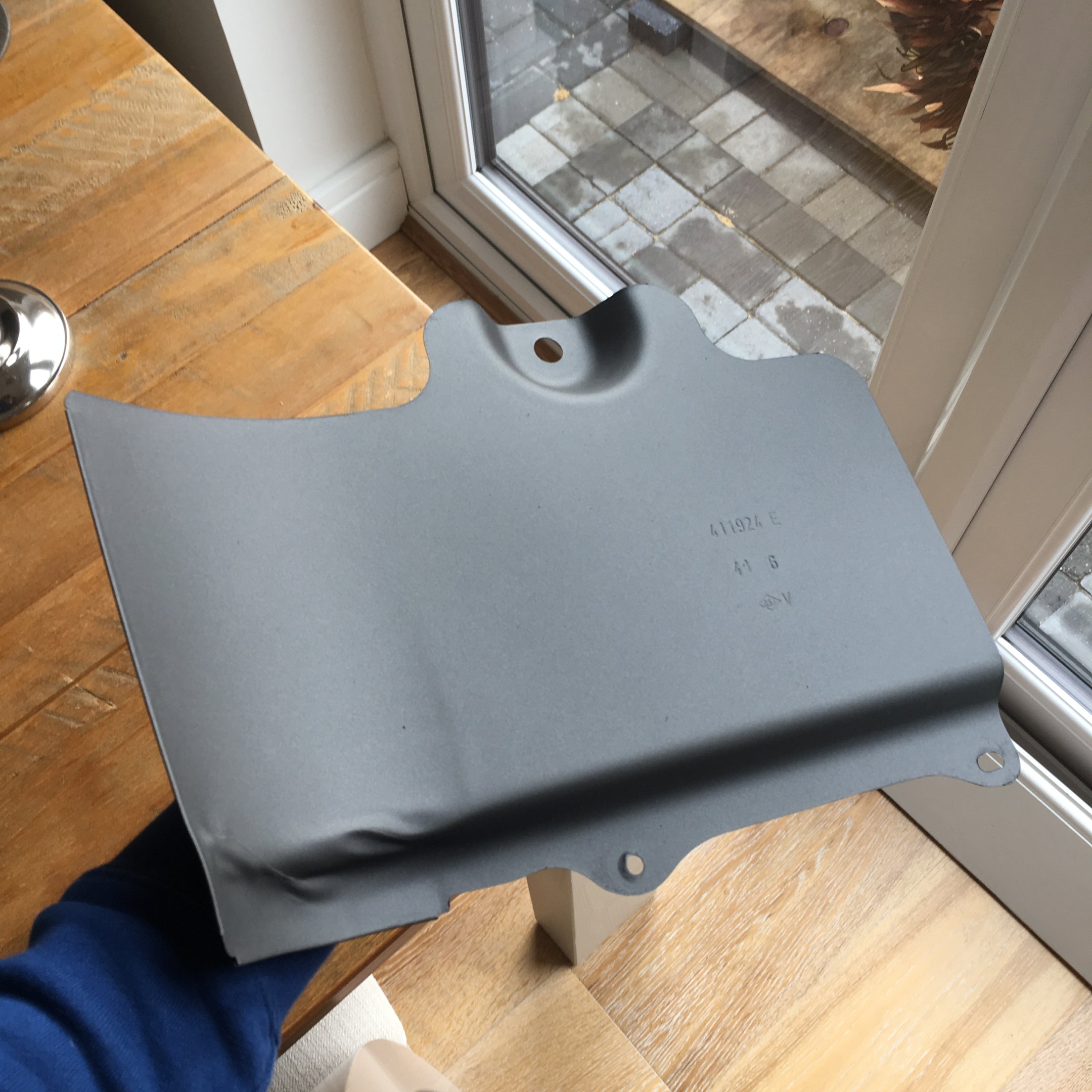

My next poverty spec item is a heat shield which I have a lick of paint:

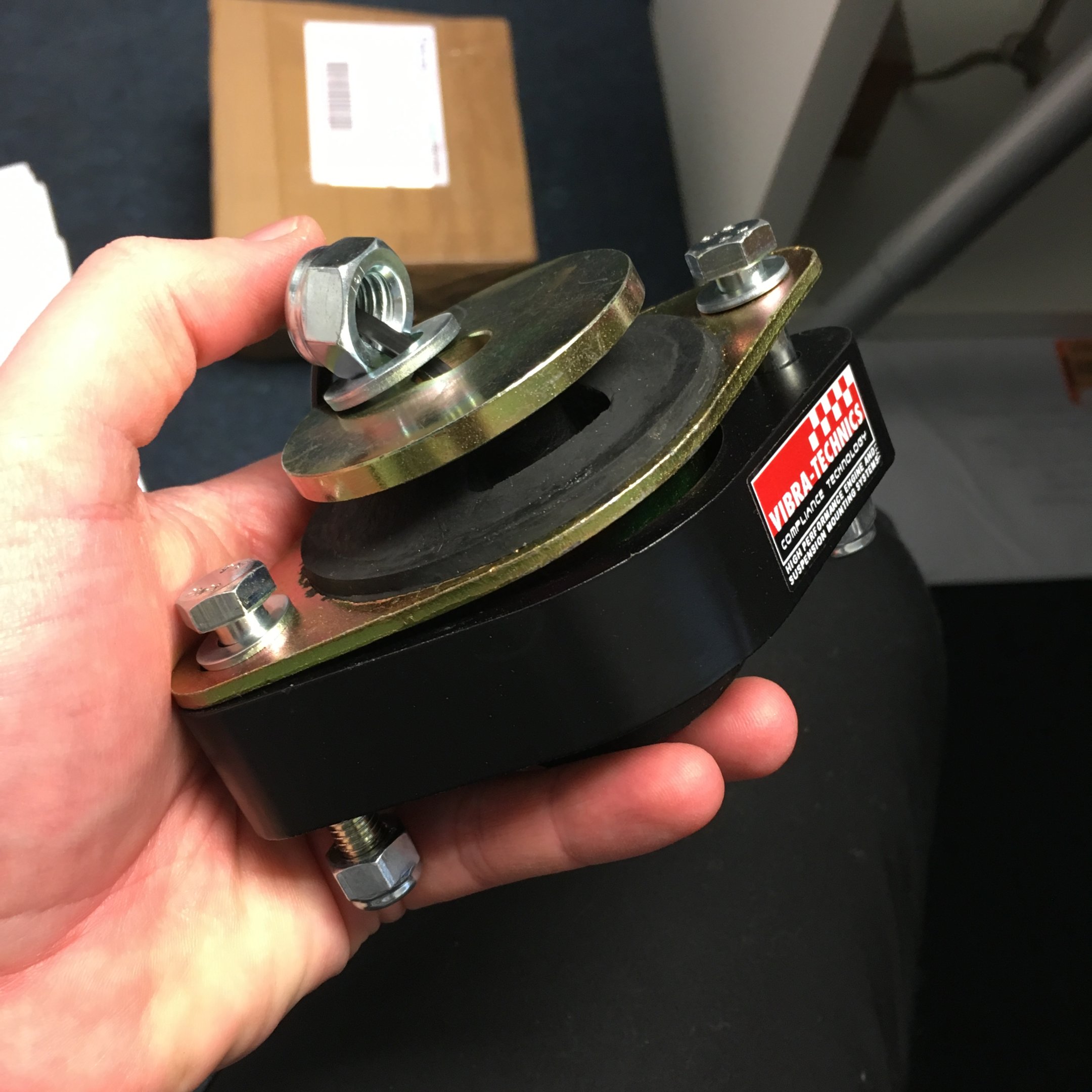

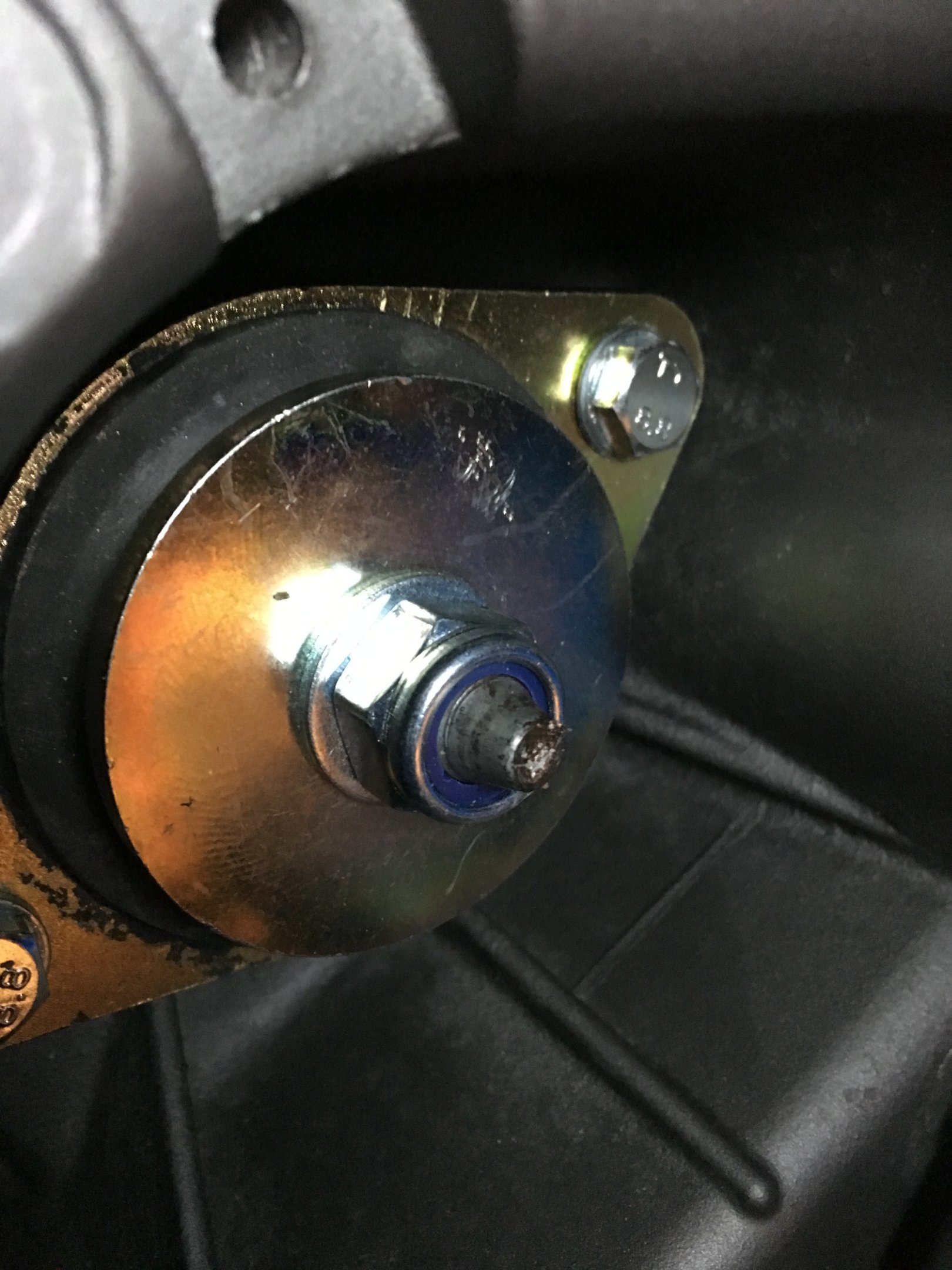

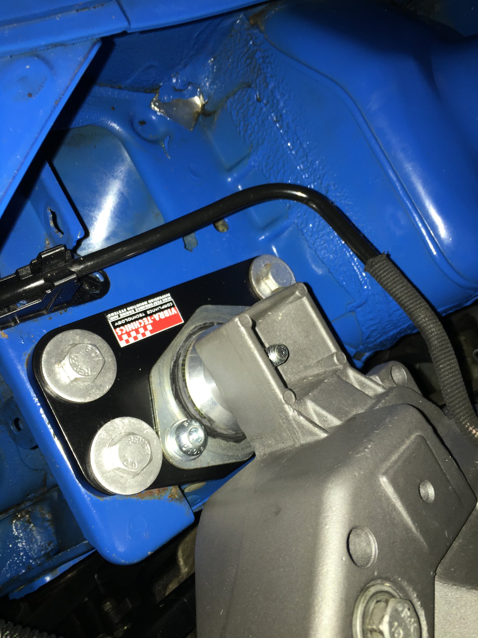

Fitted my engine mounts however I struggled to my nut that low, there is only a small amount of it catching but I can't seem to get it any lower:
The cam side engine mount went on easy.

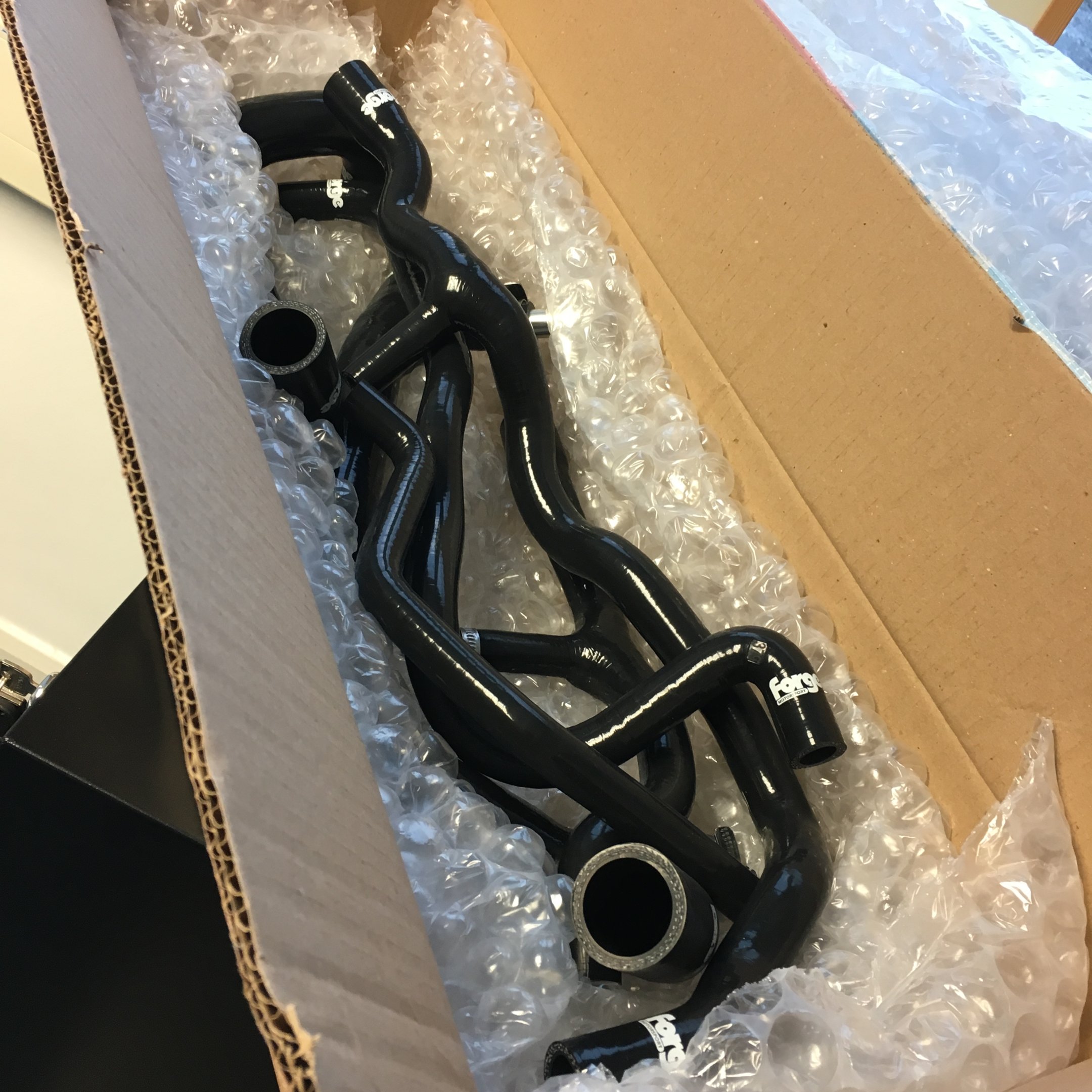

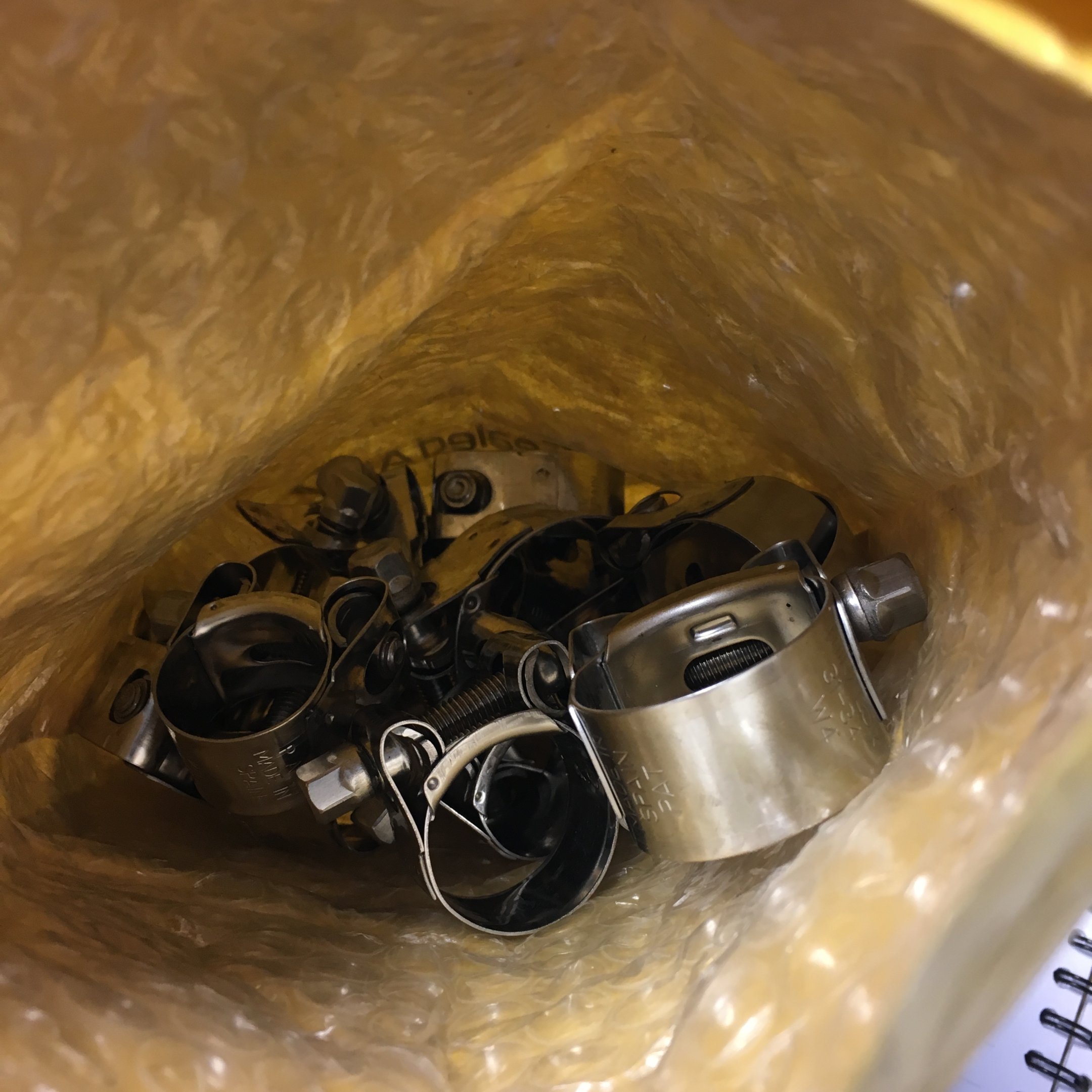

As some of you may know I had an issue with my Forge hoses, the connection section by the heater matrix was much longer than other people's so I had to cut them to fit, I had to take a good 5cm off between the two hoses.

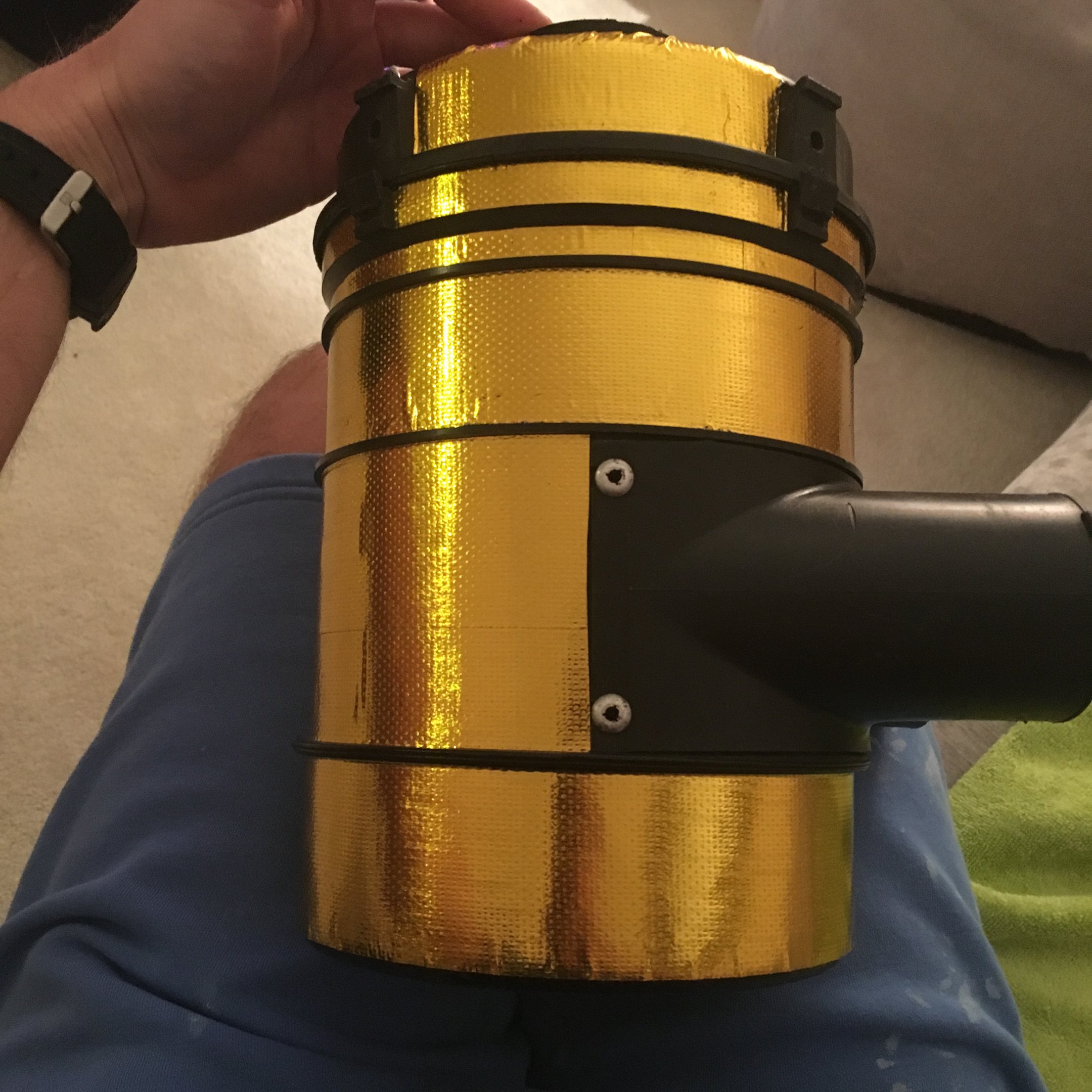

I then decided I liked the idea of wrapping my air box with some "heat reflective tape"
Fitting the new rad:
Rad in position:
All back together:
I took it out for a quick spin on Saturday evening and all appears good, I had a slight coolant leak from the bottom radiator connector where I hadn't done it up tight enough, I'v used the more expensive Mikalor clips but I'm not sure they grip as well as decent jubilee clip (just my view) so I may flush the coolant out again in a few weeks and change the clips to jubilee items.
Anyway the good news is that it drives fine, the clutch started to make a funny noise when the peddle is depressed (like you can hear it slipping) but as said above hopefully I'll get the EPAS column fitted and working this week.
I then want to give the Clio an oil change and then it should be ready for 2018!
Jekyll
Great stuff mate. The gearbox mount can sometimes be a right pain. As you said, the engine mount is easy!
