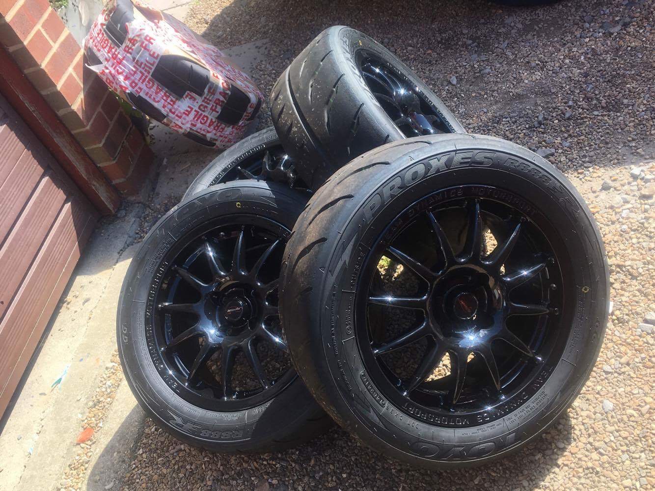

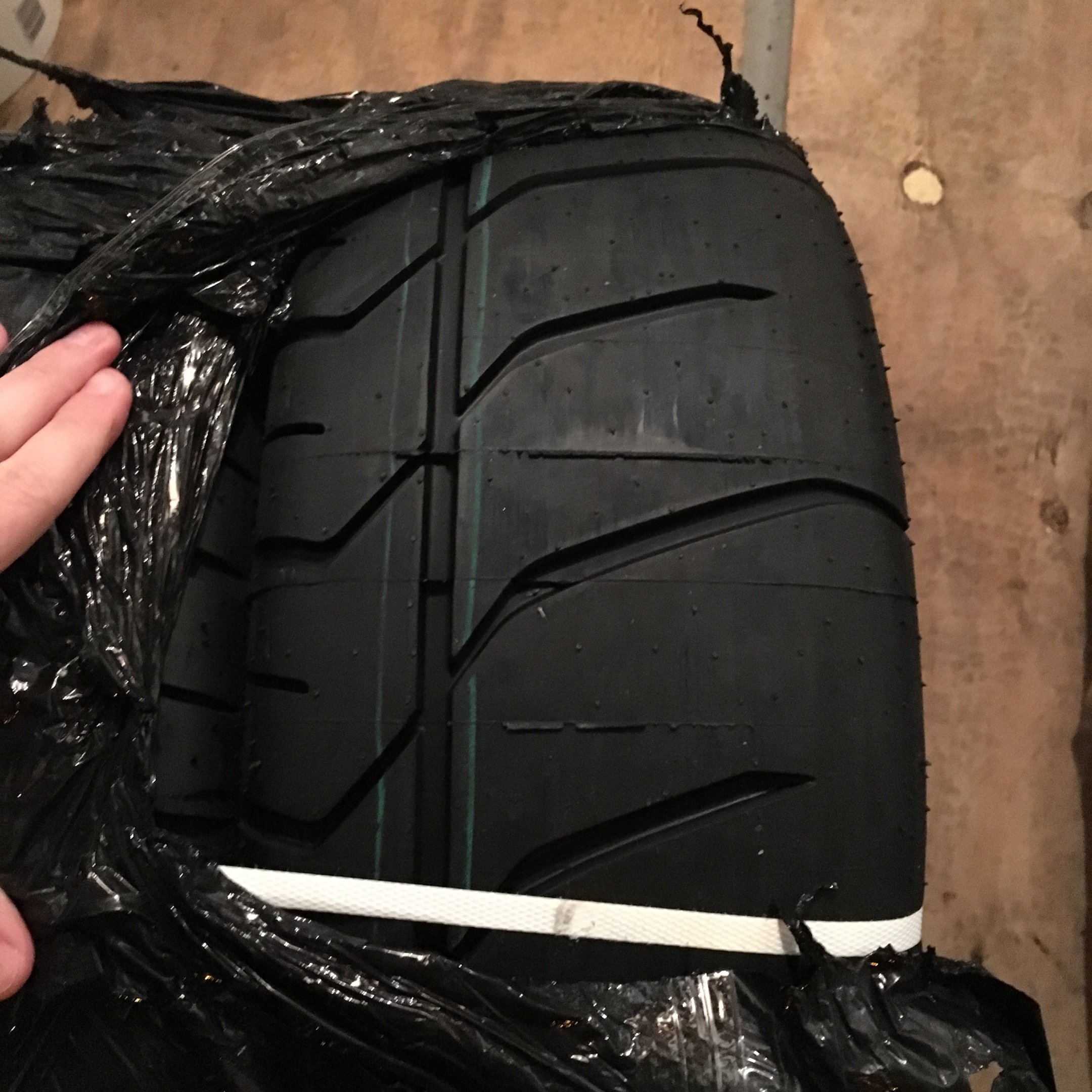

What tyres did you get for the 2118s?

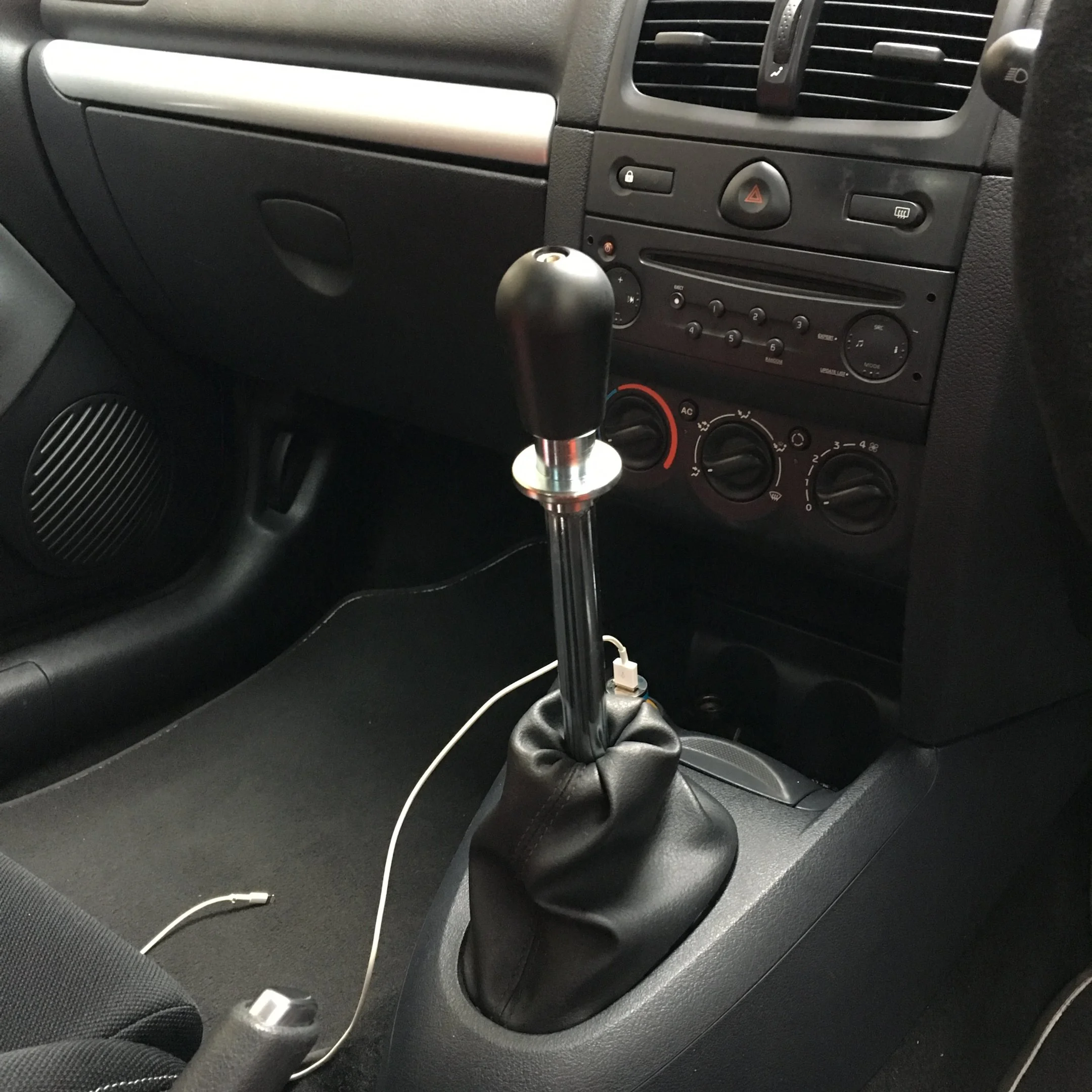

Also, what's the indifference on thoughts regarding the PMS shifter?
I ordered Extreme VR2 S2 I believe @GrahamV182 is running them and from what I've read seems to like them. They should turn up any day.
Regarding the PMS Shifter, its grown on me however when I first got it I wasn't keen. It took ages to set up and get into a perfect position and the adjustments were so small it all seemed a little bit too fussy. In addition to this i had a loud vibration noise coming from the shifter which unfortunately appears to be something I will have to live with. Its not as bad as it was when we first fitted but it still loud. I will upload a video. In addition to this I couldn't initially see any benefit but it has grown on me.

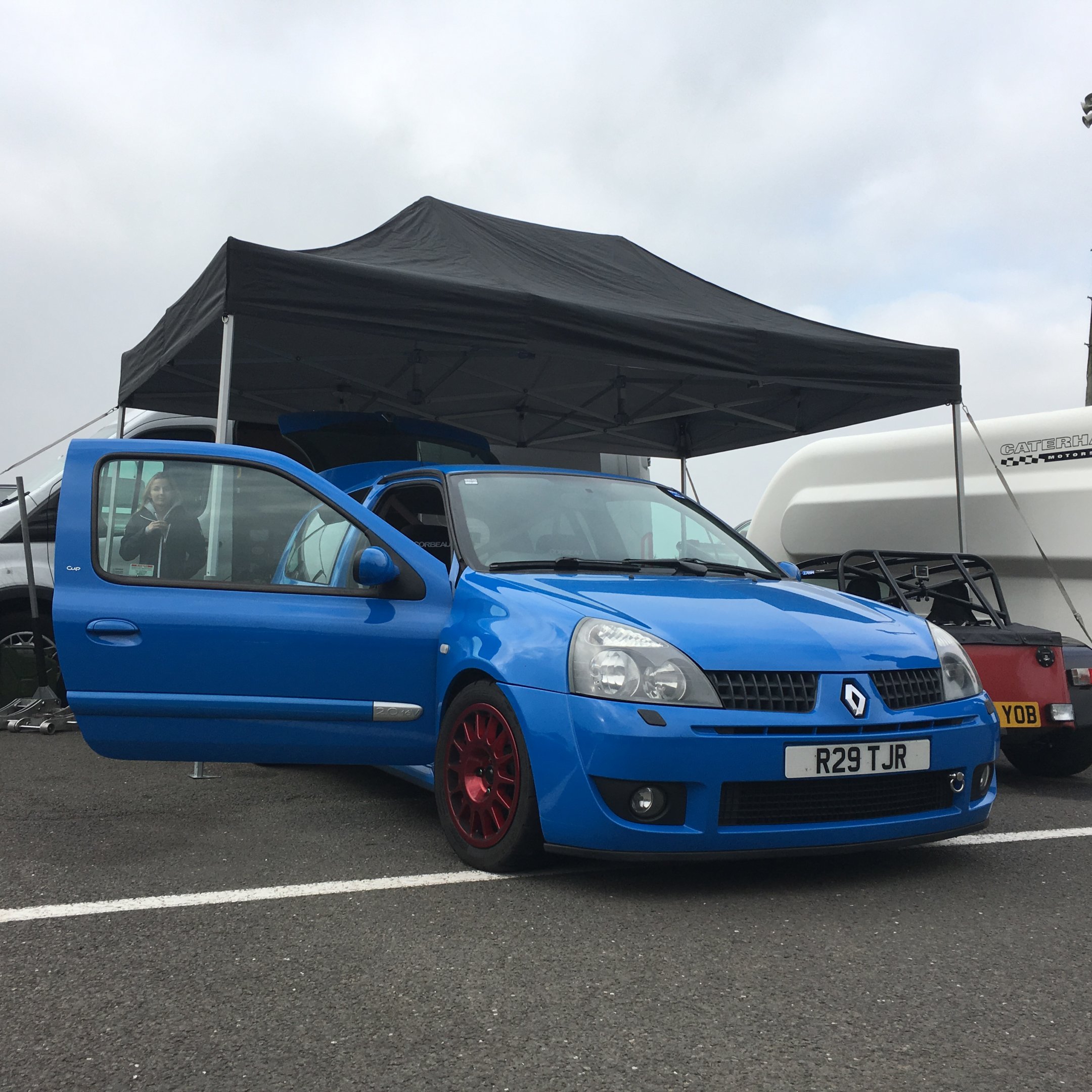

Track Day - Snetterton 16th August 2017 (Evening)

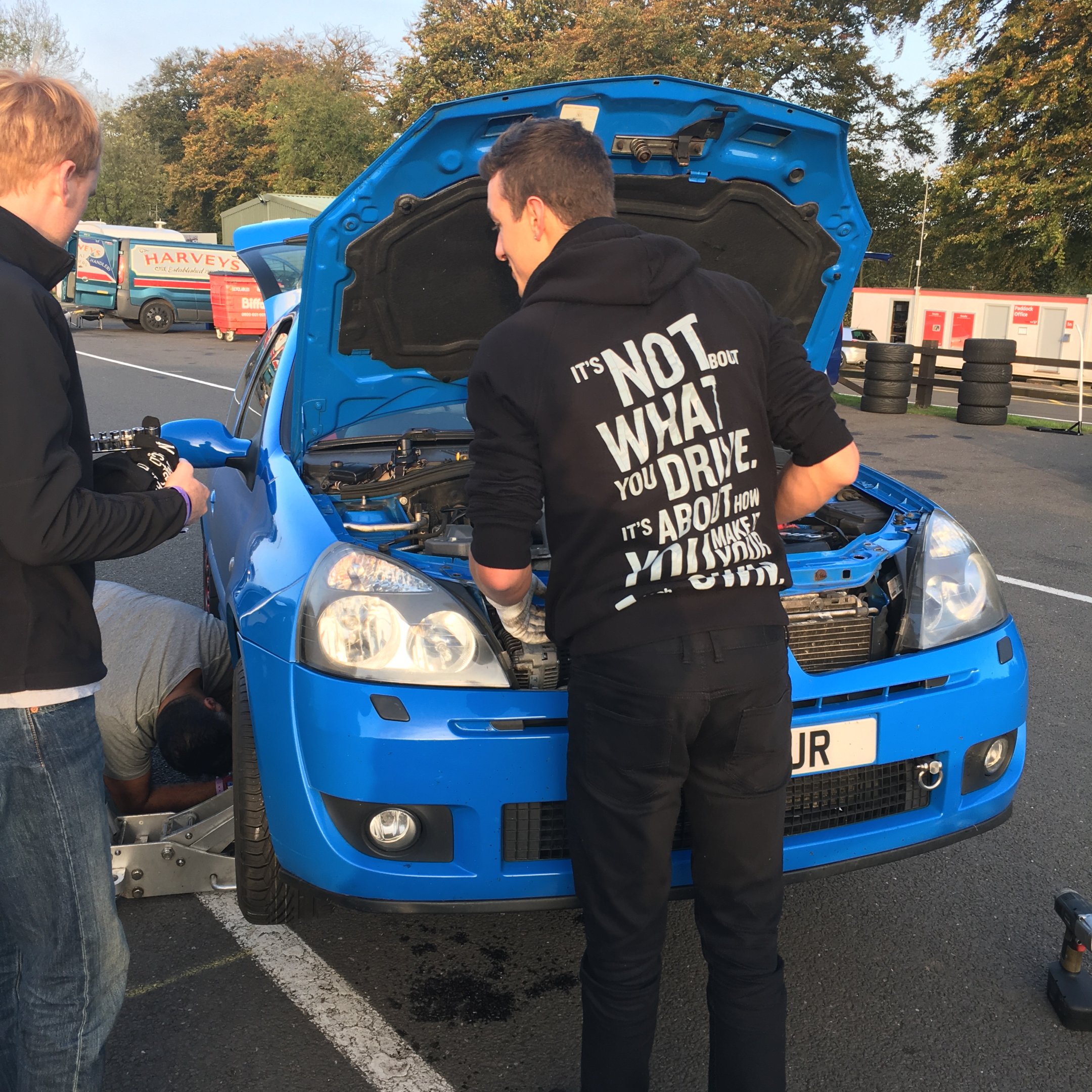

After around 10 months of ownership it was about time I actually used the car! The week leading up to the track day I tried to resolve a few issues:

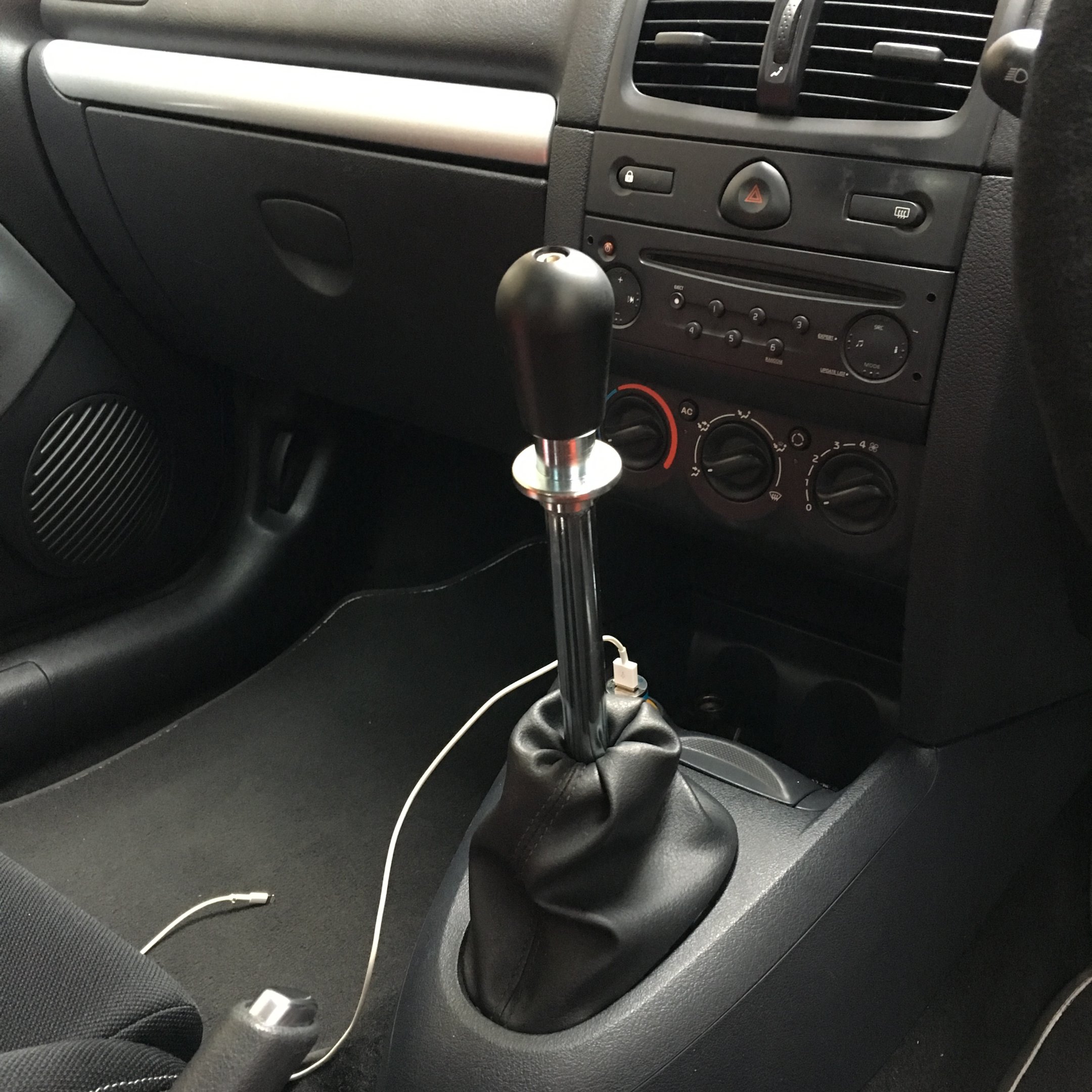

  • Try to reduce the rattle on the PMS shifter
  • Check alignment
  • Pack the car!

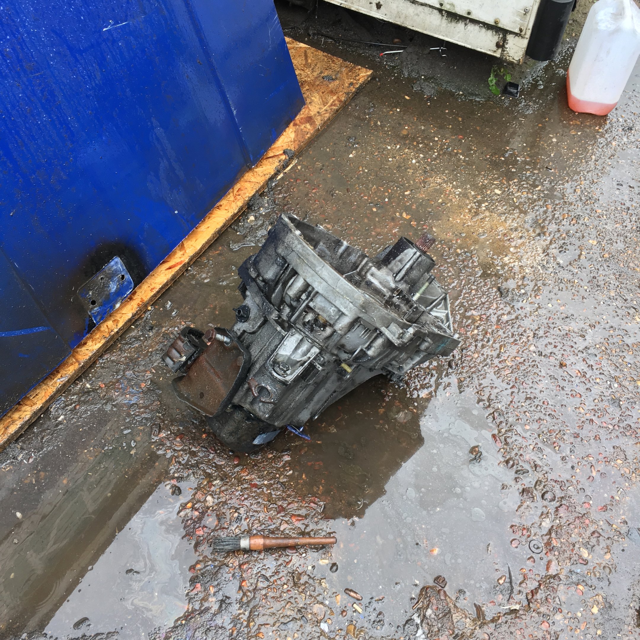

I spent a good few hours playing around with the PMS shifter and I just cant stop the rattle. Luckily it doesn't make much noise at cruising speeds. Below is a video to show what I'm dealing with, any idea's/tips on how to reduce would be great:
However the position and feel of the PMS has grown on me and I must say I am now totally sold, although reverse is still a bit of a pain, it does look cool!

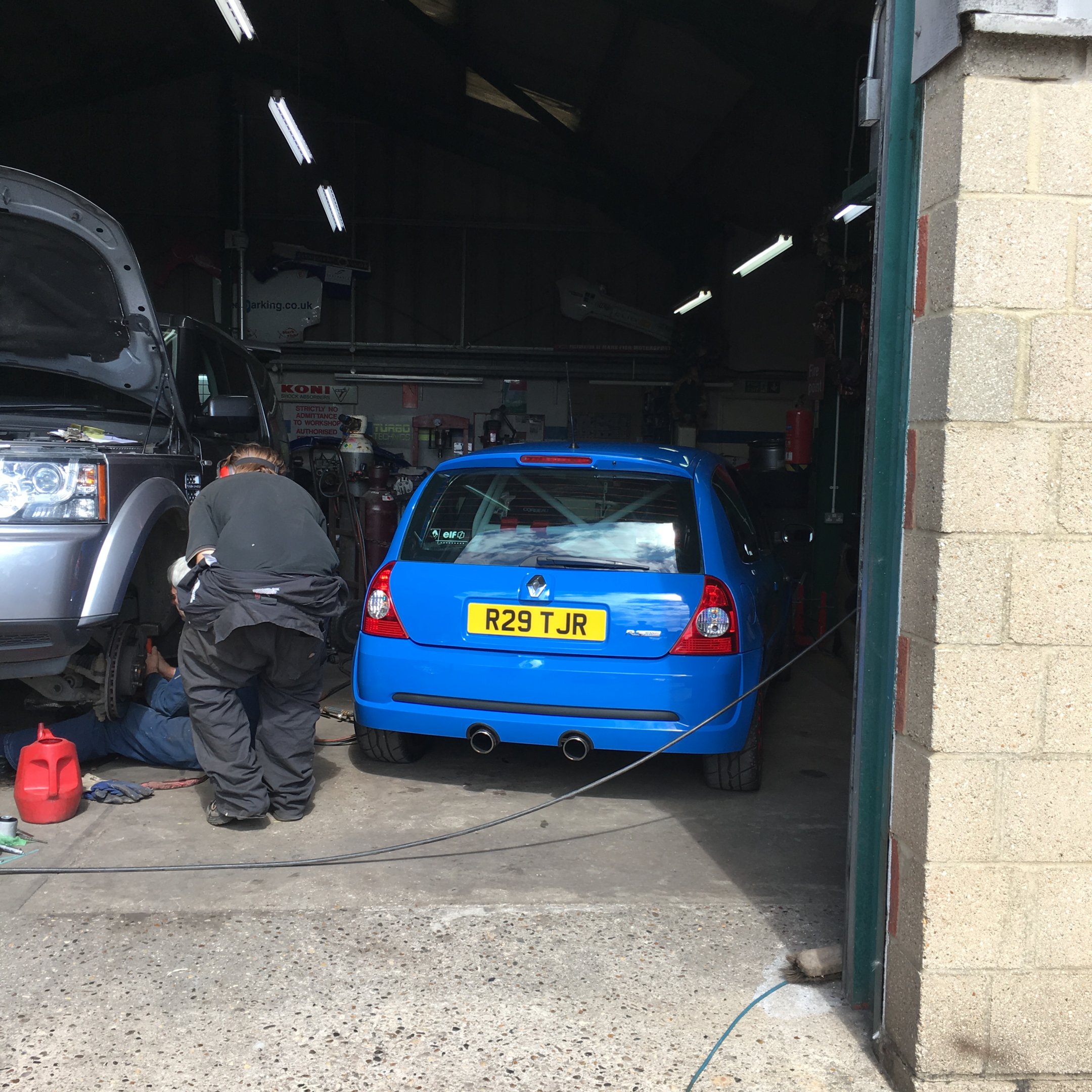

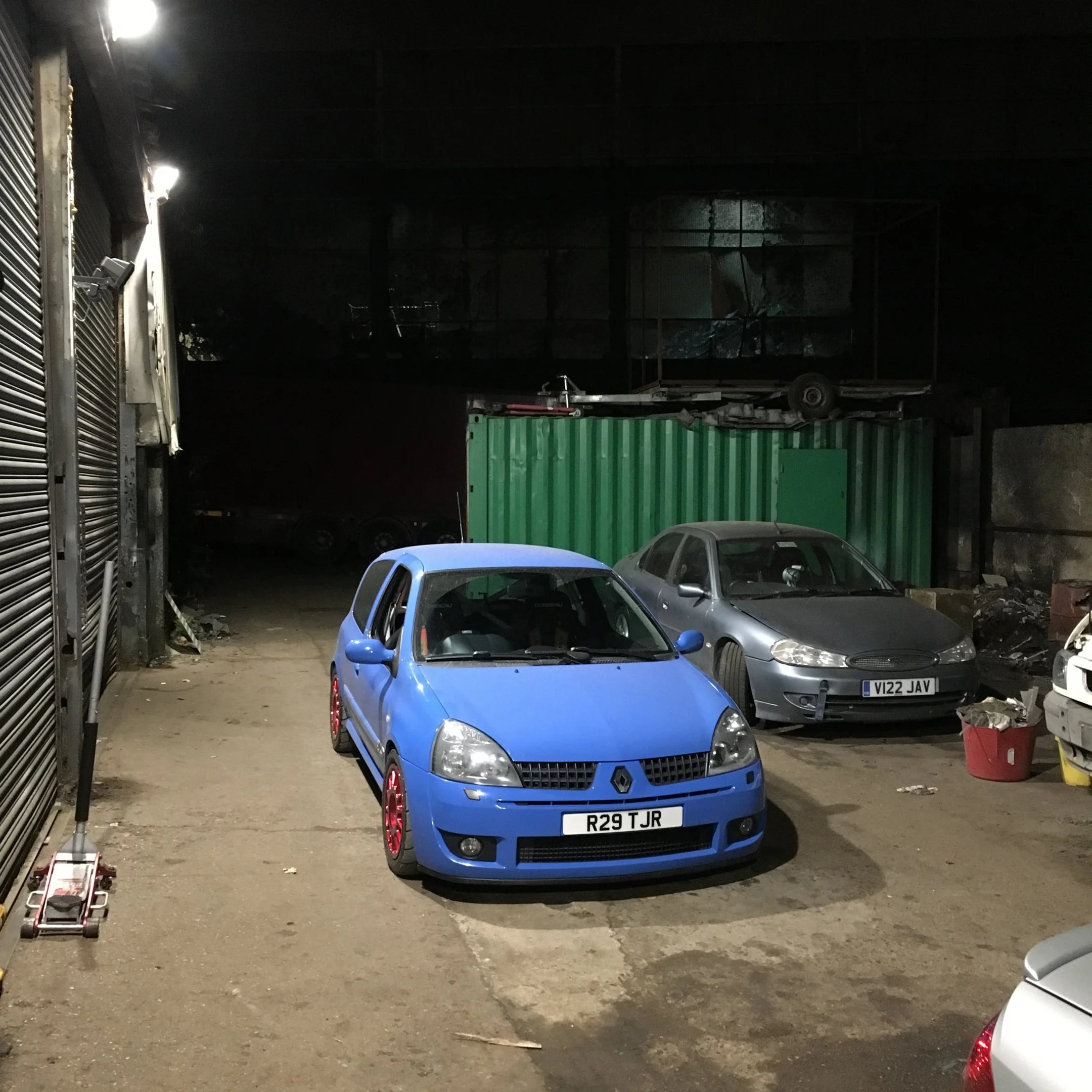

In my quest to resolve the rattle I popped over to Mark Fish Motorsport on Tuesday which turned into him checking the alignment, so a quick hour or so I was back on the road again:
He made slight adjustment to the Clio but there is definitely some adjustment require now that I've actually driven it on track.

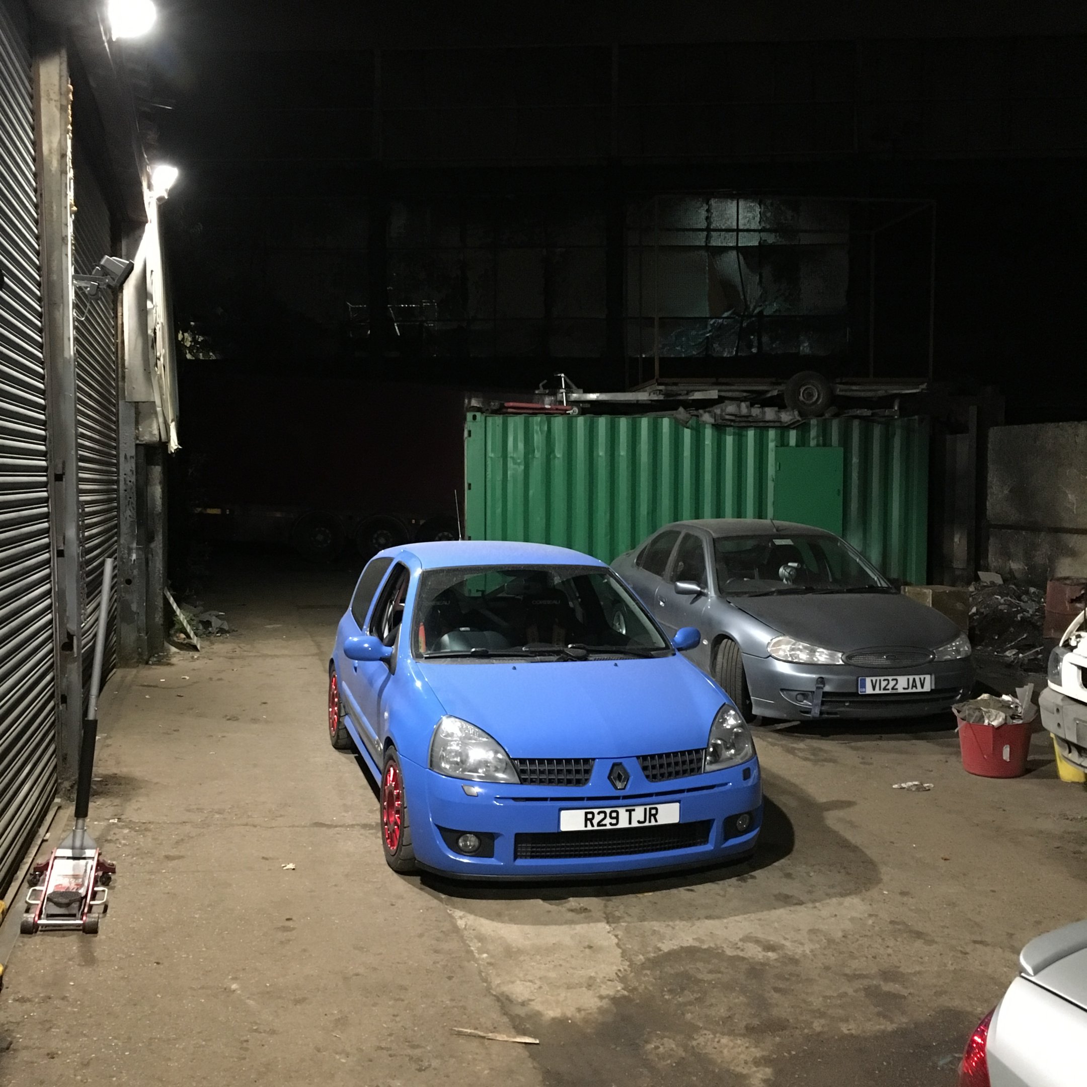

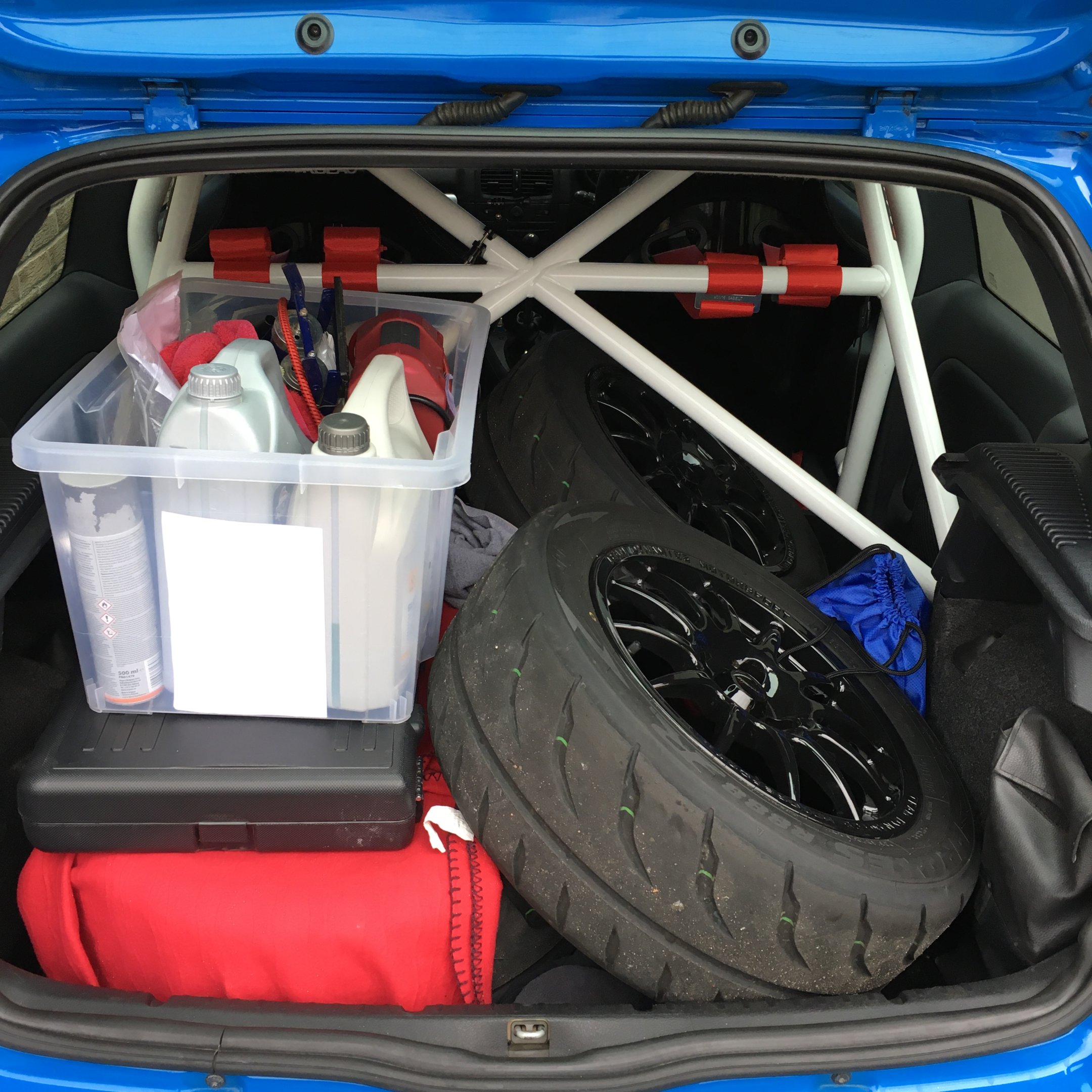

The track day was booked for Wednesday evening and on Tuesday evening I drove to Waterlooville (basically Portsmouth) from Essex, around 2 hours each way to collect a set of 15" Team Dynamics Pro Race 1.2's in Gloss Black. It was a set of 5 wheels with Toyo R888r tyres (205/50/15) with the 5th wheel & tyre being brand new while the remaining 4 are virtually brand new also.
I'm pleased as punch with them and it also means I can now sell my Cup Turini's, there is certainly no need for 3 sets of wheels!
I eventually got home around 10pm, I was planning on packing the car however I called it a night. I was up bright and early on Wednesday, as I had to pop into work until midday, so first thing I go all my items together, its amazing what you can fit into the back of a caged Clio (4 wheels, 200 piece halford tool kit, two helmets and an array of fluids etc):
So around 8 (M3, caterham, 135, Fiesta, MR2, Morgan, Civic) of us left Essex around 2pm to get to Snetterton in plenty of time and I quickly went about fitting the TD's however the slightly wider 205 tyres rub badly compared the the 195's on my 2118's. I did the sighting lap with them on (forgot to take a pic) but they were quickly removed again. I therefore need to review suspension/arch liners/brackets to see what is catching as even the 195 are rubbing. I did read online about moving the bumper brackets but I'll look into this next weekend.
The drive down:

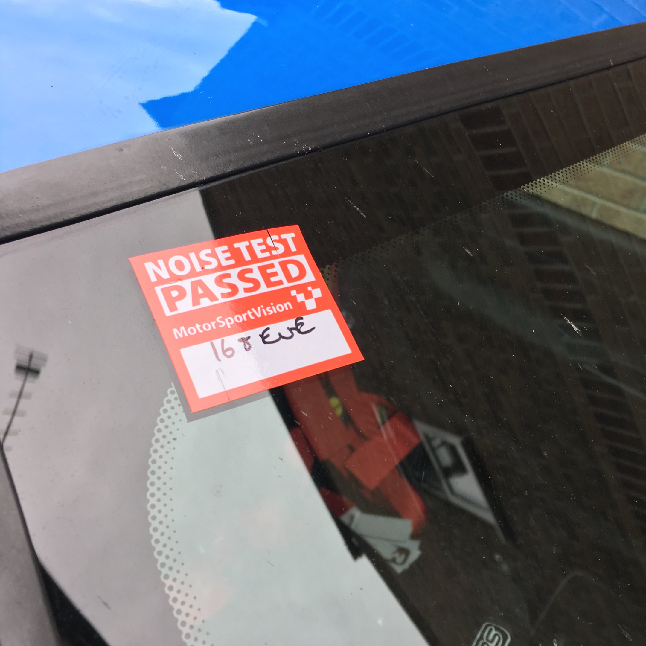

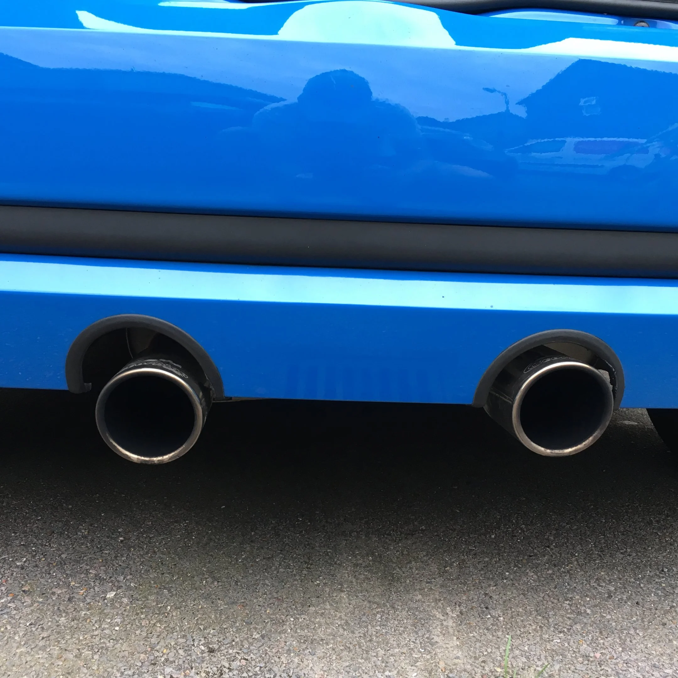

Noise testing:
The car was recorded at 98dB which is louder than I expected, however it passed fine.

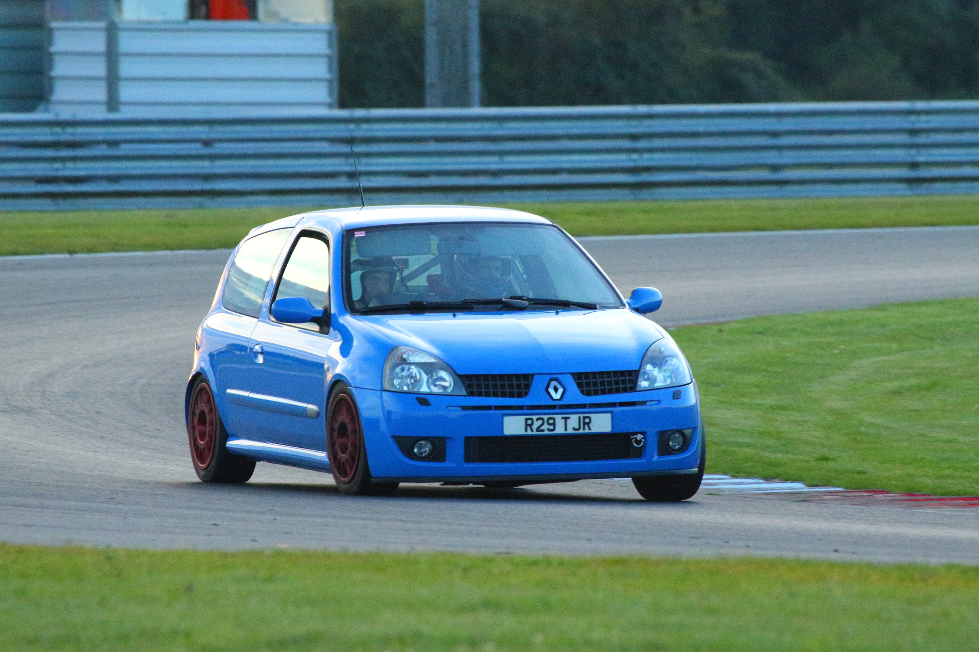

I don't actually have any pics of my on track yet however I do have some GoPro footage from inside the car and I have a few pics I've ordered online. Overall it was a great first time on track in the Clio. I have a lot to learn about how the car drives and it made me notice how the car currently under-steers (as called by @Scrooge) , I really struggled to get the back end out even if lifting off mid-bend.
It was a great evening and fantastic value for money. The Clio didn't miss a beat all evening and I was on track for a long time. The only casualty was the exhaust hanger finally gave up and therefore I melted the exhaust surround, so I'm after a new pair of these also!
I'll upload the professional pics and GoPro footage hopefully later this week all things being well.

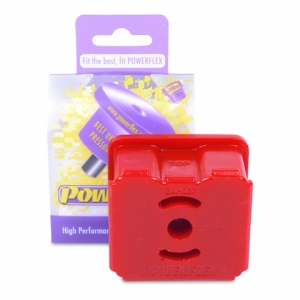

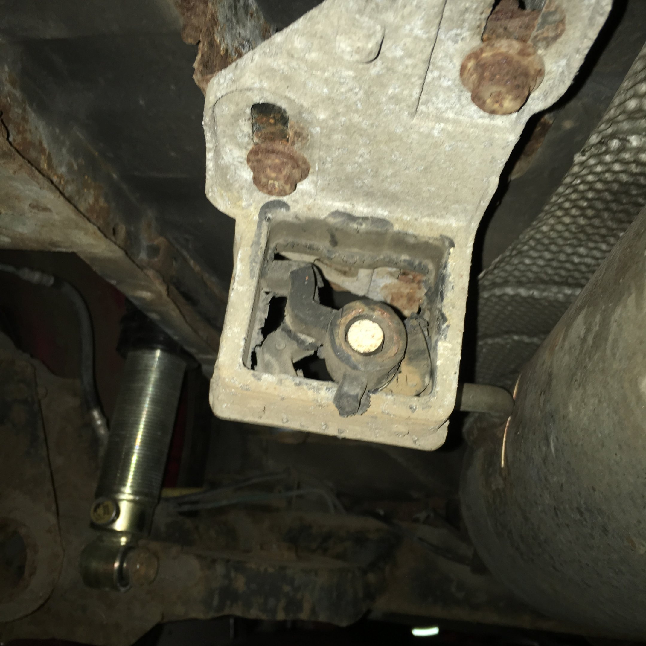

Good write up Tom, I have the powerflex black exhaust hangers on mine but you would probably be better with the red ones.
I was surprised when the noise test came back as 99db for me, Its normally about 89db for me!

@a17vts I have 2 brand new exhaust hangers if you're interested?
Glad all went okay!
Interested, I'll drop you a PM.

I was massively surprised at my noise test results. Next time I'll just hold it a little lower!
Agreed, I think black will just rip a hole in my exhaust!
My PMS rattles like that, like you say not all the time but still... I read somewhere, not sure it was on here that someone had put sand in the linkage between the bottom of the shifter and the gearbox and that made a difference. PMS also sell a weight that is supposed to help, although have heard varying reports that it still does it but just at a different RPM rather than getting rid of it. Out of interest how much did Mark Fish charge for checking the alignment? Need mine doing ideally and looking for somewhere to take it! Glad the track day went well :up:

  2. New exhaust mounts.

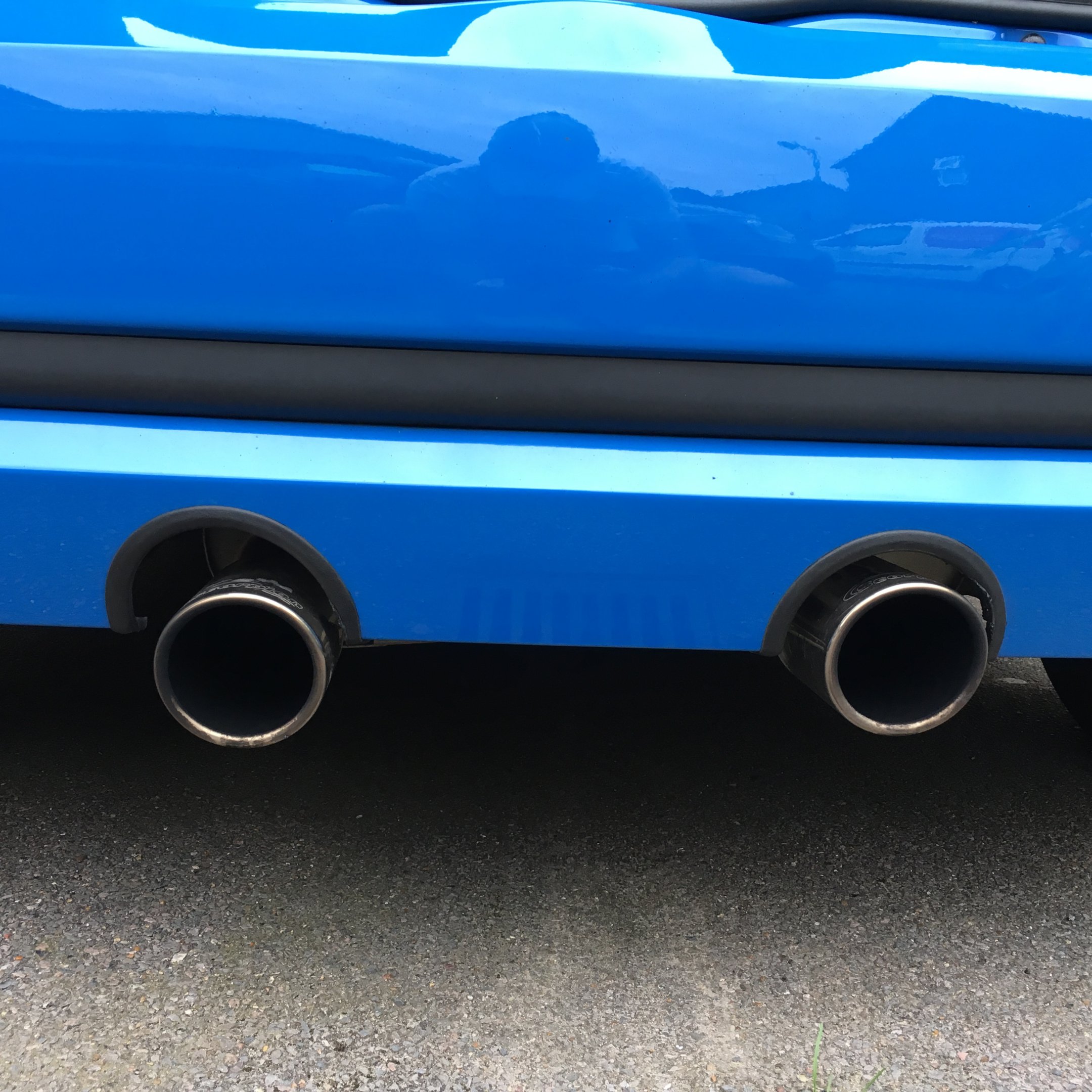

Exhaust mounts
After the issues at Snetterton I was in dire need of new exhaust mounts. After a bit of research I decided to order the Powerflex (red) exhaust mounts and a standard middle mount. The Powerflex items weren't cheap at £20.00 per side but hopefully they'll get the exhaust in the right place and hold it there.

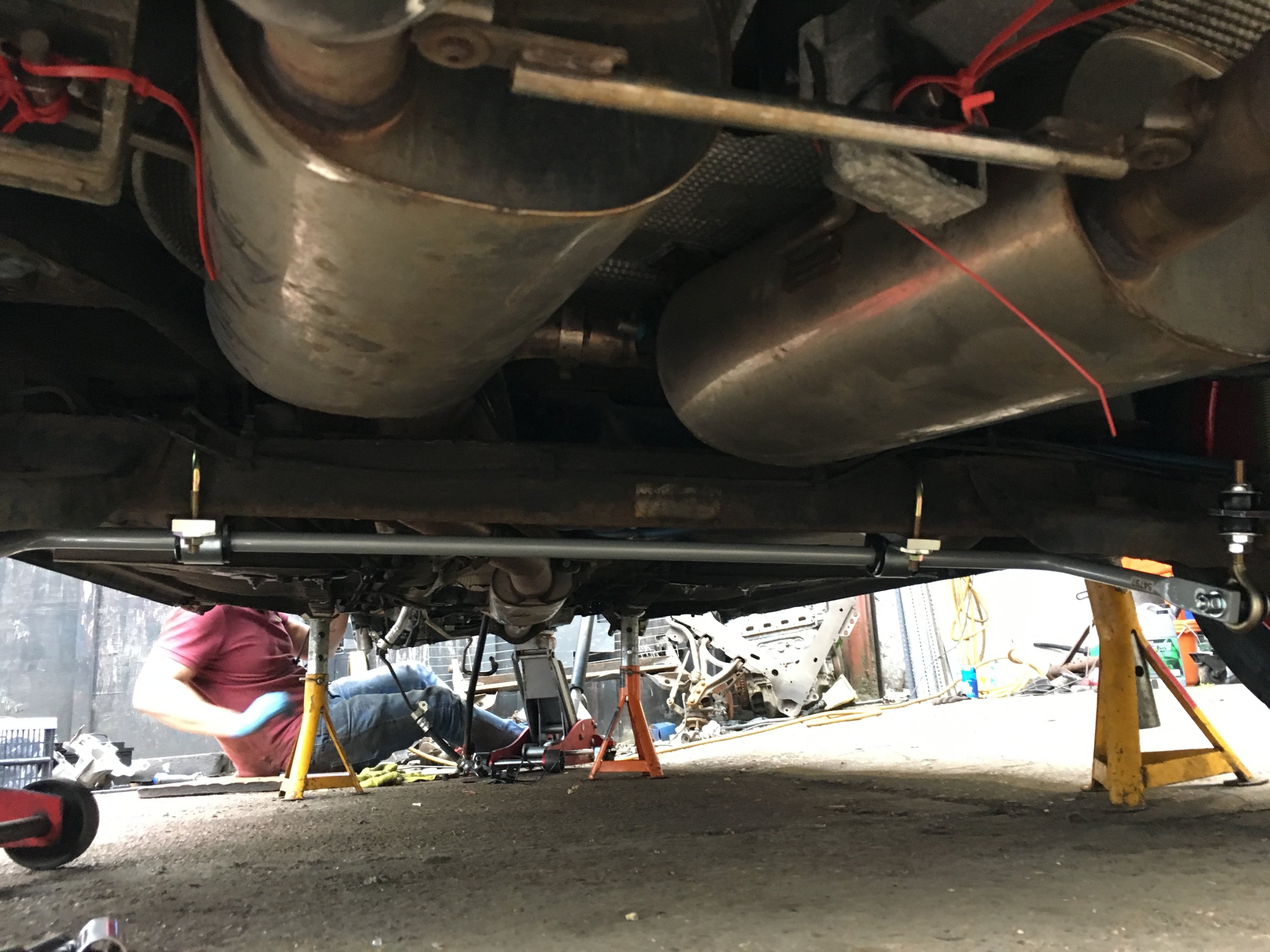

Rear Anti Roll Bar
After a bit of research I've read that a rear anti roll bar may help with the understeer so I'm ordering one of these tonight. I'm going to order the Whiteline ARB from KAM racing. While I'm at it I also plan to order new front anti roll bar bushes as I noticed these have started to wear.
I'm hoping once I've got this fitting I'll pop back to Mark Fish and get the set up however I'll want to resolve the rubbing issue prior to this.

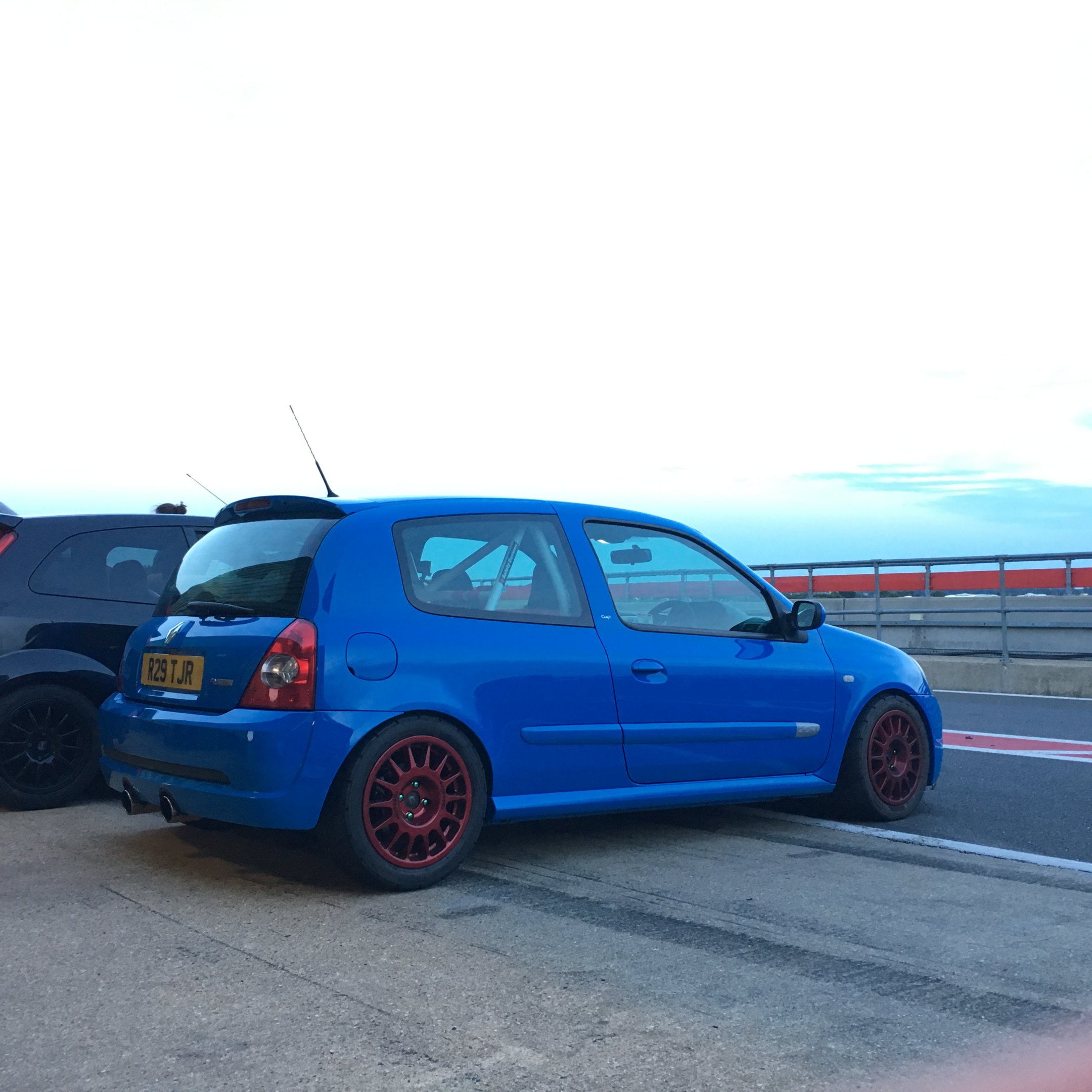

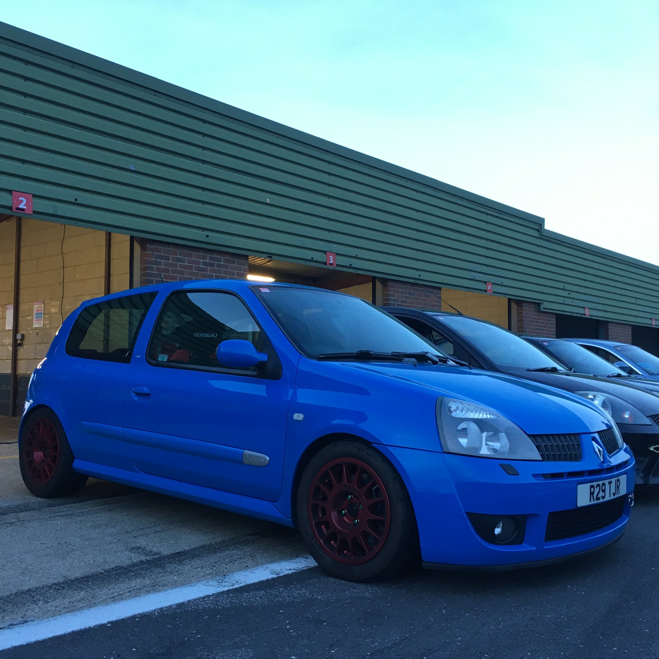

Finally a quick couple of pics from Snetterton the other night:

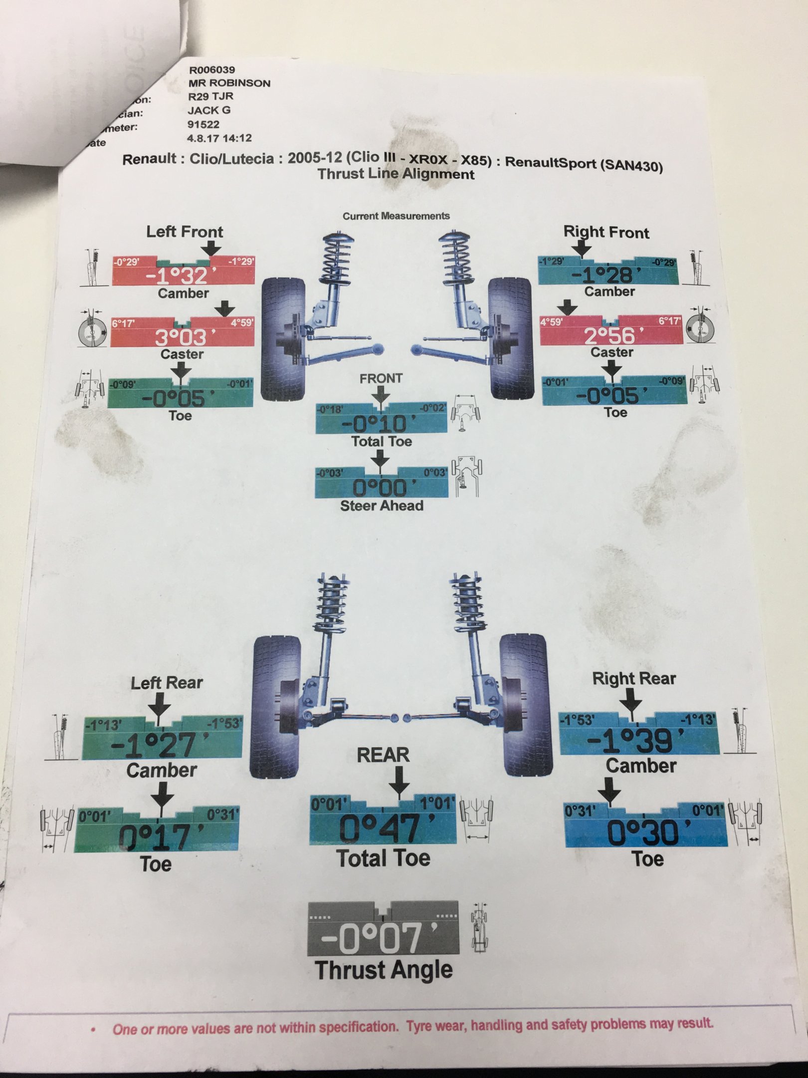

What geometry settings have you got mate? Also to reduce understeer, try trail braking. It'll bring the back end into play more too.
This is the current set up although I think the toe has been slightly adjusted since but nothing major:
I'm aware its a relatively standard set up but any pointers would be great.
Thanks for the tip regarding trial breaking, its not something I usually do TBH however I did try it for the first time the other night after a suggestion from a friend. It did seem to help but the understeer remained although not so prominent.
Front set-up looks okay to me,
Maybe a bit less toe-in on the rear? Others may suggest otherwise.
Ok we have a starting point! Right next question is what suspension setup do you have? Springs and dampers, or coilovers? If it's the latter, do you know what the spring rates are? Are they adjustable?
With that info I can give you a pretty good starting point for where to go mate.
Thanks for the help in advance.
Setup is as follows:
  • GAZ GHA's (Front 350, Rear 250) adjustable (I don't actually know the full amount of adjustment but the rears are 8 down from full hard while the front are about 3/4 from fully hard)
Camber is adjustable at front while the rear is standard (no shims etc)
I hope that helps. Sorry I'm jo expert so any help would be great.
Well the spring rates ain't the stiffest, but we can work with it!
For a start, go full stiff on the rear dampers and about half way on the fronts. Take it out on track and see how you get on, but be aware that the rear end will now be significantly livelier than before. Too stiff? Drop it off 1 click at a time. Fronts are the same, so either up or down depending on what it's doing.
Camber could do with being about 2 degrees up front tbh.
Toe out on the fronts is fine. Don't go beyond 15mins toe out though as you'll start to kick f**k out the tyres.
I'd be tempted to leave the rear end geo until you've got a better feel with the car mate.
Getting a setup to suit you will take time, but that listed above will give you a good starting point.
Going stiff (easy!!) on the rear end is what the clio chassis loves.
Great, thanks for taking the time to respond.
I can easily change the spring for not a lot of money so I can look into that in the future but this should hopefully give me a starting point and I can work with it over time. I appreciate getting the suspension "correct" isn't a one answer question.
Thanks.
Oh I totally forgot to mention the fact i'm running H&R (DRA Bolt to Hub) 20mm spacers at the front @NorthloopCup
No spacers on the rear.
Not sure if this will make any difference to your synopsis.

I'm not a fan of spacers personally mate as it throws the scrub geometry out too much on the 1*2's. I'd go no more than 10mm, 15mm at a push up front personally.
I agree about spacers, I didn't want to run spacers however the tyres would have rubbed on the coilovers without them.
I'm running 2118's in a ET38 offset. I only used 20mm as it was the smallest bolt to hub spacers I could find. Would you suggest running nut & stud and a smaller spacer? However I was under the impression (maybe incorrectly) that bolt to hub would be "better/safer".
I just remembered why I though bolt to hub etc would be better (well just read it on PMS website) basically you require at least 18mm spacers to clear the current center ring. Therefore does the additional 2mm make much difference?

Some more Snetterton pics (not sure if these help @NorthloopCup):

  1. Rain!
  2. Rusty subframe bolts
  3. Rusty/broken power steering pipes
  4. Broken clutch components ("brand new" valeo unit)
  5. More rain!
  6. Steering wheel column not connected
So basically had a few shitty weekends on the Clio but I can't thank @Scrooge enough for all his help, he's been amazing :up:

After a slight misunderstanding from Extreme Tyres I've finally got hold my my VR2's. All going well they will be put on my 2118's tomorrow afternoon and this weekend I'm at Cadwell so will be able to report back on there performance. Most importantly the thread pattern is cool! :cool:

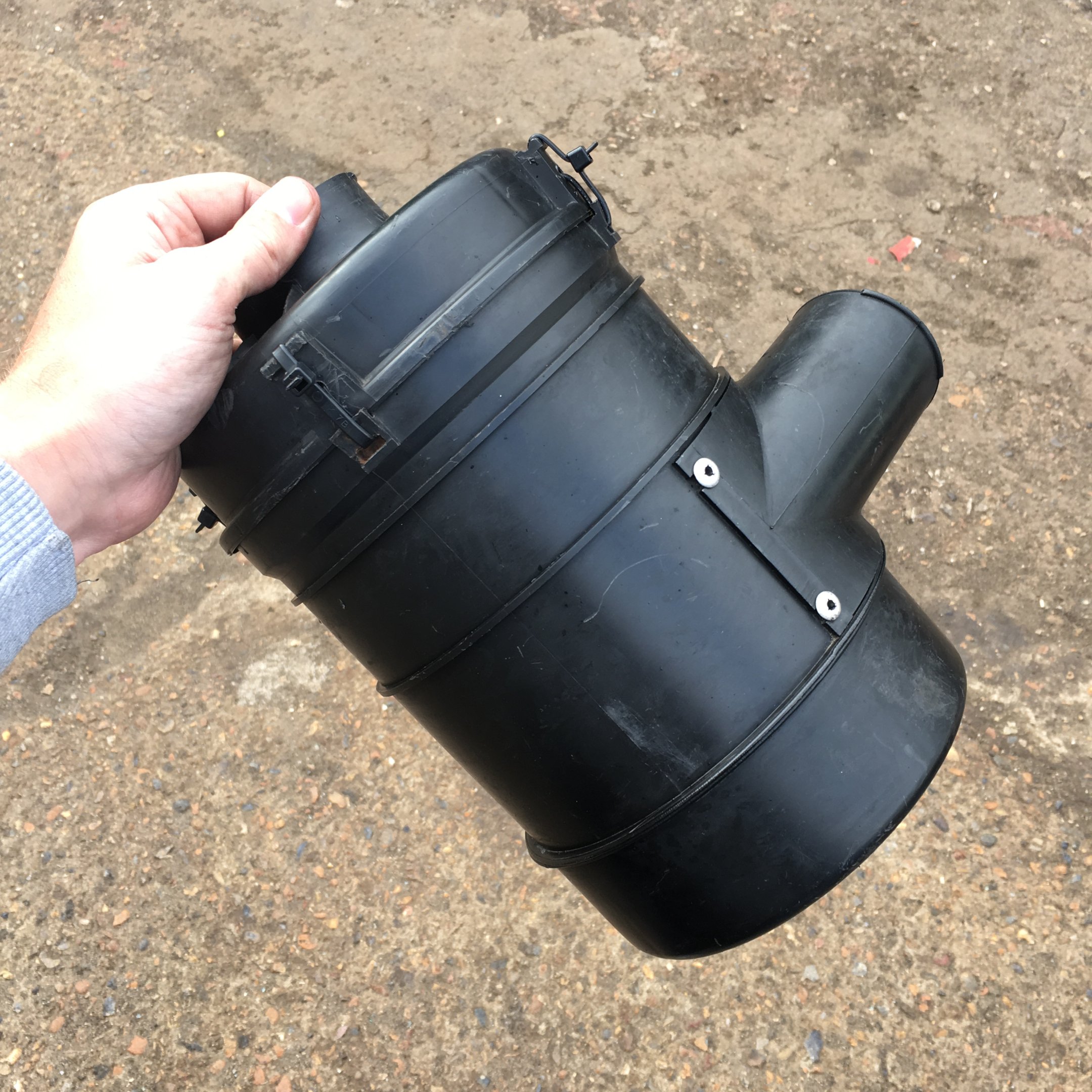

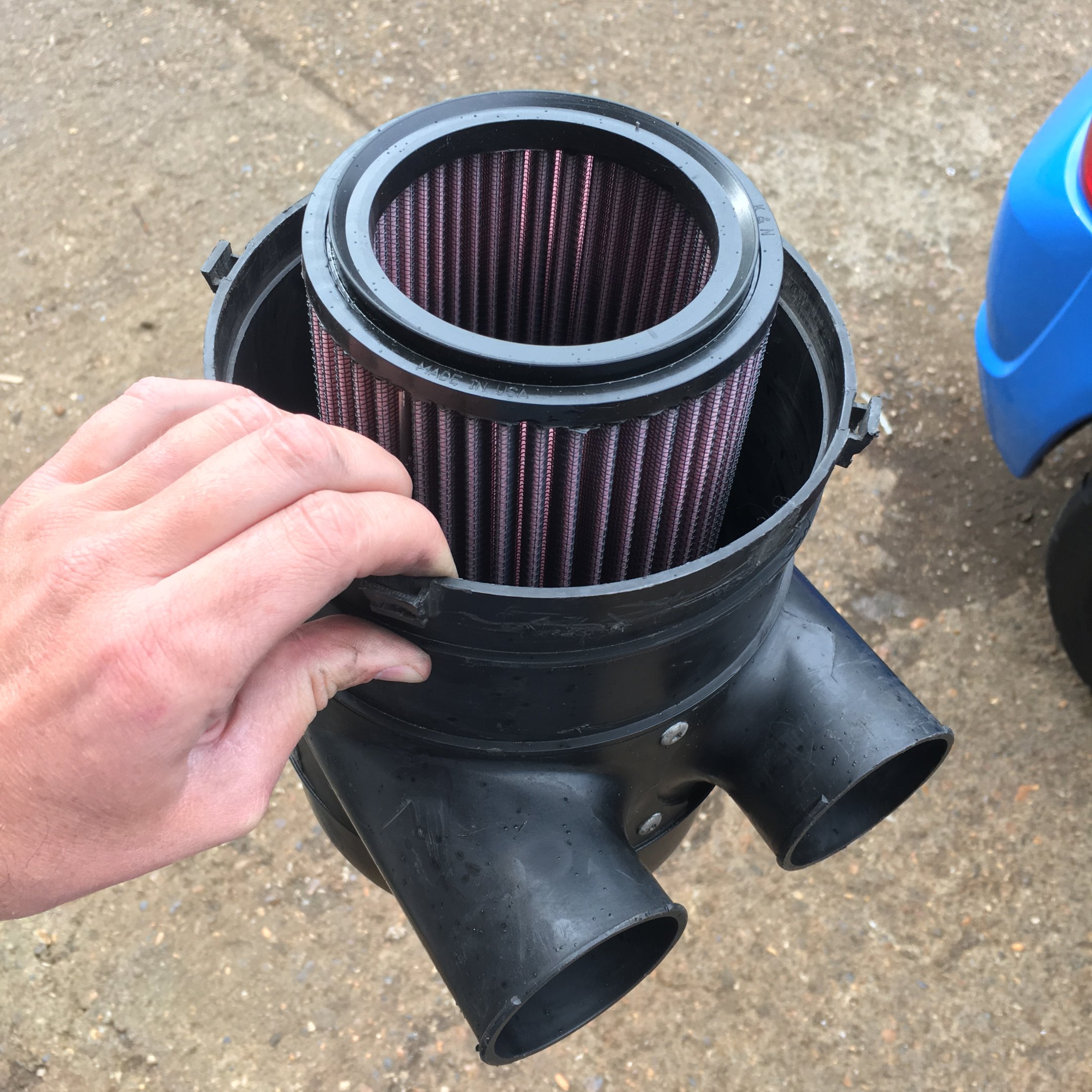

Again I had a few issues with air filters, I ordered one which was out of stock and then got sent a standard one in "error" so I then purchased a K&N item direct which arrived next day so quickly got to fitting it:
Cables ties FTW!
Whilst on the easy jobs I fitted my Whiteline rear ARB, only took two weekend to finish! Nothing to do with it being hard just me! (ignore cable ties they are used for positioning)
I've put it on its softest setting and again I will be able to report back after this weekend.
So here come the shitty jobs!

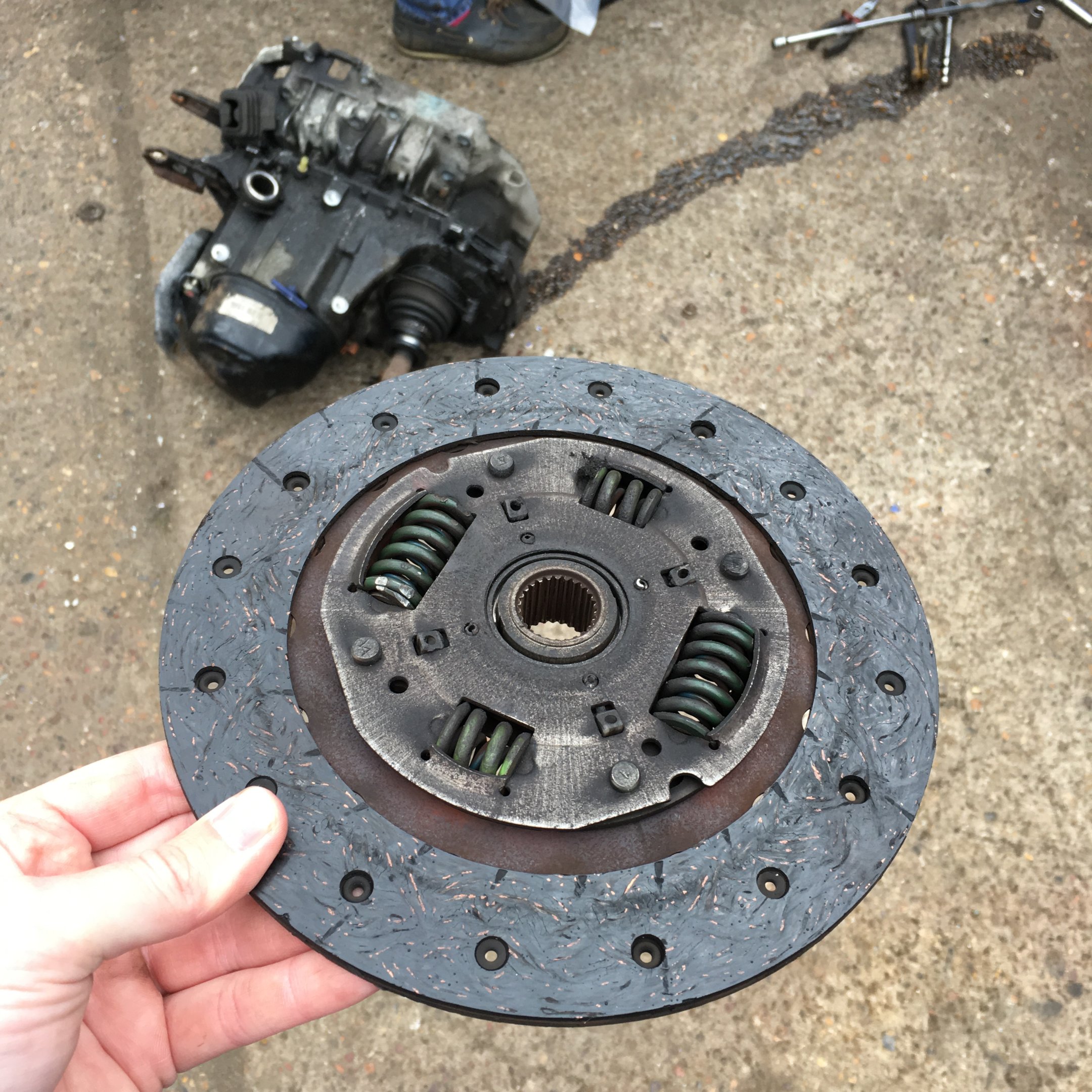

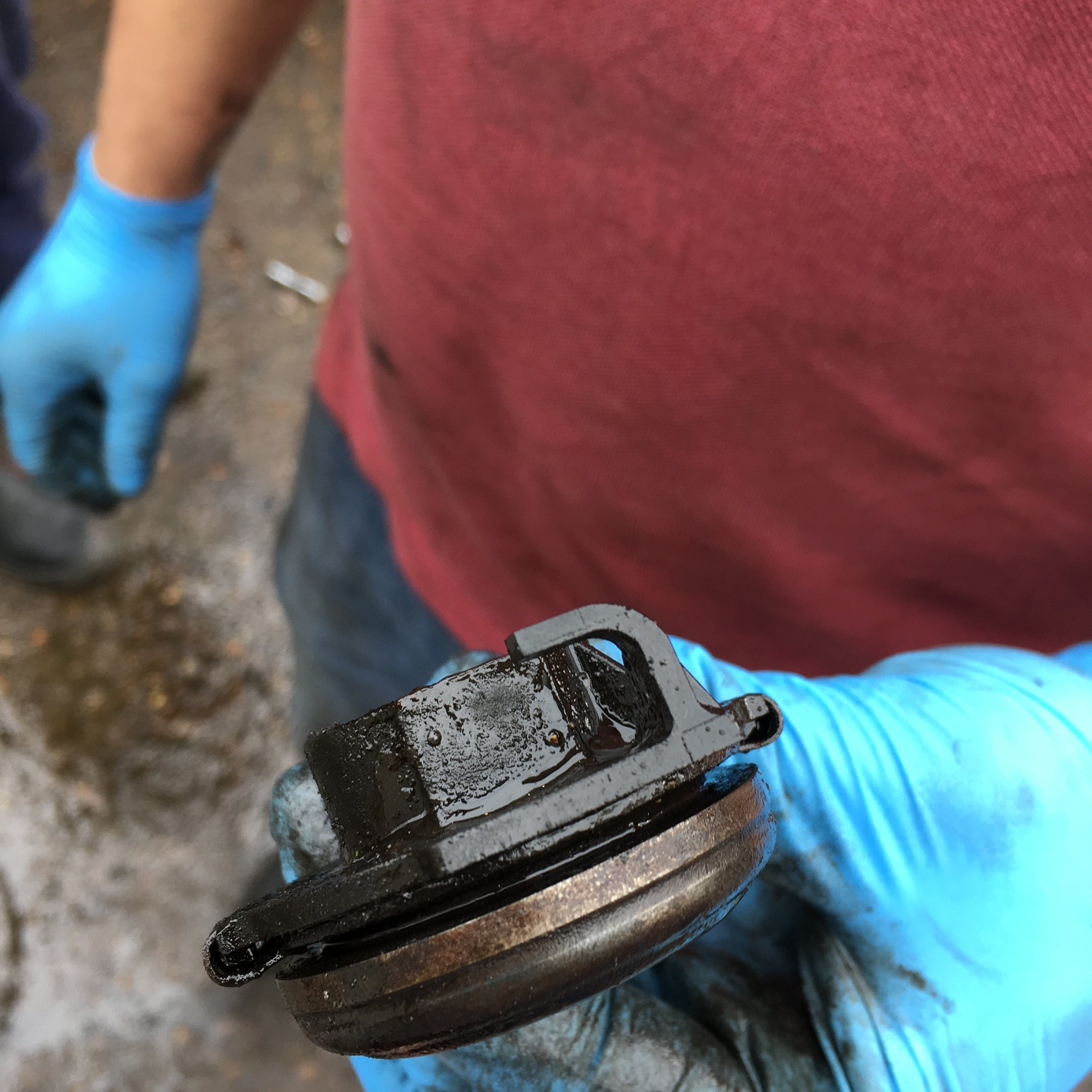

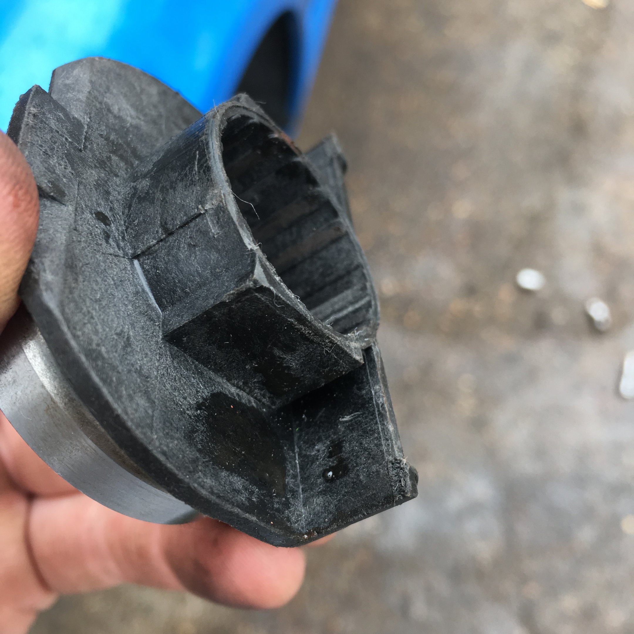

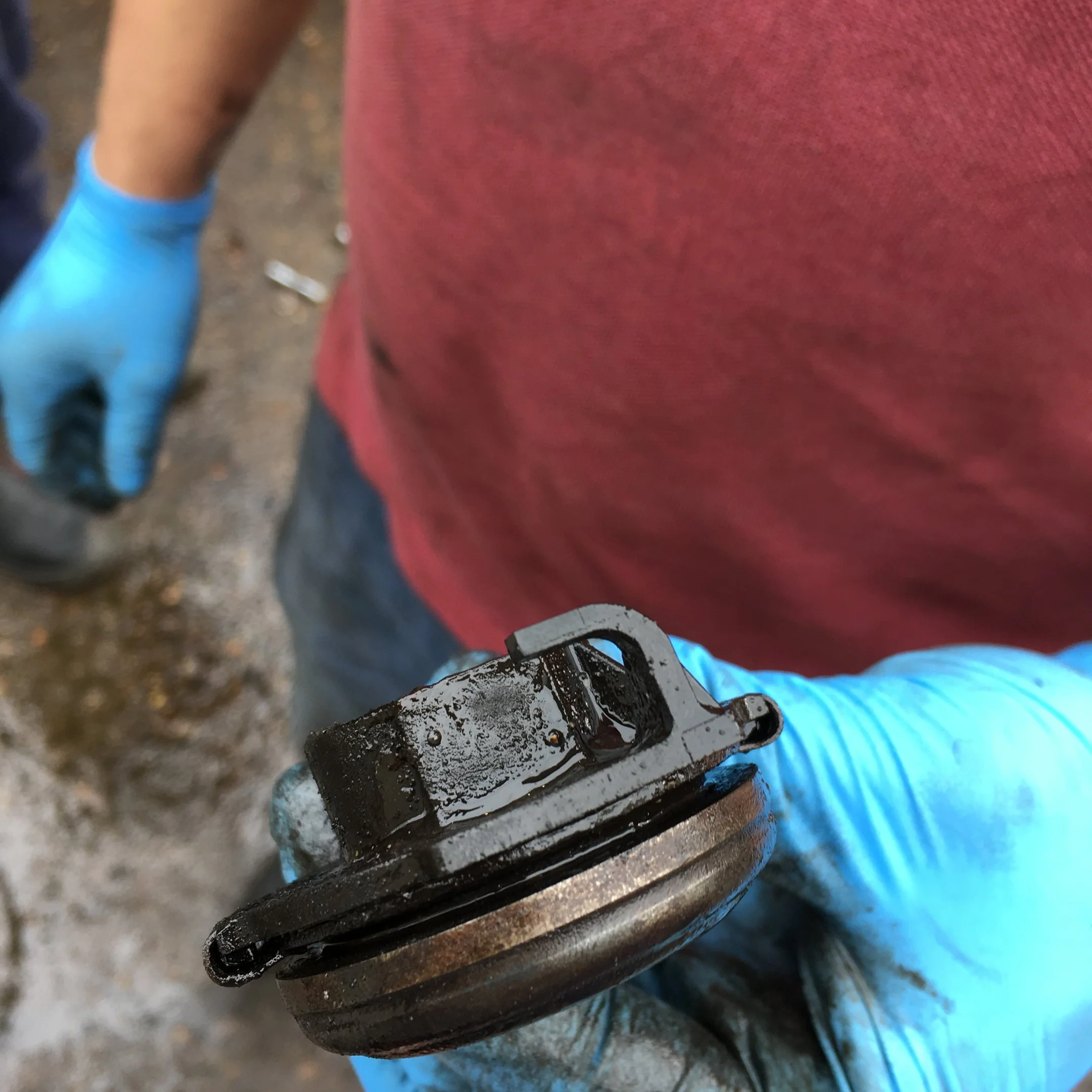

Firstly I ordered a Valeo clutch from eBay (a company with lots of feedback and sales of this unit according to eBay) and upon arrival I believe the part was an old unit and to make matters worse the clutch release bearing was broken. The two positioning clips were broken clean off:
Original Part:
New part:
You can see at the bottom where the original clips should be positioned, unfortunately we found this out at around 2.30pm on a Saturday so had a nightmare finding a replacement, after a good hour we eventually got held of one from GSF.

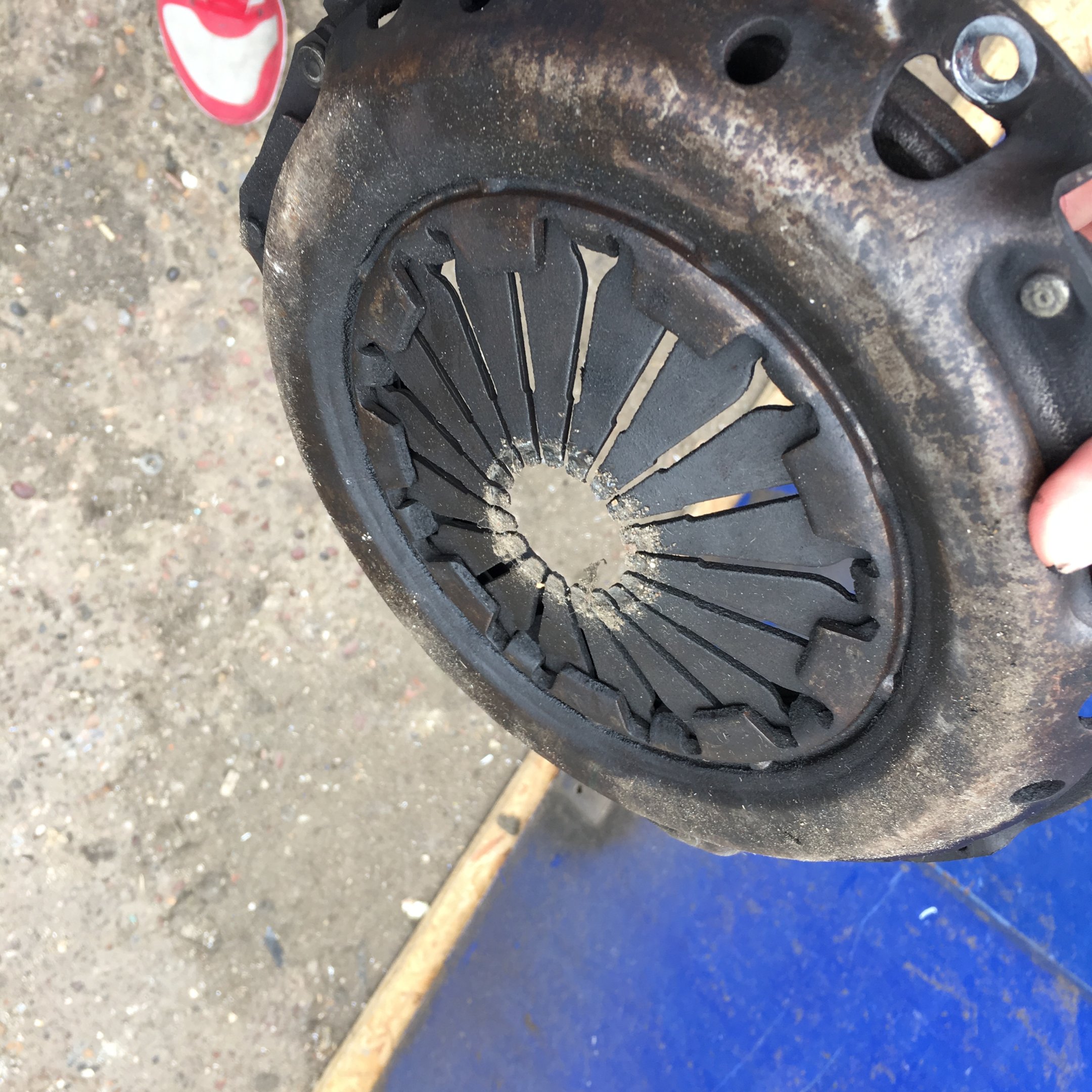

In brighter news the original clutch was from new and was in need of a change:
The clutch casing was also filled with oil from an earlier leak from the block which hopefully has now been resolved! But the gearbox was given a good clean:

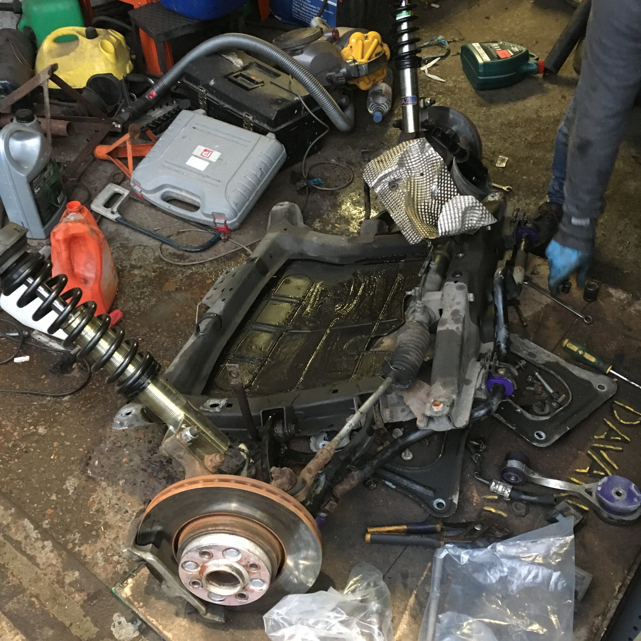

Finally the front ARB bushes were replaced with Powerflex items and new track rod ends where fitted (although not all in this pic):
So late on Saturday evening we got the subframe back on the car and all going well tomorrow afternoon we'll get it all back together again, so that tracking can be done ready for Sunday at Cadwell Park.
I also have the following to do before Saturday:
  • Fit Uniroyal Rainsport to my TD Pro Race 1.2's
  • Fit new VR2's to 2118's
  • Fit new exhaust mounts (Tiger Seal)
  • Tracking

Cadwell Park - Sunday 15th October 2017
Firstly I had an amazing day at Cadwell Park, by far the best track I've driven to date.
However the lead up to the track day it was a bit of a nightmare, but with the amazing help of @Scrooge the car was ready to depart on Saturday afternoon.
With Cadwell being a good 3 hours from home I decided to drive up on Saturday afternoon, stay at my sister's house who lives around 35 mins from the track, and then drive across in the morning.

A few pics of the Clio:

Not blaming this but it appears that my power steering fluid leaked, a friend in the car behind said I gave off a puff of white smoke just before the bend, which I assume was the fluid on the tyre thus causing the car understeer more than usual. No harm done so all is well.
Back in the pits it became clear the power steering pipe had leaked, right behind the alternator so a pain to get to. We therefore made a temporary fix to allow me to get home, however I still used 3.5l of power steering fluid on the way home and had to stop every 40 mins to top up the fluid.
Trying to fix the problem:

  • I need some rear camber, the inside of my tyres aren’t wearing at all, so will look into this over the winter.
