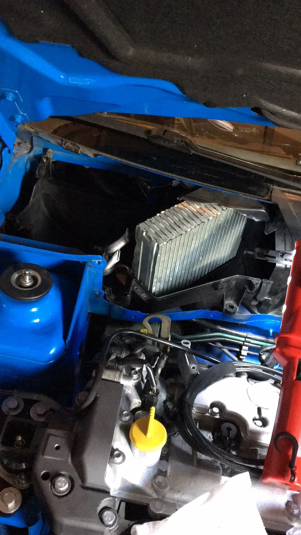

However before I started on the column I wanted to remove all the AC junk from the scuttle.

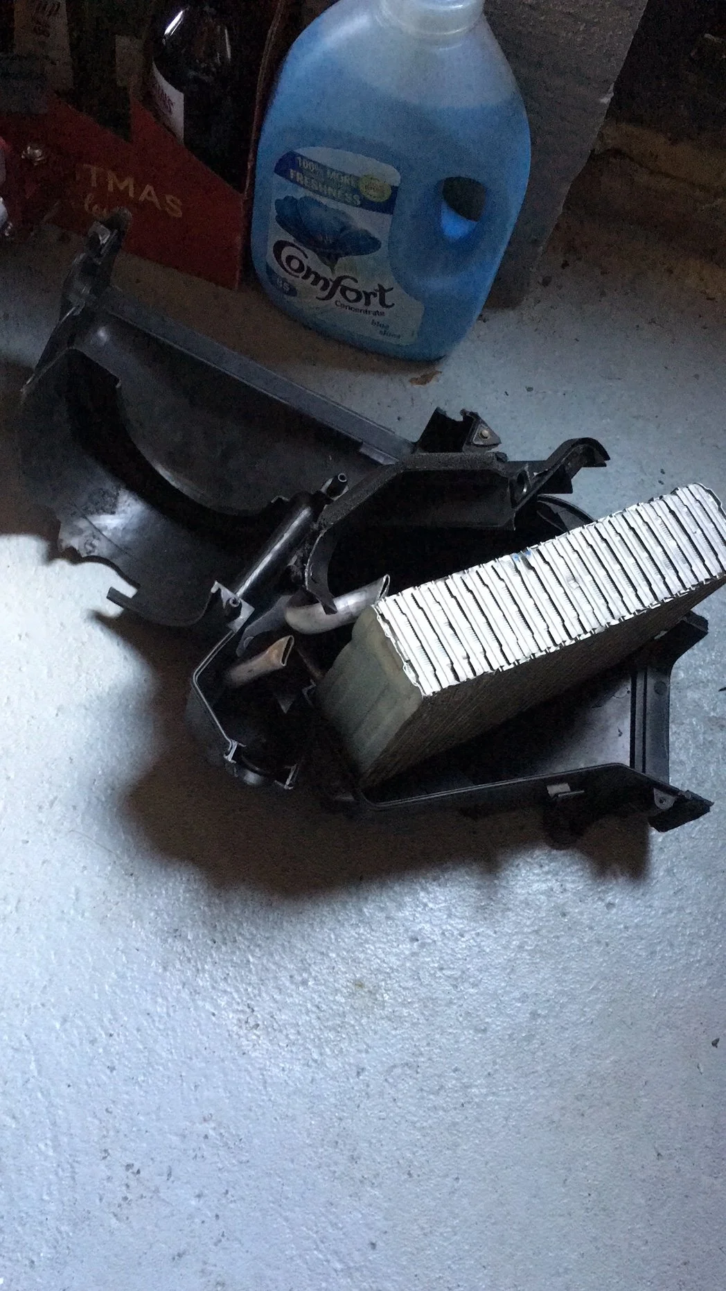

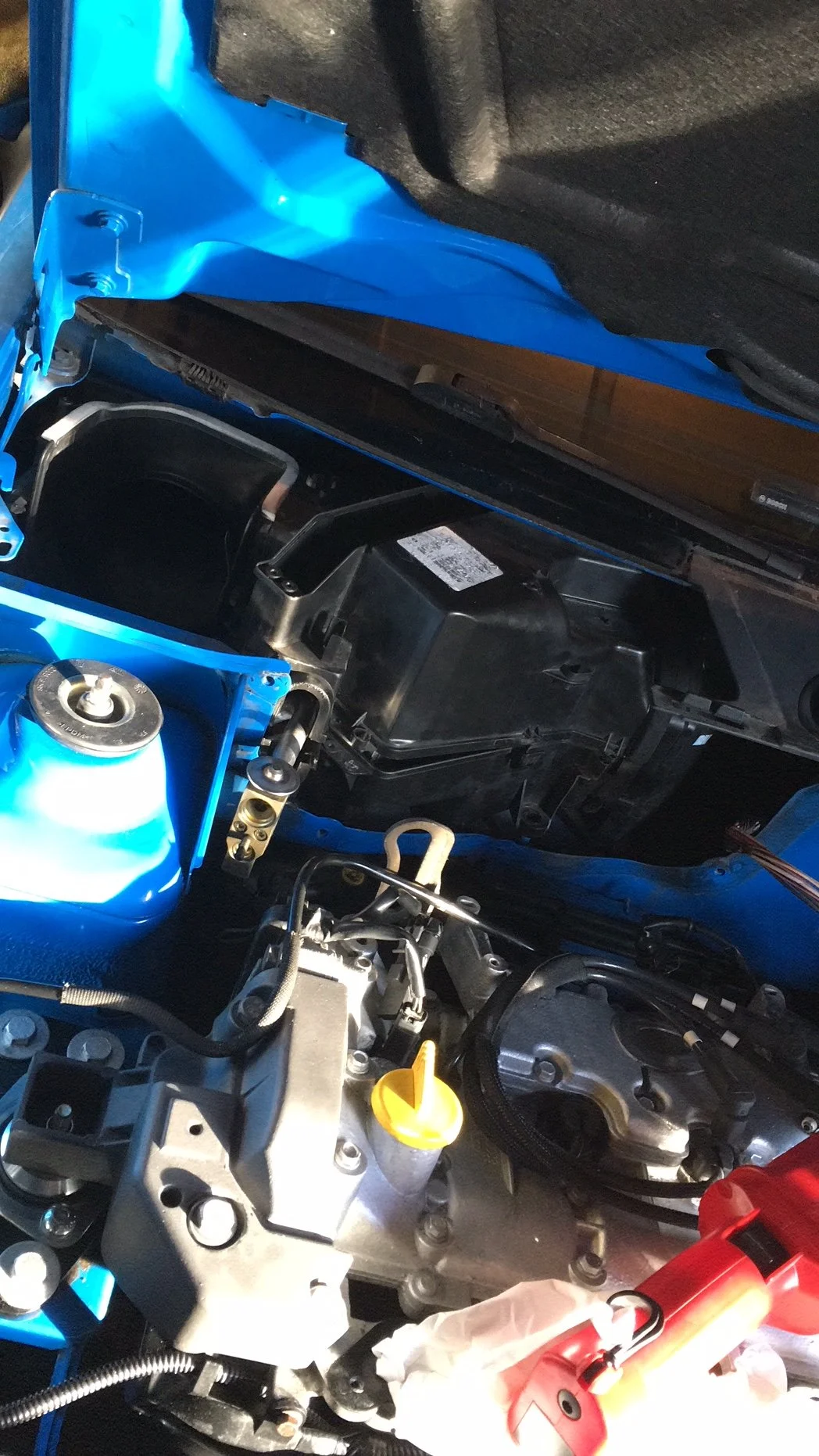

Firstly I have no idea how you guys manage to remove all this from the scuttle? I spent hours trying to work it out (yes all the bolts from the drivers footwell were removed) but I just couldn't work out how to get it out the gap. This is what I started with:
As you can see I removed the inlet but this still didn't help!
Eventually I accidentally snapped off a part of the casing so I just went and snapped of a few other parts!
Even like this I was unable to remove it, so I kept on snapping off parts until it fitted out the gap, this is what I ended up with:

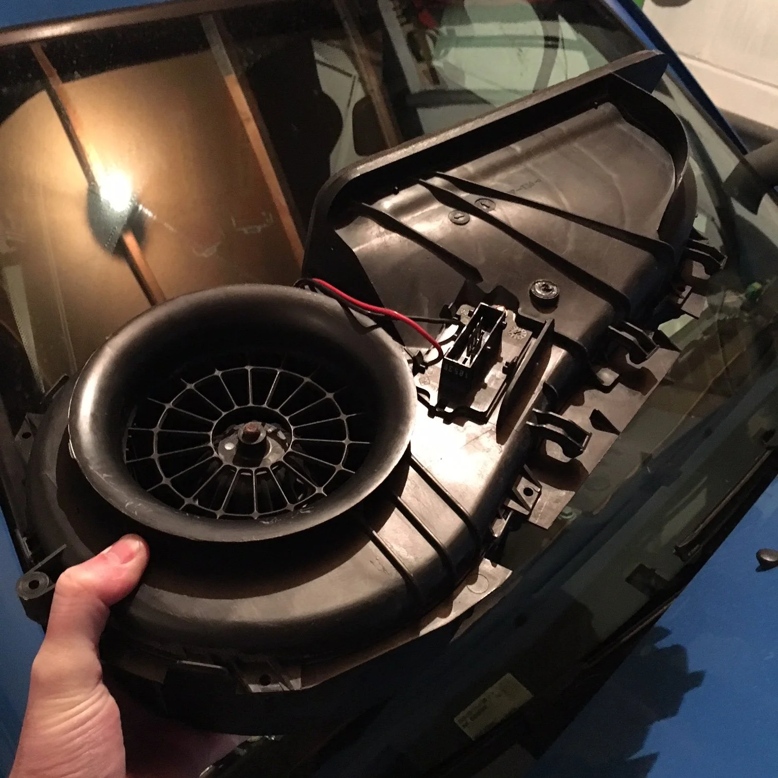

Although I now have a nice clean scuttle I now have no heating! I therefore sourced a 172 Cup heater blower but now I'm not sure if it'll fit? Any advice/tips would be great.
Pic of said 172 Cup blower:
So I'm not sure if my solution will work, but I really hope I have!

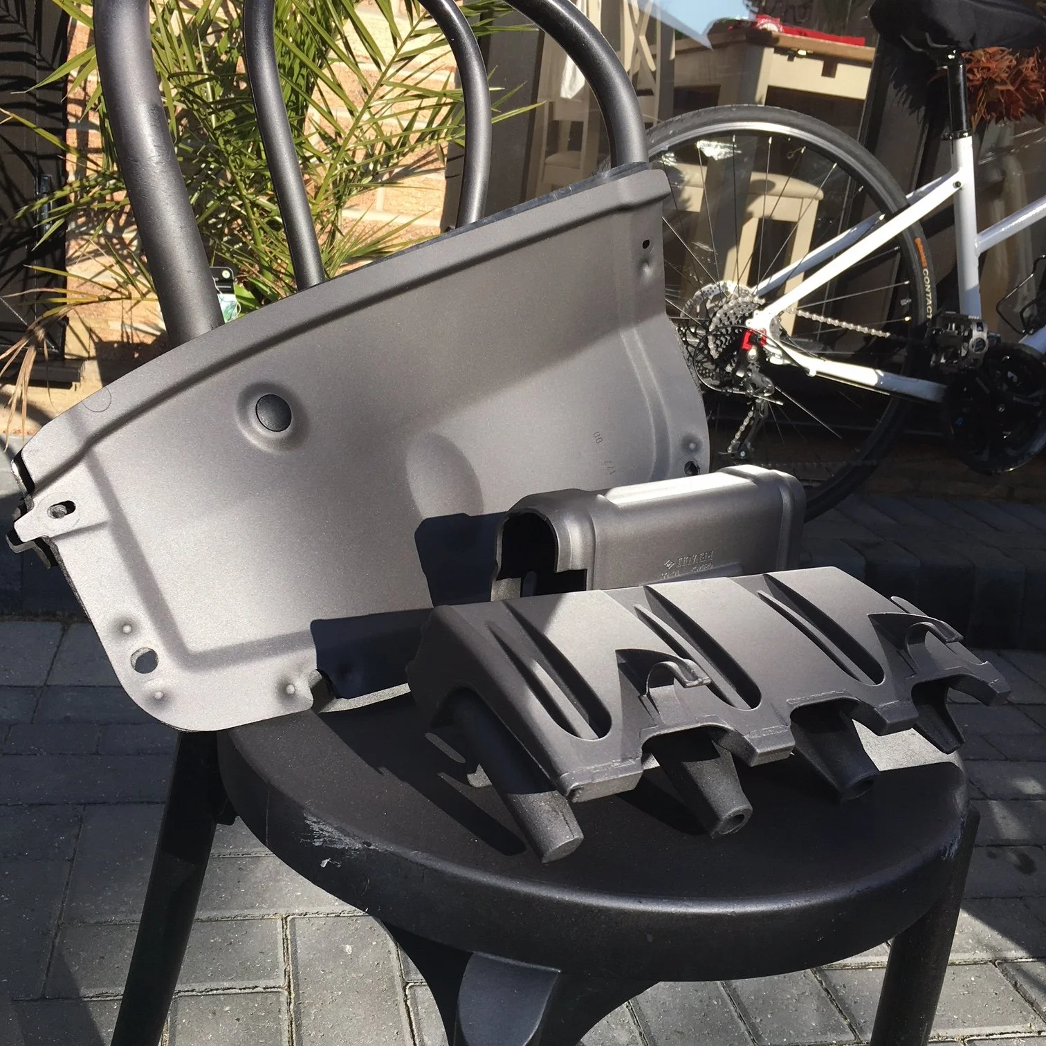

To cheer me up I decided to paint a few parts (something I'm ok at). I painted the bulkhead panel, fuel rail guard & ECU cover):

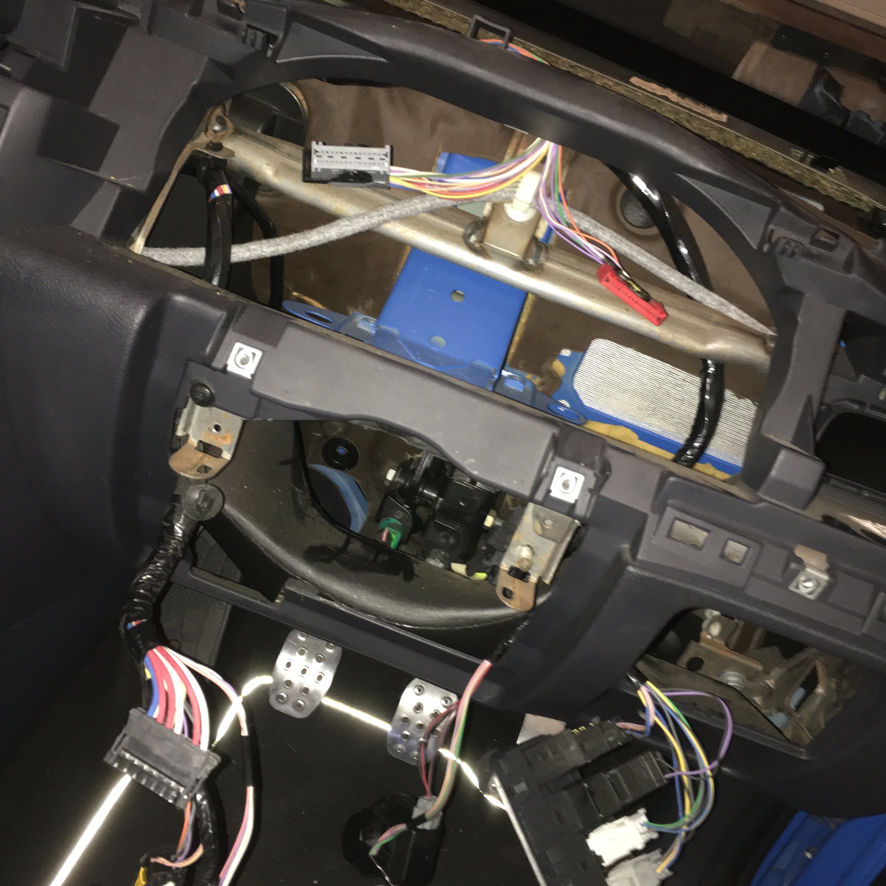

Feeling slightly upbeat I decided to try and removed the steering column which again was hard work IMO.
I've managed to free to the column with some help from @Stuiemc but I can't get the steering wheel boss off, so i've sprayed it with some WD40 in the hope it'll free it.

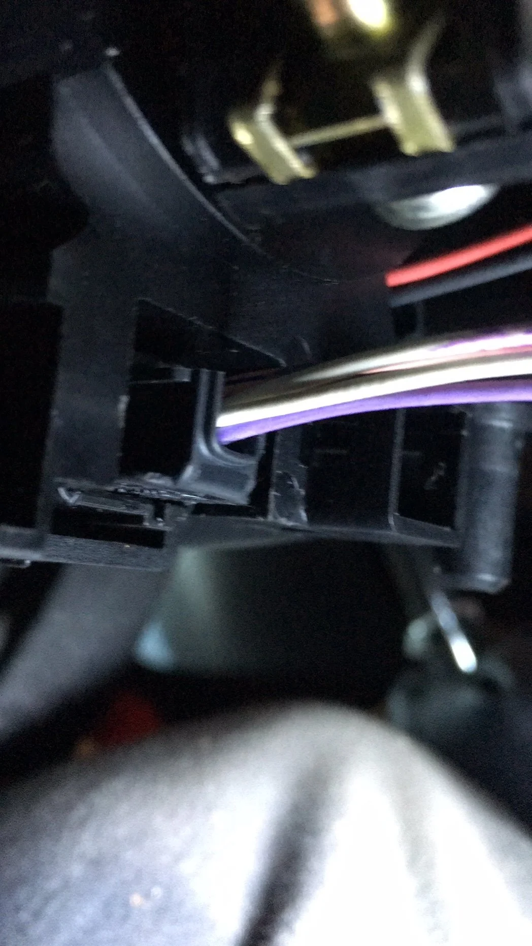

I also can't work out how to disconnect this connection:
It goes in behind the steering wheel into the steering angle sensor (I think). Again any help on this would be great.

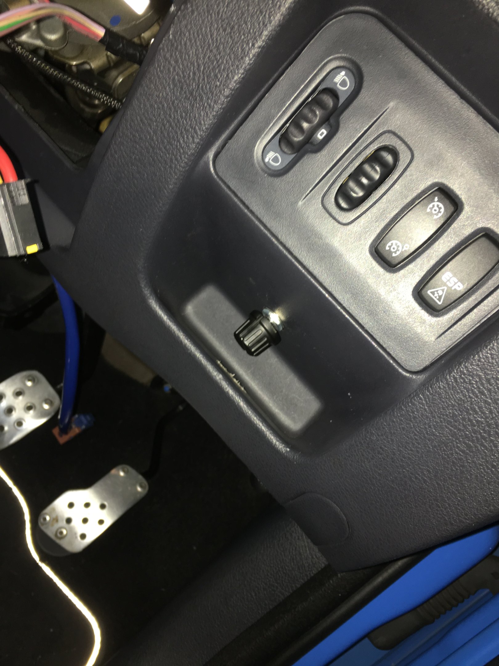

As mine is a Cup I couldn’t work out where to mount the adjuster but settled for here:
I could do with cutting down the stalk a little more but from ththe drivers seat etc you can’t see it so I’ll leave that until a warmer day!
I’m really pleased with the EPAS in general. I like the adjustment and having only been for a quick blast it feels as good as I remember it.

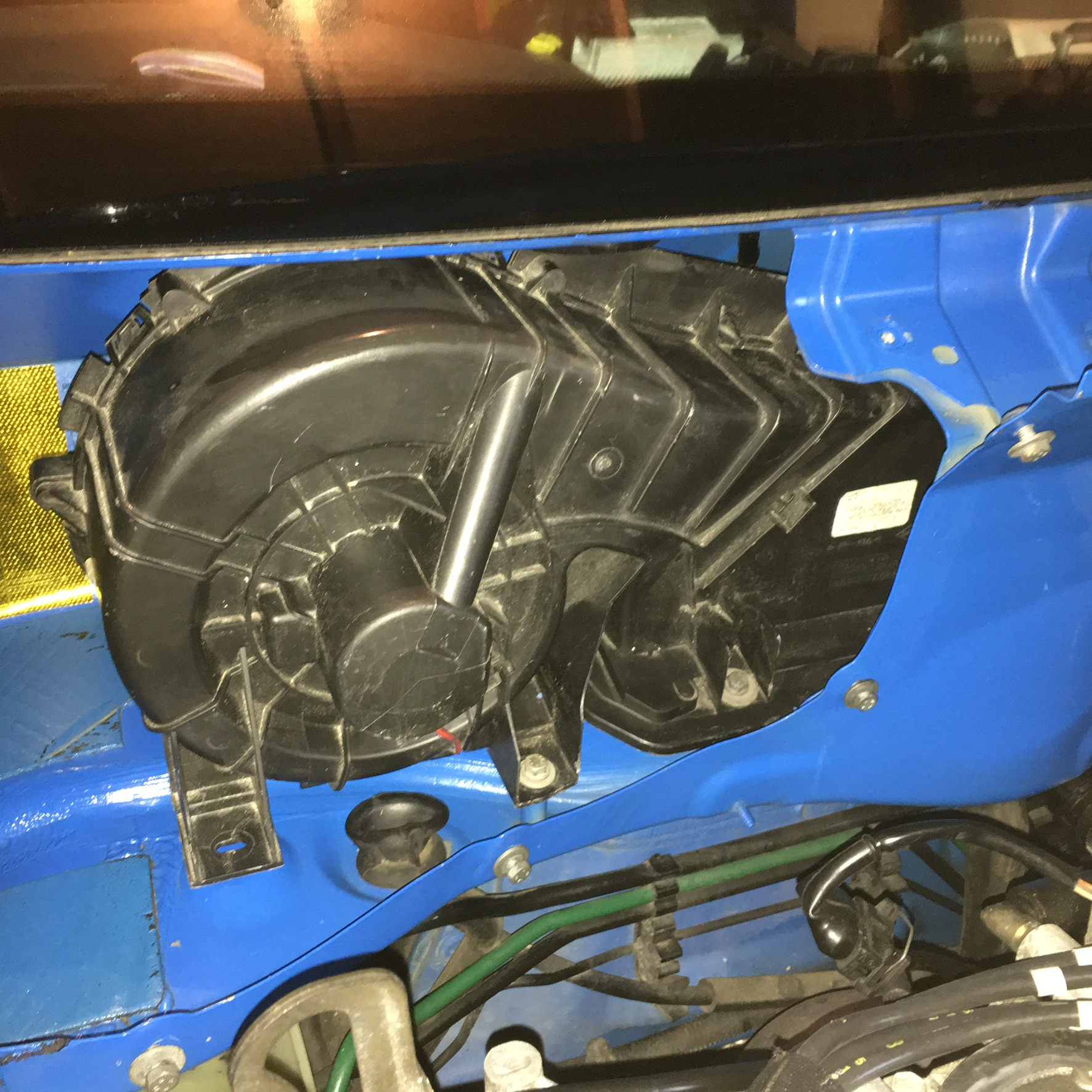

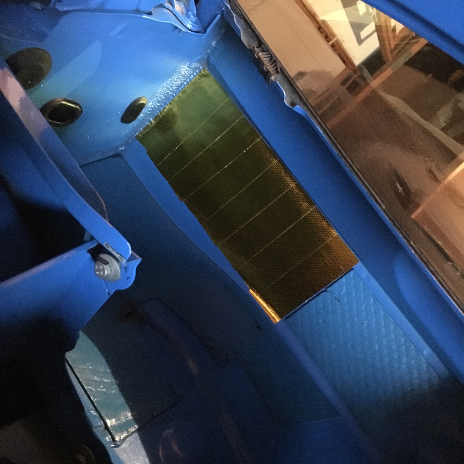

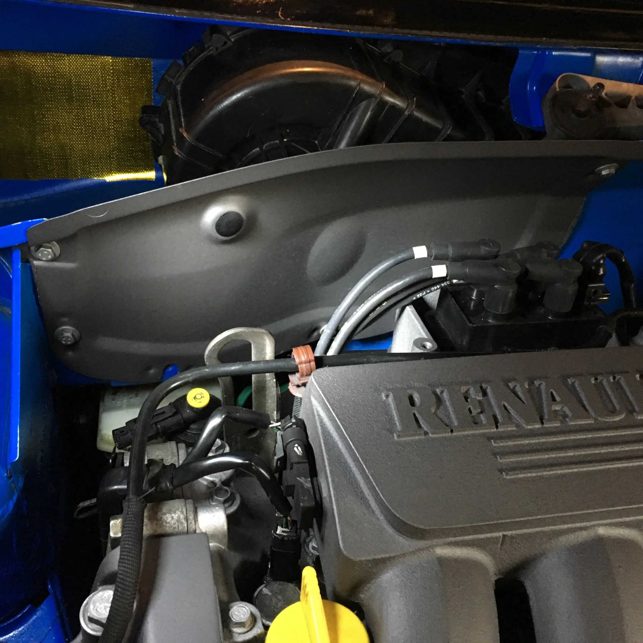

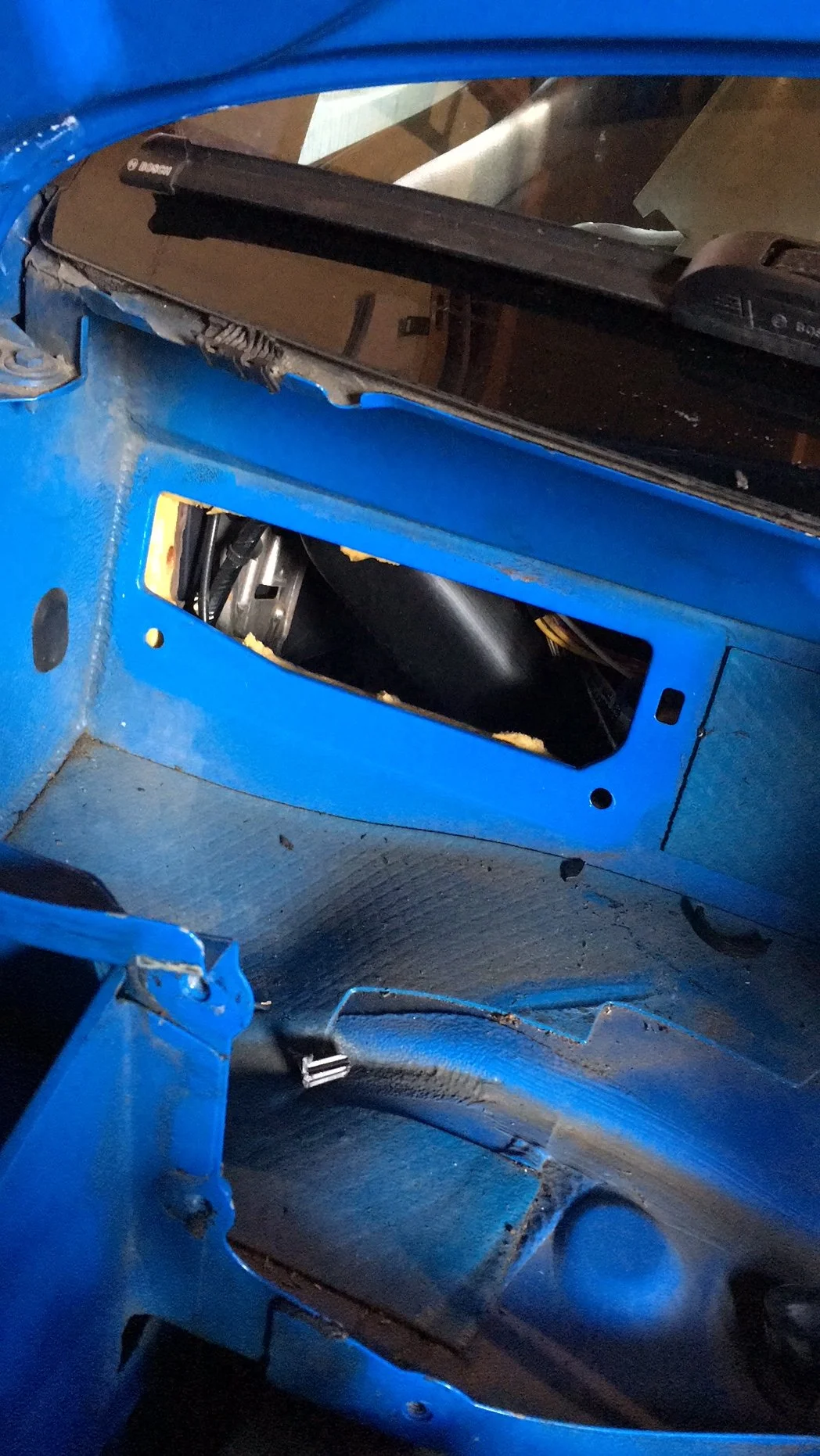

After ripping out the original heater/AC unit I was luckily enough to find a 172 Cup set up which just plugged straight in so I set about fitting that:
As you can see in ththe back ground I taped up the original hole left by the AC.
At some point in my life I’ll get a proper fix done...maybe!

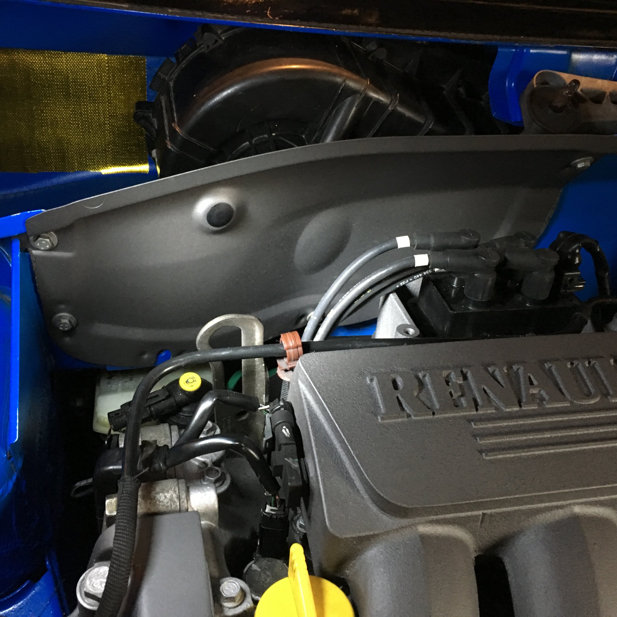

I then just had to put it all back together. I need a new airfilter as my current phase 1 Airbox no longer fits in the space due to new rad & hoses so I’ve ordered a set up.

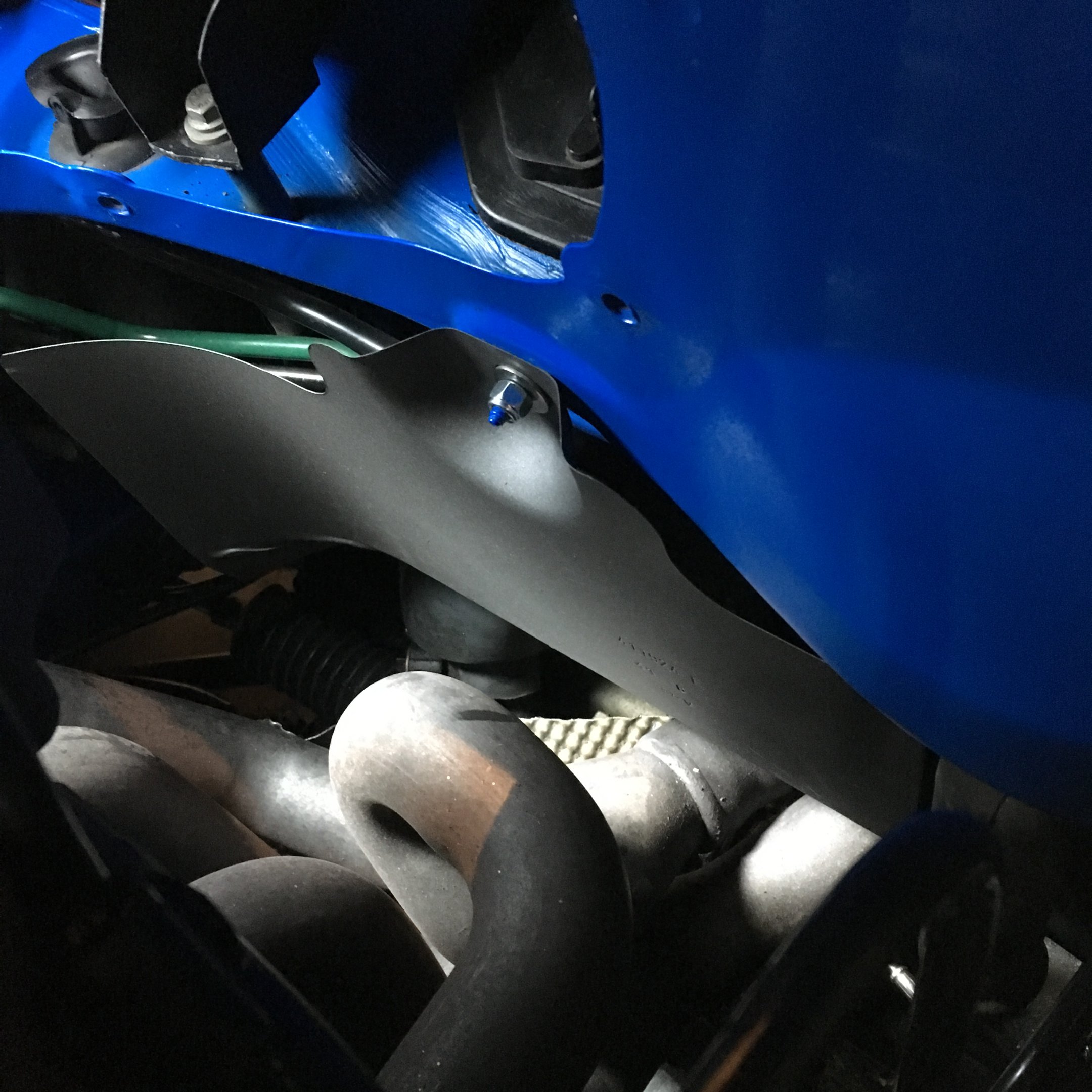

Manifold heat shield:
Bulkhead panel:

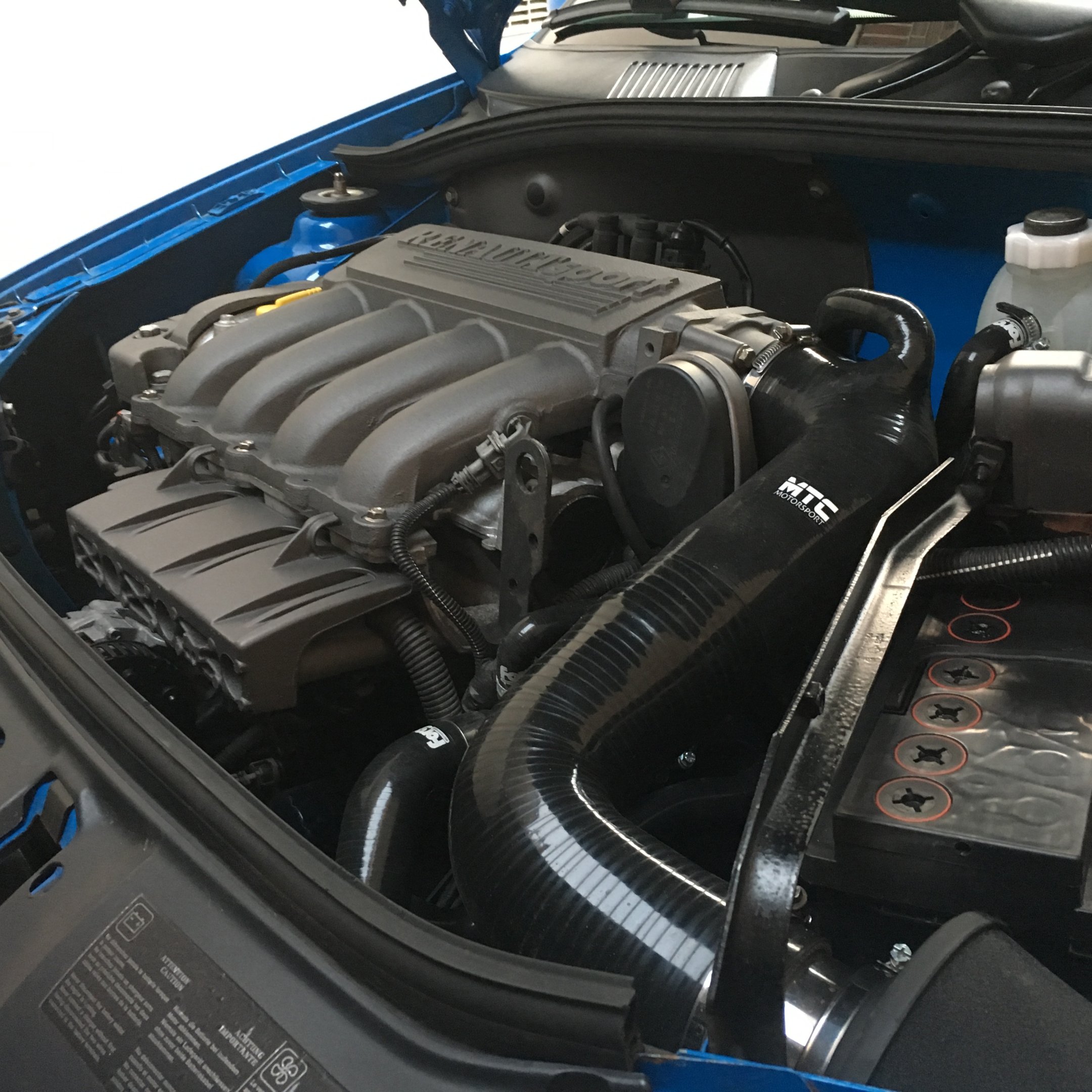

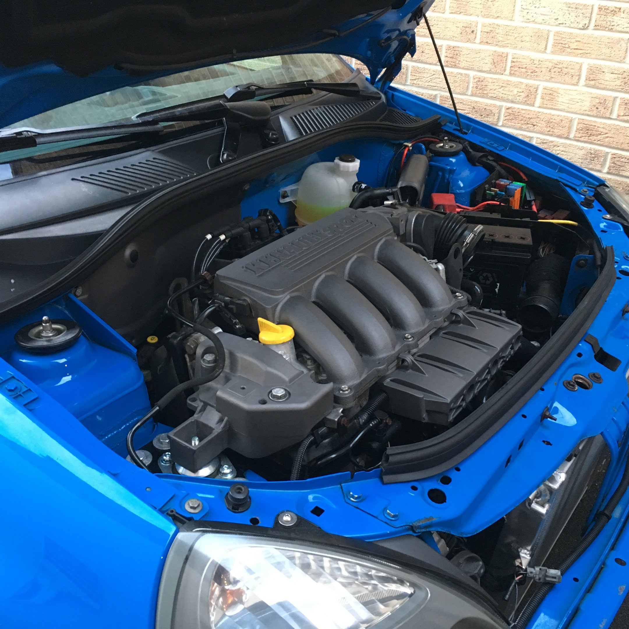

And finally some engine bay pics:
I’ve since moved the sensors out the way.

Does the cup blower work in place of the climate one, same wiring etc?
Mine was plug and play, had to make a new mount for the alarm but apart from that it was easy.
I have heard other people having issues but not sure if thats because mine was a 182 Cup so only AC and not climate control.

I was so pleased it was a straight fit tbh as a few people stated they attempted the swap and it didn't work. The only item I had to move was the alarm but TBH I'm sure if I had time I could have made the original bracket work.

I've got copied @Dr Jekyll set up, mainly because its great value for money.
I do plan on moving the battery behind the passenger seat at some point therefore it'll give me more room to think about other options.
Glad it’s all up and running! No risk of leaks now, yippee. God your engine bay is clean! Very envious of that. Mines grim.
Climate and non climate looms are different in the skuttle so sounds like it’s only plug and play for cars with manual controls.
Not as glad as me! It took far longer than I was expecting however so pleased with the end result.
The clean engine bay is the main reason it took so long, I even cleaned the scuttle panel, no one will ever see it!
I was hoping that would be the case regarding the 172 Cup blower, such an easy replacement and means I can actually remove the AC in full as I see so many people leave all the stuff in the bulkhead.

I've copied @Dr Jekyll and made a homemade intake as I couldn't get my phase 1 airbag to box in the gap, however this new setup sounds much better and also looks better in the engine bay:

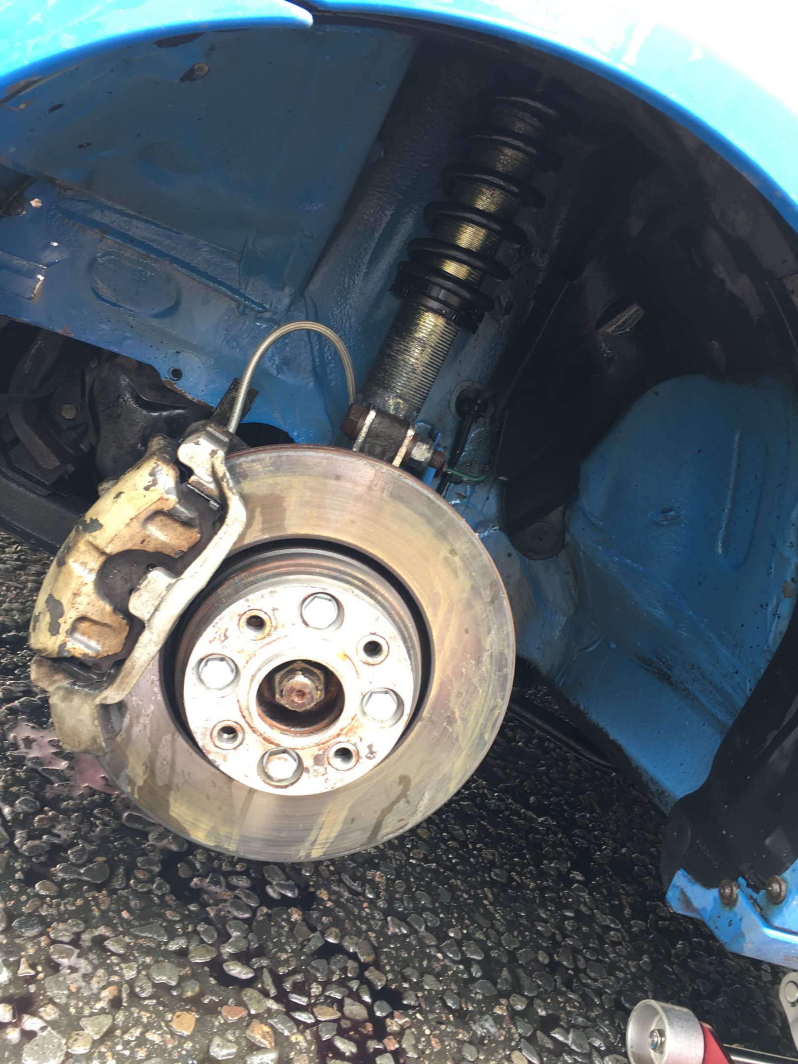

I also gave the arches a quick going over when I pop the 2118's back on. I can't believe the damage caused to the Coilovers the car has only done around 1,000 miles in the wet and they have already look much older. Its my own fault as a few people recommend ACF50 but I was planning on doing it this Spring/Summer.

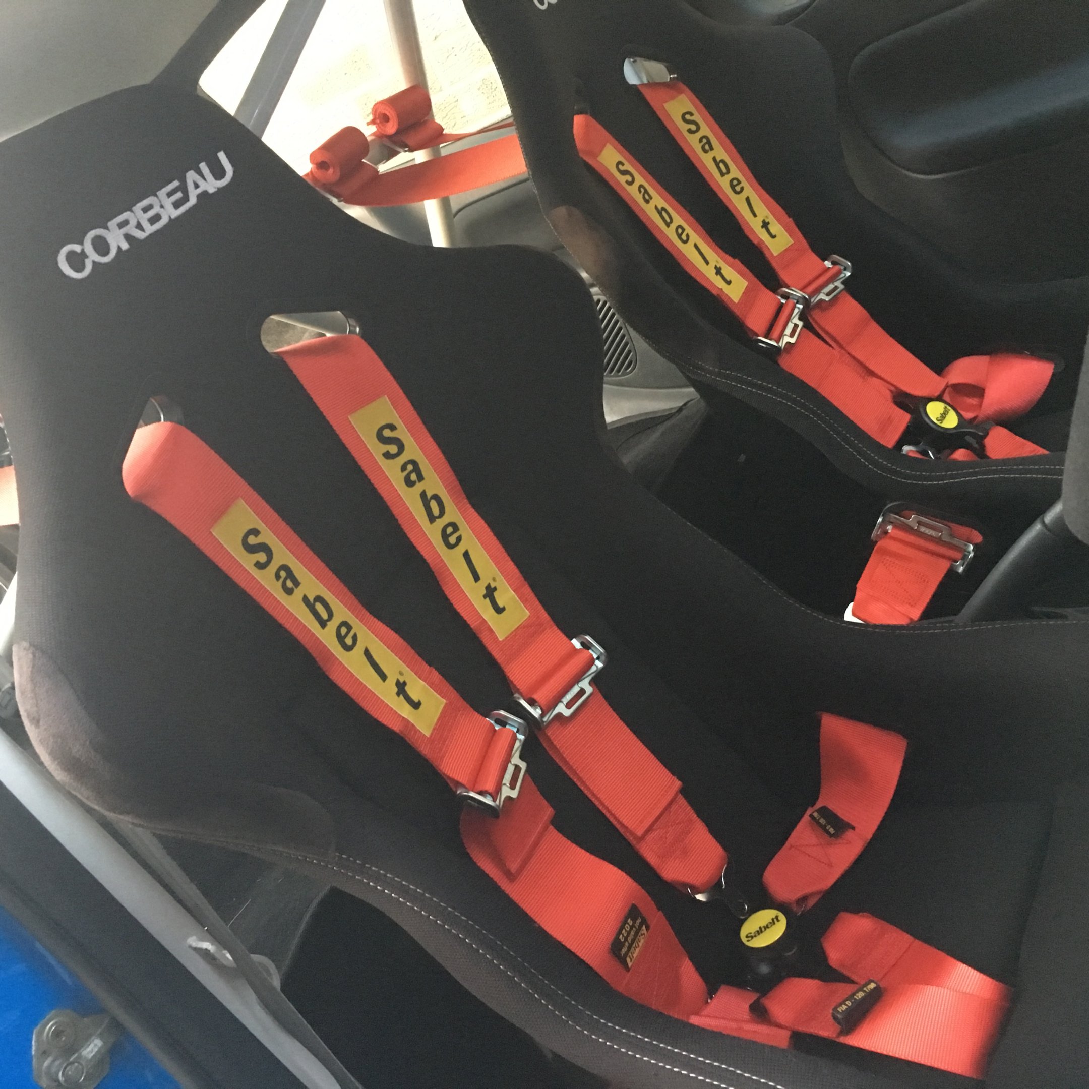

Finally I'm not sure if I've ever posted a pic of the front seats with the harnesses:
Finally I'm on the outlook for a front section of my cage and maybe a diff but apart from that the car is "finished".
