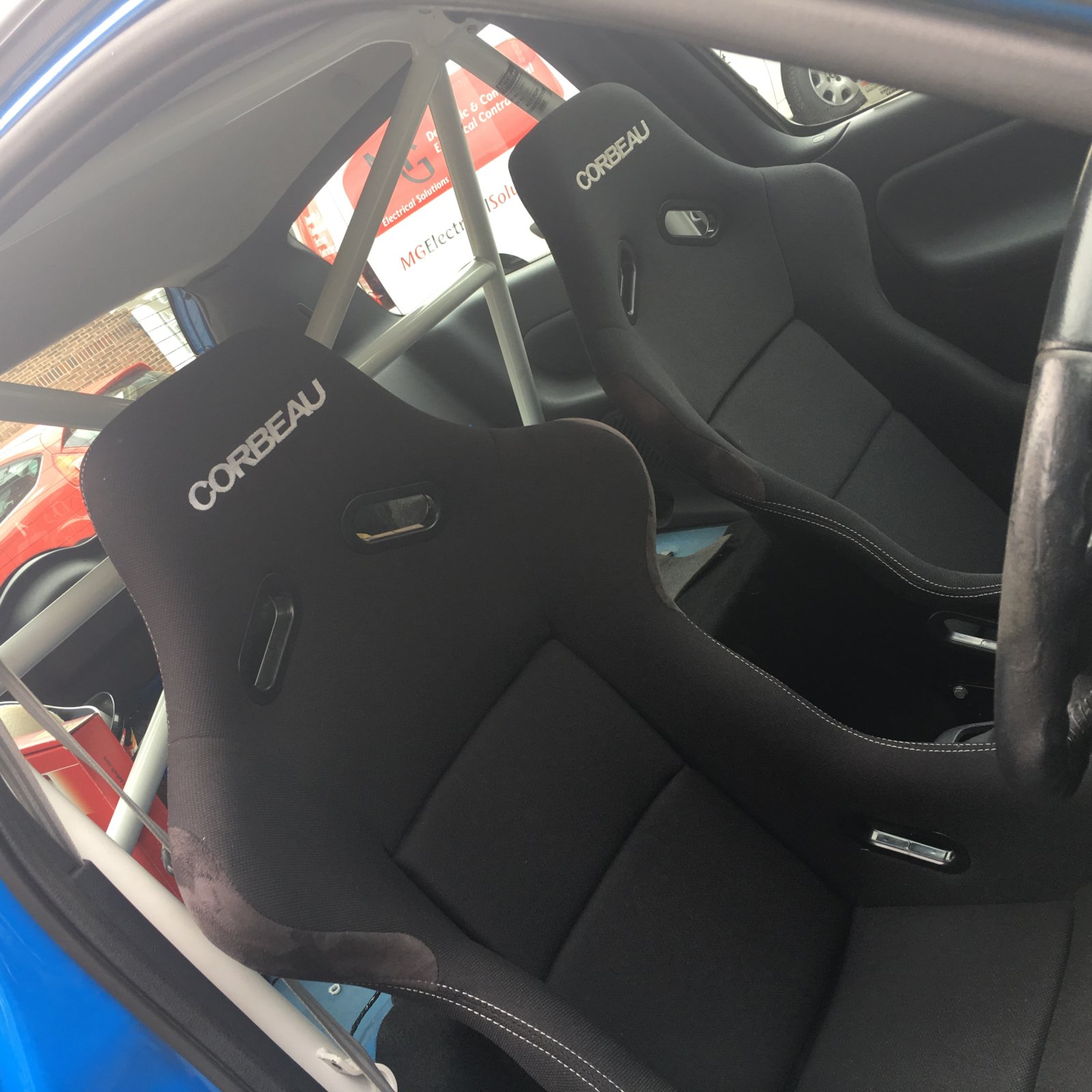

Another good weekend working on the car.
I can't thank @JON FOZ enough for getting the subframes to me so quickly, top bloke!

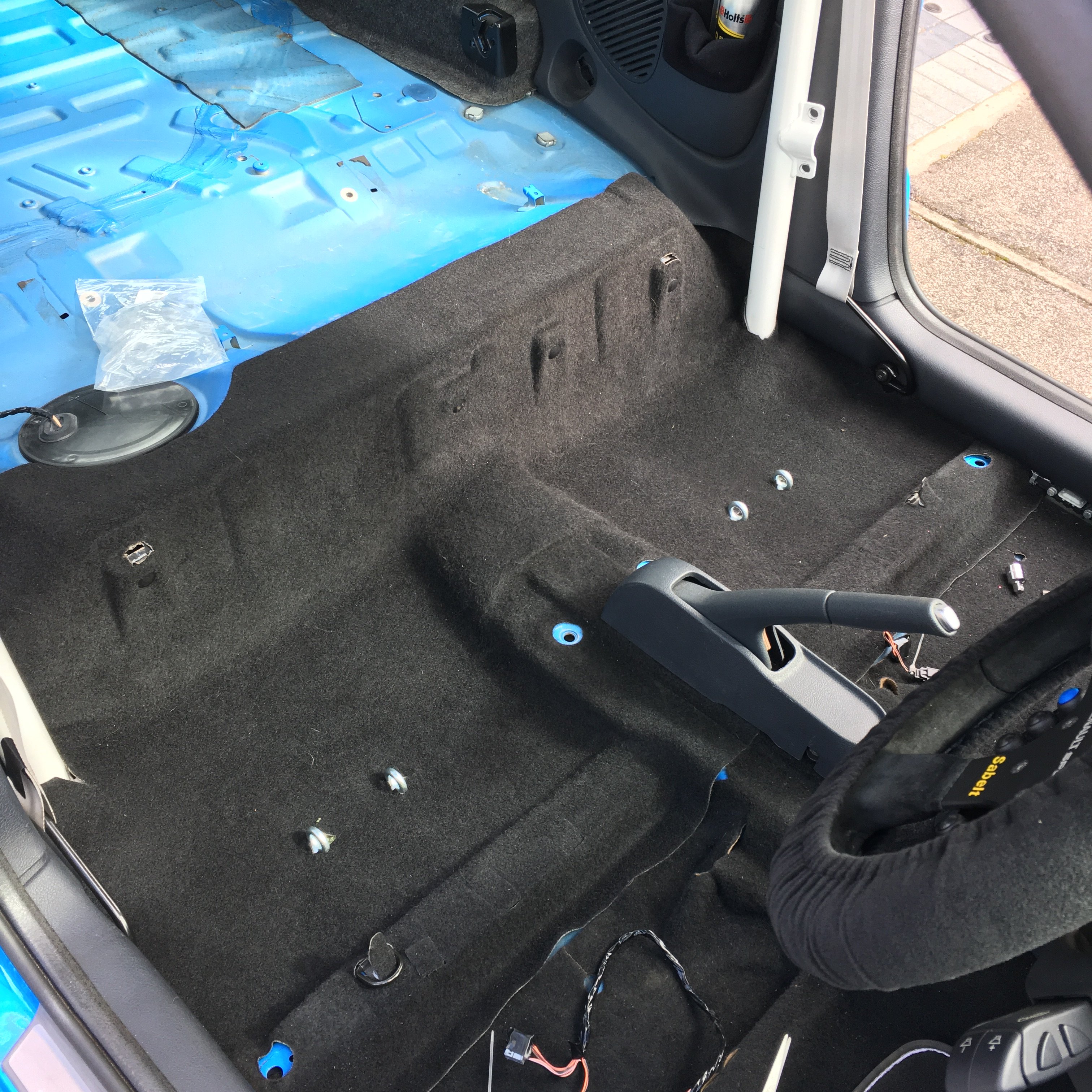

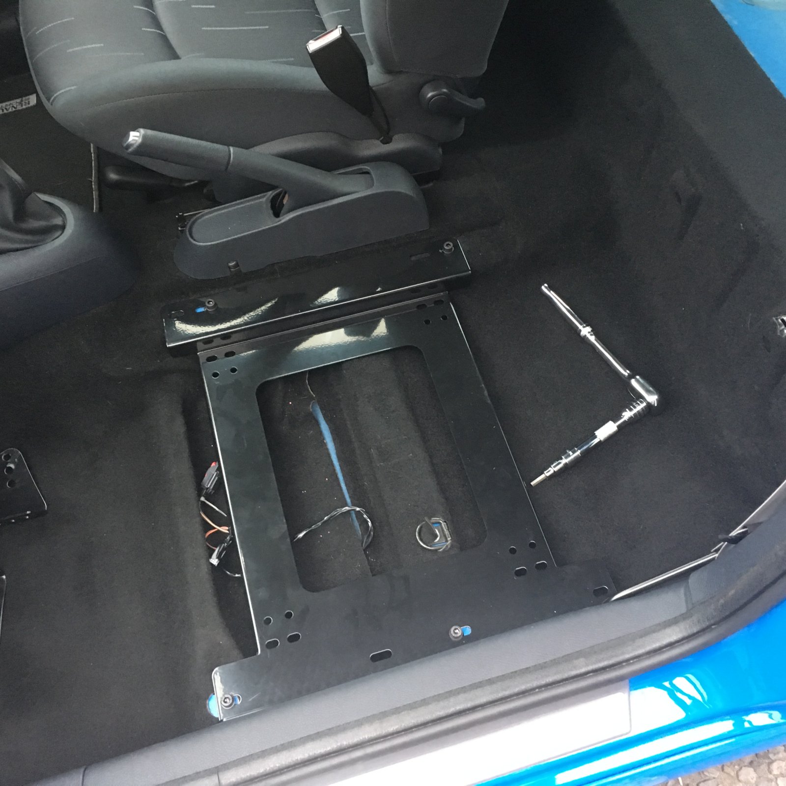

I started fitting the buckets seats on Friday evening (8.30pm start time!) I was really thankful for the guides on here for both fitting and resistors. I only managed to remove the passenger seat on Friday night but it made it all clear on what was required, I'll let the pics do the talking:
Seat out including the spacers:
I ordered all new bolts to secure the seats to the car & side mounts to the subframe to try and keep it all looking clean, I'll be ordering some slightly larger washers for the Subframes today as I'm not totally happy at present.

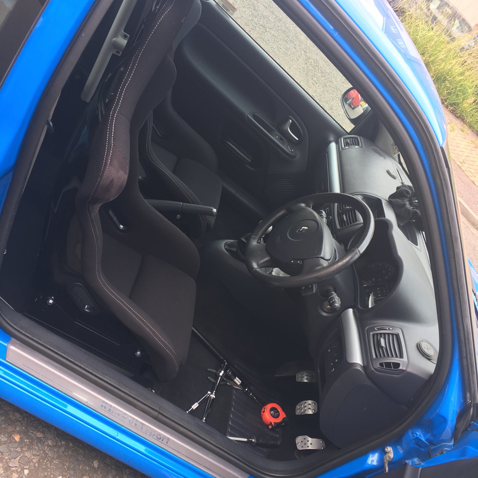

Sub frame fitted:

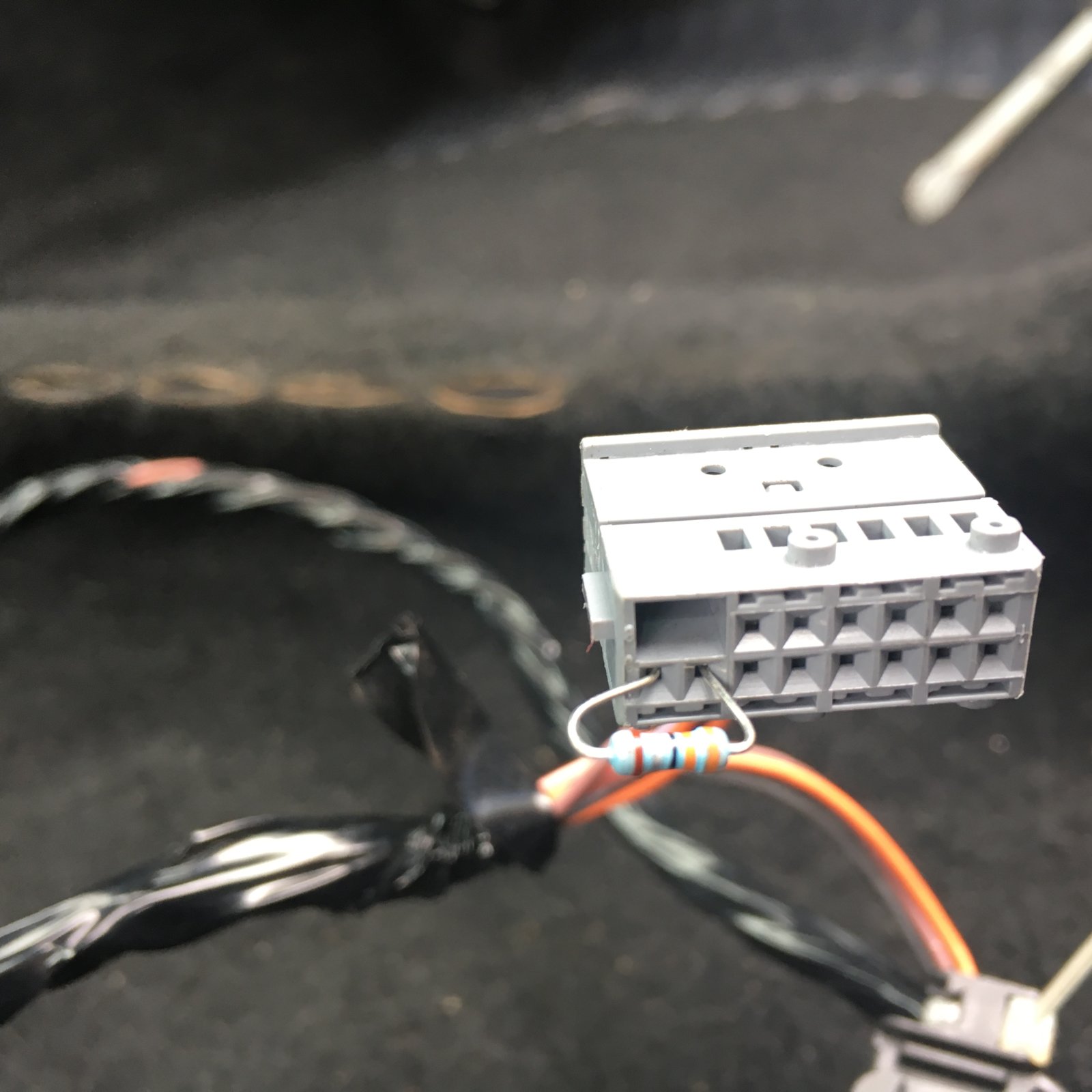

Sorting resistors:
Didn't actually take any pics of fitting the side mounts fitting, however I took my time at this stage as I was removing the runners, as suggest by a few including @Akay therefore the seating positions are fixed so I wanted to get them right first time. I must say I'm really please that I removed the runners as the seating position is just perfect.

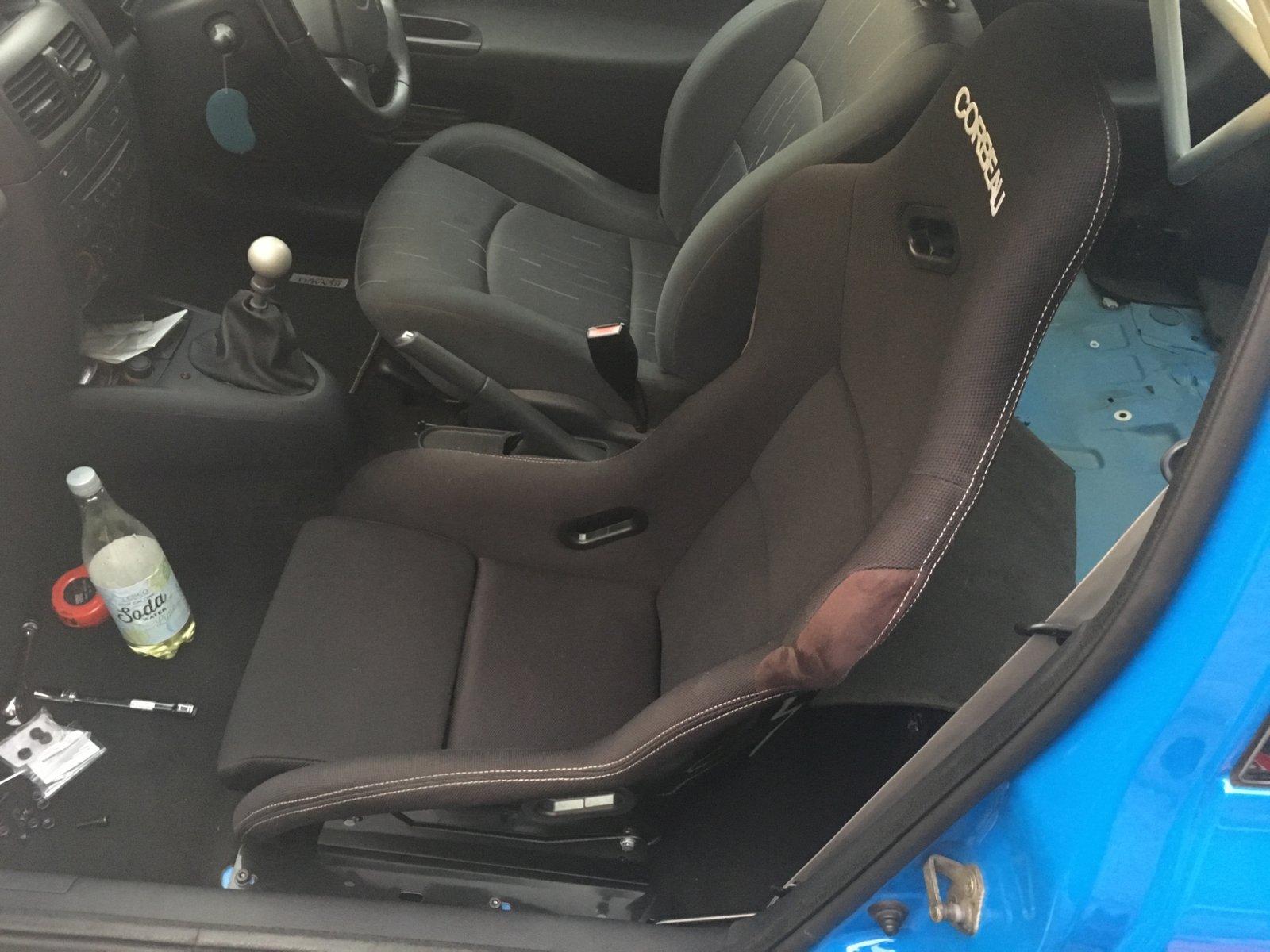

The passenger seat is as far back as possible while the drivers seat is one fixing forward.
Passenger seat fitted:
Both fitted:

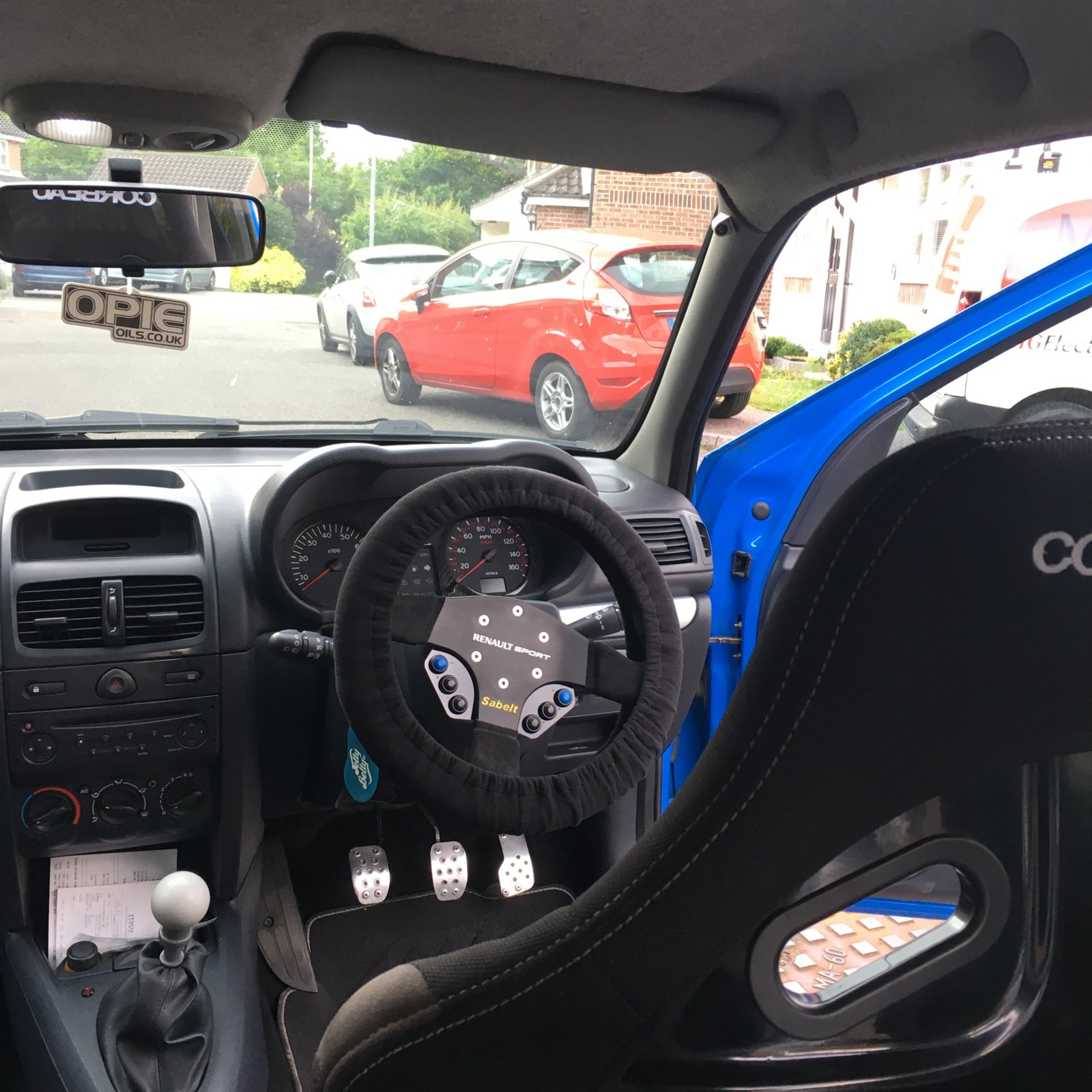

I must say when I first fitted the seats I thought they were too low but after a quick drive around the block, they are perfect. The seating position is perfect and all the buttons, arm rest and steering wheel all feel in a much better place. I did a quick measurement and calculated the seating position to be 17cm lower than the original.

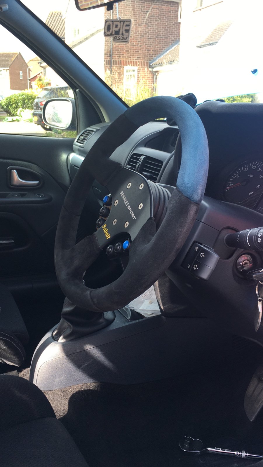

I then decided to fit my Sabelt Steering wheel & cruise control bracket, Not many pics of the actual process however I followed a good video which I found on youtube, I've yet to check all the functions of the bracket but I've done the hard part and tidying it up/getting it working shouldn't be too much of an issue.
The steering wheel feels so much better, and I like that fact the cruise control etc still works.

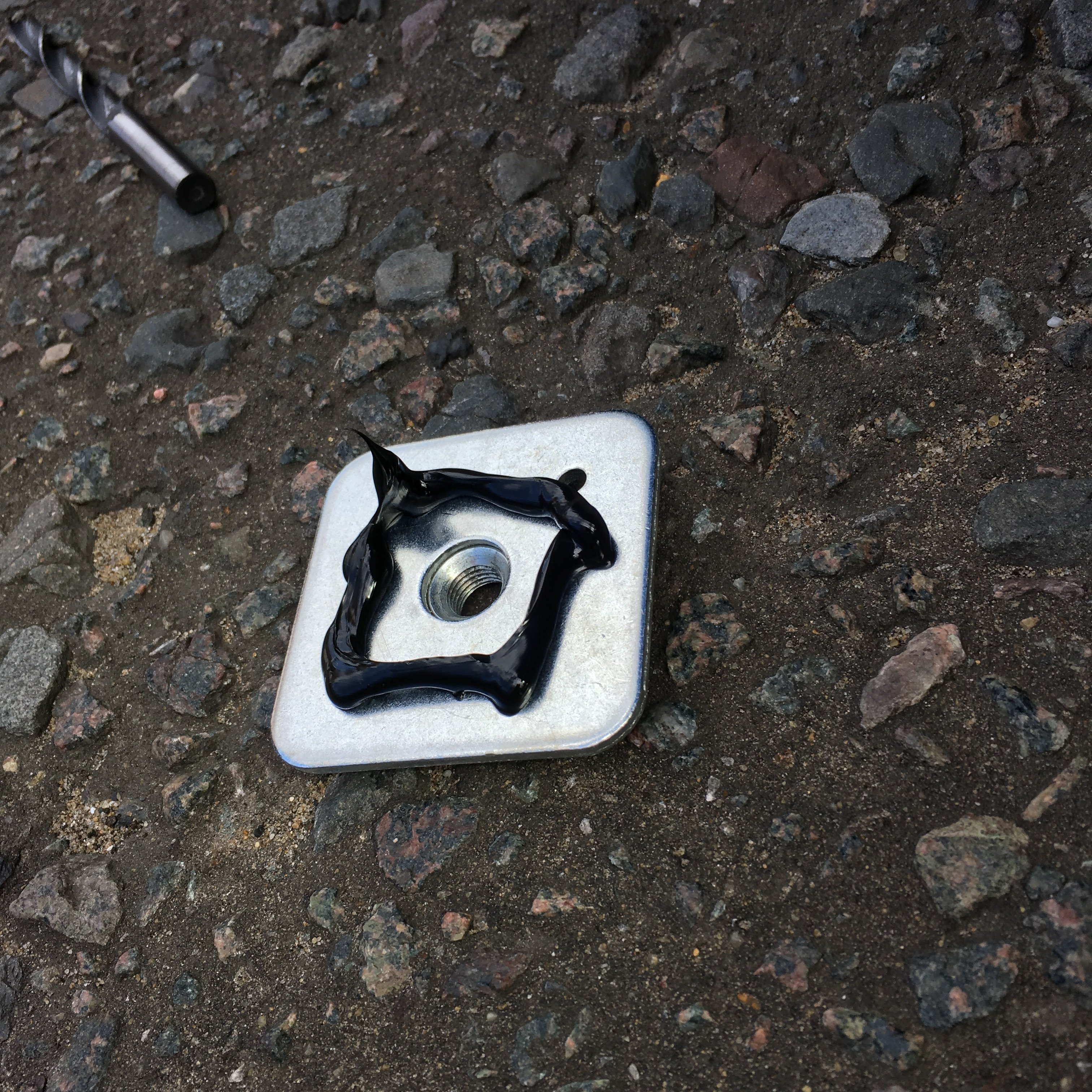

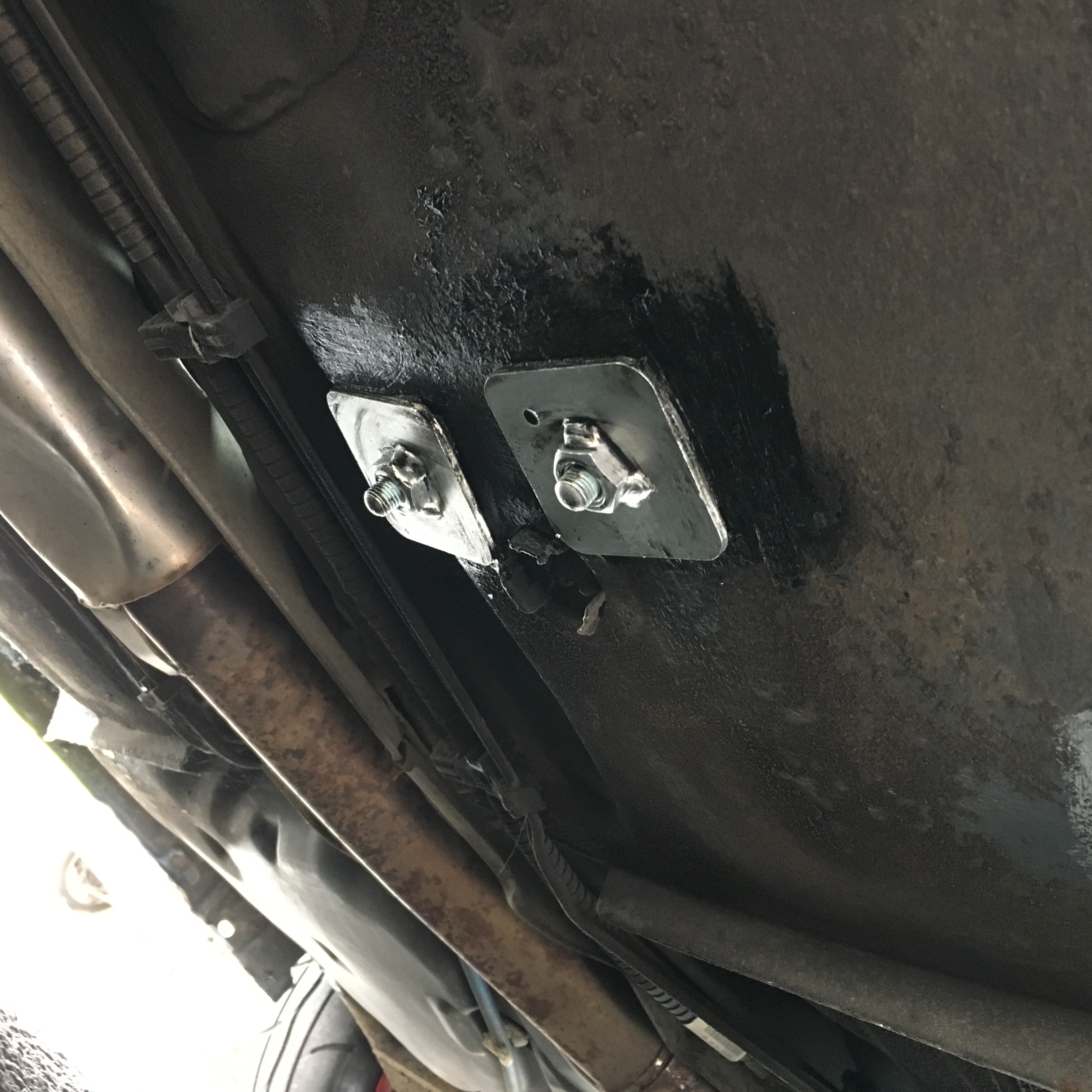

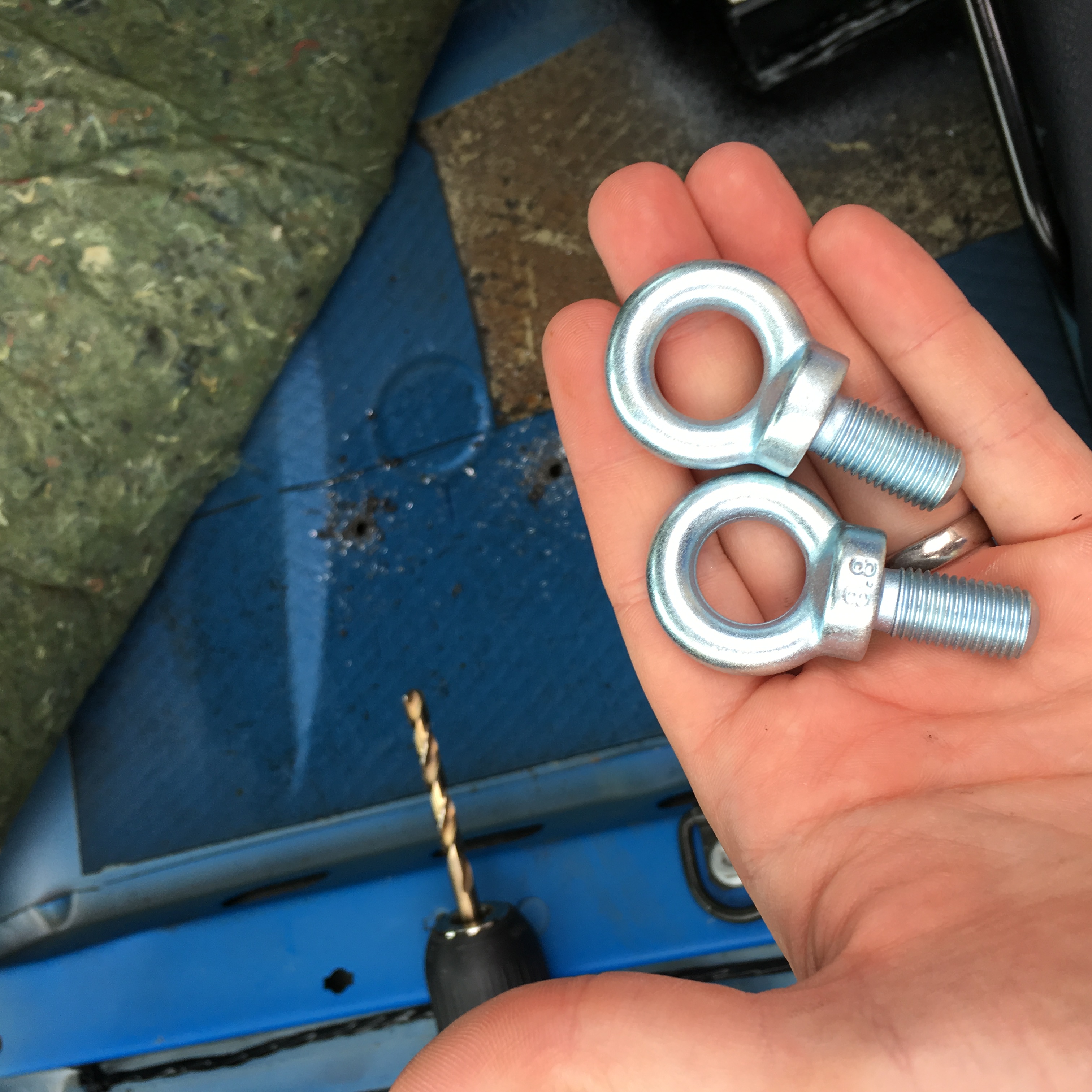

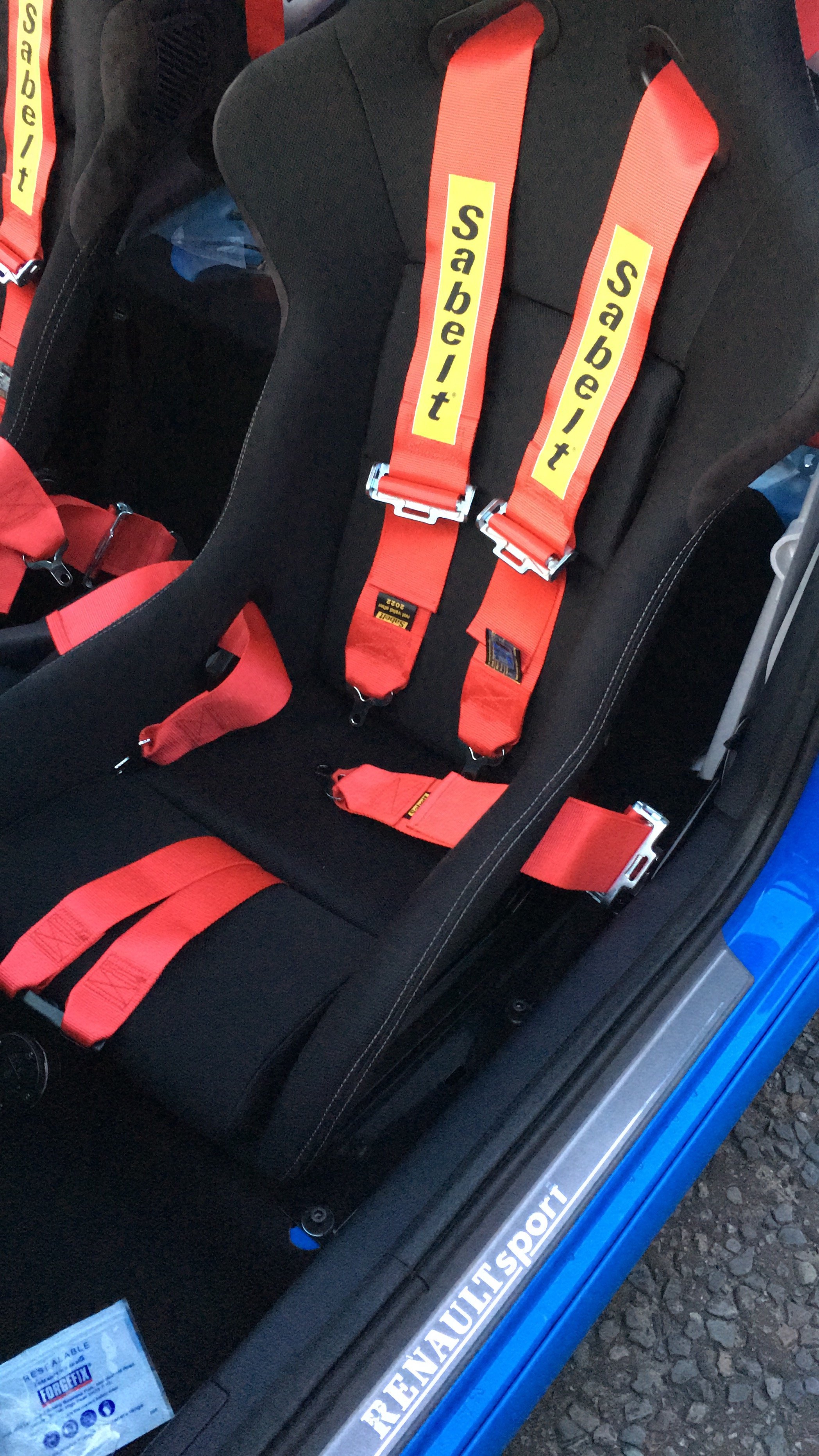

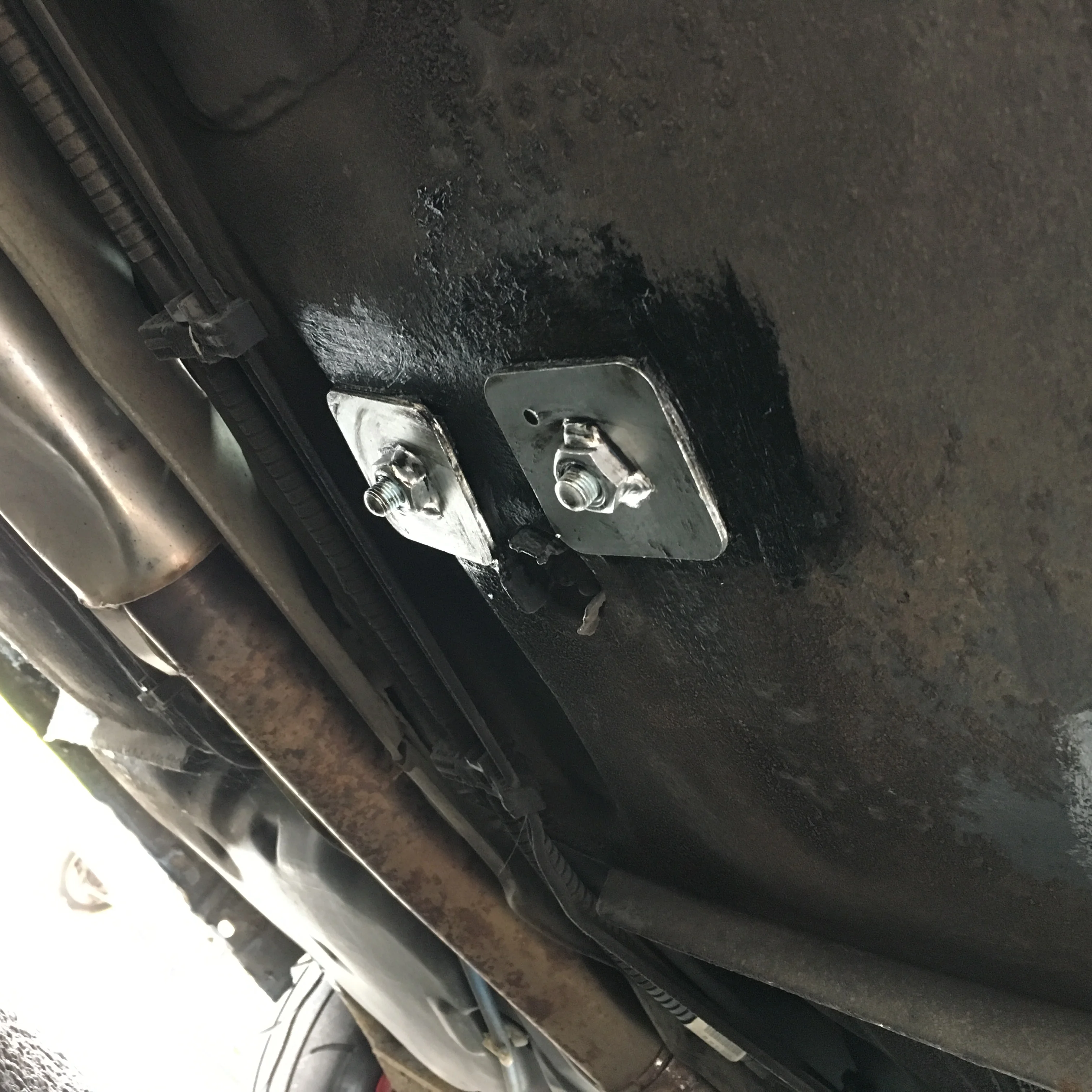

This weekend I managed to get a few free hours and I managed to fit the harnesses.
I still need to spend a bit of time adjusting the shoulder straps but the hard work is done, I'll let the pics do the talking:

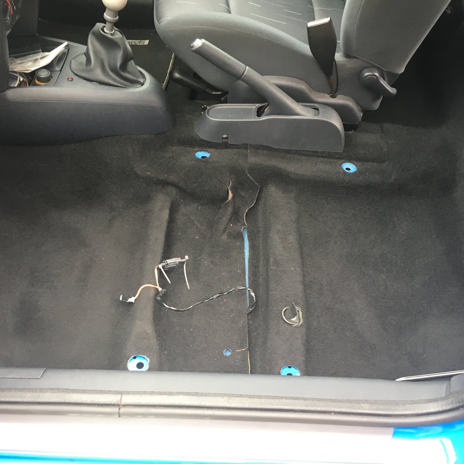

I measured up on the passenger side and luckily where I wanted to drill was a good inch away from the pipes:

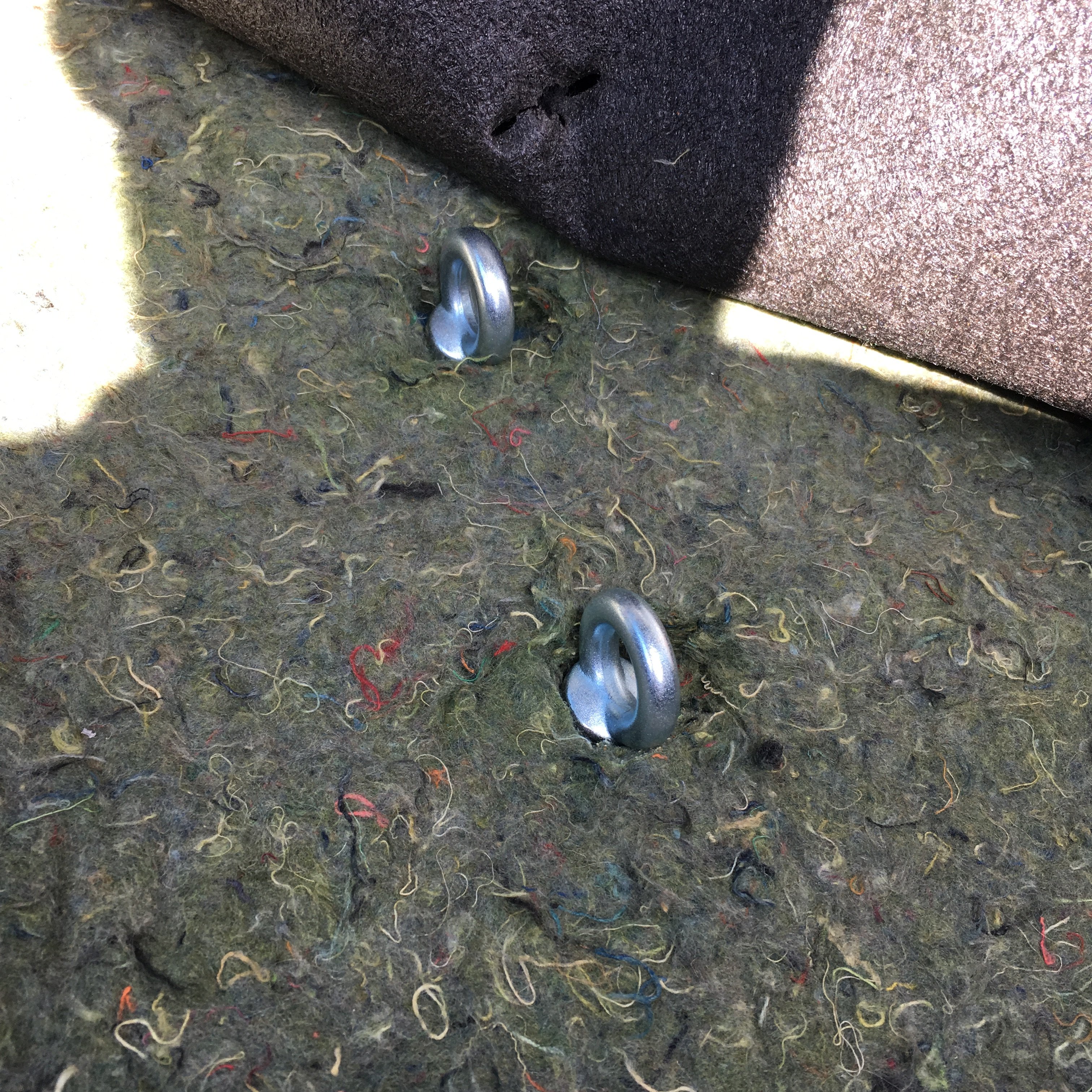

The crotch strap/belt was fitted using eye bolts:
As I want to retain the carpet I cut away at both the underlay and carpet so the bolts where mounted directly to the floor:
I used a bead of silicone to help keep the water out:
Finally the two brackets fitted:
I plan on painting the brackets under the car to help protect them a little.
How they look:
As you can also see in the final pic I also managed to grab a boot mat which covers the rear passenger seats also.

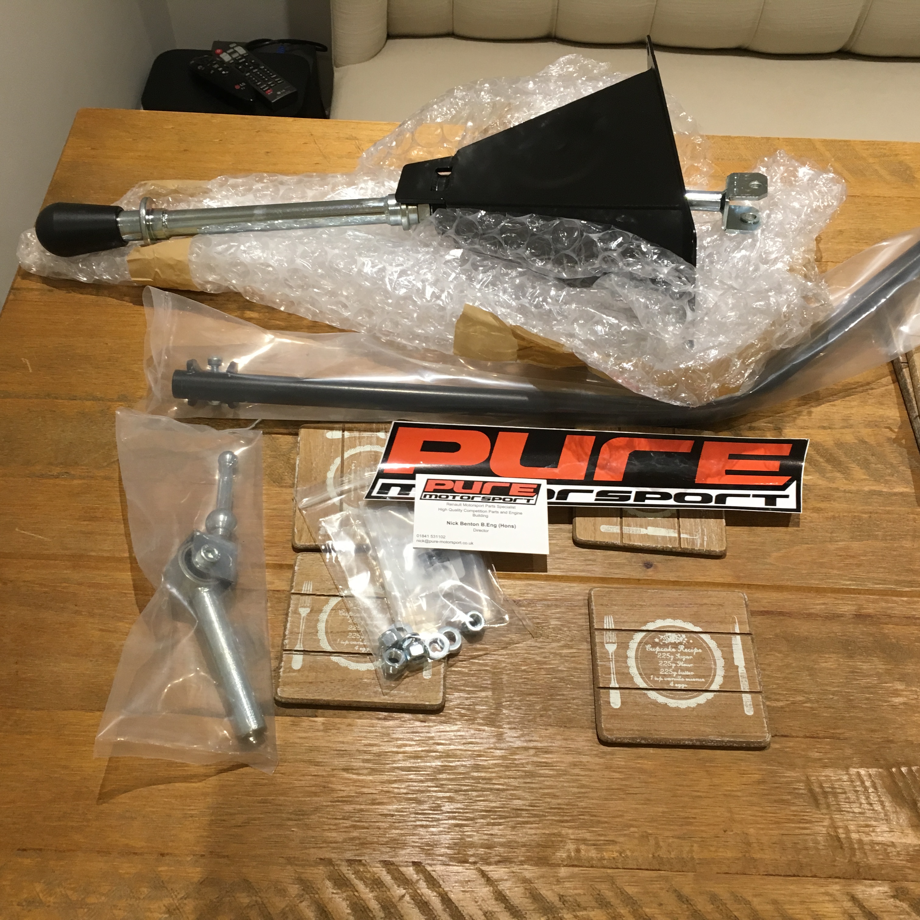

My PMS (Pure Motorsport) Shifter arrived yesterday and I can't wait to get it fitted.
In away this weekend but I'll try and get it fitted on Thursday/Friday evening.

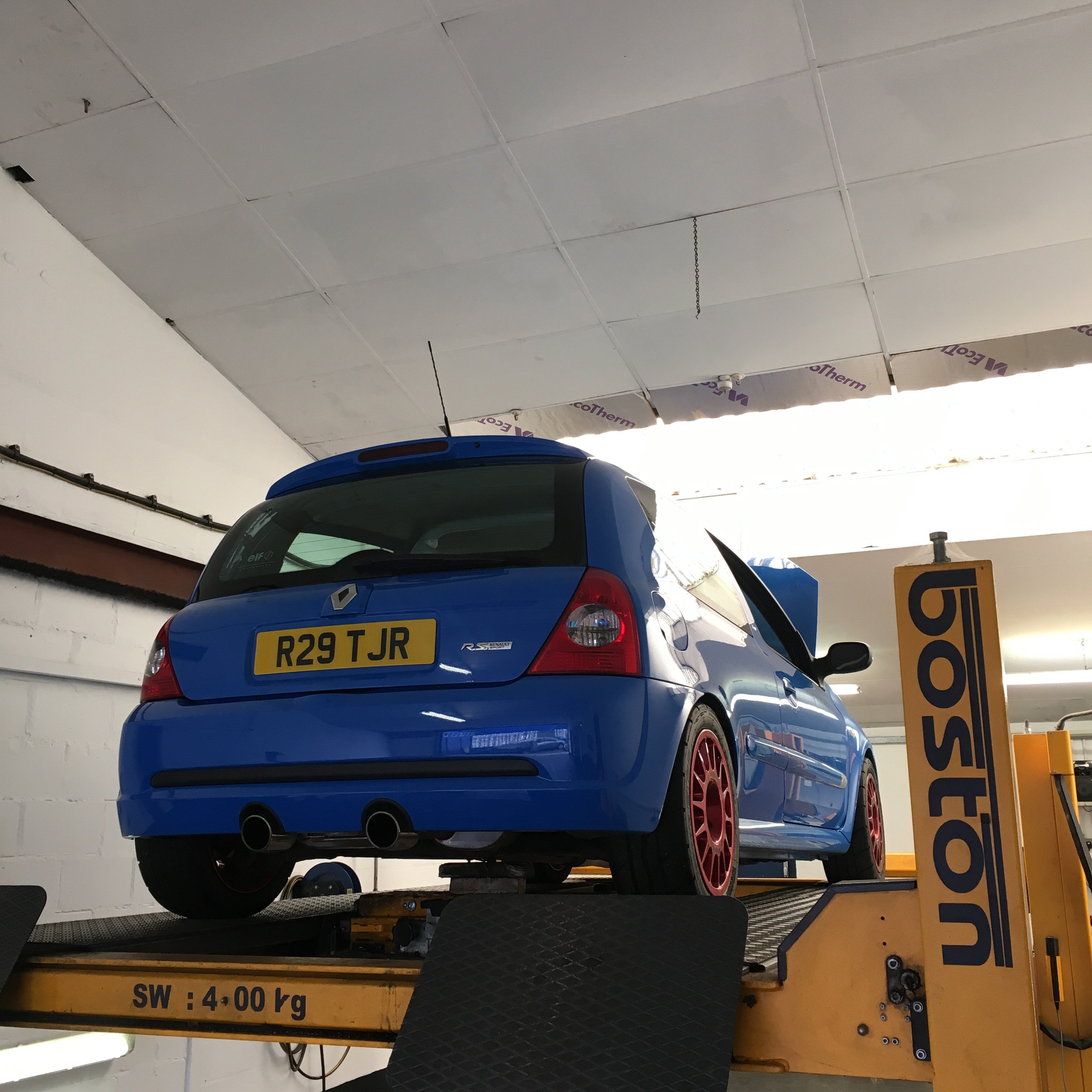

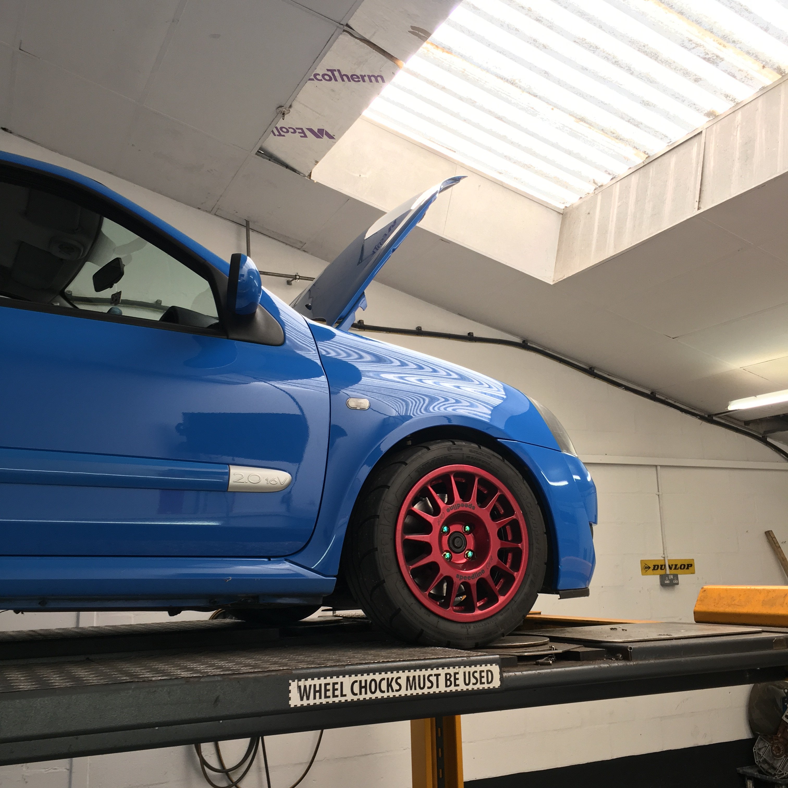

Alignment Done - Elite Rainham

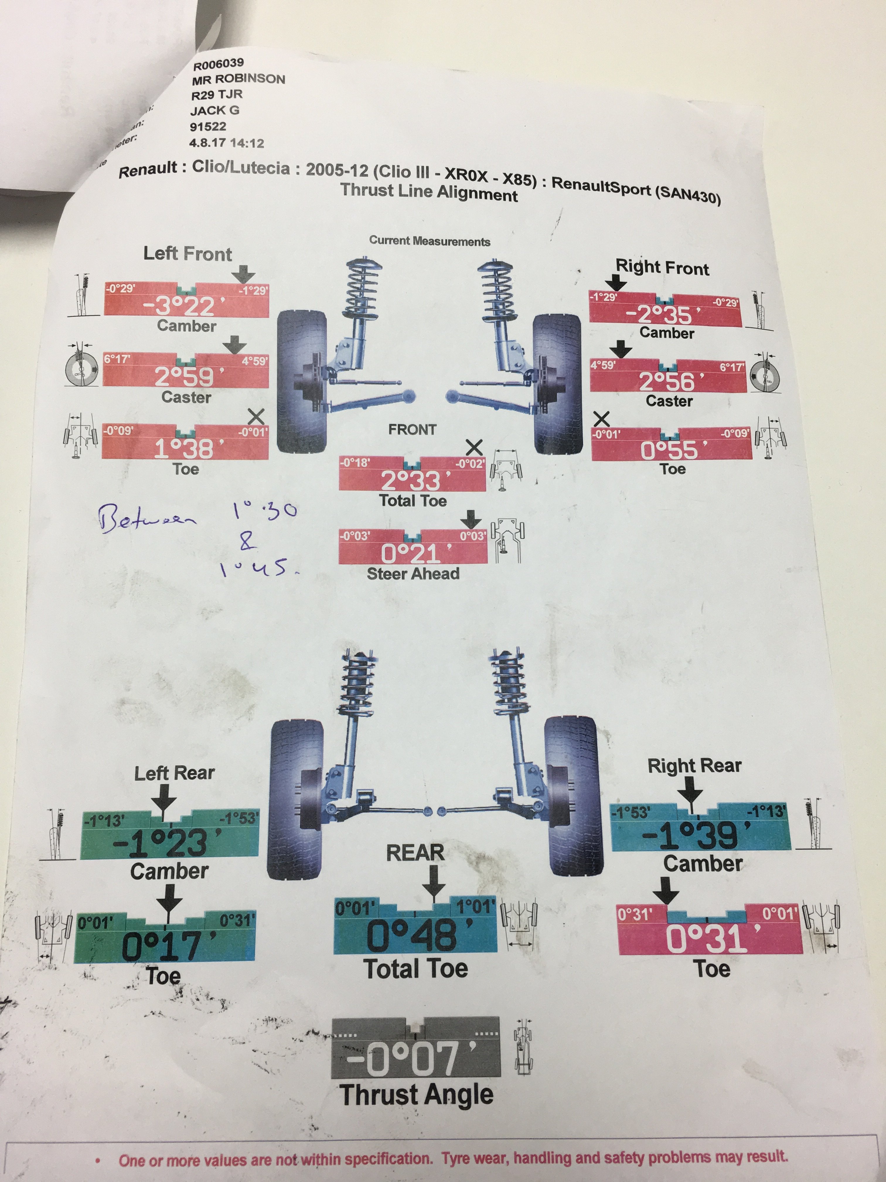

So on Friday I popped to Elite in Rainham (Essex) to get the alignment done, a mixed review. I like the fact you can just turn up and get the alignment done without any prior booking yet I was at Elite for almost 4 hours and they were far from busy. The time didn't bother me too much as I had my laptop and they have WIFI so I was able to do some work however the lack of updates and forgetting to re-balance wheels didn't fill me with confidence.
I'm far from an expert in suspensions, my only knowledge is a bit of internet research but they didn't fill me with confidence with advising on the set up, however the car drives so much better than before so I can't moan too much! I'll let the pics do the talking:
Prior to being set up:
As said above I'm no expert but I'm not sure the above was a great. I advised Elite the purpose of the car I was advised by them to run between 1.30 & 1.45 camber and this is the final outcome and they would sort out the toe!

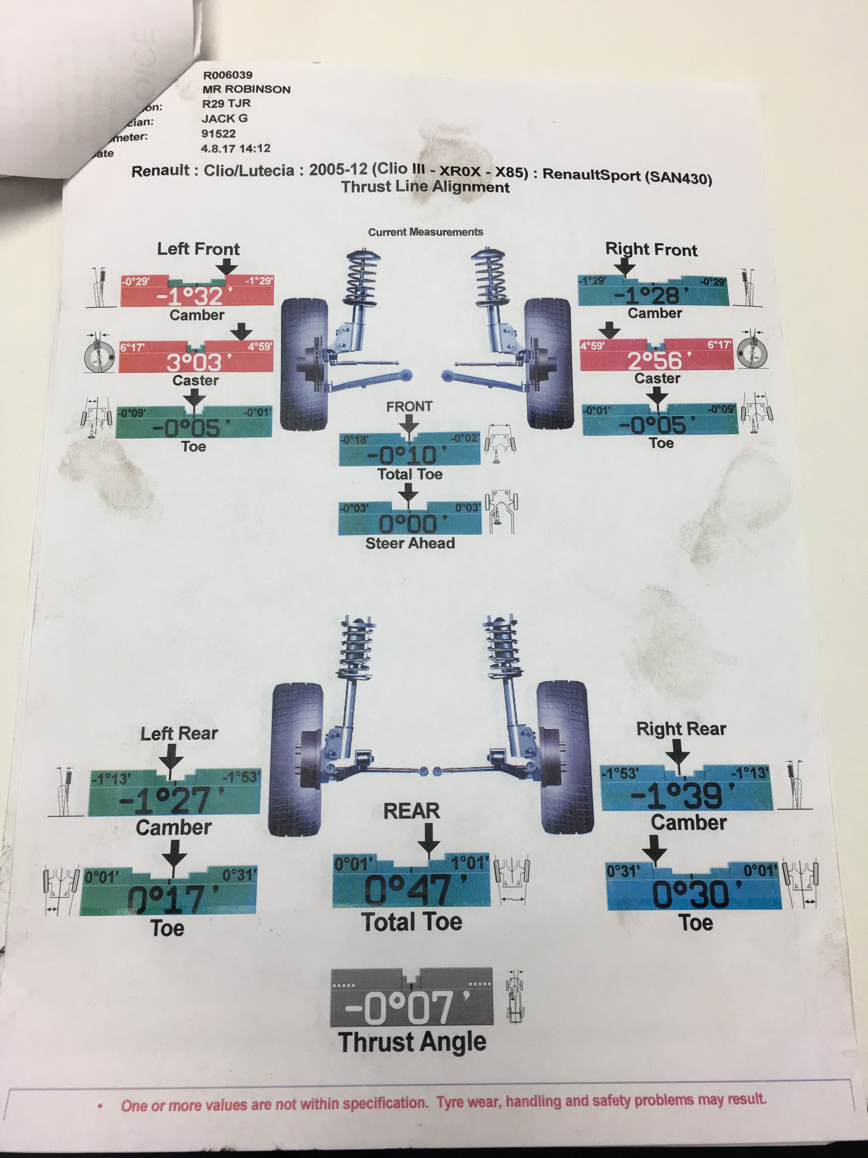

After:
I've only driven it home but its much nicer to drive on the road and next Tuesday evening I'm on track so I'll be able to see how it handles and I can tweak the setup accordingly there after.
For those that are interested Elite charged me £116 for the following:
  • Wheels alignment
  • Wheel balance (all four)
  • Camber Adjustment

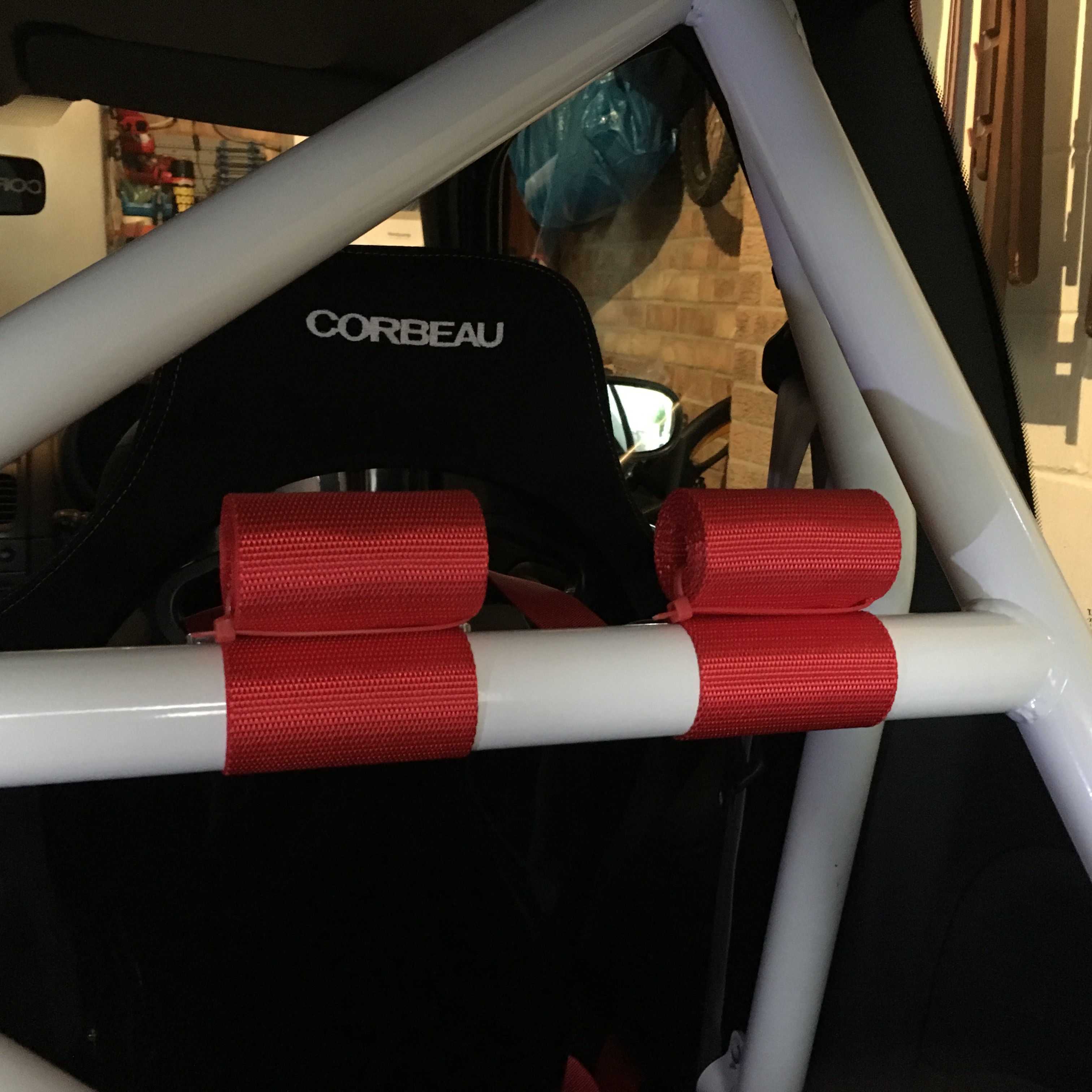

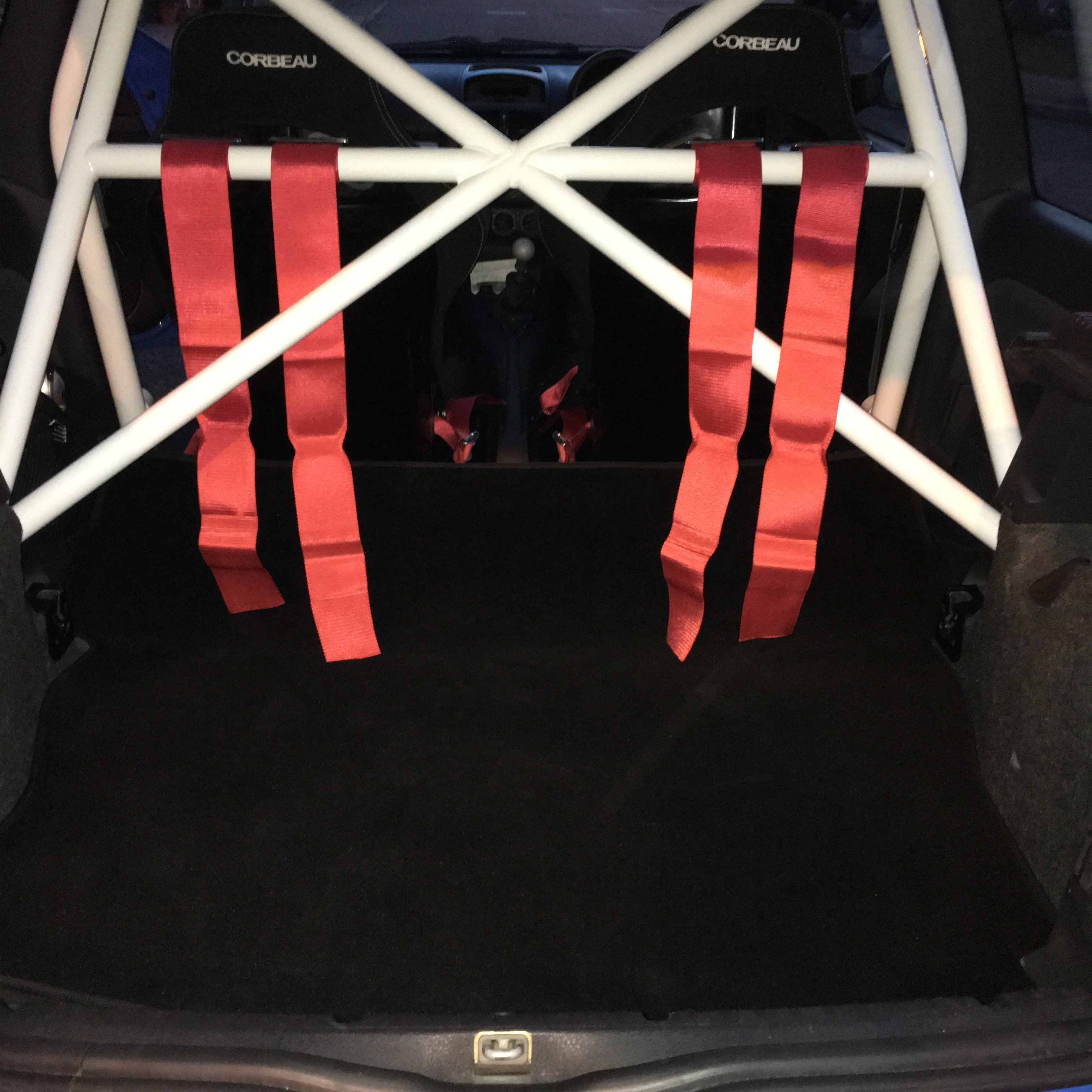

Finally my 100 red cable ties arrived so I was able to finish the harnesses:

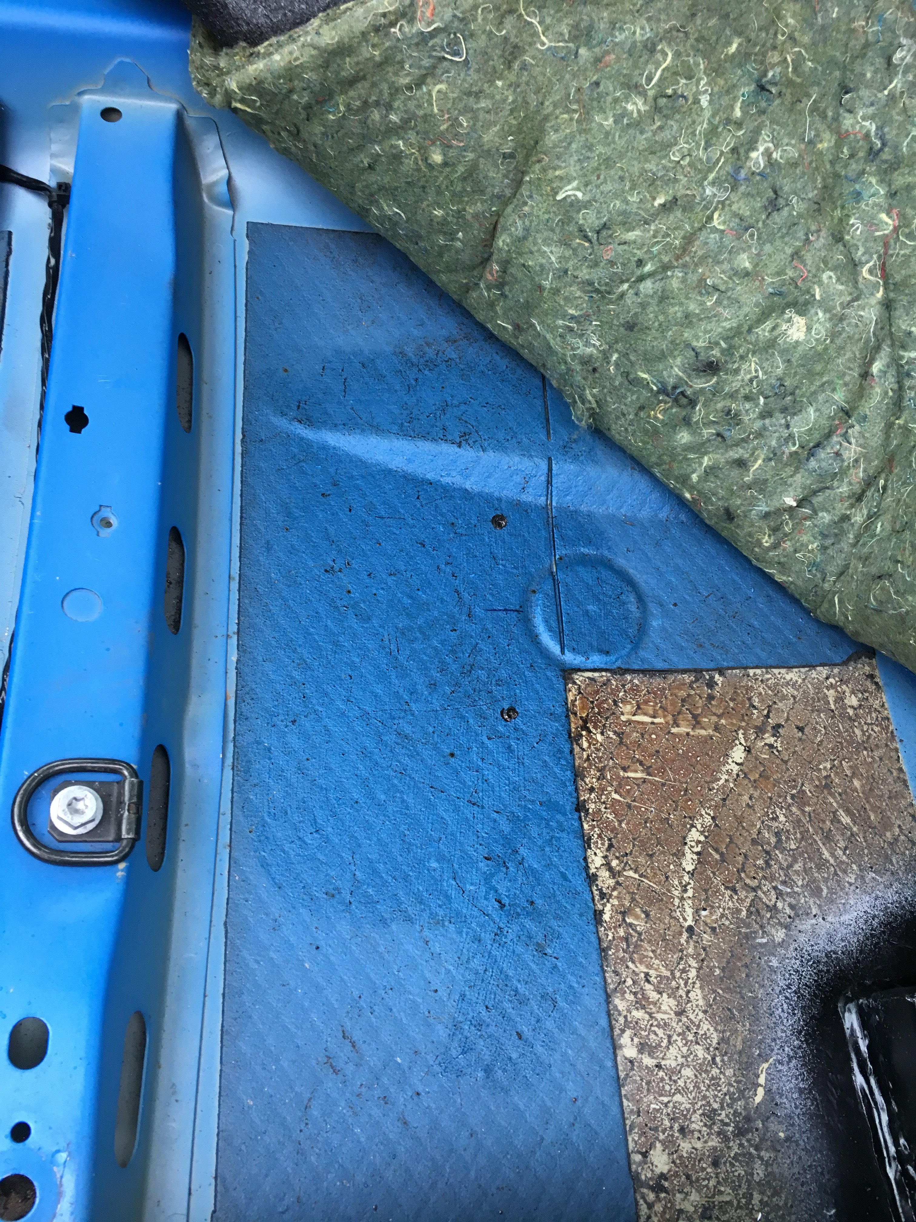

I then went home and finished undersealing the welded sections where the cage removed the original protection, however forgot to take any pics!
