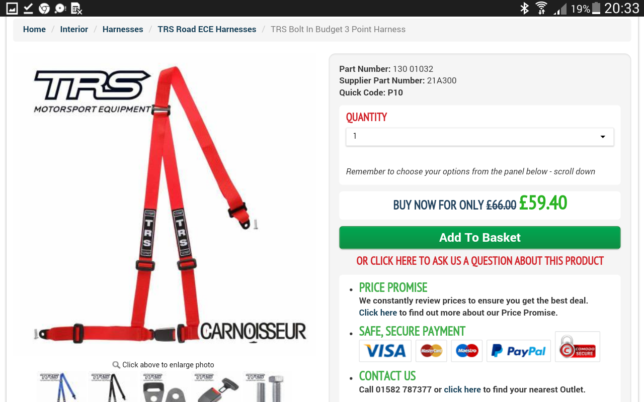

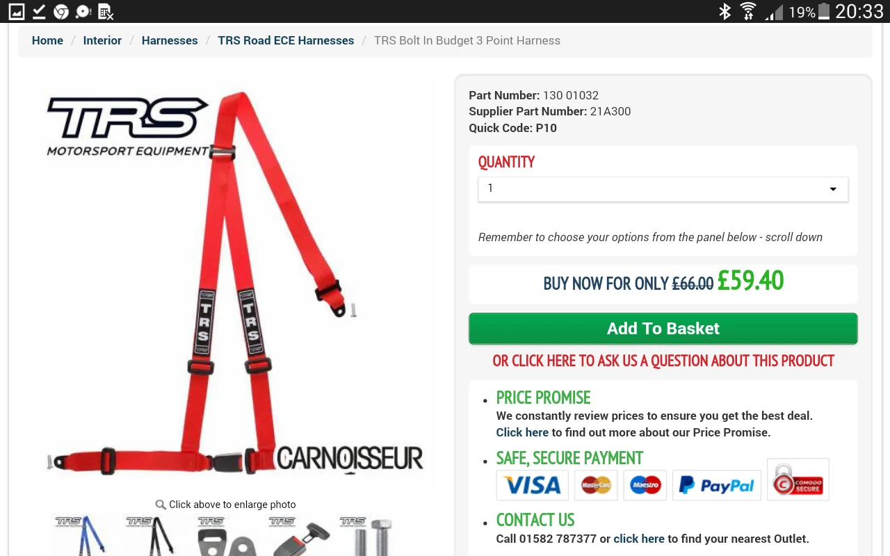

Just a quickie on harnesses ...... This type (2 shoulder straps on one mount) are a no no in any class

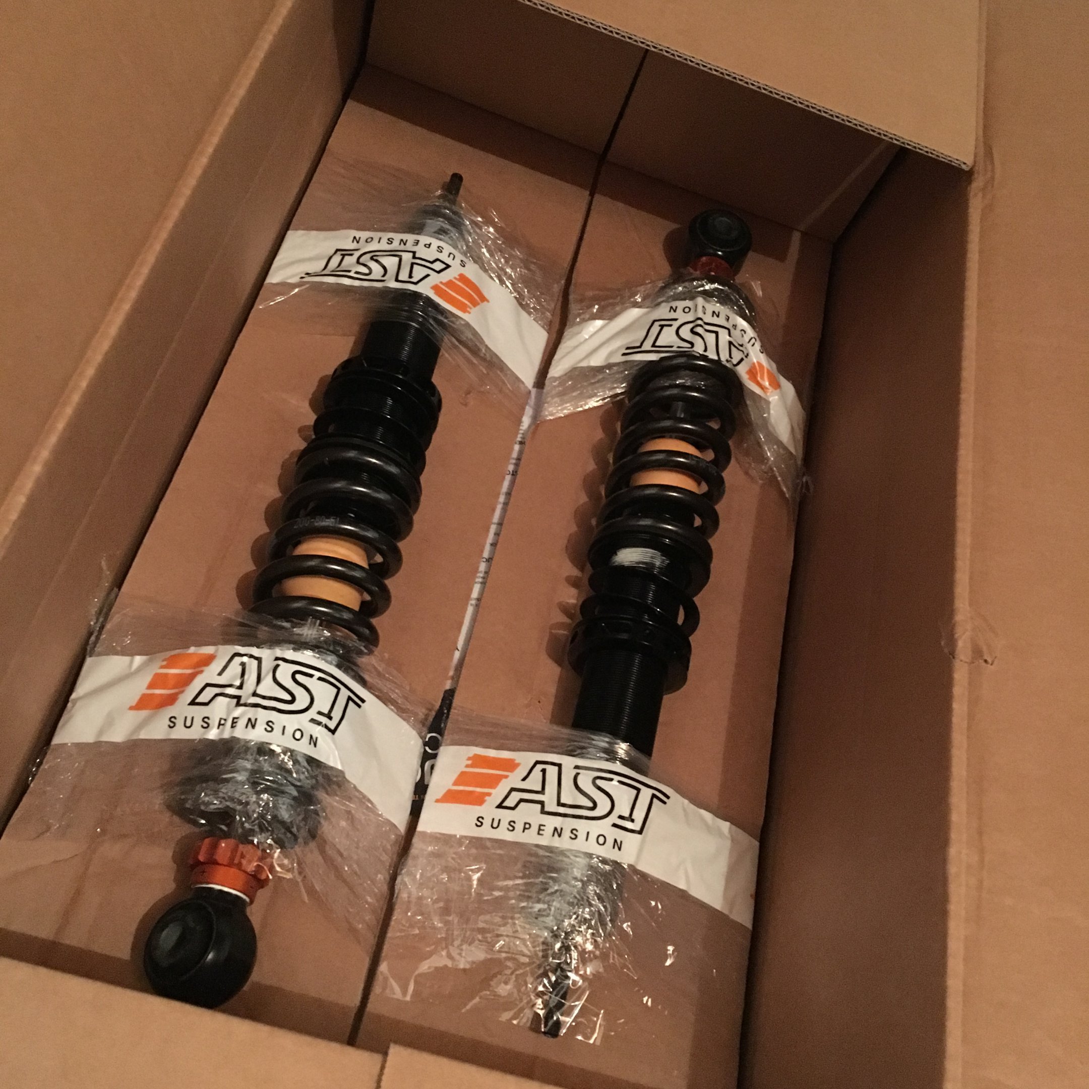

So after a sour ending to 2018 with the Valeo clutch giving way after around 1,000 miles, I saw this as a time to upgrade, I'll be honest I got a little carried away and had the following work done:

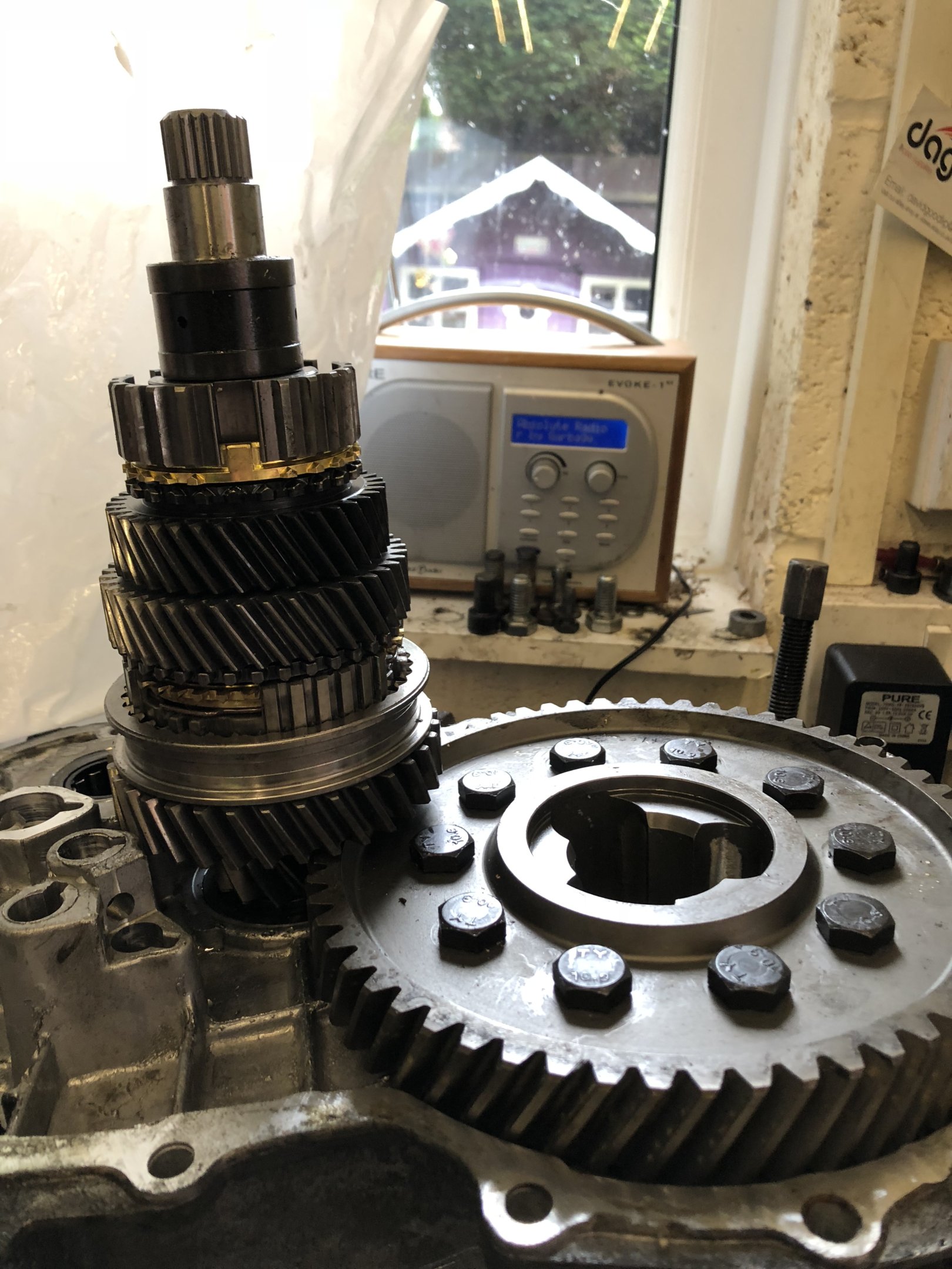

As the car would need to be off the road for a while while @NorthloopCup rebuilt the gearbox I sent the car to Alex at AW Motorworks, I can't recommend him highly enough, excellent communication and just a nice bloke.
I dropped the car off at AW Motorworks early November 2018, in the hope of getting the car back for the last ever trackday at Rockingham on 8th December 2018. As the gearbox was being rebuilt this was quickly removed and sent off for Mark to work his magic, again I would highly recommend his services. ? While the gearbox was being rebuilt it was fitted with a Gripper diff and a 4.53FD alongside the new TTV lightened flywheel.

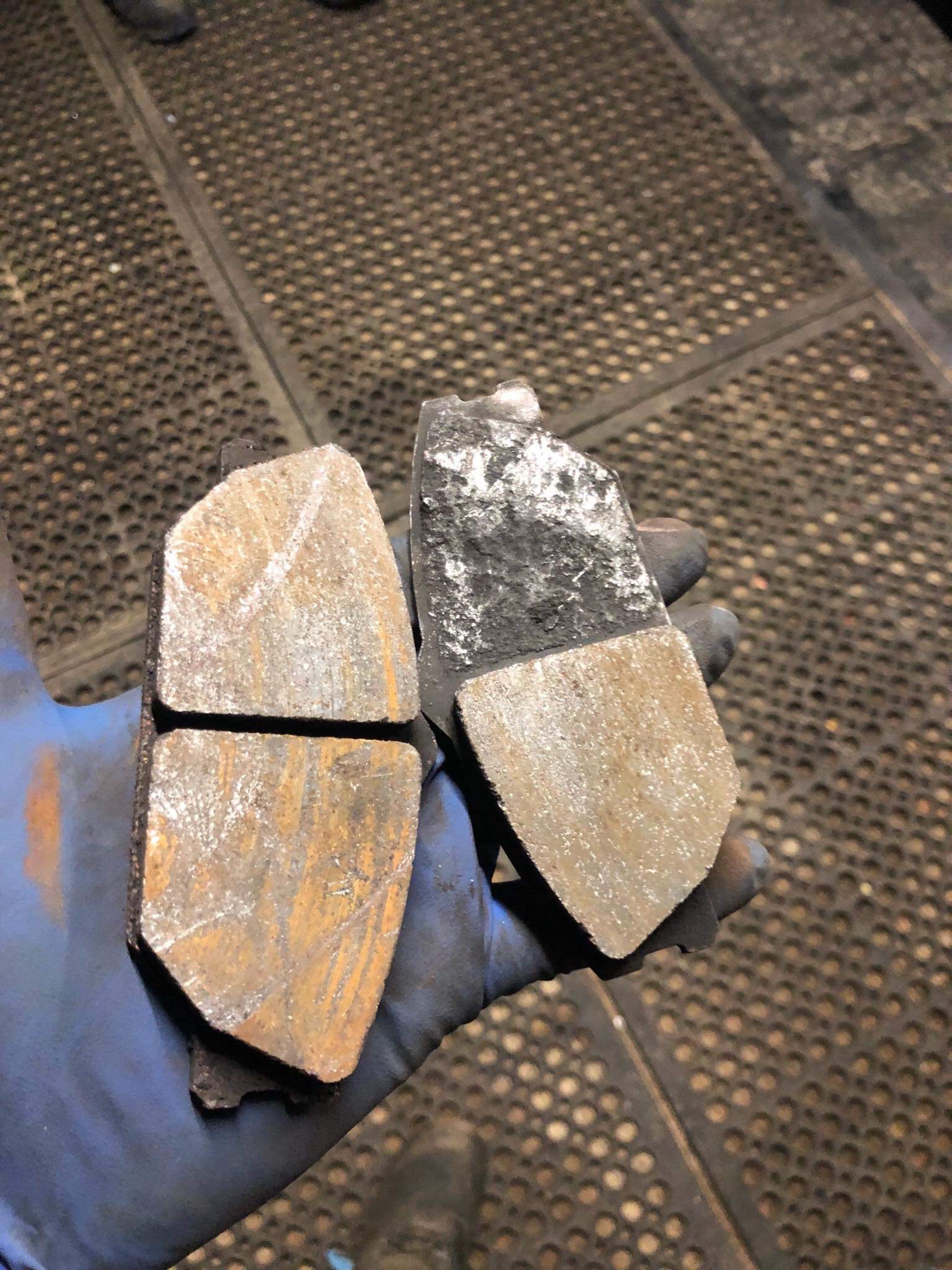

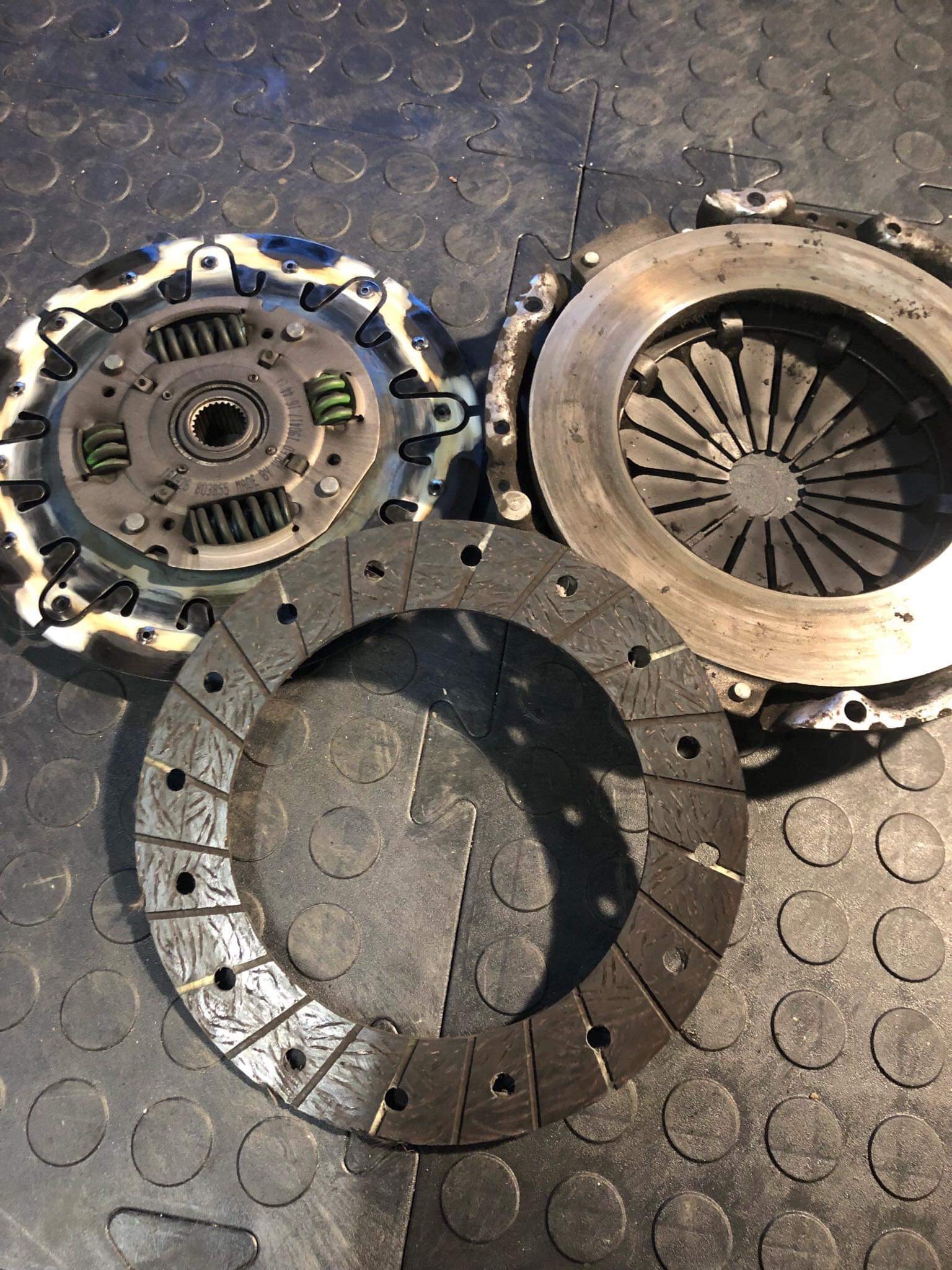

This was the state of the Valoe clutch after 1,000:

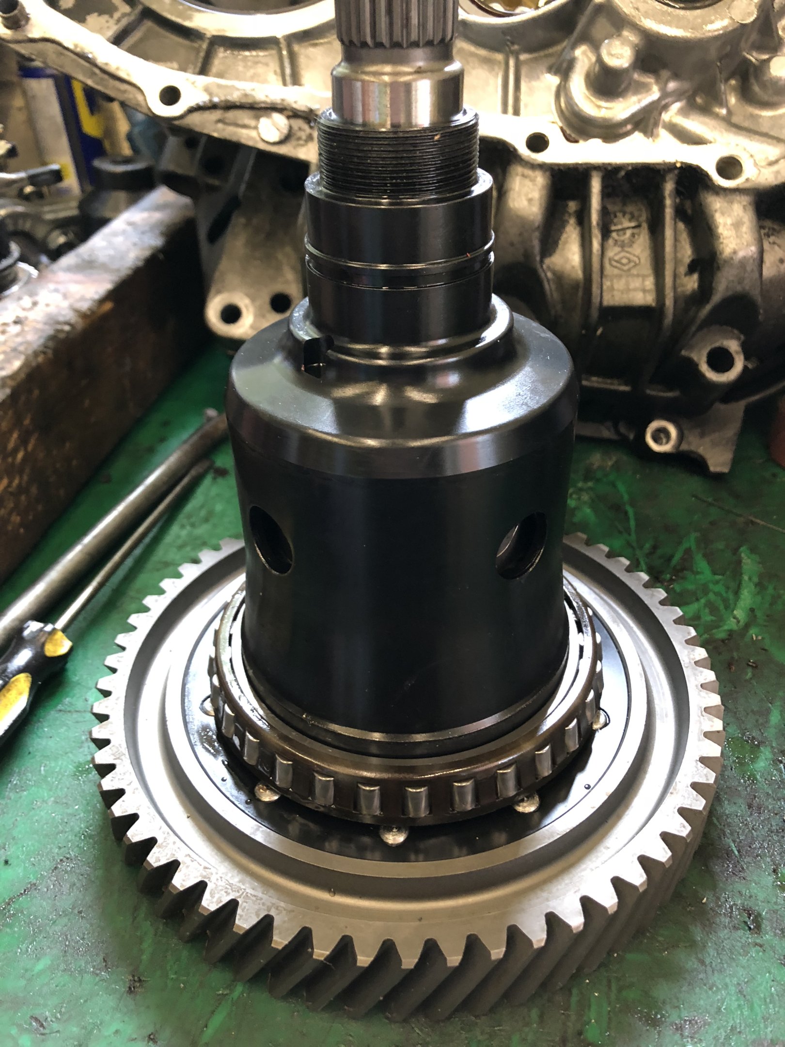

The gearbox was rebuilt and collected however we were still awaiting on the HELIX clutch (nightmare to deal with) and unfortunately due to the delay I made the decision to fit another Valeo unit. I've since received the HELIX clutch kit so I may make the decision to fit this in the summer but we'll see.
A few pics while Mark was rebuilding:

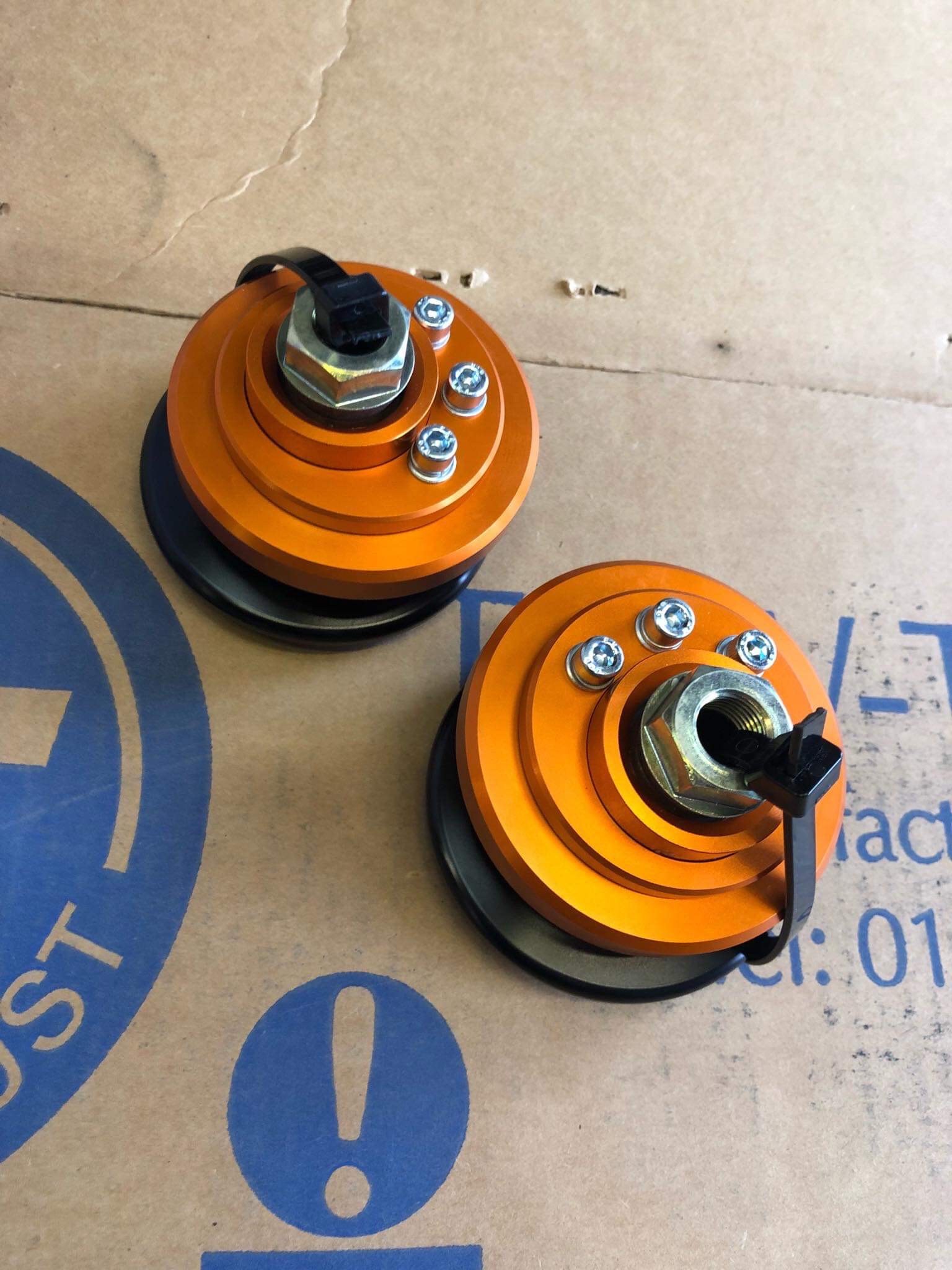

I didn't initially plan on changing the suspension but I the GAZ items where only ever a short term fix so I got these fitted:
So as I was geting closer to the Rockingham track day Alex noticed this...
CL RC5+'s after again around 1,000 miles! So I missed using the Clio at Rockingham which was a bit sad, however I've now fitted DN1.11s, due to the Clio not being ready I gave the Abarth its first go on track, I didn't enjoy it!

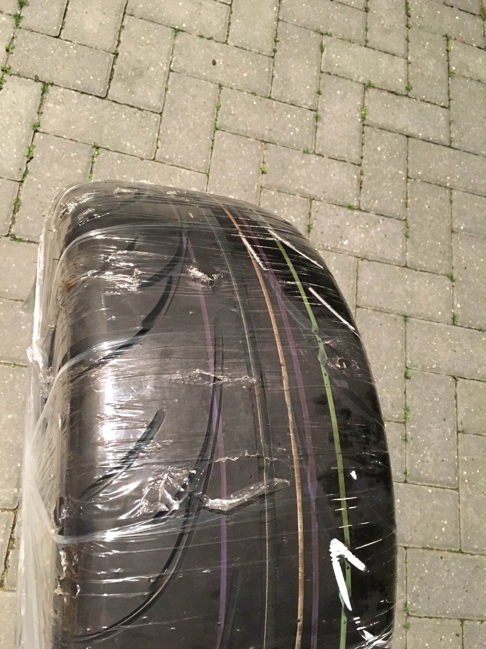

Finally in prep for the 2019 season I purchased a set of Interstate Tyre based on the recommendation of @GrahamV182 so i look forward to giving them a go:

Great update .... Re the 'Race DNRT' tyres: did you go for 195s or 205s?
I'd be interested in your thoughts on the tyres. I personally don't think they are quite as good as Extremes - but great value for money.
I've gone for 195, as I found 205's rubbed badly. I plan on fitting them to my TD Pro Race 1.2's and using them this year, save a little weight. I'll report back with progress.

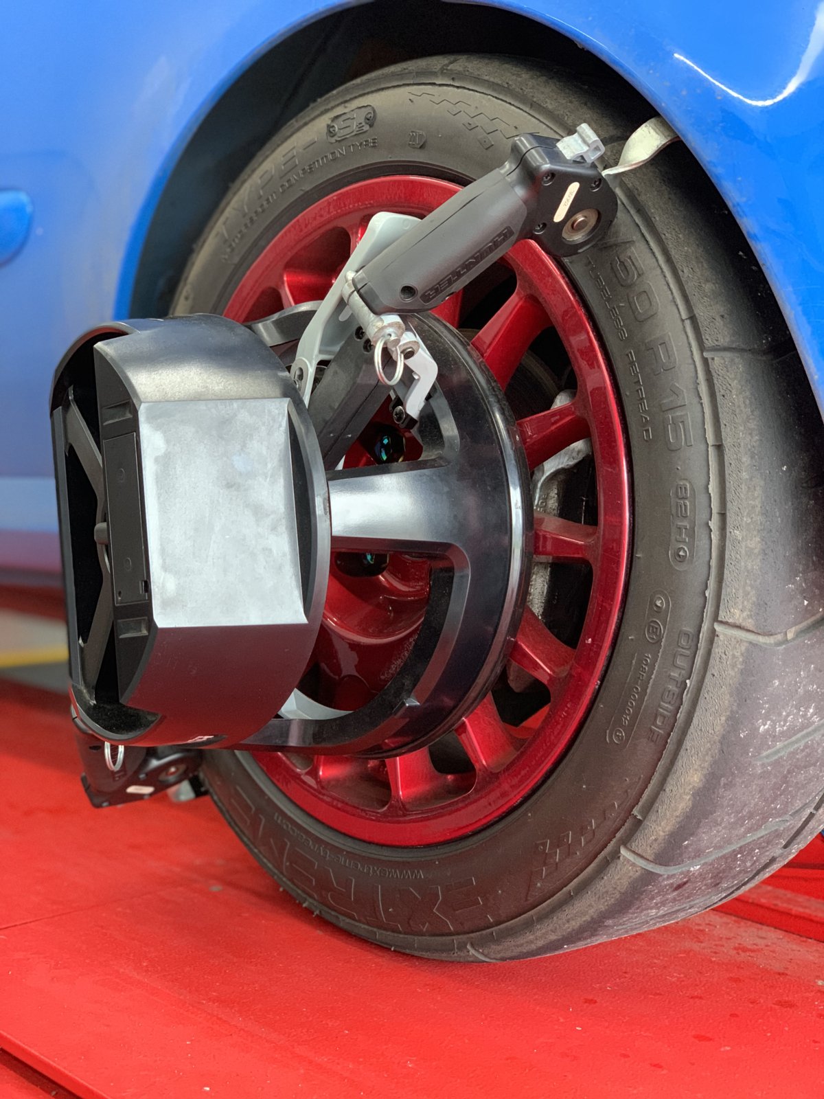

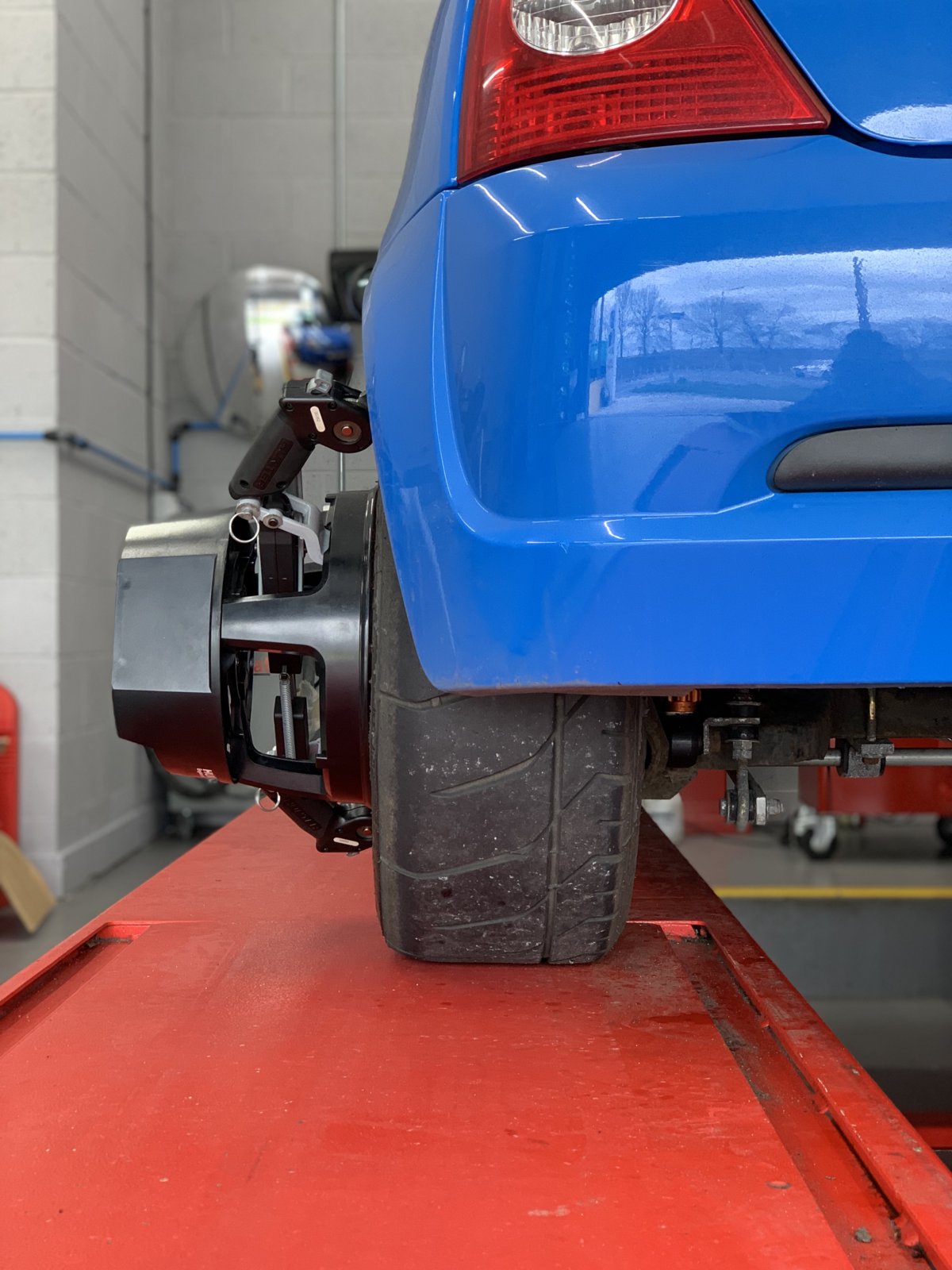

Where did you get the alignment done mate?
A place called DGT in Basildon. I basically told them what I wanted and they did it, but I don't believe they are experienced enough to advise.

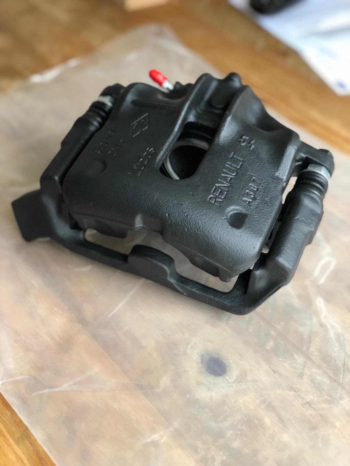

So with me not being able to do much, i started gathering parts for the Clio, all going well I could be back in the car sprinting in September, so I wanted to make sure its ready to go when I'm on my feet:

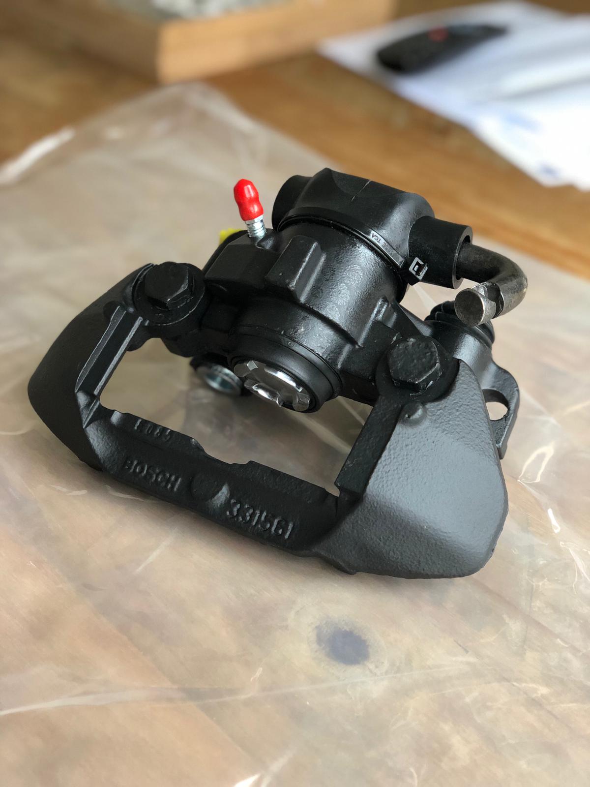

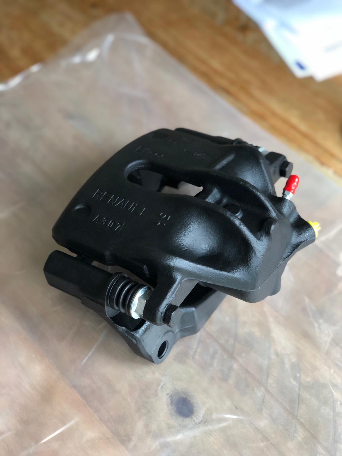

Firstly I sent my callipers off to Bigg Red to be refurbished, to be honest they where one of the best companies I've ever dealt with in the car industry. Good communication, mega quick turnaround and when they forgot to add stainless nipples they posted them out for next day delivery, they also look great
In hindsight I should have got them painted in the "premium" finish but we will see how these cope with the heat.

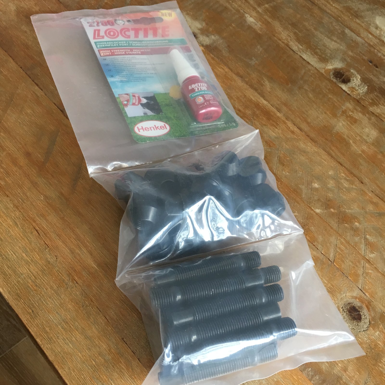

Next on my shopping list was a set of wheel studs, last year I had a few issues with my wheel bolts coming loose. I'm also currently running a 20mm spacer which I don't like as its hard work to check the bolts on the hub spacer are tight also plus I can go down to a 10mm spacer which I will prefer. I was looking at items on eBay, which I am sure are just as good however I wanted the piece of mind so went for the PMS one:
Also makes its nice and easy coming with the loctite. I also ordered a set of 10mm spacers for the front but no pic yet!

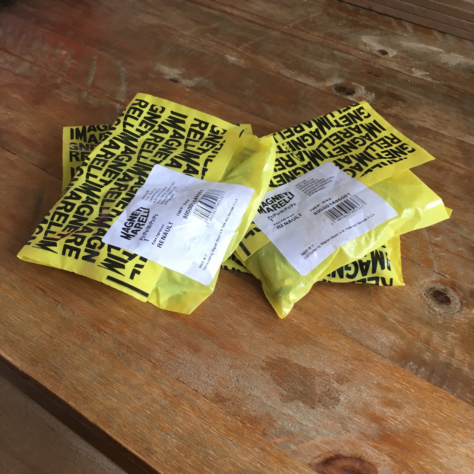

Although I've had no issues I thought it would be a good time to change the injectors, as they haven't been changed in my ownership and when going through the paperwork I'm not sure when they have ever been changed. I went for OEM (Magneti Marelli), hoping they are not copies!

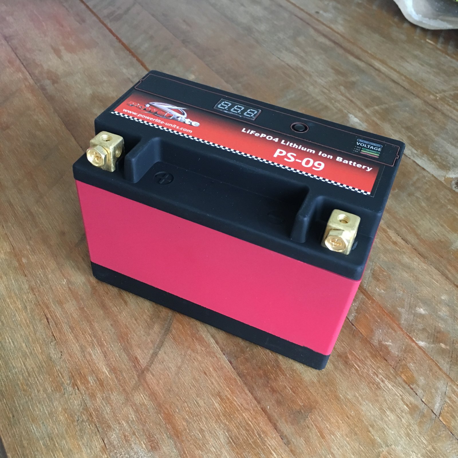

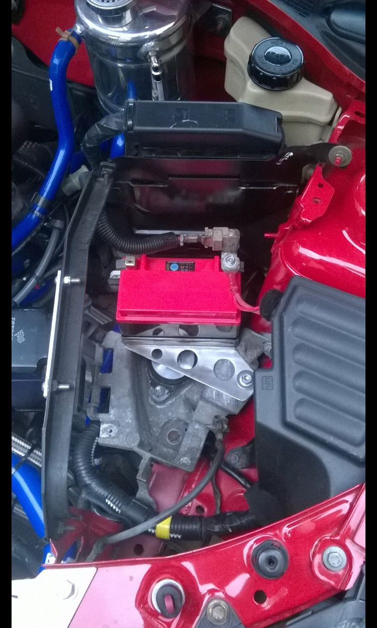

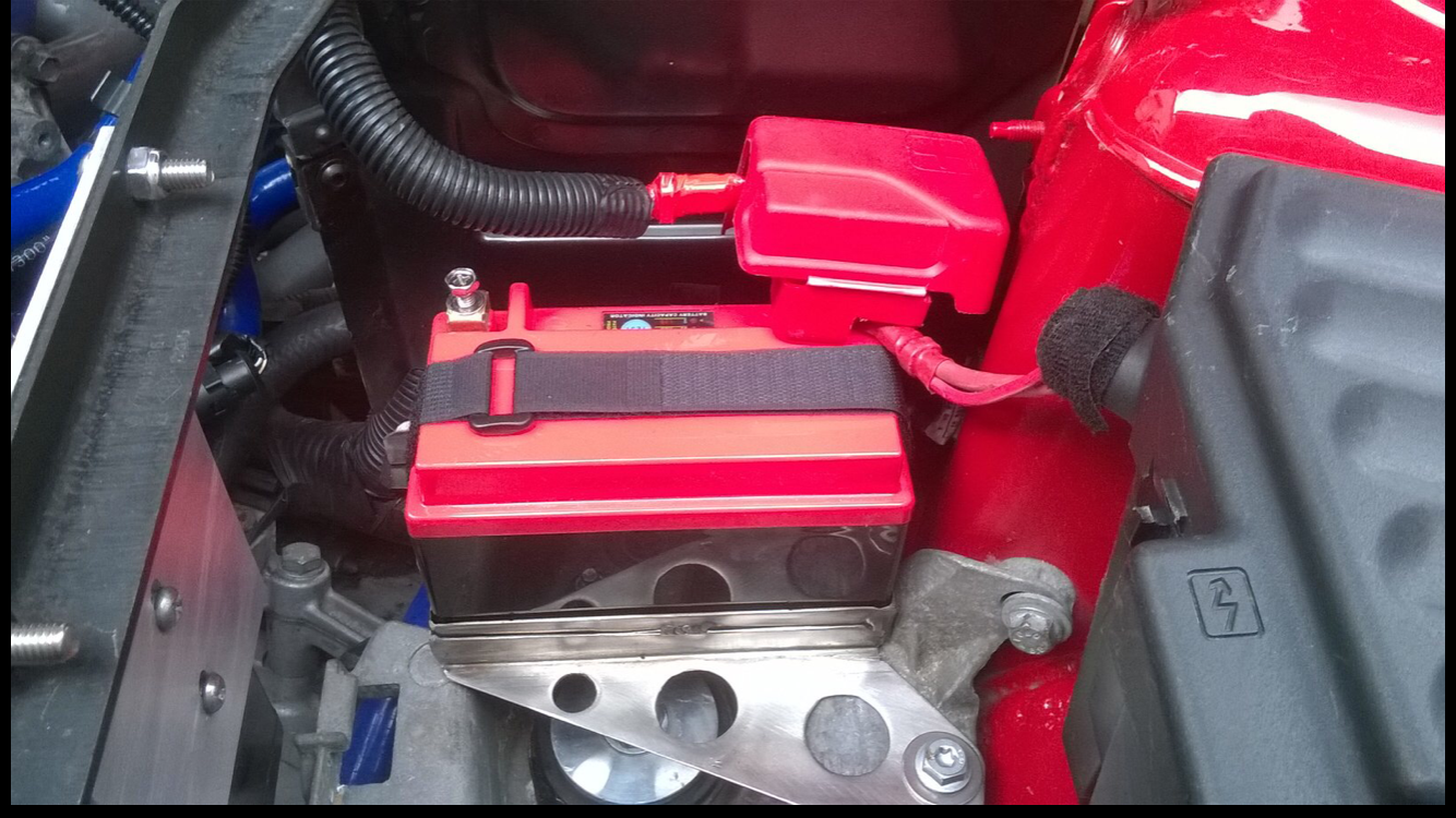

Finally after much online shopping around I decided on a new lightweight battery, as I don't use the car that often, I've gone with the Power Lite PS-09 which appealed to for a few reasons:
  1. Cost. This was only £95 delivered, which cheaper than the odyssey version.
  2. Weight. This is only 1.4kg which is far lighter than the odyssey version.
  3. Size. Its tiny, around 1/3 of a normal battery, thus leaving me more room in the engine bay. (Size (mm) (W x D x H) - 150 x 87 x 104)
  4. Comes with a charger. As the car is sitting in a garage most of its life its good that this comes with a charger so I know its ready to go when I am.
I'm going to leave the battery in the engine bay as it'll save weight on all the extra wires, secondly I'm not sure how batteries in the cabin are viewed by MSA and finally personally don't see the benefit unless you need the room up front. Oh and it also has a very cool voltage display panel.
I just need to work out how I can fit the batter in the OEM location, although I think I remember @cpaterson76 made a lovely bracket for his old trophy.
View attachment 1414336View attachment 1414338View attachment 1414339
I am also going to purchase a new set of leads and a coil pack which I'll order this week.

Did the job nicely and with a little Velcro strap all was secure ? and like u say at 1kg batter why add the weight of relocation cables....

Where did you get the battery from as I can only see the ps/05 and ps-20 for sale?
Got it from a chap on Facebook Allan McDonald, if you search him, but they are hard to find, I got his last one.
Also interested in the battery - looks very good value …..
Did you buy a package? i.e. charger, battery and mounting cage?
As above Graham. Contact Allan he was really helpful. The battery comes with a charger as standard but no mounting brackets which is what I’m hoping @cpaterson76 can help with.
I ordered a Velcro strap from eBay which I hope will be sufficient to hold it in place with a cage.

Maybe stupid question but,why are these small lightweight batts no good for daily use?
If I'm honest I'm not sure, just from what I've read online! I think the Odyssey ones are ok for every day use but this one is much lighter. From my limited knowledge I just think this is a little low on power output, I'm not sure how long it will last if parked up for a few days not on charge.

Ok mate,will have to look into it.Would be nice to have a smaller batt,not bothered about the weight side of it,just be good to have more space for the induction filter & doing bits in the area.
R29TJR
  2005 RB 182 Cup
This was my main reason, to give a bit more room around the battery to help with the air filter, as its mega tight in that area.
