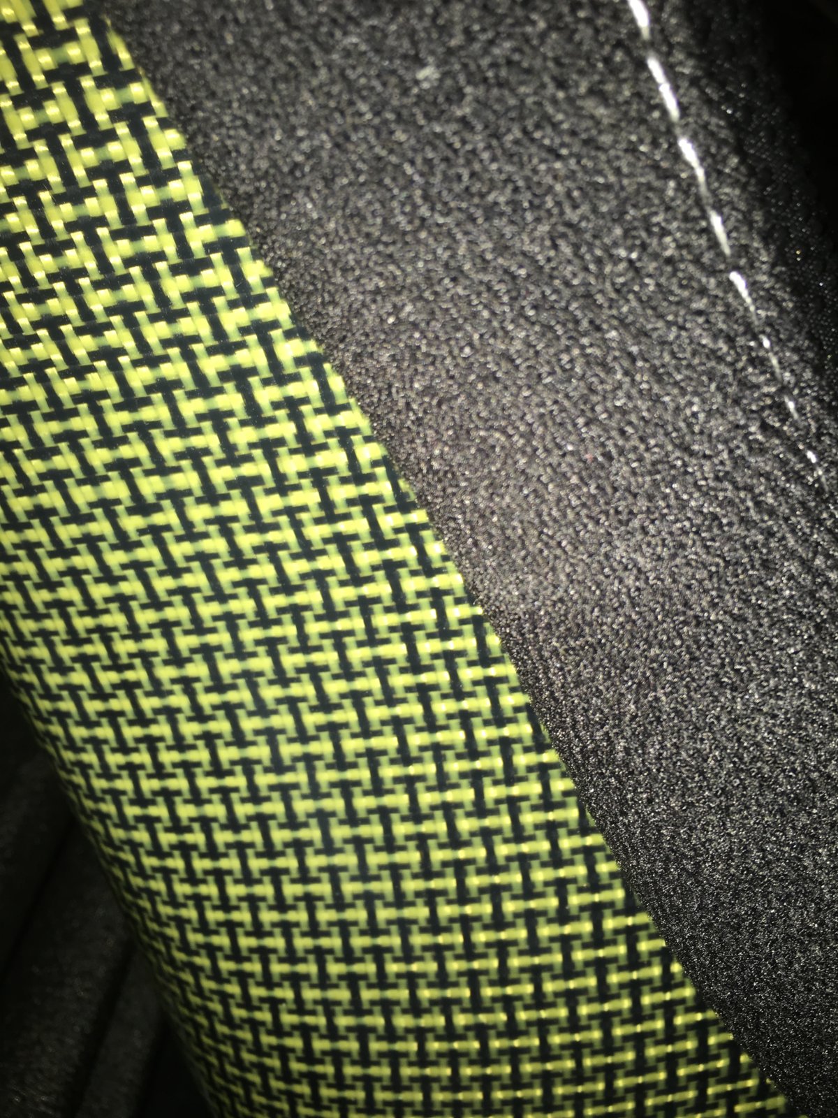

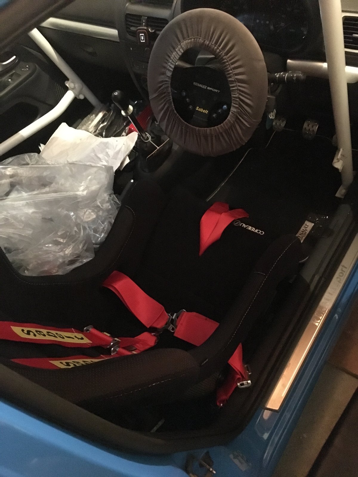

So on Wednesday evening I did sensible thing and contacted Corbeau to find an XL seat that could be delivered before Friday! I dealt with a chap there who was really helpful and managed to get a Corbeau Pro Series in Carbon/Kevlar. Its a lovely seat and its so much more comfortable than the Club Sports, really good value for money and looks amazing too.
As I was away at the weekend for my 5th wedding anniversary I only had Friday evening to fit the seat, which to be honest was a horrid job, mainly down to lack of movement in my hip, bearing in mind I've only been walking unaided for around a week at this point!
Seat arrived:
Unfortunately I'm unable to run my door bars with the new seats, but I'm hoping when I'm more mobile I can see if this can be changed.
Look so nice...

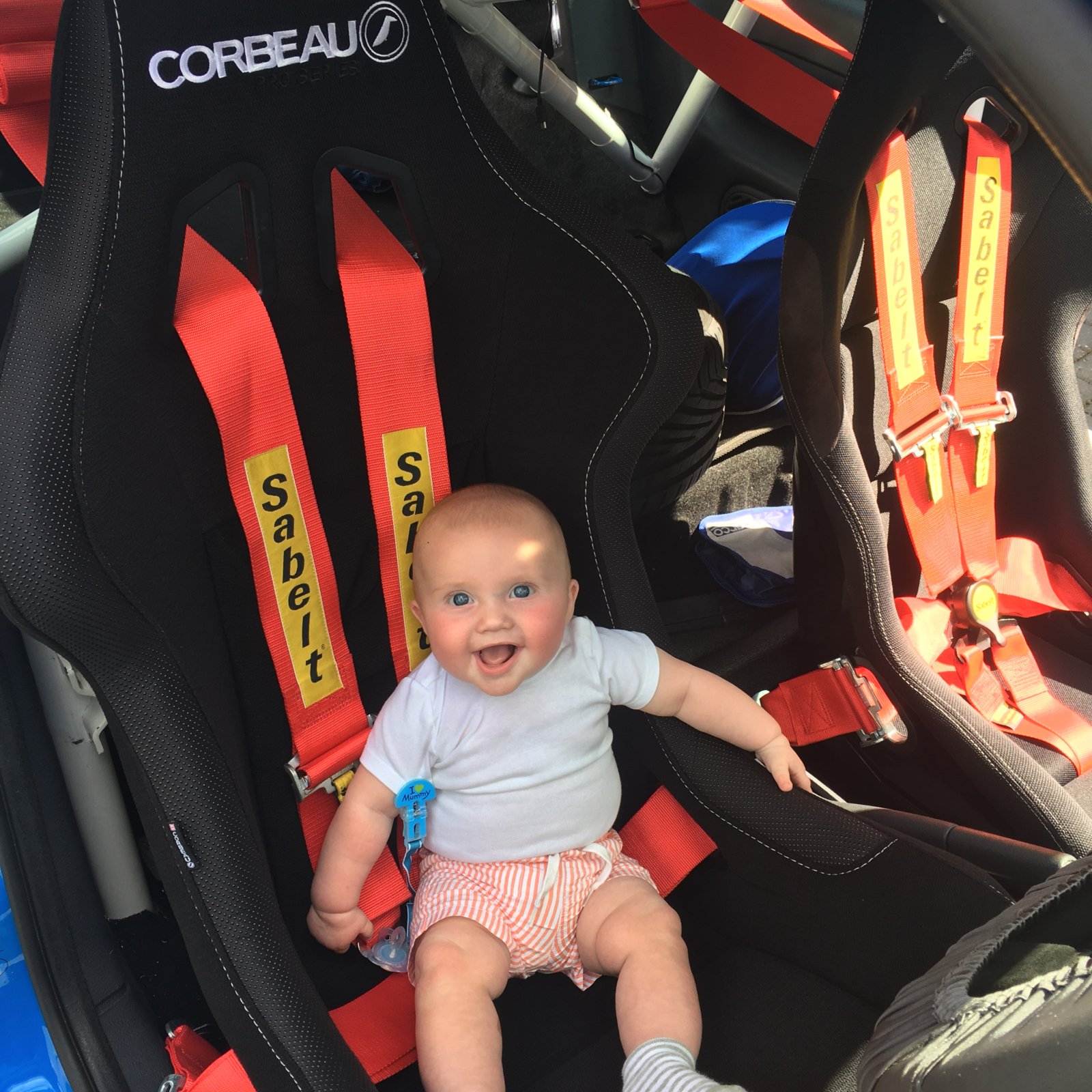

Cooper loved the new seat:
