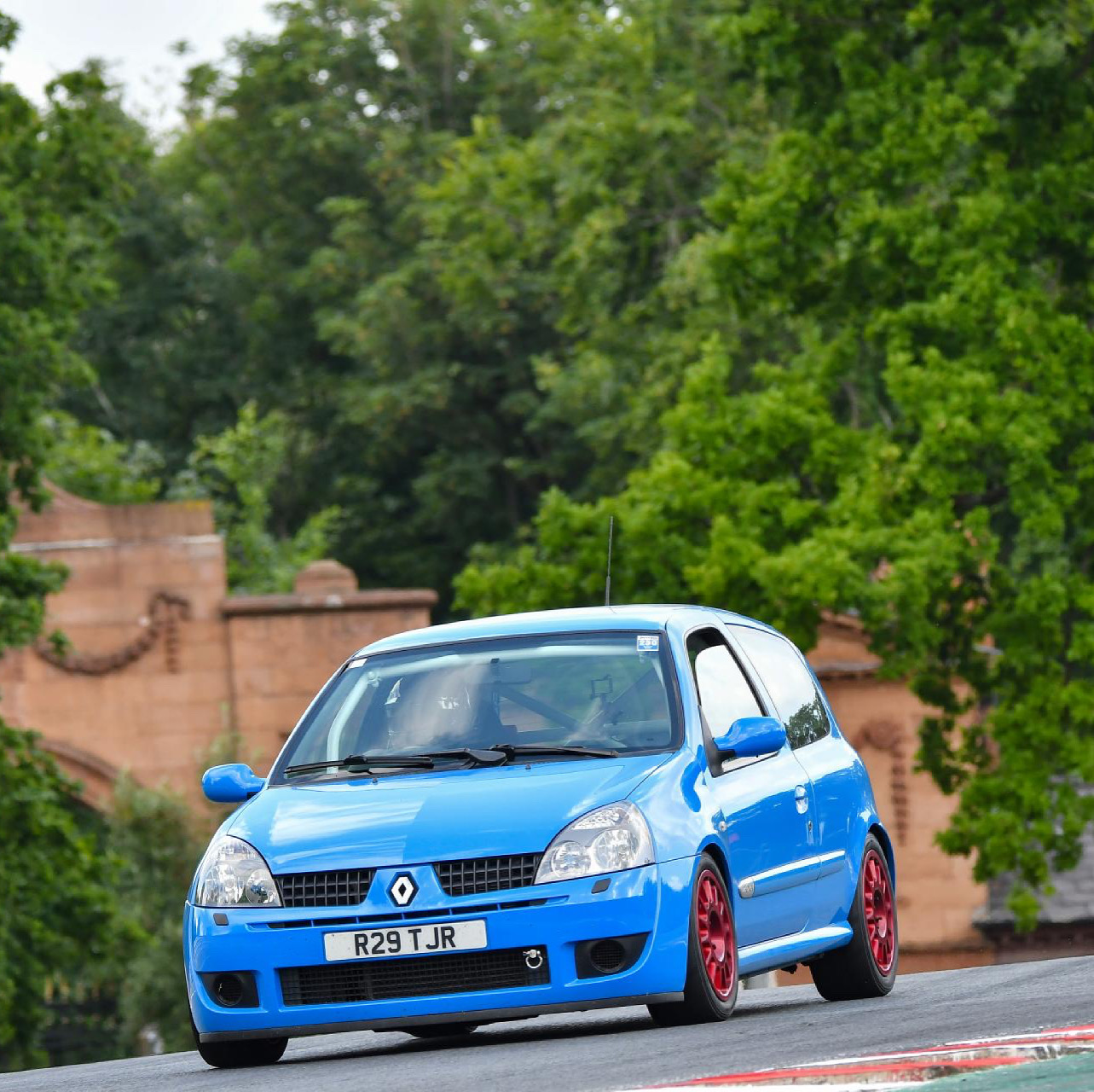

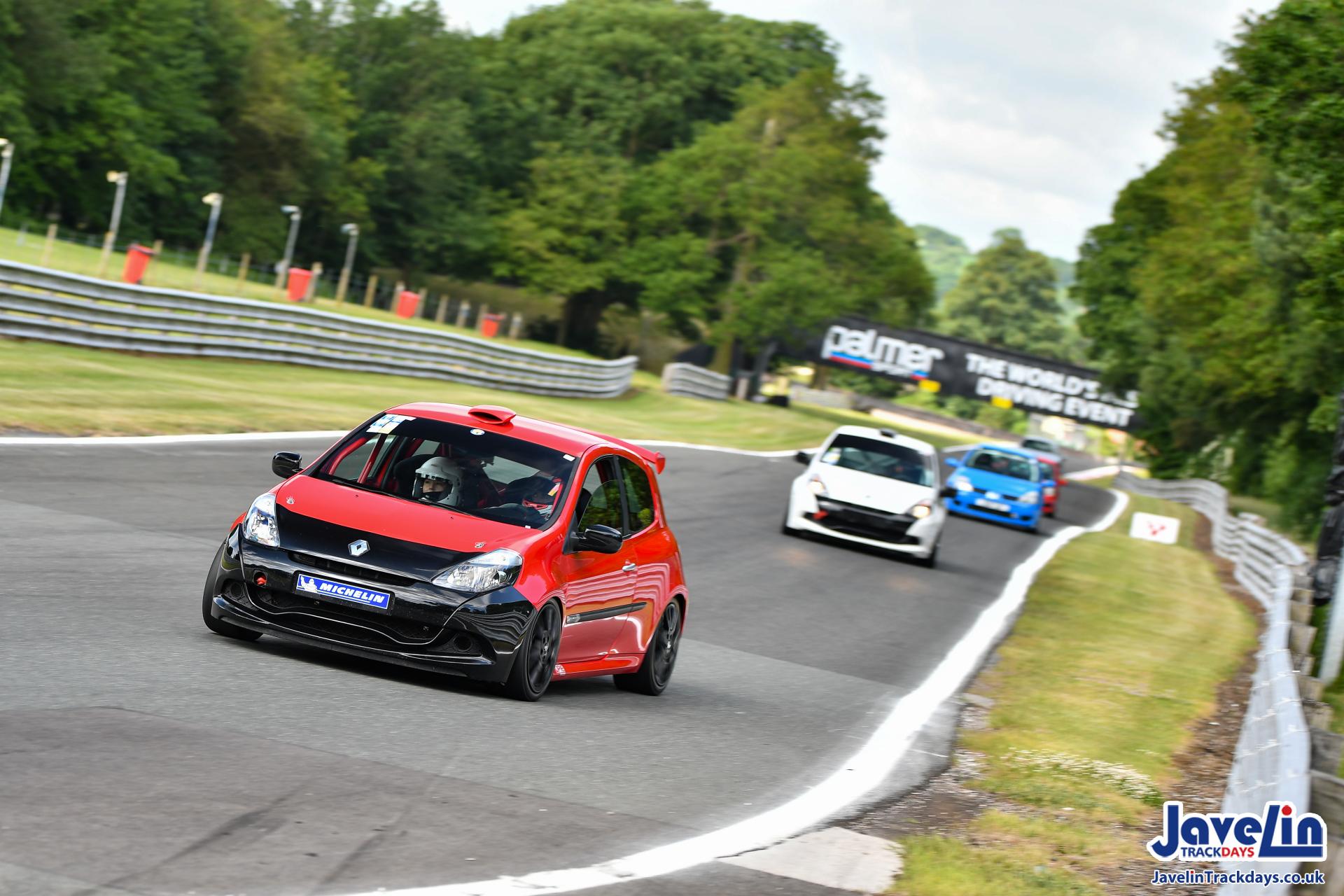

Love the "through the trees" pic!
This is also my favorite pic, currently my laptop background!

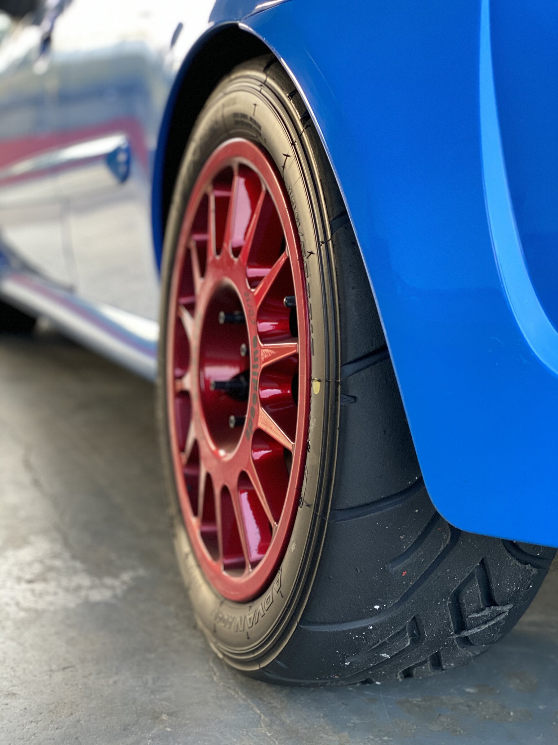

First off I wanted to say how impressed I am with my Yoko A048's, they aren't road legal however on track they are absolutely amazing plus look cool also:

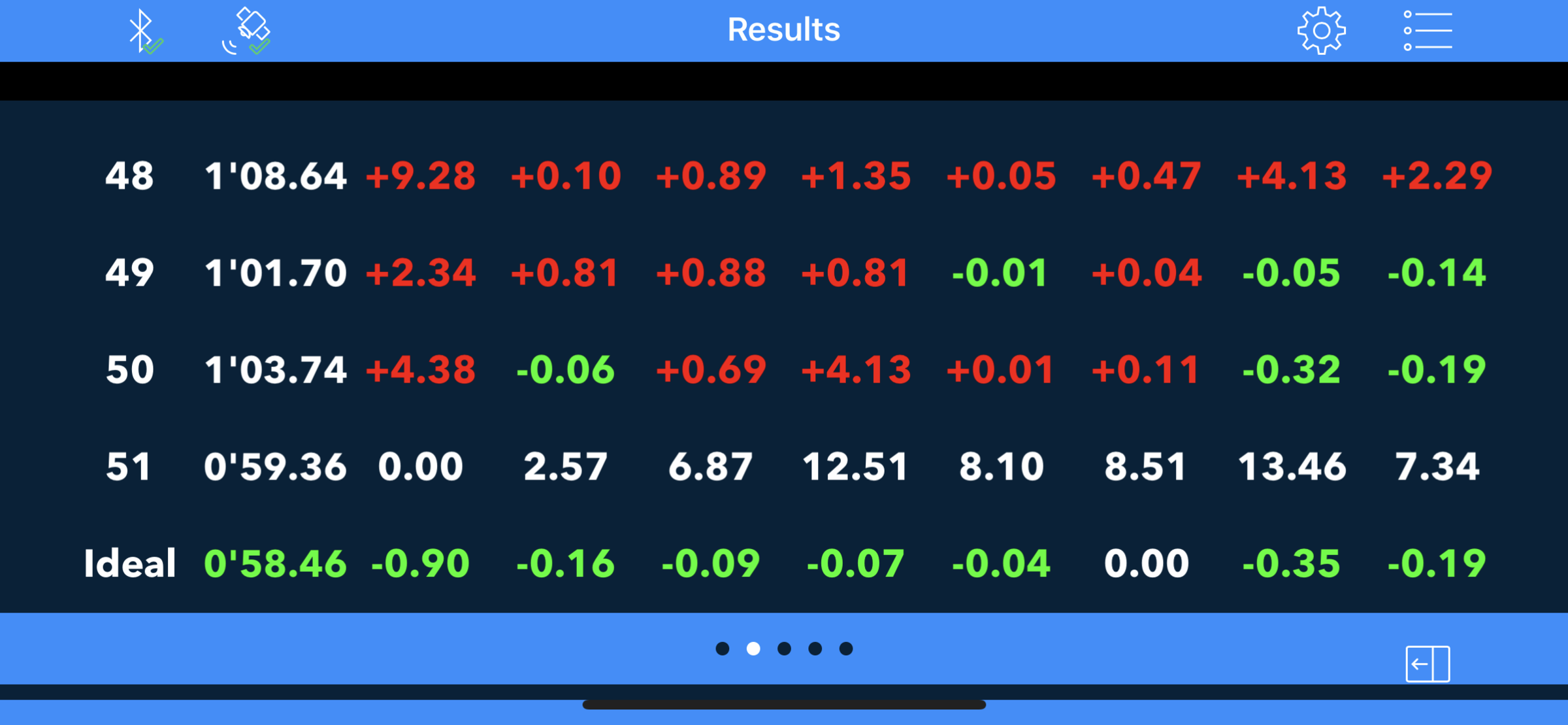

I can't remember what detail I went into regarding my timing device but a few friend arrange a group buy of the vBox Sports which I absolutely love, the data you can pull from the device is amazing I won't go into full detail on this post but at some point I'll bore you with the details now I'll save that for another post but I genuinely believe this device alone has made the biggest improvement to driving.

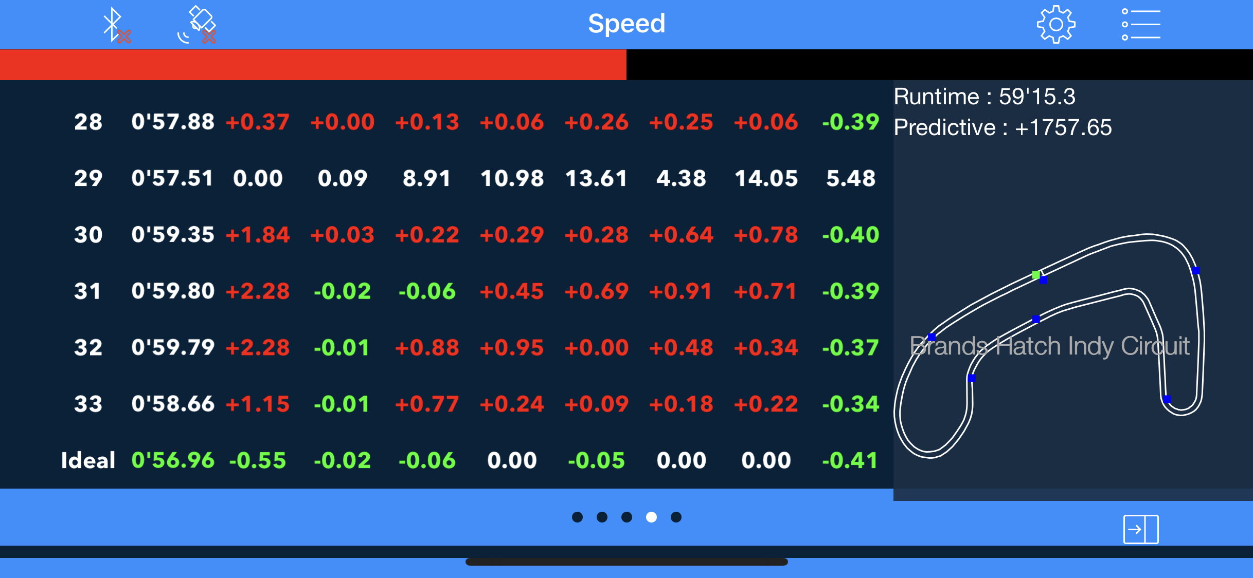

Anyway this is a snapshot from my evening session at Brands on 15th June 2020:
As detailed in my previous post this shows my best time of the evening being 59.36 but with the car offering far more and me growing with confidence.

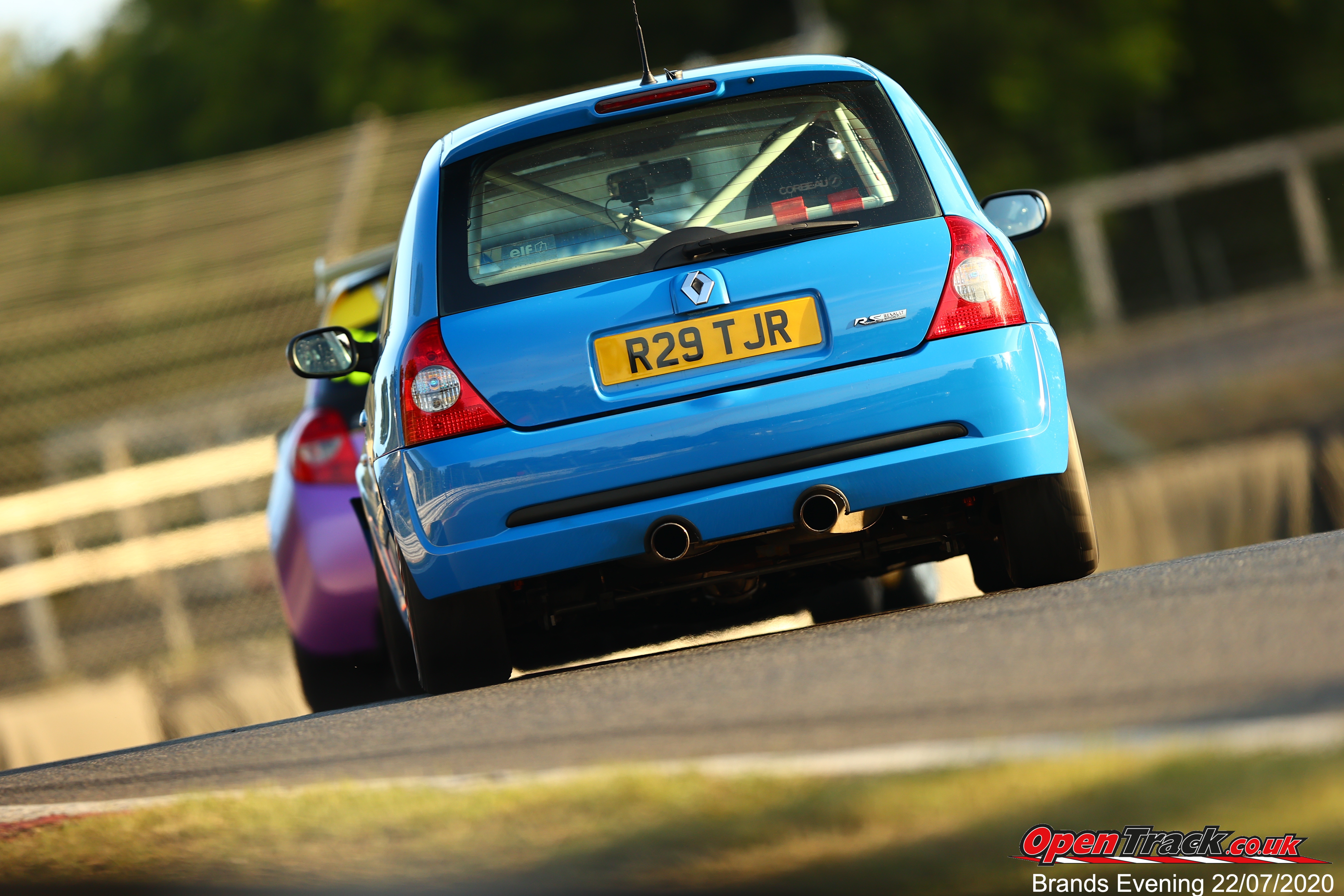

I say this a lot but this was my best track day to-date. I was on track with three Clio 200 Cup Race Cars, whom are all quicker than me but I hold my own! Was only an evening session this one but got plenty of laps in and some great pics from Opentrack.
I also beat my PB around Brands of 57.51, and there is still a huge amount of driver improvement. I've found my VBOX has made me enjoy track days far more and has also improved my ability no end. I do not have the phone on display while driving however as I know the laps are recorded I concentrate more. Prior to the VBOX I would often find myself driving aimlessly. In short I save almost 2 seconds off my June track day.
Official Pics:

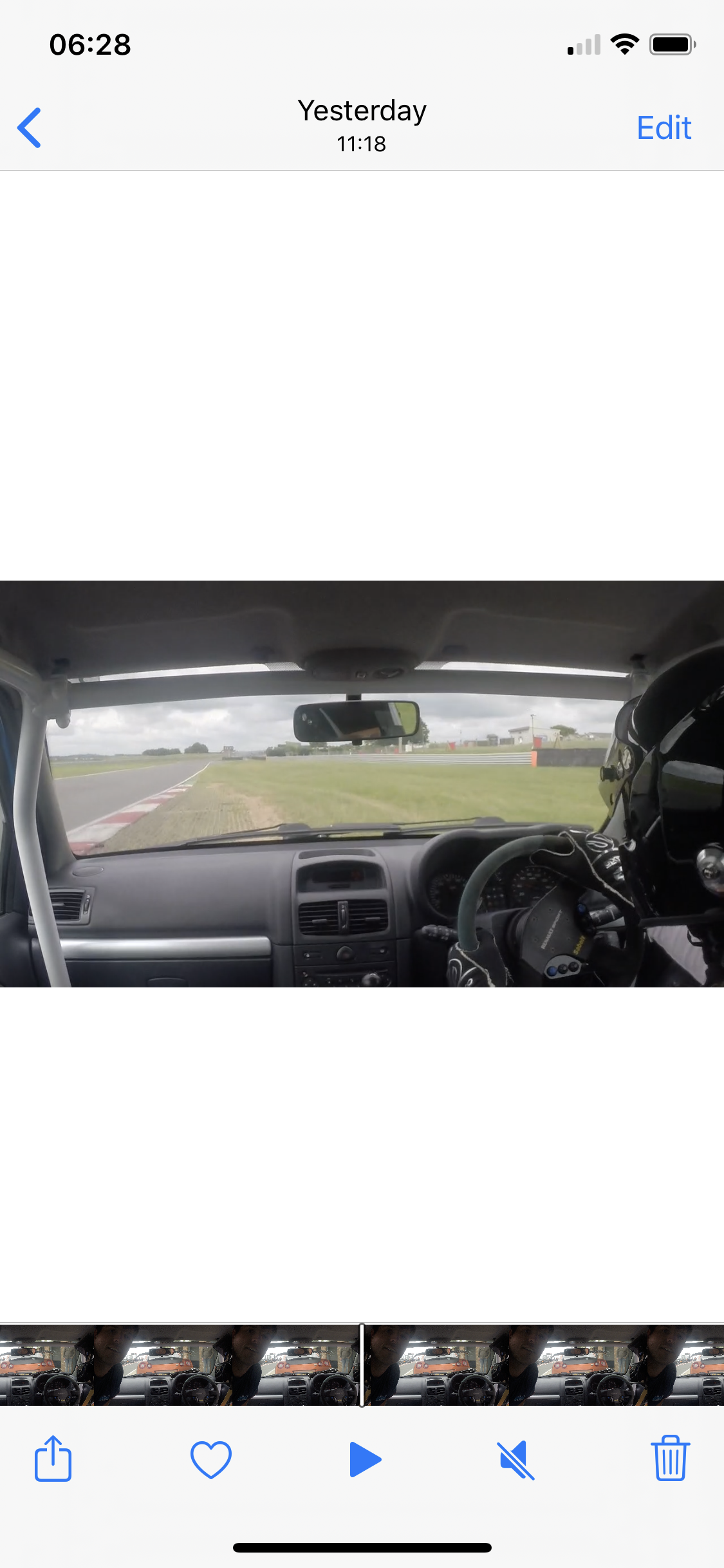

I might be being daft here mate but it looks like your helmet isn't strapped properly? The strap should go back under the chin instead of hanging towards n/s, at least it should on every helmet I've ever owned!
You're correct.
I've just found the whole session and I got distracted while putting my lid on. I've put it through the metal part but never actually tightened it up.
Good job I didn't crash.

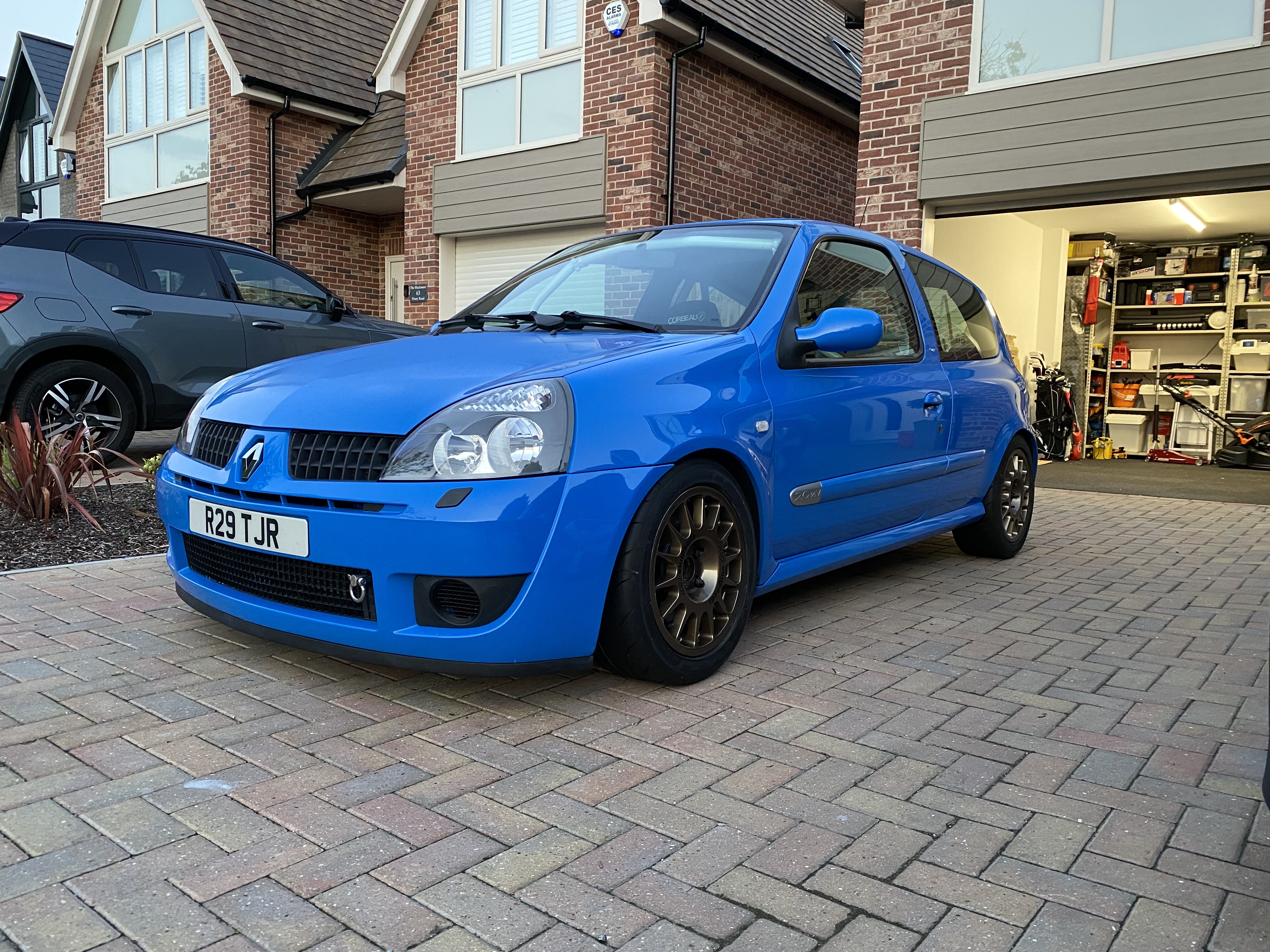

August 2020 - June 2021
Following my track evening at Snetterton in August 2020, the Clio had sat in storage until around May when I moved it into my garage. The car developed a starting issue, which some of you may have seen on IG. After many hours of searching for the issue the amazing Alex from AW Motorworks resolved the issue.

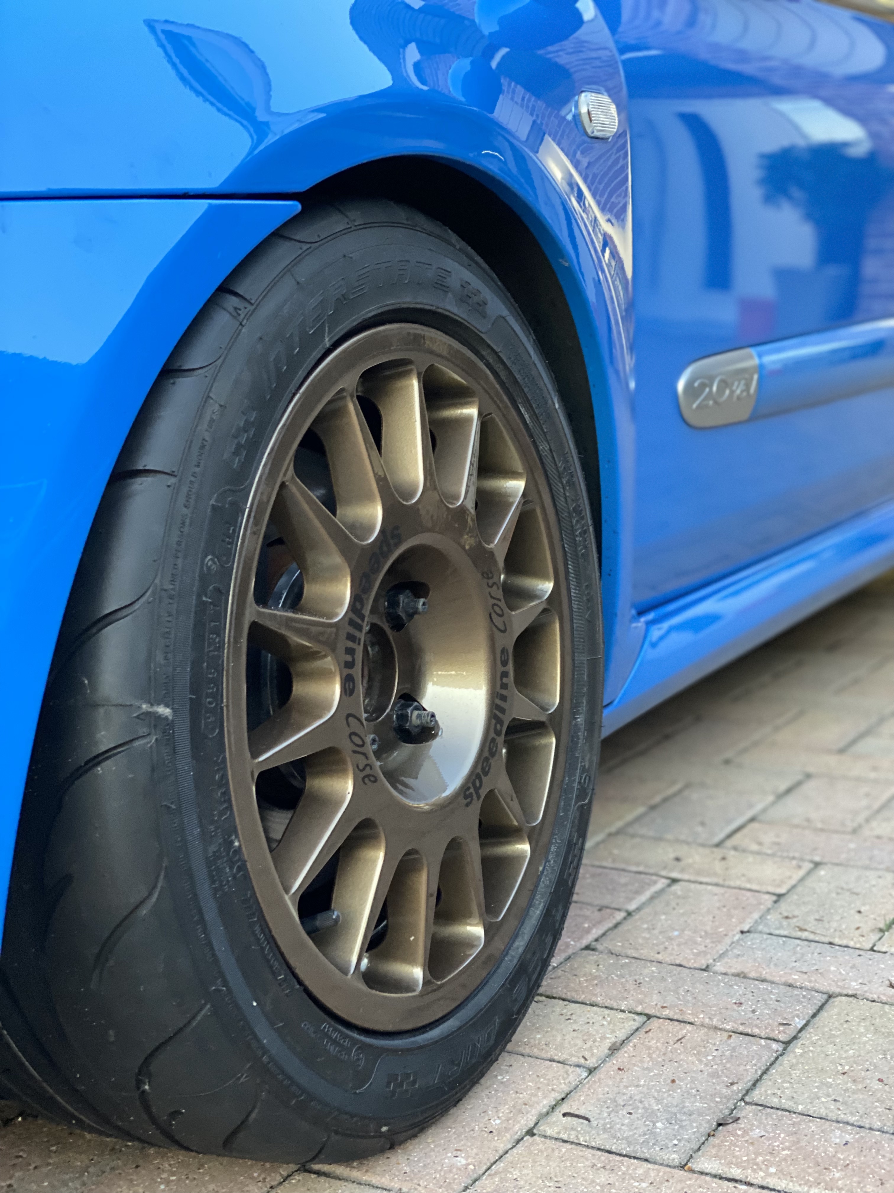

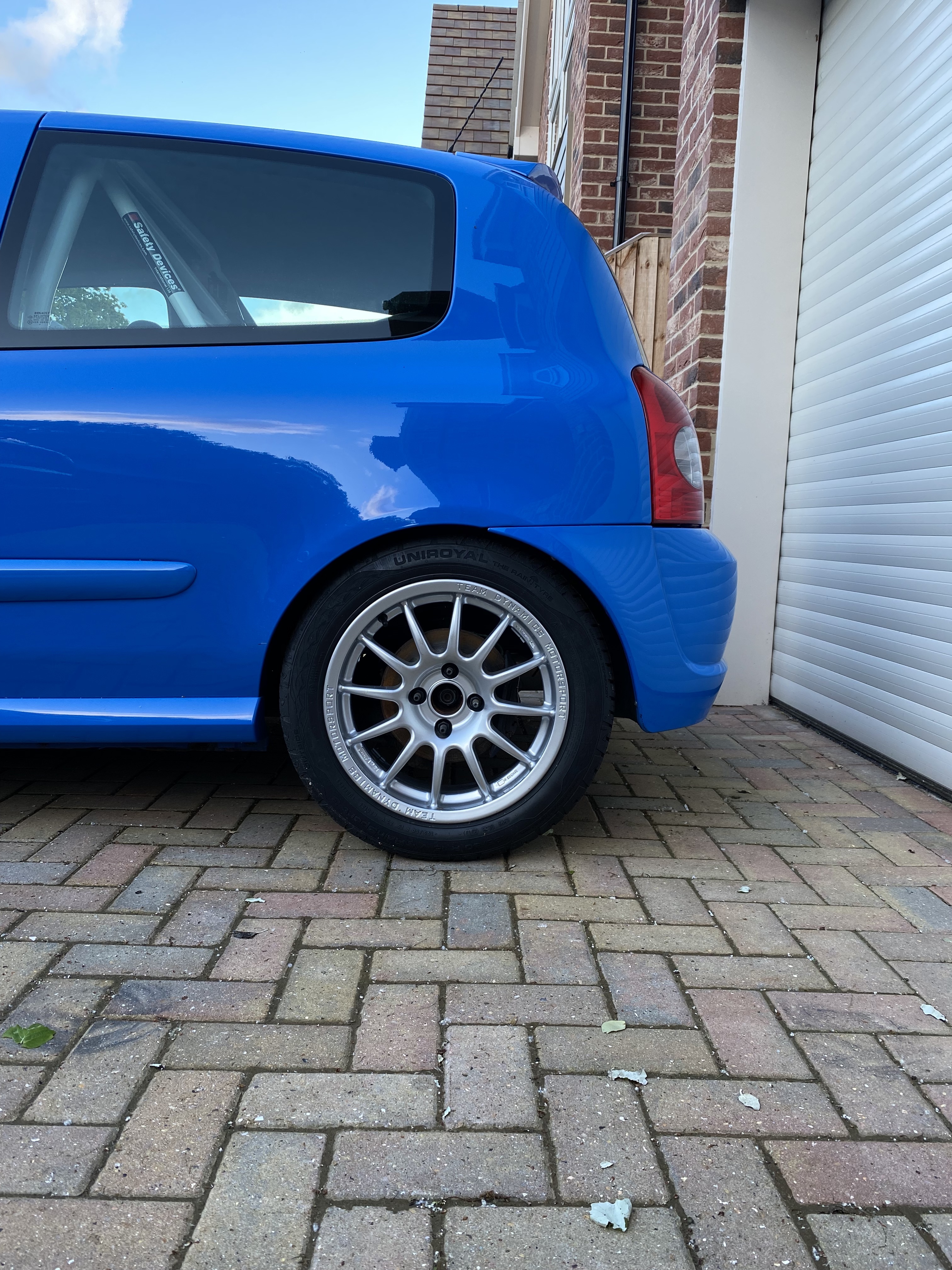

I then played around with wheels I'd accumulated, in short I still prefer the look of the 2118's however I'm very aware of how much they weigh. I've now got 3 sets of wheels:
1. TD Pro Race 1.2's Silver (Uniroyal RainSport 3's)
2. Speedline 2118's ET38 Candy Red (Yoko A048's)
3. Speedline 2118's ET38 Bronze/Gold (Interstate Race DNRT)
I'll look to fit a set of AR-1's to the Pro Race 1.2's so I can use them for sprinting as they are the lightest so should save me some time, while the 2118's I'll keep for trackdays/road use.

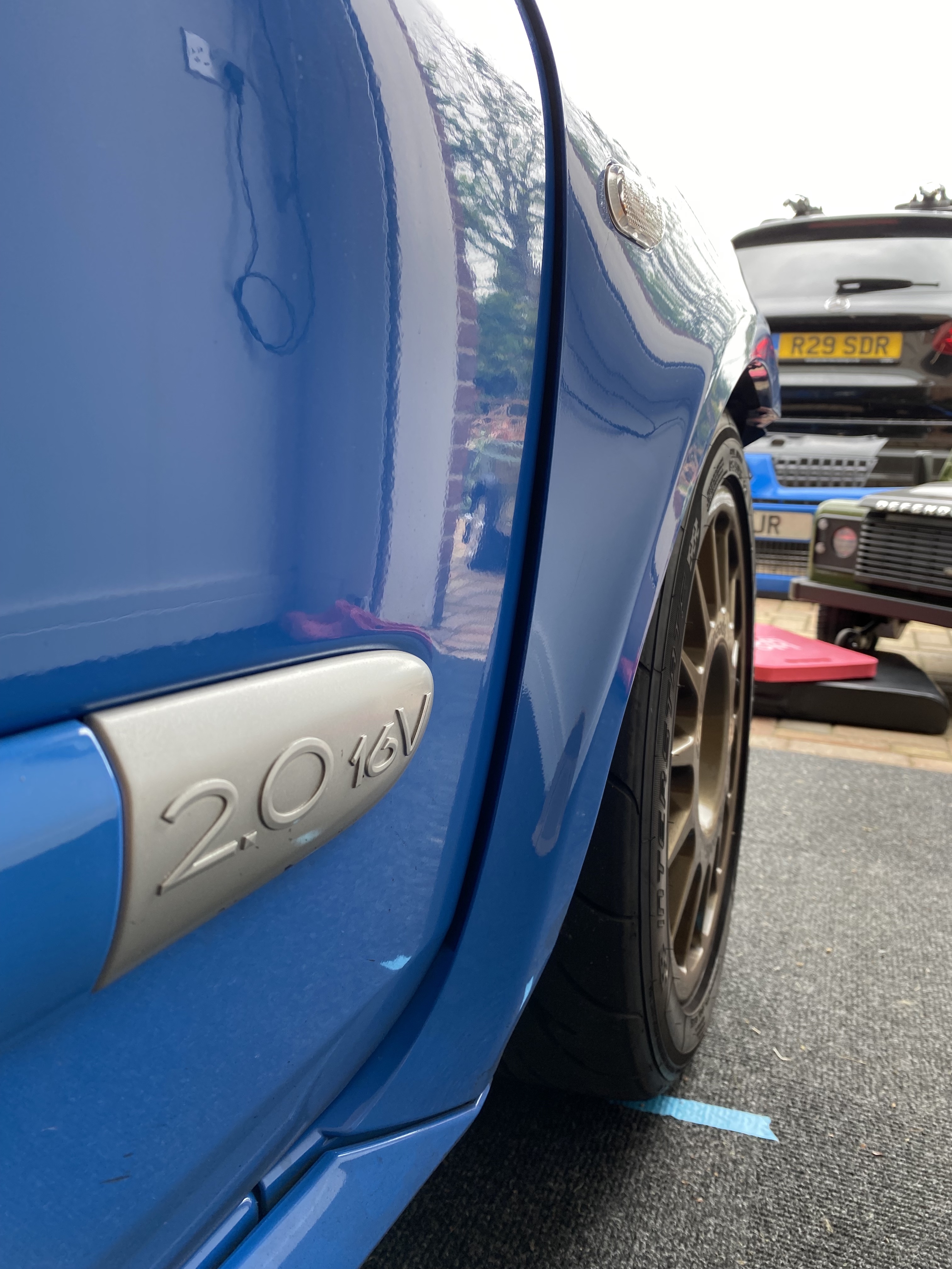

I set about getting the car ready for its MOT. I smashed both fog lights so I set about fitting some covers which I found from some chap on FB, I forget his name however they are a great product IMO. At the same time I also order a brand new OEM grill and some aftermarket stickers to fit. I was really pleased with the outcome:
I then promptly got the car MOT'd and had all the fluids (engine oil, gearbox oil, coolant, brake fluid) changed ready for upcoming events, unfortunately on route home from the MOT the car bottomed out and the gearbox got stuck in 5th. Fortunately due to a very helpful local it was a quick fix, although I'll look to run a sump guard as soon as they become available, you'll see why in this pic:
It couldn't have been more inline with the gear linkage if I tried!

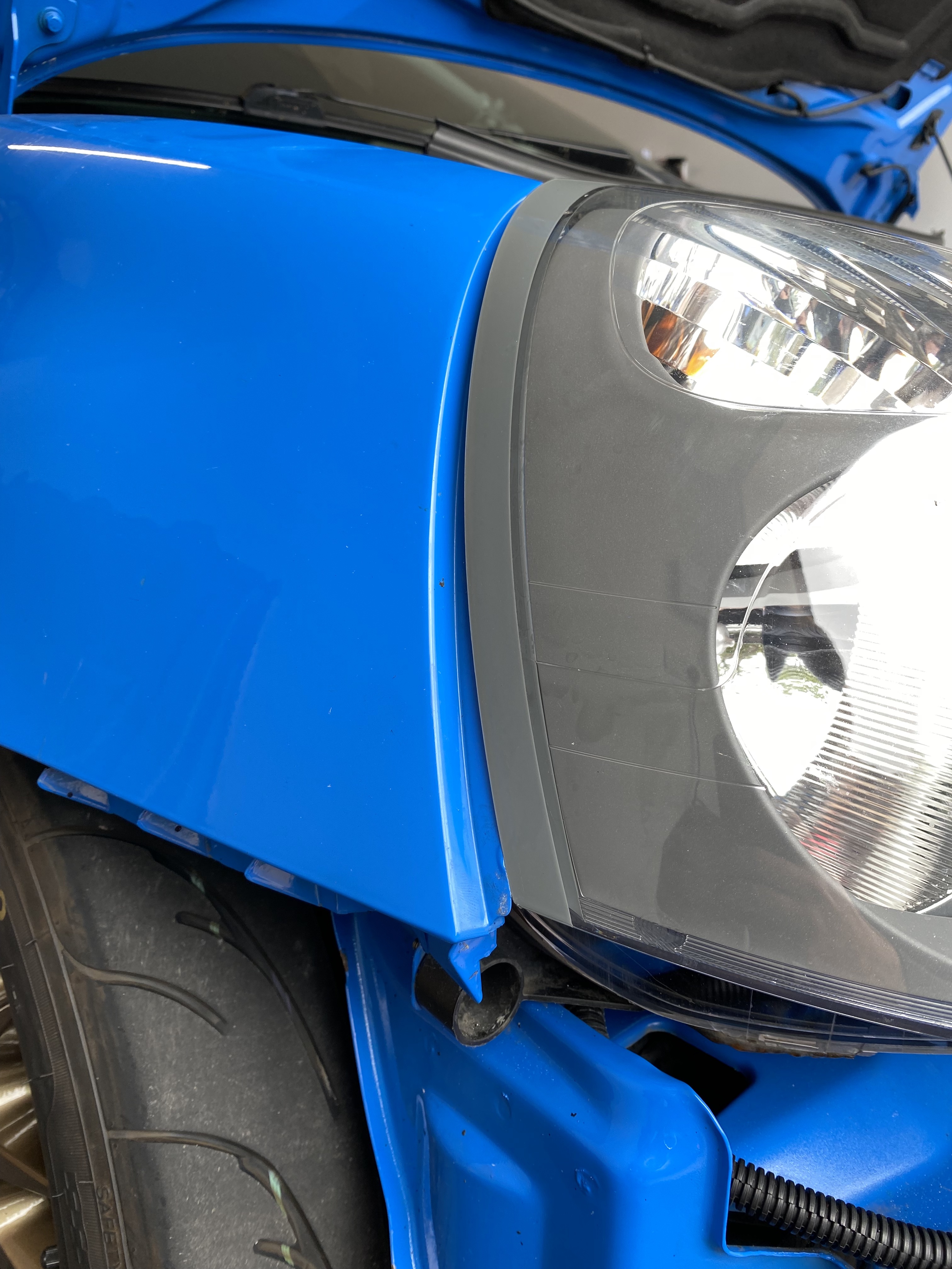

I then had Mark (AKA @Jekyll) pop over to clean up my headlights, I was mega impressed with the results. Unfortunately the photo's do not do his work credit.

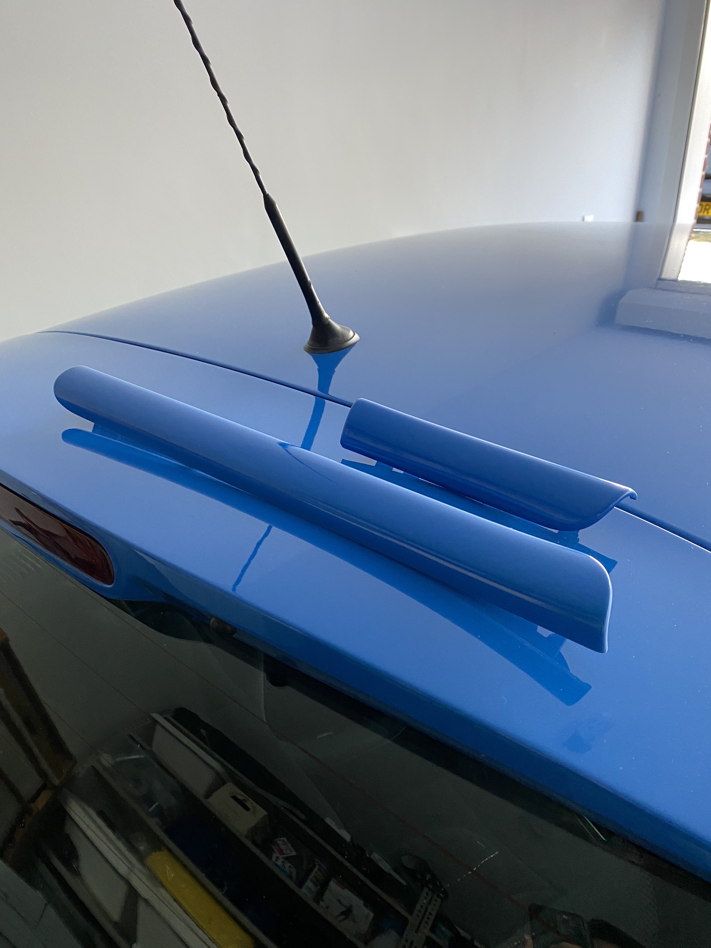

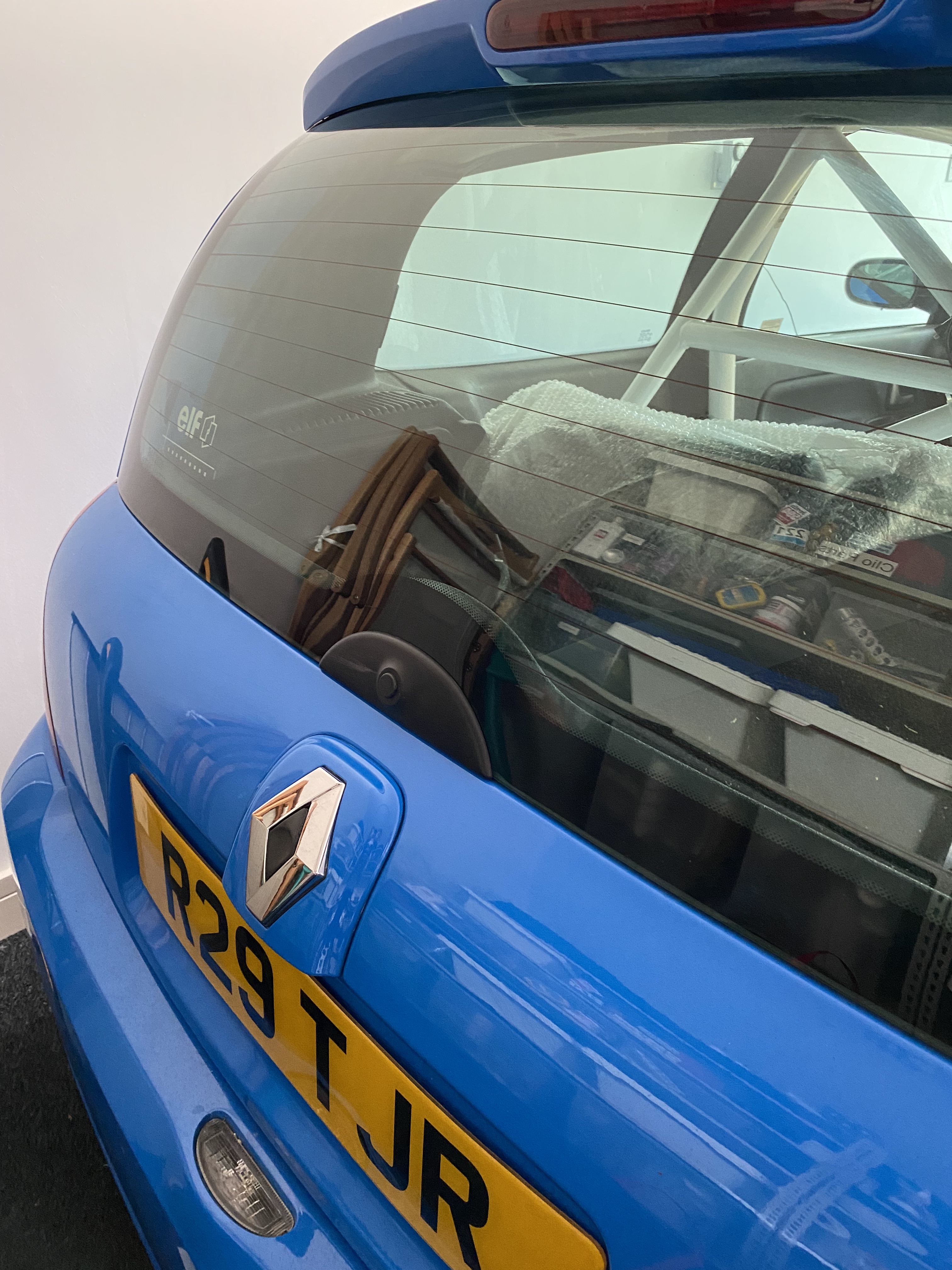

Randomly one night I decided to remove the rear wiper, I definitely prefer it without but not sure if I prefer the below or the Kill All Wipers kit, I'll live with this for a while and see what I think...

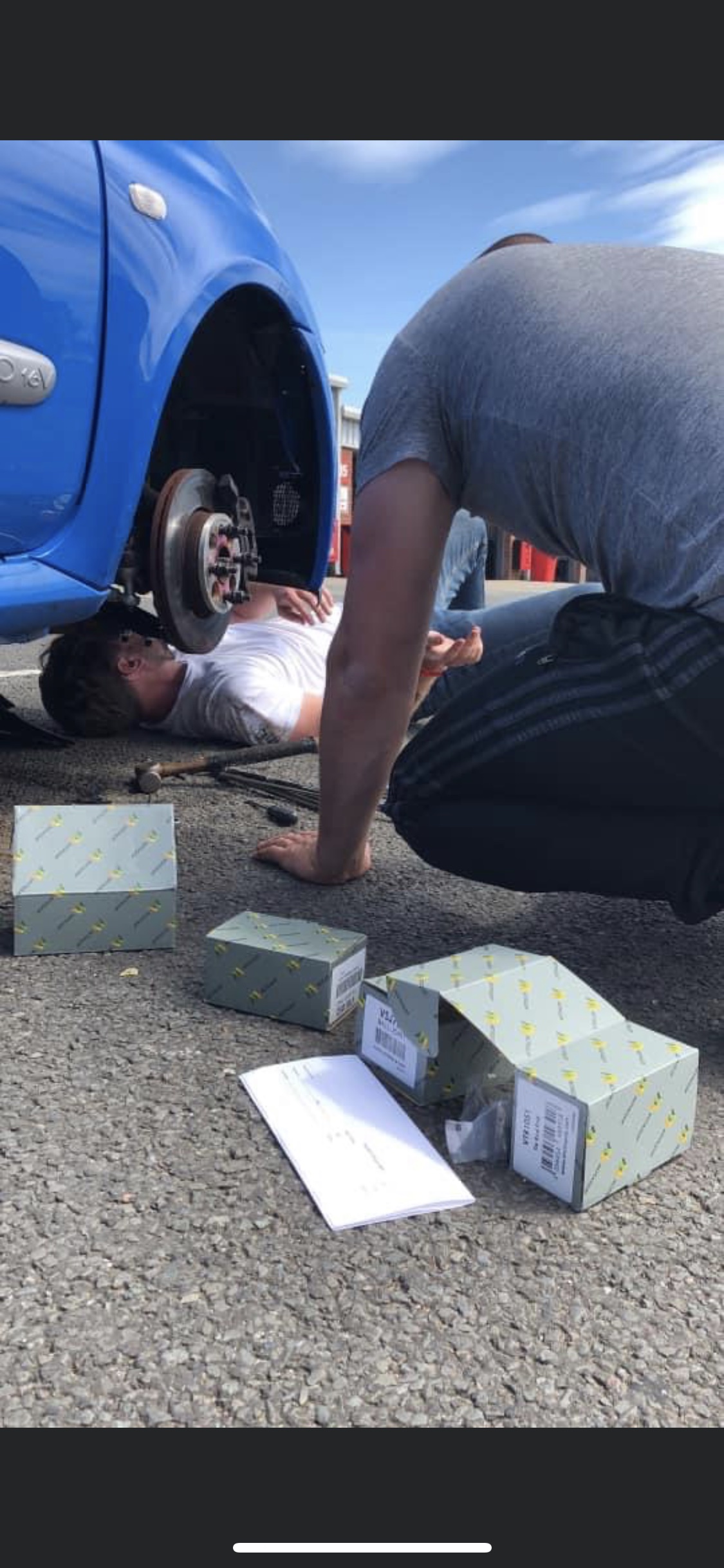

Having not been on track since August 2020 I was very excited to get out especially at a track I'd not driven before. However it was going to be my day.
The plan was to pop into the office for a few hours on Monday morning, a slow drive up in the afternoon, refreshed for the Tuesday, as per usual I got stuck in the office and didn't get on the road until around 6.30pm and then got stuck when they closed the M6 :mad: I finally arrived around 11.00 - 11.30pm.

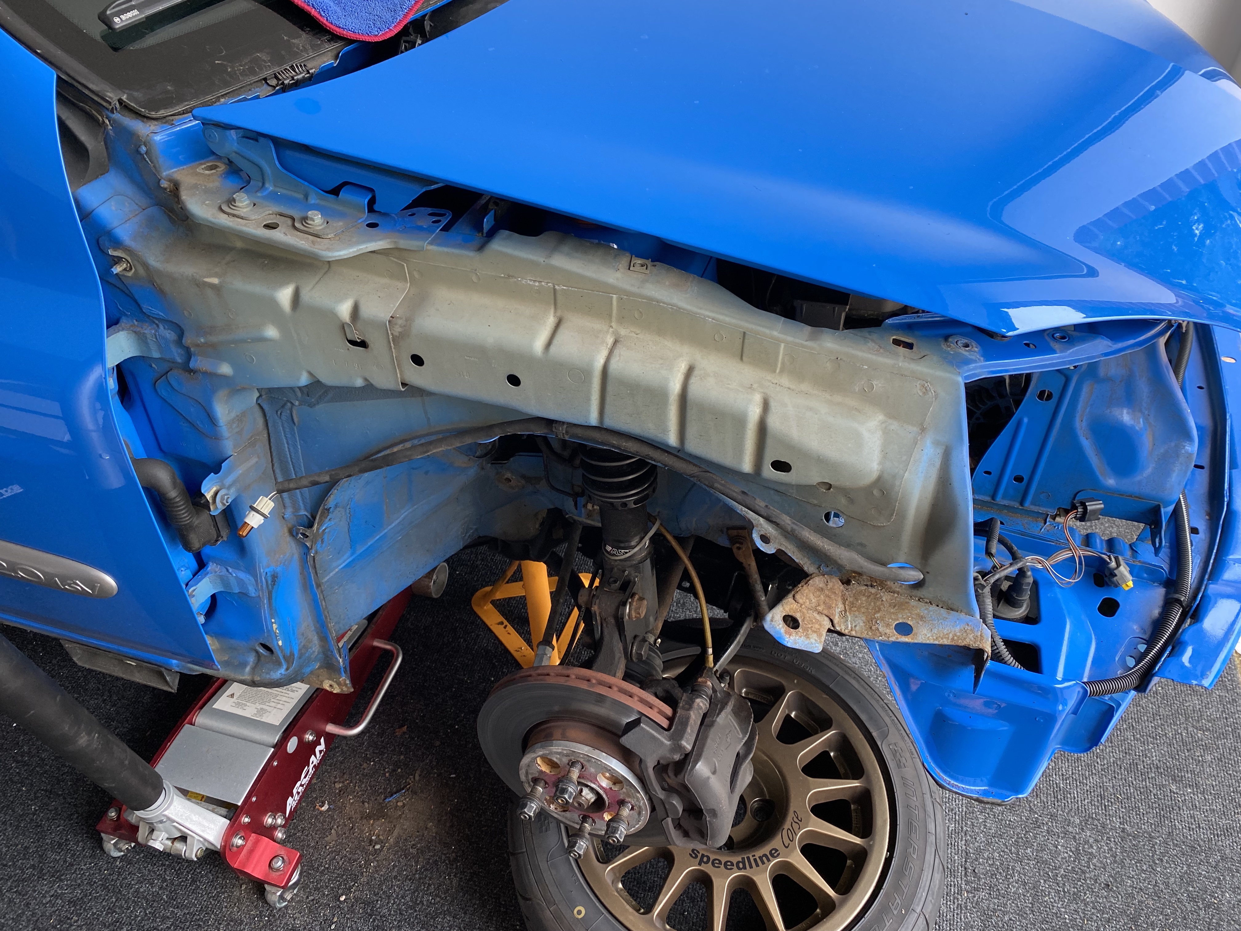

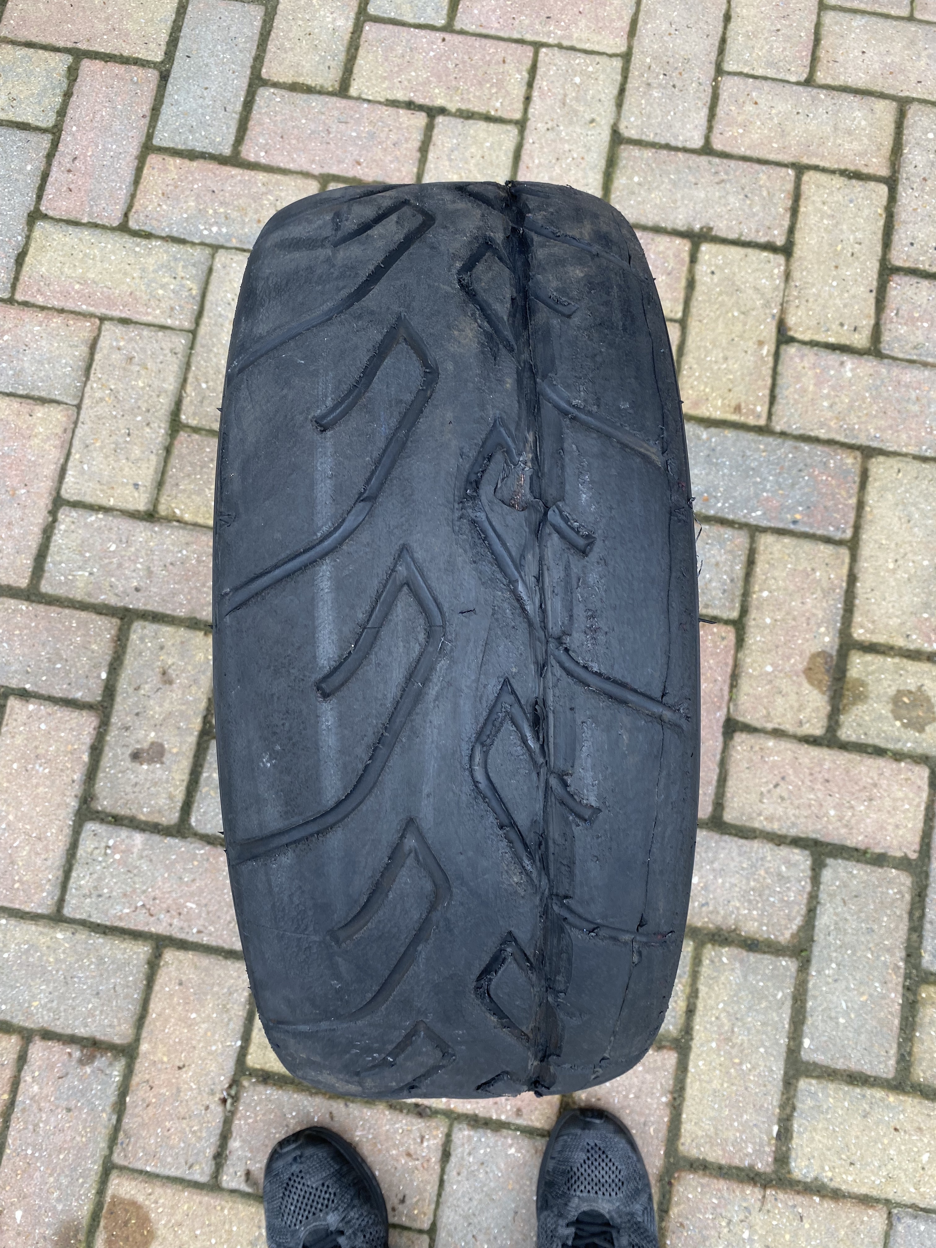

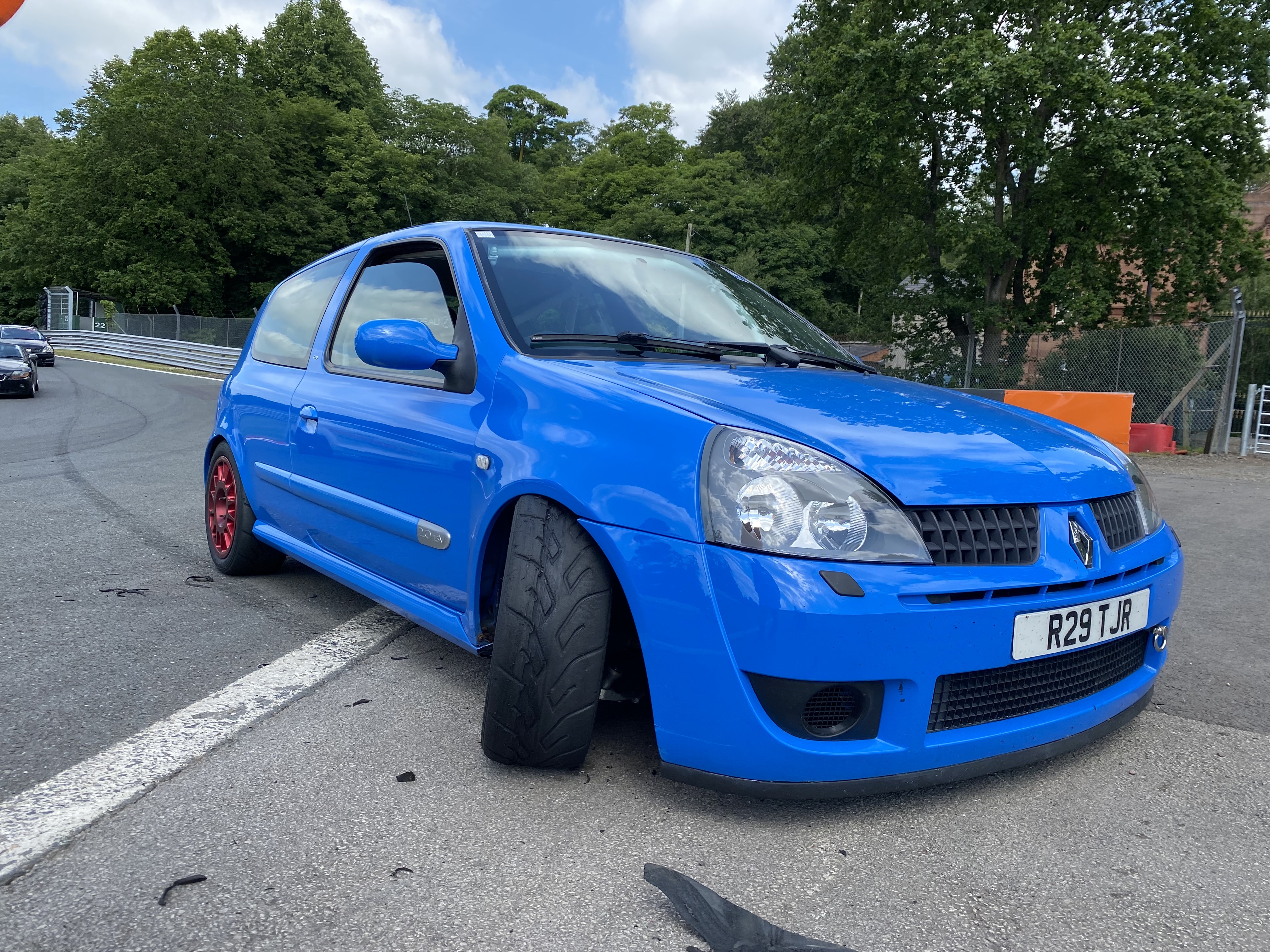

The day got off to a slow start, a really nice Porsche crashed at around 9.30am causing the first red flag of the day, then a golf got a flat tyre (I think) causing a second red shortly after. Eventually I got back out and was following a Twingo whom I assume had done the track before as his lines were perfect and he was going at a great pace for me to learn the track. Then as I was doing my in-lap on the final bend the front right dropped and it locked up. At first I was sure my wheel studs had snapped.

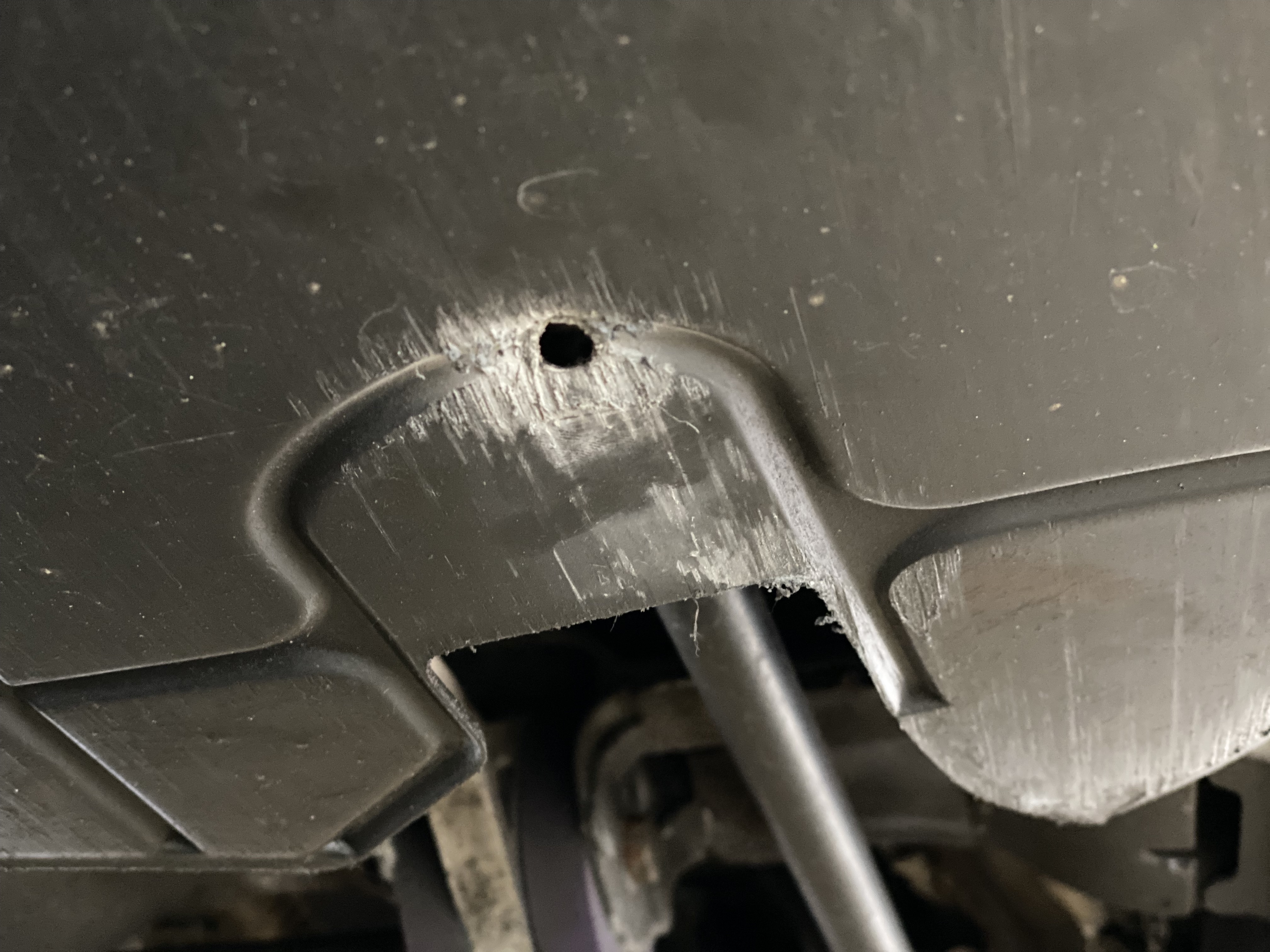

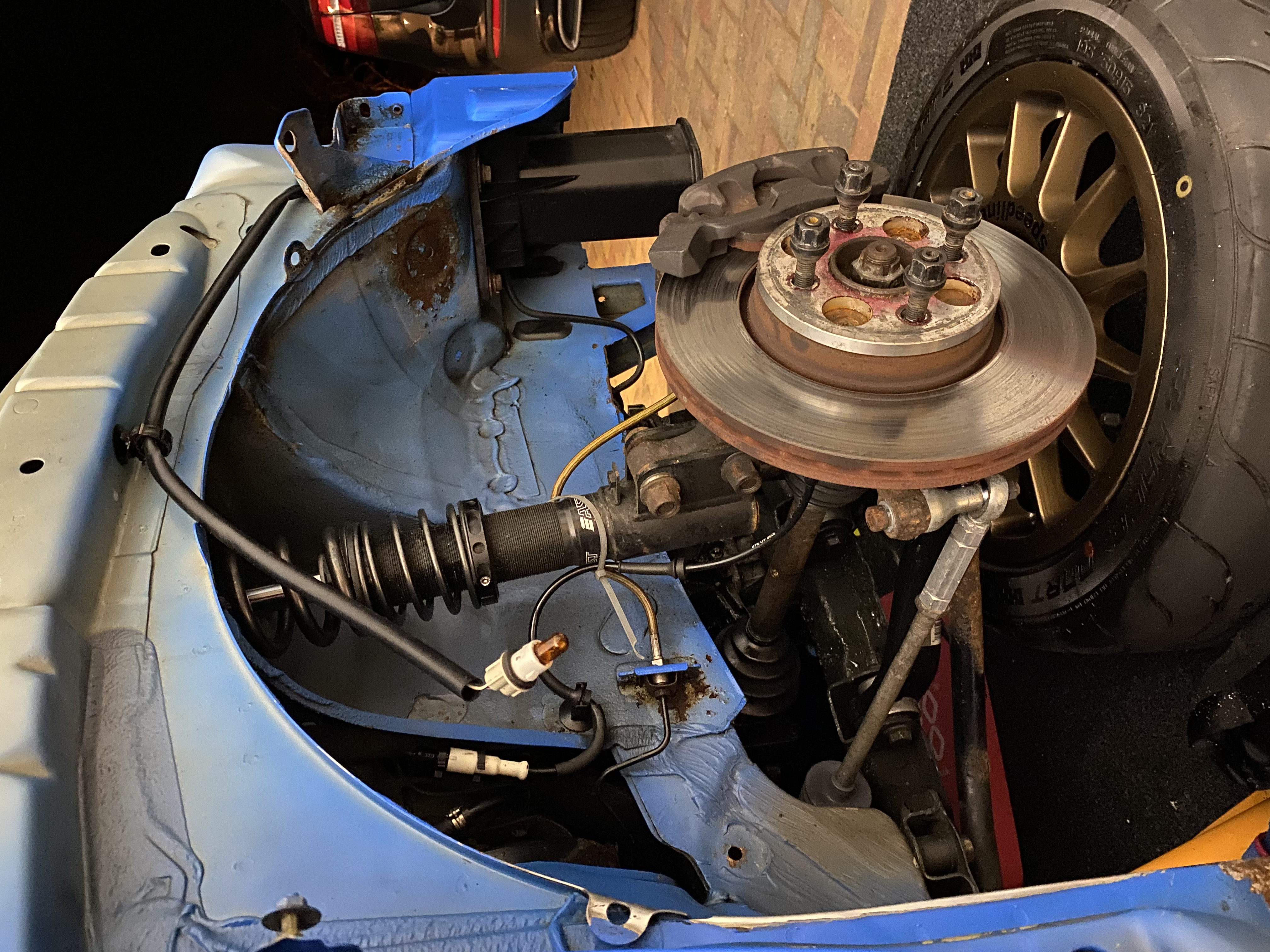

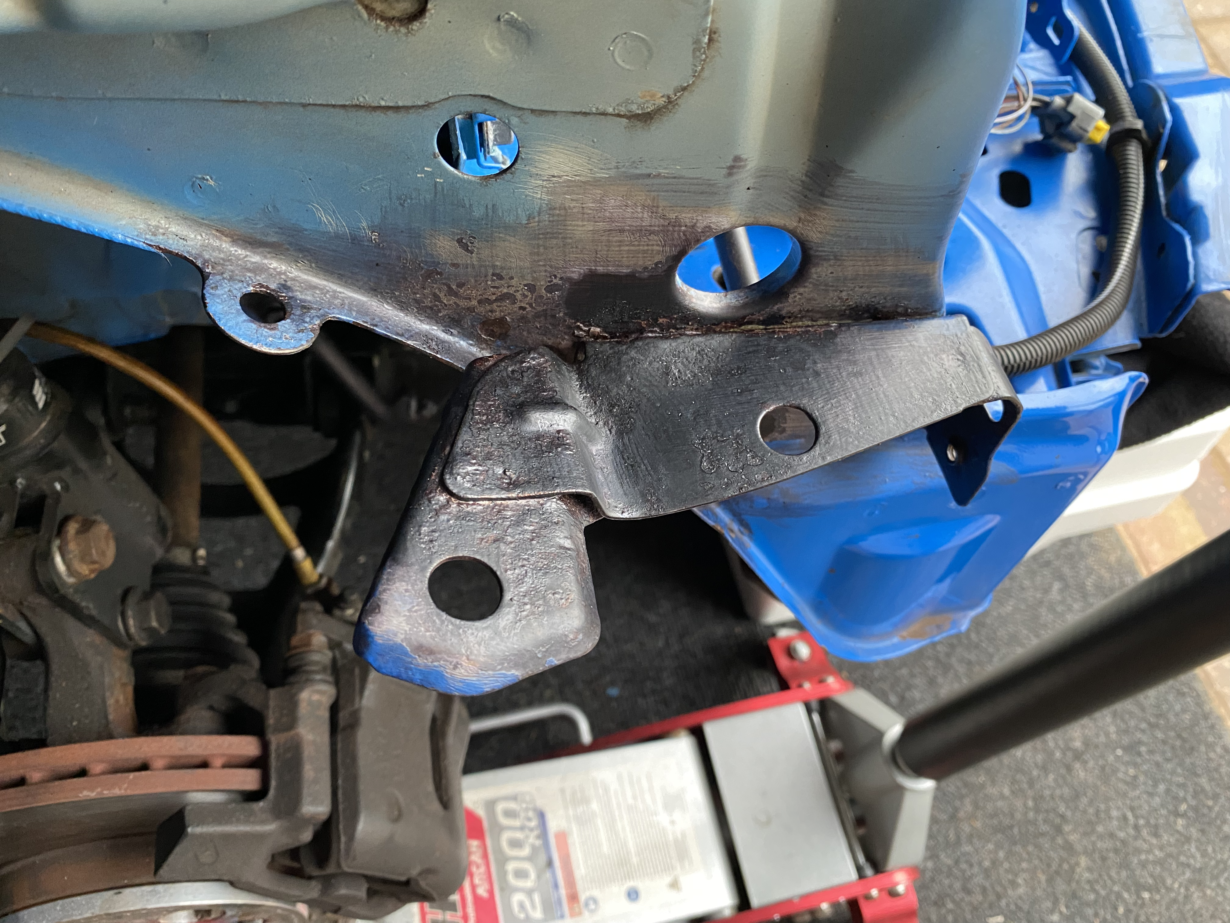

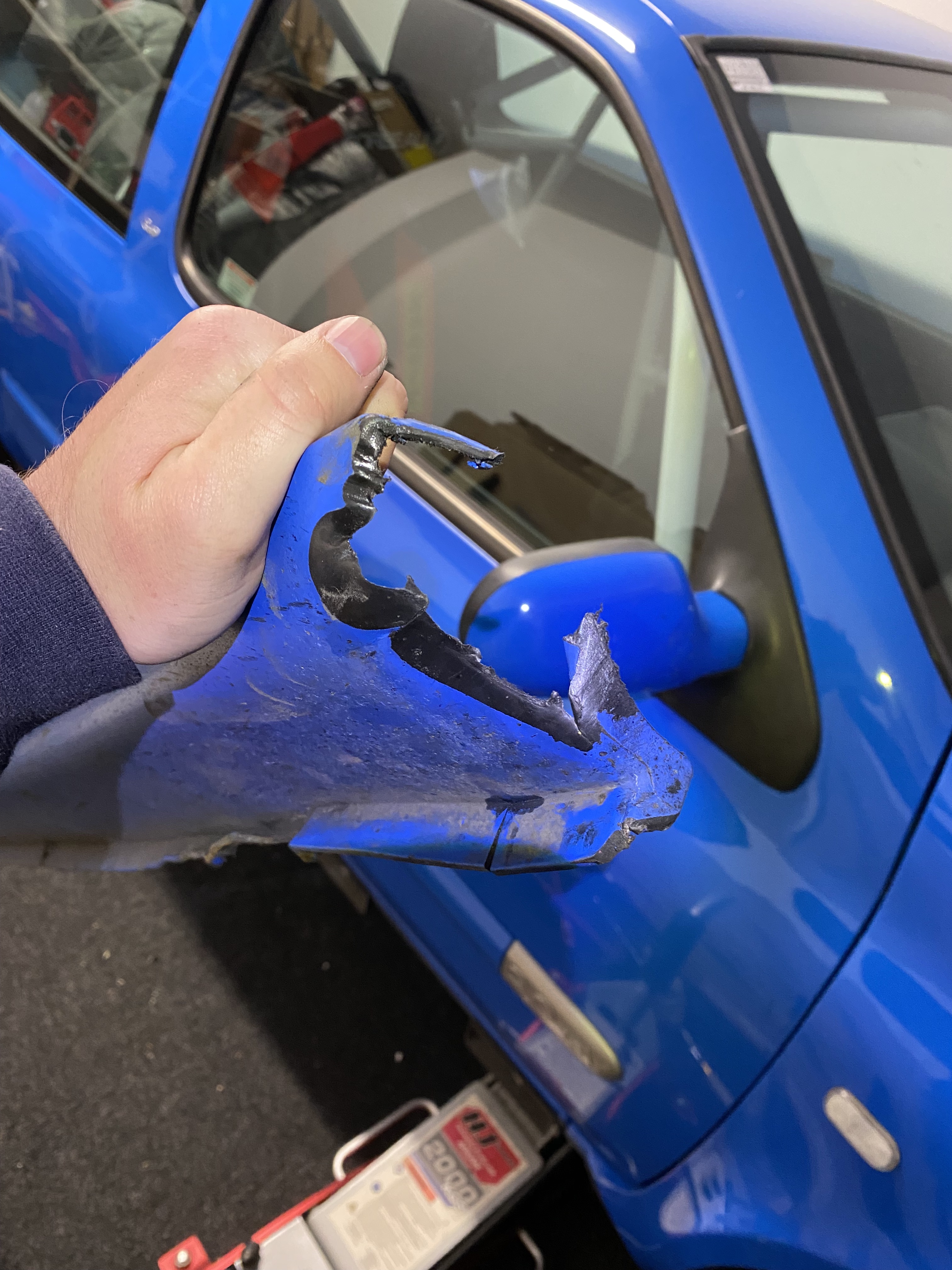

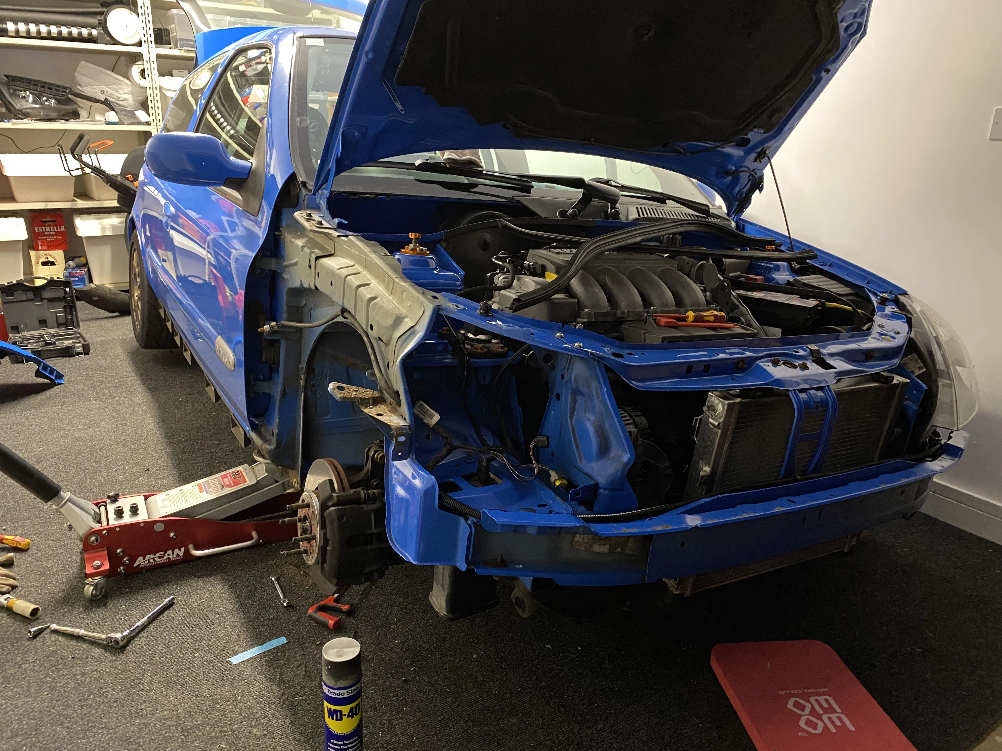

It transpired by lower ball joint has snapped, and ripped out the drive shaft. It also caused some body work damage to the side skirt however nothing major.
All this before 10.45am!
In the garage, early doors:
Shortly followed by this:
Which resulted in this...
The process now begins of getting her up and running again...

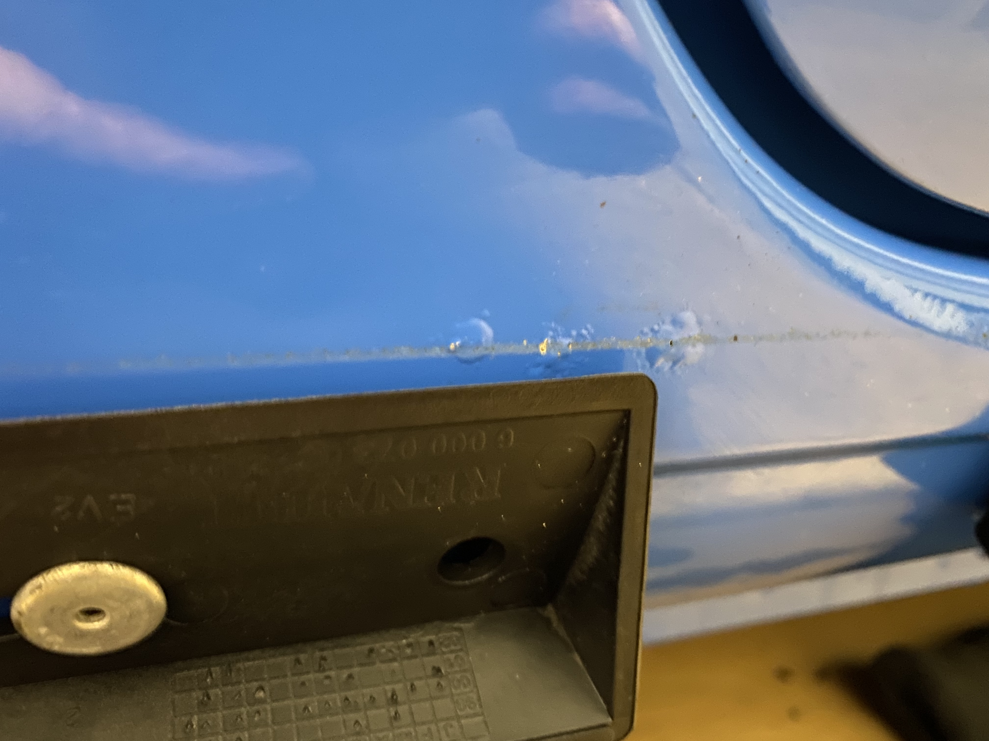

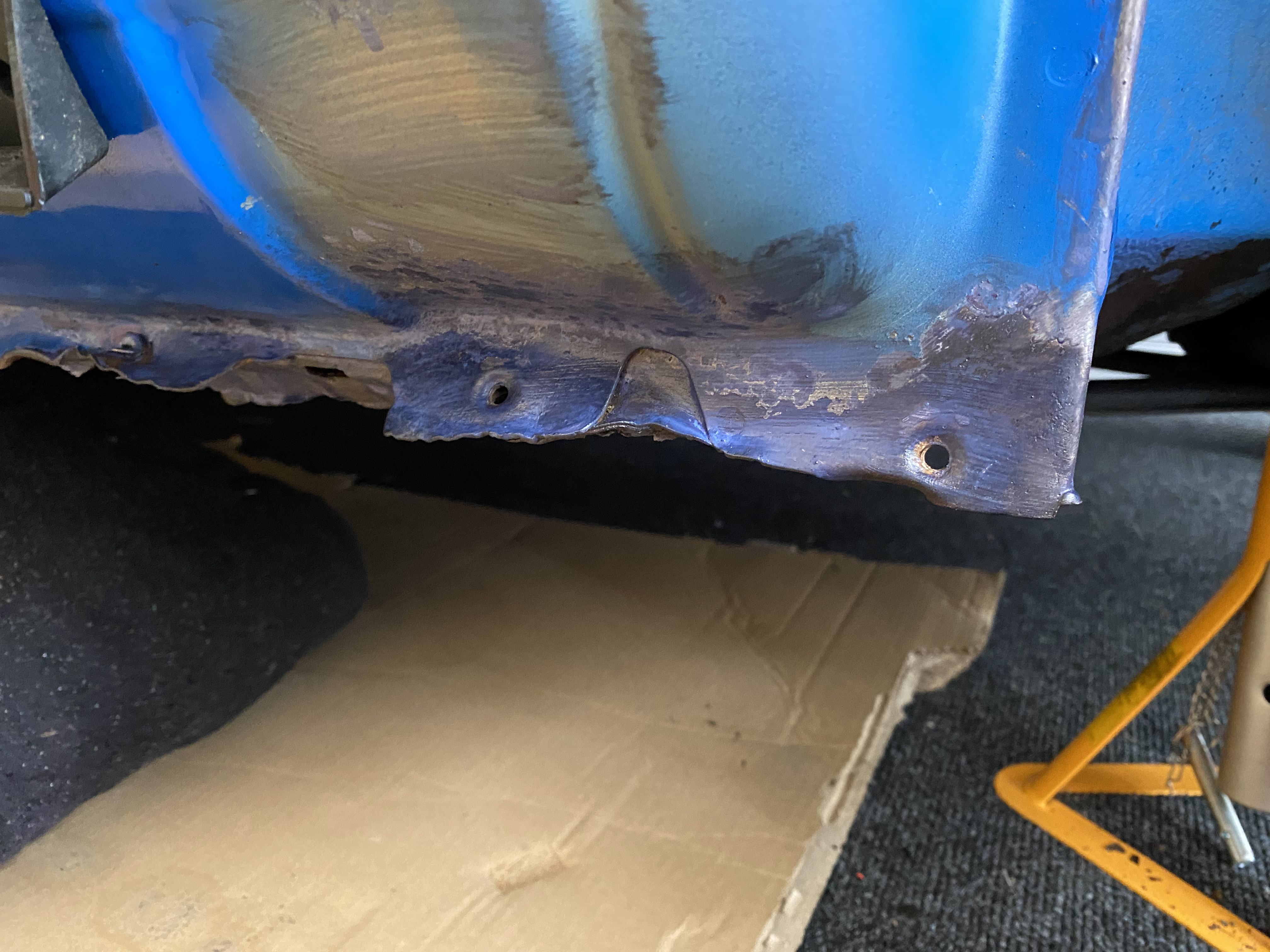

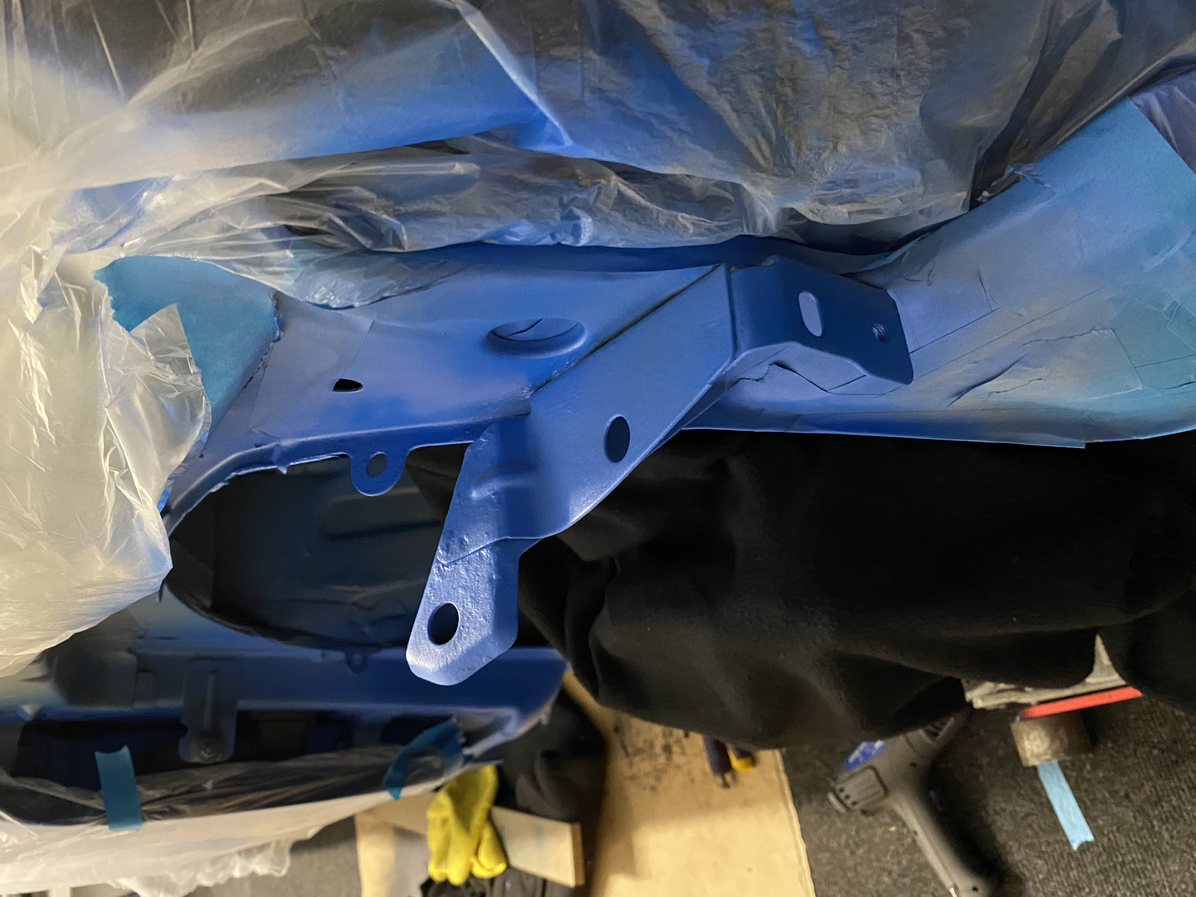

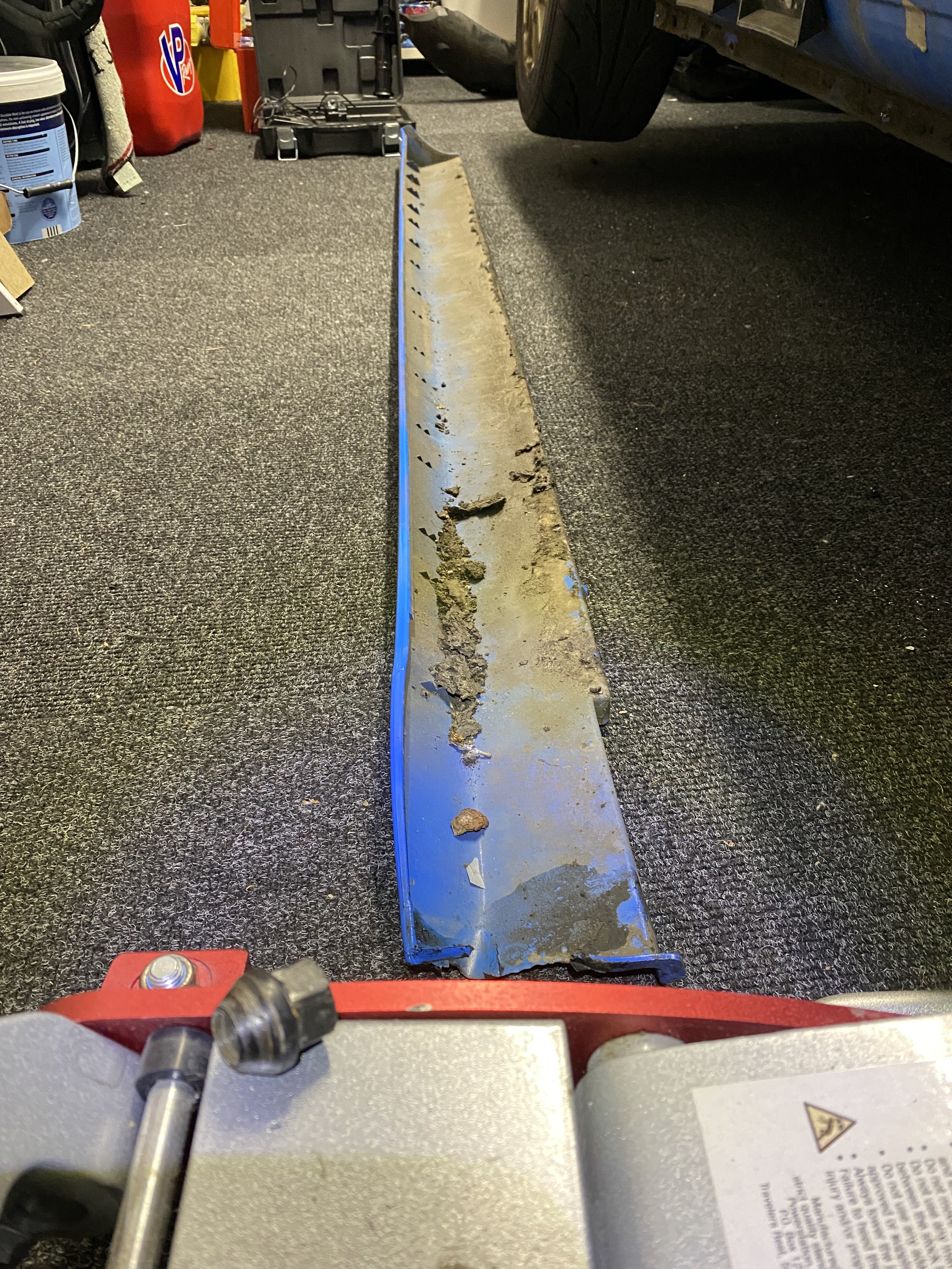

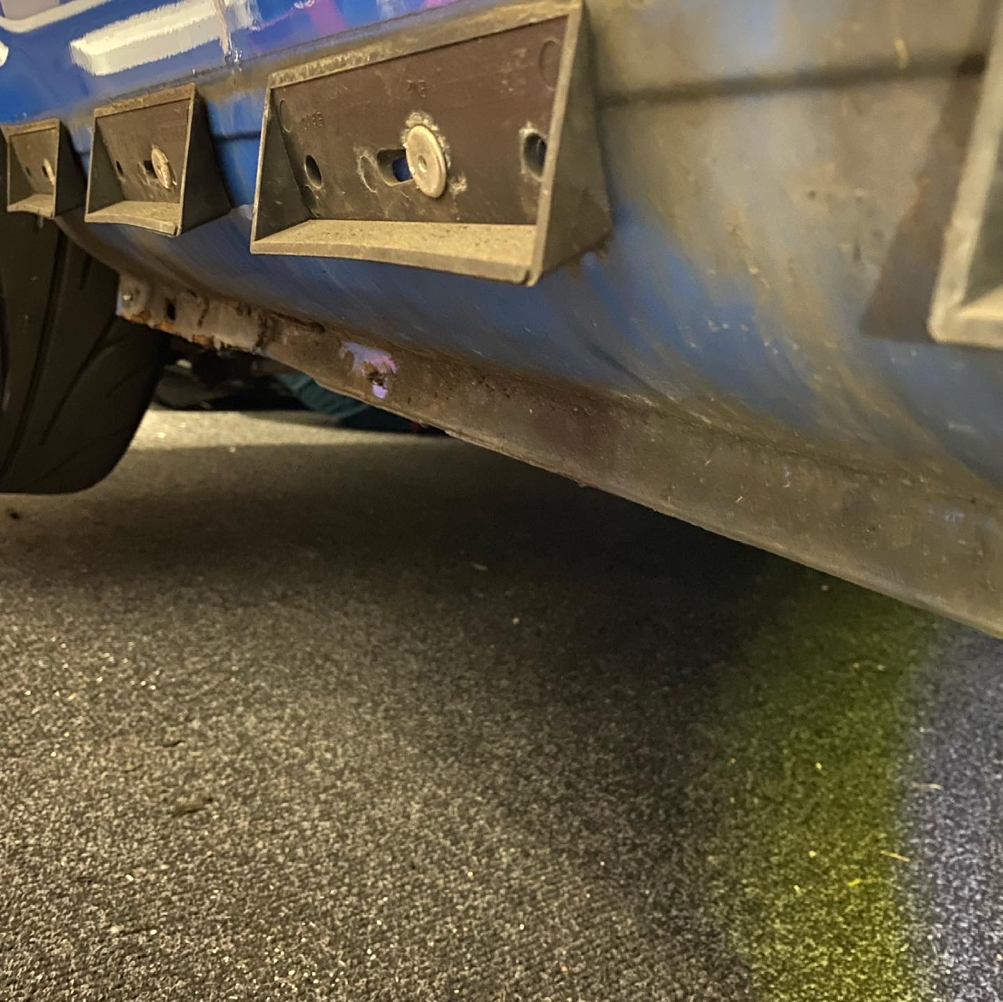

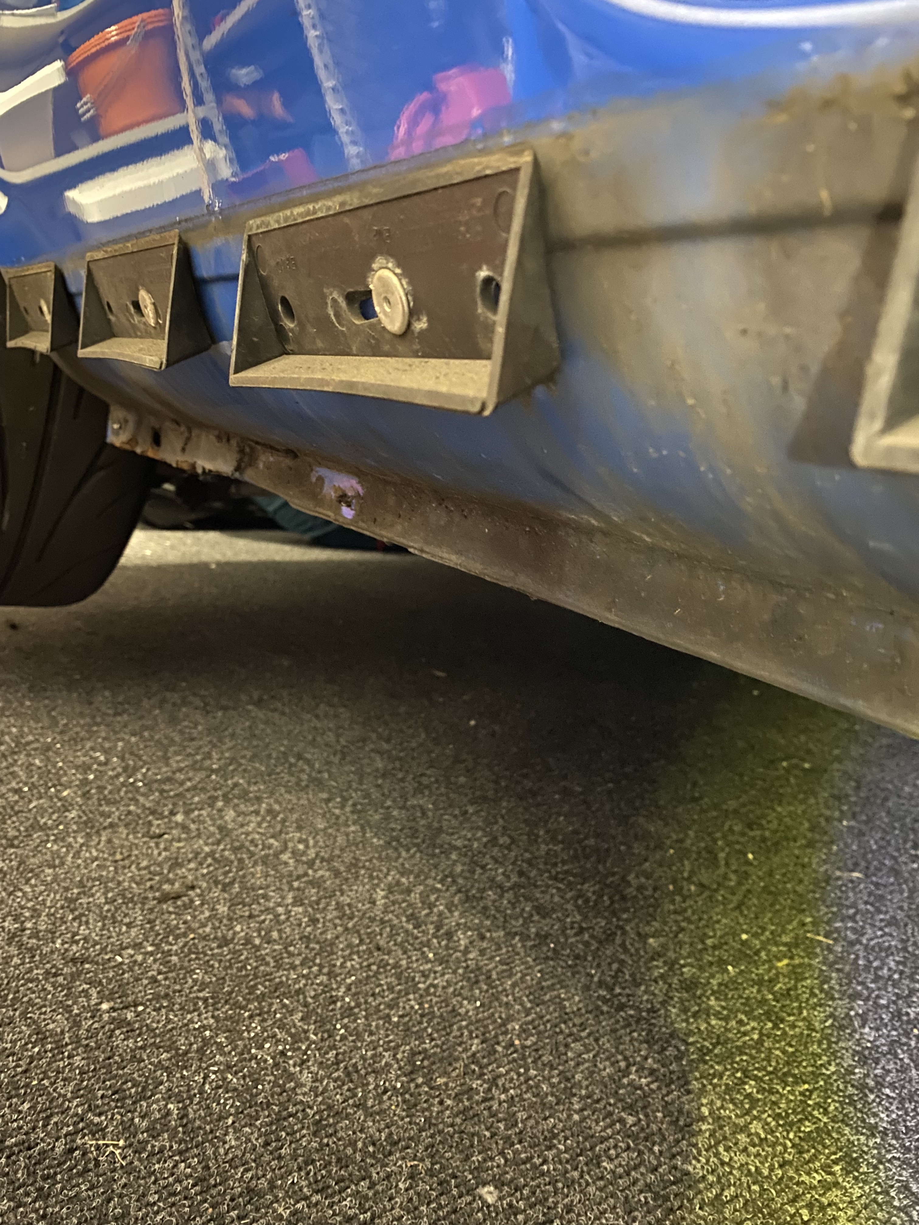

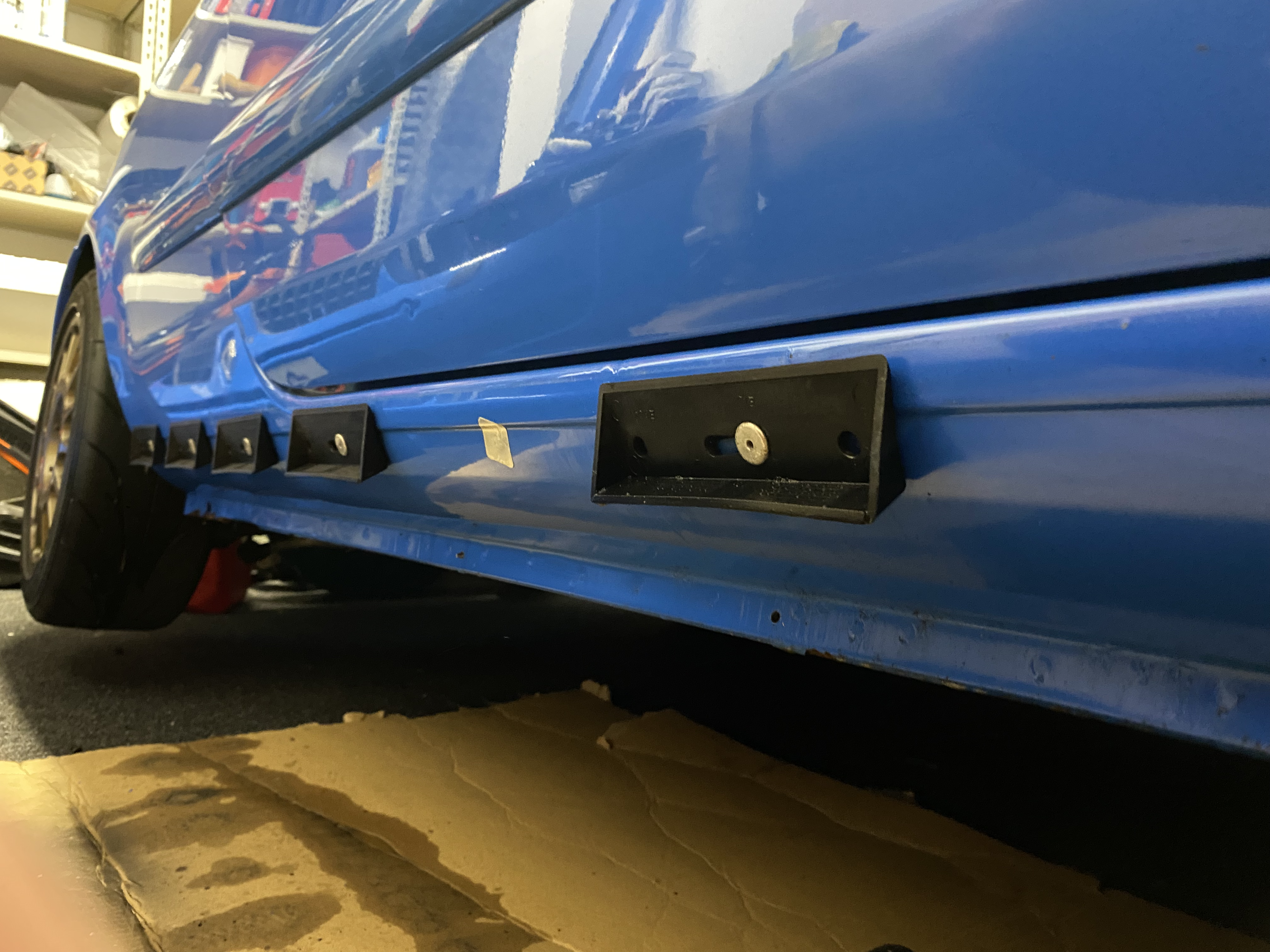

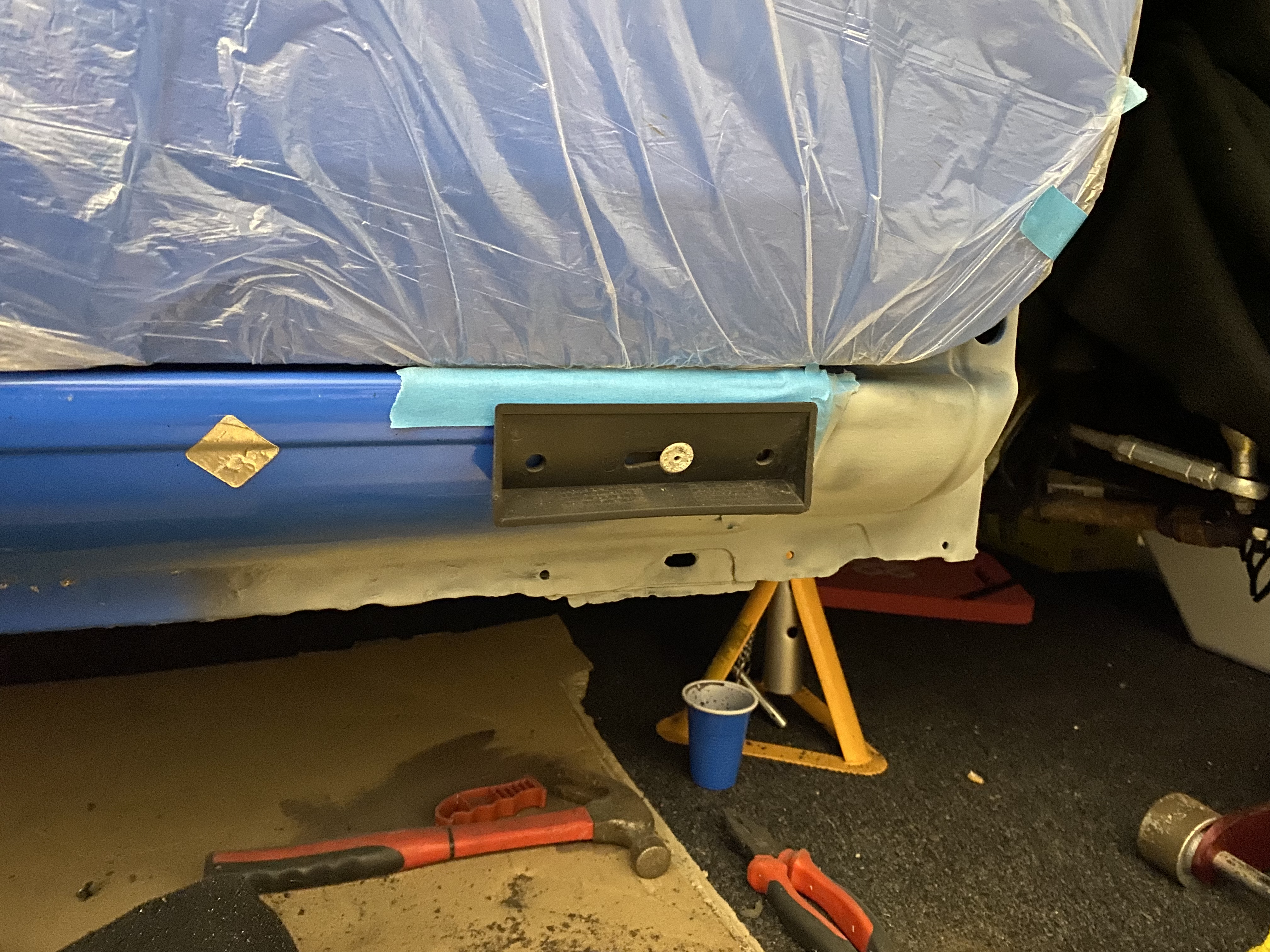

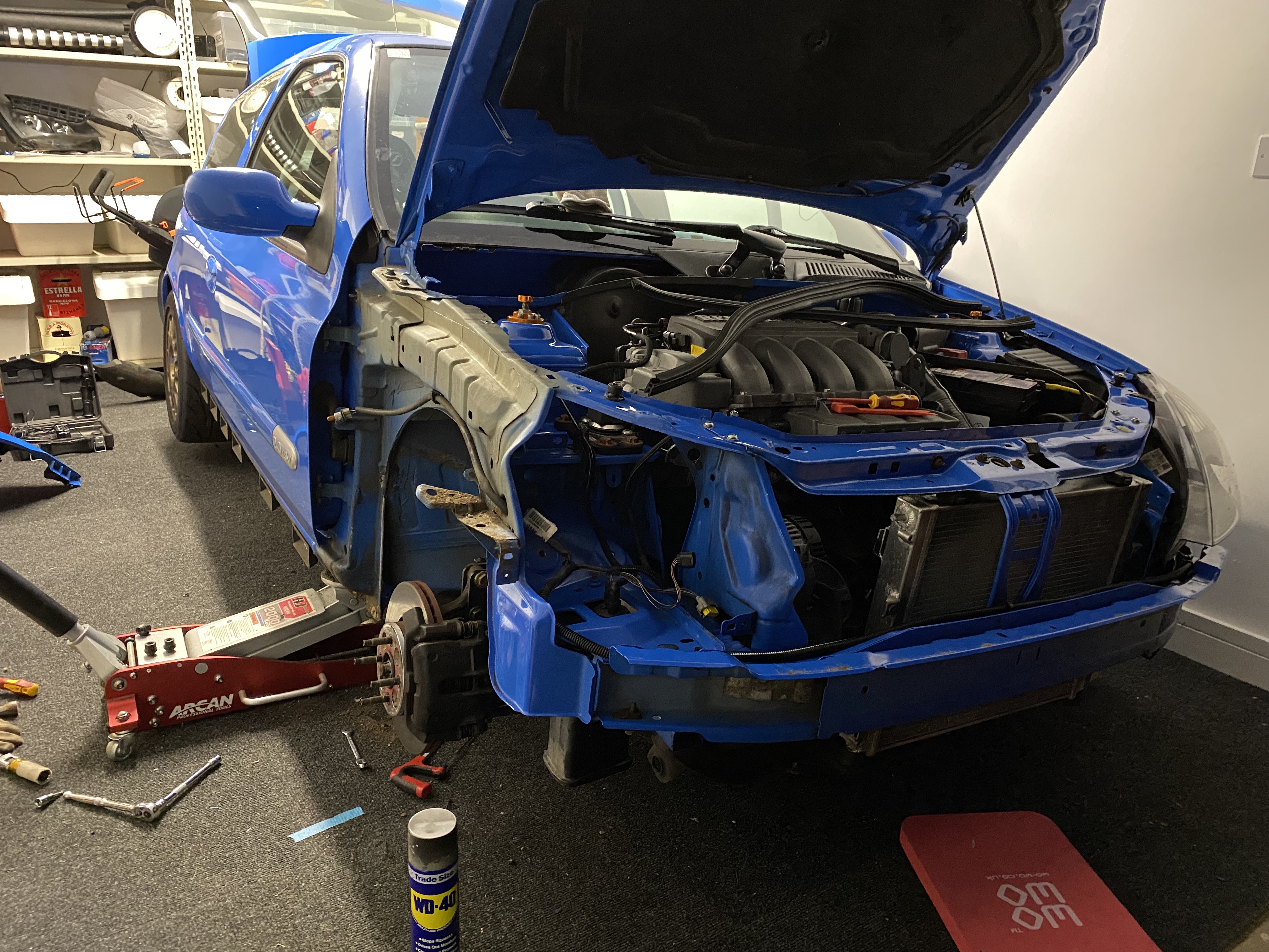

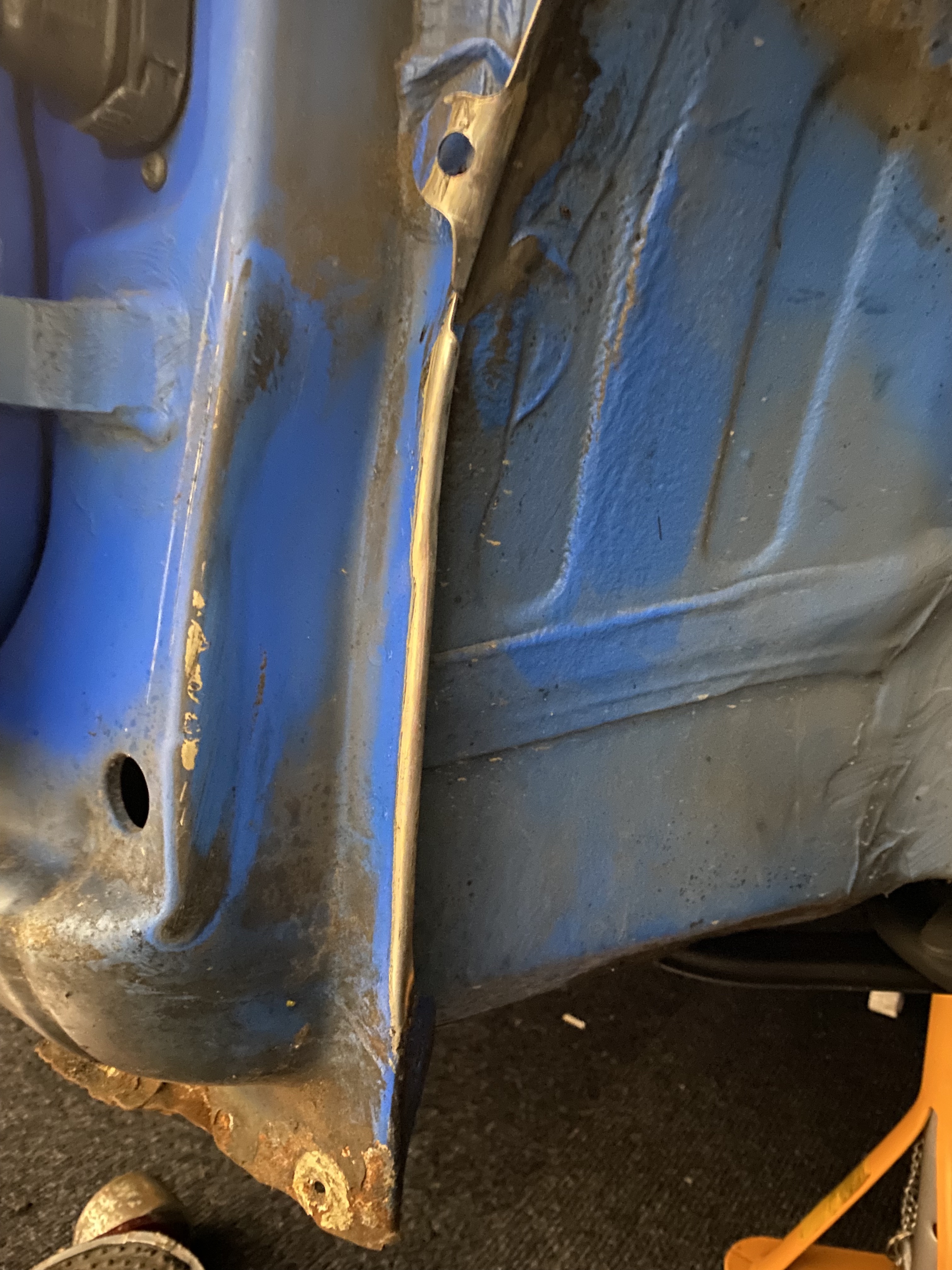

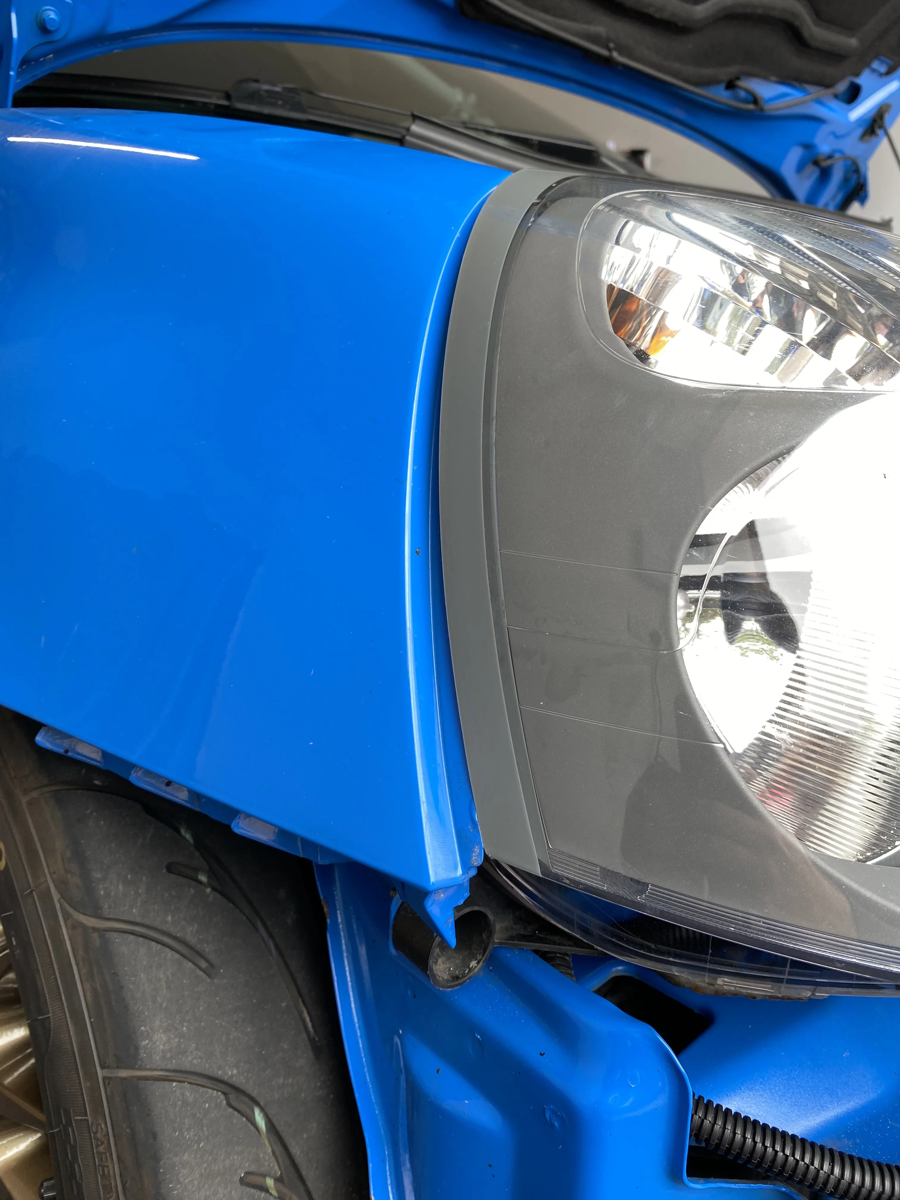

One evening last week I decided to set about getting the body work lined up correctly.
After playing around for a good few hours I made the decision that my only option was to remove both the wing and side skirt.
Considering it was my first time removing panels it wasn't too hard. From start to finish it took me around 1.5hrs which included some internet searching to find how the wing was connected. I'm still researching how best to reattach the side skirts however I think I'll go the rivnut route for ease of future removal.

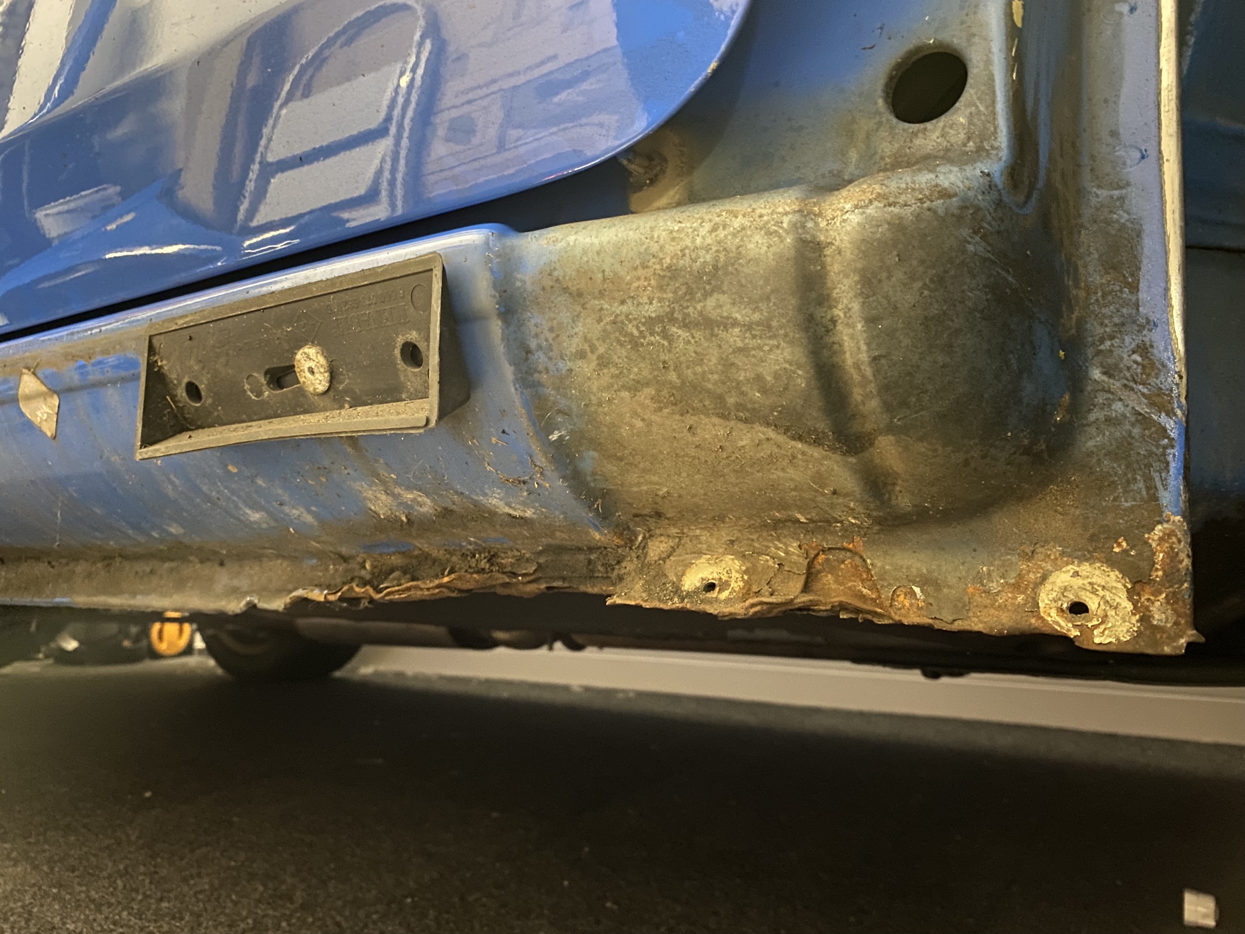

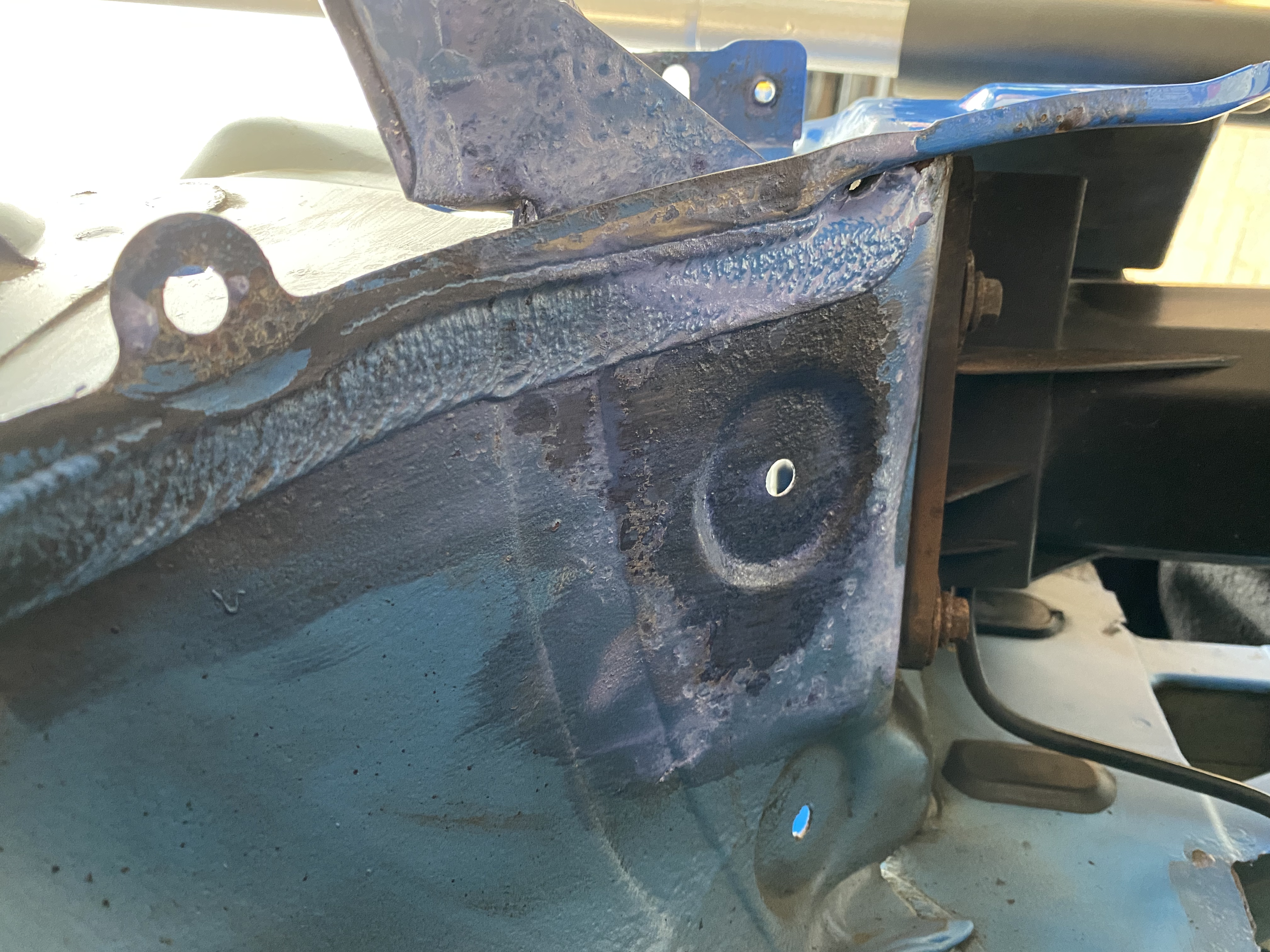

Upon removing the side skirts the Clio was left in the following state:
The Side skirt was holding a far bit of track debris

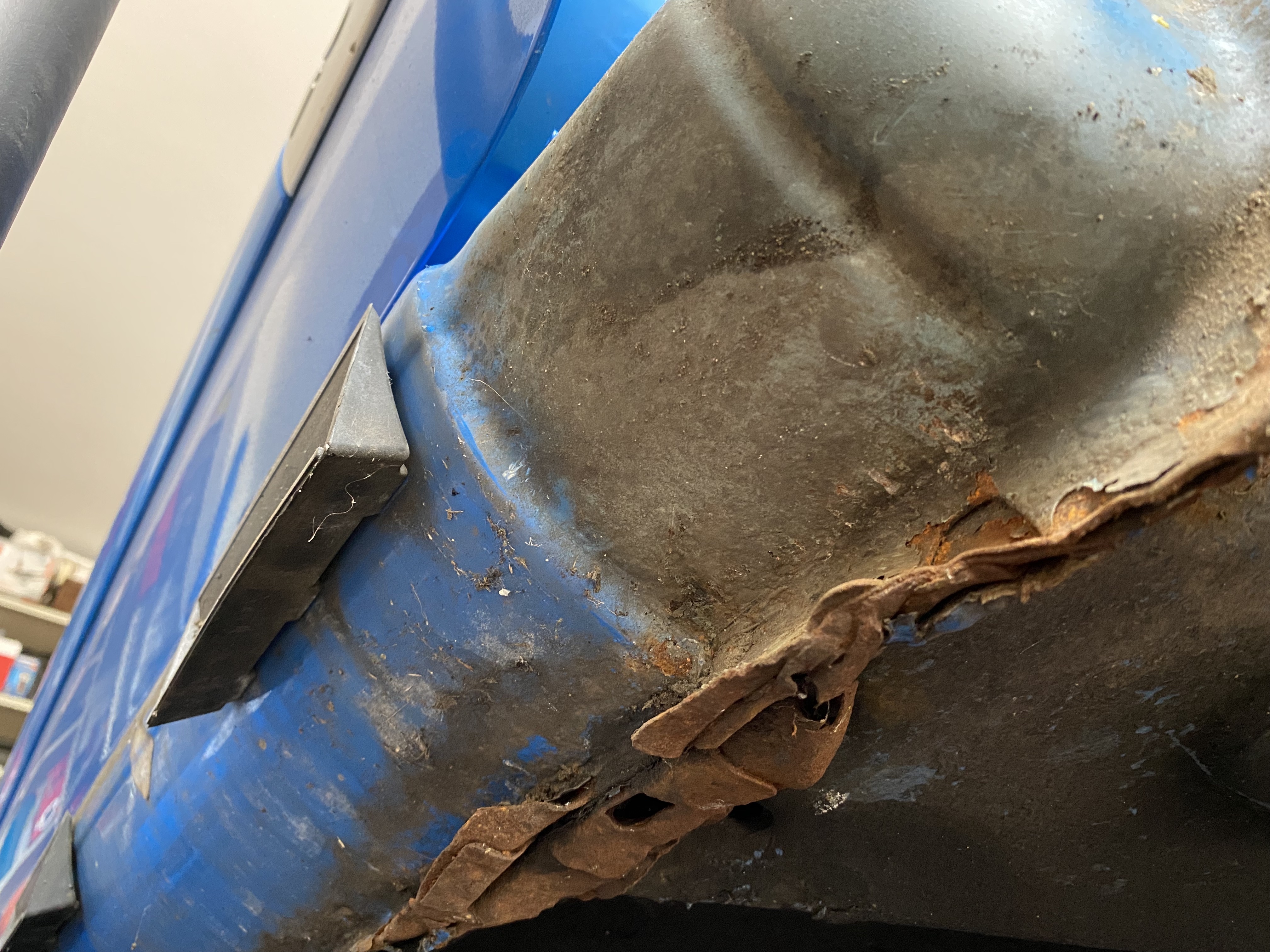

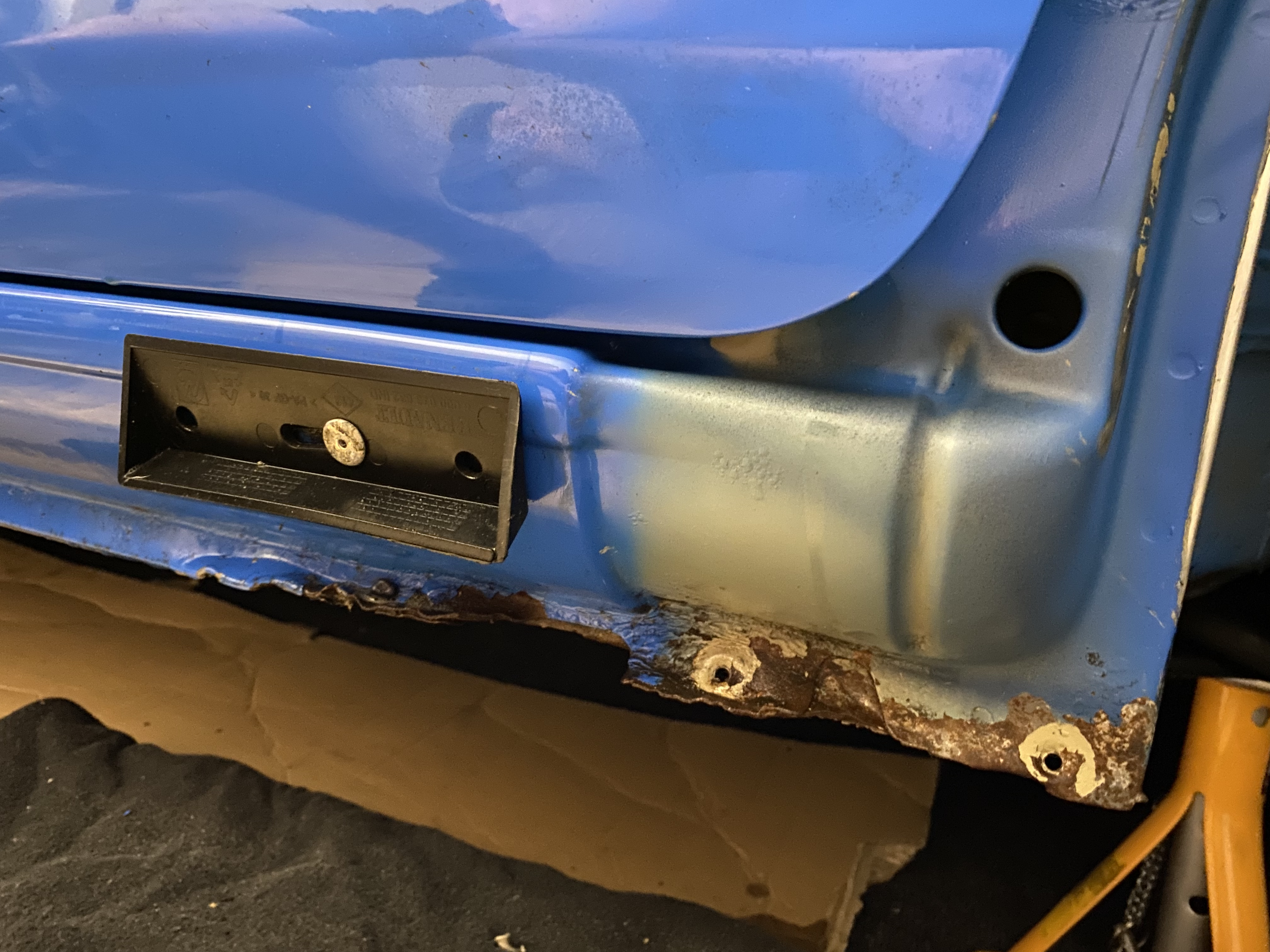

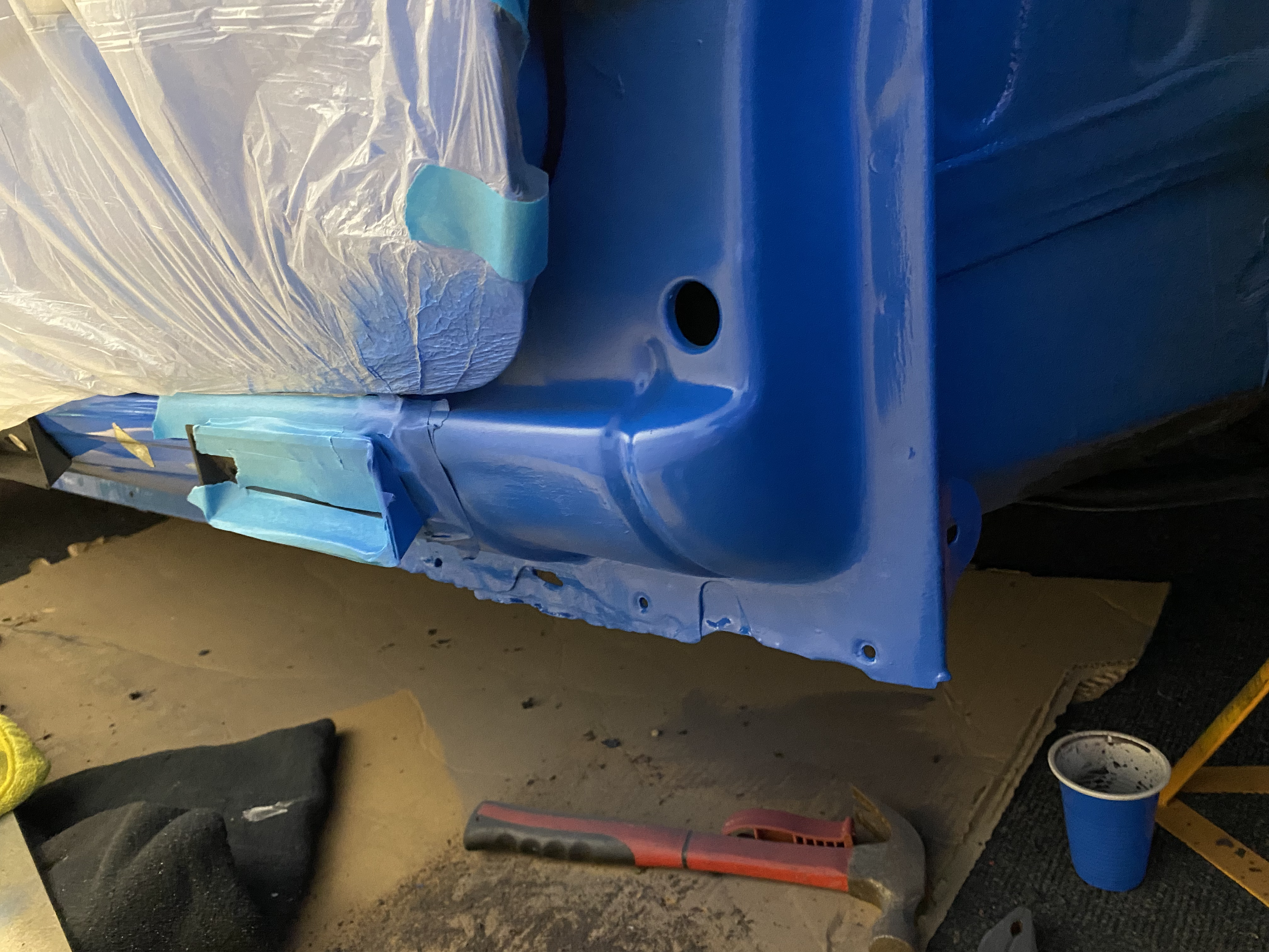

Now the sills have been exposed it's forced me to fix the common Clio issue, apparently they aren't that bad but I'm open to recommendations on how to fix and what products to use. You can also see the recent damage caused to the arch:
I'm sure the passenger side is similar so I'll remove that side skirt, maybe this weekend, and then look to fix them and add some additional strength like many have done. But I still need to do more research.
Tom
frayz
They're not bad at all mate, just looks scarier than it is.
Id get a wire wheel on a drill in there as much as you can on the rusted areas and treat with some Bilt Hamber Deox C to try and remove/convert as much rust as possible. Then paint in some Bilt Hamber Hydrate 80. This will convert/seal any remaining rust under there.
Then you have a few options from the likes of Bilt Hamber, Jenolite, POR15, Upol or Dinitrol. Get some protection in between the layers before hammering the sills back as straight as possible. I used some hammers, drifts and smooth flat grips from Knipex to straighten mine.
Then you attack the rest of the rust with the same methods, wire wheel, hydrate 80 and then epoxy paint/underseal etc.
Once complete give it all a liberal coating of Bilt Hamber Dynax UB which will put a final calcium wax coating over the top.
Then put your skirts back on.
All that sounds complex, but it isnt really, just take your time, clean the s**t out, convert the rust and treat it. Its all behind the skirts so doesn't have to be a show stopping finish, it just needs to be hardy and weather proof. If you do that im pretty sure those bits of the car will outlast the rest of the metalwork.
You know im only a text away if youre stuck :)

Amazing @frayz thanks for the detailed reply. It's really helped I think my biggest issues was not knowing where to start...
That said I have a fews questions if that's OK?

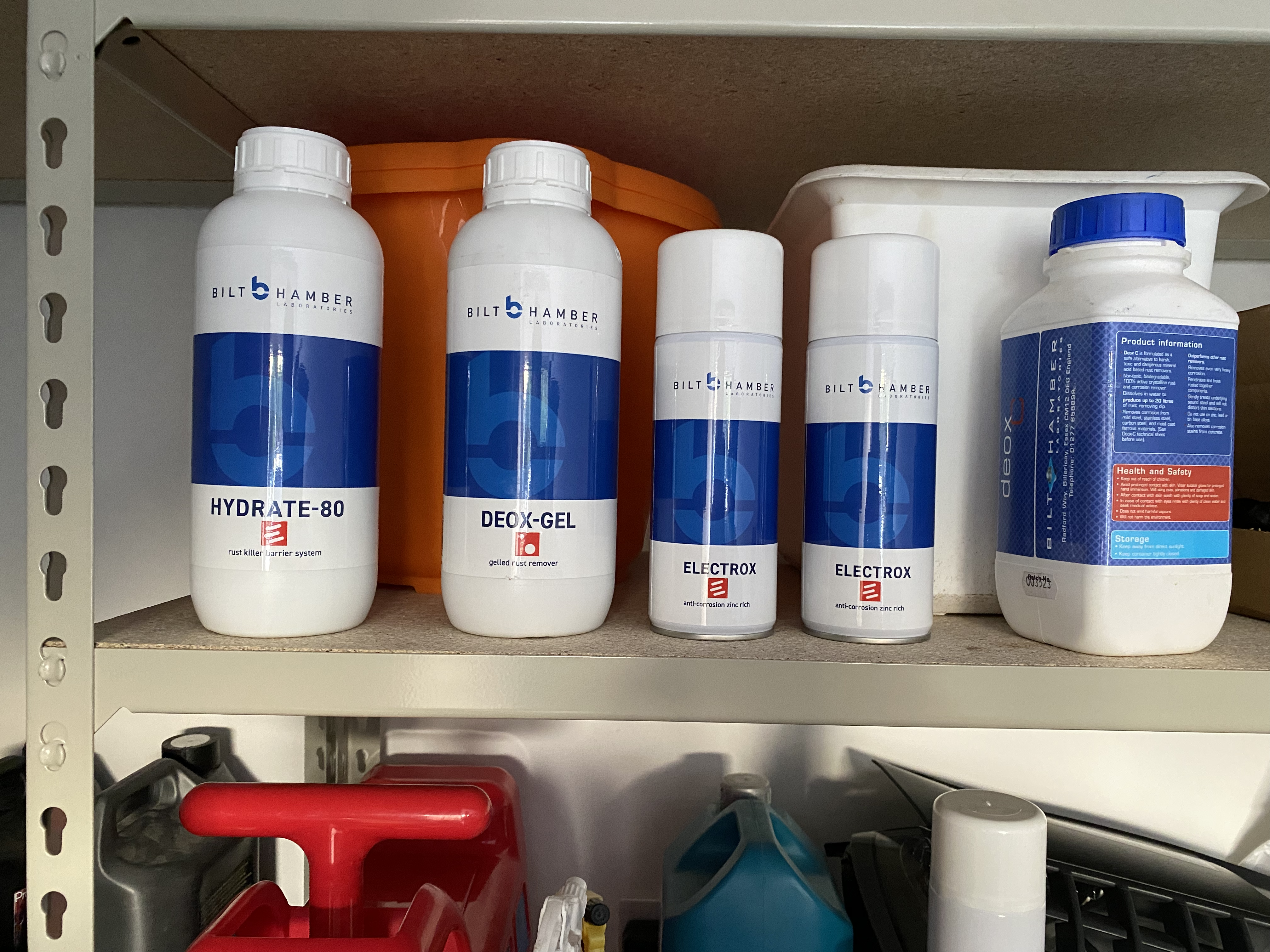

Firstly, from my research Bilt Hamber Doex C appears to be a solutions you place part into to remove the rust? Have I misunderstood? Not sure I have a box big enough to place my whole Clio!
To confirm, I currently believe the process is as follows:
  1. Wire wheel remove as much rust as possible
  2. Heat up and move sills into correct position
  3. Clean some more
  4. Rust converter (Hydrate 80?)
  5. Epoxy paint/underseal
  6. Bilt Hamber Dynax UB
  7. Admire my work!
Sorry for all the questions, I'll hopefully get all the part ordered this weekend and next week I'll make a start on the repair.

You can get deox gel that sticks to bits you can't submerge. But that's a rust remover and I think it'll be better to wire brush and then use hydrate 80 which is a rust converter and then add protection of choice. That's the process I'm doing atm.
frayz
As above. The Deox gel clings to the parts so you can paint it on. Then cover in cling film/pallet wrap to prevent it from drying out. Just helps to get rid of as much rust as positive before using hydrate 80 to convert and seal whatever’s left.
Then epoxy paint and finish etc.

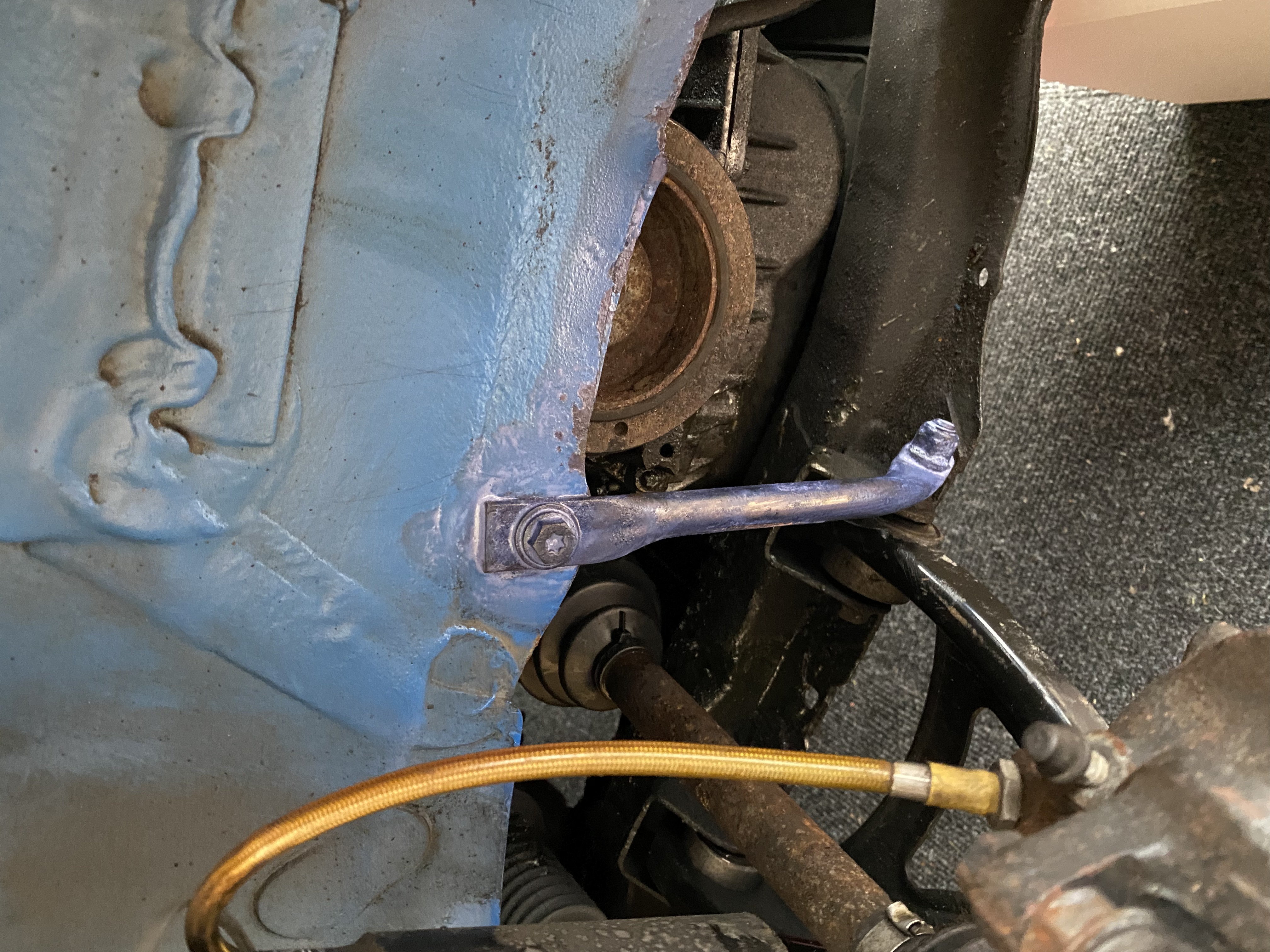

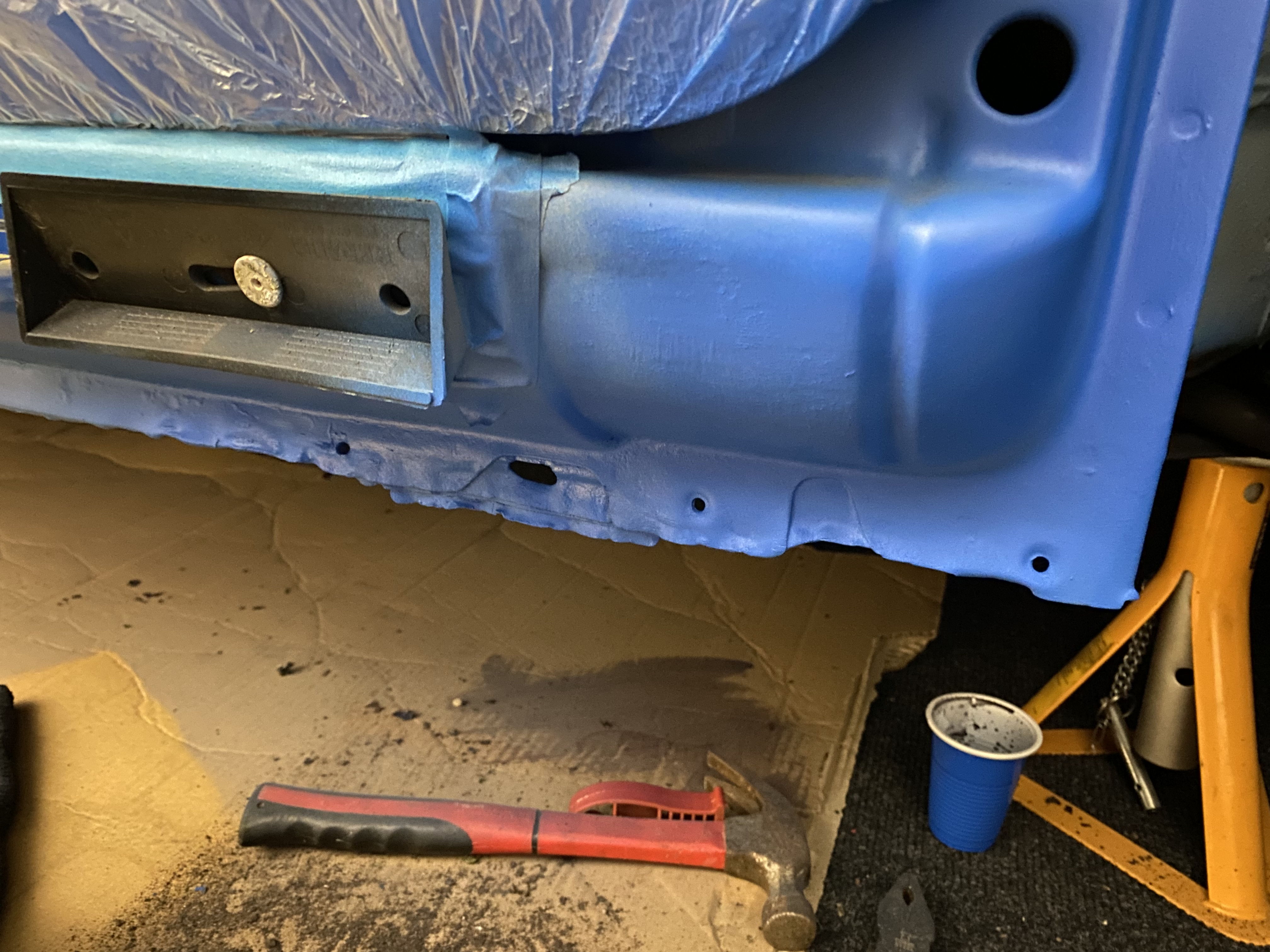

Slow Progress...30th July 2020
Unfortunately progress has been really slow on the 182, like many people at present, work is crazy busy, having a pregnant wife with constant "morning sickness" and 2 year old boy isn't a great mix for free time!
Although actual work on the car has been slow I've been securing parts/equipment to enable me to get the car back up and running.

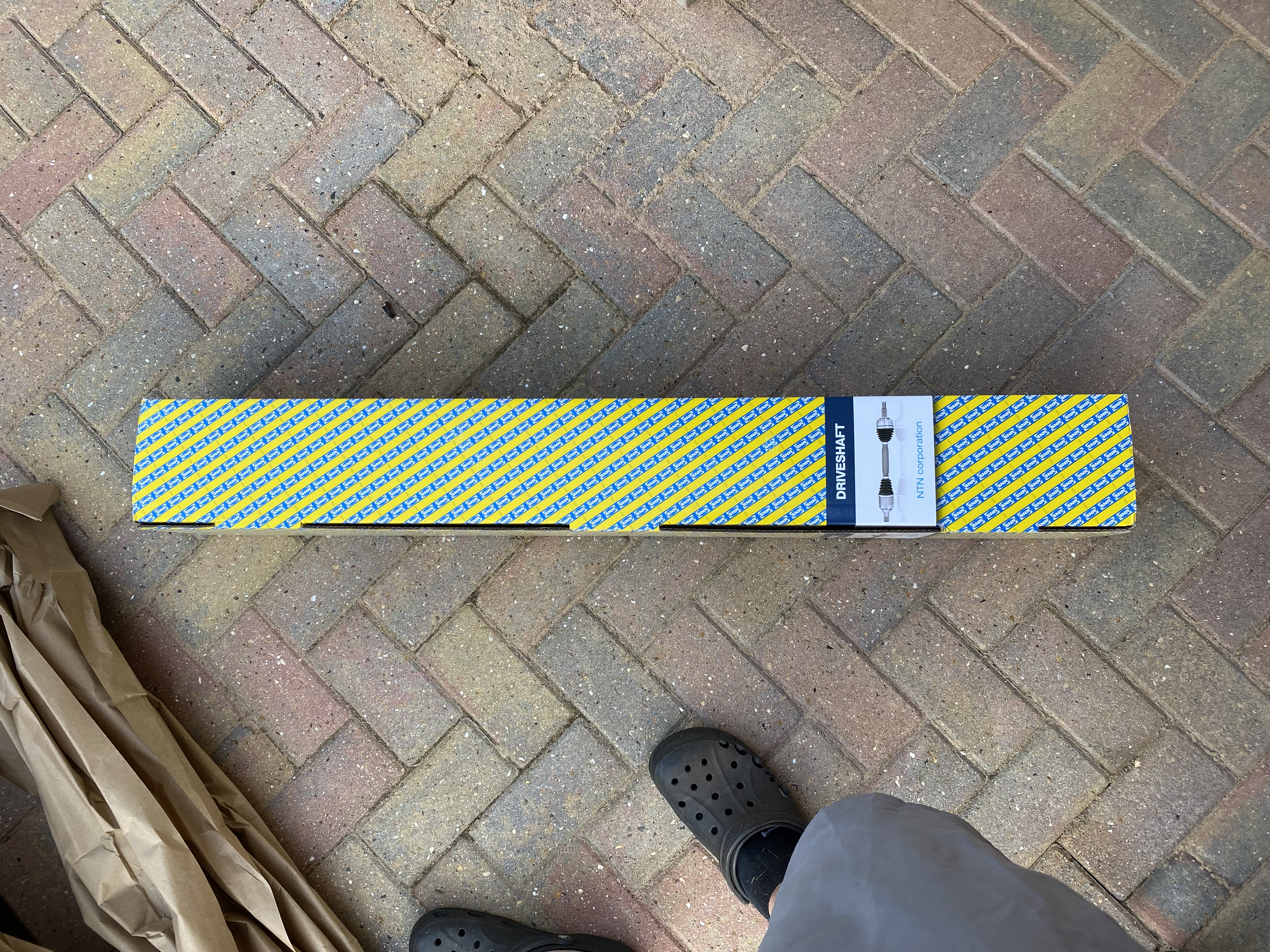

Firstly I didn't realise how hard it would be to locate a drive shaft for the Clio, many people recommend J&R items and fitting a different boot however I've gone for an SNR part from AutoDoc. This only arrived earlier this week (maybe last week) so I now in theory have all the parts required to put it back together:
Nothing more exciting than car parts arriving in the post:

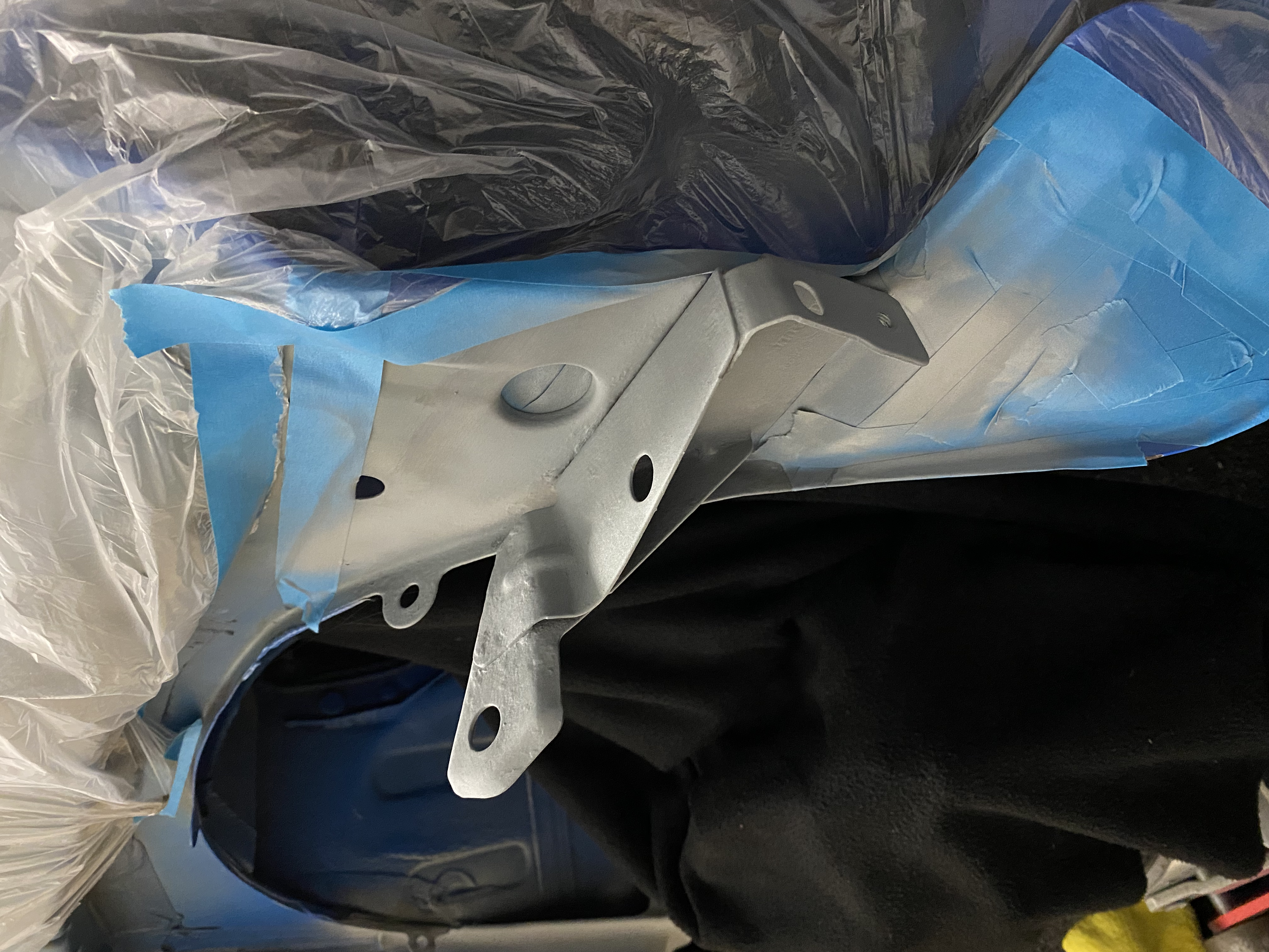

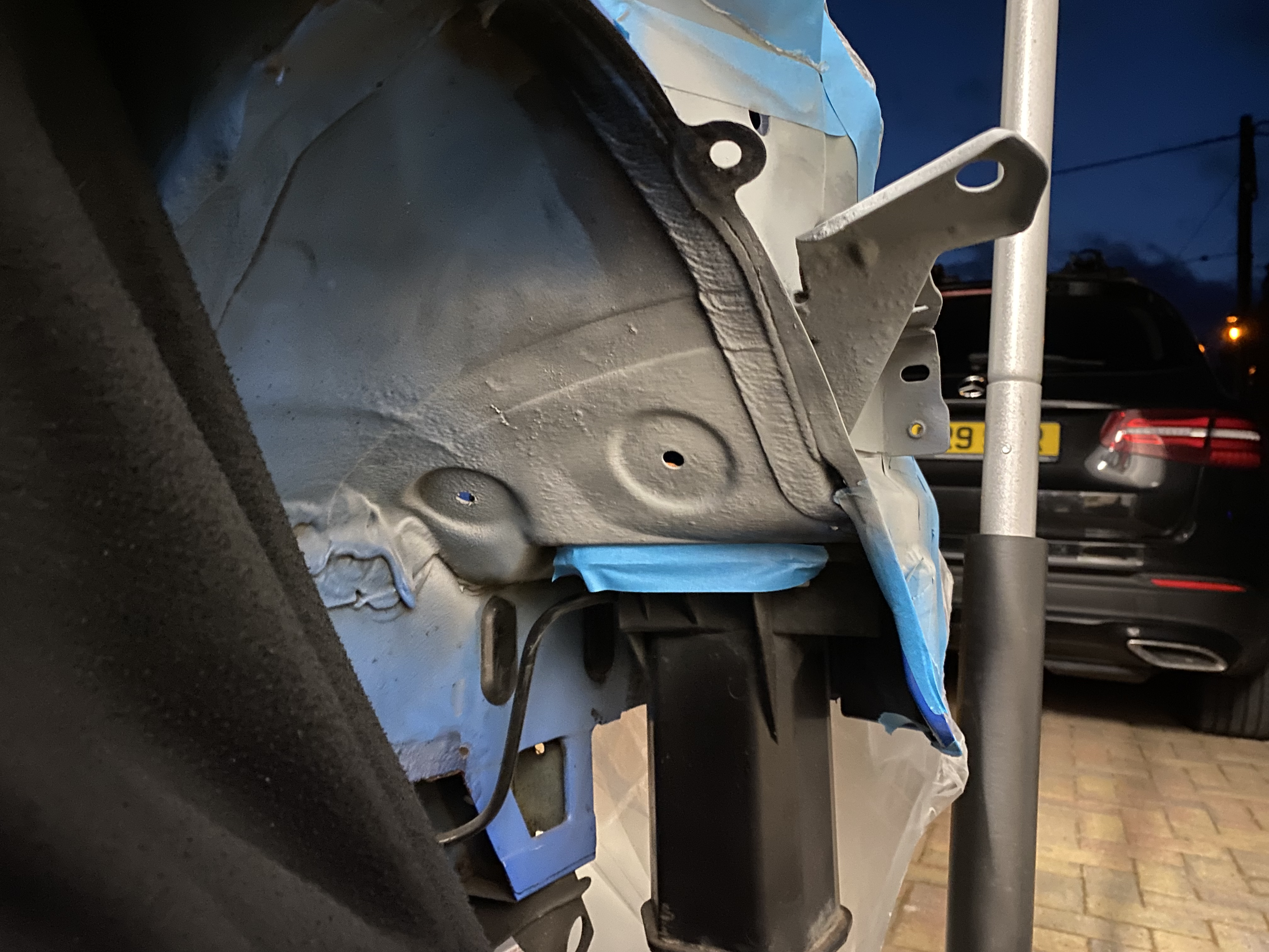

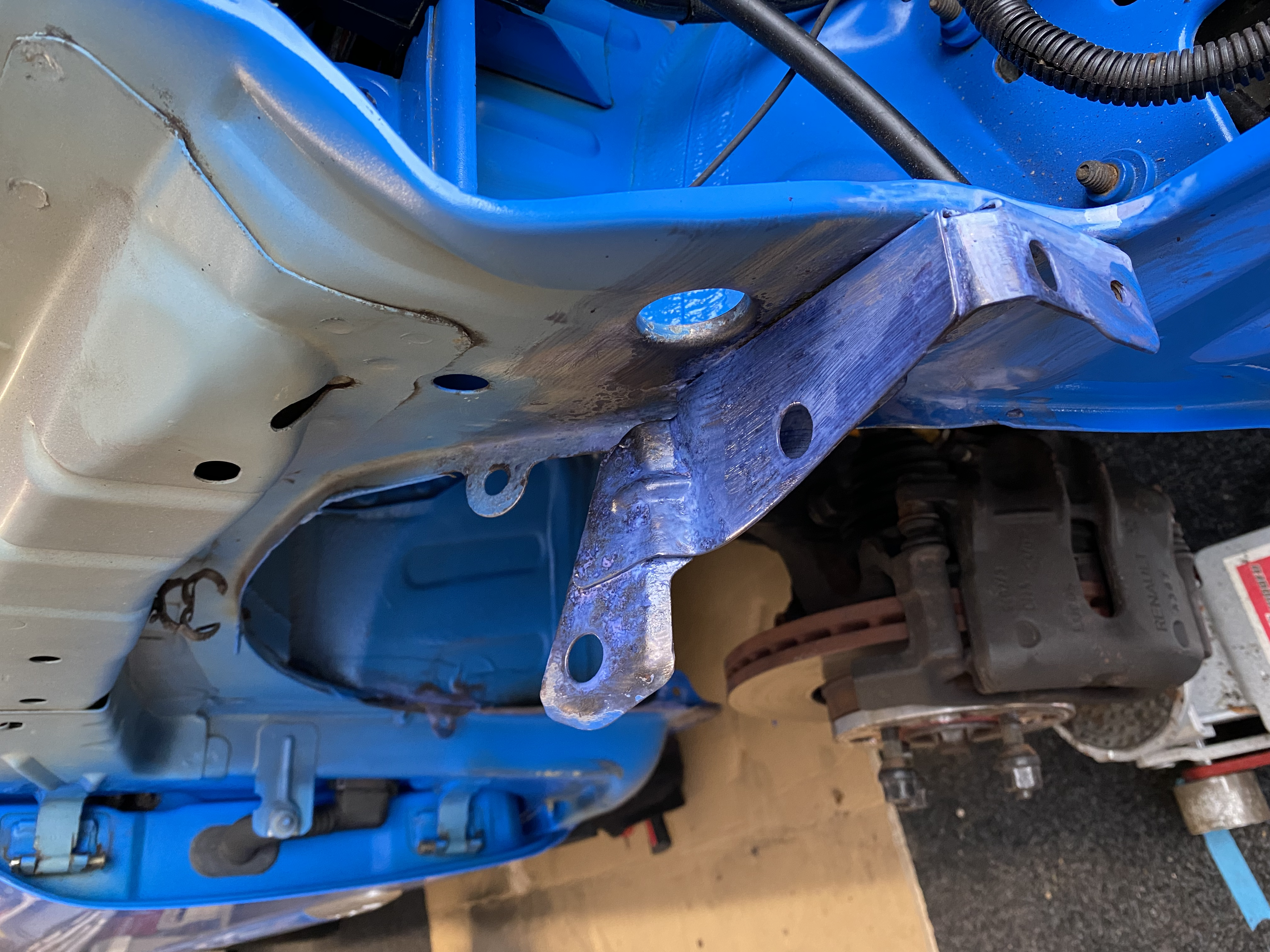

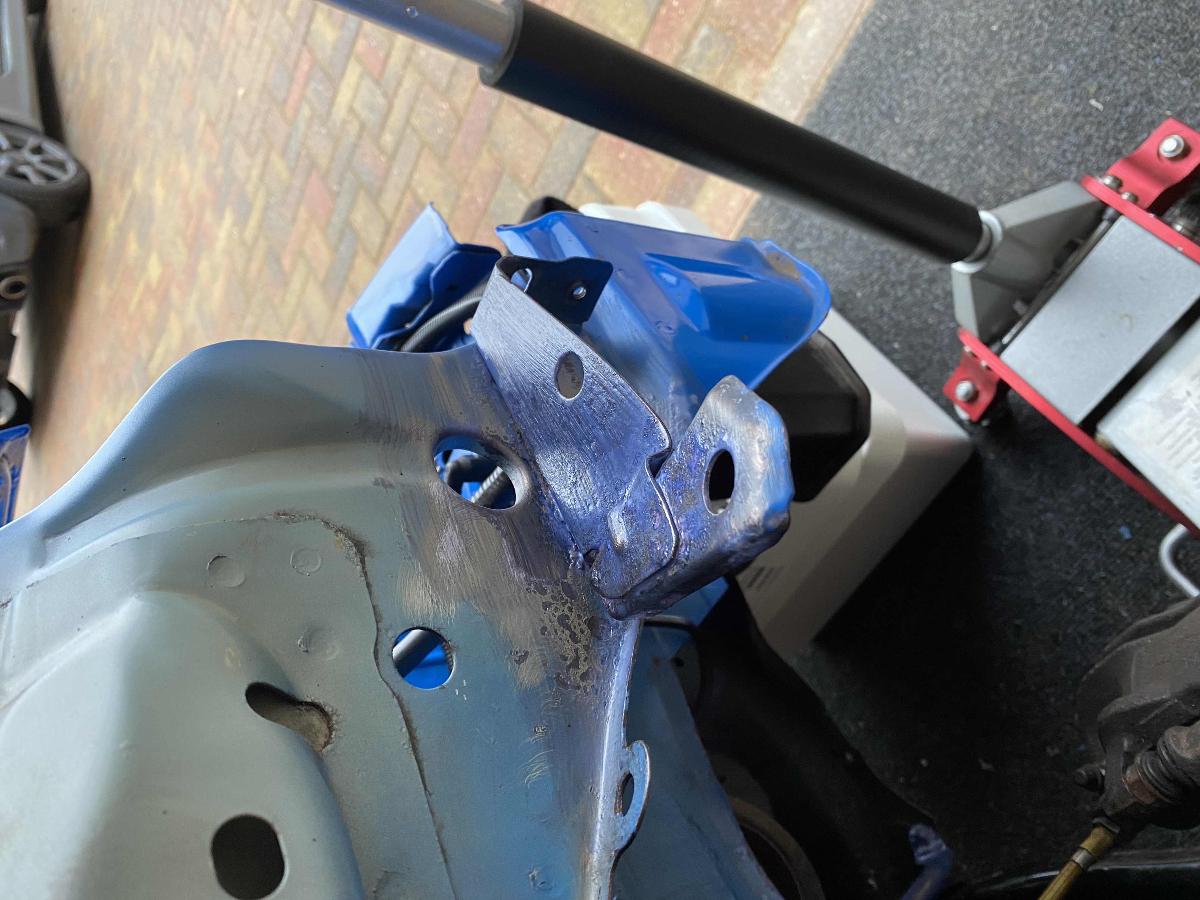

With the help from the CS/Insta I set about buying the correct products to sort the sills, at one point I was thinking about going "balls deep" and literally doing a full nut and bolt restoration however with a trackday booked at the Nurburgring at the beginning of September I thought this would be a stupid move, I've therefore decided to tidy up the areas I've exposed and the get the car up and running and then maybe this winter take the car off the road and get all the work completed in one hit. I've already mentioned this to Alex and I need to spend sometime writing up a full list of what I wish and hopefully I'll get it booked in with him later in the year.
That said I purchase a load of BH products to sort the drivers side sills while they are exposed:

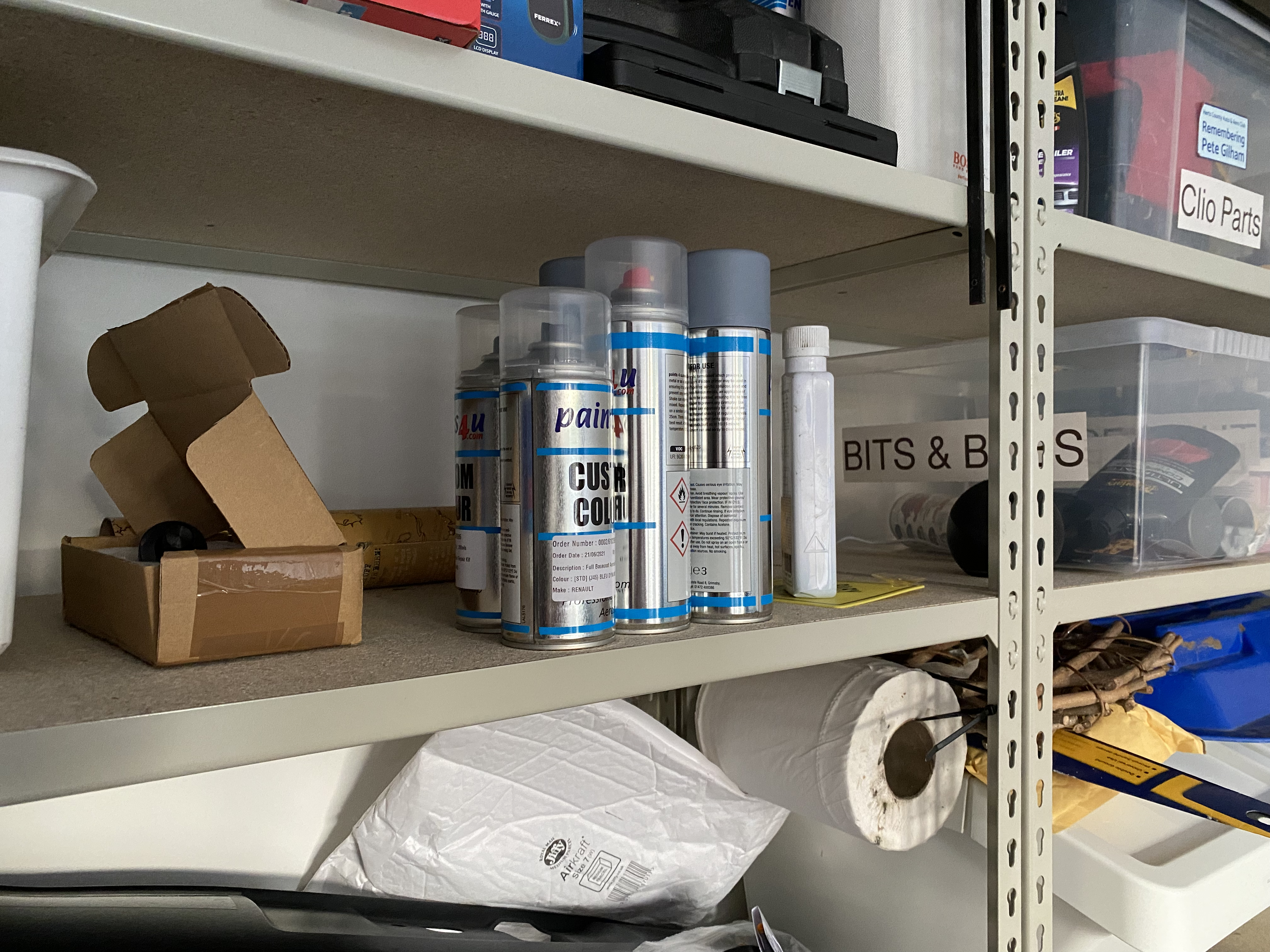

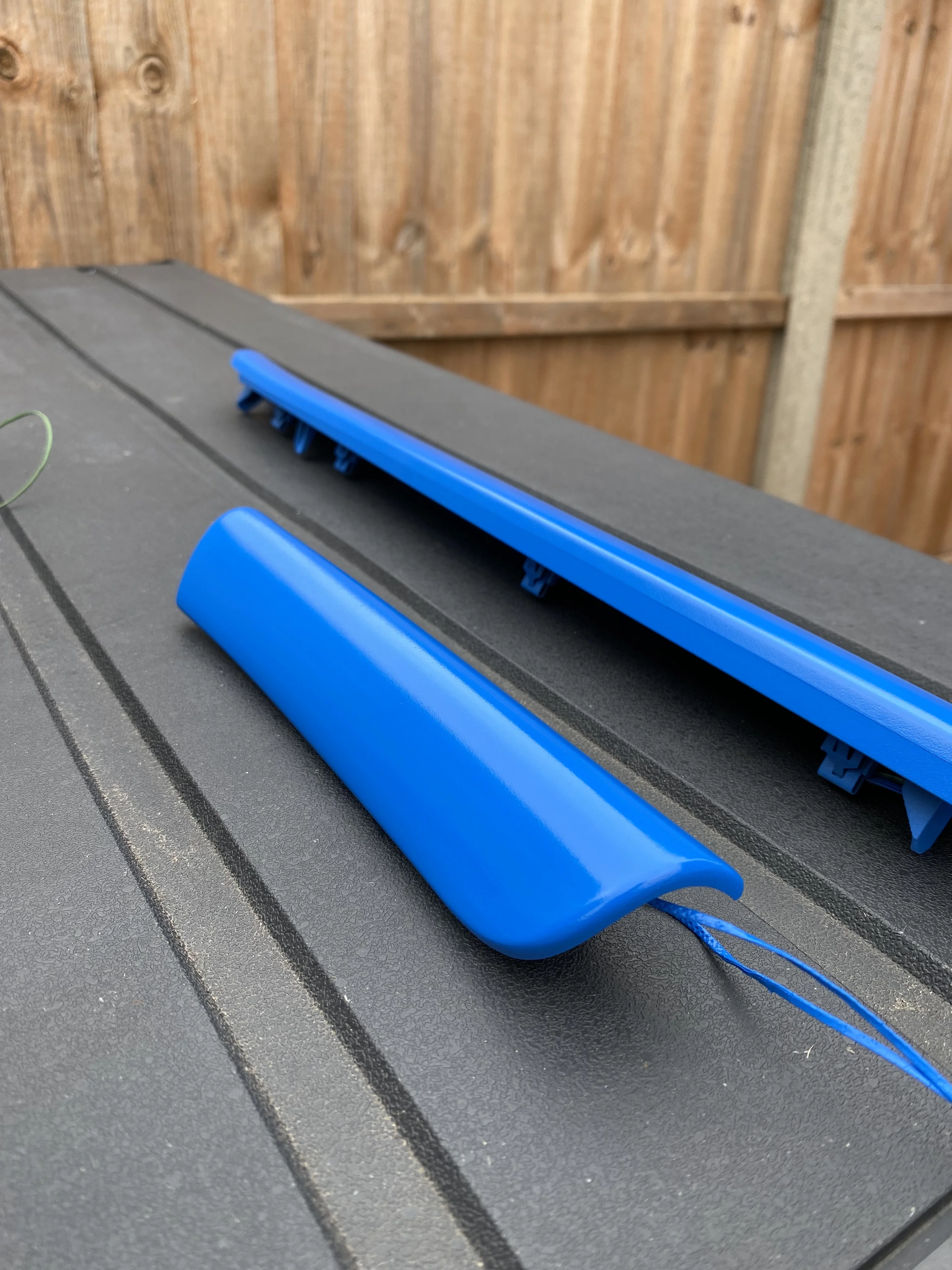

I've also purchase a small amount of RB paint:

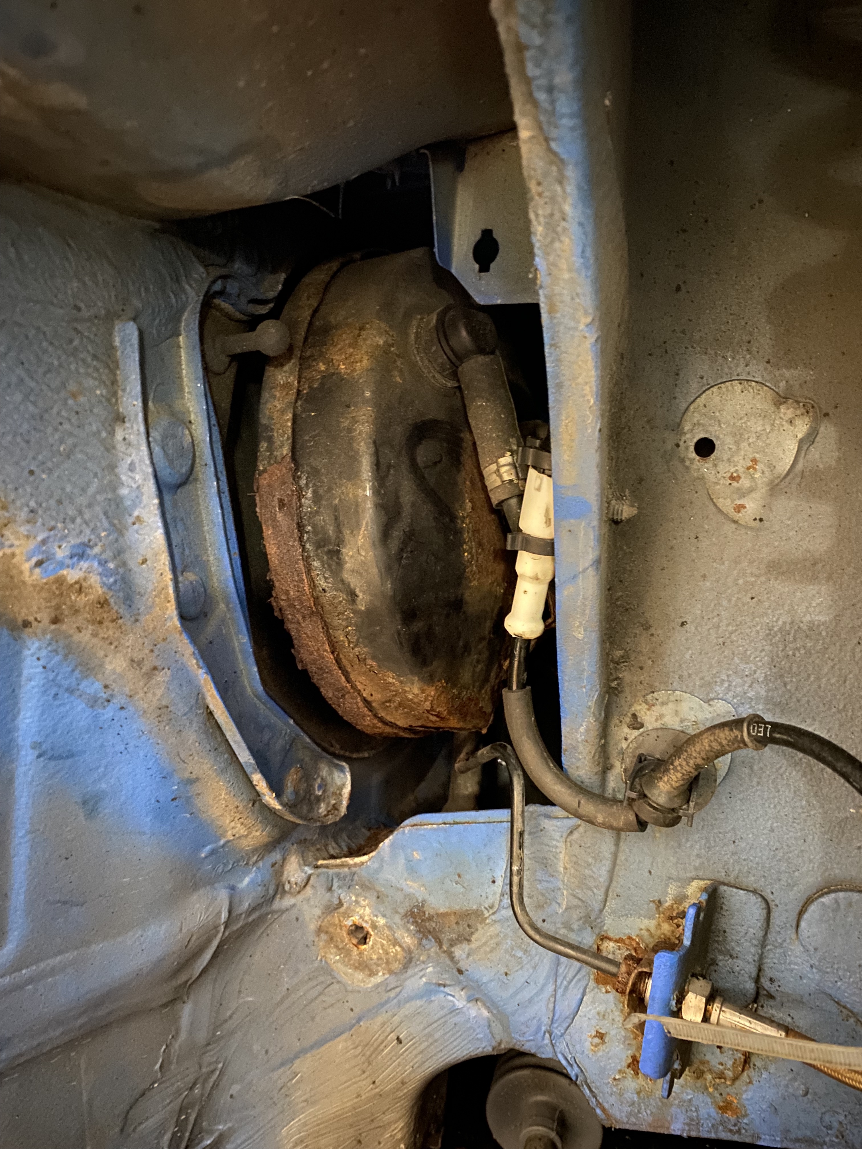

A had a few hours the other night to I quickly gave the sills and arch a quick clean so see what I was working with:
All of these rust spots were hidden with the side skirts fitted however I will look to get these sorted later in the year.
I now own a number of wire wheels brushes so I can look to remove a majority of the rust and then this weekend I plan on straightening the sills and get the side skirt fitted along with the wheel arch. Once they are all back in place I've then got the task of fitting the new drive shaft and fitting the new ball joint.

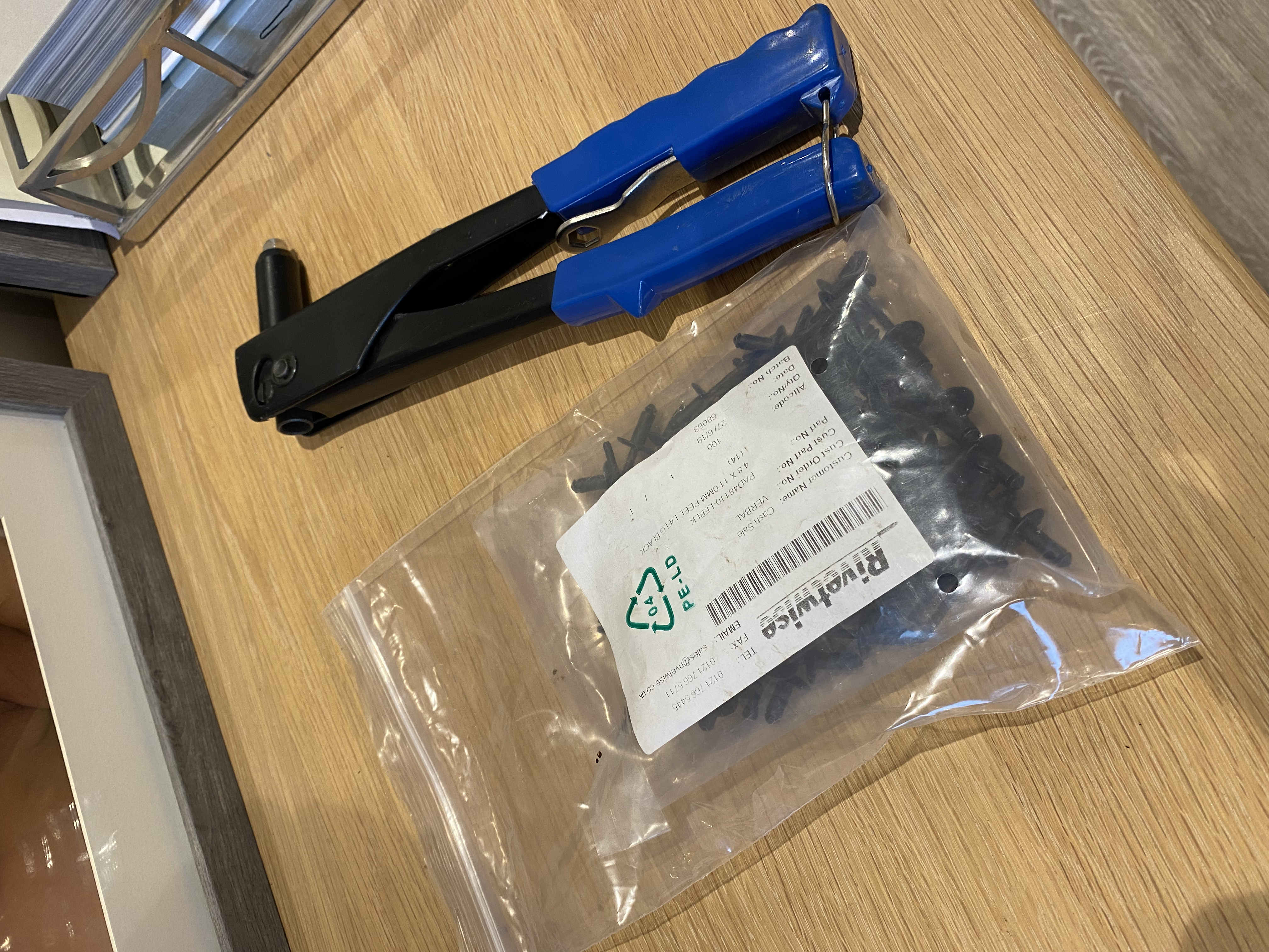

Thanks to @frayz for lending me this rivet gun and providing me enough rivets to re-fit the side skirts.
I'm still a little concerned I'll need a new side skirt before Germany, as my current one has a hole, I'm worried this will turn into a funnel and could cause more issues, I'll see what it fits like prior to fitting the rivets and go from there however trying to locate a RB side skirt is a nightmare...
Ideally I want the car up and running by next weekend as I would like to use for a few weeks prior to the drive to Germany. As soon as it's working I'll commute daily in the car, hopefully this will highlight any issues and give me time to get them resolved.
Fingers crossed for a more positive update soon.

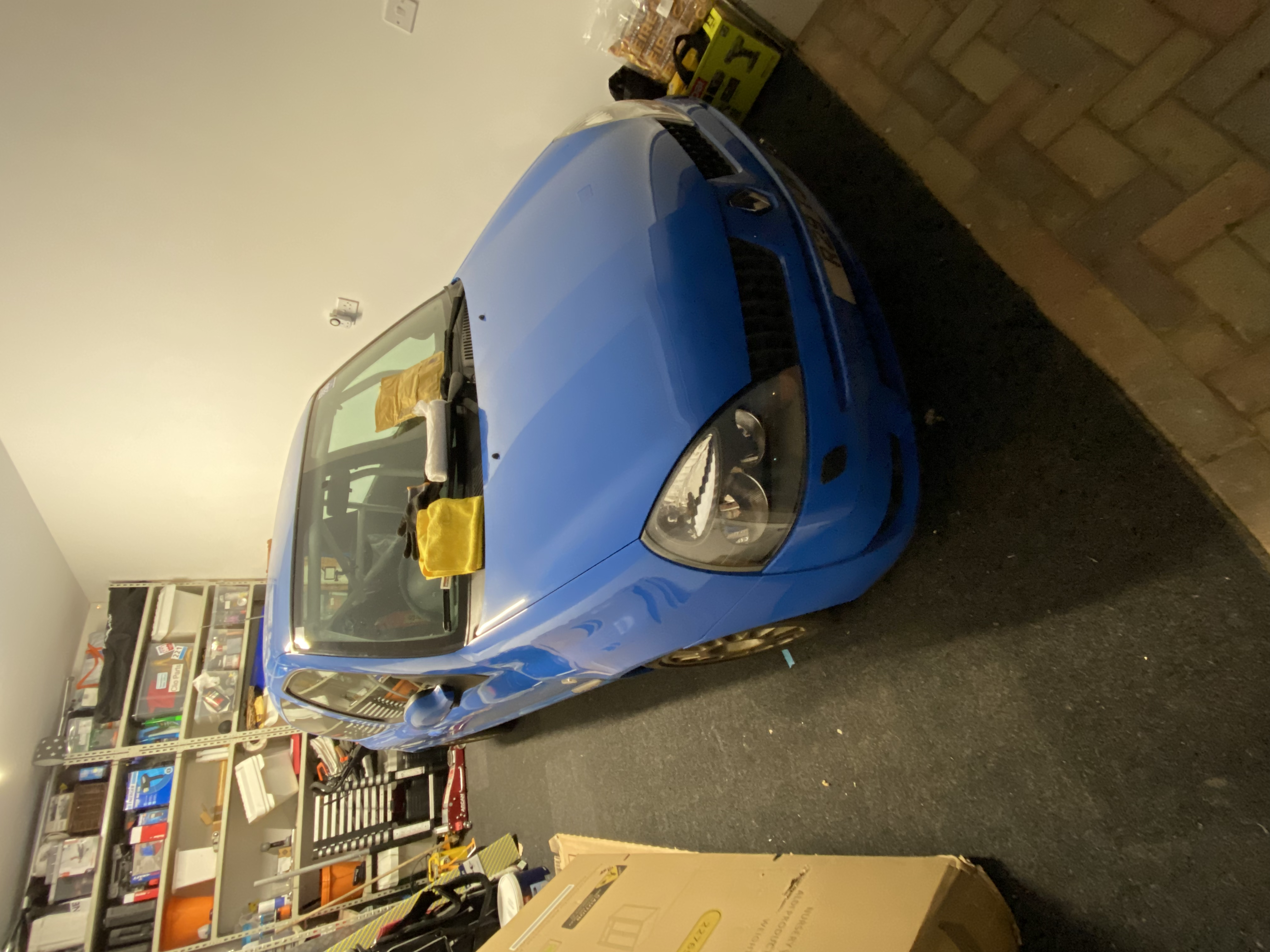

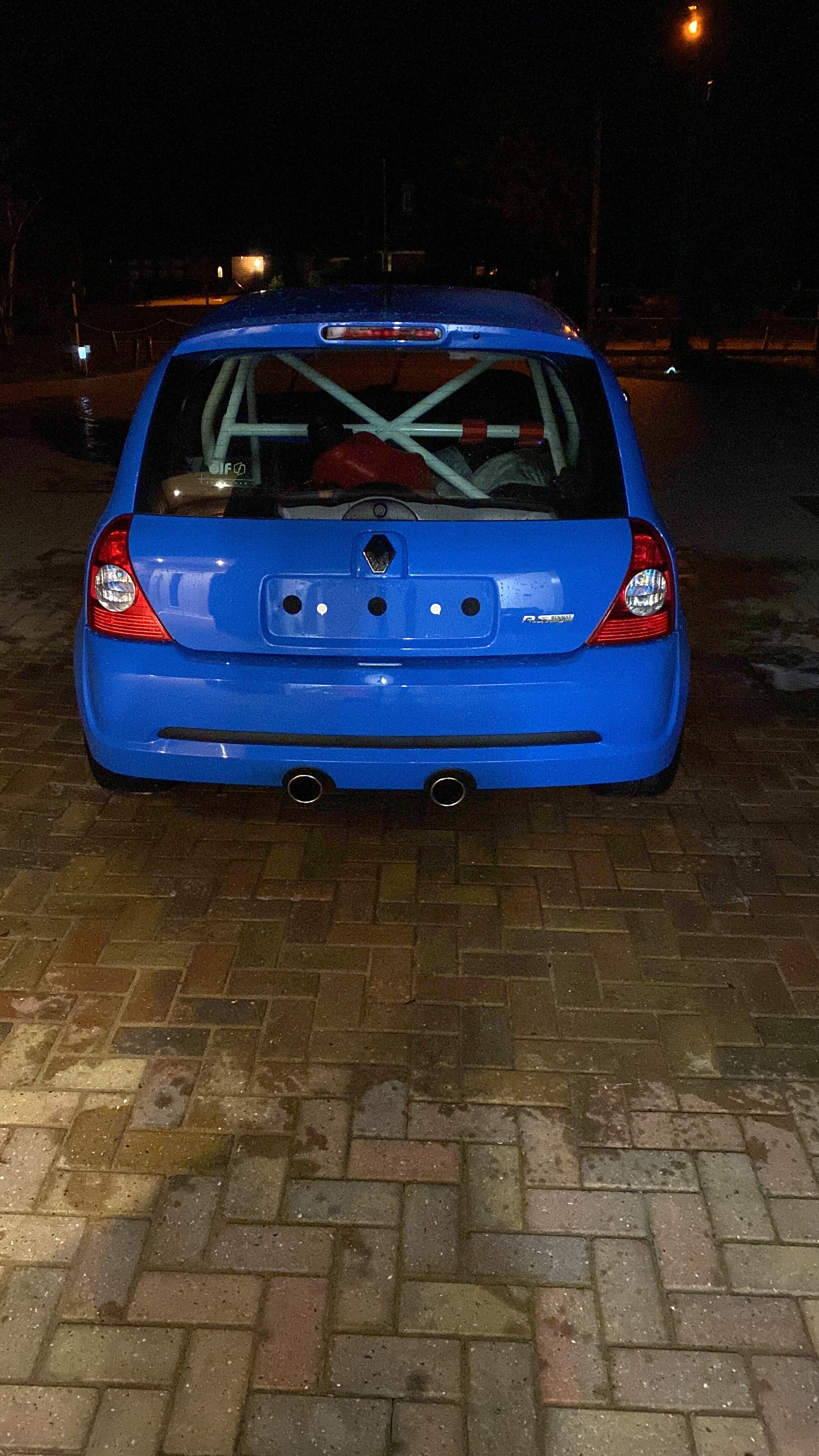

Update 10th August 2021 - Up and running

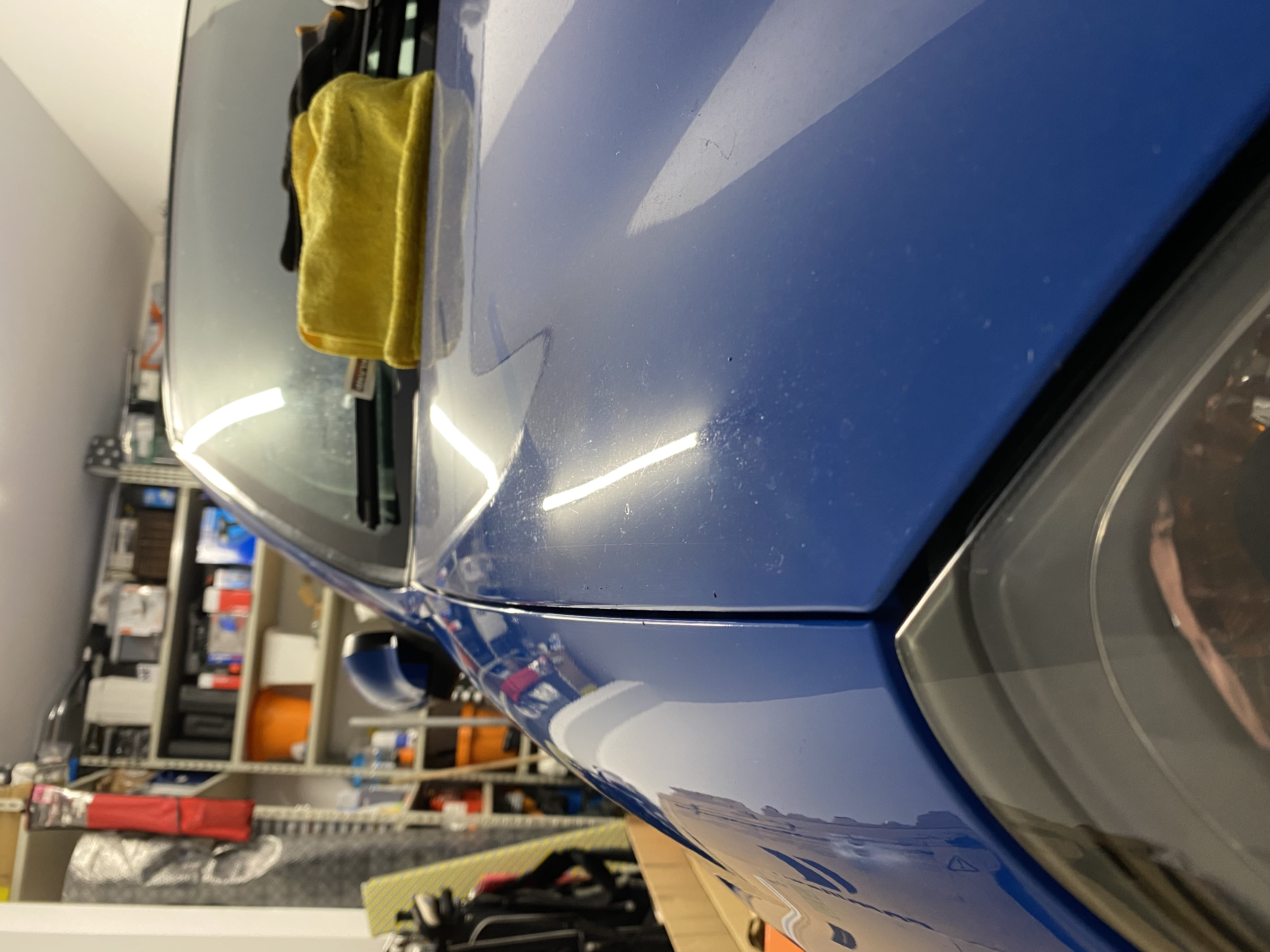

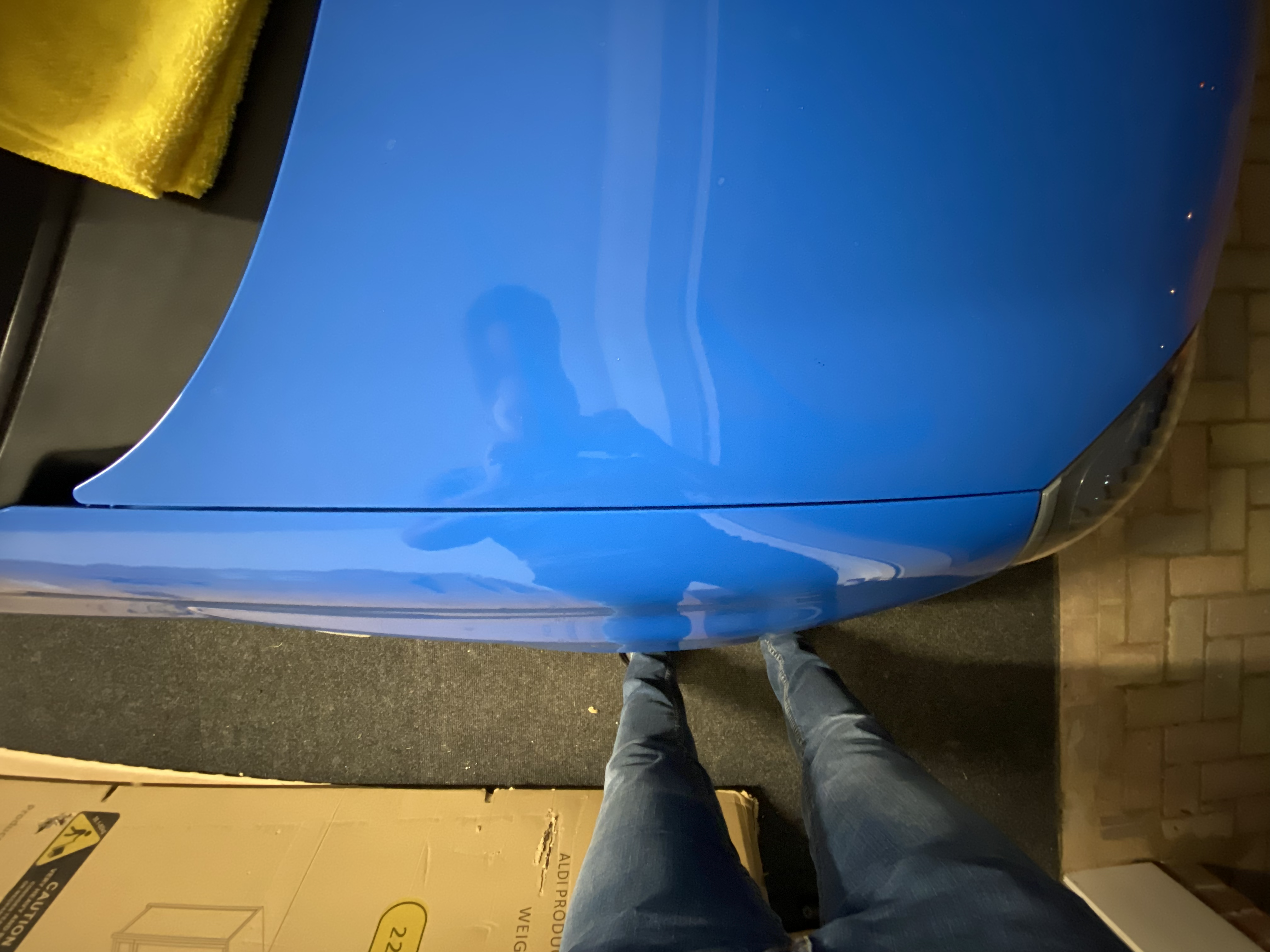

Since the last update I'm pleased to say I've got the car up and running, I'm still not 100% happy with how the wing is lined up and I still need a new side skirt as the current one has a hole in it but I'm pleased it back on its own wheels.
Once again a thanks to everyone whom provided advise on how to tackle the bodywork and a special mention to @frayz for lending me his Rivet gun and providing me with the correct peel rivets.
I'm not the best at taking pics so I missed a few stages, however hopefully the below will explain what I have, or haven't done!

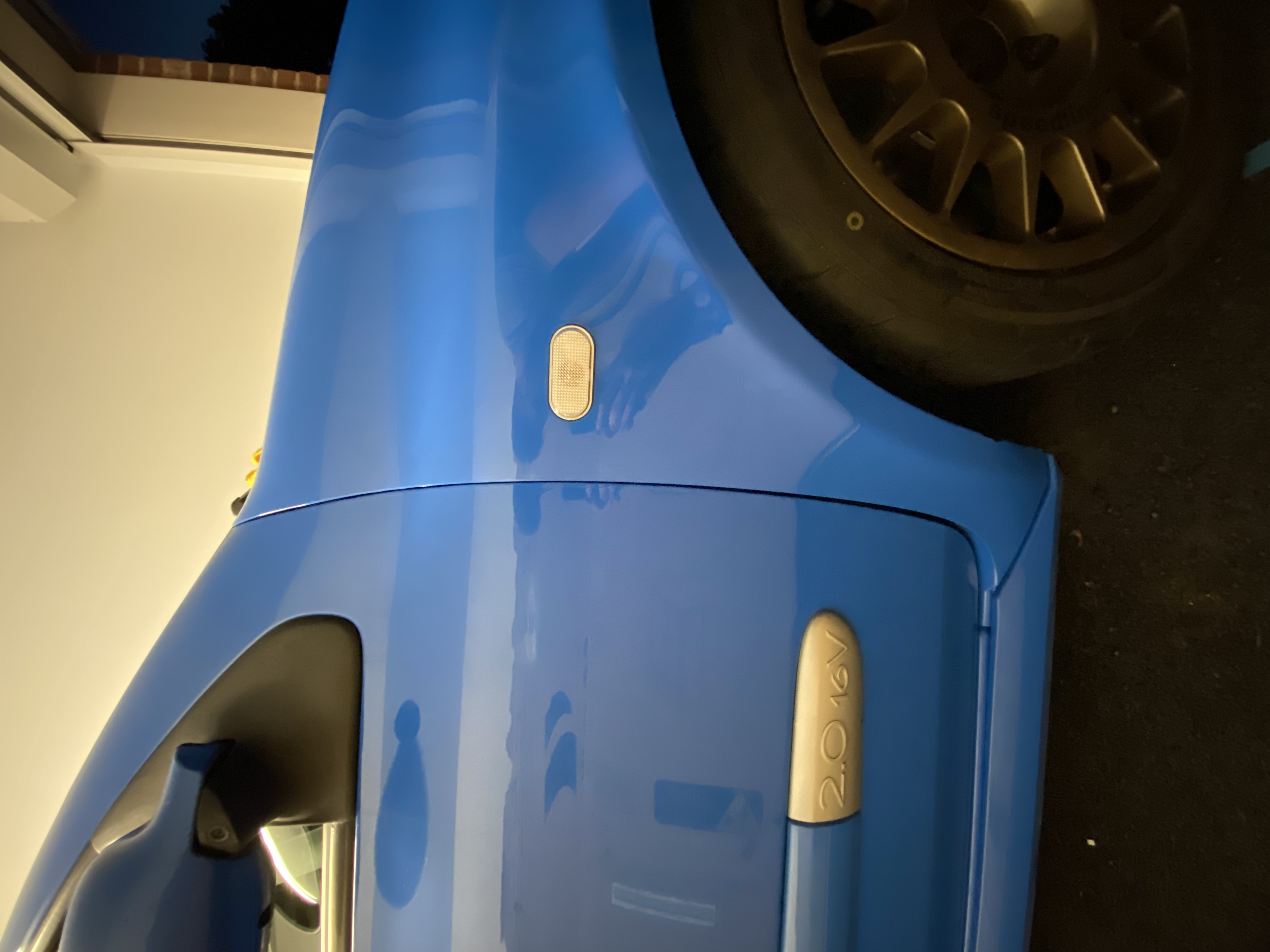

Rust Repair...
I first attacked the car with various wire bushes, drill and grinder attachments to remove the loose rust. During this process I also made a start on straightening the sills, unfortunately I didn't get many pics of this part as it was often done late at night while my neighbours were on holiday!
Once I'd removed all the rust I could possible I then followed the following steps:
  1. Bilt Hamber Deox Gel
  2. Bilt Hamber Hydrate 80
  3. Bilt Hamber Electrox (primer)
  4. Racing Blue Paint
  5. Lacquer
I also need to add a layer of protection over the top, have another BH product to do this, I must say at this point I have been massively impressed with every product used, I had high expectations and they have certainly lived up to the hype.
Below is a section of pics showing the progress, hopefully in order, as stated above the early steps where not photographed:

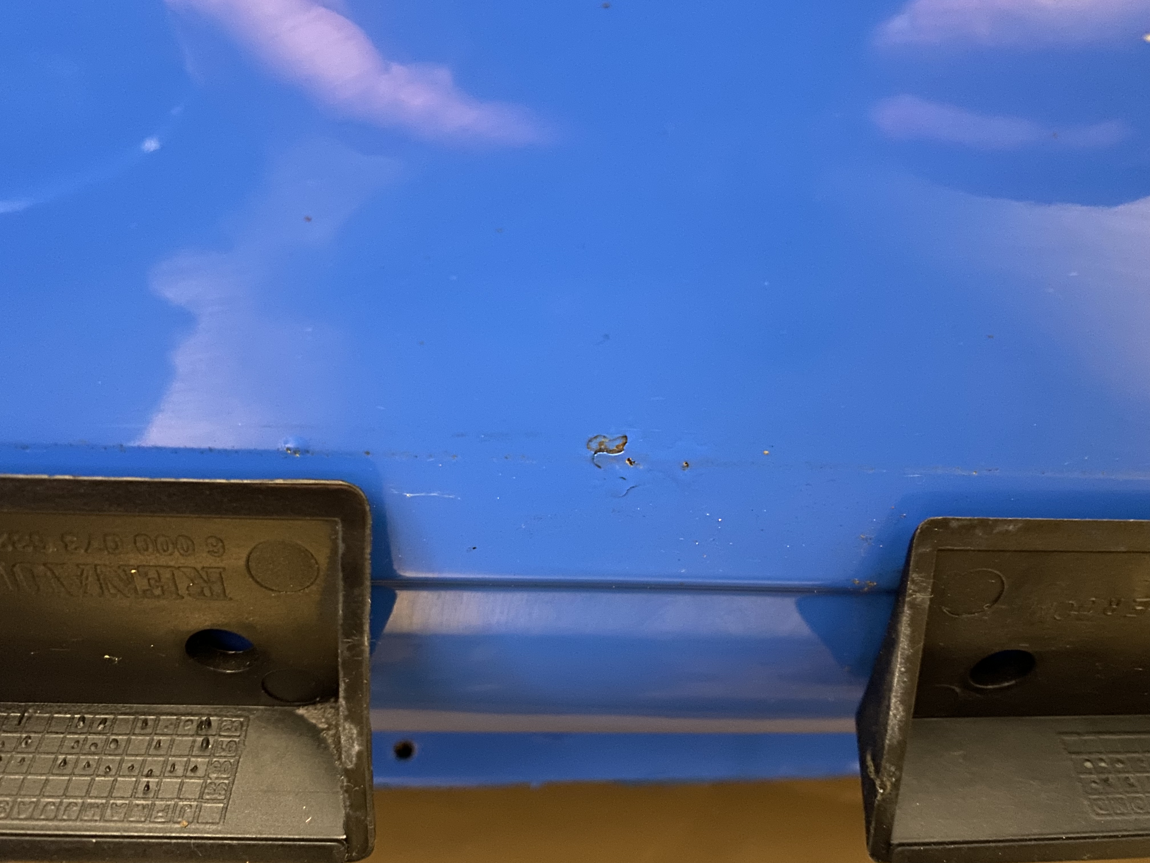

Bilt Hamber Hydrate 80 (going on)
Bilt Hamber Hydrate 80 (dried)
Bilt Hamber Electrox (Primer)
More to follow...
R29TJR
  2005 RB 182 Cup
Continued...

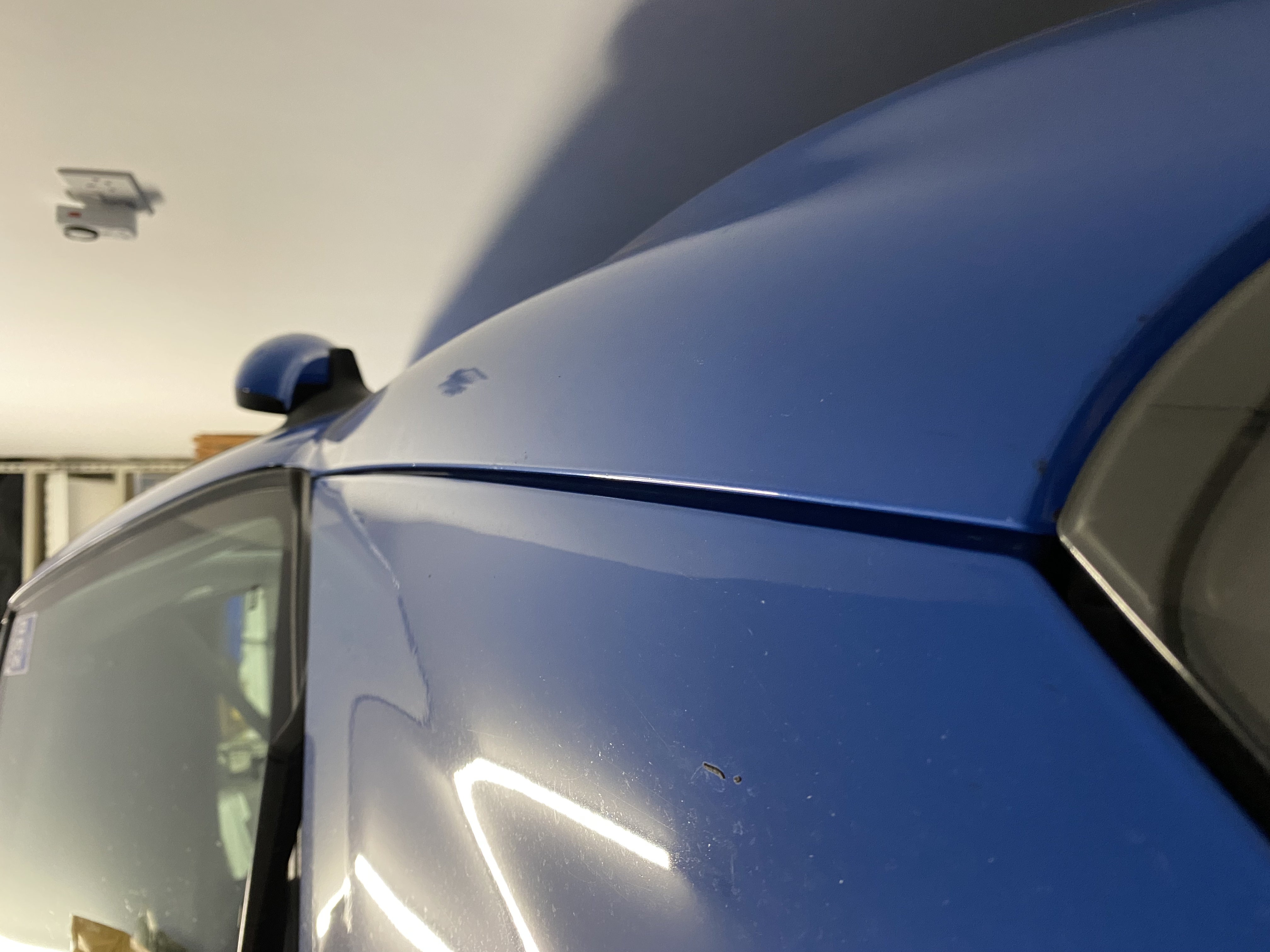

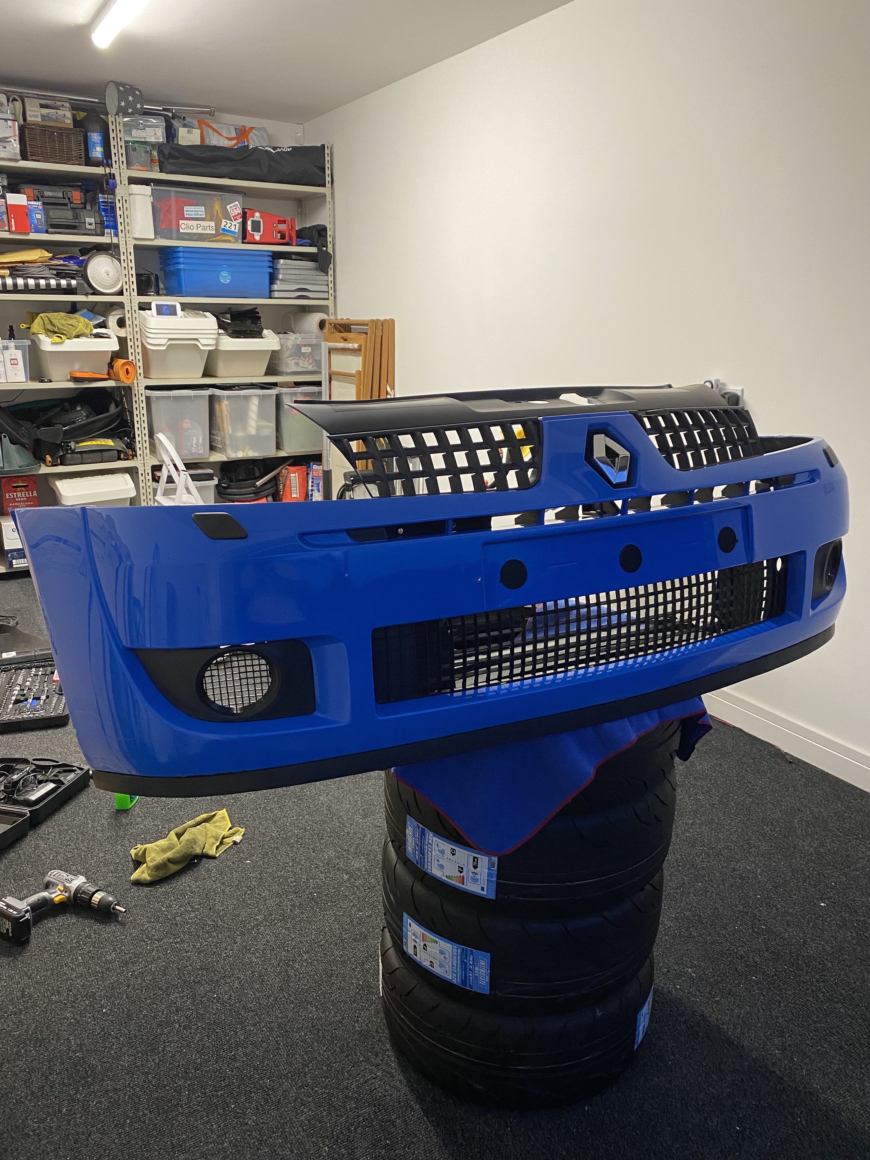

Racing Blue Paint
Overall I was really happy with the finish so I then set about bolting the panels back on, they are ok, but I still think they need some minor adjustment to fit perfectly and as mentioned above I still need a new side skirt, but this is how it's currently sitting:

15” Speedline 2118’s in Candy Red with Nankang AR1's (ET38)
15" Speedline 2118's in Gold/Bronze with Interstate Race DNRT (ET38)
15” Team Dynamics Pro Race 1.2’s in High Gloss Silver with Uniroyal Rainsport 3 Tyres

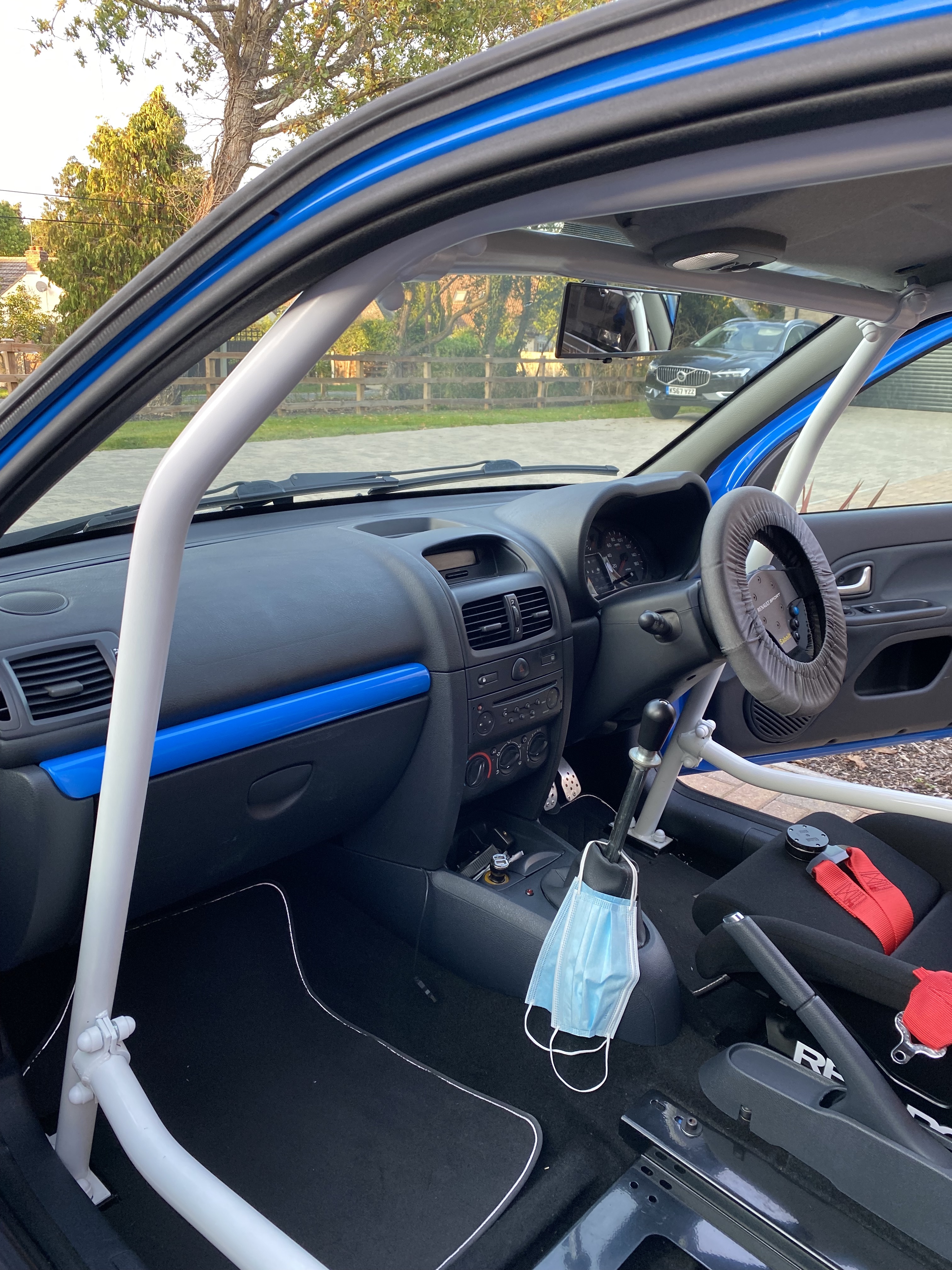

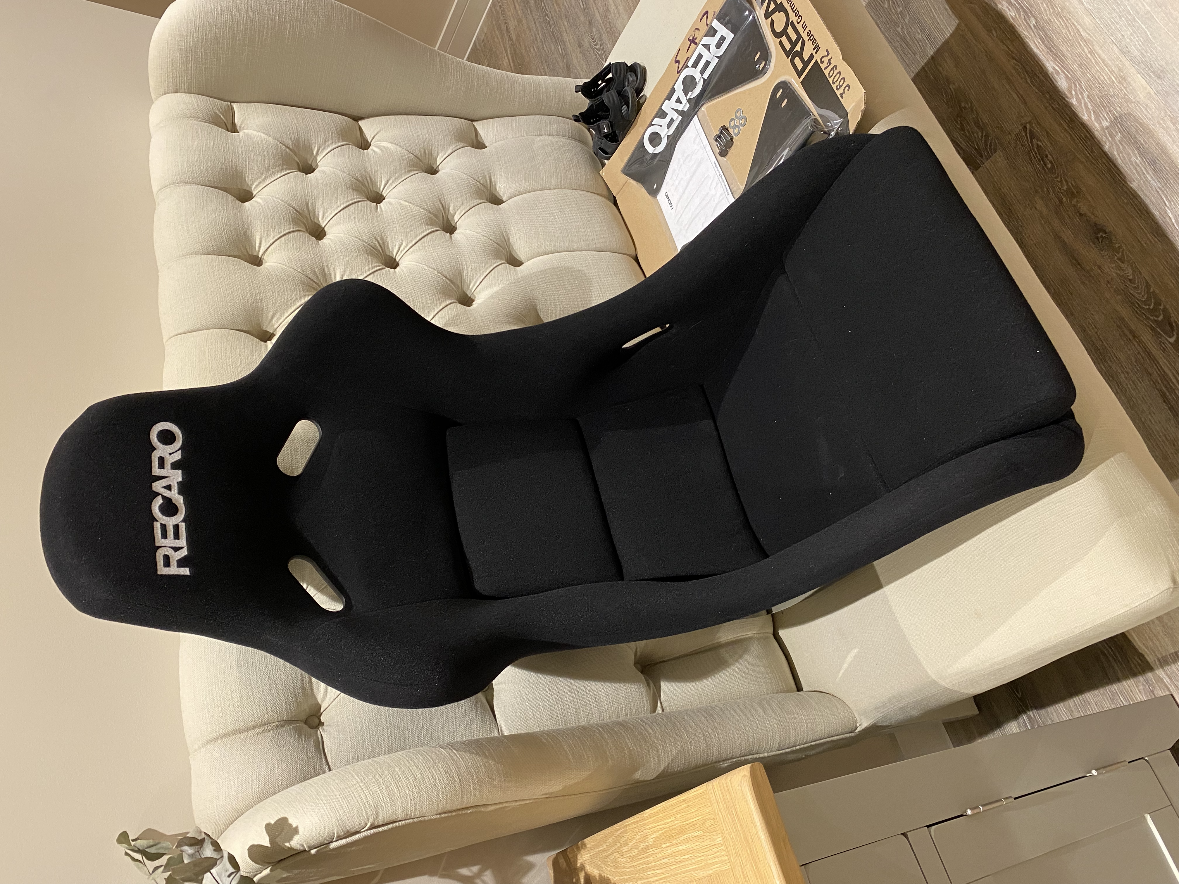

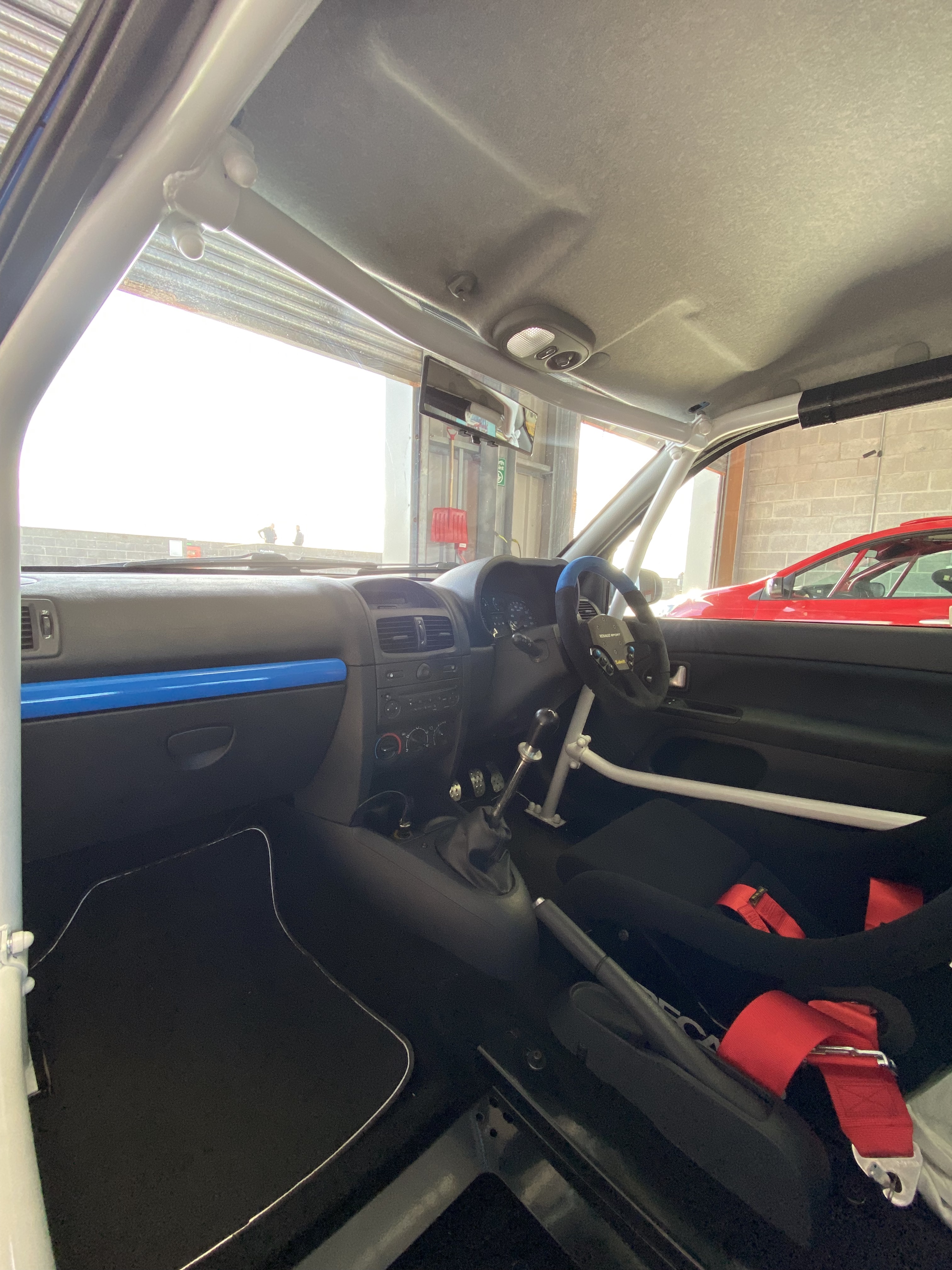

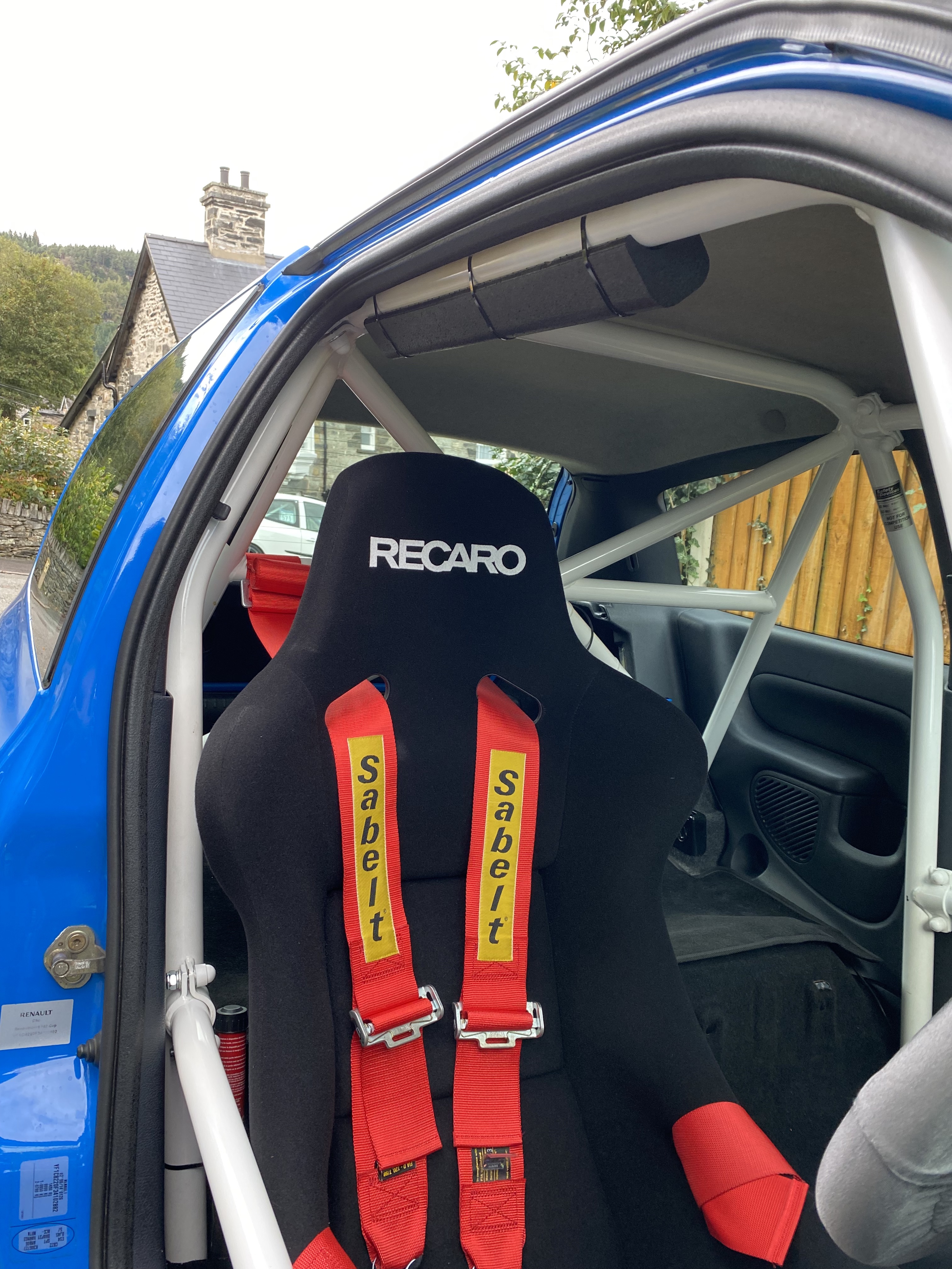

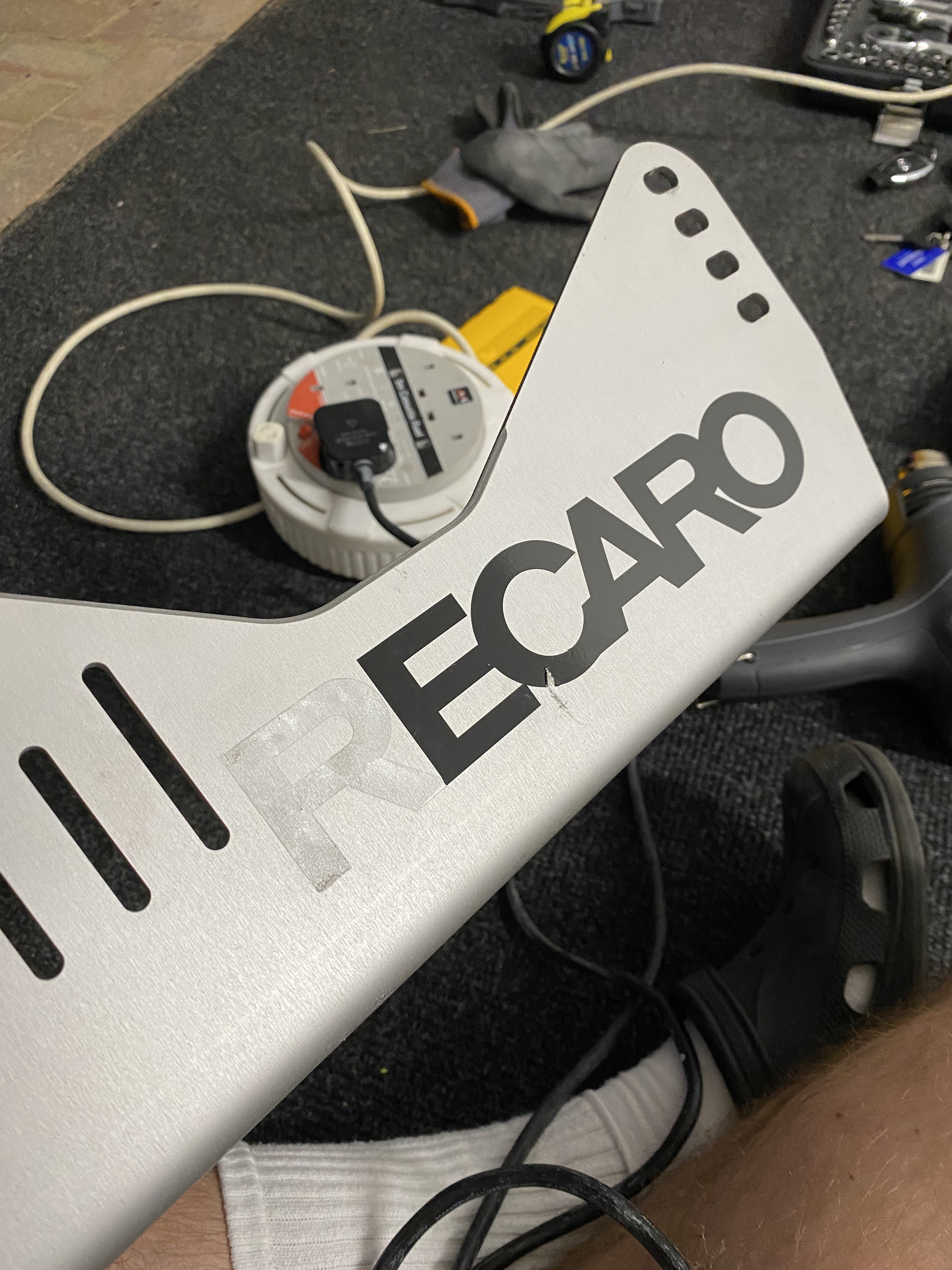

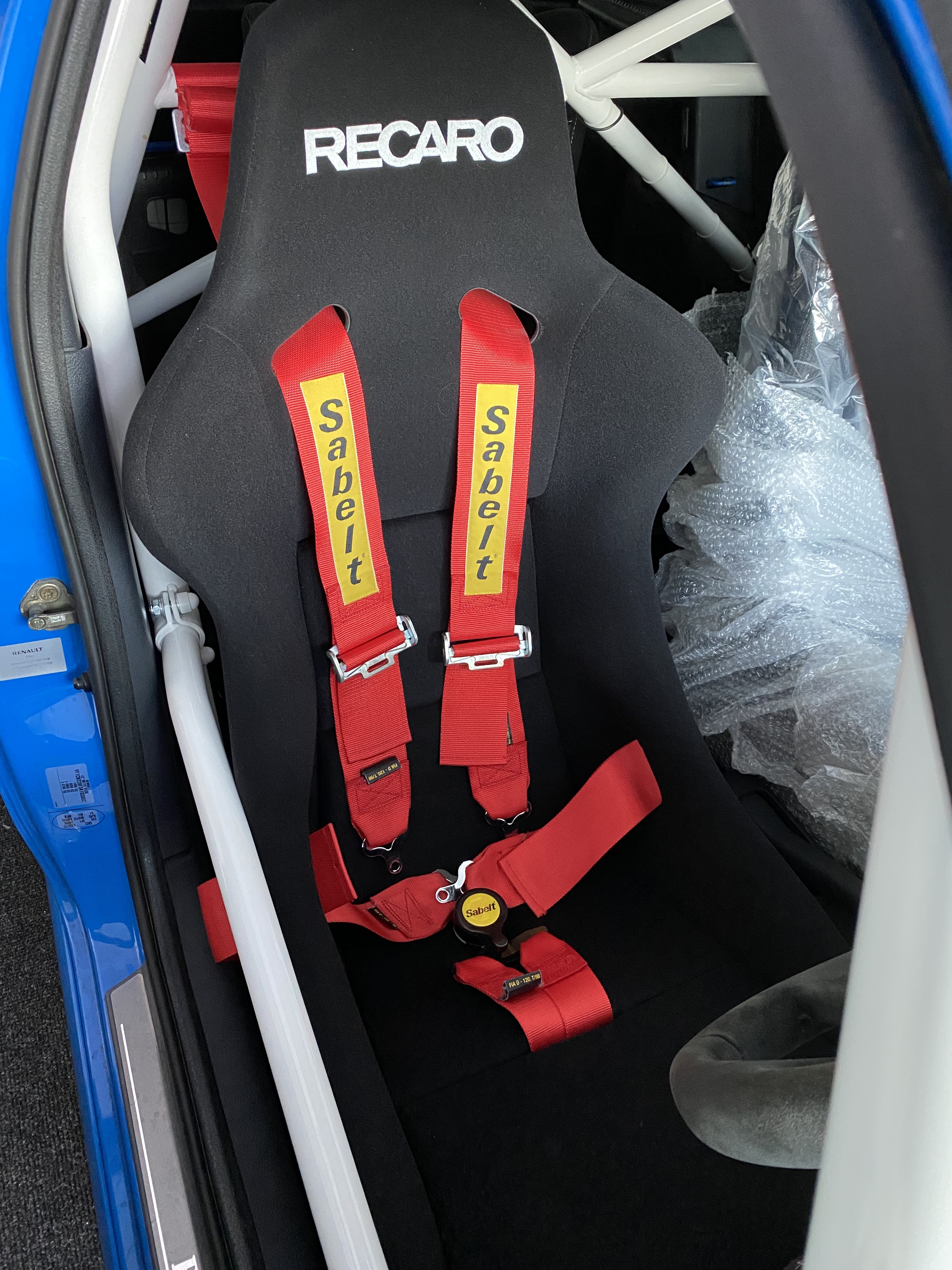

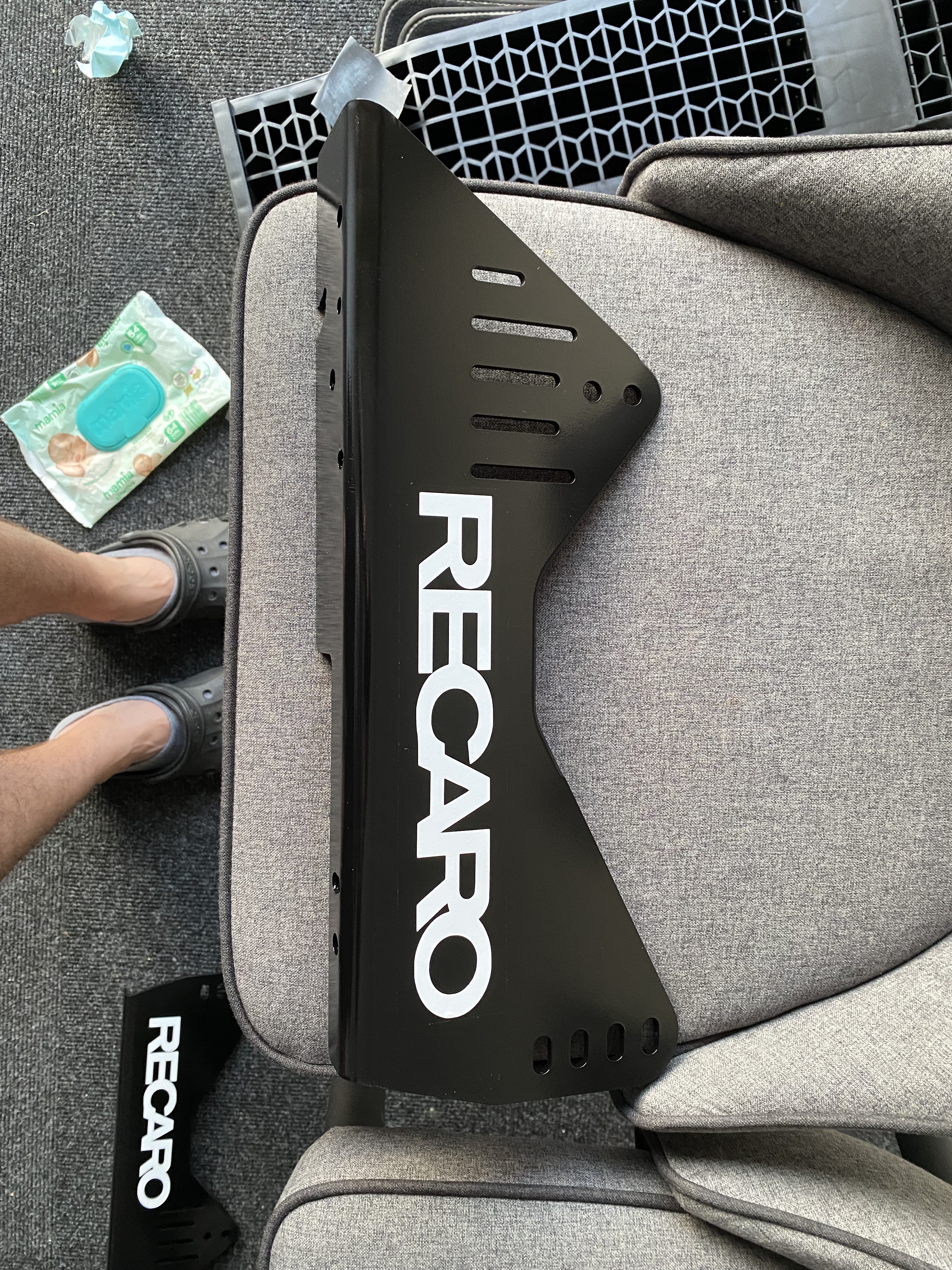

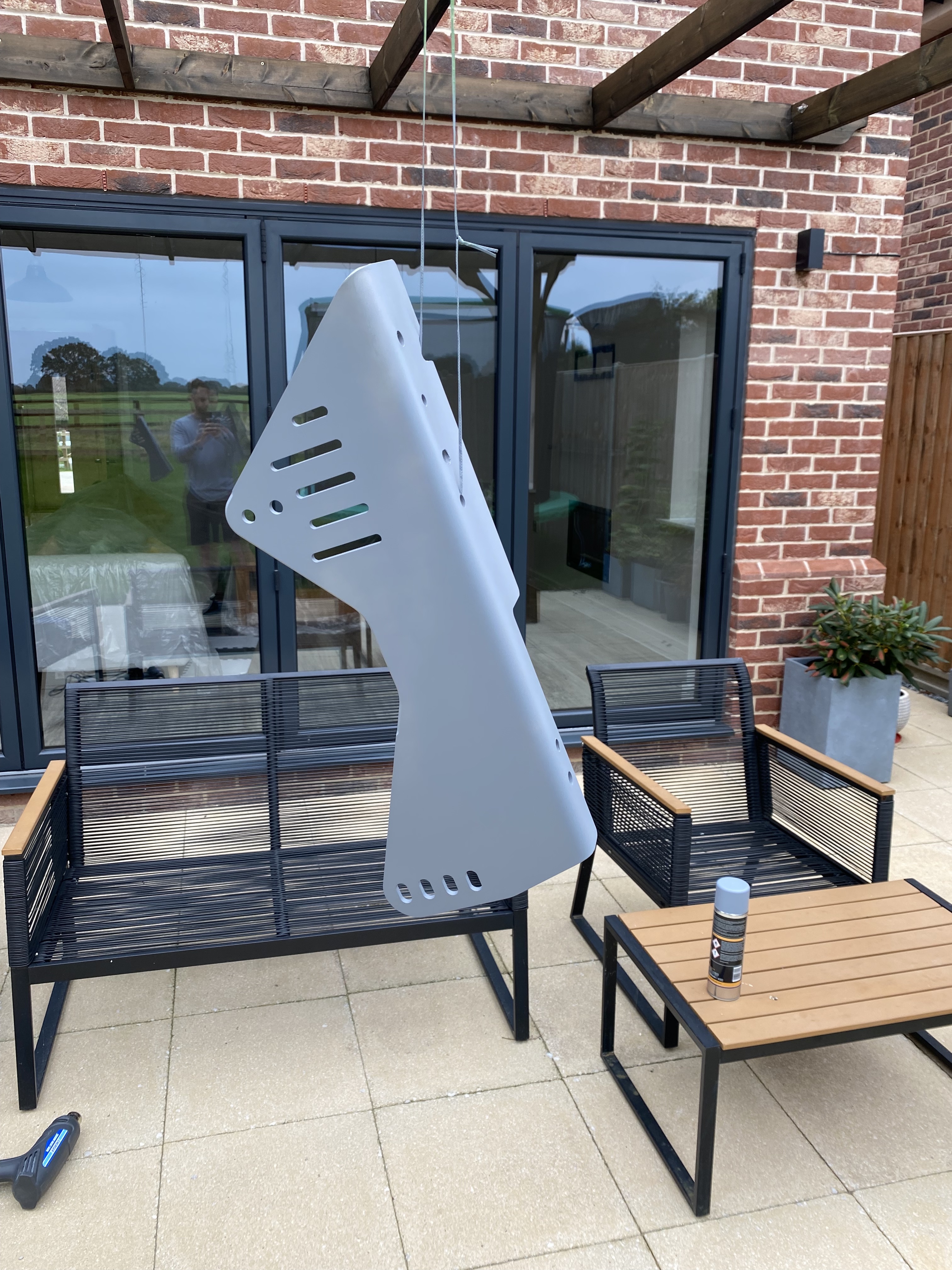

Firstly I had the "easy" job of fitting the Recaro Pole Position seat, as I'm the only person to drive the car I have mounted the side mounts directly to the subframes. This helps by increasing rigidity and also helps lower the seating position. The side mounts that came with the seat wouldn't work with my side mounts so I managed to source a suitable set from eBay however they were alloy so i quickly set about painting them black. I spent a long time, I mean a very long time ensuring the seating position was correct as I had to drill both the side mount and sub frame. I taped up the subframe and measured a a number of times and tried the seating position a few nights to ensure I was totally happy before I started drilling! I've really pleased I spent my time on this part as the seating position is just perfect for me.
Painting the side mounts was harder than expected and quickly I realise the it would be harder than expected to remove the OEM Recaro stickers however once these were removed it was a relatively quick job. I'm not 100% happy with the end results, therefore I will look to redo them at some point. Now for the pics!
Sidemounts before
Sidemounts during
Sidemounts after

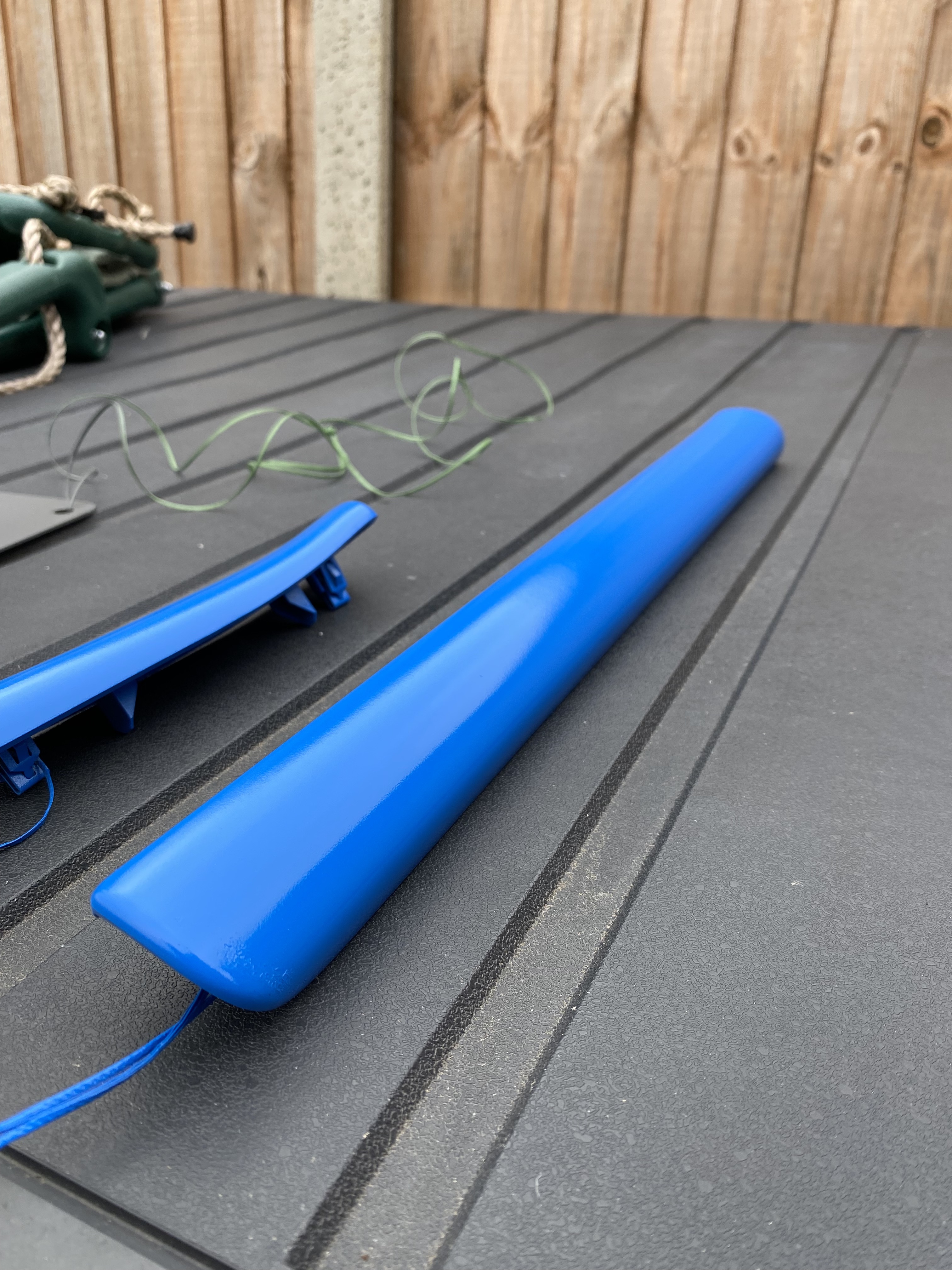

While I was painting I had a set of spare dash inserts which I had always thought about painting Racing Blue. I wasn't sure if this would make the interior look a little toy like, however I'm really pleased with the outcome. Yet again I'm not 100% happy with the end results (I painted on a very windy day) so I will look to repaint these at some point.
Dash inserts after (I've since re-painted these but no pics yet)

I then had a few weeks before a track day at Anglesey so I just wanted to clean a few items before the long journey. Firstly I took a pic of the Pole Position, I must admit I know these seat are expensive but its so comfortable, I drop the whole way to Anglesey, then around Wales for a few days, a whole day track day and home again and felt perfectly fine. As I'm sure you have all noticed, I currently only have one seat. I may keep it like this as; 1 it means I don't have to take people out on track days, which helps with weight! 2 I think it looks pretty cool with only one seat! I almost forgot to say, with the Recaro Pole Position fitted this allowed me to fit my door bar which I am most pleased about.
Recarco fitted:
I then re-painted the dash inserts as the finish was poor as I rushed the original coat, it came out much better 2nd time around, as you can see:
Dash Inserts:
Dash inserts fitted:

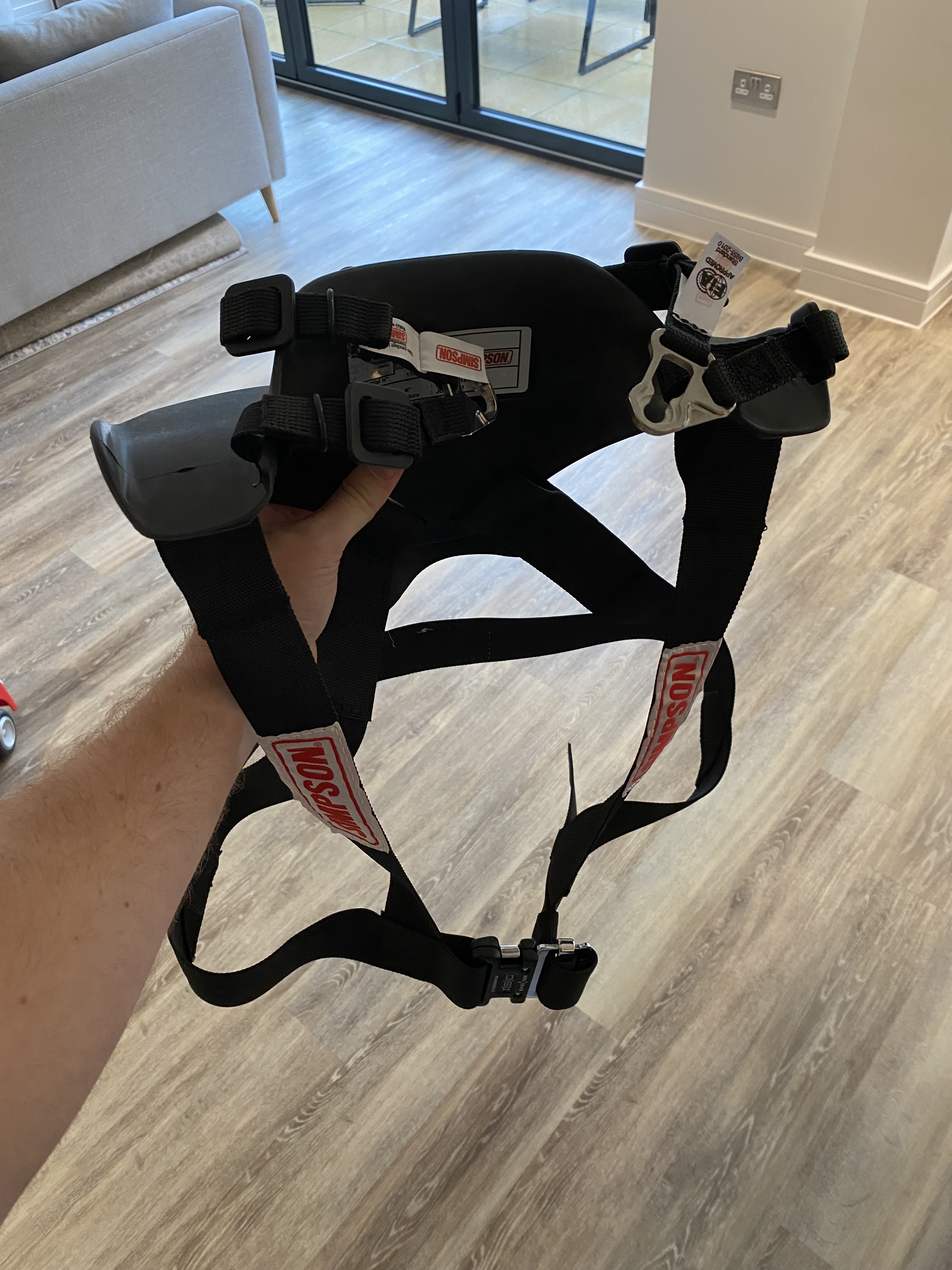

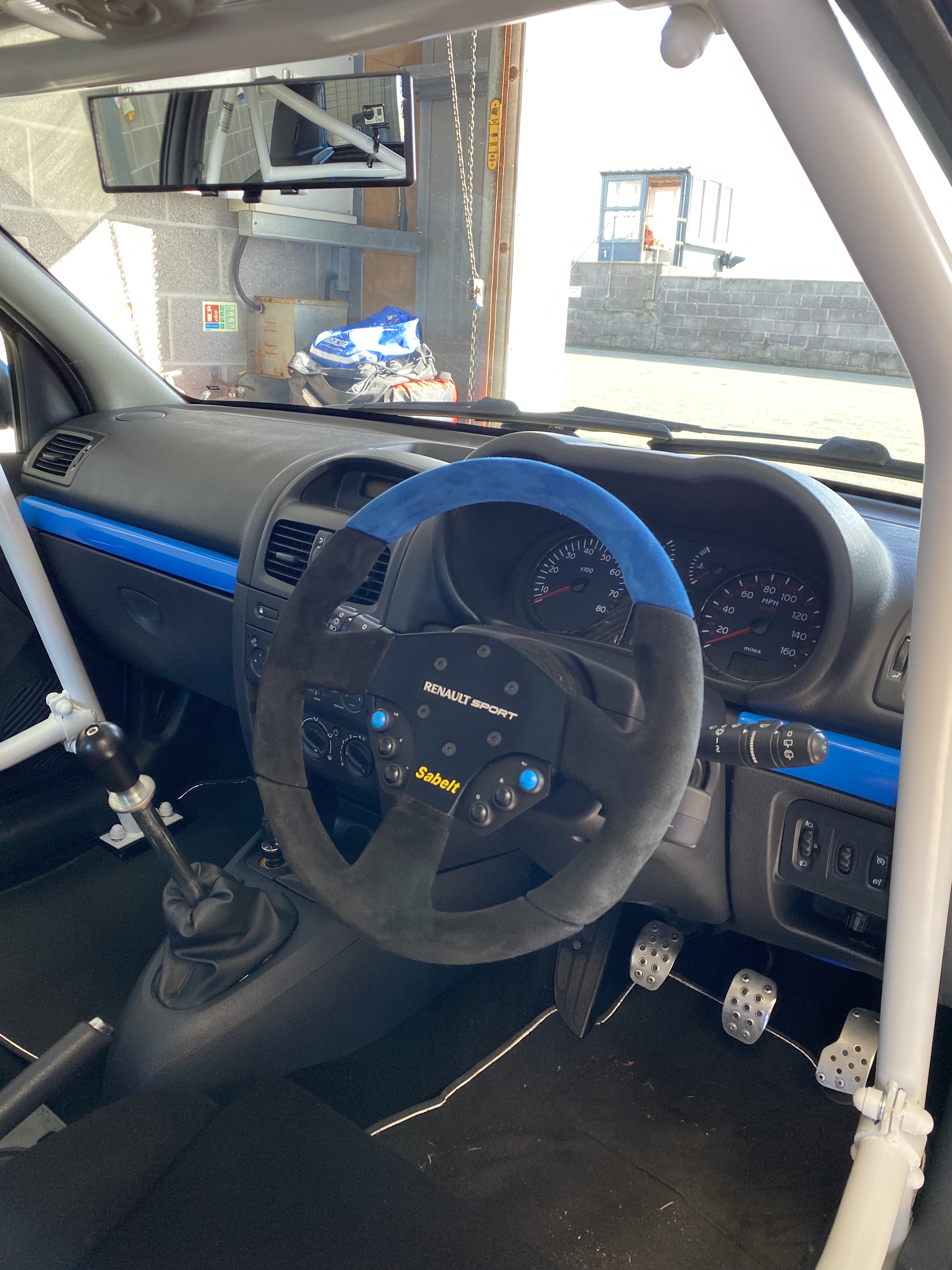

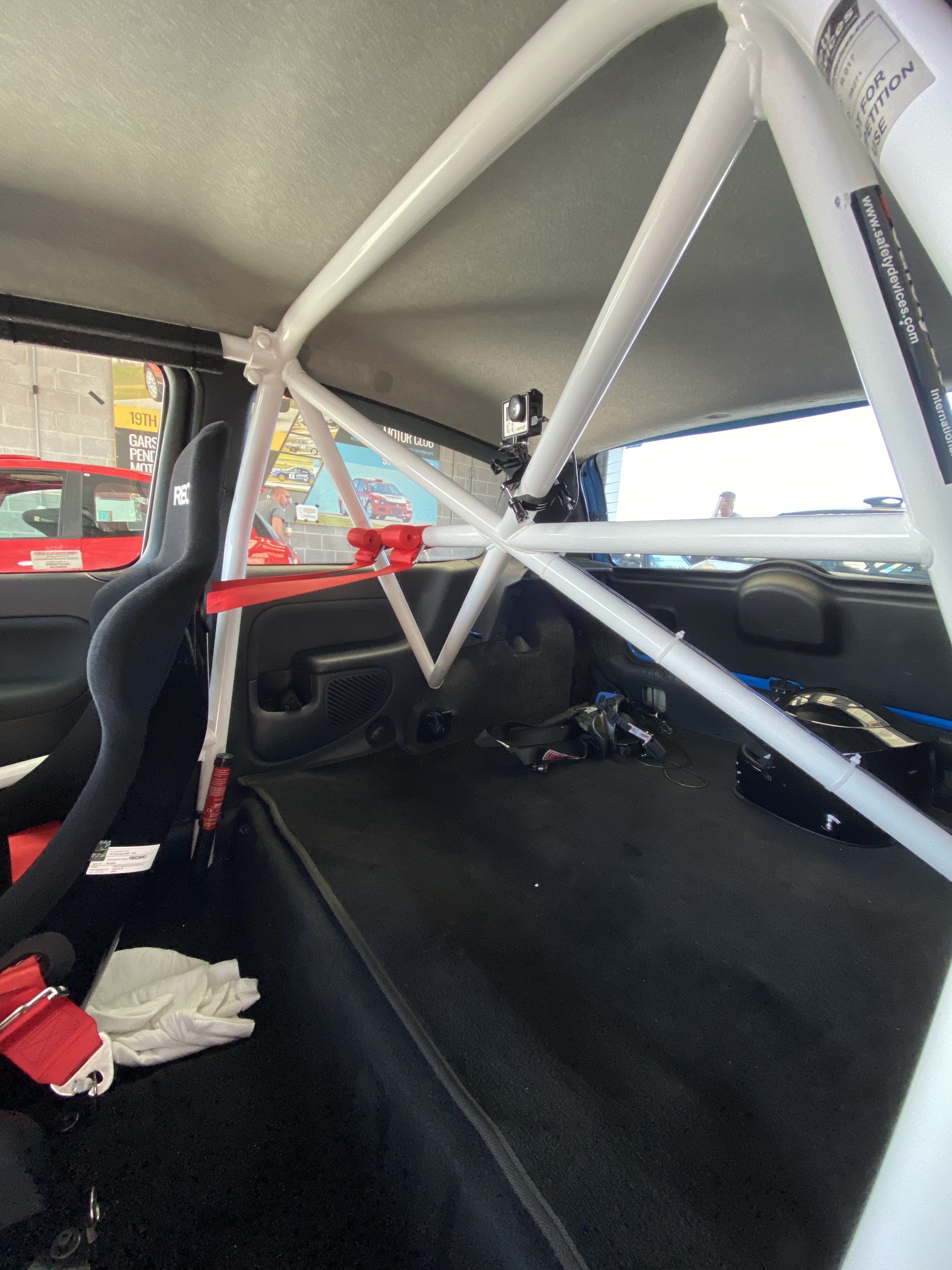

As I'm getting older, I'm also realising you can't put a price on safety. Around 2 years ago I was in the market for a Hans device however after trying on multiple versions I never found any comfortable. I then made the decision to buy the Simpson Hybrid Sport. I can't recommend this product enough, you can hardly tell you are wearing the device and it's so easy to use. I highly recommend if anyone is in the market for such a safety device.
Simpson Hybrid Sport:

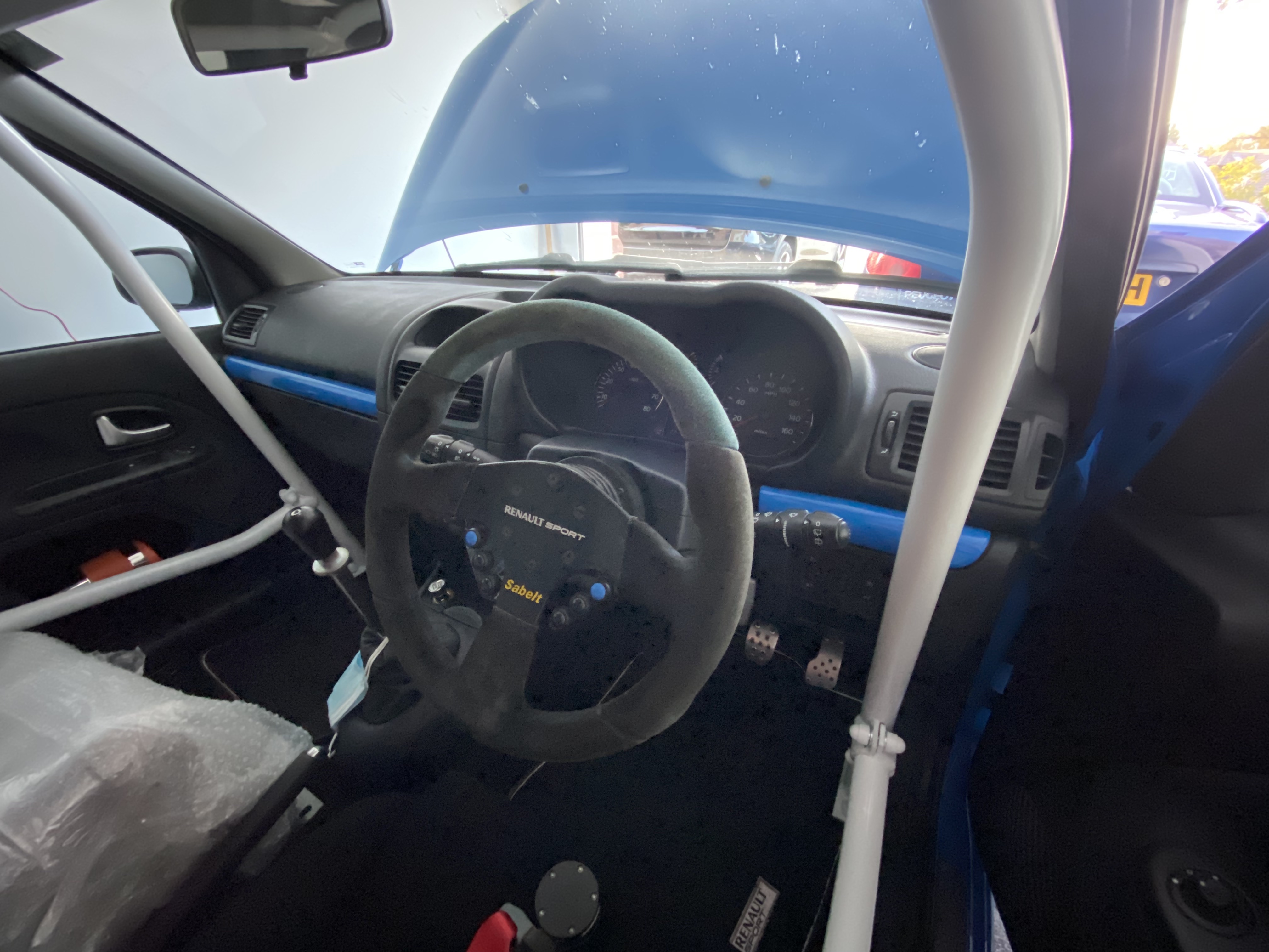

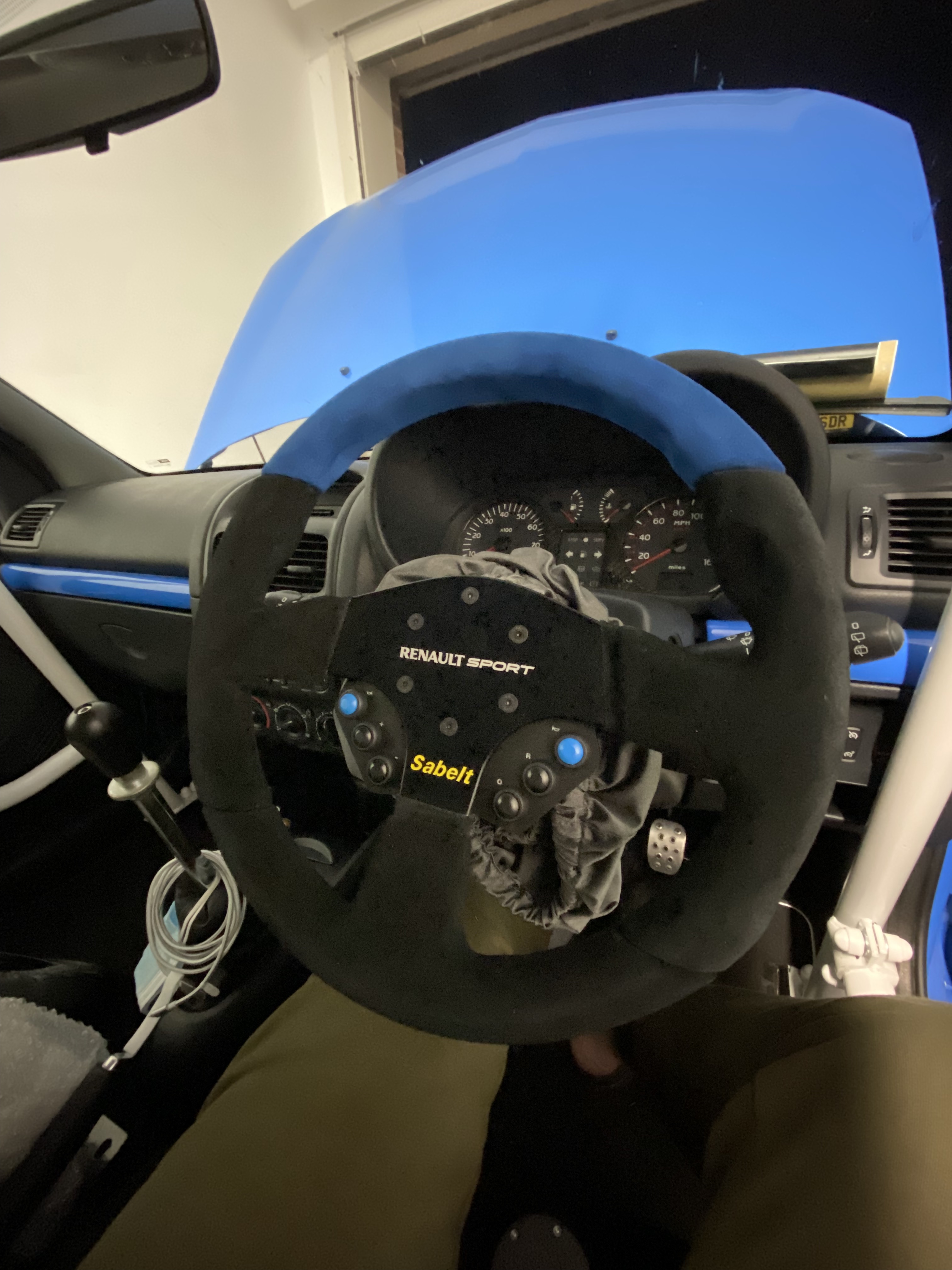

A few months ago I purchased a brand new RenaultSport Sabelt steering wheel as mine was a little dirty, so I set about fitting that while a had a few evening free, at the same time I fitted a brand new oil cap, cleaned and painted the engine mount bolts and fitted a brand new steering wheel cruise control bracket. I'm not really pleased with the interior, IMO its perfect with the only thought being a flocked dash but where do you stop the flocking...
Pics of interior

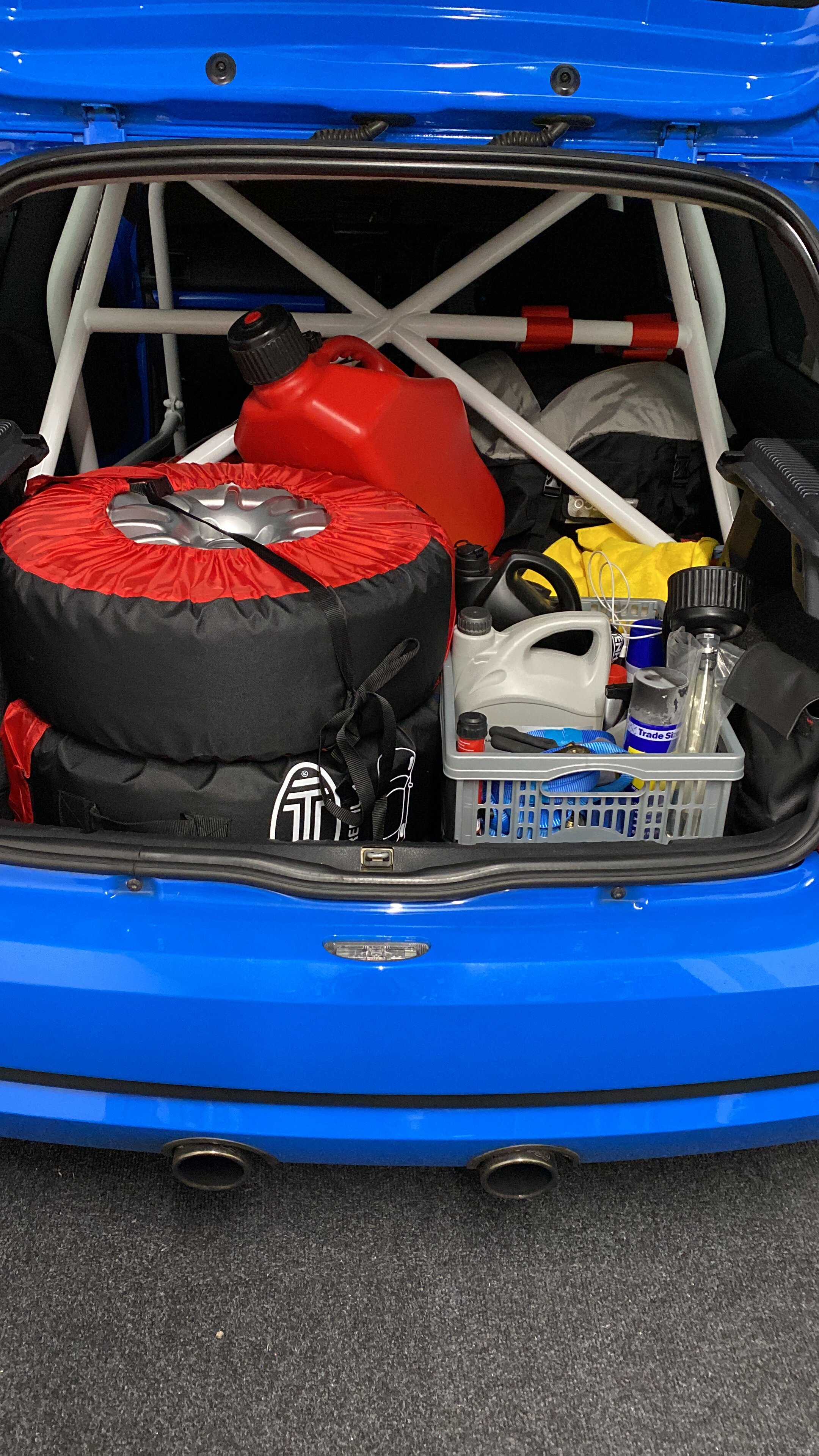

Finally it was time to pack the car ready for my long weekend away, its amazing what you can fit in a Clio! I couldn't also help but give it a quick clean, although it was dark before I started!
Amazing how quickly the exhaust gets covered:
Full, ready to roll:

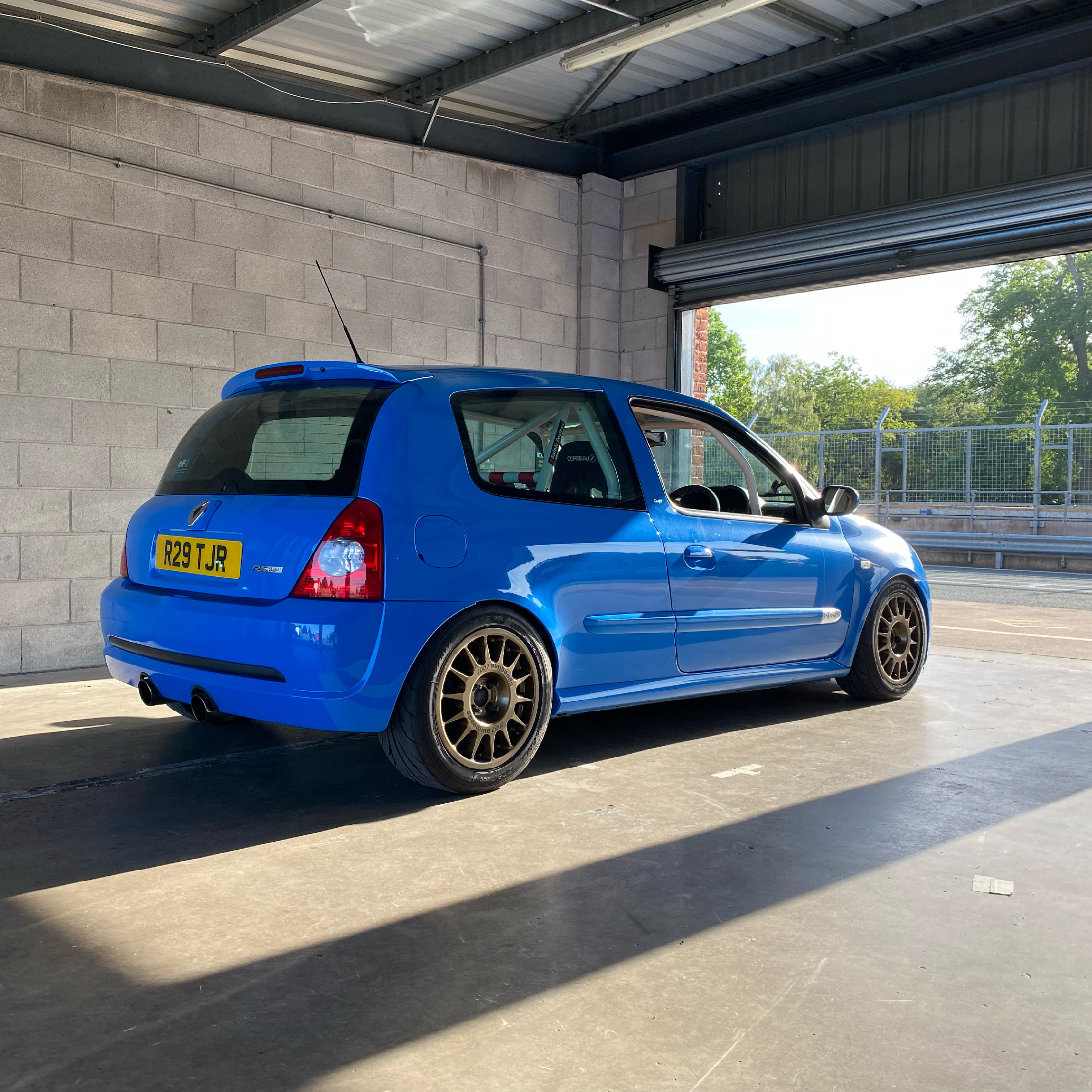

Anglesey Circuit (International & Coastal)

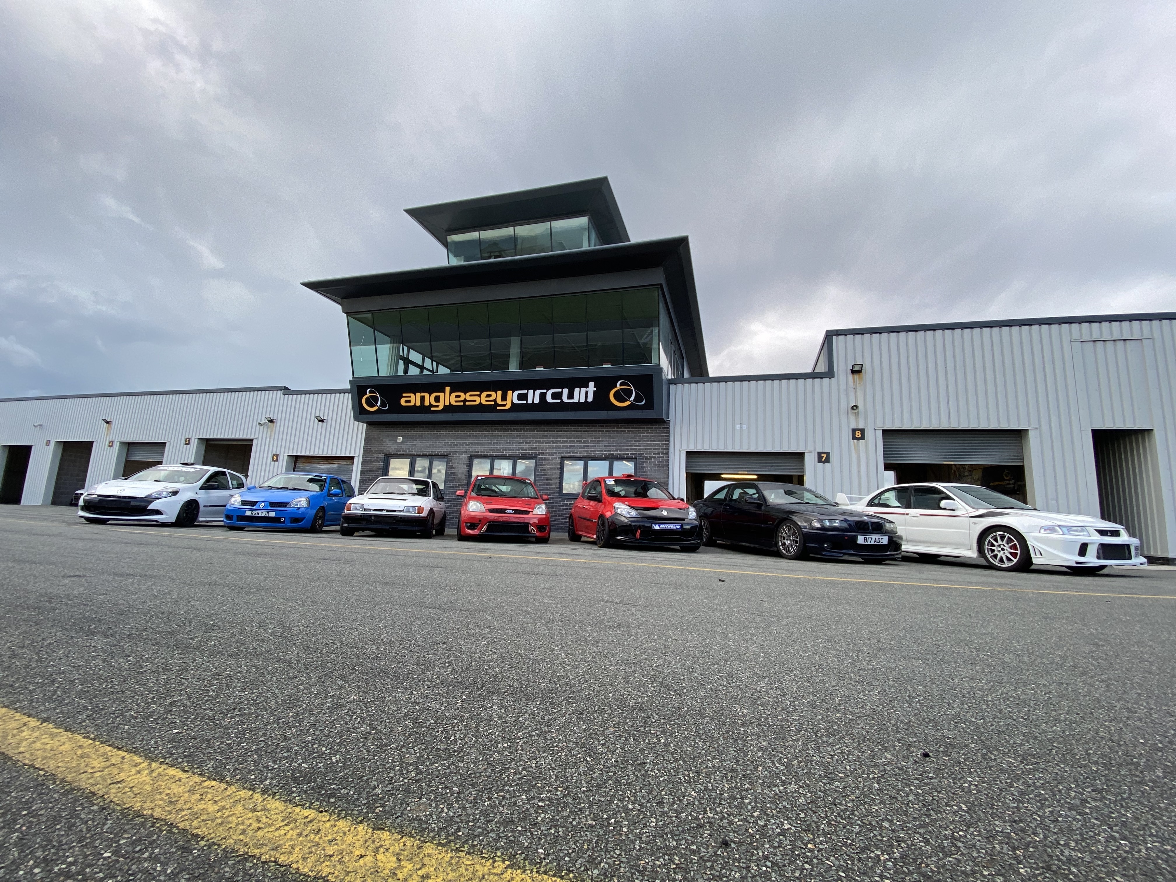

The car was ready for Anglesey and I couldn't wait to get out on track again, I've not been on track as much as I would have liked over the past two years but hopefully 2022 can be back to "normal"! This was my first time at Anglesey. Its a great circuit, although please note it's very harsh on tyres, I basically did a whole set of Interstate tyres during the day.
We left for Wales on Friday 24th September 2021 and those of you with good memories will remember this was the first weekend with fuel shortages, not ideal with such a long journey with a track day at the end, and certainly not ideal when you're driving with a friend with an TME Evo which only gets around 200 miles to a tank and can only run on vPower! Anyway we got there OK, although at one point I did get down to what appeared empty 😱 Luckily when we arrive just after Midnight there was a shell garage open so we both filled up and luckily fuel was ok all weekend.
Parked up:
Seat showing door bar:
The track day was great in the morning we had the International Circuit and after lunch we went to the Coastal layout. Loved both however as I knew I had the long journey home the following day I took it easy from around 2pm and called it a day around 3pm, especially considering we were unsure of the fuel situation on route home.
I used my vBox however not sure If I captured the best times of the day the best I had recorded was:
International: 1:49.32
Coastal: 1:24.11
Unfortunately I didn't get any footage of the day, well I did but I forgot to remove the lens protector which is badly scuffed therefore the footage is awful.
Anyways, pics are always best IMO:
