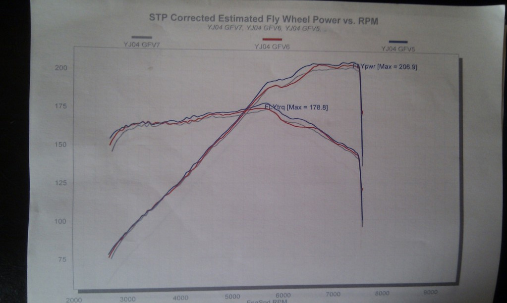

Ive Recently purchased an itb'd 182 which was built / mapped by fred ,tdf and rs tuning and it made a very healthy 207 bhp peak and 179ftlb of torque. The is completely standard apart from the engine work , i sold my old stripped 172 cup but standard engine wise to a friend which is slightly faster 0-60 and miles faster 60-110
The peak power difference assuming it made 172 bhp standard (unlikely) is +35hp but the 182 should have more power across the whole rev range
The weight difference should only be around 150 kg would this make that much difference or could their be a problem with the boddies / map
Any help apprieciated thanks dan

highly possible you have a sensor down or similar, get it checked
  DON'T SEND ME PM'S!!
179lb/ft...........:S
if it's not overbored and high compression, then that's got to be a misquote
  Evo 5 RS
150kg is quite a lot. That said standard stripped cup wouldn't be quicker it might be AS quick if it's a strong'en.. plus with that torque you'd be laughing (if it's accurate)
More to the point though... have you actually seen it make that power yourself? Like Fred says it might be flagging from a sensor or something else

Assuming TDF’s rollers are ok, my ITB’d 172 is pushing out 202bhp and 175lb/ft (with exhaust etc), so doesn’t sound unbelievable.
I thought the numbers were from a Dynodynamics. That explains it tbh. that superflow is a lovely piec of kit, but it's consistently higher than elsewhere.
Best thing to do is see where in the revs the gains are, if the gains are all higher up, then it's not a big surprise that a healthy standard car will keep up, especially on the road.

best bet would be to put it on a different set of rollers or go back to rs tuning if you can get back there , the engine may be dying for all you know have you done a compression check on it , at least then you know if the engine has a fault or a sensor is down somewhere , rs tuning are the people i would be seeing as they have a set of rollers and know clio's like the back of there hands

ill compression test it asap , if that doesnt show any faults ill get it up to TDF , does anyone know if normal EOBD code readers work with the gen90 ? thanks for the help
Your better off performing a leak down test, Compression tests are far from accurate.
