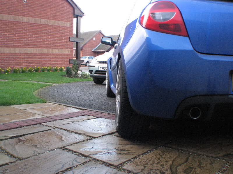

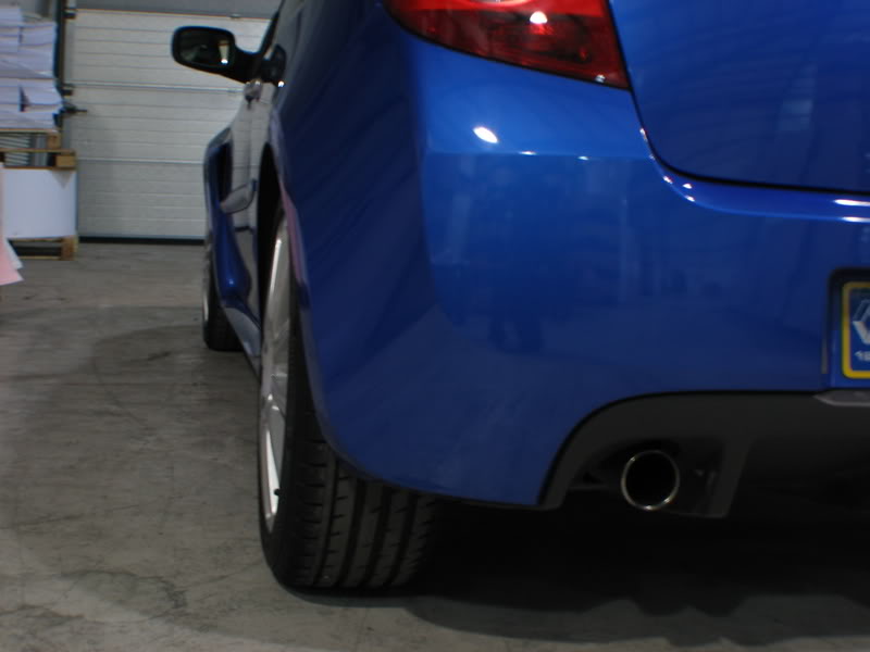

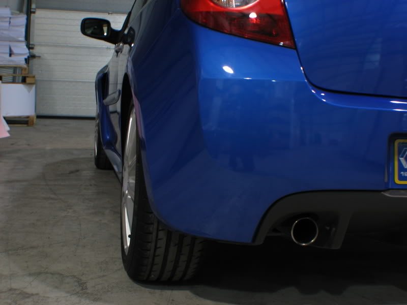

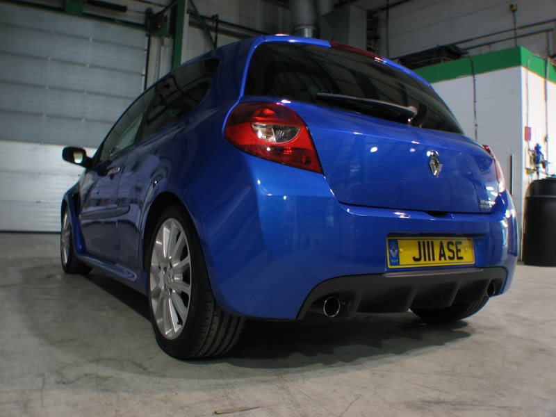

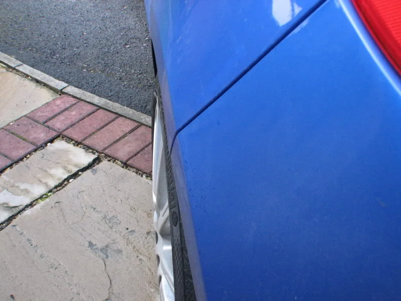

:approve:finally got around to fitting the spacers to fill the arches.
and boy do they fill the arches.
they are light wieght alloy 25mm hubcentric H&R all round(the type that bolt to hub and then wheels bolt to the spacer,eliminates need for longer bolts.)
sorry bout the dirty bum but its rianing here,will give her a wash and wax over weekend and post some more pics.
sorry there are so many(got carried away)
before...

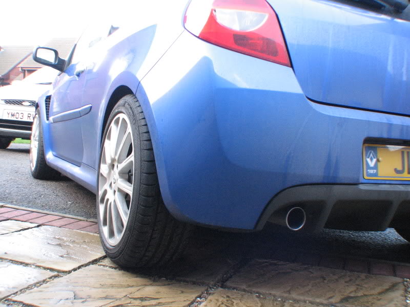

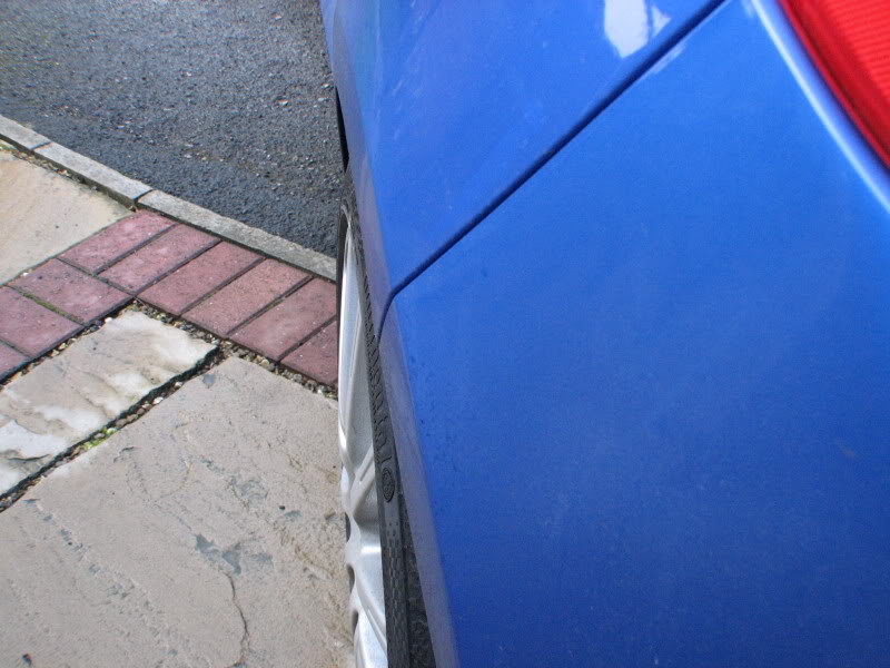

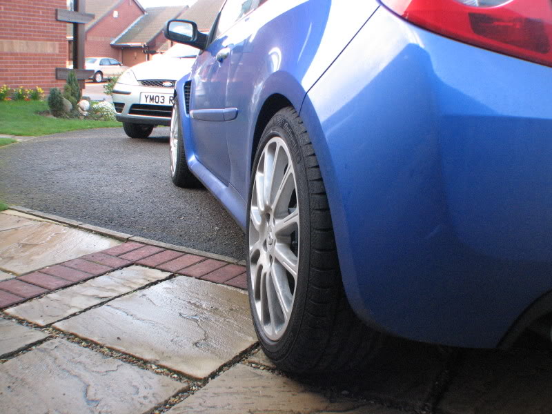

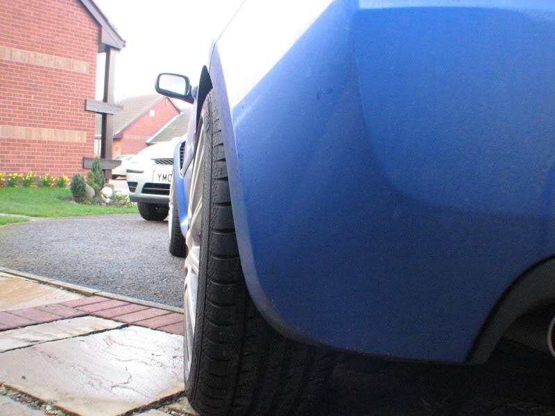

after...

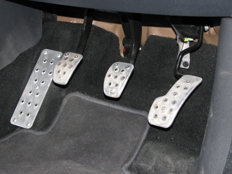

quick one of the meggy foot rest i fitted the other night at work.

Prefer the original look to be honest - looked neater. Looks almost like you've got wheels with the wrong offset, like those dodgy old Corsas you sometimes see.
Do spacers not put far more strain on your wheel bearings?

tbh wouldnt expect to feel any difference but dont know if its my imagination but feels bit more sure footed and less roll due to wider track.

I'd like to see shots from further away, i imagine the stance looks terrific, but i also have reservations about using spacers.

wheels just looked lost from certain angles before.
as for the extra strain.yes they do,.more than standard car but if i was to have changed the wheels for bigger or even heavy ones that would have caused extra stain too.the wheels are light wieght and the spacers are also, so should be ok.(touch wood)

Those spacers are top notch tho rob, interesting mod.
Looks better, i'd be worried about wheel travel.

Looks good although maybe 15mm would of been a nice compramise.
naah!!! all or nothing.:D
plus the 15mm dont bolt to the hub so would need longer bolts and lockers and then there really is a chance of the bolts snapping under strain.(i know of times this has happend)
