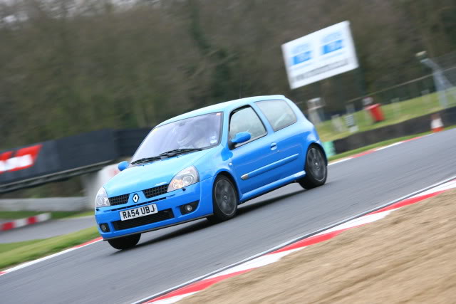

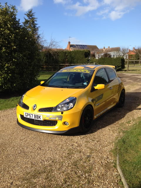

Here is my supercharged R27, had it back since the weekend, its epic!! 260bp and 250 ft/lbs!!! So fast, relentless acceleration!!! Here is some pics of it and my 182.
Leave the comments on the stickers, i had 57876256378172 sheep comments on my last thread. I get the idea but tough lol!!
Mods to date on R27:
KW V3s
Akrapovic evo system
Jamsport inlets
Jamsport supercharger
OZ Ultraleggra's
200 diffuser with akra tips
888's
Full RS body kit
Gotech ECU

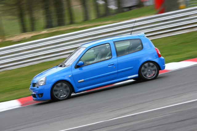

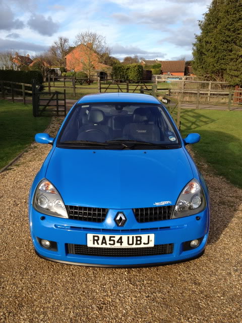

Mods on 182:
Whiteline rear ARB
Eibach proline springs (20mm front, 15mm rear)
Eibach front camberbolts
Powerflow backbox with jamsport decat
Knuckles

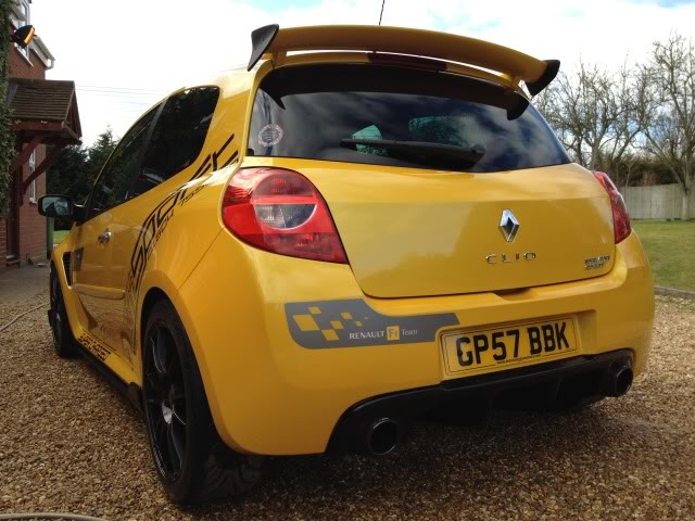

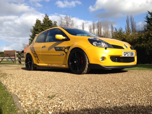

When/if you get rid of the stickers, you should get the bullets smoothed, sprayed ly with 'super charged' in black renaultsport writing... So much more subtle.

I prob will get rid of the stickers when it gets machine polished. Erm..it didnt cost me much lol

Lol its quite hard to keep it stealthy in ly ;) But i no what your saying, they will come off when its detailed with a machine polisher. They went on at trax last year just for the show, but i liked them so left them. At least they go with the colour scheme, and this is my toy after all so not fussed about the attention it gets. They look better in the flesh i have to say.

I would also love your 2 cars but hate the stickers. Otherwise wow. Writing supercharged on the car? Why? :(

Why? Dude i explained it in a post lol?!
Jam-sport have supercharged it. Your either blind or takin the pi55. ;)

I actually rather like the stickers, give it a cool motorsport feel and lets face it, it's got the power to back it up. :)
