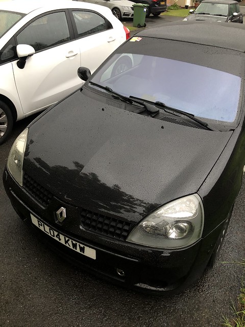

  • Rear wiper deleted
  • Passenger door replaced
  • Rear seats removed, tailored boot mat in
  • Recaro Pole Positions (Recaro side mounts, Recaro sliders, Jon Fozz X-Low subframes)
  • OS headlight replaced
  • PAS high pressure pipe replaced
  • Gearbox nylon bush replaced
  • Renaultsport Sparco wheel (and Momo boss) added
  • Volantech Horn/Cruise bracket added
  • PBS brake pads all round, new front disks
  • Genuine washer blanks added

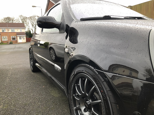

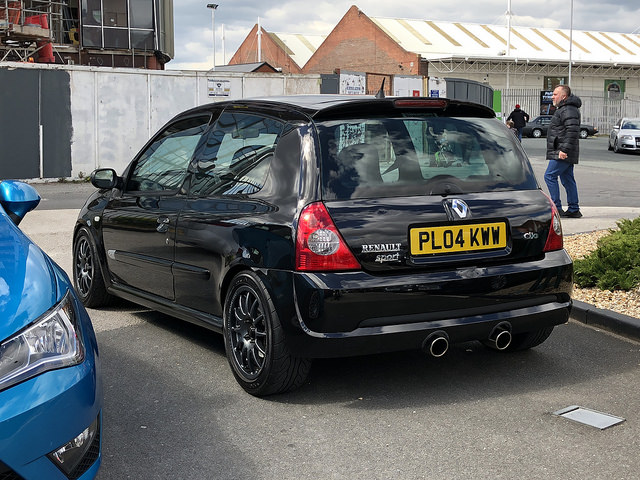

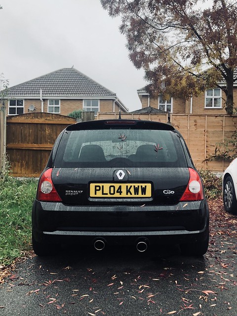

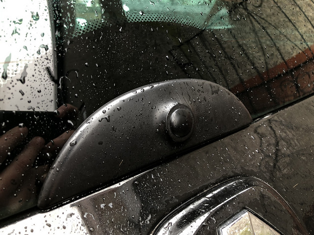

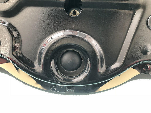

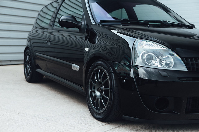

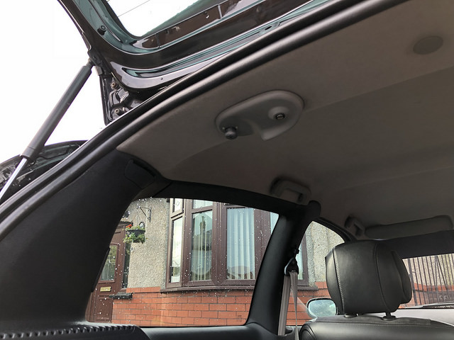

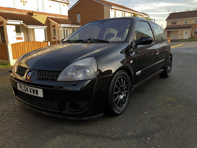

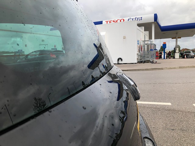

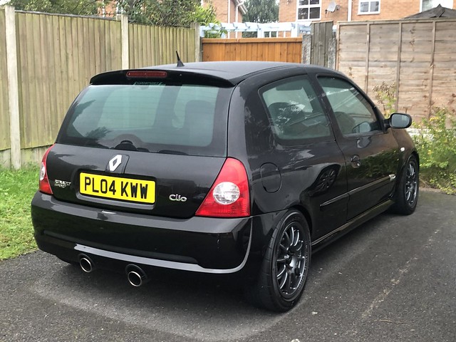

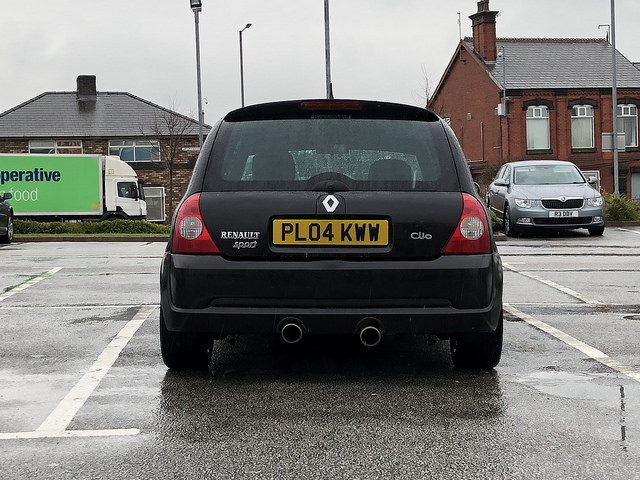

So, really simple and basic one, deleted the rear wiper. Makes the rear end look so much tidier. Thought I would miss it, but I haven't so far. Just a simple bung from eBay into the existing trim, and then a bigger one from Halfords for the inside so it's completely watertight.
BG 182 by Niall97, on Flickr

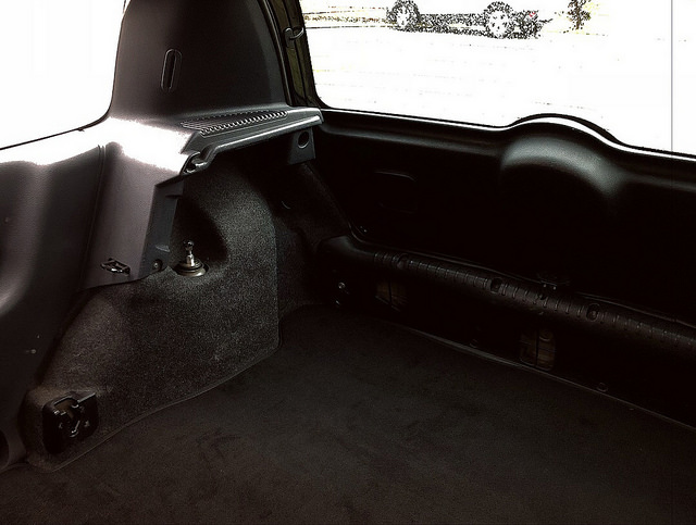

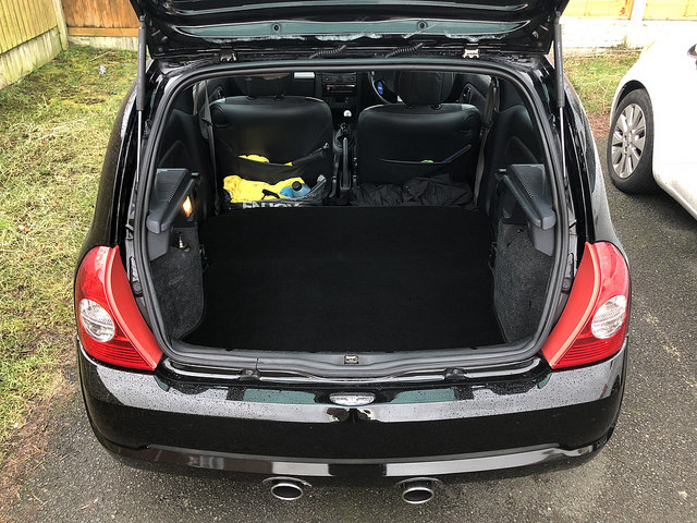

Next up the rear seats were taken out, as well as seatbelt etc, and a nice tailored velour boot mat put in place of them. Again, looks so much neater and tidier. I knew I'd be soon getting some fixed buckets, which would render the rear seats useless. I never did like having people in the back anyway.

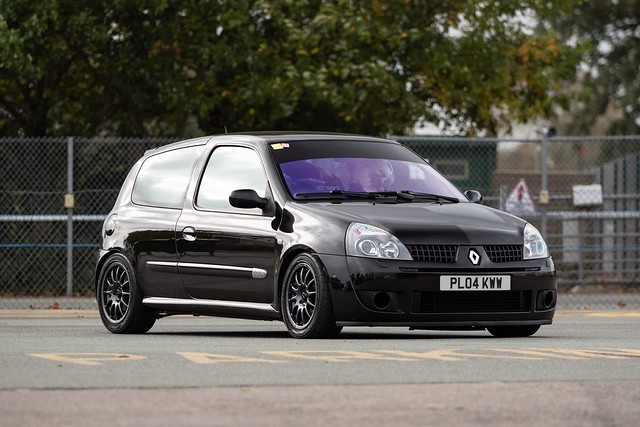

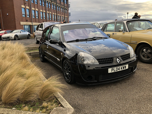

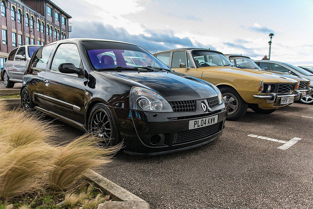

This was how the car was looking, January this year before and then at Cars & Coffee Liverpool.

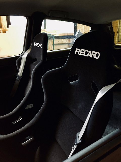

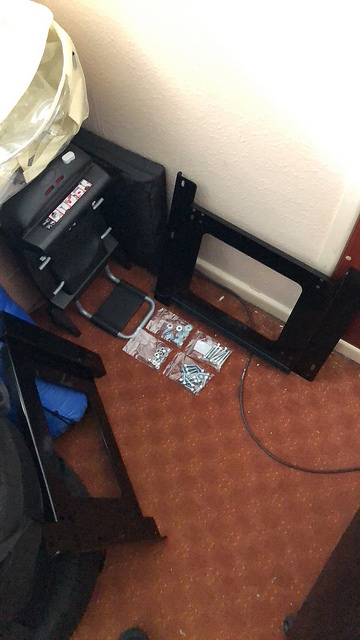

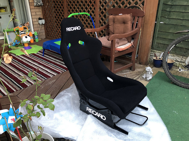

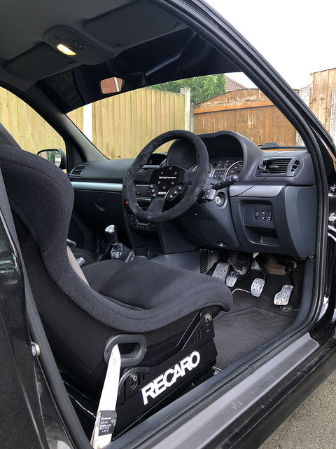

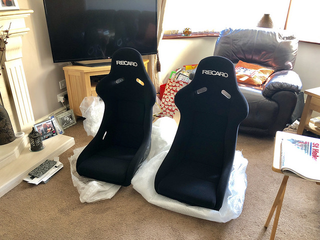

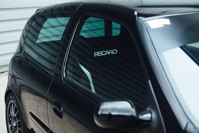

I went away with work after that for 2 1/2 months, and when I came back I ordered a big present for myself, something I'd wanted for for the car from the beginning but of course it's quite a big outlay - Recaro Pole Positions. The standard driving position had always been a big problem, just ruined what is a great car to drive, so some low buckets were the plan. I'd toyed with the idea of Corbeau Clubsports being quite popular, but Pole Positions have always been a favourite seat of mine, the Recaro brand being an OEM supplier (for Renaultsport of course too), and quality products in general are something I like to stick to, as well as the comfort that Pole Positions are renowned for made them the obvious choice for the Clubsport spec I'm going for.

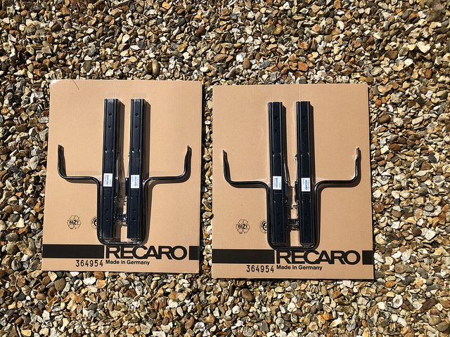

Recaro double locking FIA approved sliders to go with them.
Jon Fozz X-Low subframes, to definitely solve the high driving position.

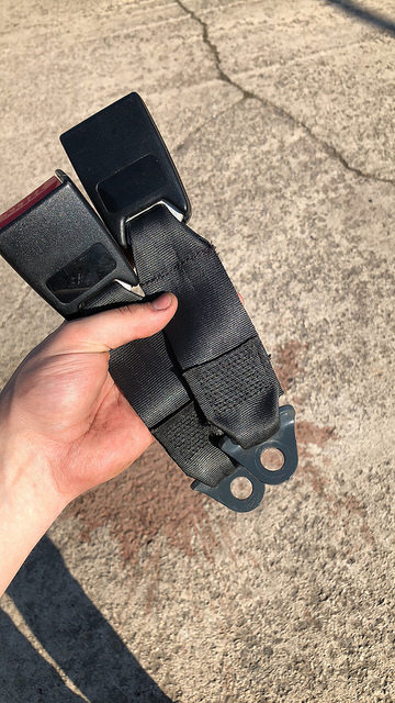

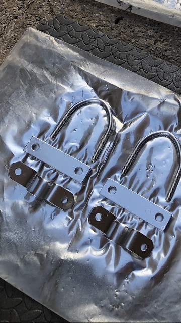

And some rope belt buckles, taken from a Peugeot 206 no less, for the standard belts until I get some harnesses and a cage to mount them to.

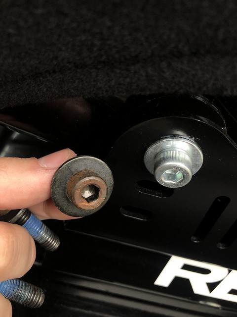

Nipped round to @JamesBryan's to assemble and fit them, one of one assembled. Ooft.

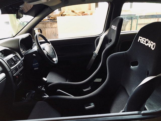

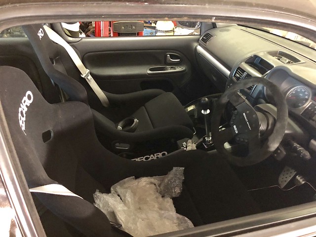

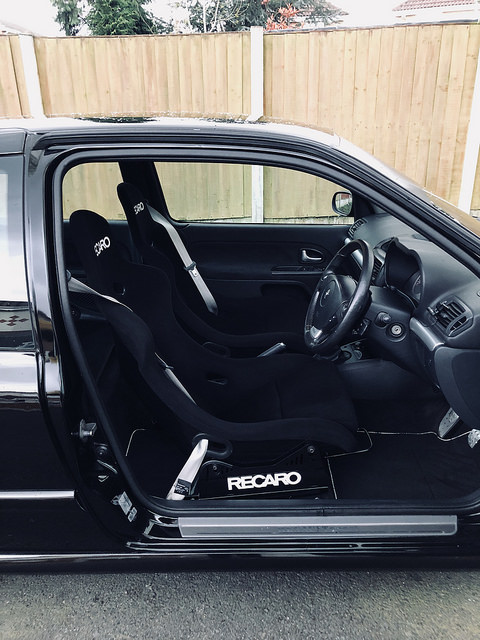

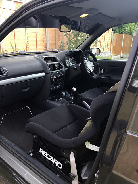

And finally in the car. Very happy with how these look in the car, as well as the driving position and support just being next level coming from the park bench standard seats.

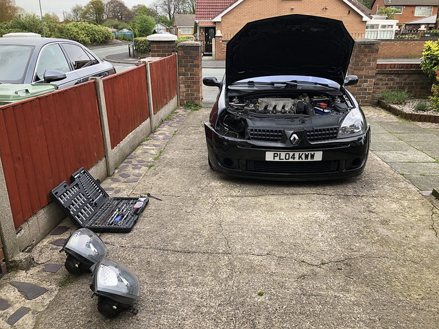

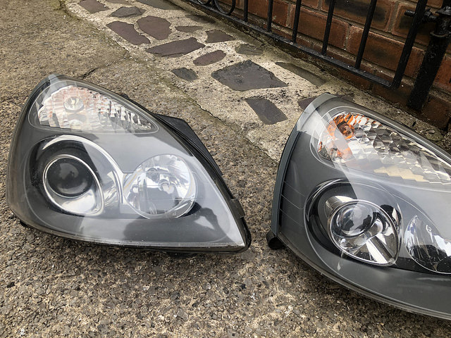

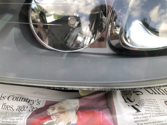

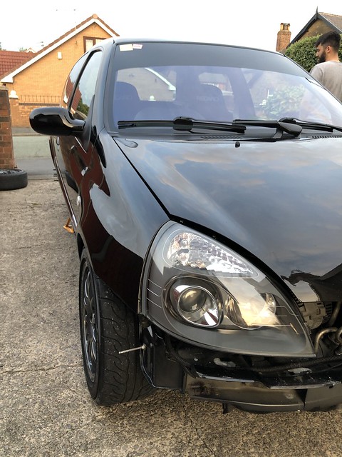

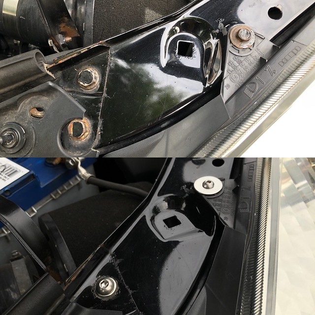

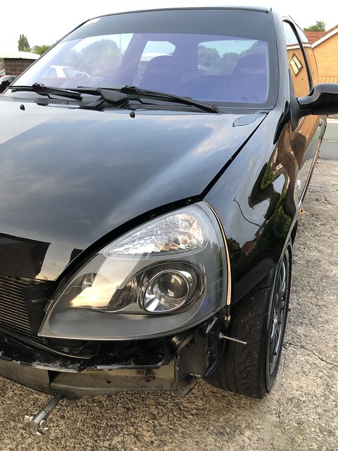

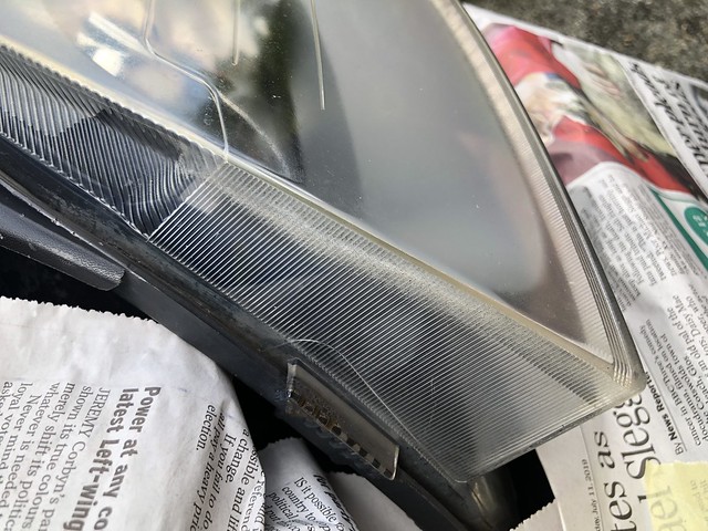

Next job was replacing the OS headlight. The adjusters had broken in mine, as well as having some dirt on the inside making it look slightly murkier than perfect. I'd bought @JB21's old ones from his 182 the month before, and the driver's one was perfect, so on that went. You can see the extra clarity of the new one on the right of the photo below, subtle, but annoyed me. Plus the adjusters were all good so no more headlight pointing at the ground.

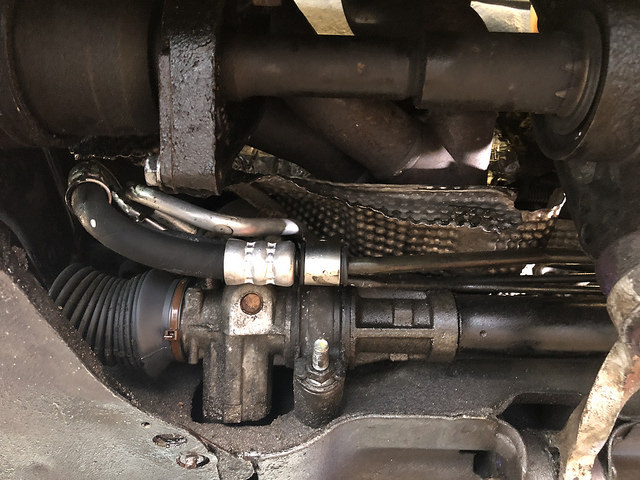

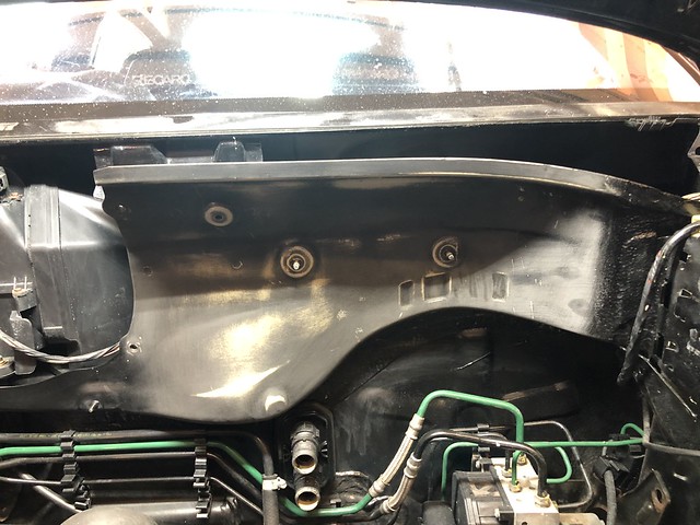

Something else that had been a problem with this car from the start was a PAS leak from the high pressure pipe, it's quite costly to replace and initially it wasn't too bad so I'd put it off for quite a while, but the problem worsened to the point where it would leave a big line on the ground when manoeuvring, and I also planned to do a few trackdays over summer, so it needed to be sorted before track for sure. I'd toyed with the idea of EPAS, but I played it safe and decided to stay hydraulic to retain the nice steering feel and self centring. Gary at Gary Burnett Vehicle Services in Warrington sorted the new pipe and fitted, one again awesome service from Gary and at a very reasonable price considering the job involved.

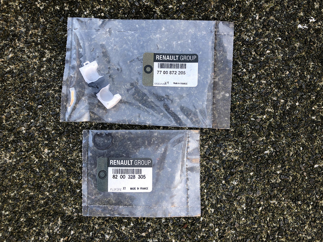

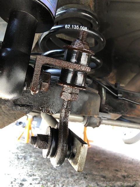

Another quick job to do was changing the nylon bush for the selector, I'd had this new bush lying around for a while, and planned and still do plan on getting a PMS shifter soon, so I never bothered fitting. But boredom one day meant I thought I'd tackle it just as a temporary improvement. Wasn't a bad job on the whole, hardest part was smashing the old bush to pieces to get it out since it didn't want to just pull out. The new one slid right in, and of course I made sure the circlip was firmly in the groove to avoid any headaches with that popping out.

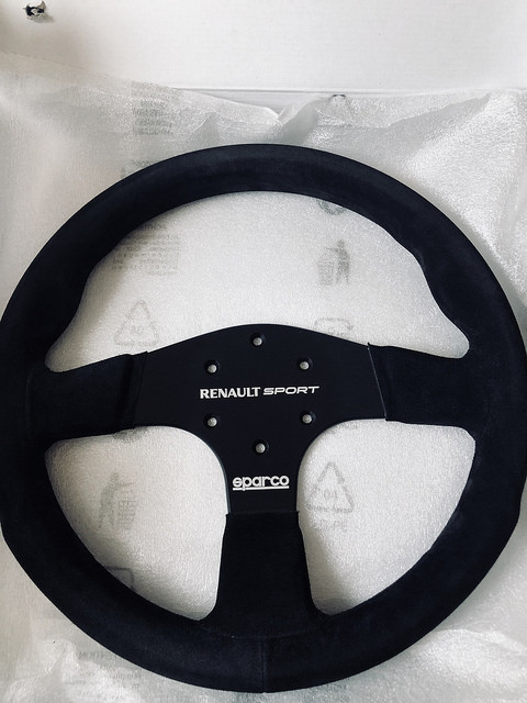

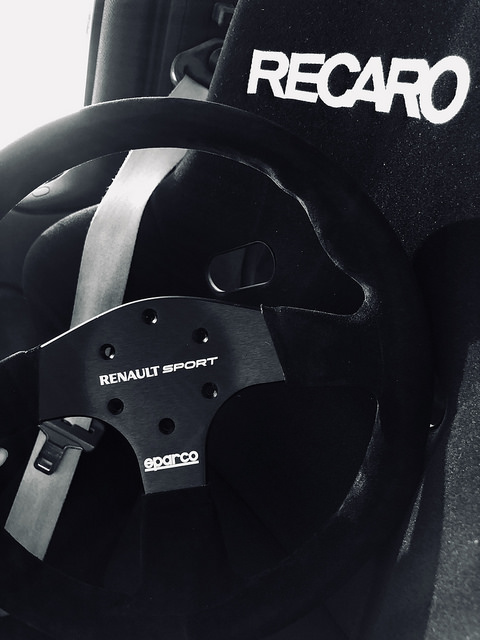

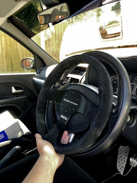

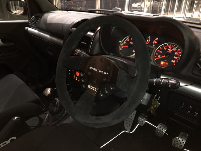

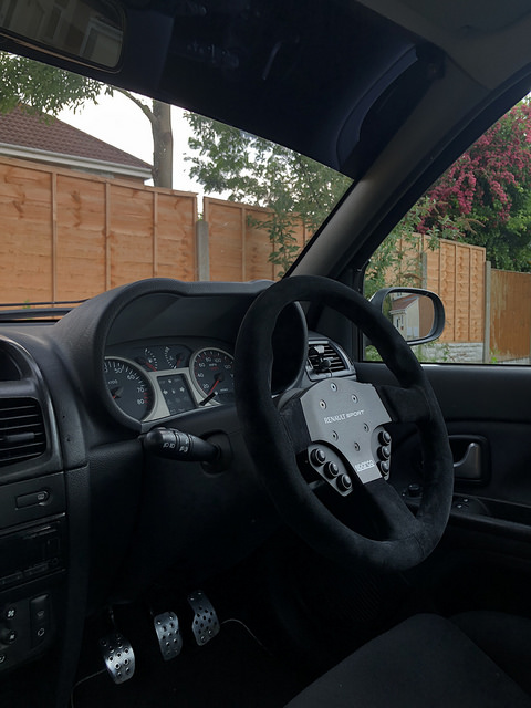

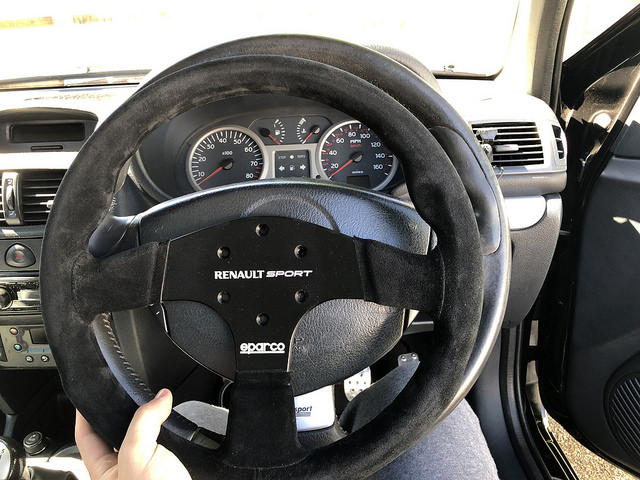

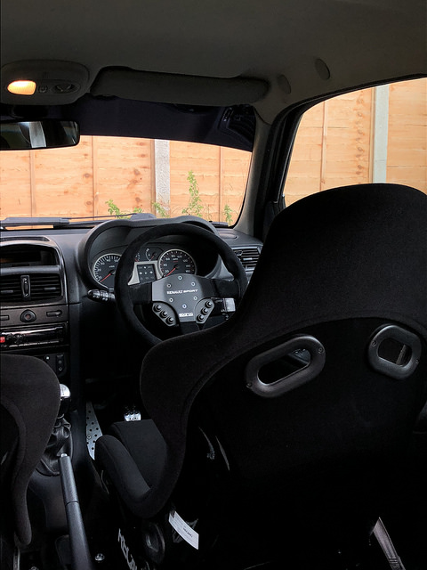

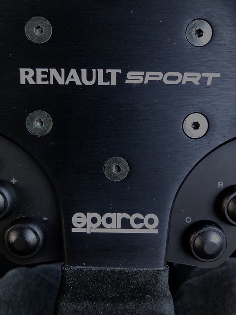

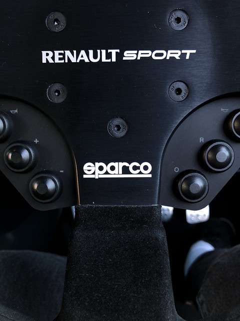

Next thing was another big ergonomic improvement to the car along side the seats, a smaller wheel. It's well known that the other big problem with these cars along with the driving position is the massive bus wheel they have as standard. So to replace it, the Renaultsport Sparco wheel. Like the seats, expensive, but just proper, so not one to do things by halves I had to have one. Complements the seats so well too, look like they were designed for each other.
Next to the standard wheel showing just how much smaller it is.
The wheel was mounted on a Momo boss, another just quality product with the self cancelling indicators being retained and the hole for the Horn/Cruise wiring. As well as this I bought one of the Volantech Horn/Cruise brackets, very popular for a reason. So good to be able to retain cruise and horn so neatly with this, especially since this wheel doesn't allow for a centre horn push. Again just complements the wheel and rest of the car so well too. Kept it simple with the satin black to match the other satin elements of the car like the sunstrip and plastics (OCD much).
Everything looking very nice together in the interior now.

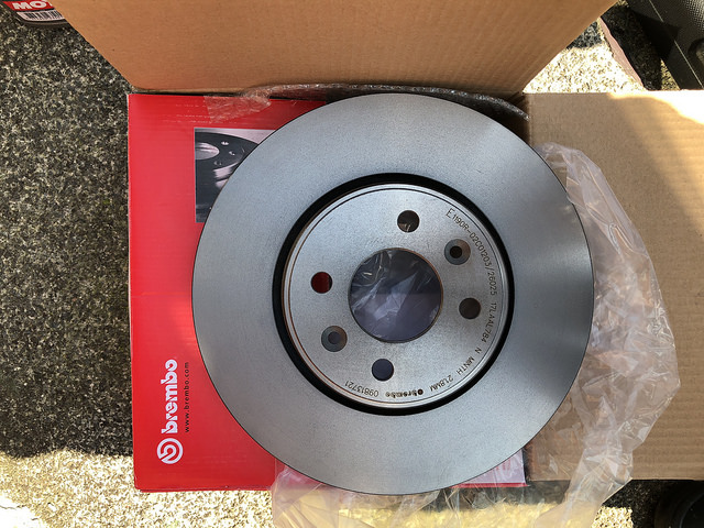

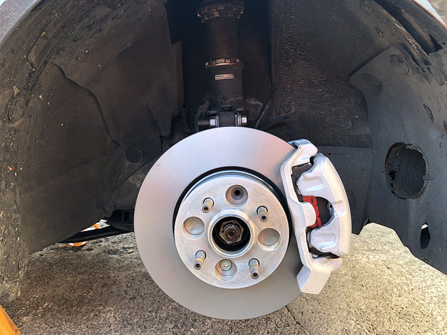

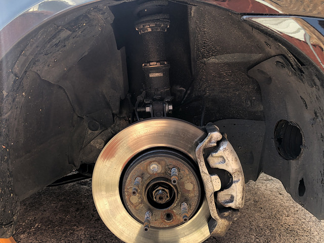

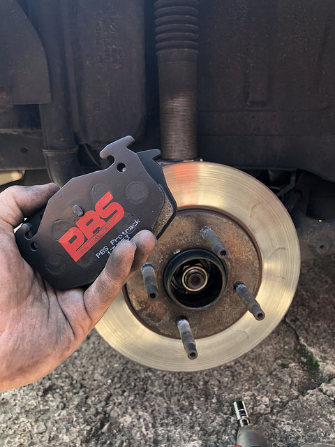

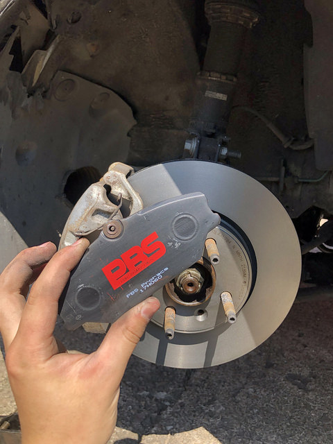

Next up was a brake refresh ahead of track. The DS2500s in the front had seen a year of abuse on road and track, had lost their effect really, and of course the disks were looking a little tired and a few heat stress marks/cracks showing, and of course it's just good practise to use new disks with new pads to avoid contamination anyway.
Before.
New Disks, from @George@RTR_Parts of course!
New PBS Pads all round.

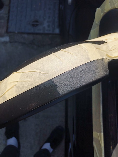

Little lick of paint while I was at it.

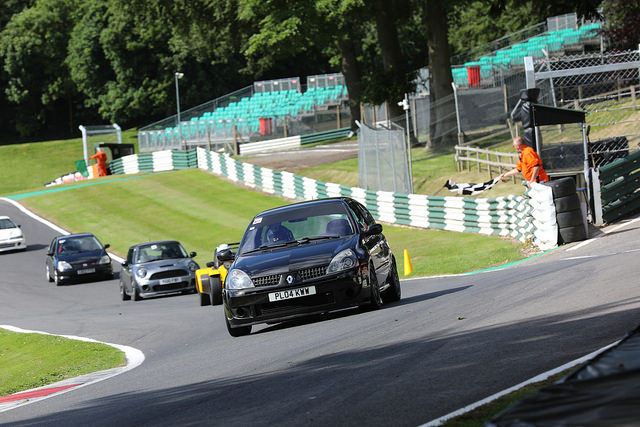

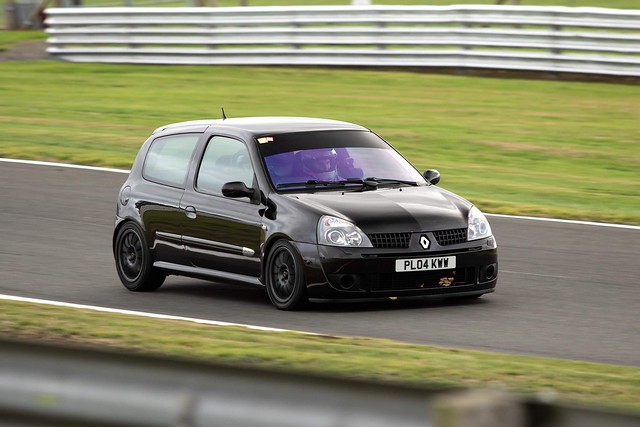

Finally the first track outing of the year, and a new track I've not tried before despite having been many times, Cadwell Park. Quite a drive from me which has stopped me going in the past, but it's got such a good reputation I had to give it a try, so booked on the Track Evening on 7th June.
Spent a lot of the earlier time learning the limits, but got some good pace up by the end. A quick clip from a lap towards the end.

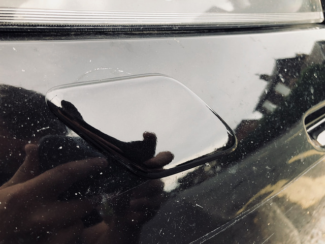

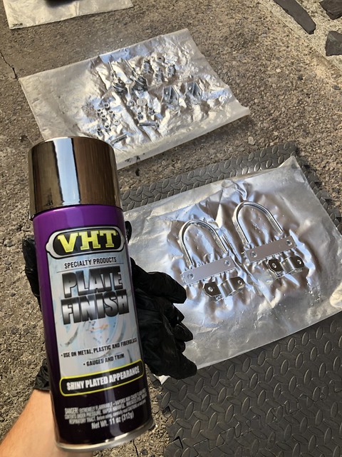

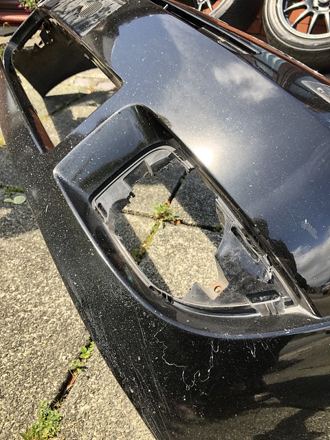

Bought another little thing to tidy the car up, some washer blanks. I'd always thought the standard washer jet stalks to be ugly and cheap looking, so I finally got hold of some nice OEM blanks from a 172 Cup.
Had them sprayed in BG, looking pretty seamless and OEM. Little things are quite satisfying sometimes.

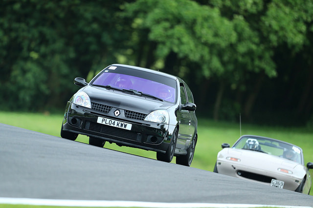

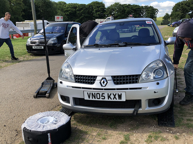

Wasting no time, I'd booked on another day at Cadwell on 21st June since I'd loved the track evening earlier in the month so much. All fuelled up ready for the long drive in the morning.
Arrived, with @JamesBryan too.
Some pics from track.

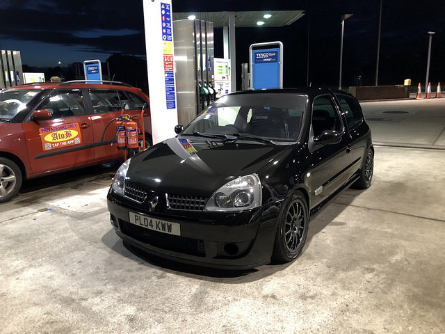

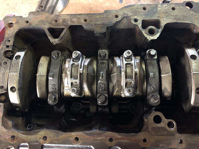

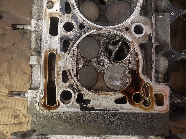

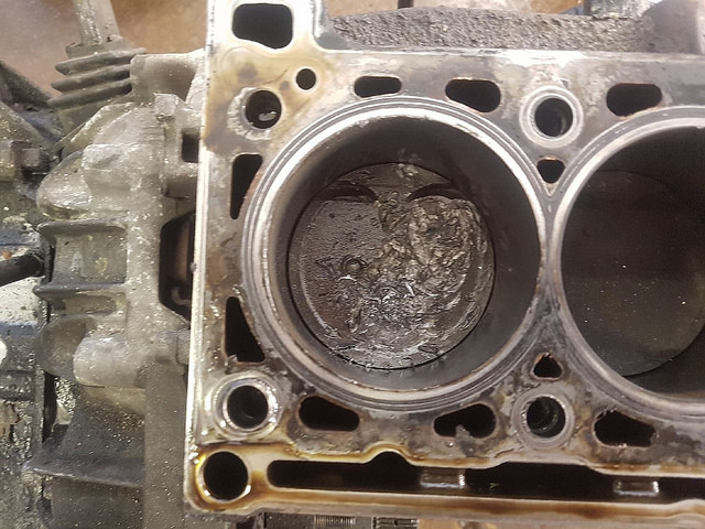

Went out for another session after this, was at the top of third just before getting on the brakes for the chicane before the mountain, and disaster...misfiring and a loss of power constantly until it died...dropped a valve. Bugger.
Dived into the pit lane straight away and made it half way up the hill before stopping and having to roll back onto the grass. Then was recovered to the entrance of the circuit.

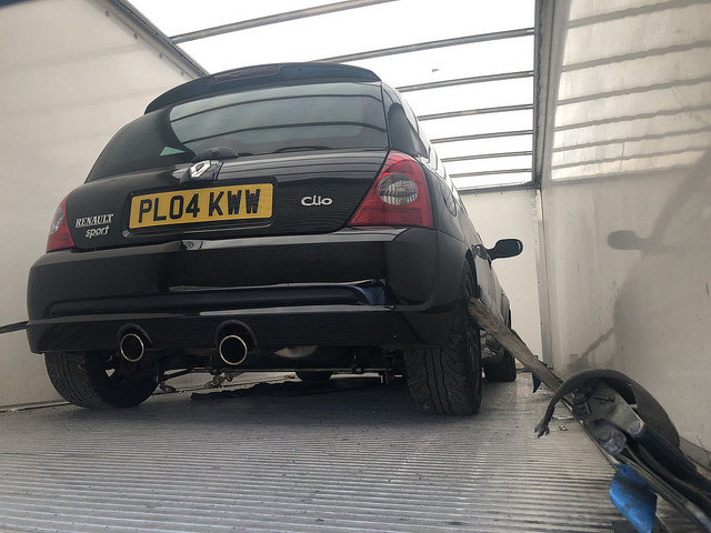

AA truck home for 5 hours, not the perfect end to the day, especially after only half an hour of track time ? At least I didn't have to pay a huge recovery bill having an AA membership anyway, being the only saving grace. Of course it had to happen on the furthest trackday I've done from home.
Looking sorry for itself in the second truck of the ride home because of the distance meaning a changeover was needed.

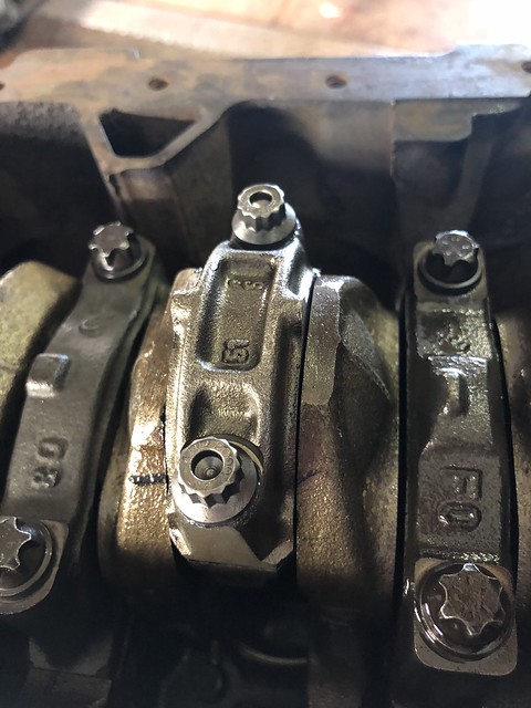

Aaaand the damage.
Lol.
https://www.youtube.com/watch?v=KmPnjLub2pU

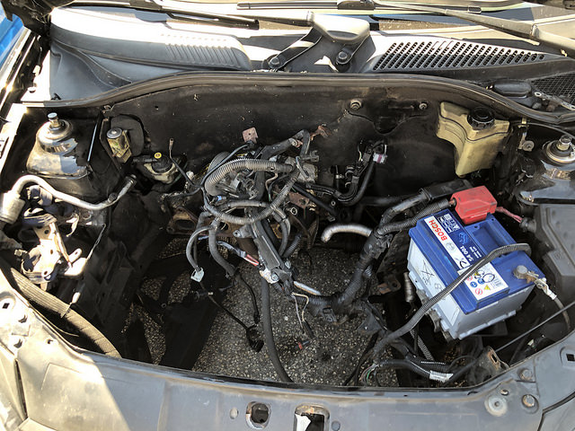

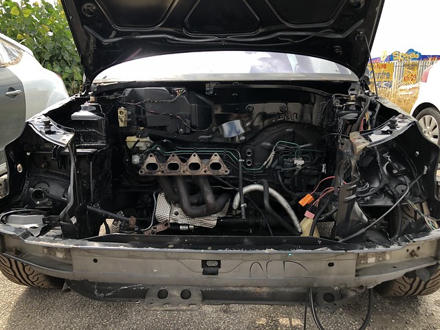

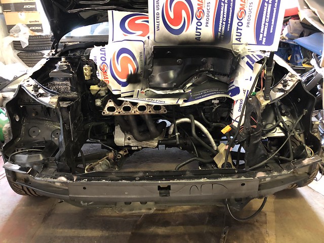

The plan then, a new block and head is being sourced, and it's going to house some nice bits. I figured since it was going to be an expensive time anyway, why not do some upgrades while I'm there and make a positive from the situation, so I'm looking forward to getting the car back rather than get the same car as it was back but with a big hole in my wallet. Since the engine is out it gives me the opportunity to really tidy up the bay which it was in real need of, and of course do a few bits I wouldn't otherwise have done.

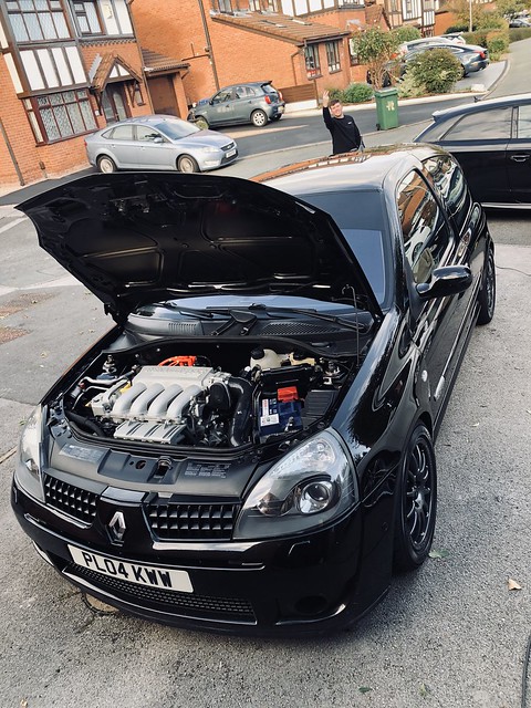

Currently looks like this...
Planned spec/bits to do are: 197 cams (with special timing as usual), 197 pistons, 197 injectors, Supertech valves (hopefully to avoid a future failure), ARP rod bolts (again to avoid any future failures), matched inlets, EFI remap, Megane 225 crank pulley, modified oil pickup, block honed/crank polished etc (not fully read up on everything that's been suggested), engine bay cleaned and stripped of unnecessary bits, engine and box completely painted, all other brackets/visible parts painted, new header tank, silicone hoses.
I'll be going for an OEM finish with everything in the bay, then black silicone hoses. Should be very tidy. Power wise I'm hoping for 200, maybe a little bit more who knows. One with a rebuilt engine and 197 cams made 199.3 at EFI the other week, so mine with the higher compression 197 pistons etc may make slightly more, who knows. Wouldn't be gutted if not anyway, will still be a lot better to drive with a slightly power and torque increase, should be amazing with the bit of extra punch but keeping OEM reliability and character. Quite cool how it's using OEM parts too.
Absolutely can't wait to get it all done and back, will take the car to a new level that I wouldn't have done probably had I not been forced into the situation, so it's created a big positive from a s**t situation. Shame I can't get the money back from the wasted trackday, mind. Hopefully should be done and back on the road by the end of this month or beginning of next.

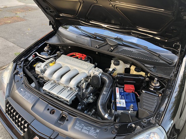

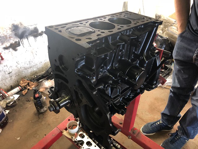

As I'm sure I've mentioned above, the plan with the new engine was to retain all of the things like standard inlet, throttle body, AC, PAS, to retain cruise control and creature comforts and just turn things up a bit over the standard car. I wanted it to be reliable and solid, and just be trackday and abuse proof. I think the end result is really cool, a 197/182 hybrid with some aftermarket parts and little modifications removing all of the faults or weaknesses with the standard engine.
So, the new engine: 197 Cams, 197 Pistons, Magneti Marelli IWP043 330cc injectors, matched inlets, headwork, Supertech valves, ARP rod bolts, woodruff key in crank pulley, oil pump mod, block honed, all new bearings, crank polished and balanced, 3 prong spark plugs, new genuine coil pack, new belt kit, new water pump, Magnecor red leads, MTC silicone coolant hoses, new Expansion tank, everything painted in fresh cast aluminium finish and satin black paint, and some 197 black rocker cover and inlet bolts as a nod to the 197 hybrid spec.

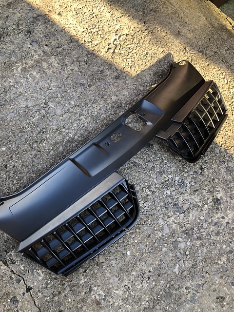

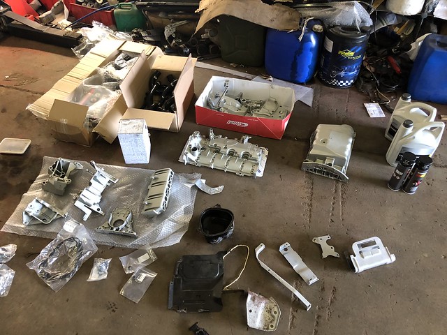

Other tidy up bits include: painting back wall of the engine bay, painting ECU cover with non-snapped bracket, painting other brackets, painting battery tray, painting gearbox and end cover, new fuse box with clips in tact, all new silver jubilee clips, painting front bumper grilles.

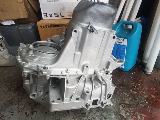

Also, a new gearbox, @JamesBryan's old one. I'd had this for a while with plans to rebuild it when the time came for an LSD, but decided to put this in as-is while I had the opportunity because mine was whining and crunching so badly I doubted it would survive another trackday.
Build done by @bloke, as was the idea for this hybrid spec beyond just 197 Cams. Credit to Carl's knowledge and expertise that all of this worked perfectly since at the time of this build this was the first car of this specific spec. And the engine has been faultless for 13,000 miles since completion!

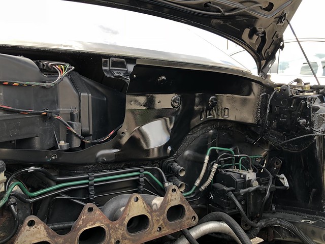

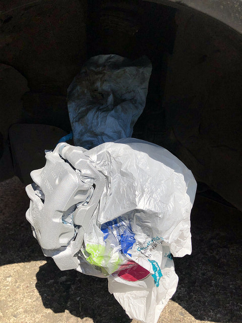

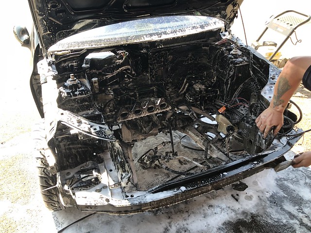

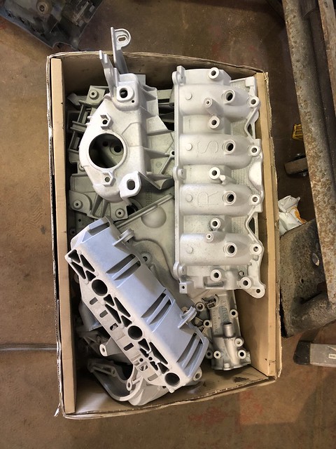

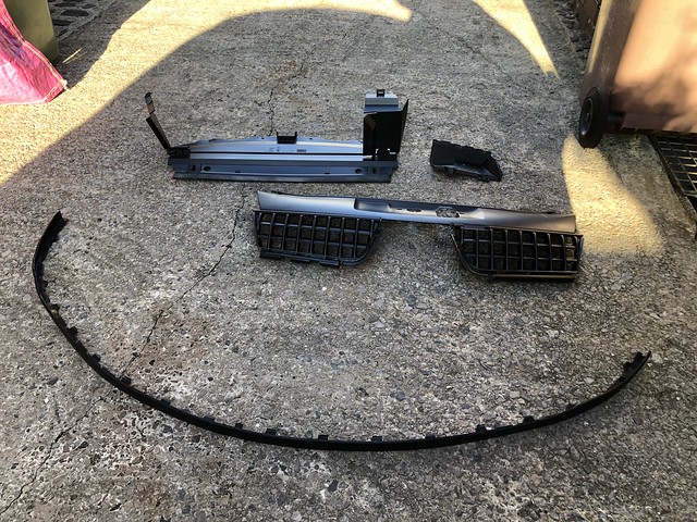

To begin with, Engine bay was given a thorough clean and then the back wall of the engine bay, which is usually hidden by sound deadening, was given a coat of Black Gold paint, it's a satin non-clear coated finish from factory, so this glossy finish should be a nice touch since I'm leaving this exposed!

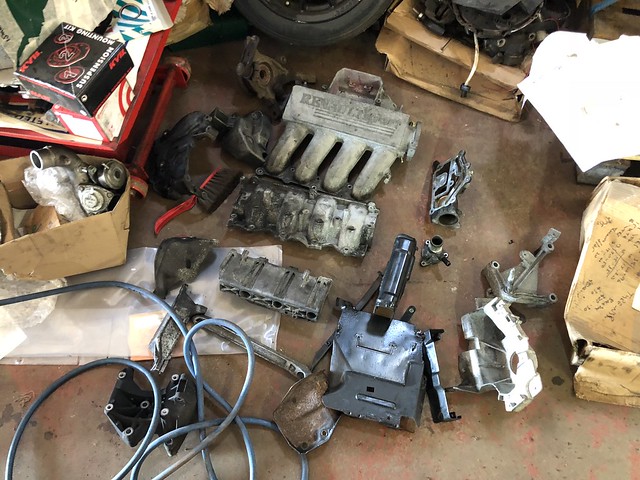

All of the bits for blasting were all assembled, inlets were looking pretty grubby!
All done.

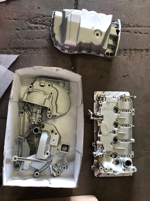

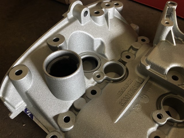

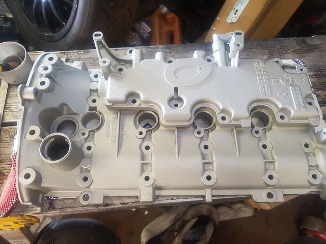

Painting then commenced on the engine, gearbox and other bits.
Can really see the cast aluminium finish to paint on the rocker cover here.

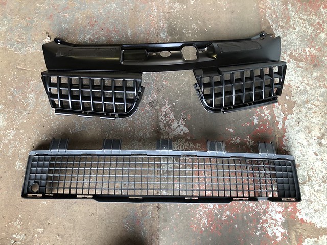

Painted, and unpainted grilles, much fresher!
Sump, engine mount and other looking fresh after paint!
Everything done.

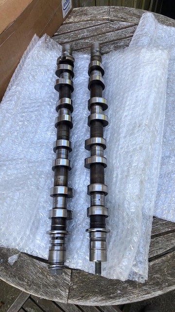

Now for some bits.
197 Cams.

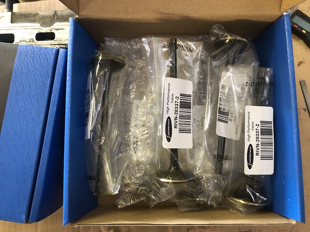

Supertech Valves.

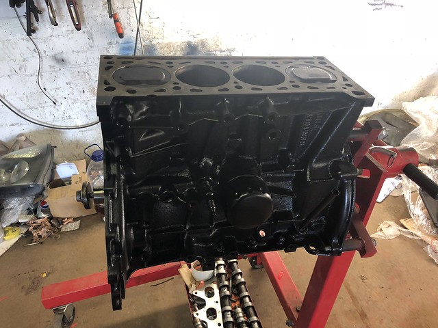

197 Pistons in the block, anybody who knows what a 182 piston looks like can see how much extra compression these will give with that raised area.

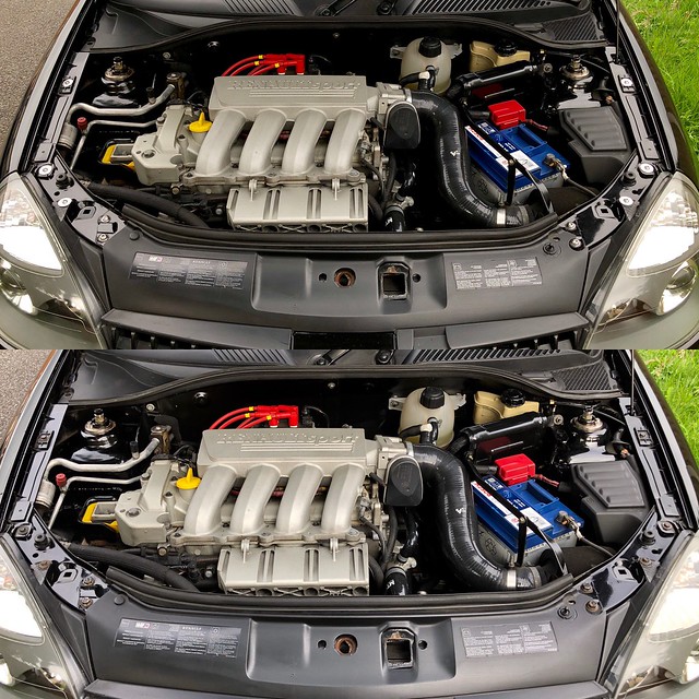

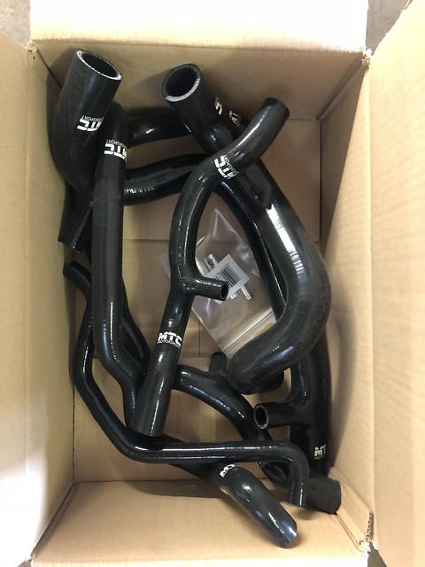

MTC silicone coolant pipes, much nicer than the tired OEM ones.
Magnecor red leads.

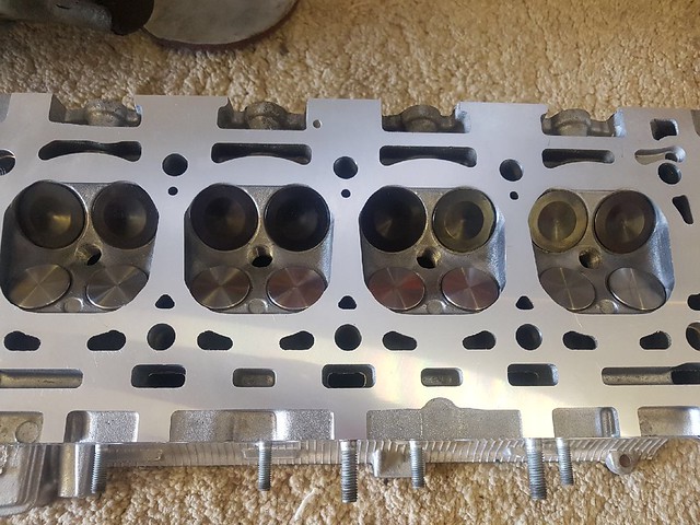

Head came back from the headwork, valves in also.
All assembled and looking very fresh!

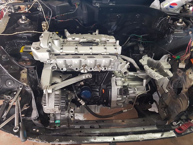

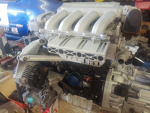

Mounted.

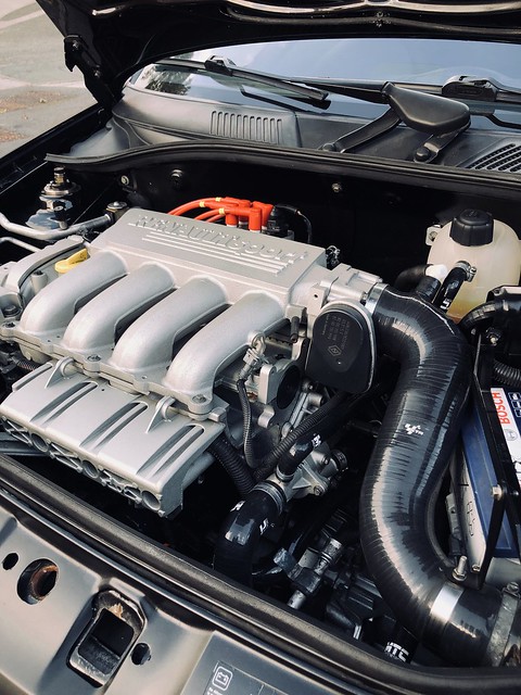

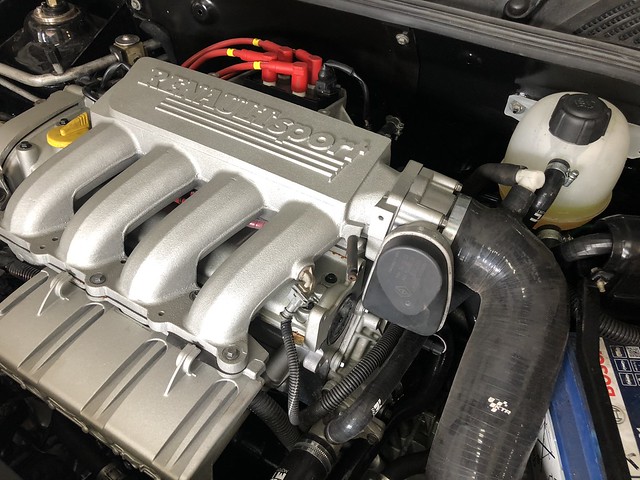

And the finished article! Looking perfect. A blend of fresh OEM finish and some aftermarket & OEM+ upgrades, and subtle changes.

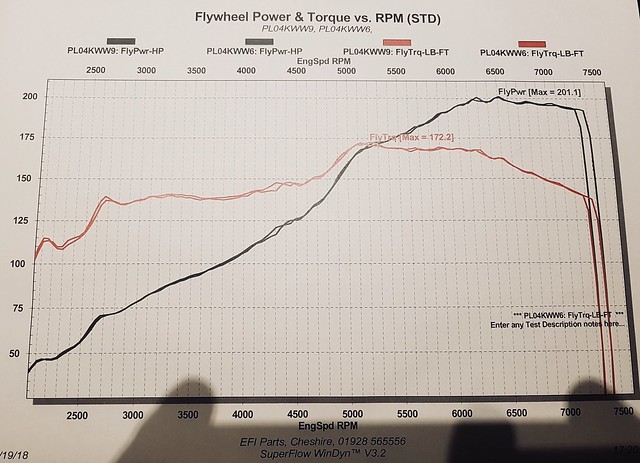

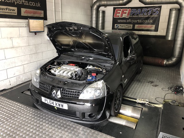

The big day, mapping at EFI, it was time to see what the hybrid 197 spec delivered!
201hp and 172lb-ft. Super happy with that. AC and PAS still in place too. I wanted to break that 200hp barrier just because, but that extra 20lb-ft or so of torque over standard means it pulls really nicely. It's essentially the standard graph just more everywhere! But goes to show that those pistons and headwork gives another 5-10hp over just 197 cams potentially.

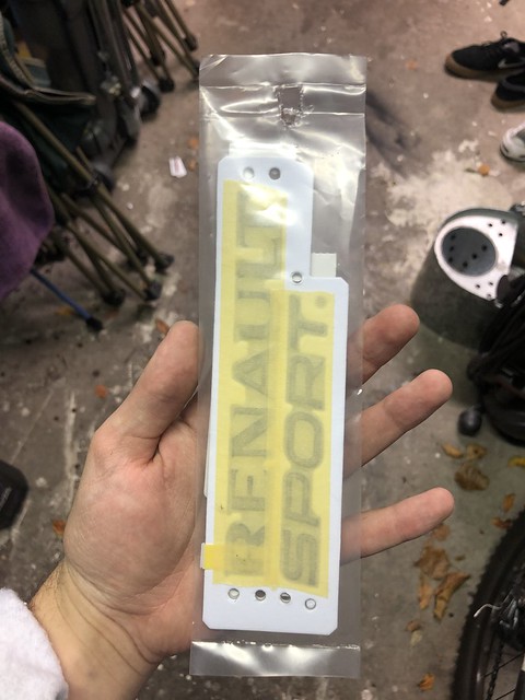

Also decided to replace the Renaultsport badge with a 197 generation one, looks much more modern and fresh, also a little nod to the 197 hybrid spec of the engine!

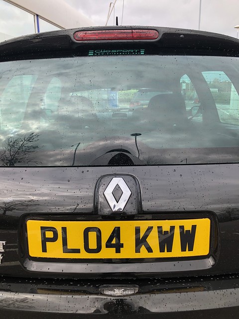

Also a KillAllWipers delete kit made by my friend Dan who runs KillAllWipers, a much slicker solution than Renault's weird half moon plastic wiper trim.

Back end looking much neater and fresher!

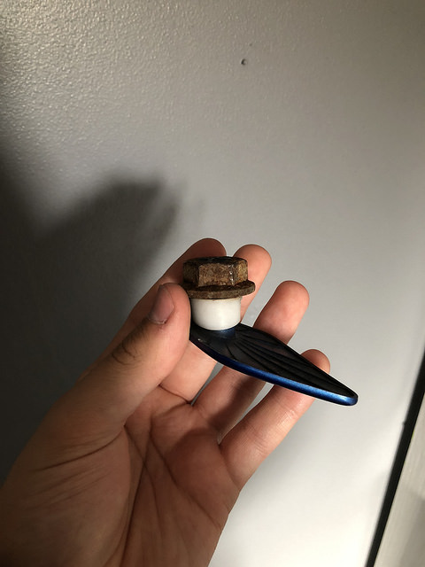

First one was a very quick and simple one, the standard Recaro seat bolts had rusted, annoying for the premium price and no moisture in the car other than just the air! Replaced them with some nice silver ones, which look much better anyway and match the other silver bolts and bits on the car.
Next was some nice stainless engine bay/slam panel bolts to replace the flakey/rusty standard ones, again, much fresher and matching other silver accents on the car.
Some black steering wheel bolts to replace the old ones which had turned a nice green colour 😐 Before and after.

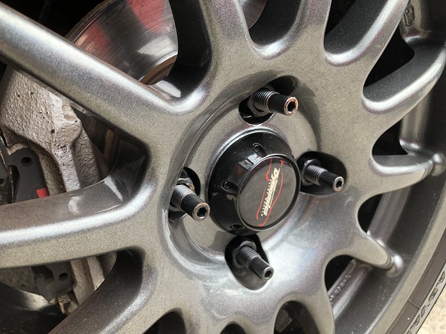

New PMS stud kit, the old ones were 18 months old and had gone rusty and pitted.

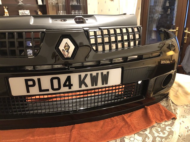

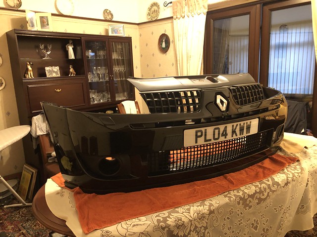

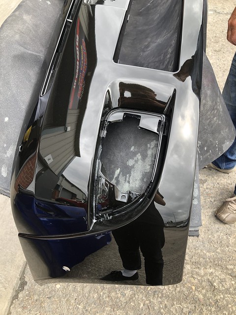

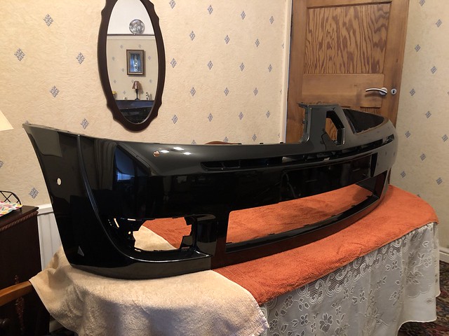

Next up was a front bumper respray, old one below looking pretty knackered!
And after!
Meanwhile, I also painted, coated and tidied up some other bits, and properly restored a matching set of headlights I'd got from @Louis.
New top grille with clips in tact painted, lower undertray/splash guards, and splitter painted.

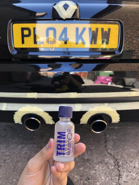

Gyeon Trim coating to all of the other plastics which has made a huge difference, it's all in the details. They look factory fresh now, and this lasts for 12 months.
Beads very nicely too.

Restored the headlights with the 3M Headlight Restoration wet sanding kit. And wet sanded the edges of them by hand. So many people miss these edges and it's these little details that make that extra 10% difference that mean they look totally mint and clear. You can see the pitting on the side and underside edges in the photos below.
All done, then coated with Gyeon Trim. Would highly recommend this for these, little known you can use it for clear lenses. They haven't yellowed at all in the 6 months since I did this like they normally would if you just left them, and they have that extra bit of clarity because of the coating acting as a lacquer.

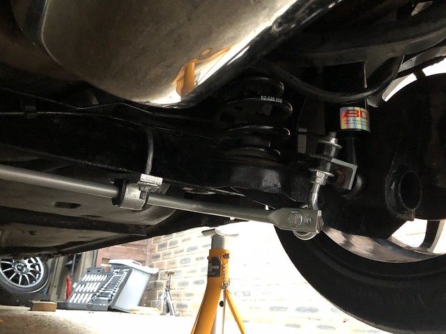

The Whiteline RARB was looking pretty rusty now after a couple of years of road use. So I decided to whip it off and give it a freshen up and lick of paint to make it look as-new. I found some plate finish effect paint that replicated that plate finish effect when it was new. Looking much fresher!
Before.
During.
After.

Cracking work. I really just wish there was a wonder-solution to the bloody headlights on these!
Would be great if they could just unbolt with the bumper in place and spending some decent time on them rather than struggling with them in situ. Looks like I'll be having a go at mine again soon. :rolleyes:
This Gyeon Trim has held up very well so far, still as clear as the day I did them 6 months ago. Not bad for a simple application!
Out of interest - what did the engine work come out to in terms of cost, if you don't mind me asking?
£2500 including mapping. Could be worse considering £330 of that was the valves.
Seems like a lot for the “gain” but this build was more to refresh and bulletproof the engine, the mods were just a bonus to make it more exciting while I was there. If it saves me a 5 hour ride in an AA Truck and my trackday ended at 10:30am then it’s money well spent IMO!
Wow - that's considerably less than I thought. Especially as I'm north-west based as well.
Damn. You've got me thinking now! :P
