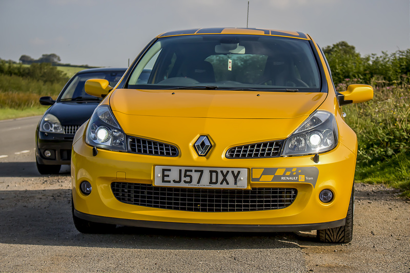

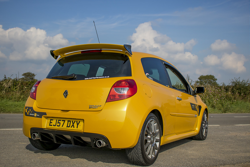

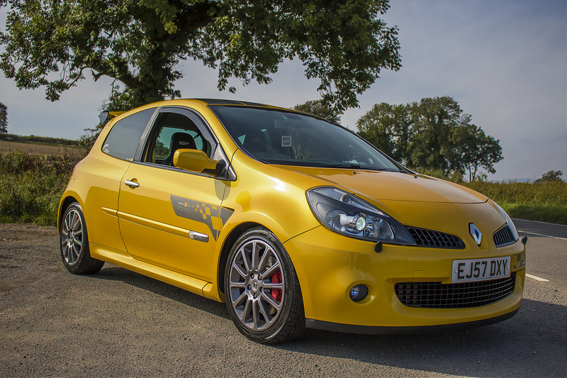

So a friend of mine recently had his 197 sent off to Tech-1 for a little bit of a change, shall we say. He got it back last weekend and really wanted some nice pictures of it, so we headed out today (after Llandow) for a little photo shoot if you will.
His car is running a Megane 225 engine, with the hybrid turbo from the Megane 250, 6 Speed LSD from the R26, and is running 300bhp (give or take). It's a bloody gorgeous car, and goes like a stabbed rat!

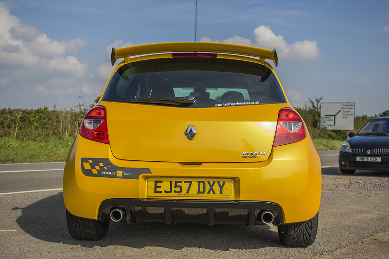

I've told him he needs a new exhaust, he's debating a non res atm as he likes the current scorpion setup. What is generally the best setup for the 197's, bar the akropovic!
From what I read, apart from the akra they're all much of the same.
I remember a lad on here having a Spanish exhaust, super sport or super sprint iirc. It sounded unreal! I'm not sure what it did for drivability but it did sound immense.

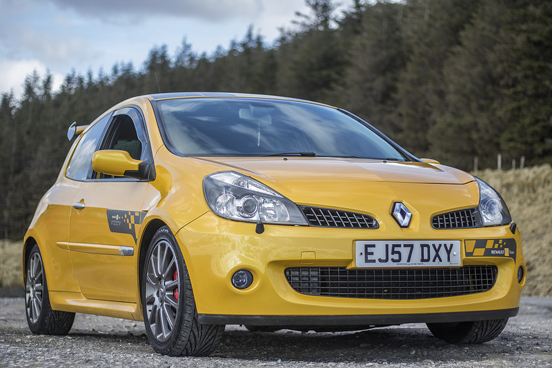

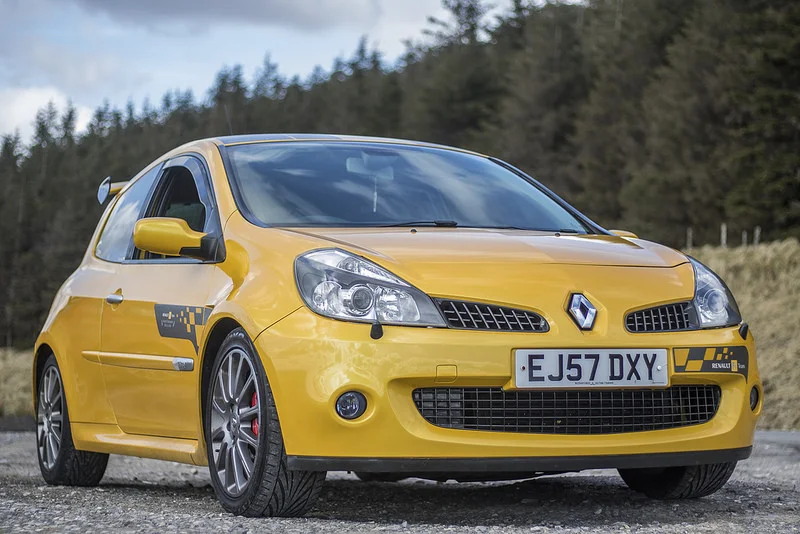

Right so, the cars back. The engine was sent off to Tech-1 for a bottom end rebuild over 3 weeks, and she came back last weekend all ready to be dropped back in.
What better thing to do than head over to some glorious Welsh roads and grab some pictures?
Almost the most prefect Clio that ever existed I reckon... (just needs the Renaultsport splitter and skirts bit :wink:)
