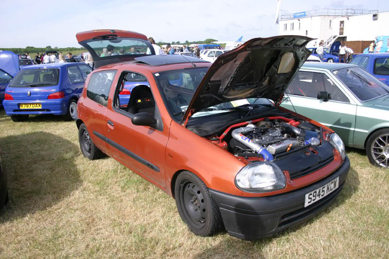

1.8T lumps seem to be the best to go for, for a lot of cars, look at Matt's Clio TT. Presumably it's very sturdy and can handle decent power without needing to change internals.

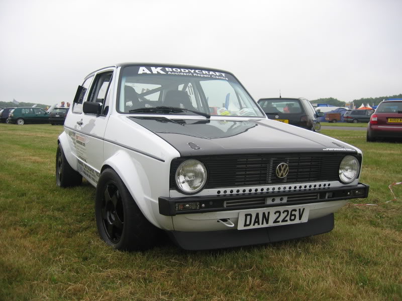

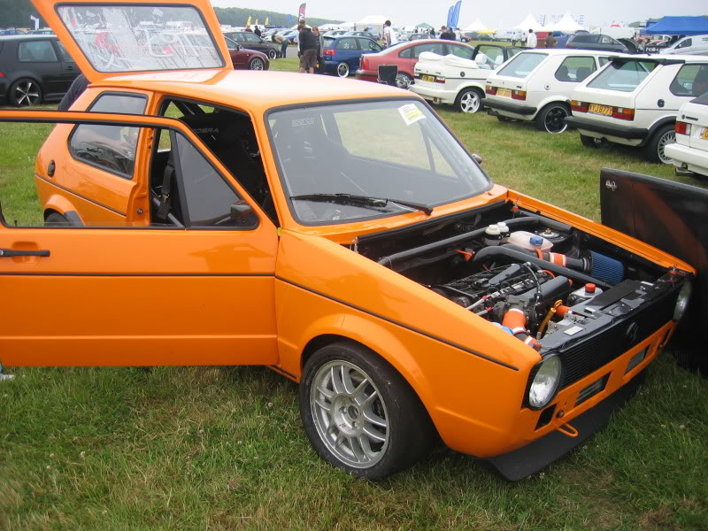

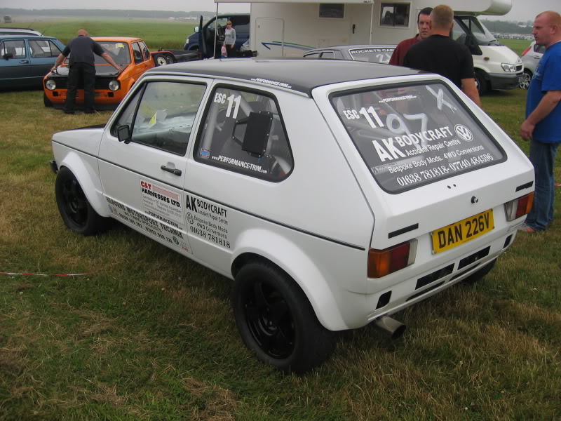

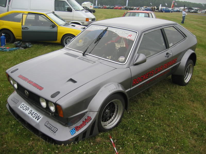

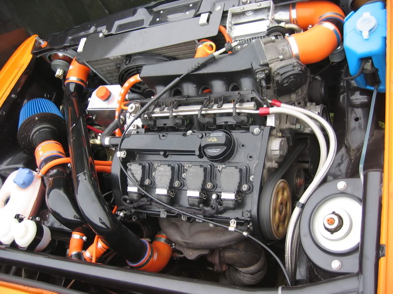

330 bhp is very easy to achieve with a 1.8T
Heres some of my mates motors with 1.8T conversions -
Jordy's scirocco 550 bhp + 150 gas
Dales's MK1 400 bhp
Andy's 550 bhp MK1
Sambo's Audi a3 450 bhp
My old one 400bhp

Most if not All of the 2.0T motors are FSI direct injection. Direct injection means your going to need a new high pressure fuel pump to acheive massive gains as the OEM simply won't flow enough. After market ECUs are also a No
Keeping to normal port injection technology makes life much easier.

Yeah. Due to the way the injectors are setup to run during stratified mode (fuel saving mode) they are capable of flowing a heck of a lot at full chat. I understand there are companies making modified pumps for the VAG 2.0s now. They are still not great for conversions as they can only be run on the OEM ECUs which require basically the whole donor cars electronic system to function. Companies like Qpeng solve hack the 1.8 20v ecus, don't know if they've done the new 2.0 yet
