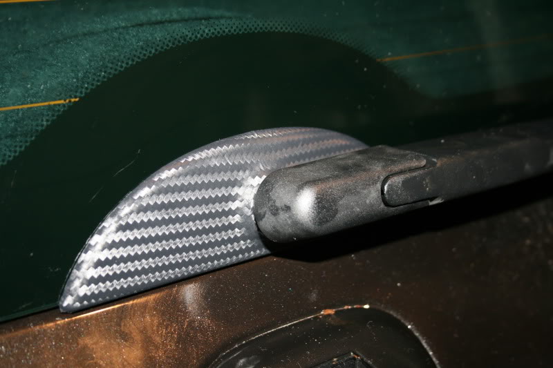

I have done my dash strips now, which were p*ss easy, however I took my wing mirrors off today, and for the last hour I have been trying to get the wrap on but it just keeps having creases in it. Its too hard to do on wing mirrors.
Anyone got any suggestions or tips?
All that CF in the interior looks good. I wouldnt mind a CF centre console on the dash.
I find it easy to fit to straight pieces, however I am struggling getting it around the mirror back
I found that it was easier to cut a peice that was much too big and use the excess to create the curves with the stretching.
Then let it cool for about an hour and trim it afterwards as it shrinks slightly when it cools.

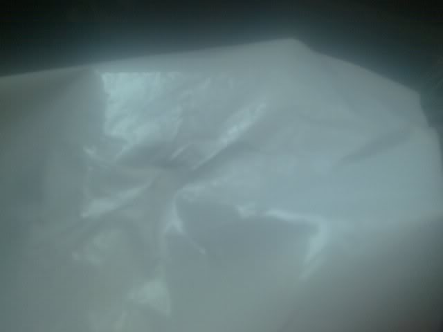

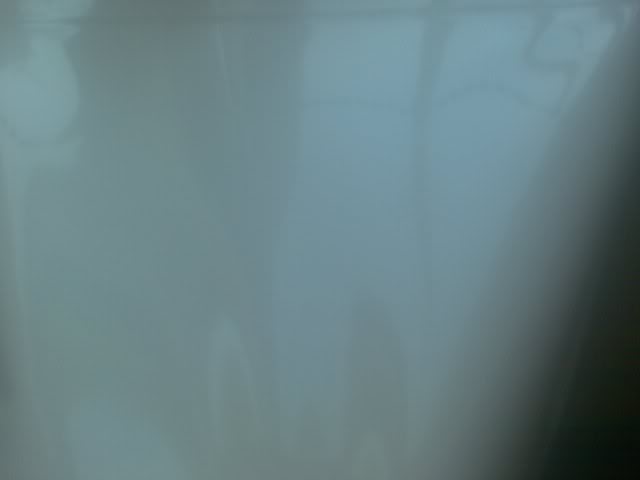

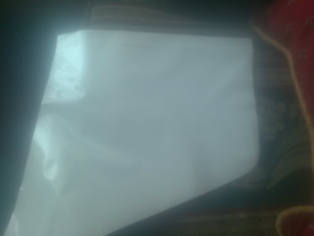

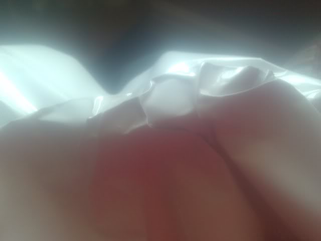

nooo!!!. you cant use any water on it, it a dry application vinyl, designed to be used without lubrication. if it goes tits up you should be able to peel off/reposition at least once more. and for anyone that doesnt know heat is your friend. especially if you screw up. eg(please excuse pics)
creased, ruined
i think not
this was saved due to adding a litttle heat. note that this is just some cheap wapping film, the 3m will be much better.
