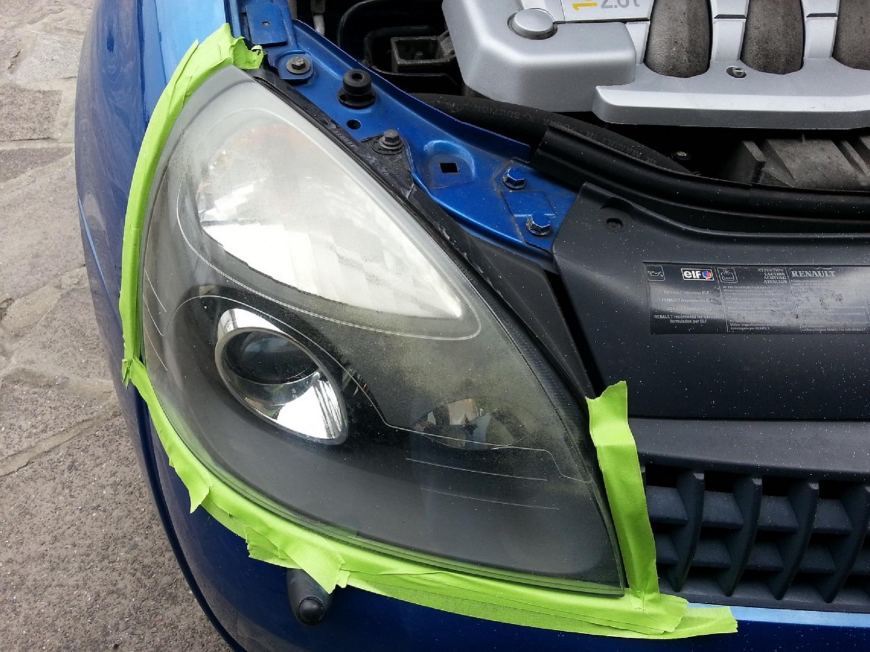

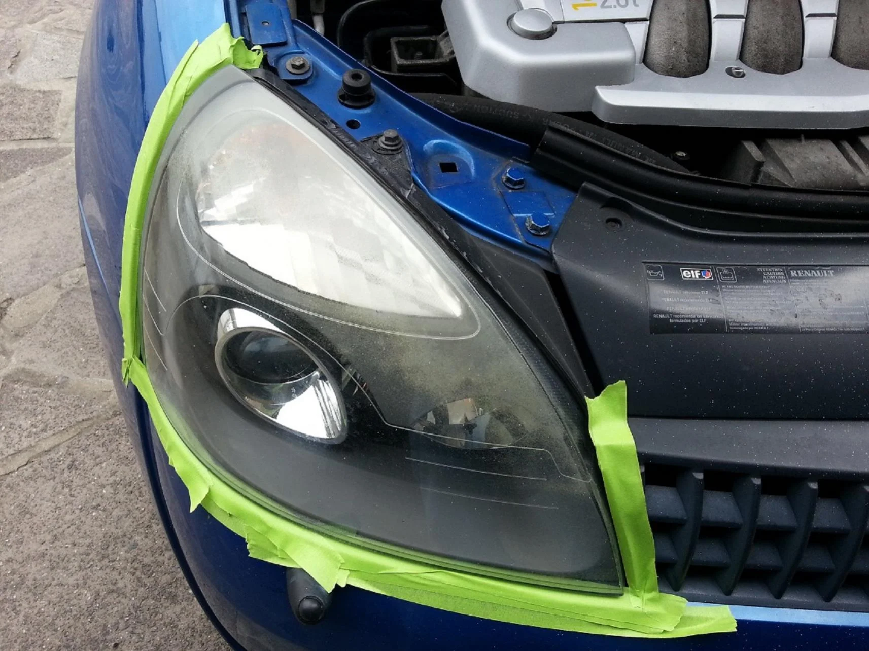

Scabby Headlight above.

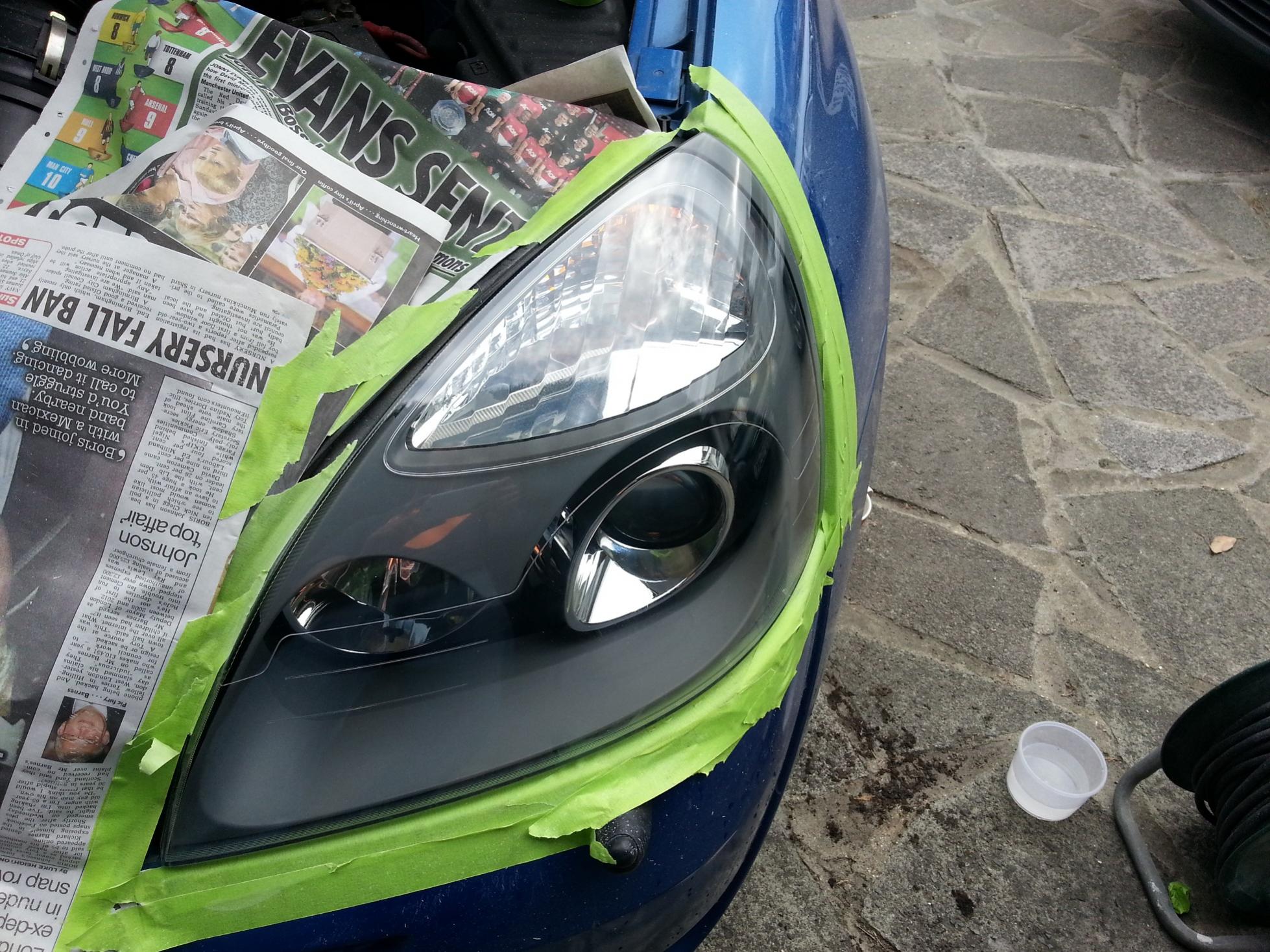

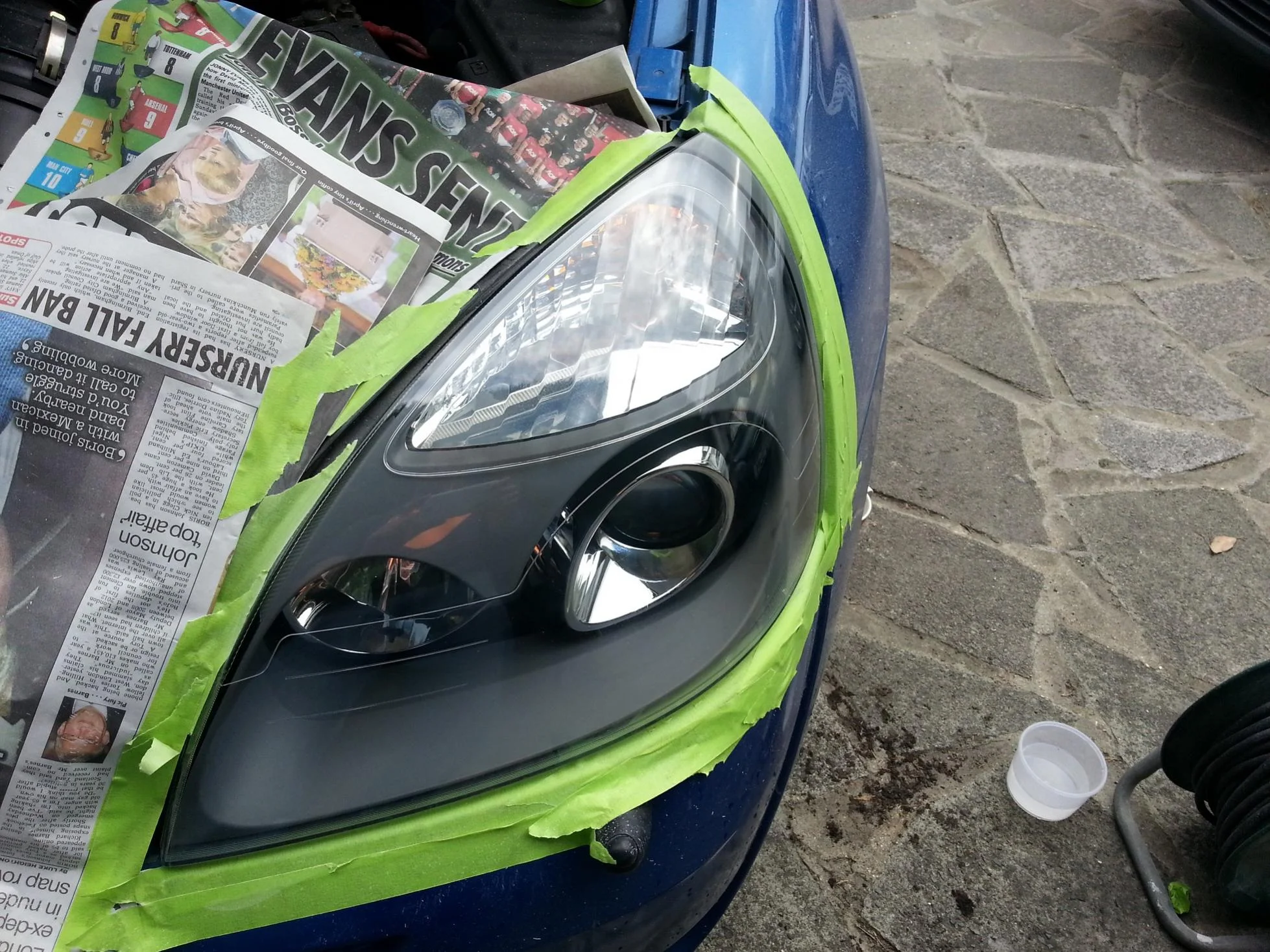

Freshly completed one above,
The compound makes a right mess of the car though.

I tried mine the other day and they show scratches and misting/ fogging. What have I done wrong?
  Fiesta ST2 MP215
Did you use all of the pads? 3 yellow and 2 white on each? Its the grey one that makes all the difference just keep it nice and wet ( how we like it ) and the orange one make sure the pad doesn't run dry otherwise it heats up to much. Give it another go. I used all the pads up until they had nothing left to give.
Rushed it. That's not a dig or a smart remark, but the only reason it wouldn't leave you perfect lenses is if you have rushed it and not followed each process to the end.

Yes use all the pads to their end dude. I also used a mains drill going at 3000rpm it blitzed them none of this battery powered crap. I didn't seal mine just gave it a good wash and wax afterwards the pic is before being cleaned.
