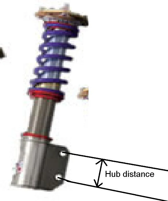

have a look at the pic it gives you an idea what to measure.
