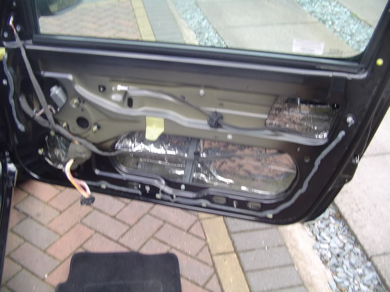

Stripped Door:

The idea here is to secure the mdf ring to the inner door skin by drilling and screwing it to the door. I put no more nails down before hand to keep it mounted to the door whilst i screwed it down, Whe ndone you will have something that looks like this:
