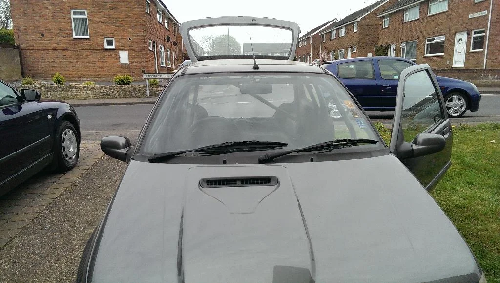

Haven't had a project thread on here for any of my cars so thought I'd do one for the car that's been around longest.

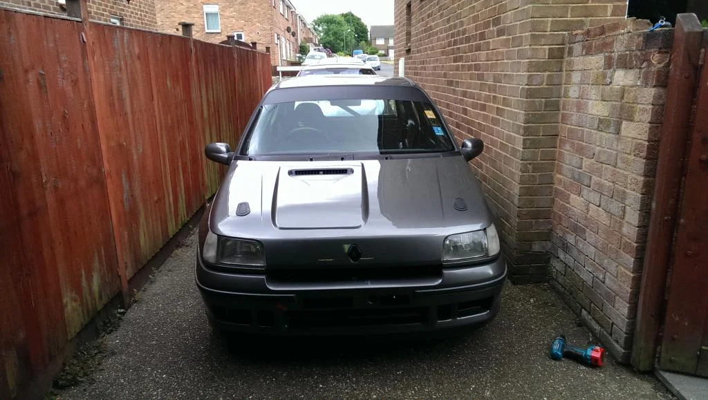

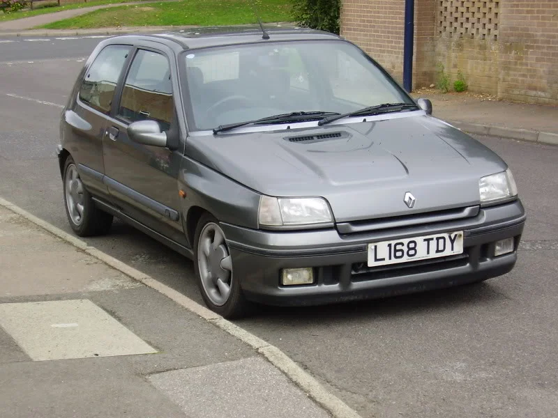

I bought the car just after passing my test and it was used as my everyday car up until last year when I got a 172. I found it listed on ebay as a 1.6 rsi but as we all know there was no such car in mk1 form and it was quite clearly a 1.8 16v, drove to Essex and picked it up that night for £400.
When I got it home

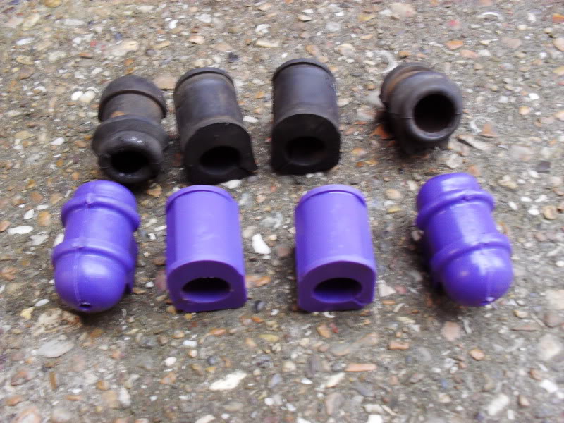

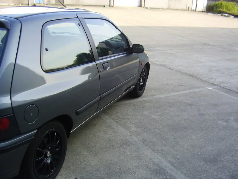

After fitting some pro race 1.2's and tidying a few things up

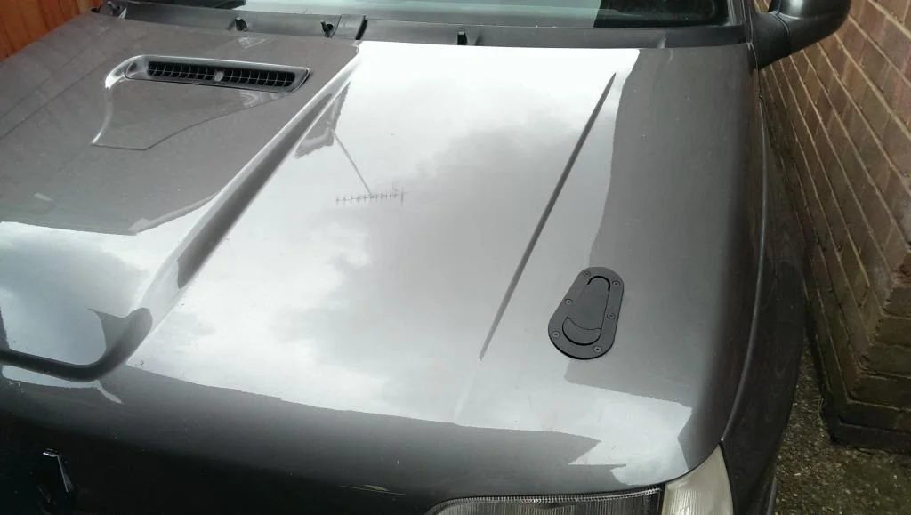

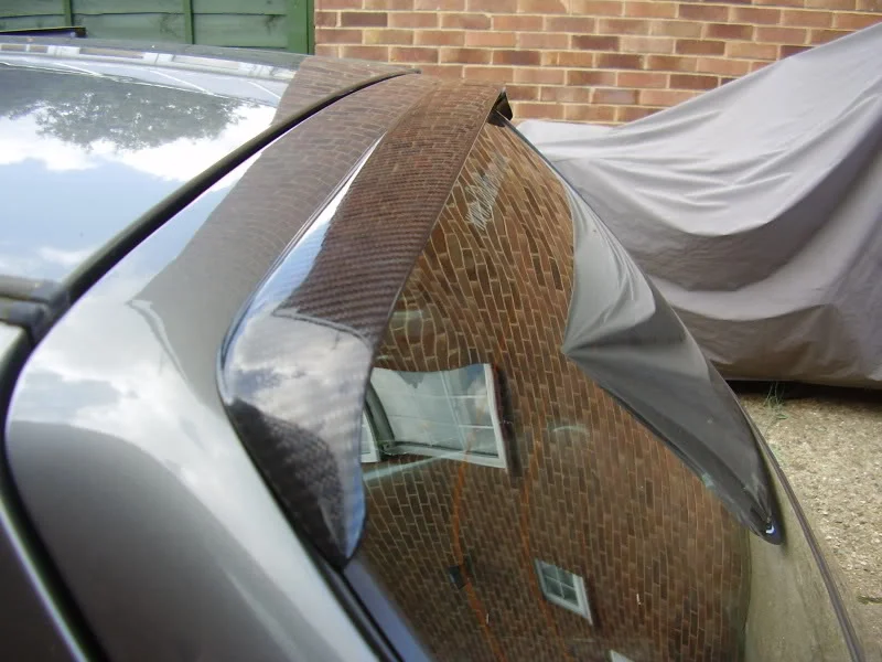

Carbon remould of the oe spoiler bought and fitted

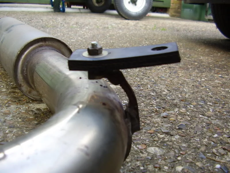

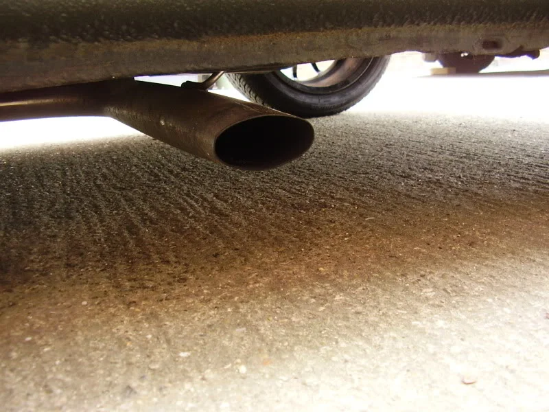

Side exit exhaust fitted

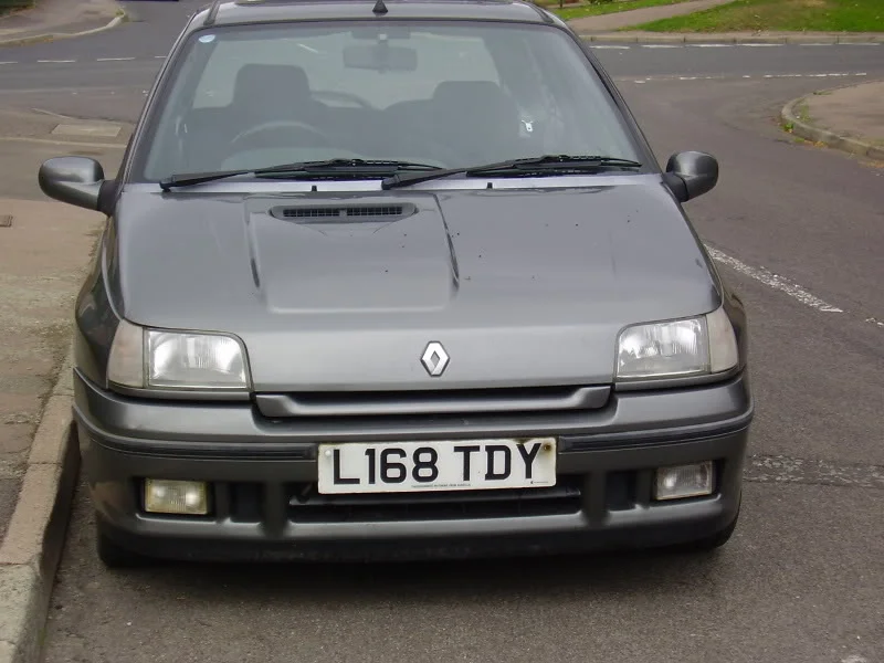

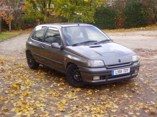

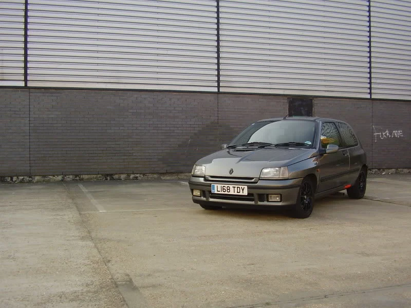

Some pics as it was at this point

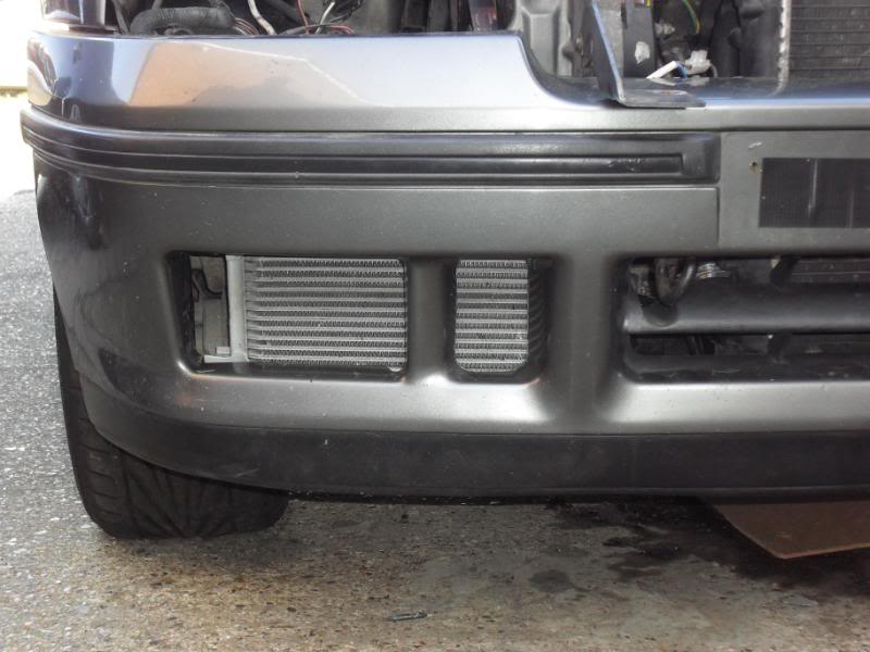

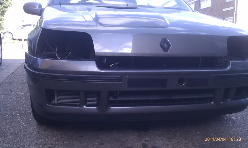

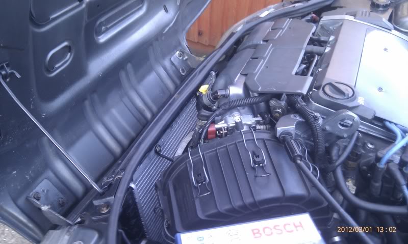

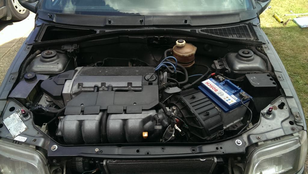

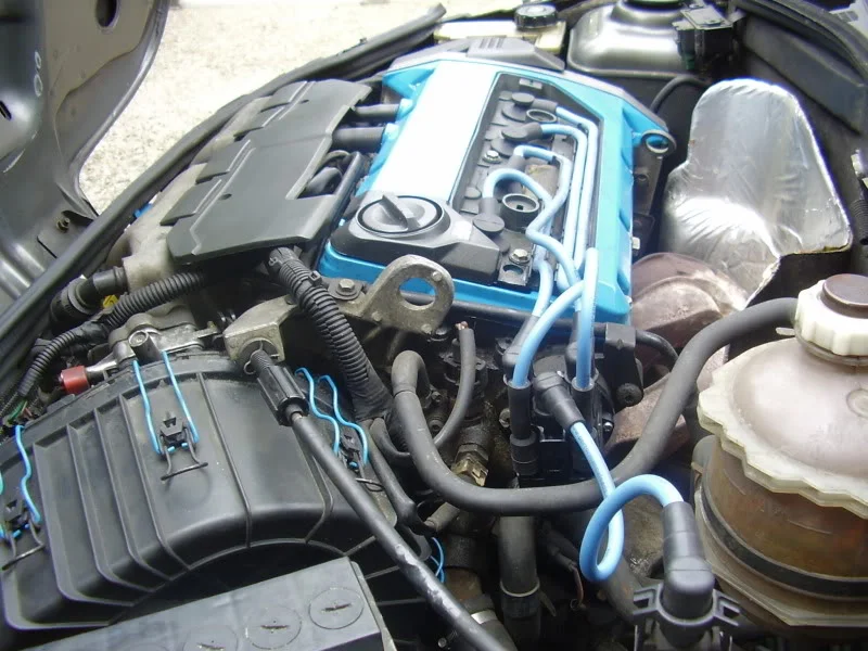

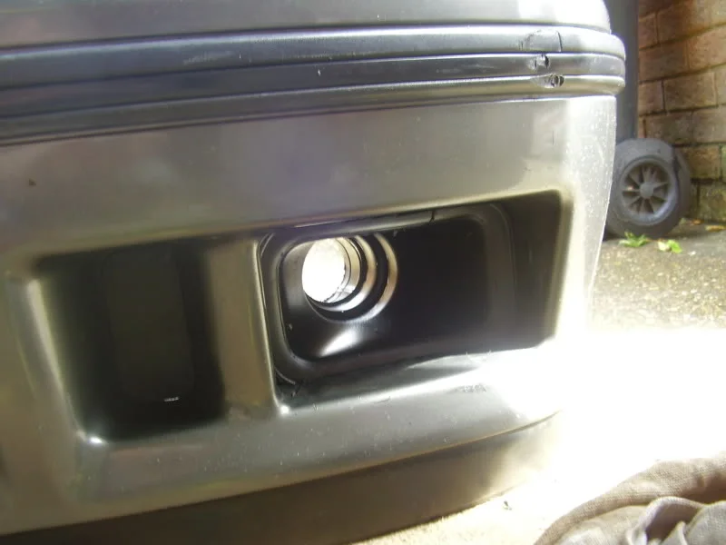

Fogs removed and an air feed fitted, plus a bit of colour in the engine bay.

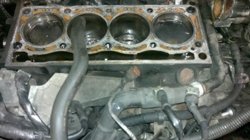

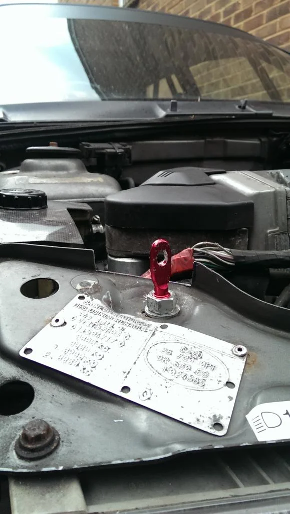

Redline old vs new photo shoot. Headgasket went on the way home from there and was 'fixed' with some K-seal, which surprisingly lasted around 2 years lol.

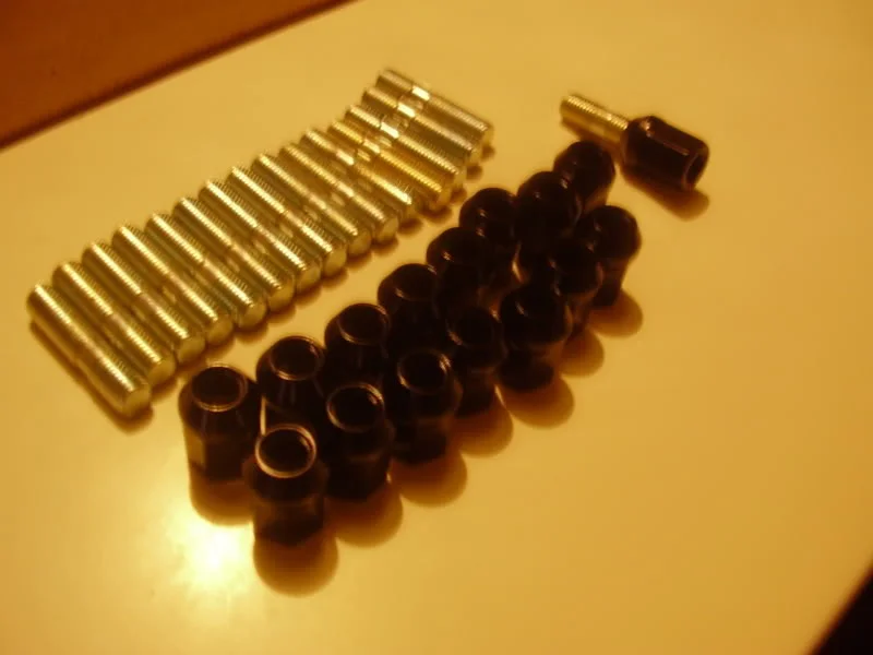

Stud and nut conversion fitted

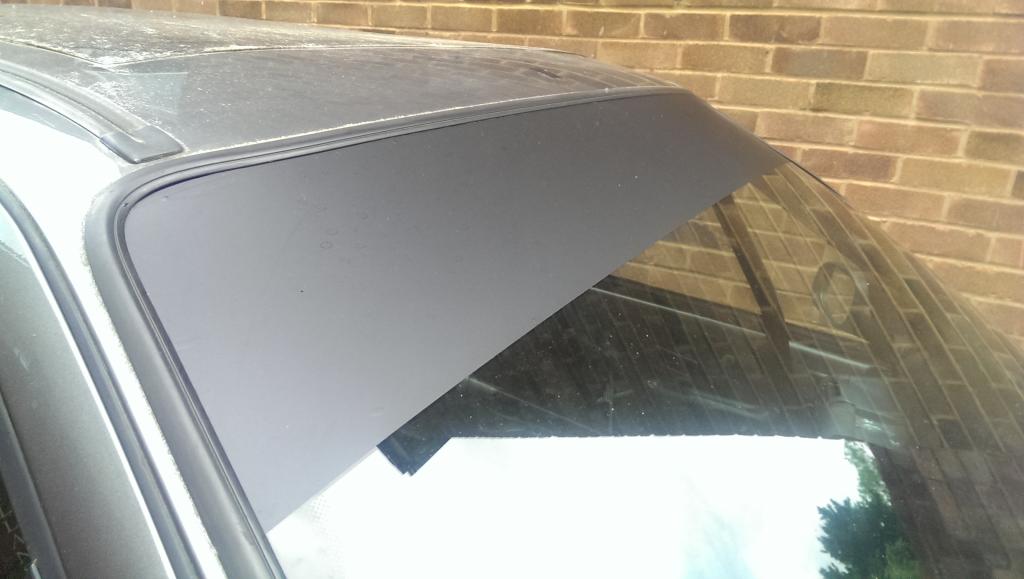

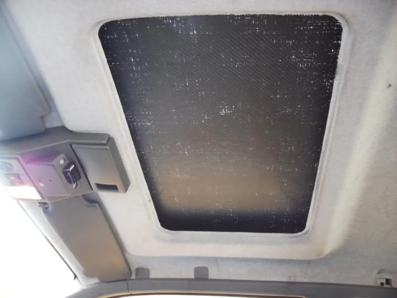

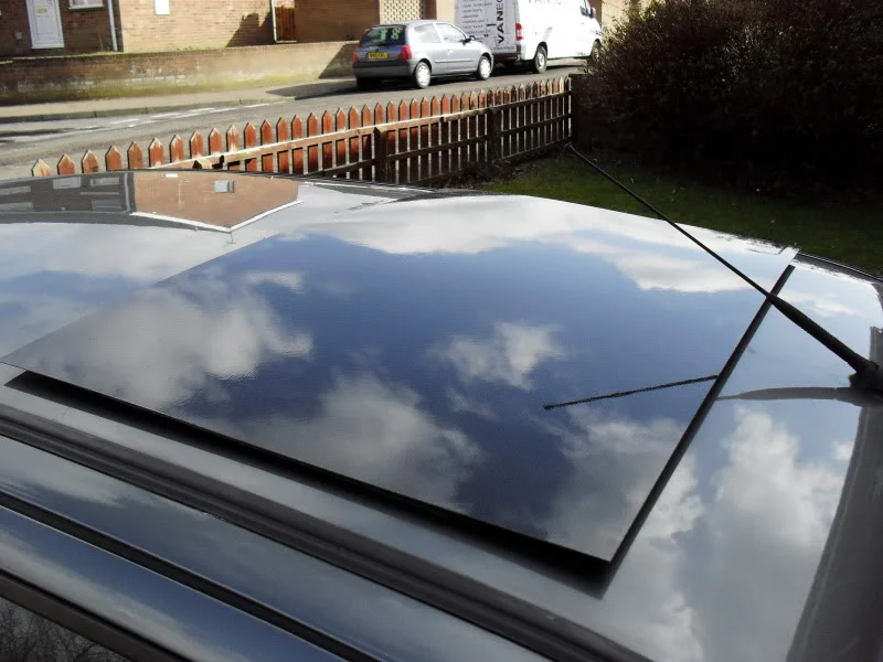

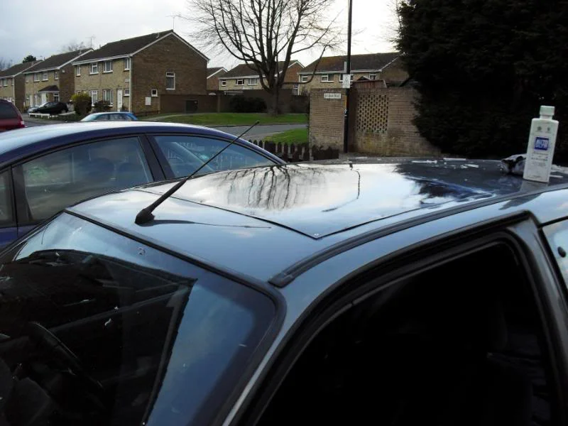

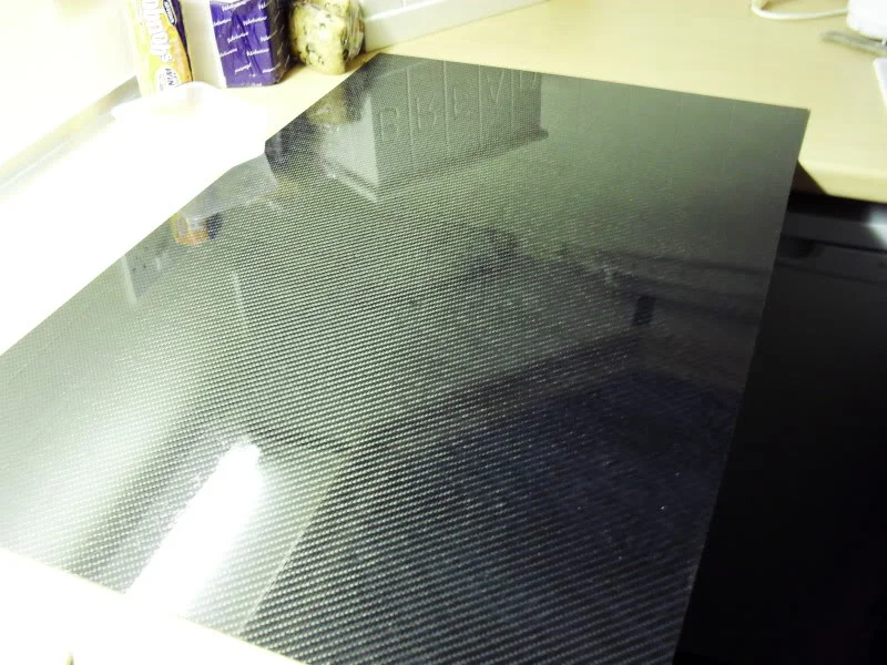

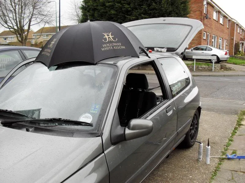

I then finally decided to do something about the leaky sunroof and replaced it with a sheet of carbon fibre instead of messing about sealing the old one up. Never got a wet lap again!
Was always gonna rain as soon as it was out wasn't it lol.

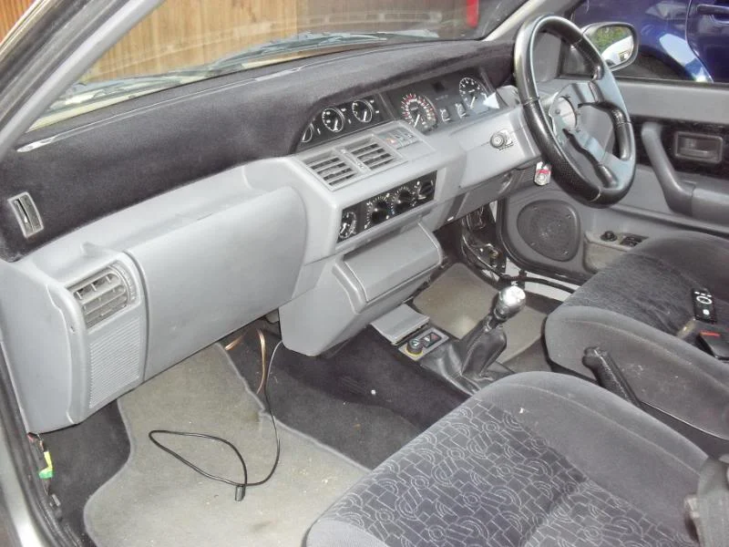

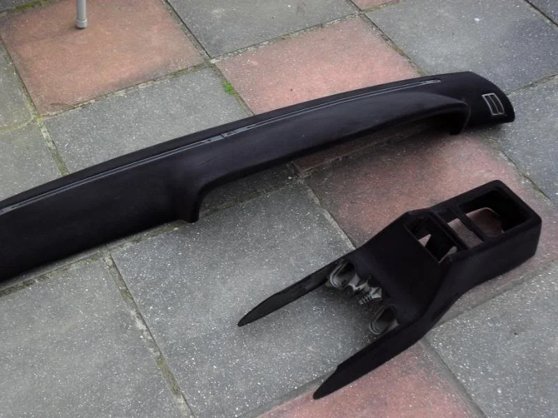

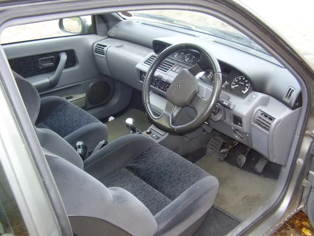

Next up was a flocked dash to stop the annoying glare you get off the standard one in nice weather. Also got the centre console done as it was marked and scratched pretty bad and had some fibreglass rear panels made up then sent over to be flocked too.

After driving the car for a fair few months with the headgasket gone and various other engine related problems (crank sensor, rad fan breaking etc), I decided to start looking around for a Williams engine to replace it. At the same time I also started buying up the parts to fit the wider front track from a Williams too, it would all be done at the same time as the engine would be coming out the bottom.

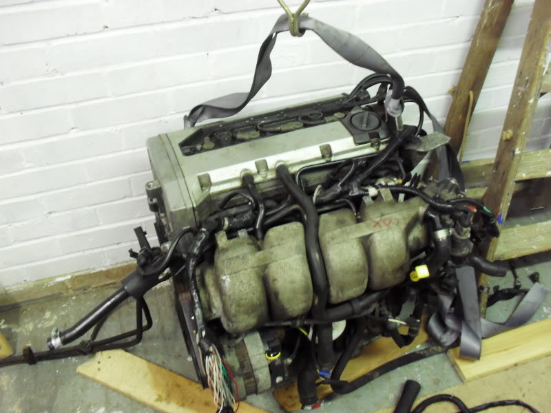

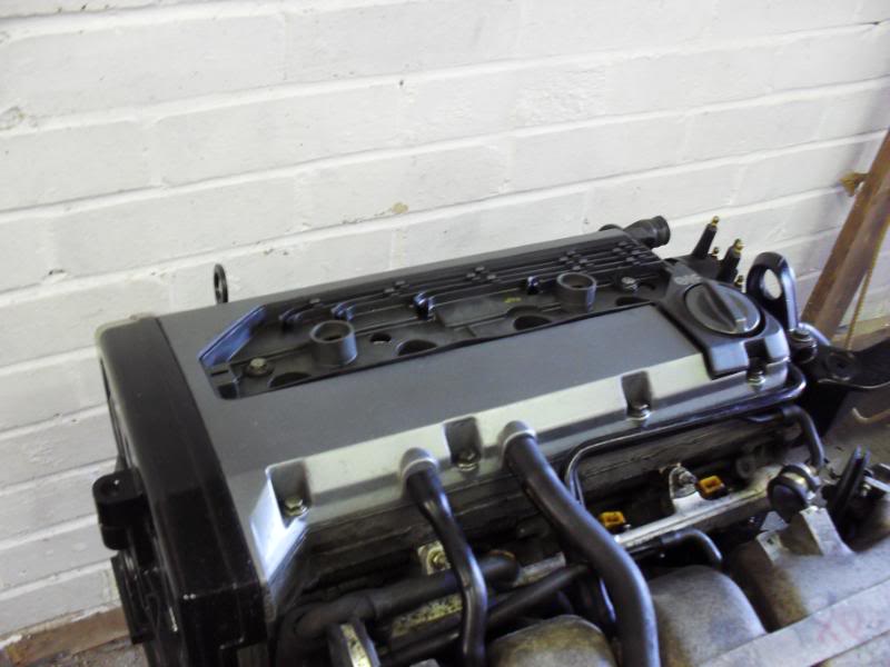

It didn't take long to find an engine and a drive up to Felixstowe and back and I had this in the garage, for the grand some of £300.

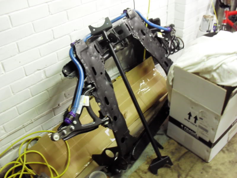

I'd also bought another valver subframe which I cleaned up and painted ready to assemble the widetrack stuff to go straight on. Genuine Williams wishbones, willy steering rack, ARB, New Shocks, Powerflex bushes were all bought straight after.

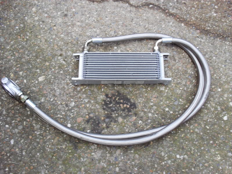

A 13 row mocal oil cooler was also purchased as it came up at a good price.
All put together
The engine after a bit of a clean up and paint

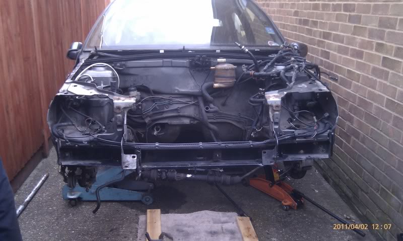

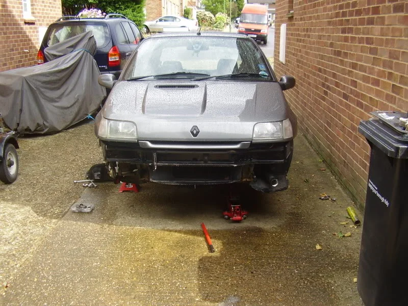

With a huge help from Luke (from clio16valver) and his mate, the engine and widetrack were all swapped over one Saturday. It even started first time that evening!
Ready to drop!

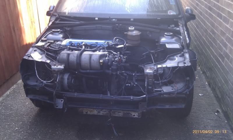

Empty and awaiting the new engine
The next day was spent tidying up the looms and fixing things back in place in the bay. Also working out where to mount the oil cooler, and I decided it would go in place of the drivers fog light as that side was bare now there was an air duct in the other one.

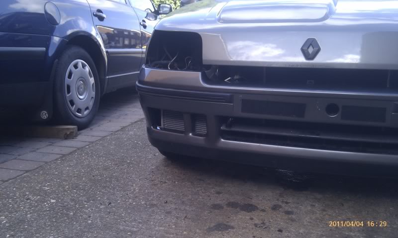

So this it how the car looked the next day
Bumper trimmed (read hacked) and back in place.
Then it was time to take it round the block and see if everything was good...It wasn't!

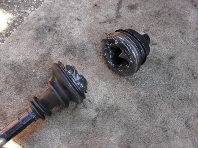

Drivers side shaft completely collapsing as soon as I went to pull away, so had to wait a few days to finally get to experience Williams power. Once that was swapped out it was a dream to drive, completely different to how the 1.8 felt but still as fun when revving hard.

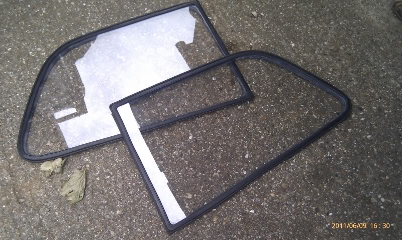

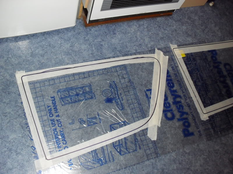

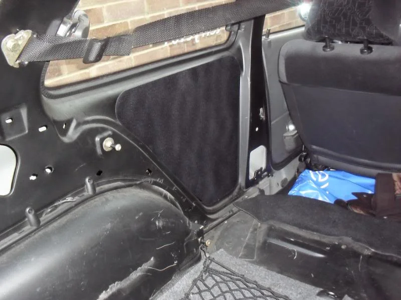

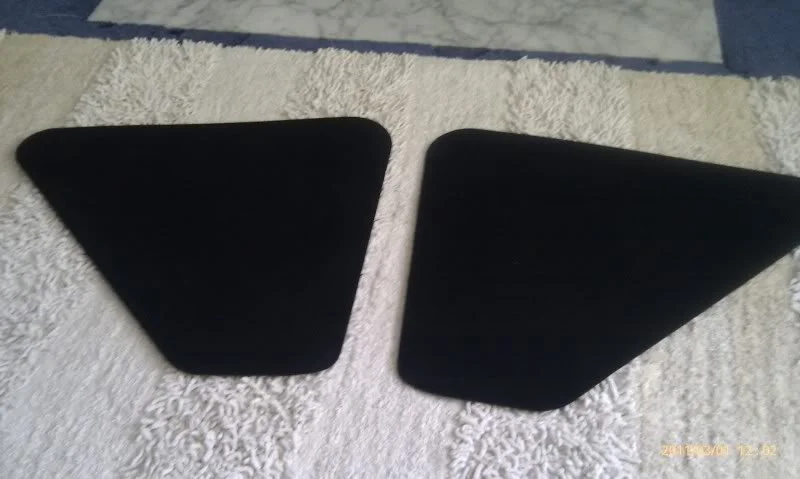

Just after this I also completed making some 'plastic' rear quarter windows to fit as the standard pop out ones were leaking pretty bad. Bought some pov spec rubbers and some sheets of polycarb from B&Q and set to cutting and fitting.
A few pics after it was back on the road.

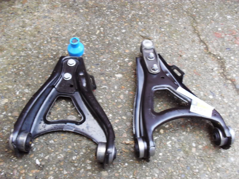

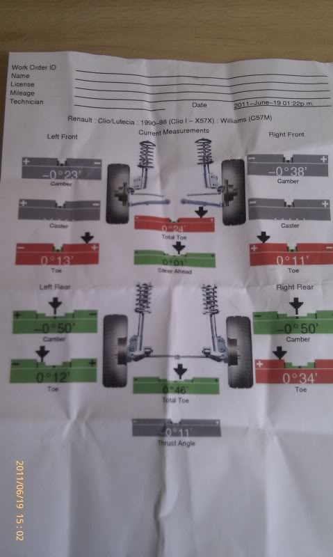

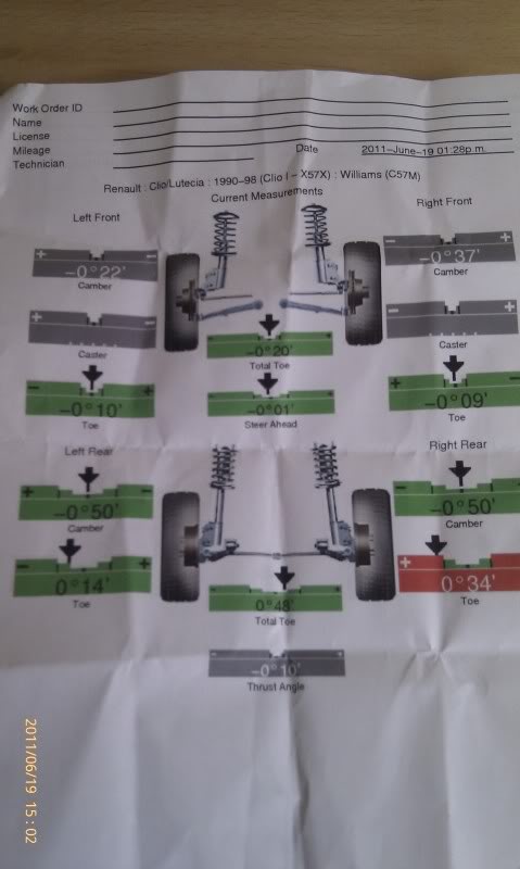

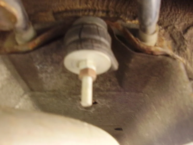

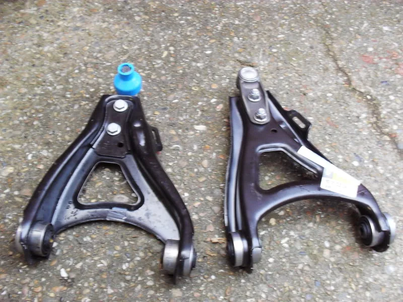

After fitting the new engine and widetrack I was far from impressed with the new handling. There was a kinda lag when turning in as if the steering wheel weren't connected and going around tight bends became scary when trying to straighten up again! After a few trips to a local garage and head scratching I found the problem, well my dad did laying under the car while I turned the wheel. When bolting the rack to the subframe I had missed out one of the rubber sleeves that goes inside the clamp, this was allowing the rack to actually slide side to side when going lock to lock....which would explain the terrifying delay in turn in!
Found the rubber sleeve in the garage bin and got it back on, the handling was then just how I imagined it would be.
Then went to have the tracking checked and make sure it was right.
Before
After

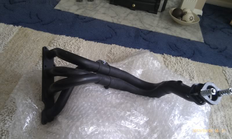

I then got fed up of looking at that horrible standard cast iron manifold in the bay and opted for a mild steel supersprint style one from k-tec. Couldn't believe just how bit the weight difference was between the two, lifting the old one out the bay was a shock! I was also shocked at the noise difference it made...loud!
[video=youtube_share;8gP9ru1uTjQ]http://youtu.be/8gP9ru1uTjQ[/video]

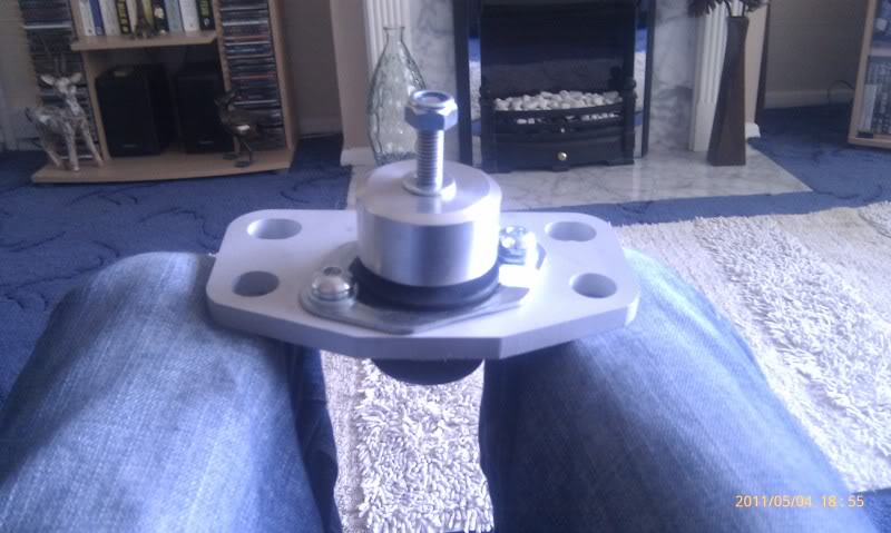

At the same time I also got an uprated top mount as mine had worn pretty badly. With running a solid gearbox one already this made the engine nice and solid and none of that standard sloppy gear movement.

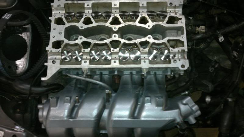

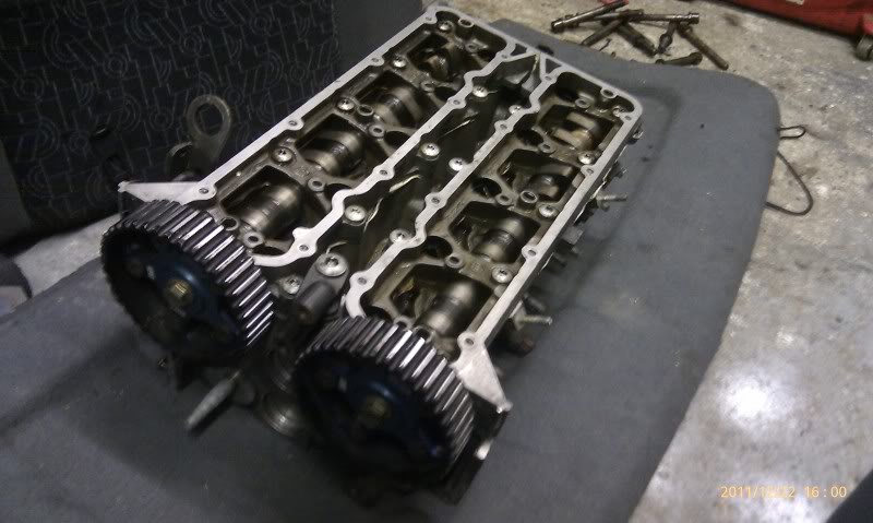

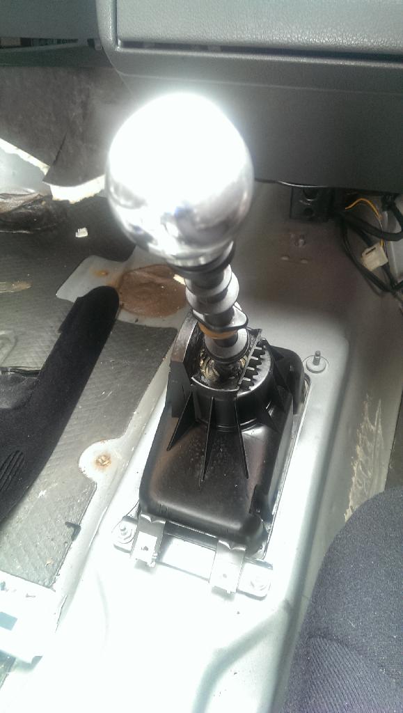

Then I got a major problem...no 5th gear! Then...no 4th gear! Then...some horrible sounds in all other gears, box was diagnosed as dead lol. At this point I'd also got an itch for a bit more power and had sourced another engine that had cams (kent rn2002's) and headwork done.
So I bought a new box and the car was packed off to have the following work done:
Fit new gearbox
New clutch

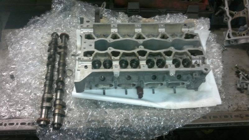

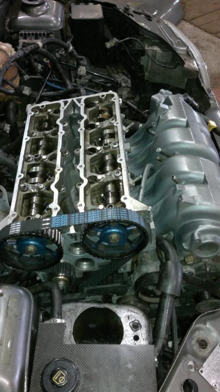

Swap the new head onto the engine
New cambelt/headgasket/lifters
Time the new cams in

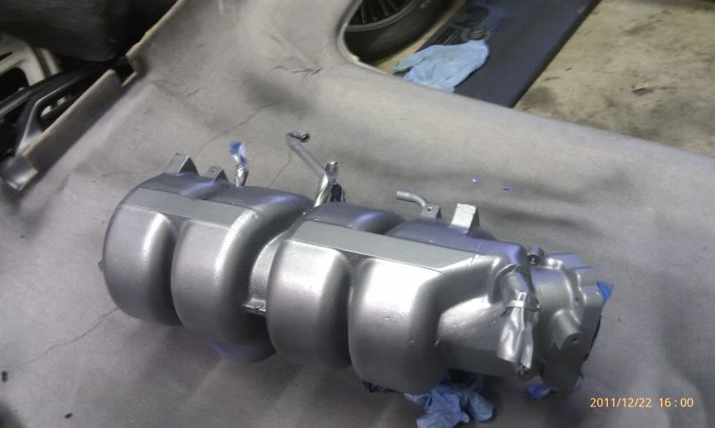

New head and painted inlet ready to go
Pics from the work carried out
While there it was discovered that the Williams lump I'd bought previously was in fact only a 2.0 bottom end with a 1.8 head on, thankfully the new head was a Williams one so I finally had an actual complete 2.0. The gearbox also drained a mixture of oil and metal so that was definitely dead! Got the car back home and it felt a lot nippier than before and had one hell of a lumpy tickover now. Bought and fitted a new rad a few days later as it was the one thing I hadn't changed when swapping engines etc.

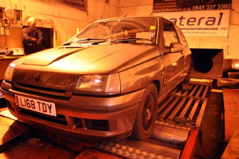

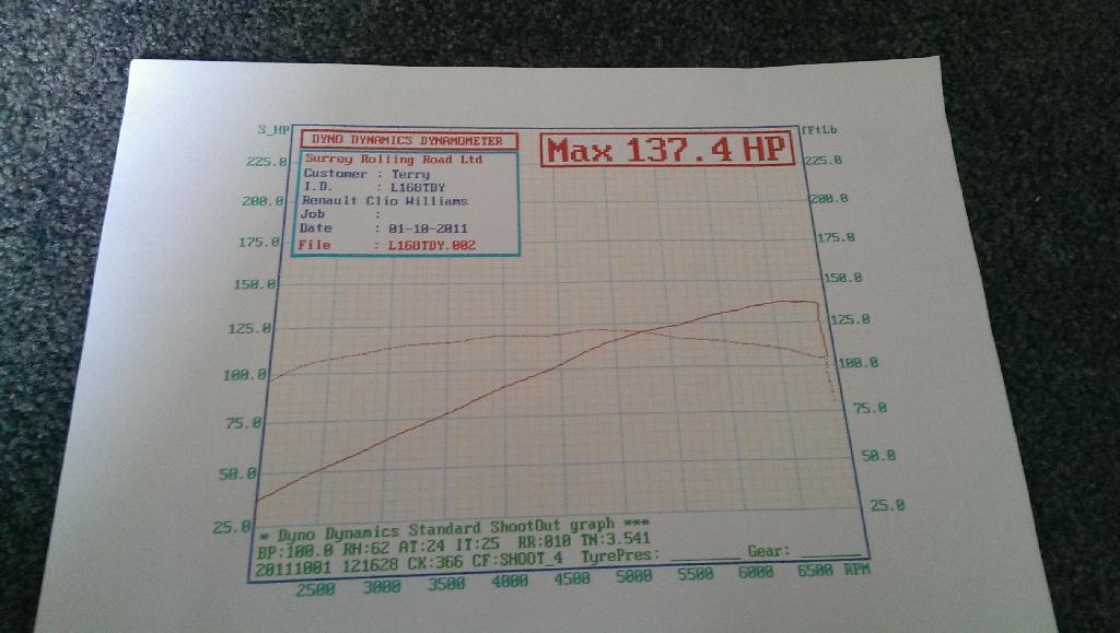

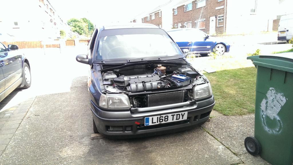

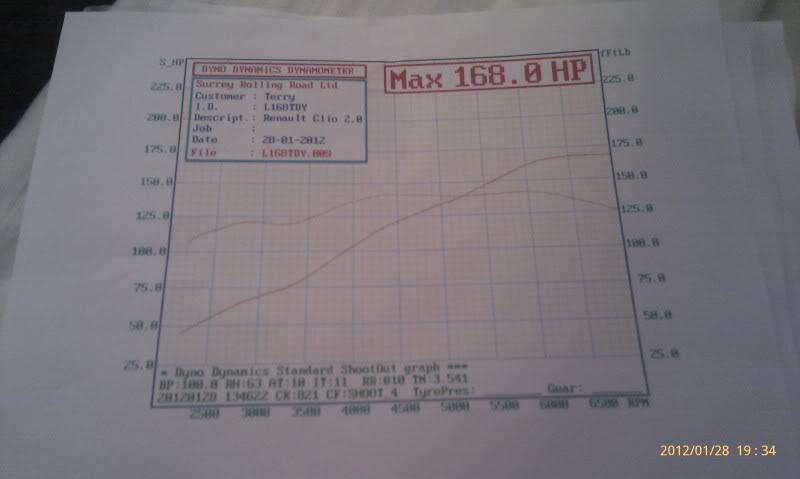

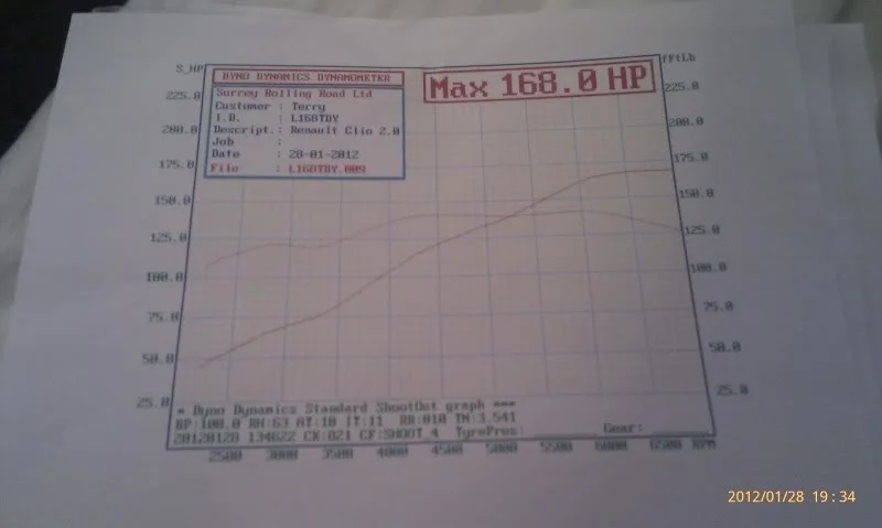

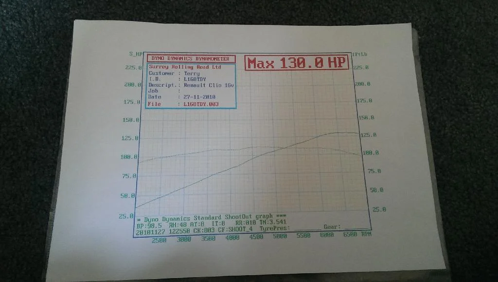

With the new engine in and having RR'd it at every stage so far, I popped along to a CS Surrey rolling road day to see what difference if any the new head had made. I'll put a summary of the changes in power below.
[video=youtube_share;rEG-oQyAoMs]http://youtu.be/rEG-oQyAoMs[/video]
1.8 (k-seal'd headgasket lol) - Silenced de-cat - Side exit - 130bhp/112lbs
2.0 bottom end/1.8 head - Silenced de-cat - side exit - 137.4bhp/121lbs
Full 2.0 - Kent rn2002's - Supersprint - Silenced de-cat - Side exit - 168.0bhp/141lbs
All RR'd at SRR so a pretty good idea of the difference the upgrades have made over time, the jump from fitting the correct head and cams was more than I imagined but its now at a number that I'm happy with and with the car last weighing in at 900kgs it certainly nips along.
This is the car pretty much up to date now, missing out a few breakdowns here and there lol. Now with the trackcar sold and a 172 for daily use this will be getting a cage/buckets etc and getting put to good use and hopefully i'll have some updates very shortly.

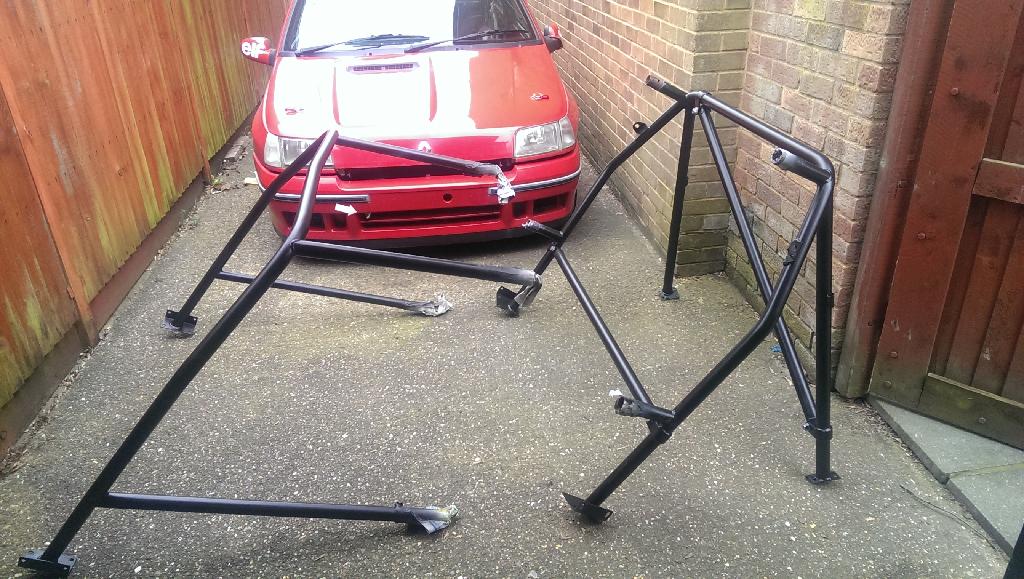

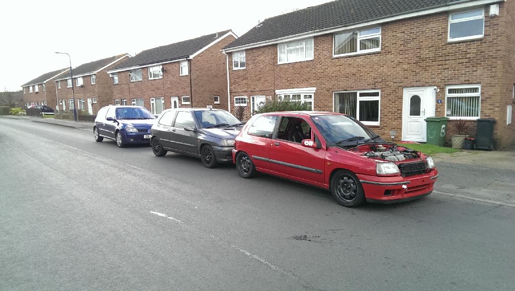

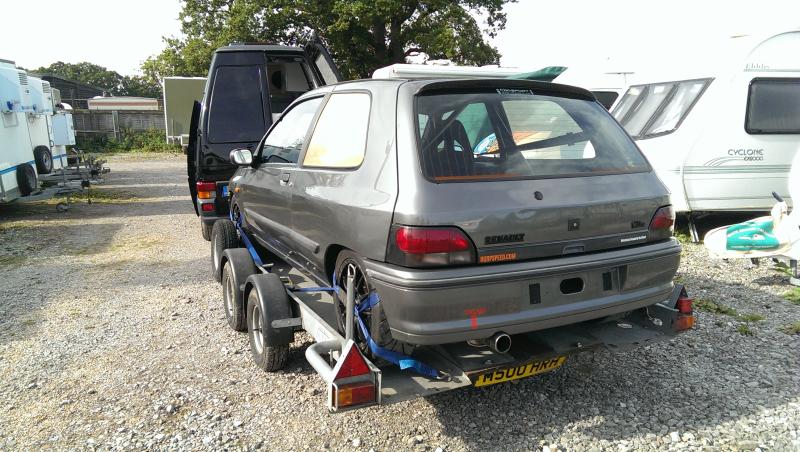

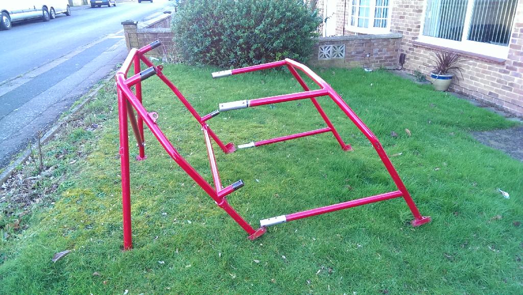

Got the track car home a month or so ago to get it ready to put up for sale, which mainly meant taking the cage, seats and exhaust off as they will be needed for this car. We bought the car with the cage already in the car loose so once it was unbolted it took a fair amount of time trying to figure out how it came out! In the end it came out through the passenger door with a bit of persuasion, it was then put in the garage to be rubbed down and sprayed black.
All 3 cars together for the first and last time

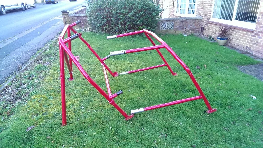

Cage removal. Front was a lot easier than the back to get out!

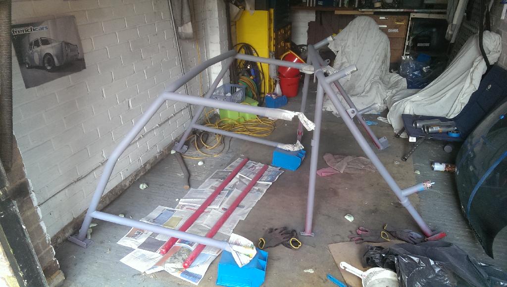

Getting painted
All ready to go

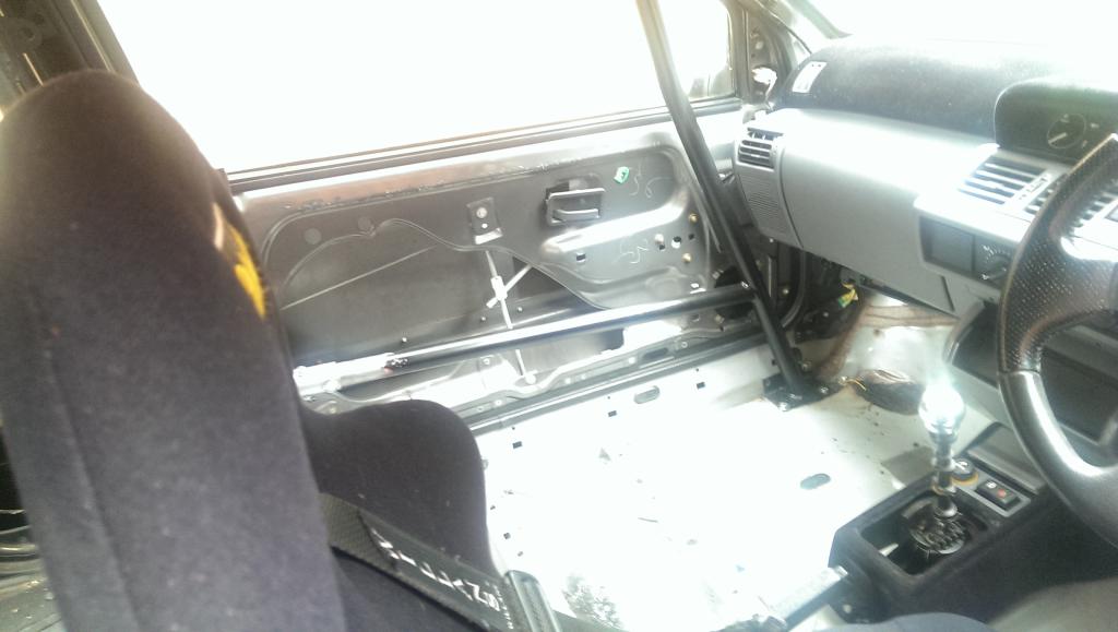

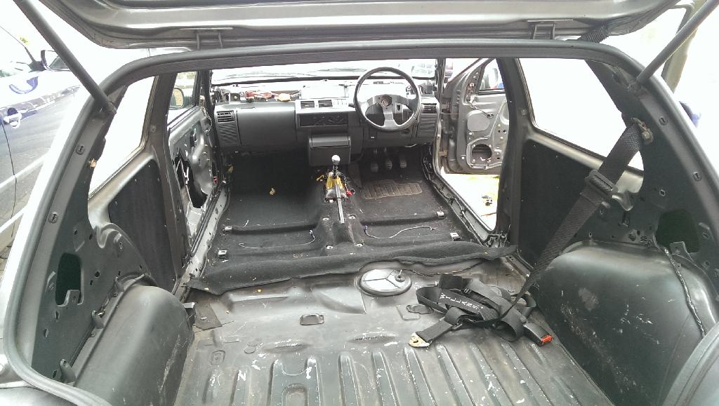

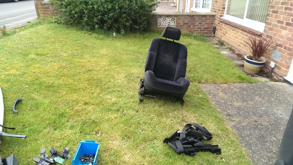

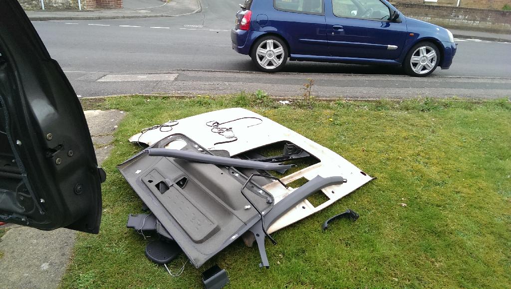

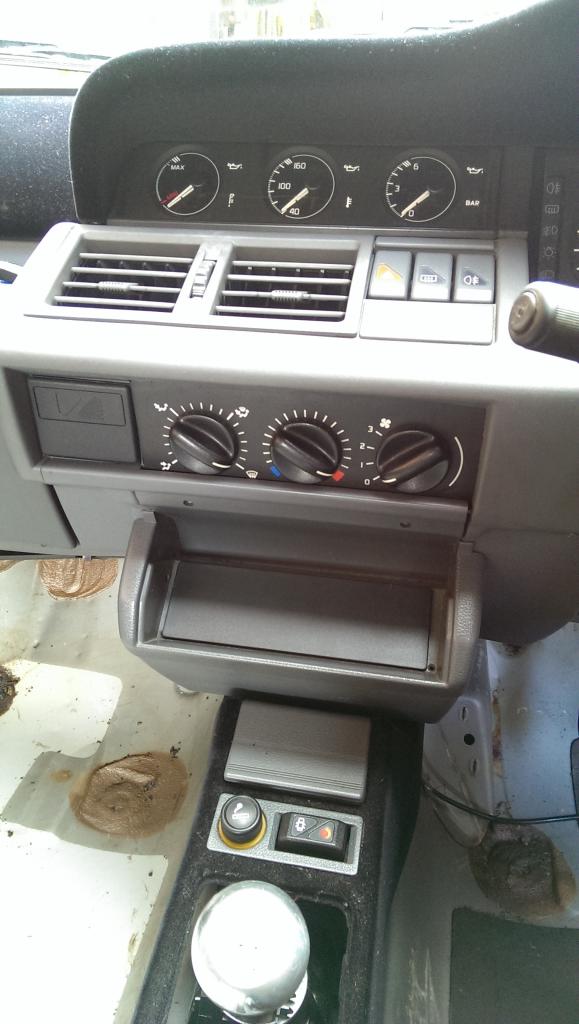

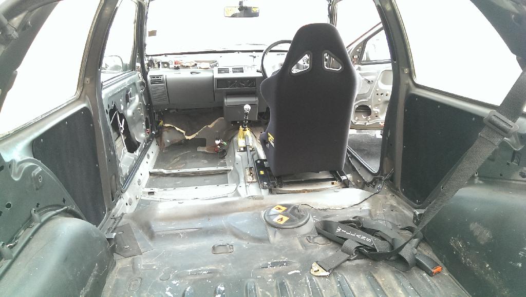

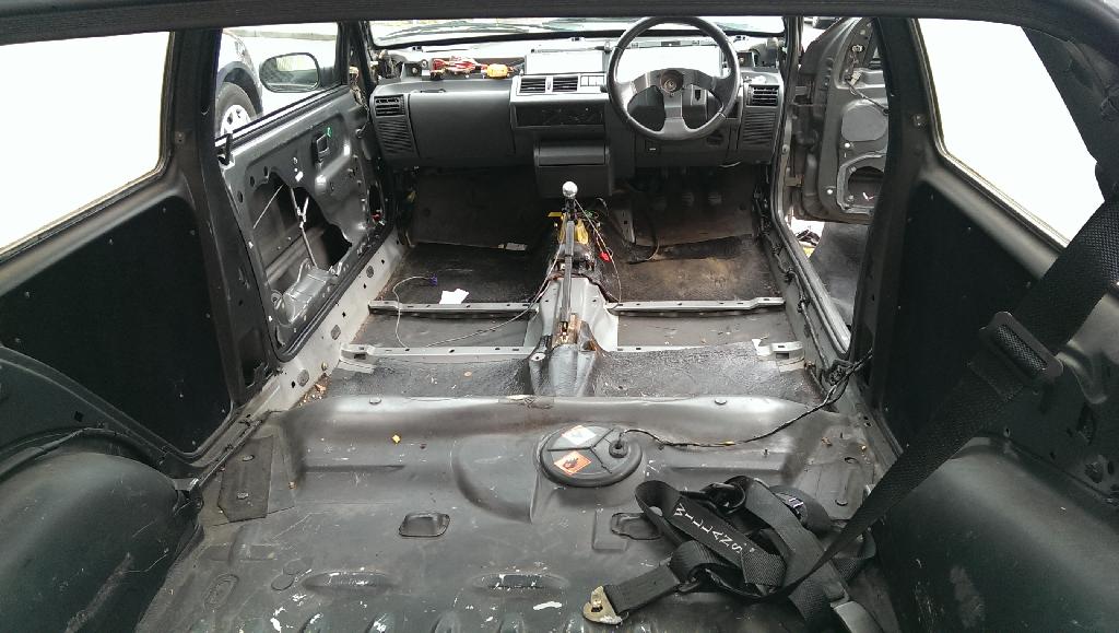

I then set about removing bits from the interior of the car that wouldn't be needed. Standard seats, door cards, carpet, roof lining etc all had to go.
This underlay foam stuff under the carpet was soaked through! No wonder I was having a bit of a mould problem.
Still finding glass from when someone put the rear window through
It was a fond farewell to what are one of the comfiest seats ever made. I'll be keeping the drivers to sit on in the garage and the passenger one is going to be made into a computer chair hopefully.
I then loosely bolted in a subframe and bucket so I could move the car around still.
This week I'll be doing a final few like tidy wiring, removing trim clips etc bits and then the cage can be put back in and bolted in place. Should have some more updates soon.

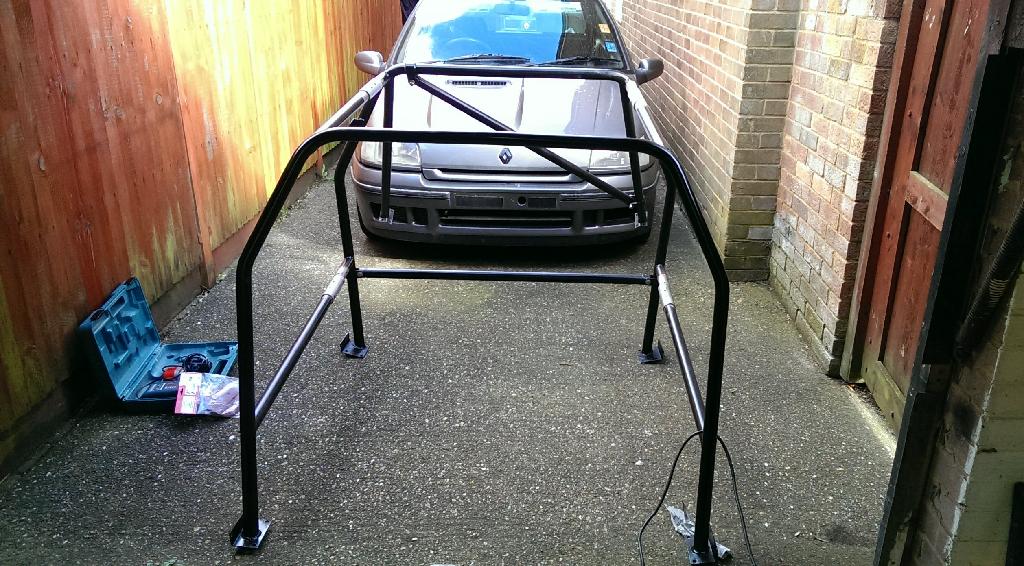

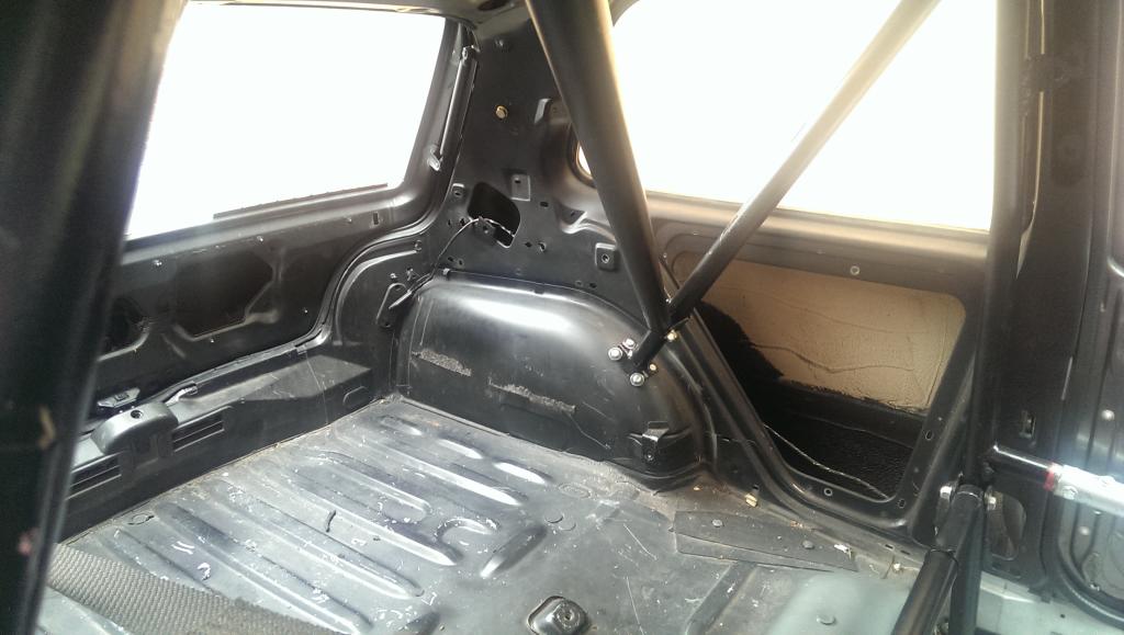

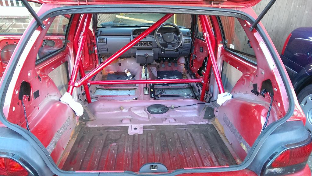

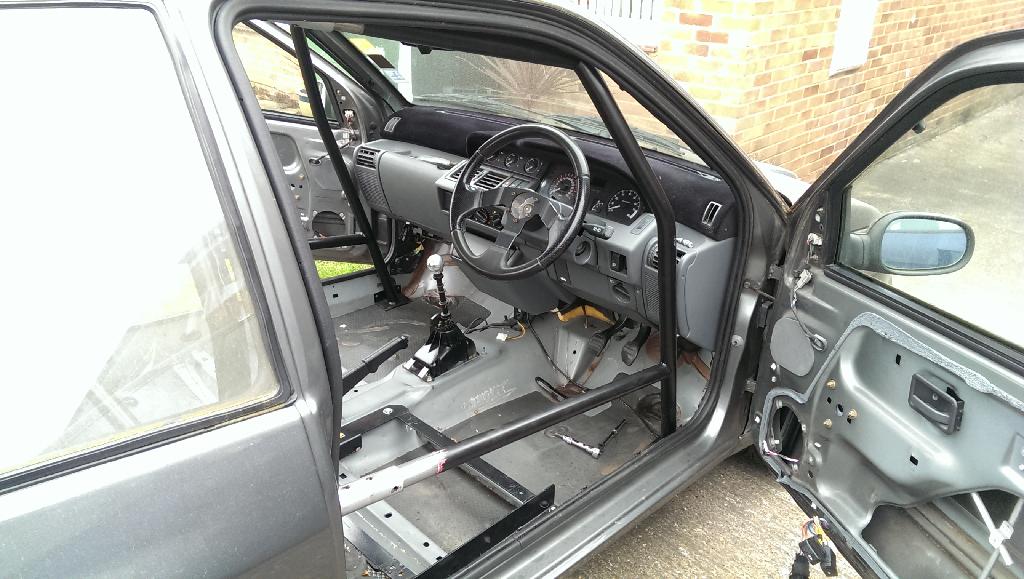

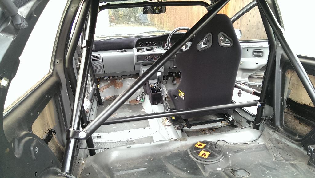

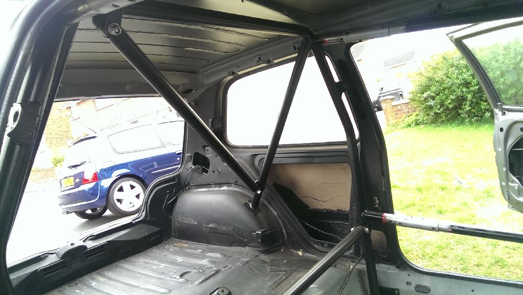

Cage is now in ready to be bolted in place. It seemed a lot easier to put in than it was to remove, think we got our angles wrong when taking it out. Gave the gear surround a quick paint and then replaced the top dash and centre console, window switches will be going where the stereo goes as the standard door cards clashed with the door bards on the cage.
Things to do:
- Bolt cage in place
- Fit passenger seat
- New pads and fluid all round
- Fit a normal exhaust
- Get the sills welded up/replaced
Shouldn't take too long to get it ready, most time consuming part will be having the sills patched up and painted etc.

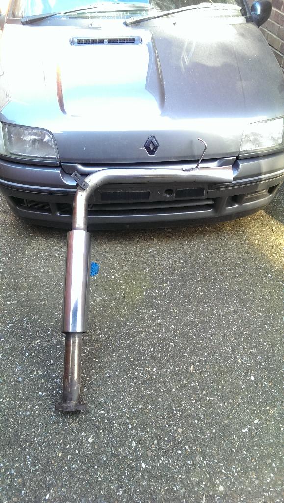

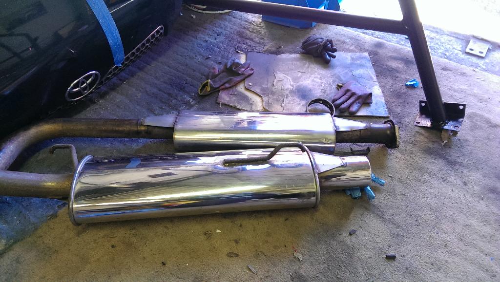

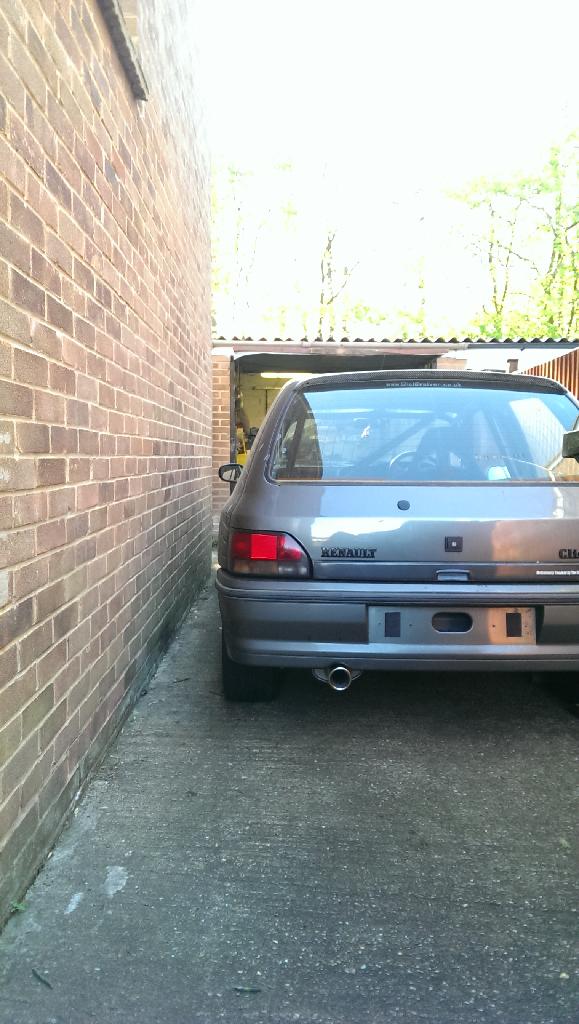

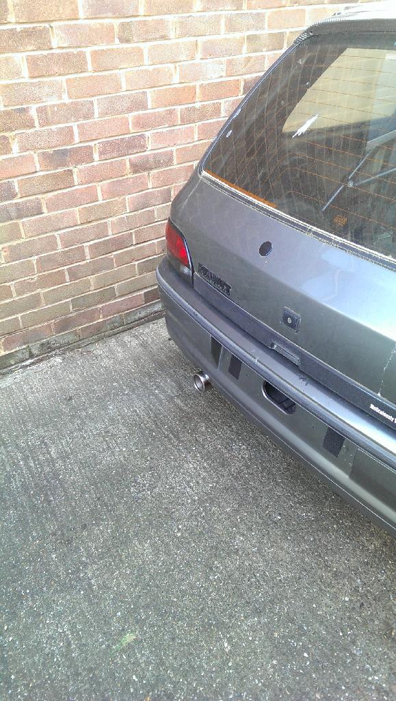

Finally had to say goodbye to the side exit today :( been on the car since I've had it and i will miss the sound but it just wont pass noise tests on track. Had to cut the cat to exhuast bolts as i hadnt had them off for years but other than that all came off easy.
Sidey is off!

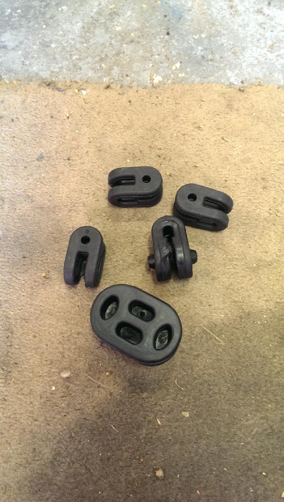

Bought an assortment of new rubbers as i cant remember what keeps a standard one in place
The replacement catback system on (think its a magnex)
Seems very weird to look at the back of the car and see an exhaust now but I'm happy with the size and how it sits. Will get a video for comparison purposes this week sometime.

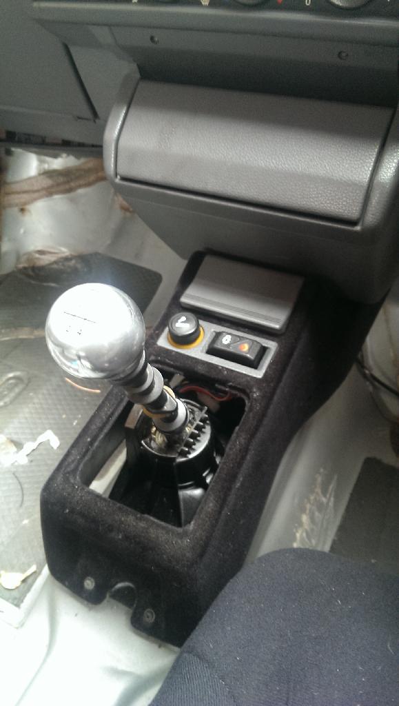

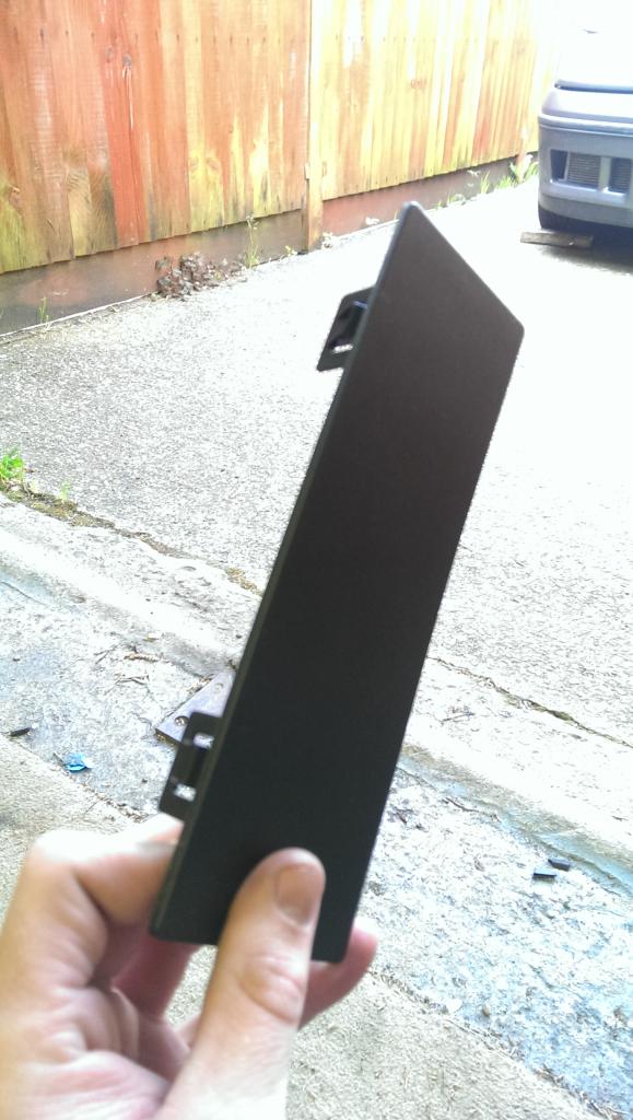

Bought a stereo blank for a few quid from ebay, should house the window switches quite neatly. Looks like moving the wiring could be a fun job tho!

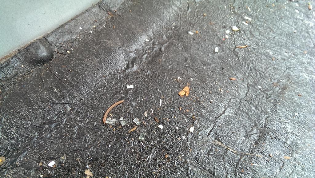

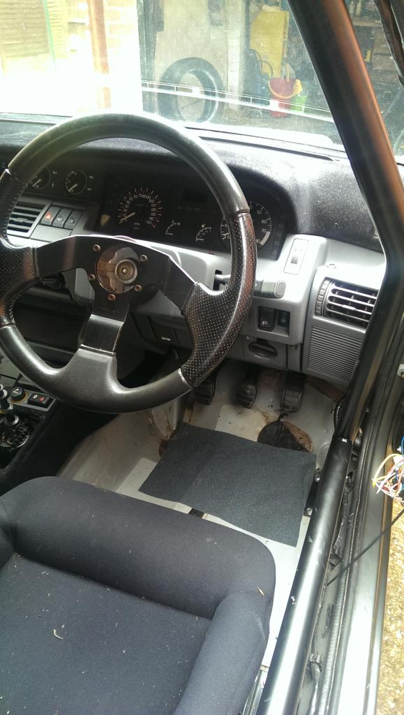

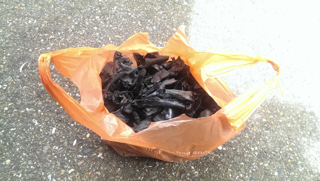

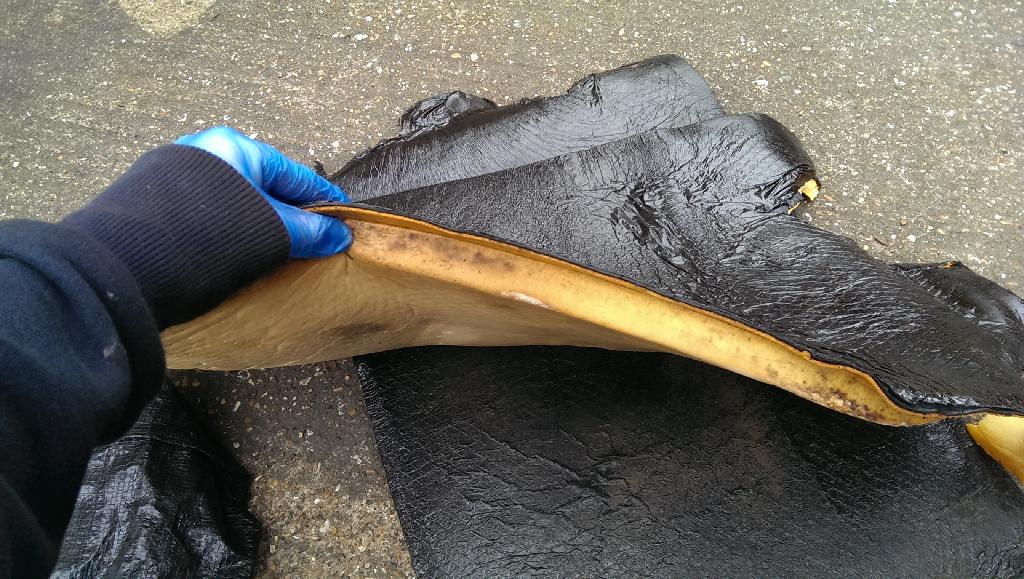

Finished scraping the last of the tar from the footwells and started laying down some grip tape in its place.

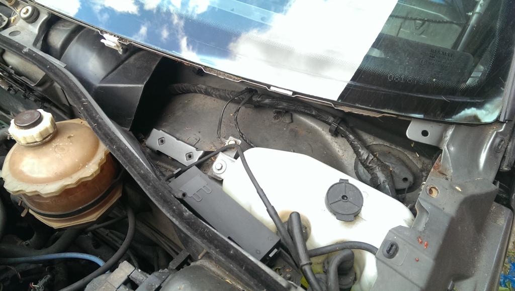

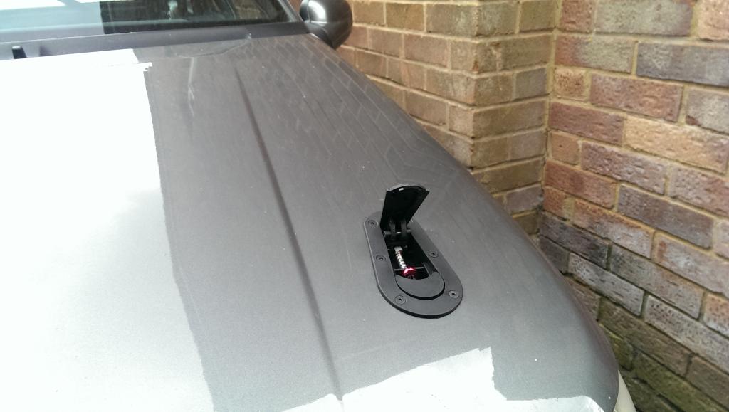

Ripped the old alarm siren out as it was driving me mad! Every time the battery was connected it would go nuts and drain it, none of the various keys turned it off despite it never working the previous years ive had the car, plus its more weight saved i suppose lol.

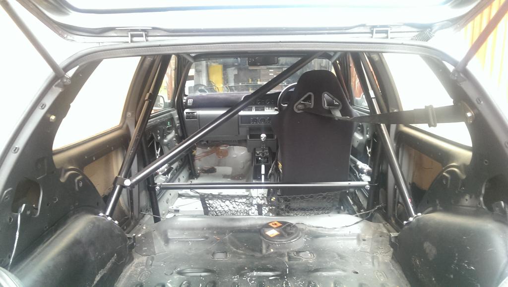

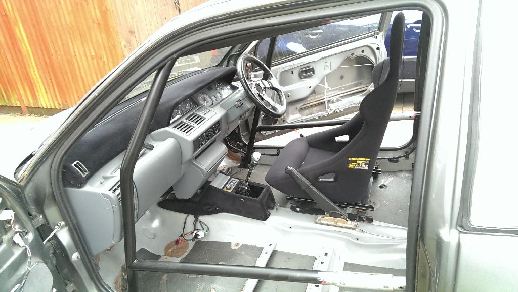

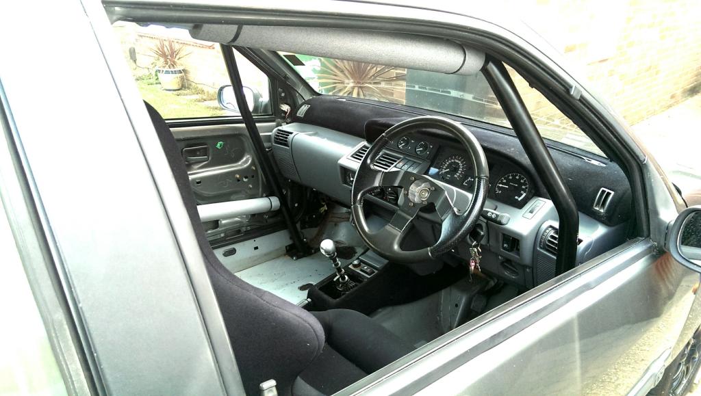

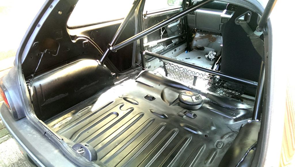

Got the cage all bolted in place at the weekend, all except some bolts at the front which must have gone through the sills on the original cup cars but these will be bolted when the old sills are chopped off in a few weeks.

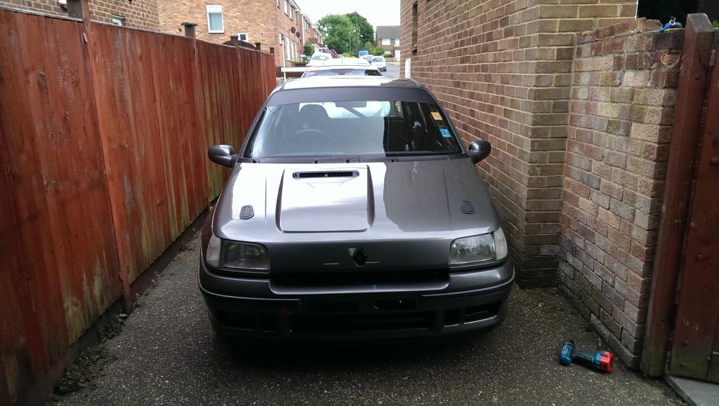

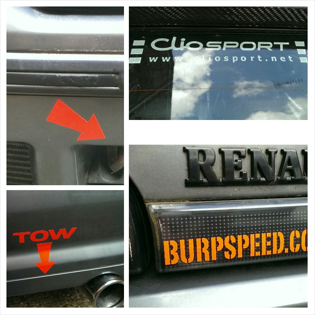

Never got around to fitting a sunstrip on the previous car but wont be making that mistake again. Tow arrows and a few other stickers fitted too.
As it stands at the moment
Going to the bodyshop in a few weeks time to have new sills fitted plus some work on the drivers rear arch, once its back it'll be fitting new discs/pads/fluid, bolting in the passenger seat and then time to get to some track days! Really cant wait to drive it again now!

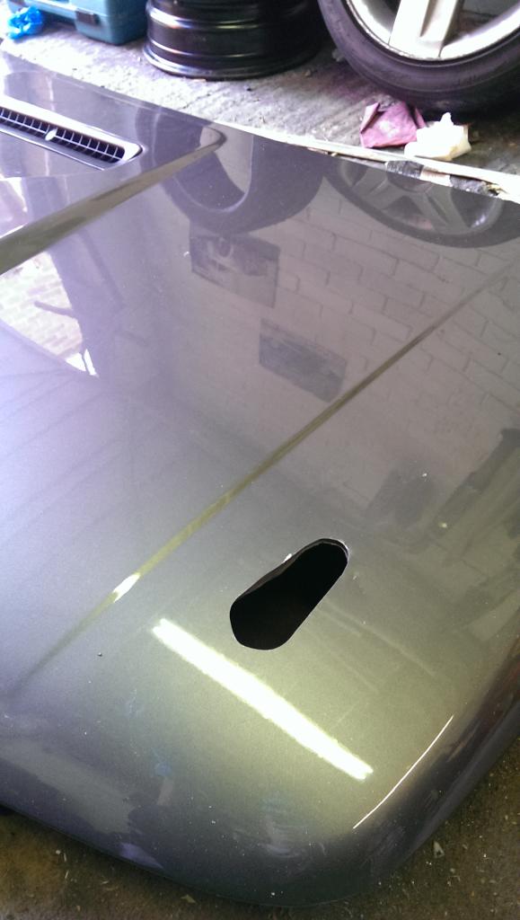

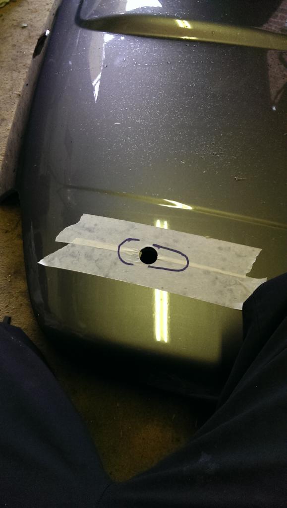

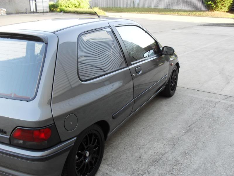

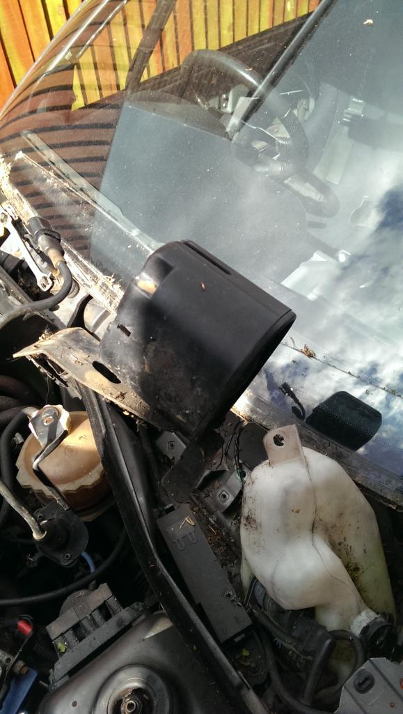

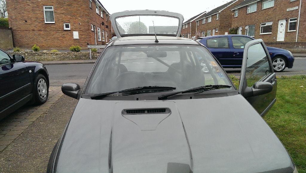

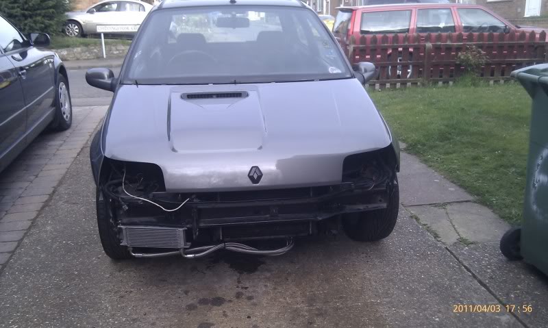

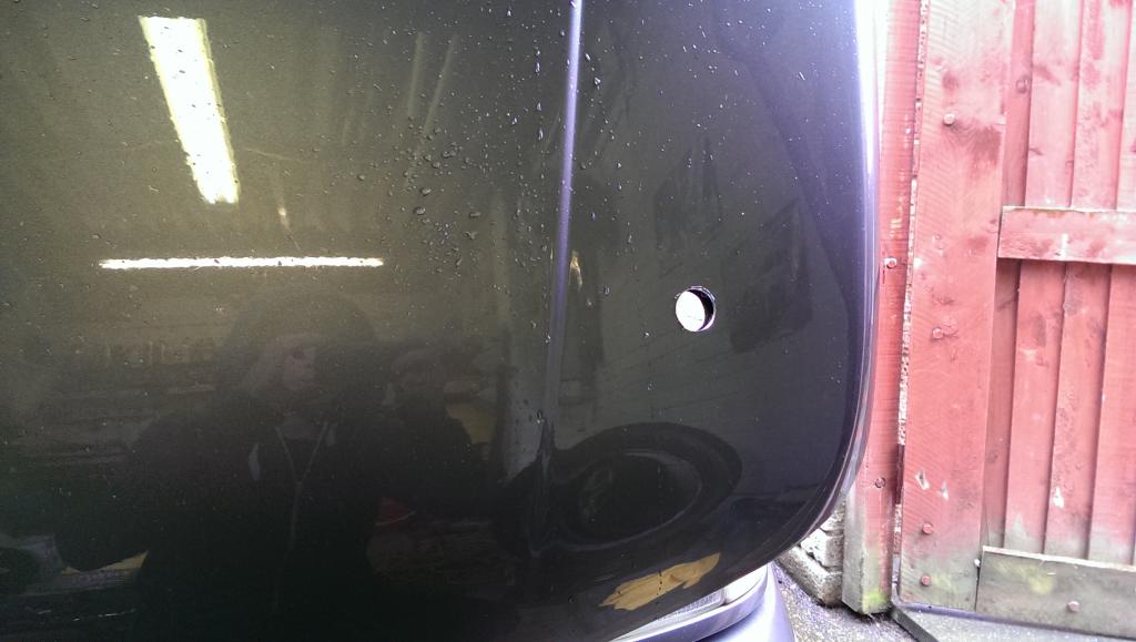

Still waiting on a date for the work to be carried out at the bodyshop so thought its best we tackle the bonnet catches this weekend, quite a time consuming job in the end trying to get it all lined up properly but got there in the end. Will make working in the bay so much easier.
No going back now...
Masked and cut out
Pins in (had to hack the back of the headlight off to get them far enough over)
Done!
Also gave the rear interior a quick re spray to cover all the chips and scratches and refitted the flocked rear panels, much neater.
Before
After

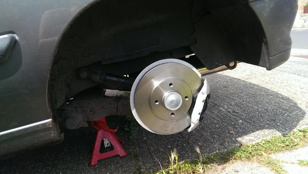

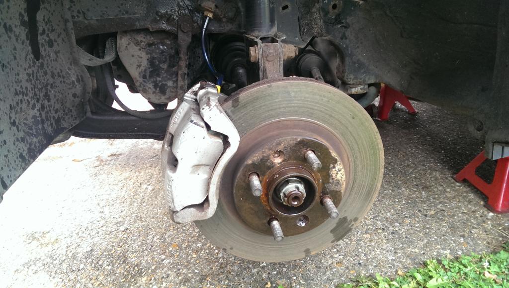

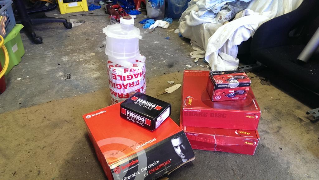

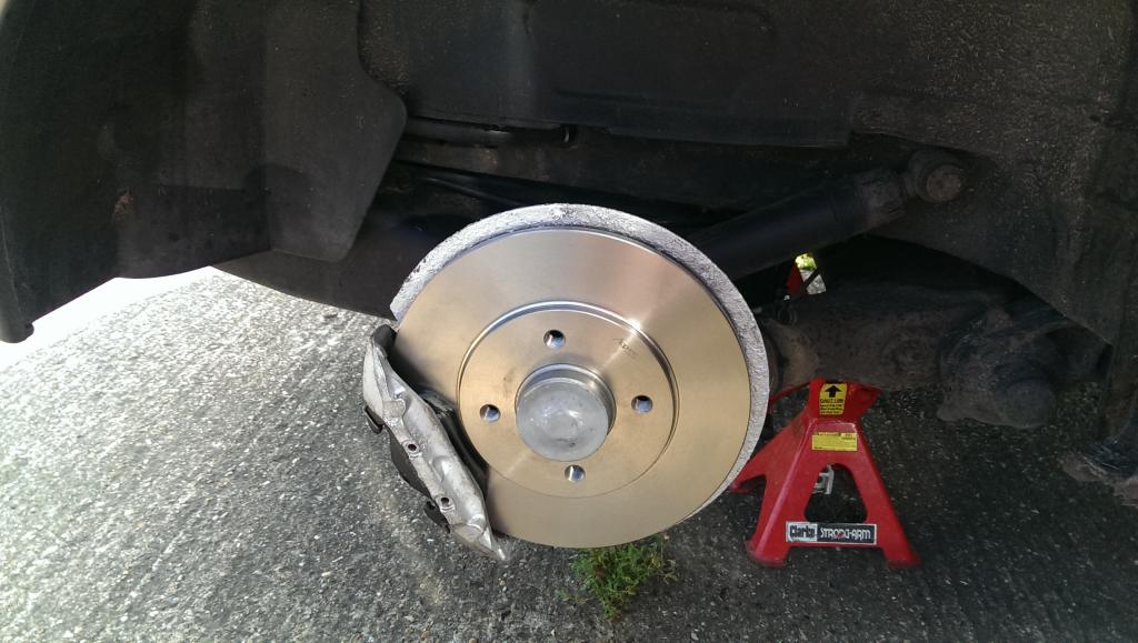

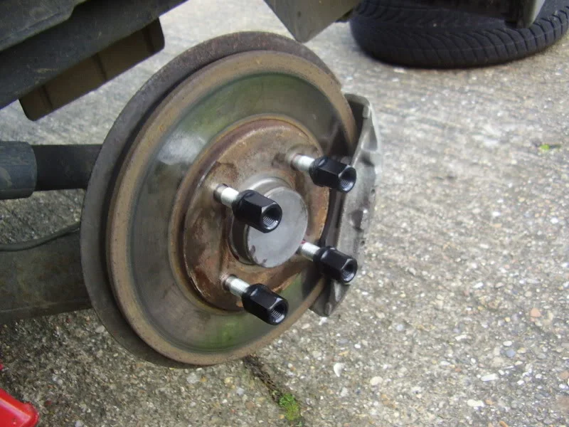

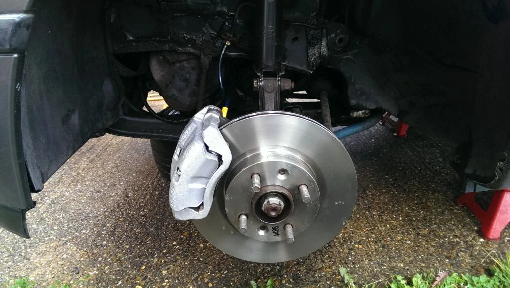

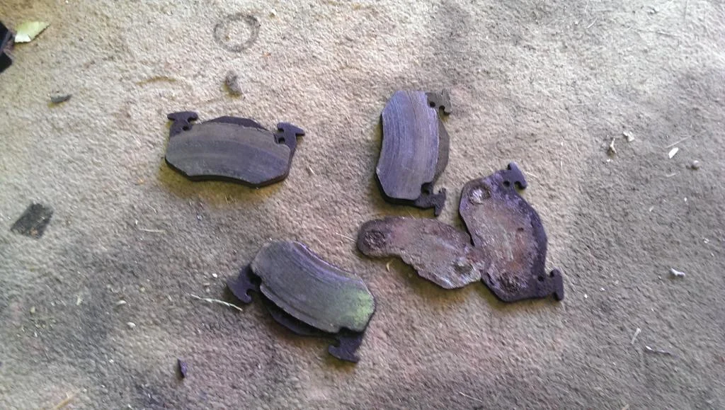

New brakes fitted this week. Got slowed down by the weather and one rear caliper being held on by 5 sided bolts..wtf!? Managed to smash and old spanned over them tho and replace with some normal bolts. Car is insured now so not long until its on the road and hopefully in time for a Brands evening on 6th august.
The old front pads had plenty left on them but were only Ferodos 'fast road' ones so replaced with DS2500, rear brakes were knackered all round lol.
Old fronts
Rear pads

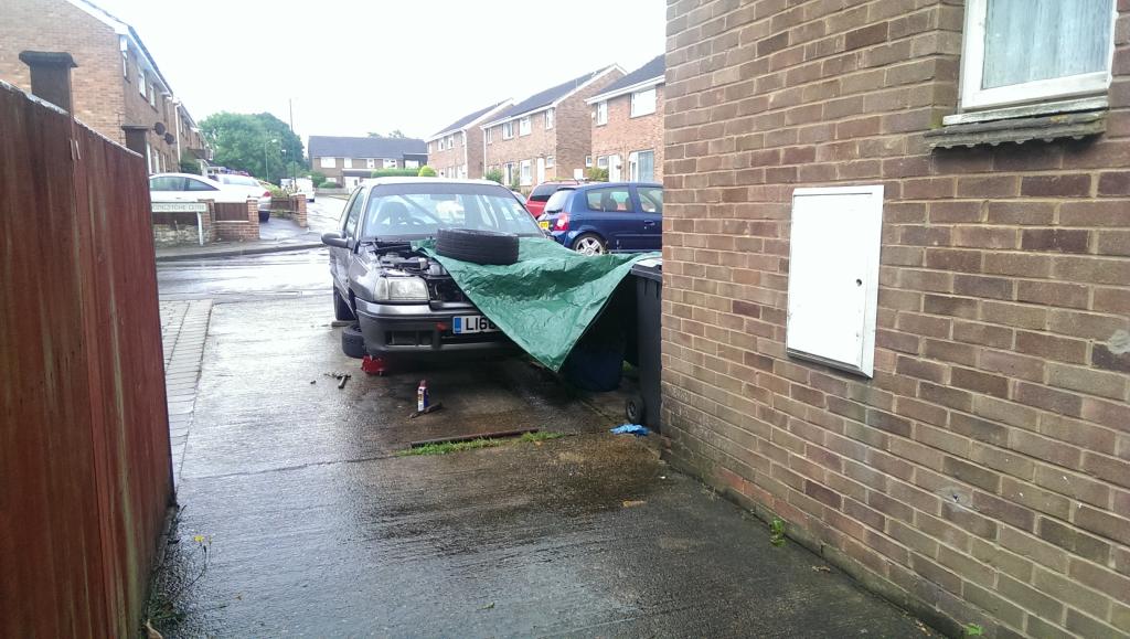

Shelter from the rain
New brakes
Some randoms I took while working
Just need to fit the braided rear lines and bleed the system with new fluid now, far too hot outside for that now tho!

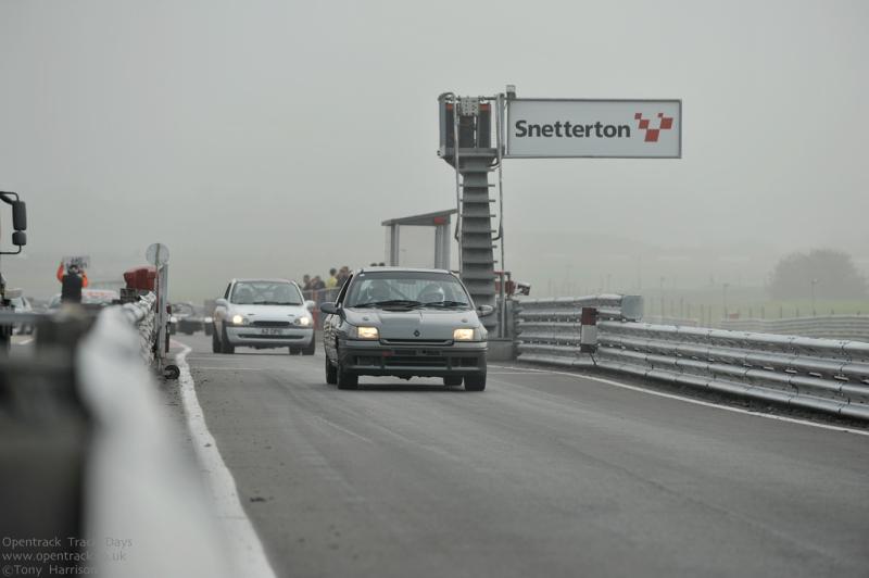

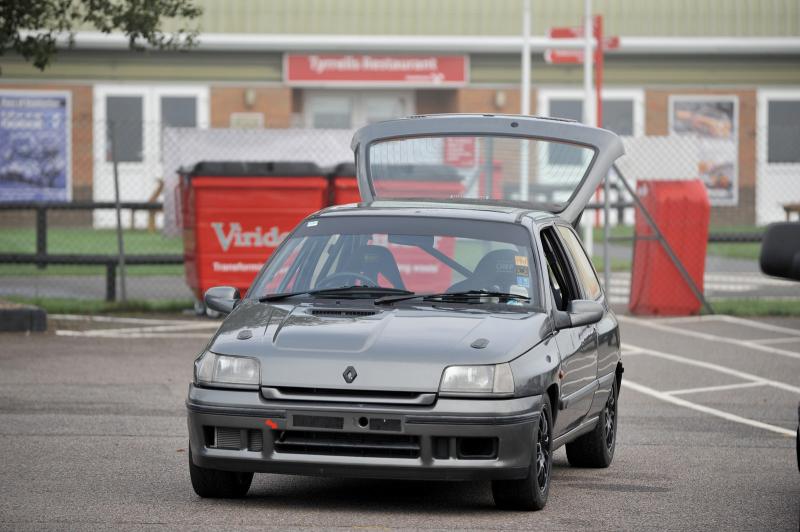

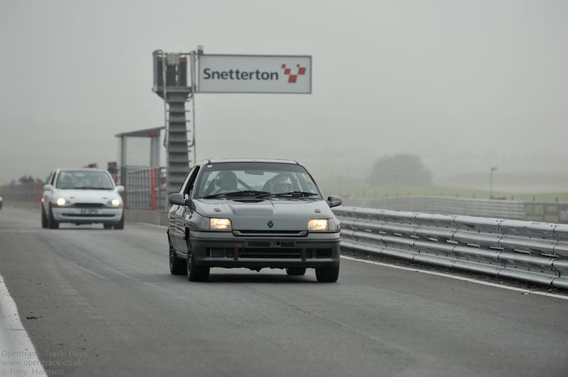

Our first outing with the car would be Snetterton booked with Opentrack. Had never driven snetterton before so was looking forward to it, up until a few days before when i caught the flu! So drove up the night before and got no sleep as I couldn't breathe, woke up early and drove to the track in dense fog!
We were meant to be out on track at 8:30 for sighting laps but I think it was around 11 by the time we actually got out due to the near zero visiibilty. Managed to still get in a decent amount of track time and some tuition while consuming box upon box of strepsils and really enjoyed the day.

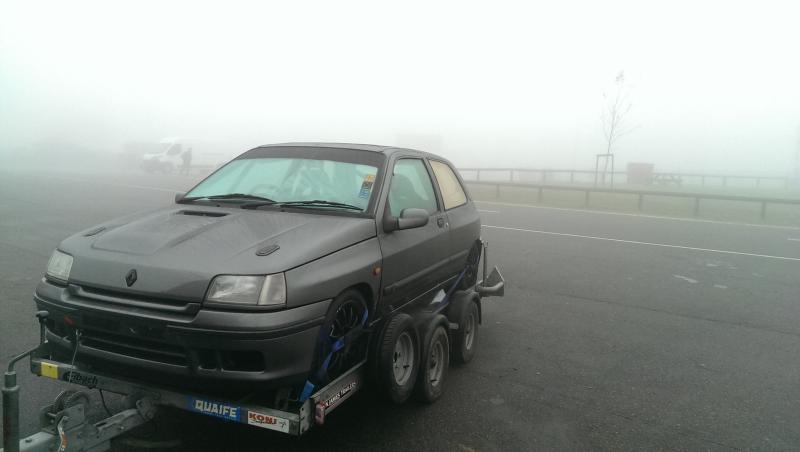

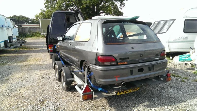

Car performed perfect all day until the last session when the thermostat to the oil cooler must have opened, highlighting the fact one of the hoses had split. So we loaded up and set off home, a bonus being the tow van has a bed which i slept in most of the journey from Norwich to Kent.
Loading up at the trailer storage
Foggy much?
Some pro pics from track
And the view from the comfort of a double bed lol
