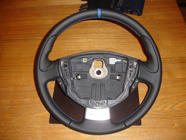

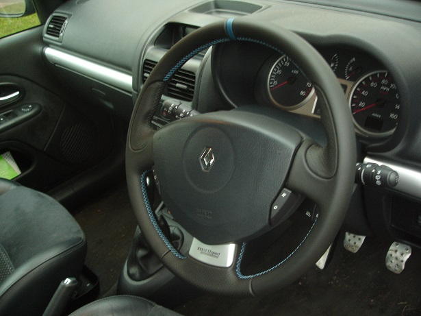

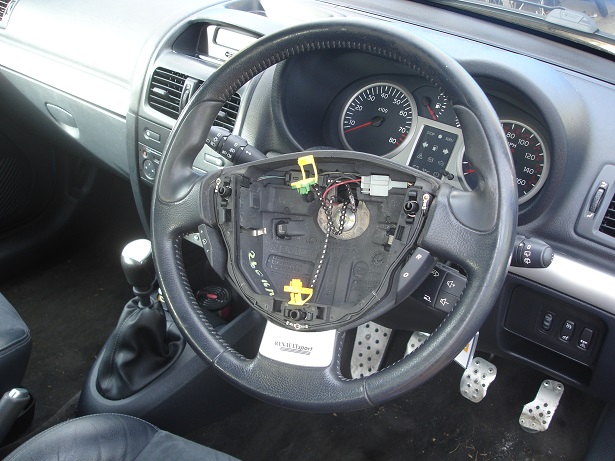

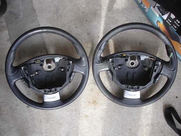

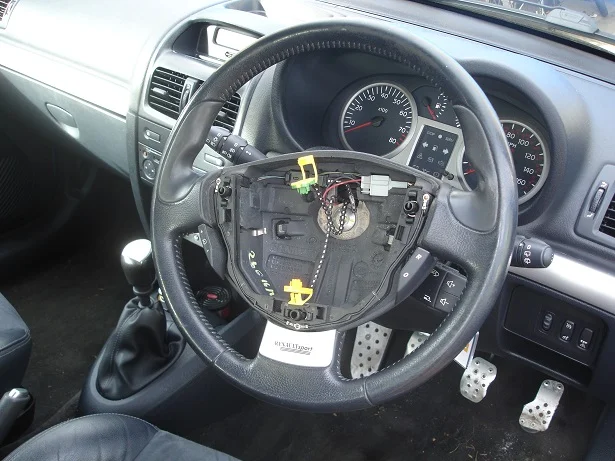

After the new year, the first thing done was to get a repair on the worn steering wheel, so it was sent off to Snappy on here for a refurb, what a difference this made to the interior, the work is absolute quality! At the same time a MAD aluminium footrest was also bought off eBay, this was another small touch that makes all the difference.
Worn wheel coming off:
Spare wheel on right to do in meantime:
The finished article:
And fitted back together :grin:

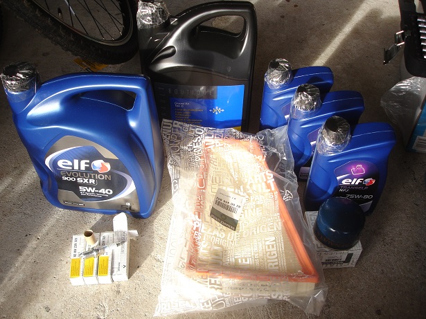

Forgot to mention at the start that I bought the car on 77,000 miles, well the mileage had now gone up to 82,000 by February and the last full service on 72,000 including all the filters etc, had been nearly a year and a half ago, not counting the minor oil & filter replacement carried out by DTM on 77k, so I figured it was time for another full service before it went in for its MOT on the 16th. Got all the service parts off here from Renault Wolverhampton and the brake bits from G172, great service from both guys and both really helpful and quick with getting the deliverys out :up:

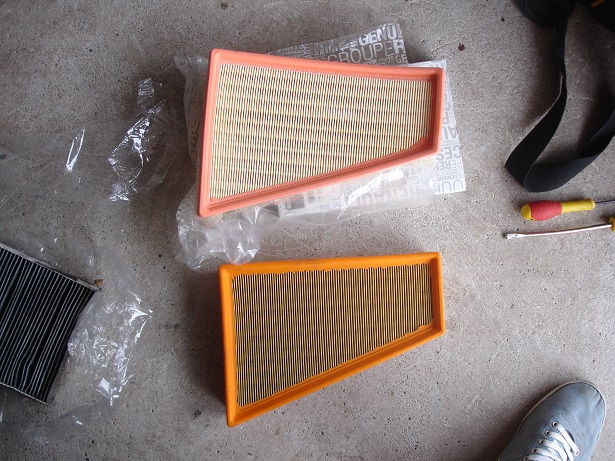

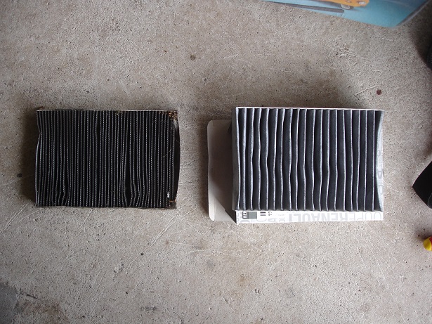

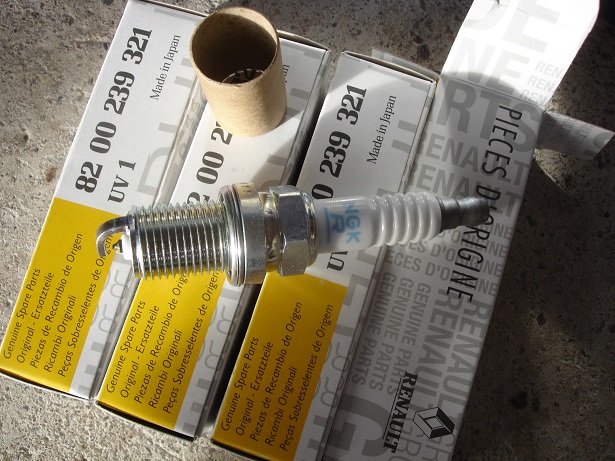

Service bits included 5ltrs Elf engine oil, 3ltrs Elf gearbox oil, oil filter, air and pollen filters, sump and box washers, NGK spark plugs and type D coolant. I also took the chance to fit a fresh coolant expansion tank since the coolant would be getting drained.
Nice fresh filters for the breathing!

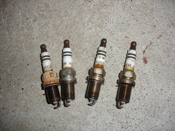

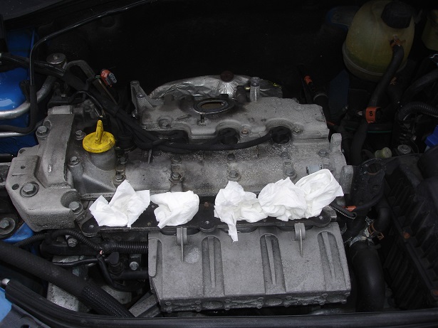

When changing the spark plugs I came across these, can only be a good thing swapping these out from what iv read on here! The one on the left looks in a much worse way than the other three, the one from nearest the oil filler end, and there was quite a bit of oil and grime on the rocker cover in the pic below so could possibly be oil leaking out from somewhere and making it into the plug hole, is this common??
The good NGK plugs going in

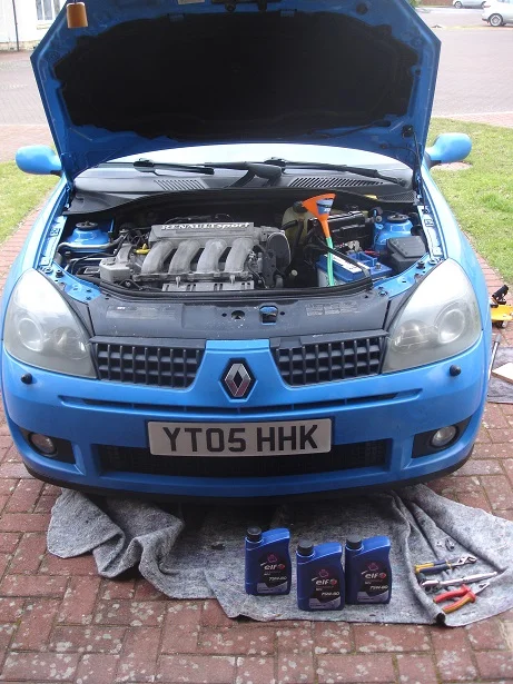

Gearbox oil getting swapped

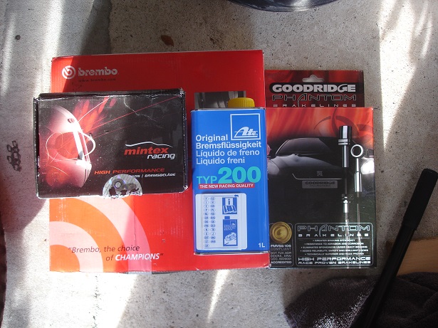

And the brake goodies below, went for Brembo HC discs and Mintex M1144 pads for the fronts, 1ltr flush of ATE superfluid, and Goodridge phantom braided lines all round, this meant the brakes were now spot on as Trev at DTM had already sorted the rears out with genuine discs, bearings and pads for me picking it up.
The plan was for me to change and fit all the parts over the weekend before I dropped the car into SWR on the Monday for them to put it through the MOT, but things didn't quite go to plan with time lol. They ended up doing the coolant flush and brakes in the morning before the MOT, which it passed with a couple of advisories which will need sorting... o/s/rear tyre worn close to the limit, slight play in a o/s/f ball joint, and a deteriorated steering rack gaiter. The next step will be for a full set of tyres asap as the previous owner has fitted a set of budgets on the rear with Nangkang's on the front, haven't read good things about either so will be looking to sort theses out as a whole set with probably some Michelin Pilot Sports now that the servicing, mot and brakes are all ticked off. After tyres I can start getting a look at getting some suspension parts freshened up.

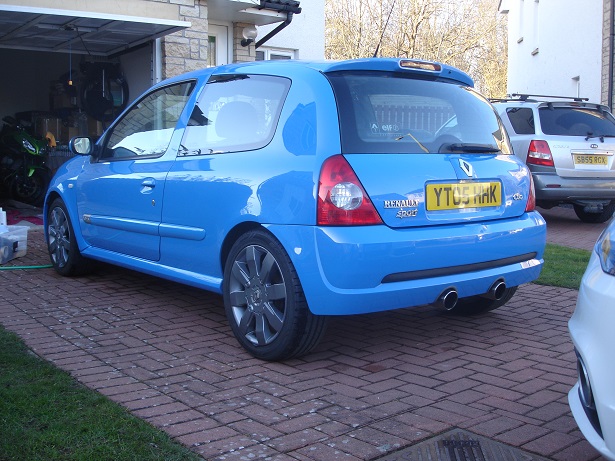

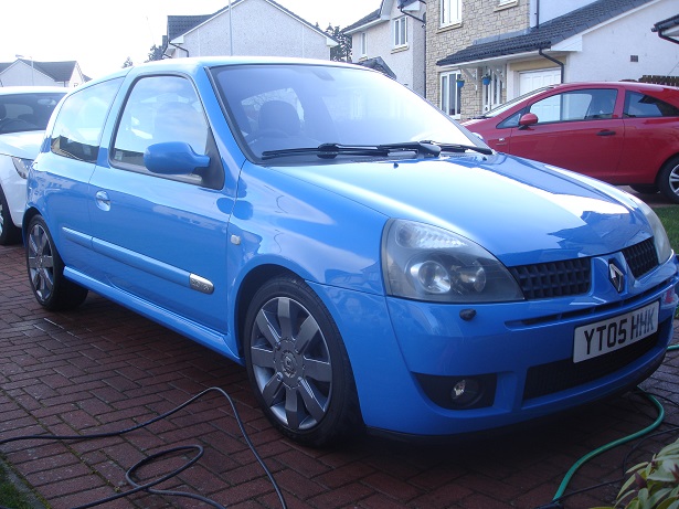

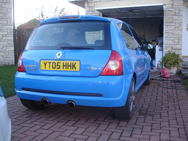

Last update to bring it up to where it is just now. Gave it a good clean once the first good weekend appeared since the winter. Came out quite well, going to give it a proper go in a few weeks, but for now it got washed, polished and sealed using Autoglym stuff.

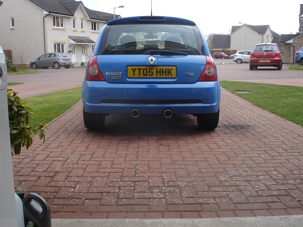

I then decided that the exhaust tips needed centred, they were sitting too far right and rattling off the bumper now and again, while I done this I also gave them their first proper polish with some Autosol, much shinier!

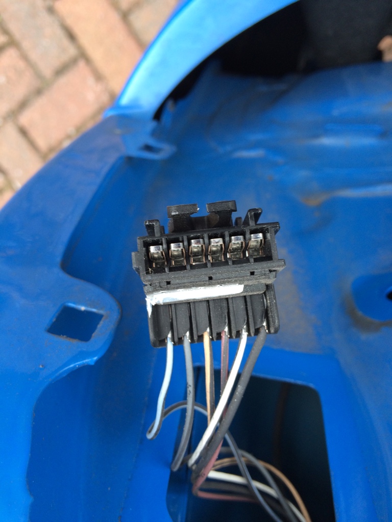

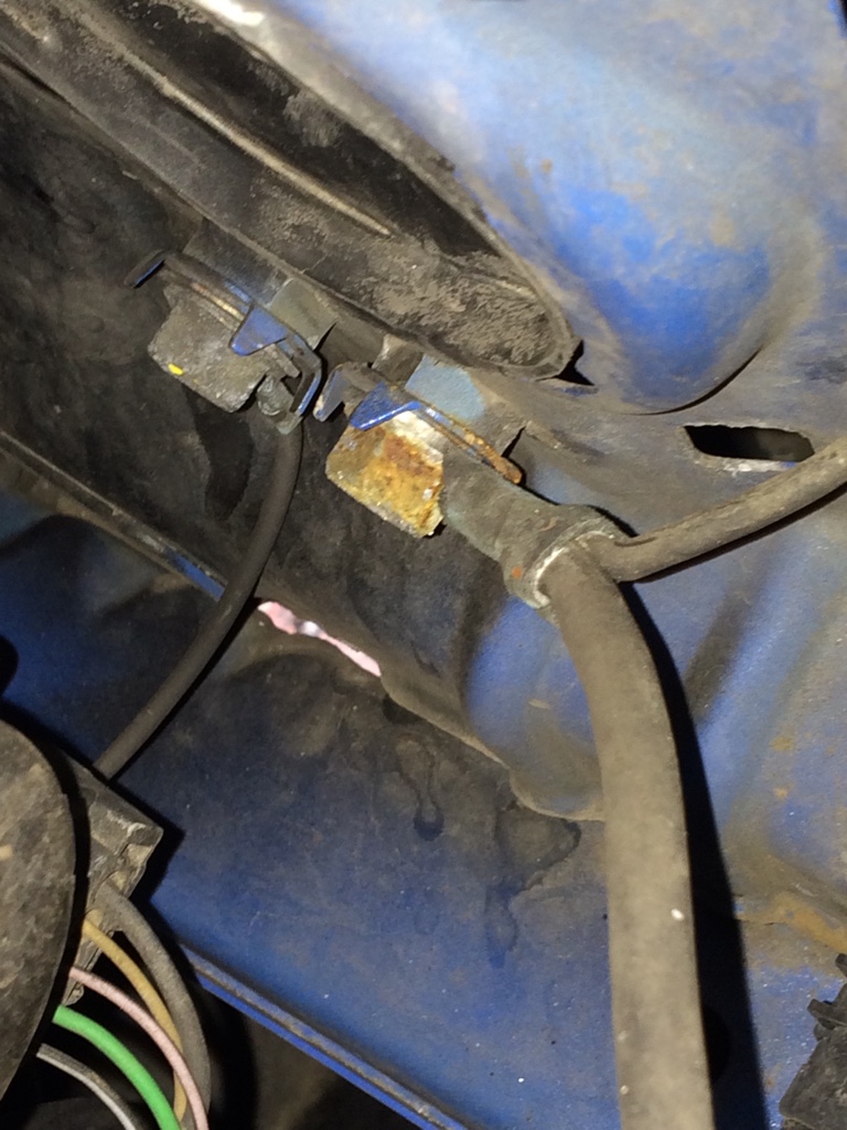

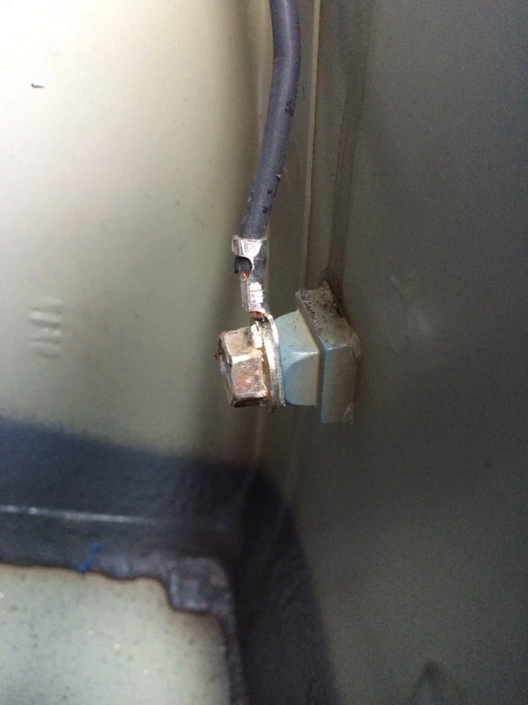

Next up was to try and get to the bottom of a few electrical problems iv had. At random times iv had intermittent faults that have came and disappeared very quickly with no apparent reason. Things such as one headlight not working to working perfect again next day, coolant temp gauge needle bouncing one day and fine ever since, really poor mpg/hesitant power one day suggesting possible lambda fault then absolutely perfect next day etc etc...
Also when I plug in the RSTuner it sometimes comes up with Shift Light Fault.
Thinking it could be an earth fault somewhere so started with the rear lights as these seem to be a common problem area but was surprised to see both sides were near enough perfect!
Battery terminals all ok as well, one connection behind the passenger headlight looks badly corroded however so will be sanding that down and cleaning it up then checking the gearbox earth after that as I see on here that can cause issues as well.

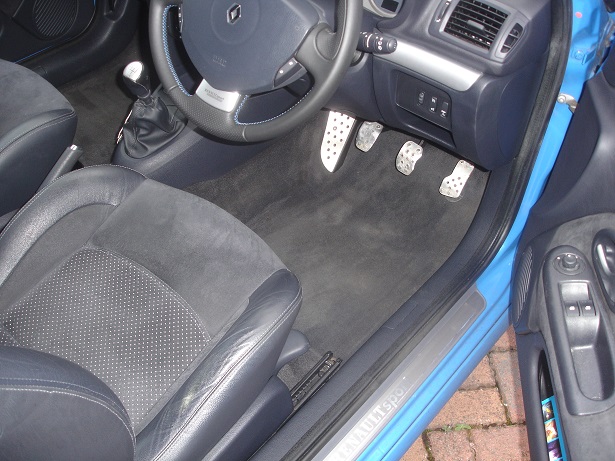

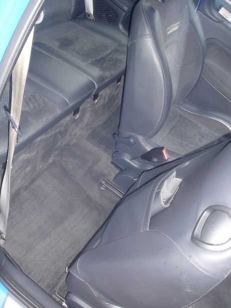

Spent a few hours today doing a few bits and that to the car, first of all gave the interior a quick going over as it hadn't been touched this year I don't think! Used Meguairs APC on surfaces and carpets then hoovered, pretty happy with the results for a quick half-hour job. Also got some mats ordered up, Renaultsport ones off eBay with old-school logos that tie in with the ones on the car, should be here Wednesday. Need to get round to cleaning the seatbelts at some point as they are letting the interior down at the moment along with the pedals, got a heel-toe accelerator plate ready to fit and just need to order up the brake and clutch plates to tidy that area up.

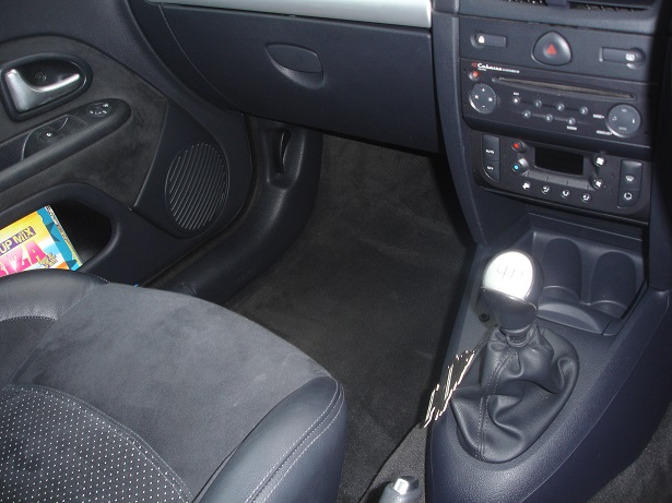

Few pics of clean interior

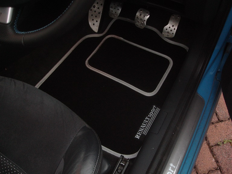

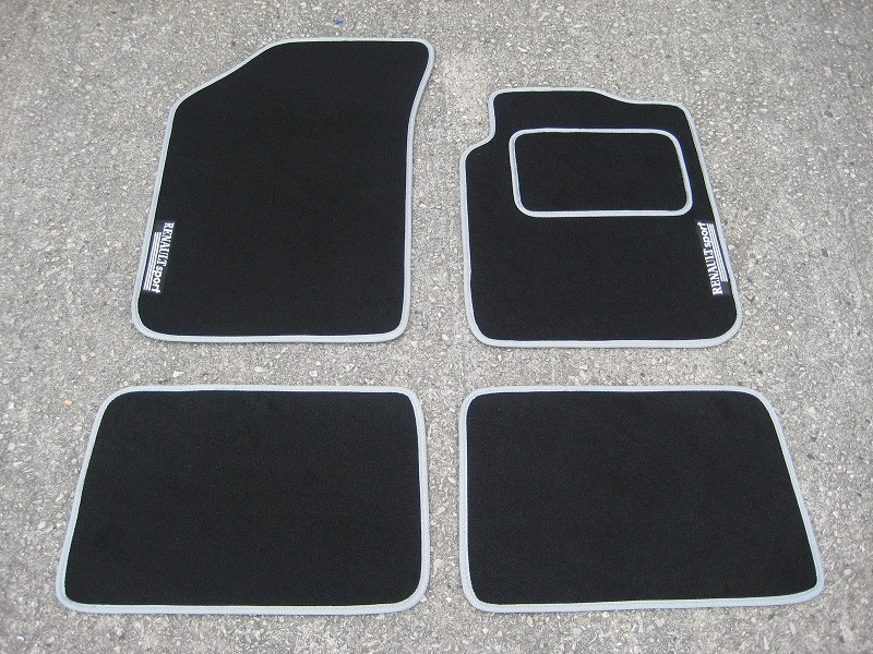

And the mats that have been ordered, should look good I reckon

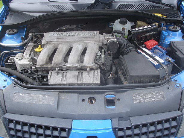

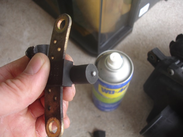

After the interior was cleaned I then removed the tdc sensor and gave it a clean up before re-fitting. Have been having a slight issue where it takes a second or so longer for the engine to fire when re-starting it hot after a lengthy drive, e.g. at petrol stations, nipping into a shop etc. Not really a problem as such, more annoying than anything but thought I would investigate anyway, cleaning the sensor seems to have had not much effect, dunno if this is a common problem or not!

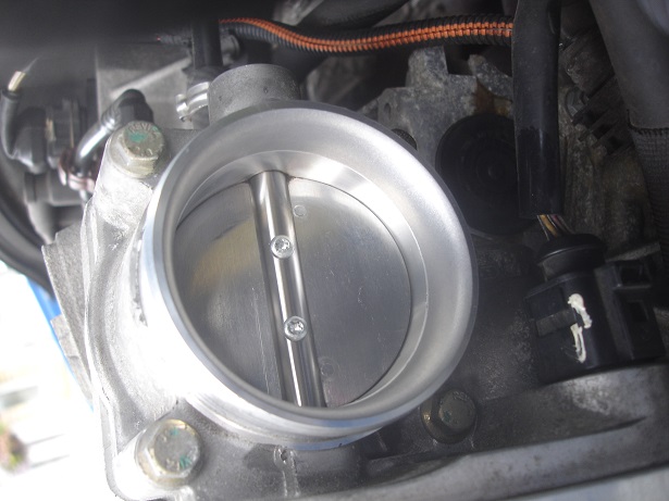

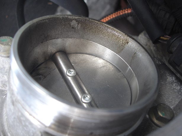

Whilst under the bonnet I also removed and cleaned up both sides of the throttle body, it was fairly gunked up with crap and sometimes the revs would stick slightly when slowing down at junctions etc. Cleaning it up has solved this issue so happy days as far as that's concerned
Everything cleaned up and put back together before taking it for a spin, also got my new slam panel seal fitted recently from group buy :smile: (think its sitting up slightly at the right from catching the airbox on it today)

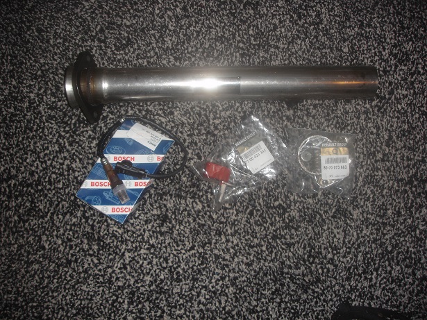

Next job is to fit the Milltek de-cat pipe that was recently purchased, just currently in the process of collecting parts and advice on here so I can sort the whole system at once and hopefully do it right first time and not have to mess around with it afterwards or bodge anything with cable ties etc.. So far got de-cat, new genuine Bosch pre-cat lambda, manifold to cat gasket kit and centre section hanger, just need to get 2x rear hangers and some high-temp silicone and should be good to go! Love the Milltek cat-back sound so the de-cat should sound even nicer I would imagine, got a resonated system so hoping its not gonna be too loud, cos if it is it might come back off lol.

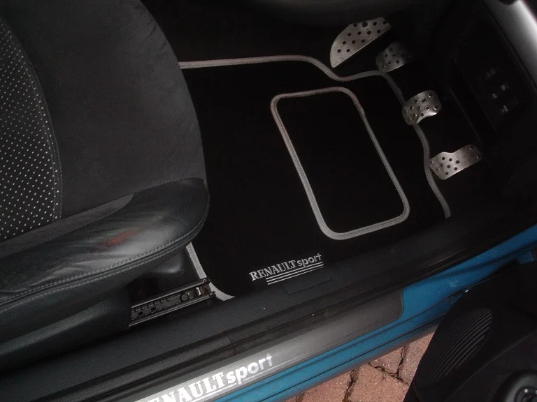

Mats fitted, fairly happy with how they look
Will look much better once the pedal plates are refreshed, and also plan to clean the seatbelts at same time, will be happy enough with interior once those jobs are done. There is a bit of wear on the drivers side bolster from the previous owner but cant see that being fixed any time soon, would love a set of Recaro's but the cost does put me off a bit at the moment, maybe try source a mint drivers seat from a car being broke if I get round to doing something about it!

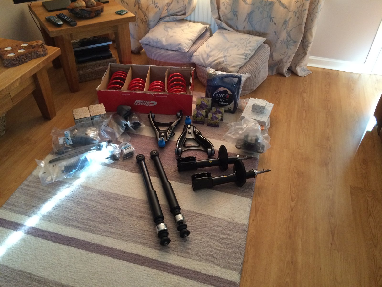

Well it's been a while since I'v added anything to this...not a great deal has happened since the last update. I fitted and ran the Milltek de-cat pipe for around 3000 miles but have just taken it off for the standard cat as the noise was a bit too much for my liking inside the cabin. Did sound epic on the outside, however the pipe will be up for sale as I prefer the quieter sound of just the cat-back system for cruising around. The Bosch lambda sensor in the manifold was also replaced at the same time as fitting the de-cat, along with all 3 exhaust mounts. Cat has just been re-fitted using a new genuine gasket kit as well so all good on the exhaust for now. The car has now ticked over onto 90,000 miles as of yesterday and goes in for its yearly service & MOT at SWR in Stirling on Wednesday...at the same time a full suspension re-fit is being carried out! A pic below of all the parts that will be getting fitted:
Genuine Renault parts -
Cup wishbones
Cup shocks
Dust covers
Top mounts with new spacers
Inner tie rods
Track rod ends
Upper gearbox mount
Upper engine mount
5ltrs elf 5w40
Oil filter and sump washer
Air filter
Cabin filter
Aftermarket parts -
Eibach sportline springs
Powerflex inner and outer ARB bushes
Powerflex steering rack bushes
Powerflex rear beam bushes
Powerflex dog-bone mount bushes
Once all that is on it will be given a 4-wheel alignment as well, really can't wait to get the car back with that lot fitted, get it detailed and enjoy driving it over the summer! The only thing I would like to have added is some Eibach spacers but funds wouldn't allow it at the moment, maybe in the future!
