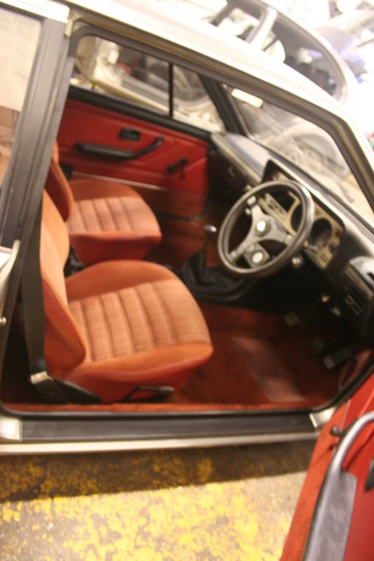

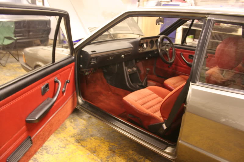

With all the wiring sorted it was time to get the interior out of my bedroom and into the car. Its the first time ive seen the full interior in the car and its made it feel like a car again. just needs a few niggles like lower dash trays to finish it off (poor pictures sorry) :eek:

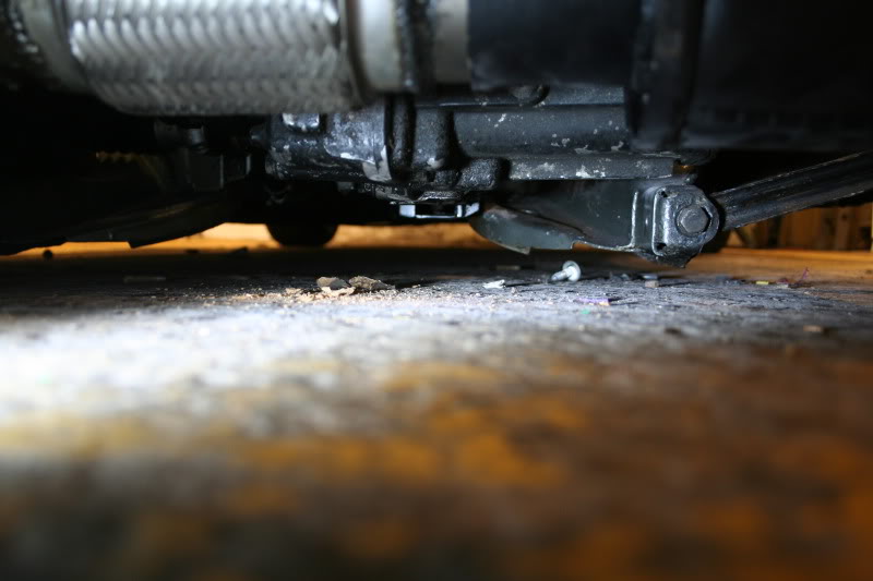

I had a custom lower gearbox made by a local lad called Arun he has the sickest Mk1 Golf. The mount now sits alot further away from the ground. :cool:

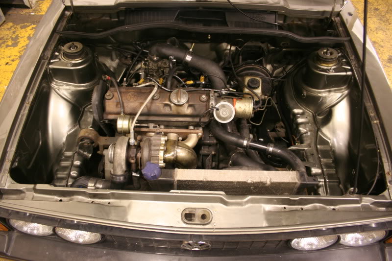

I have spent most of my evenings this week in the engine bay finishing off the looms, wrapping and stashing them. This also included relocating the coil and ignition amp to the scuttle tray. To say im glad its over is an understatement but it was deffo worth the hassle.
A standard R5 GTT carb will take a 1 bar of boost on the standard jetting.. If I go above a bar my mate Rob said he will bore out the jet for me. but I indend to run it at about 10-12 psi to make sure it gets to edition38 then after that the boost is getting wound up, Ive got mates with a Mk1 1.8T Van and a Mk1 G60 2 door Jetta to show whos boss. ;)
