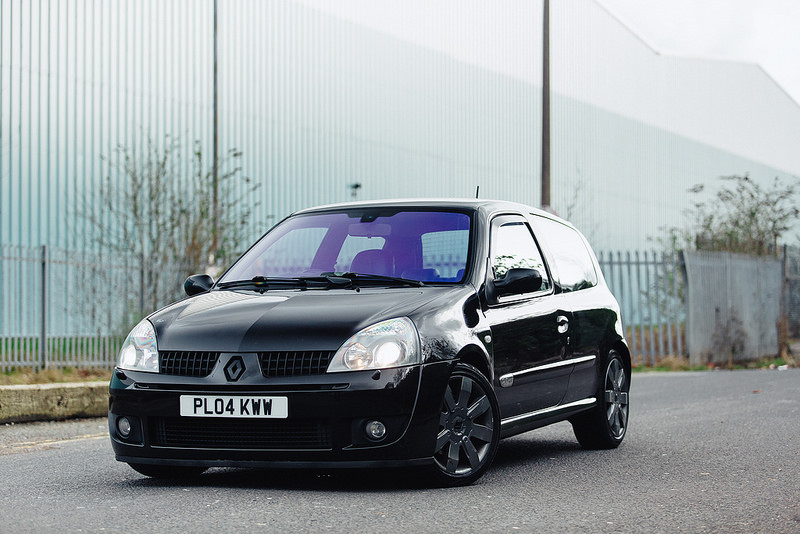

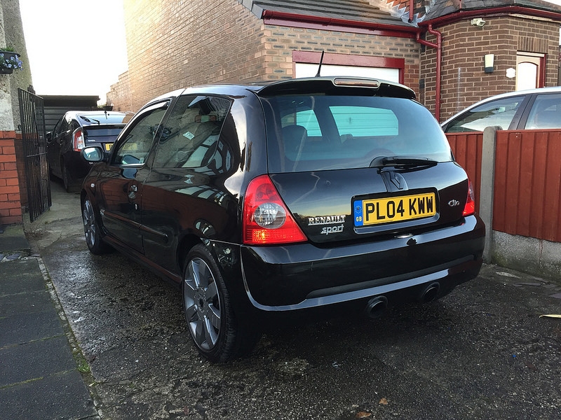

Thought it was about time to start a project thread for my car.

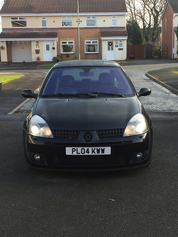

Bought it back in late November looking like this:
BG 182
by Niall97, on Flickr
BG 182
BG 182
BG 182
Not ideal, but the important bits were all good. Belts done by Engine Dynamics, box is fine etc.
Cosmetically it wasn't the prettiest, a number of age related dings and marks, but most of these are easily sorted out with some TLC and relatively little money.

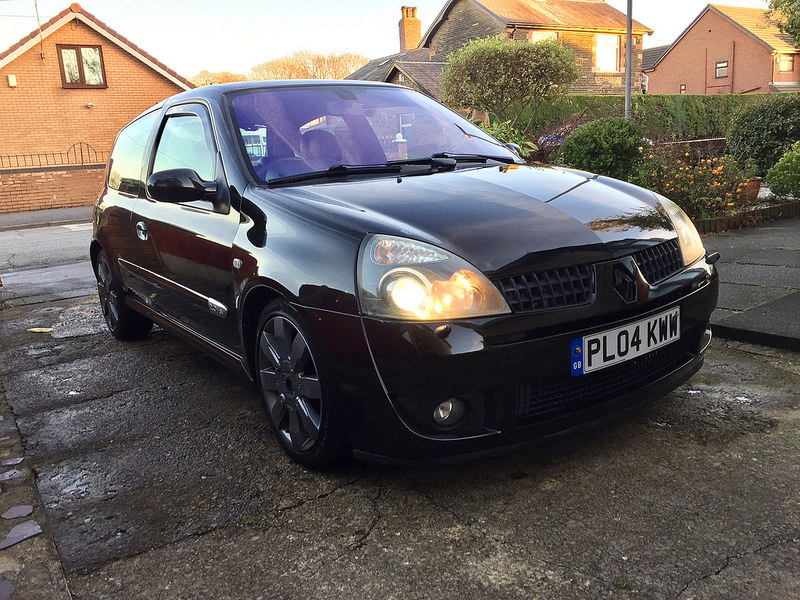

Got it home, and set about ordering some of the basic CS bits to tidy it up:
  • KTEC Induction kit
  • Custom 3/4 plate and plain rear plate
  • Phillips Silvervisions
  • Bosch Aero front wiper blades
  • Bosch rear wiper

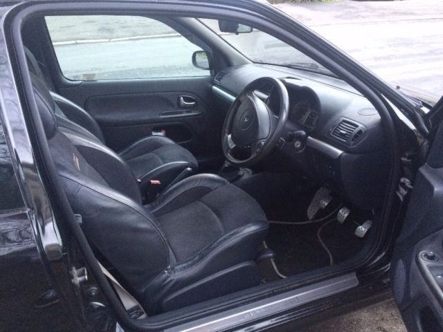

  • Dash strips/wheel trim and gear knob insert back to original plain silver 182 ones from the 172 ph2 ones it had
  • Debobbled the seat/doorcard alcantara
  • Removed the awful 'Renaultsport Clio' etched vinyl stickers in the rear windows
  • Added a CS Sticker
Before:
BG 182
BG 182
After:
BG 182
BG 182

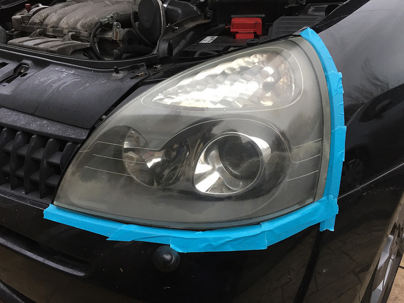

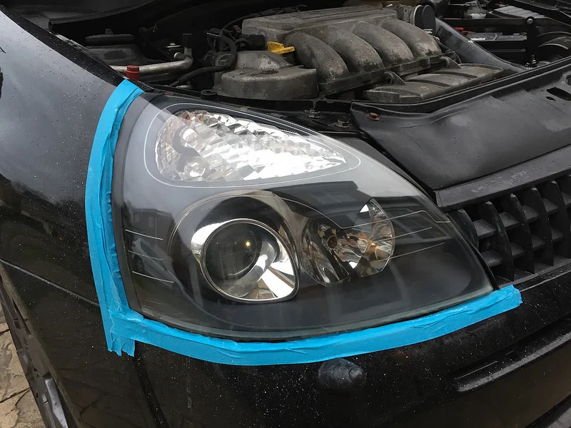

  • Restored the headlights with an Autoglym Headlight Restoration kit
Headlights before:
BG 182
Headlights after:
BG 182

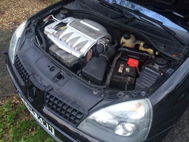

Other than these, I've added/mended/replaced:
  • 3 injectors replaced (after a mis-fire)
  • Alternator (and aux belt kit) replaced
  • Alternator splash guard added
  • N/S rear light connector block replaced
  • New rear numberplate light (kept the LED bulb and put in this)
  • Battery clamp added (with help of @JamesBryan)
  • Boot net added
  • Top engine mount replaced with good second hand one (with help of @Brett)
  • Front engine bay seal replaced with good second hand one
  • Seat belts cleaned
  • Manifold to decat genuine exhaust fitting kit added (again, with the help of @JamesBryan)
  • Rear wiper motor replaced with second hand one (with the help of @JamesBryan)
  • Rear wiper arm replaced (third party one, genuine Renault one will be being bought)
  • Alternator live wire ring connector replaced
  • 2 new front Yokohama S-Drives

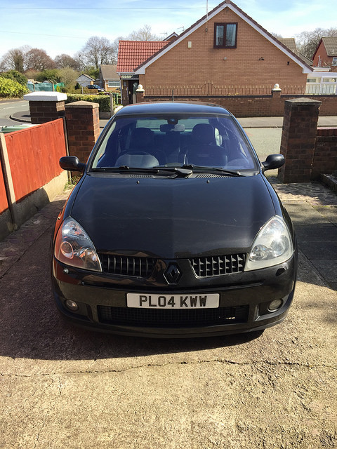

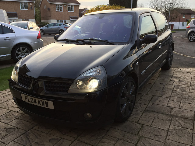

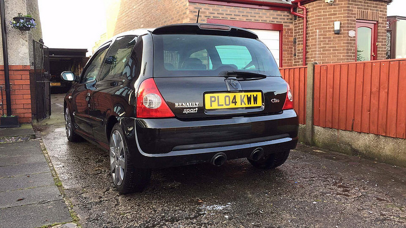

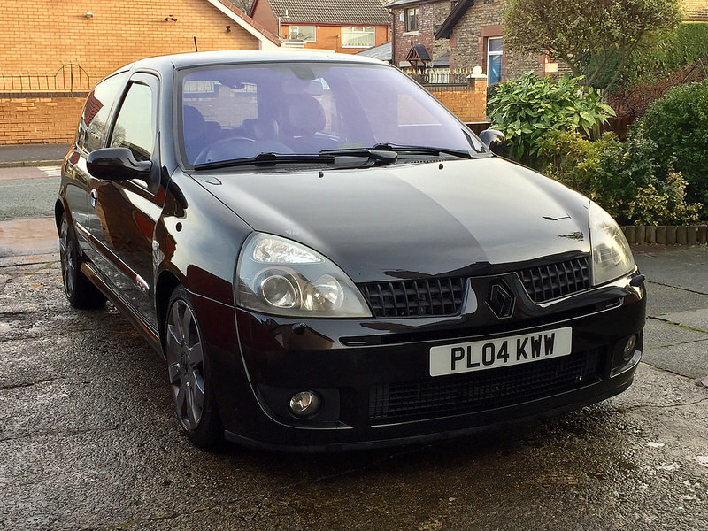

Currently looks like this:
BG Clio 182
BG Clio 182

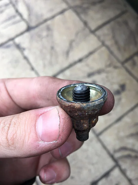

A week or so ago I went out to the car, went to start it and...nothing. Just click. I'd been having issues with the exiter wire coming off the starter motor, that I had fixed by removing the washer from behind the spade connector so it couldn't rotate due to vibration, so I checked this first and it was still firmly on - hmm!
I then started wiggling things and found this.
Oh dear. I would like to thank the previous owner for being a complete moron, and for his not only cheap but incorrectly installed starter motor (I've had to move the wiring around previously to this, and the lack of a heat shield). Anyway a Bosch Starter from my brother's breaker 172 was put on and correctly this time too, so it's all good. Heat shield was also put on this time which I was going to have to put on anyway and so I was considering putting the Bosch one on anyway just for peace of mind. I only use Bosch/renowned third party or OEM for stuff I do to the car so this sits easier with me now.

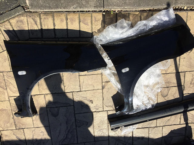

Then came some better weather, so I could finally get rid of my knackered wing and bonnet that had been bugging me for a while.
As you can see in this pic, there is some bad paint peel around the circumference of the arch, weird, no idea how that happened, but was on the car when I bought it.
BG 182

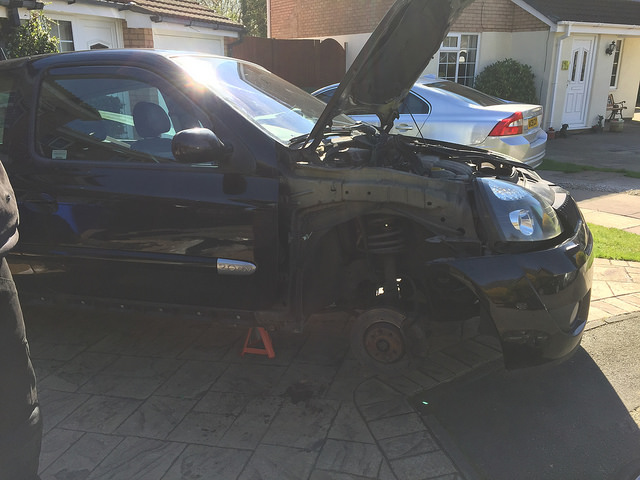

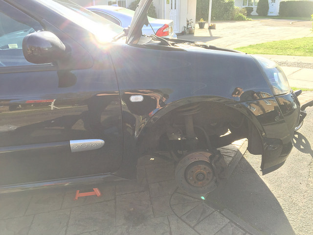

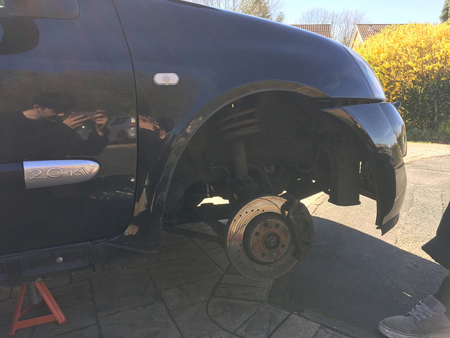

So we set about removing the wing, and that means the side skirt, headlight, detaching the bumper and arch liner.
BG 182
I'd had the new wing for months, bought from eBay waiting to go on. Here's the old wing and new wing side by side, you can see how bad the paint peel was on the old one.

New wing on, looking a lot better!
BG 182

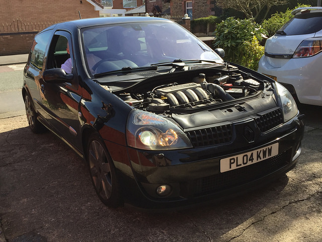

Then onwards to the bonnet. As you might be able to see in the below pic, near the bottom left (O/S) next to the indicator, the bonnet had a circle of bad lacquer and paint peel. Again, no idea how it happened and was on the car when I bought it.
BG 182

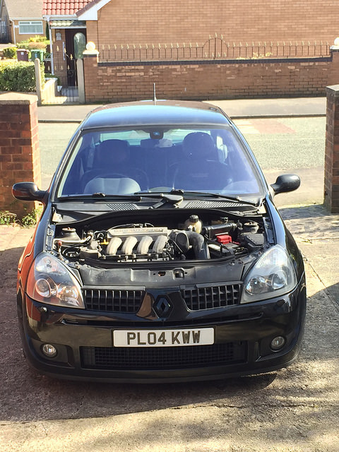

Old bonnet off, was loving the exposed engine mad max look, so aggressive, so I had to take some pics.
BG 182
BG 182
New bonnet sourced from @cs_dave, again had this lying around for months, much better now.

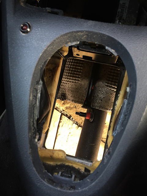

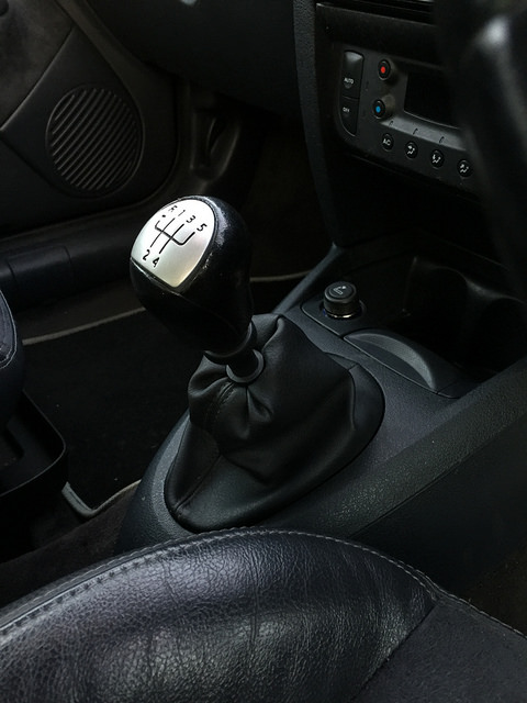

Final job was to get rid of my aftermarket gear knob, it's been bugging me for a while as per the other stuff, it looks OEM from a distance, but it's one of the cheap third party ones that are made of a rubbery material and just don't look or feel as nice as the original leather one, so it had to go.
Got under the car; heat shield off, linkage disconnected, 4 nuts off, and dropped it through the bottom of the car with some manoeuvring past the exhaust.
Also, LOL, short shifter?
BG 182
Weird seeing the floor and your exhaust from the inside of the car.
BG 182

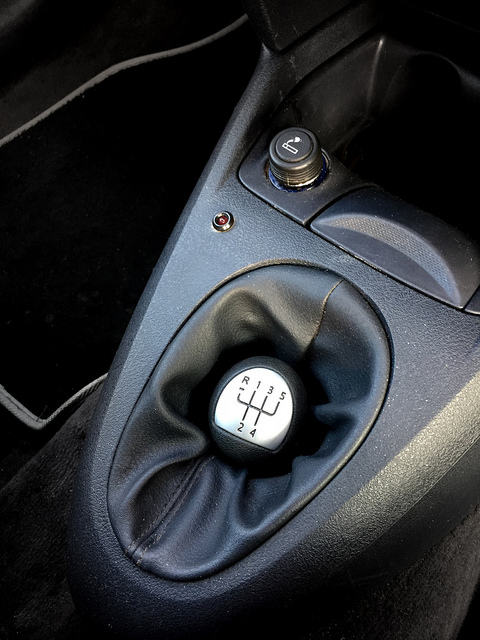

Reversed the process, and the new gearstick is in, nice to have it as it should be.
BG 182

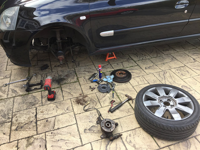

So, another very generic update as has been seen a million times here before, however I'll post anyway for the sake of having a diary of the work on the car.
Updates are as follows:
  • New Renault N/S front wheel bearing
  • Replaced N/S lower ball joint
  • Replaced rear wiper motor
  • Cleaned throttle body
  • Replaced upper gearbox mount

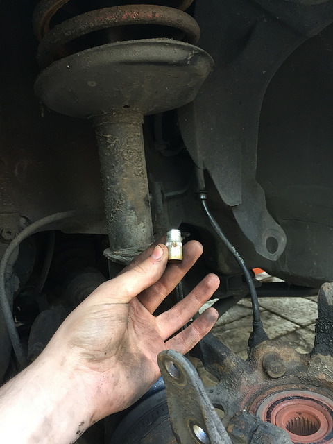

After the last update I put up on here I discovered while the car was jacked up that my front left wheel bearing was knackered, wheel was moving top to bottom with a clunk sound. We checked the hub nut and torqued to 280nm as per spec, still happened, so new wheel bearing it was.
Amusingly, for those who follow Car Throttle/Car Memes on Facebook, when we unclipped the arch liner a wild 10mm socket appeared:tearsofjoy:
BG 182

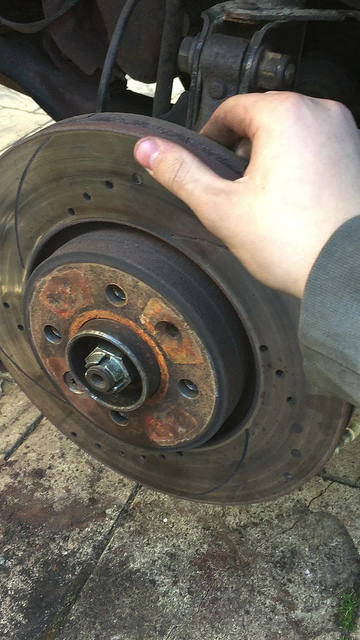

Anyway, myself and @JamesBryan took the car apart and got the hub off with much WD40 and ugga dagga's of the impact gun.
BG 182

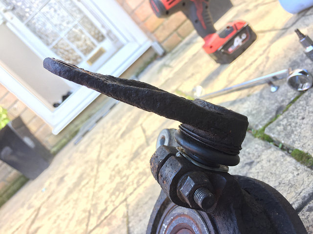

Upon taking it apart, we discovered that the lower ball joint had seen some better days having some lateral movement with a little clunk as per the wheel, so to be thorough we went and grabbed a good one from my breaker ph1 172 and put that on and put everything back together quickly just to be sure it wasn't the ball joint.
BG 182
The problem persisted, so it was definitely the wheel bearing.
We then popped over to @Jonff's to press the old bearing out and the new one in. All was going smoothly until after we had pressed the new bearing in, and it was both very stiff and had an even more severe clunk than before. Hmmm, not good, or at least we thought so. We went back and put the hub back on the car, and as you can see below this was the amount of movement we had.
BG 182
At this point I was getting ready to call the AA to recover me from James's house as it would have been totally undrivable/unsafe to drive on with so much movement, then James buzzed the hub nut on tight and hey presto - solid as a rock! We then torqued it to 280nm, put everything back together, wheel back on and it was totally solid. Lowered the car back onto the ground and took it for a drive, all totally fine. Weird right?!

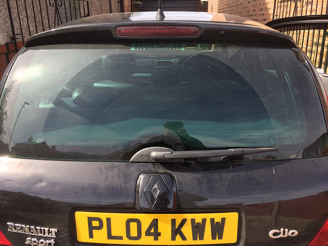

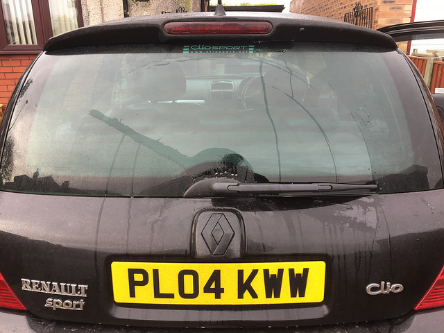

Also this week, my new rear wiper motor came, as some may have seen I had some issues with the one from my breaker ph1 in that they are actually different between ph1 and ph2, must be either a different part or a different signal perhaps? Anyhow I put this on and now it's working perfectly, which is such a relief after the old one was scratching my boot lid and not wiping the whole window.
Before:
IMG_3744
After:
BG 182

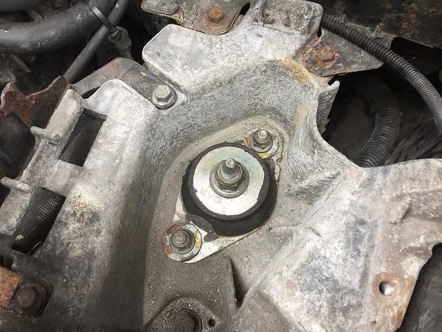

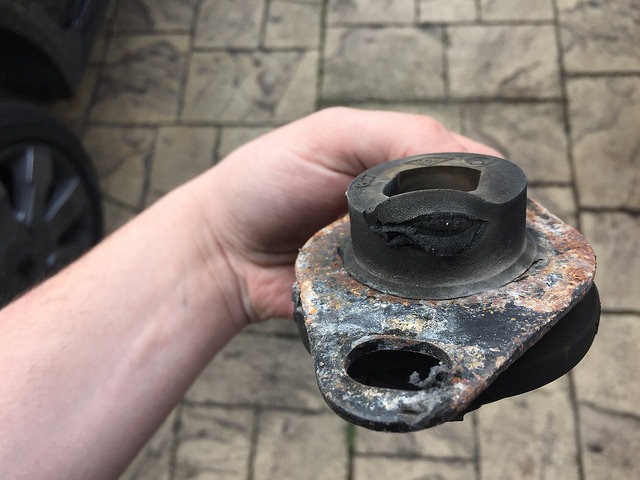

Finally, this weekend (after picking James's rebuilt gearbox from @NorthloopCup) we set about changing the upper gearbox mount for the nearly new one from my breaker ph1. I'd had an awful clunk/bang when changing from 2nd to 3rd or 3rd to 4th when driving spiritedly shall we say, so it was clear a mount was at fault, we'd already powerflex'd the dogbone and replaced the upper engine mount with the good one from my breaker ph1 so this was the last one on the list. This is what the old one looked like when we pulled it out - not great!
BG 182
BG 182

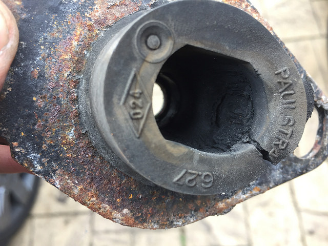

The rubber had totally given way inside and felt just like solid metal, hence the bang when changing gear. New one on and torqued to 12nm for the smaller nuts and 62nm for the big nut.
BG 182
Drove it afterwards and it feels a lot better, feels exactly as it should, no more horrible metal on metal clunk when you're giving it some poke. Very glad to have this sorted as it'd been irritating me for ages, especially having driven other cars that were fine, so this should futureproof it for quite a while now.

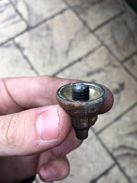

Lastly, we were going to attempt to lower my seats by removing the plastic spacers after being inspired by @Louis' thread, however this happened to the inside thread. F*cks sake.
BG 182
So this week the hunt begins for either a new slider or whole new seat.
BG 182
BG 182
I saw you posting about your issues with that bearing on facebook mate, glad you got it all sorted! I also received that clear repeater mate forgot to say sorry! Cheers for that really appreciate it.
f**king bummer on that bolt snapping! You must have been going at it with a breaker a fair bit haha. Looks to be the one that's near to the exhaust though? Mine were rusted to buggery too, applied plenty of copper slip on refitting. Seems stupid how exposed those ones are, as the others are under those bungs and in great condition. Could you not completely grind that old broken stud off, drill through the slider and then nut and bolt it? Or weld like a captive nut? Sliders aren't expensive though to be fair.
Niall
Yeah was just our simple mistake really, no harm done, all good now. And yeah no worries bud!
Yeah we did buzz it with the gun but it would have snapped anyway it was so corroded, the ones under the bungs came straight off no issues. As you say a new slider is so cheap it doesn't really matter, just inconvenient. Seat is relatively solid for the time being.

It was 21Nm for those smaller nuts mate, not 12Nm.
Things that shouldn't have gone smoothly have gone smoothly and jobs that should be easy have been a ball ache haha!
Mr Trailer Man
Potentially was why it wasn't right though in all fairness, might not have been tight enough?
Yeah i doubt the old one was tight enough/torqued really. Goes to show how much torque you can apply when using a torque wrench compared to using the 1/2" ratchet. Did it up with the ratchet and it felt tight, put the torque wrench on and got a few turns on it.
