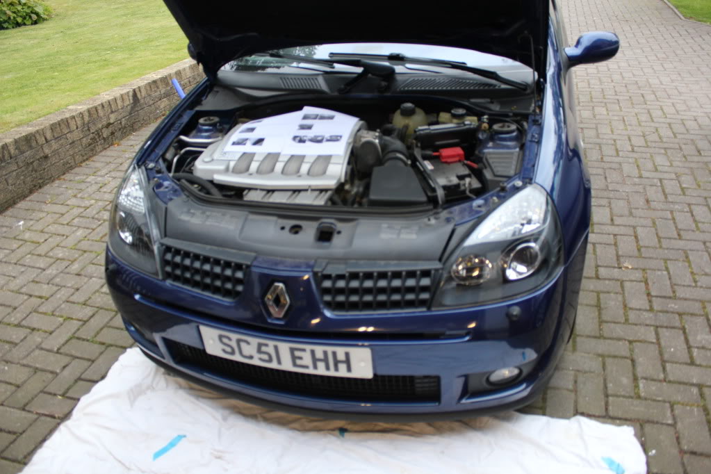

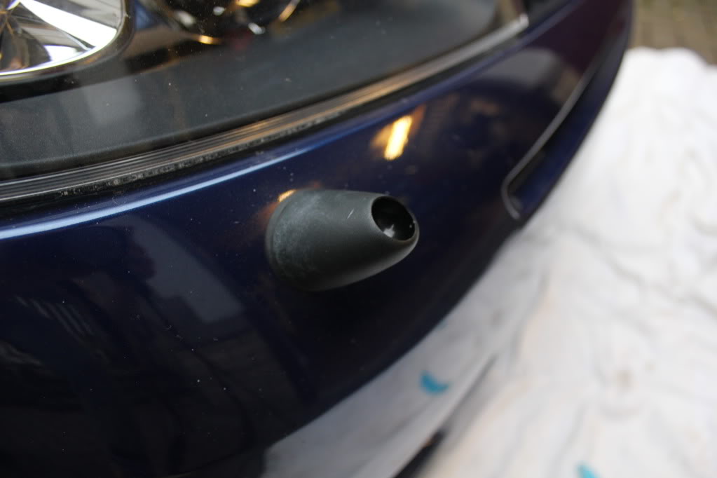

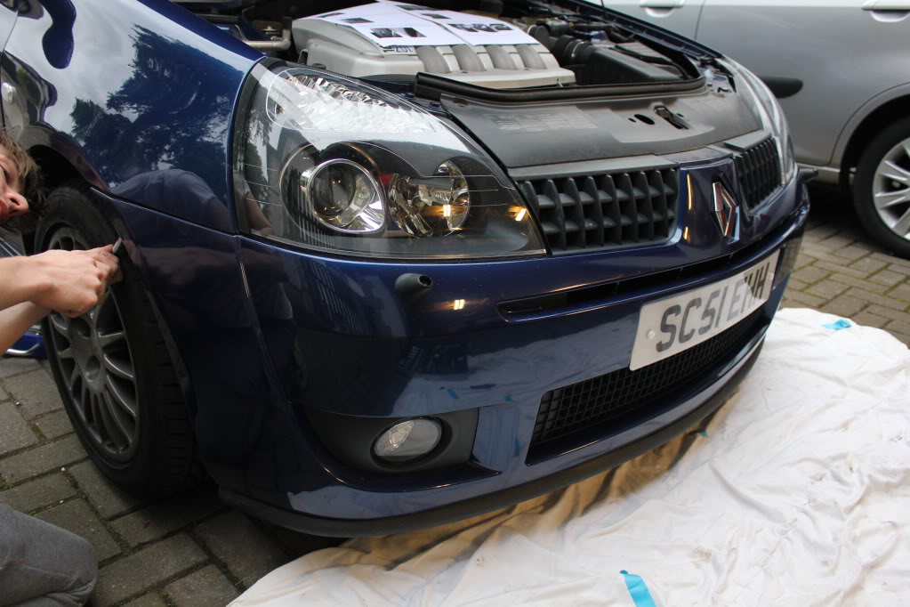

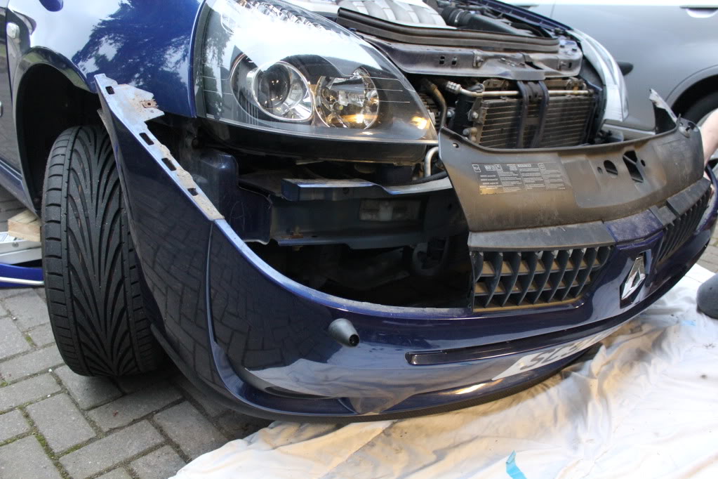

My Driver side washer was broken when I bought the car - common fault.
It was the first thing I said I'd fix so naturally it's 10 months later and I just haven't got round to it.
So:
So that's the smaller, wider Renault Sport Megane Washers fitted. They seem to mist nicely and are fractionally neater than the standard 172 ones :)

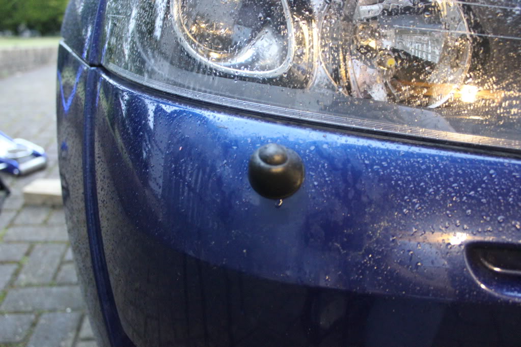

Ah a sceptic :p I was slightly sceptical and also took the attitude that "if they're there and they spray - they'll pass an MOT"
However they work great. If you have ever removed the washers they have a little locating nipple on the washer and in the hole. These megane ones have that too. Also they aim lower so I'd imagine they'd actually get more effective at speed, as the airflow forces the water over the light. They also clean the light perfectly when the car is static. :)
