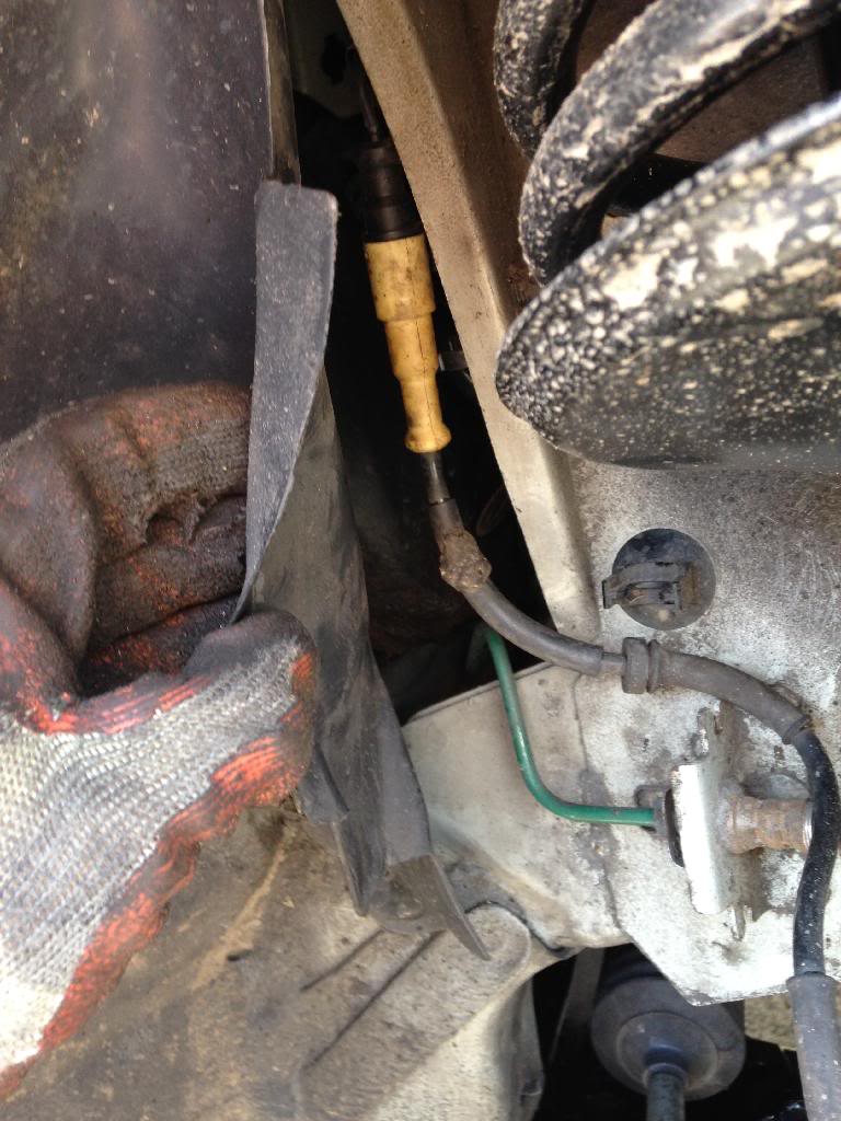

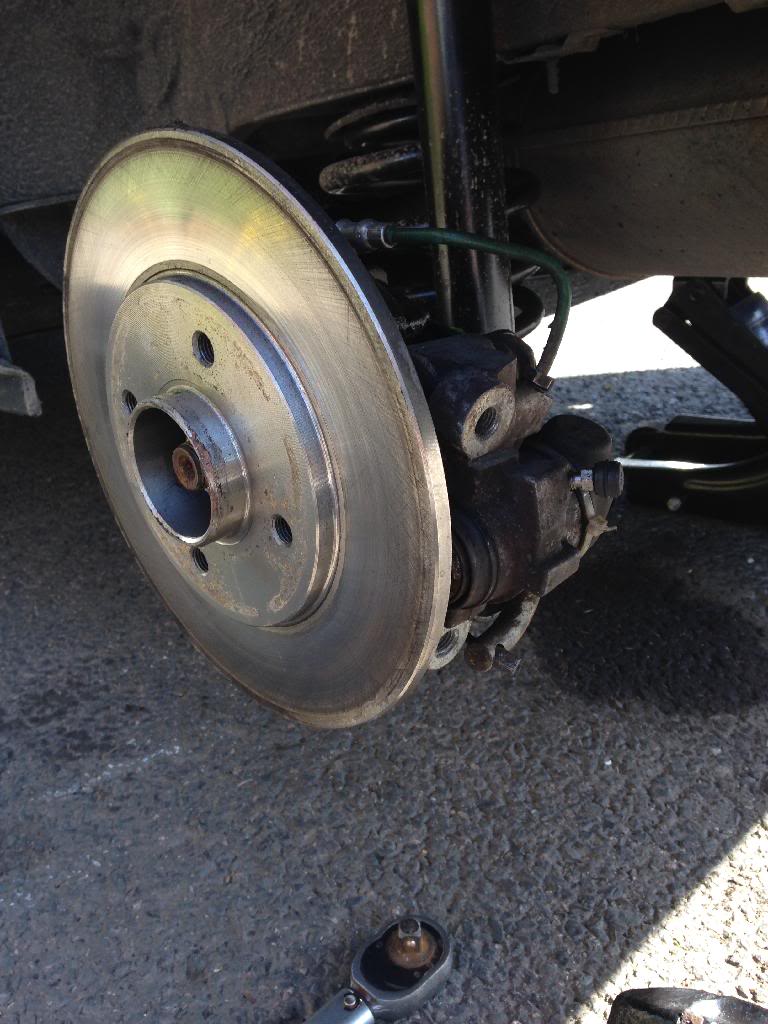

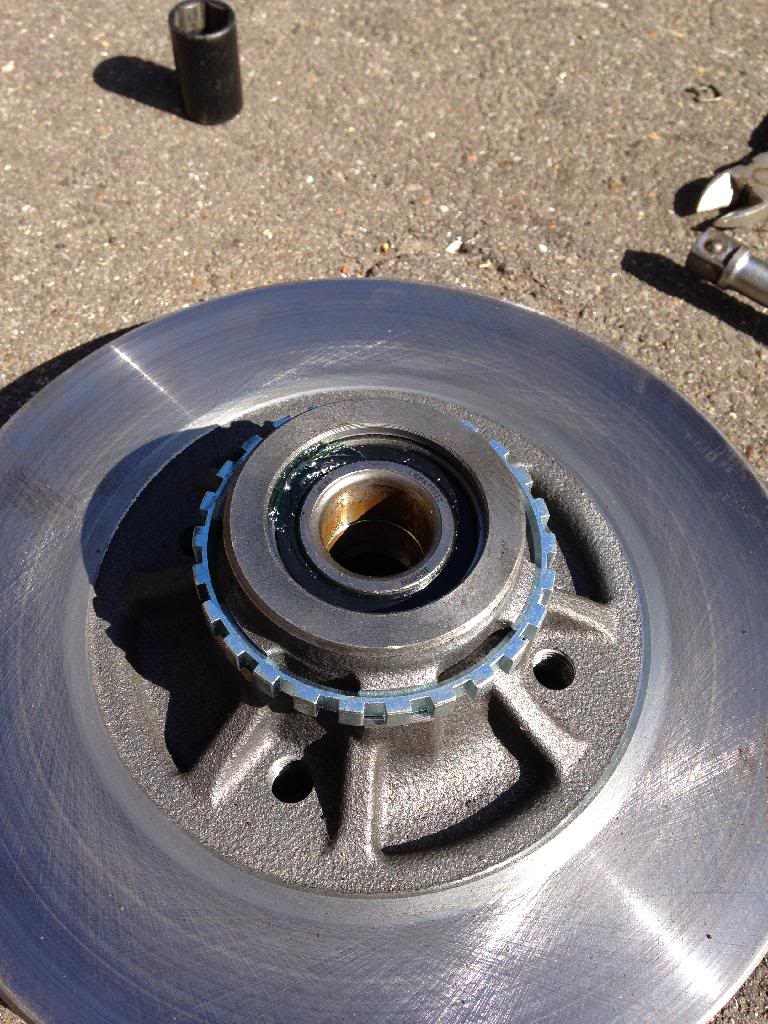

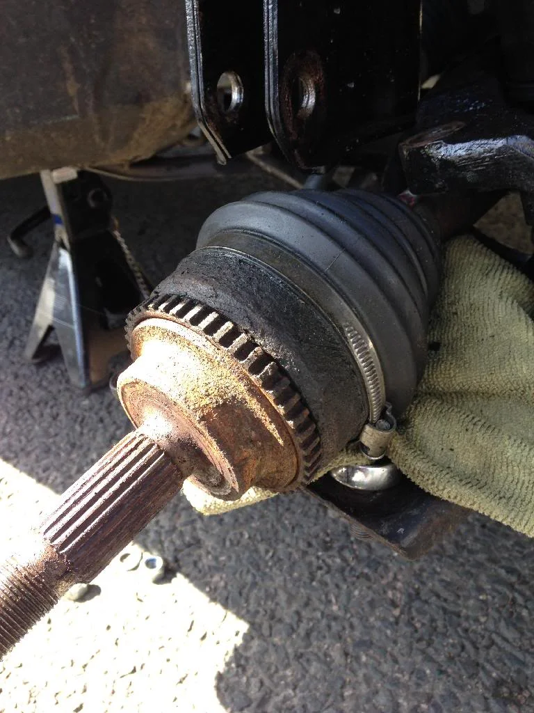

Right, here are the photos.

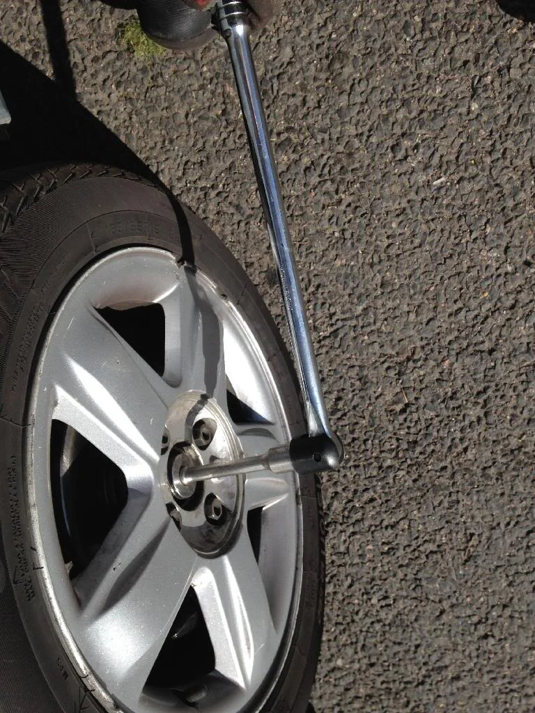

Rears are easy, slacken hub nut (30mm), wheel off, pad carrier off, disc off, get a screw driver behind the ring gradually working it off.

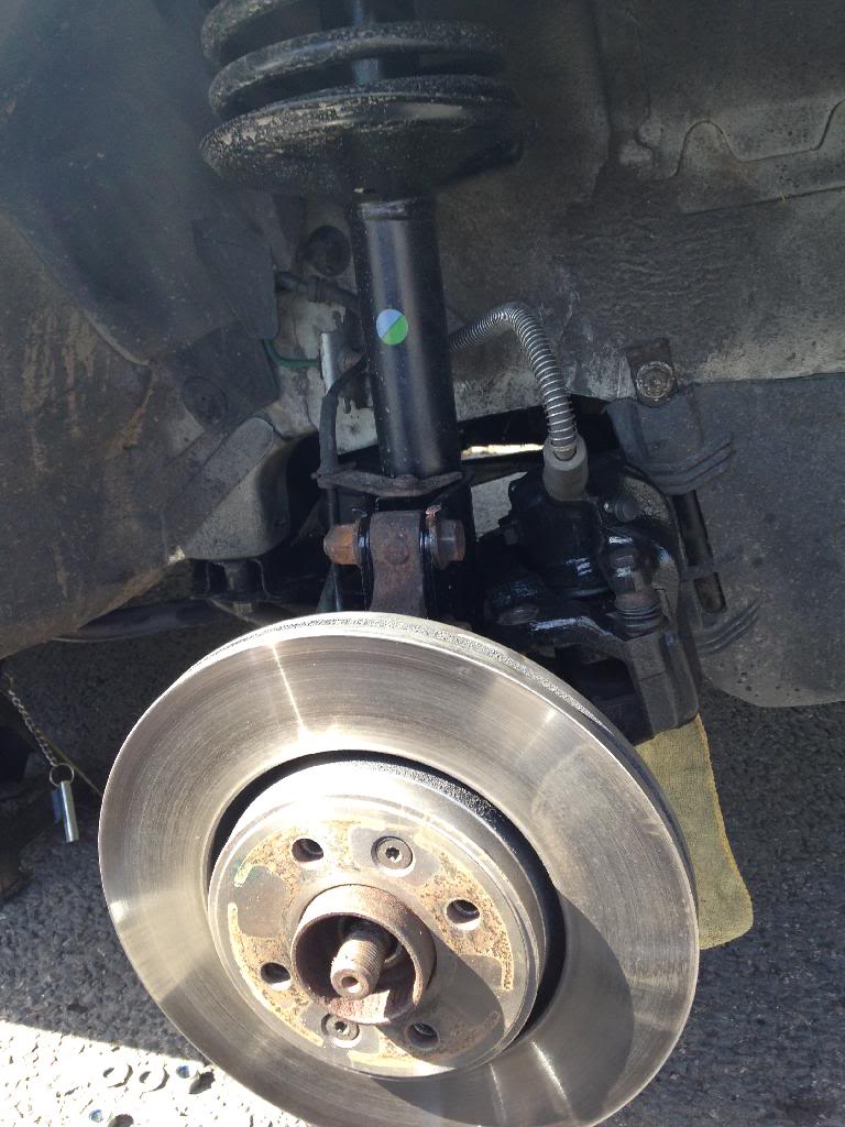

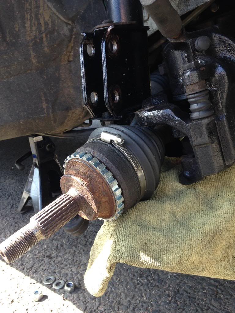

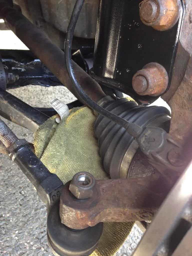

Fronts are also nice and easy
Slacken hub nut (30mm), take off wheel, loosen caliper hub bolts, tre, lower ball joint (2 that bolt to wishbone), disconnect abs sensor and loosen strut bolts. Once it's all loose take the track rod out of the hub, remove the caliper from the hub, put a rag inbetween the driveshaft and wishbone to prevent damage to the CV boot. Take out 1 of the strut bolts, take nuts off bottom of ball joint. It should then be free apart from the strut bolt which you can now remove.
You can do this job in situe, get a hack saw, cut the ABS ring off, not all the way, quite deep into it, then use a screw driver to split it. Clean up the area where it was. Start to put the new one on, working your way around until it's in the same position the old one way.
Put the car back together.
