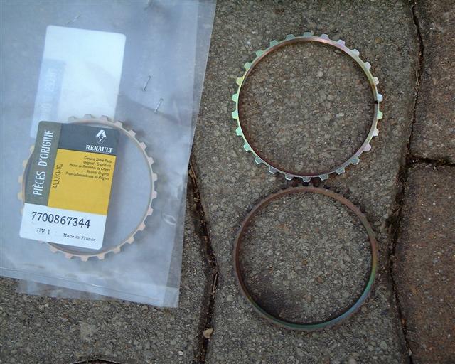

I actually noticed today that my abs ring on my 172 had split, i phoned renault today to ask if they had a replacement and was told that i would need the whole driveshaft OUCH!
Is there nowhere that does them as seperate rings for the front?
NO idea, the problem is on the dialogies its not normally listed under the car/ driveshaft like it should be. Heres proof they are sold seperatly but i doubt this is the right one.
The pic I posted is for a rear brake disc. Count the number of teeth on the ring and nag the parts person as Im sure they can get them they just have to dig deep on the dialogies to locate them. Failing that get them to ring up another dealor.
